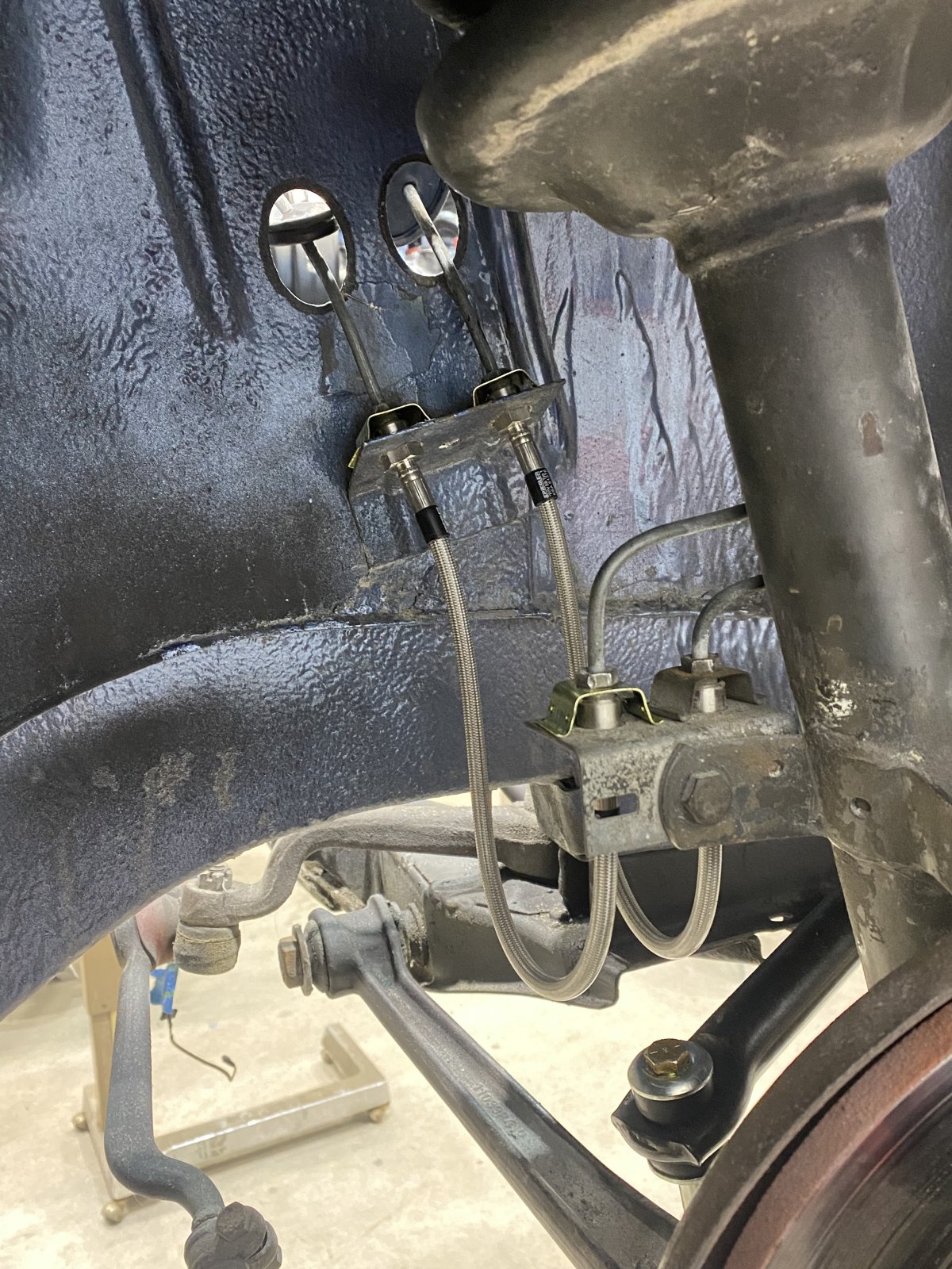

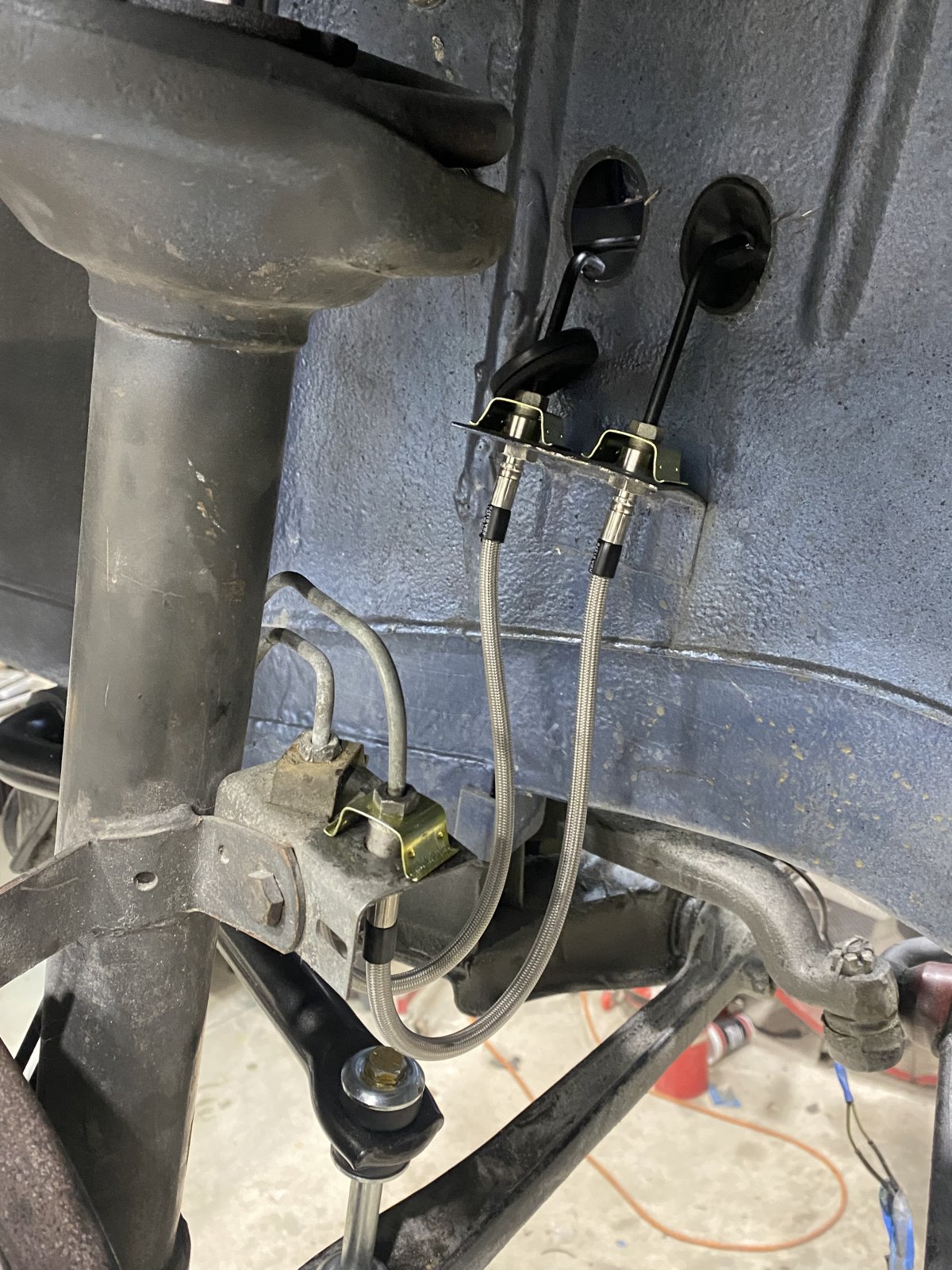

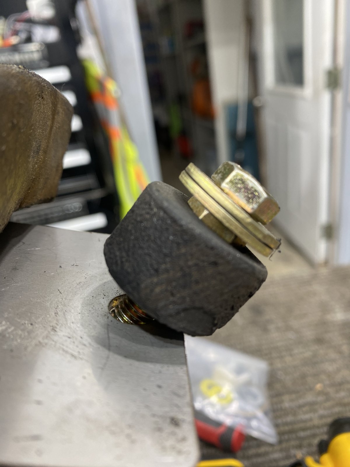

Tuesday finished up anti sway bars with needed new bolts and new SS break lines…
Wednesday worked a couple of hours in shop way to cold today…

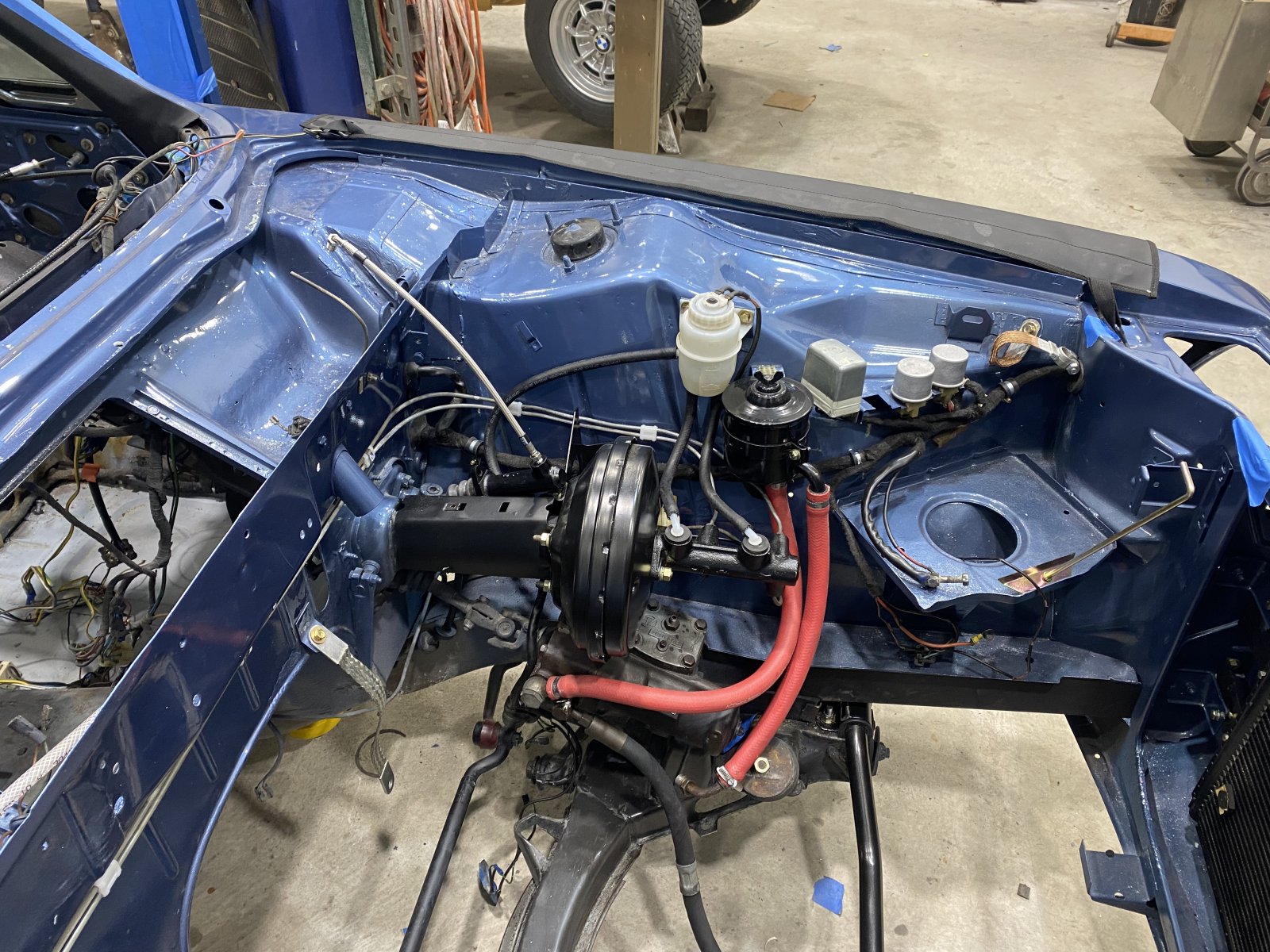

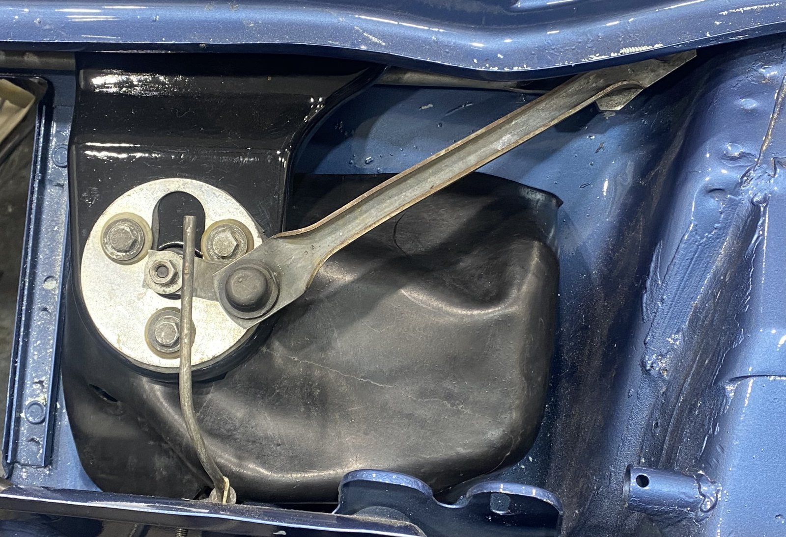

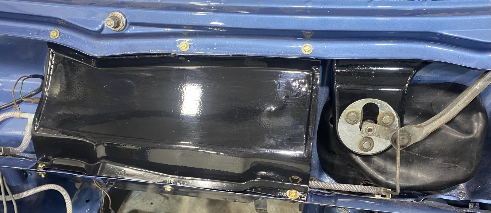

here, installed wiper motor with cover I made and test fit heater intake cover..

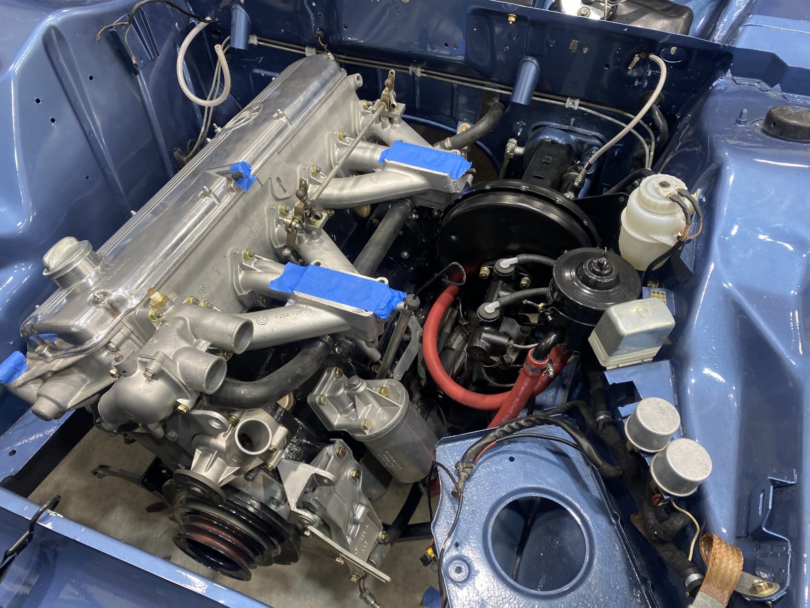

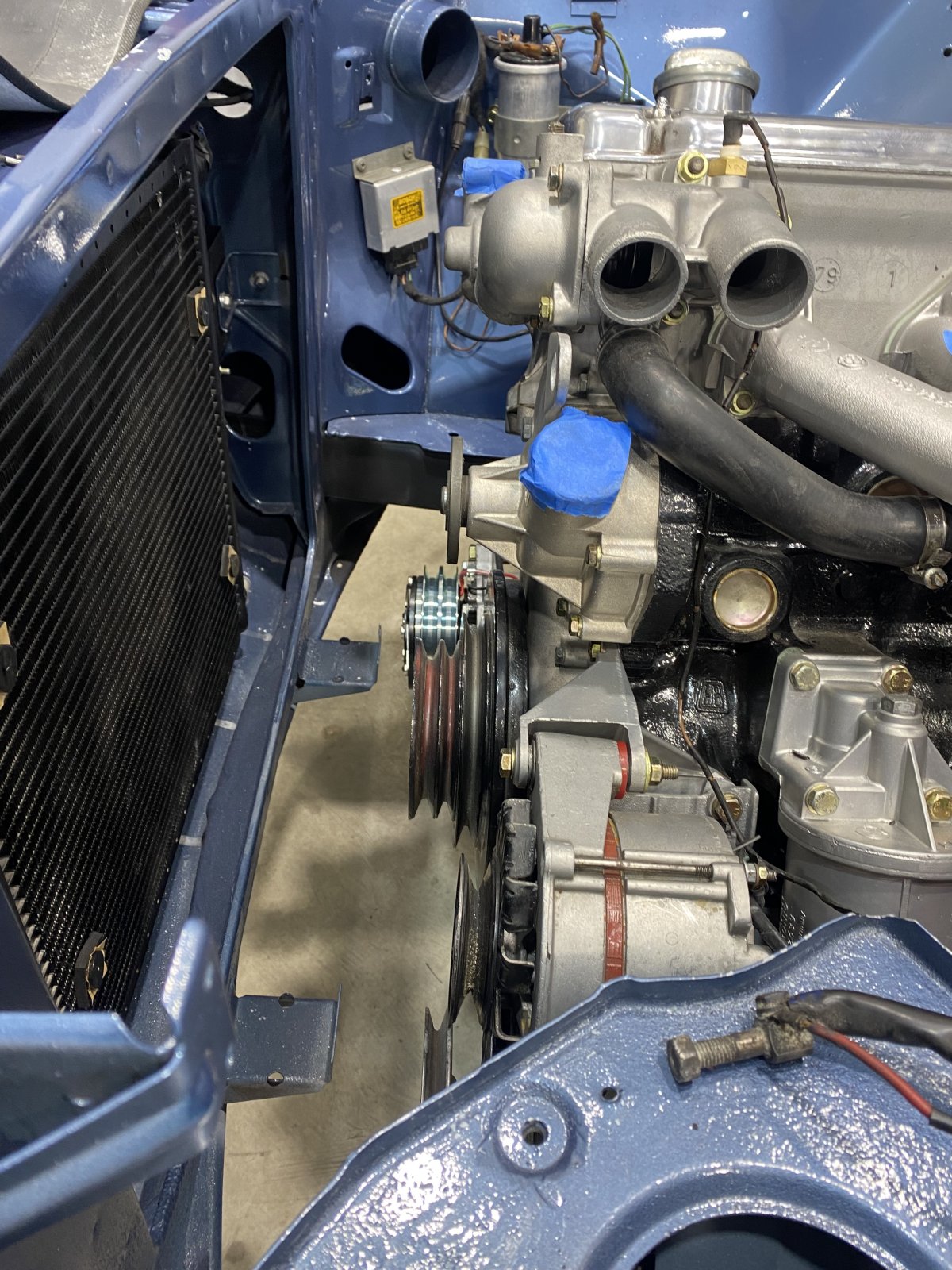

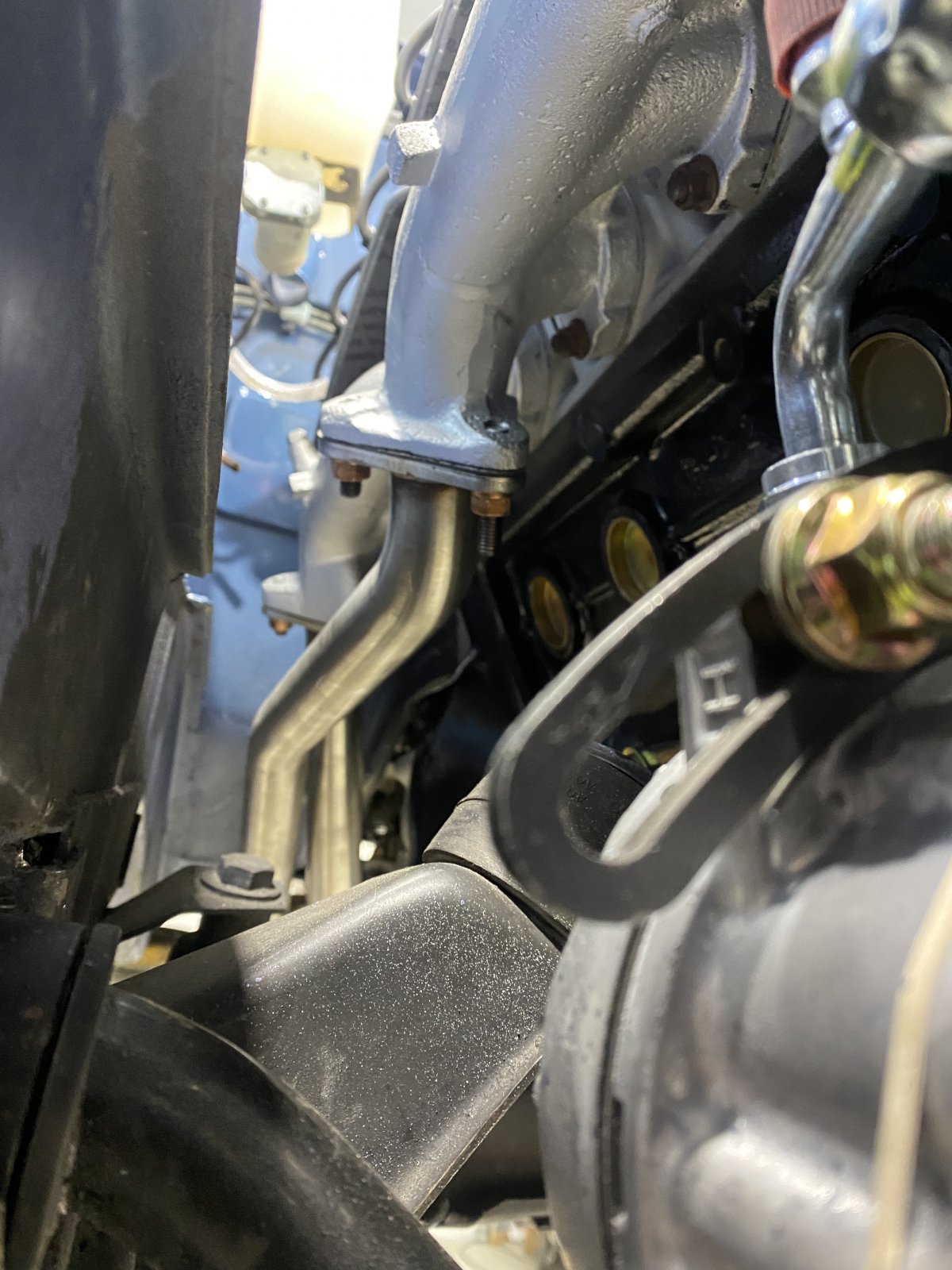

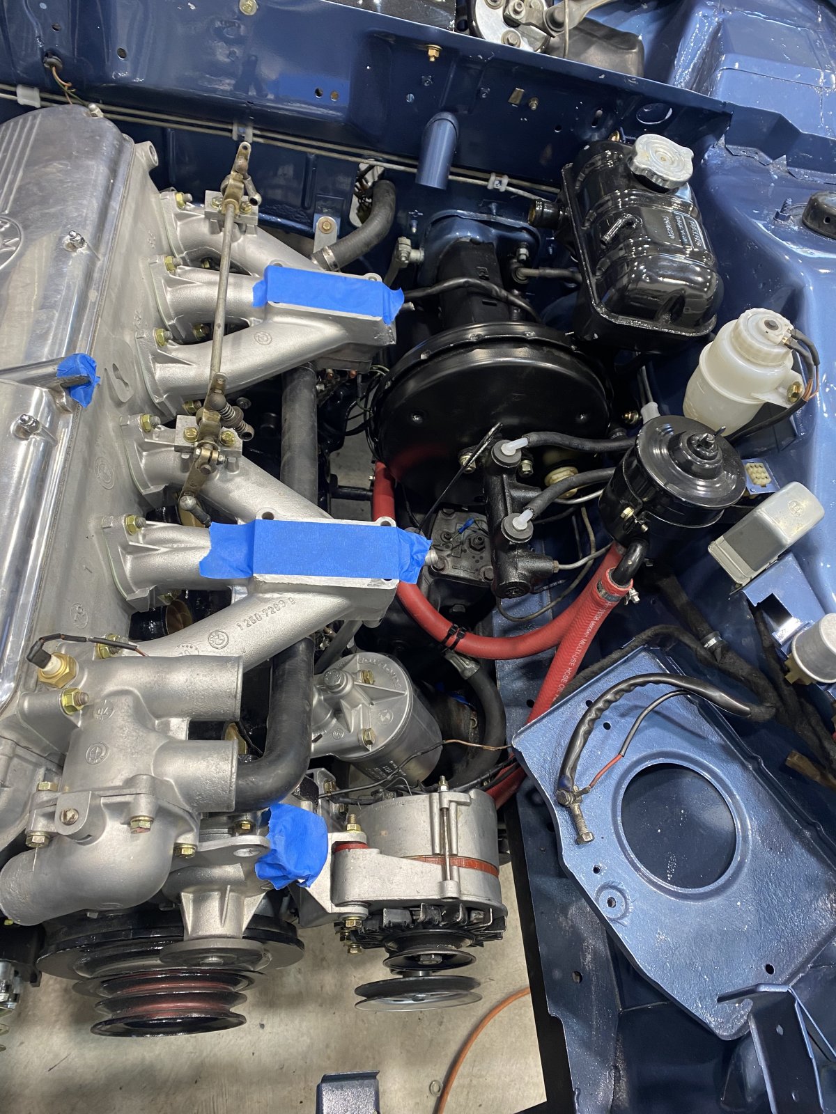

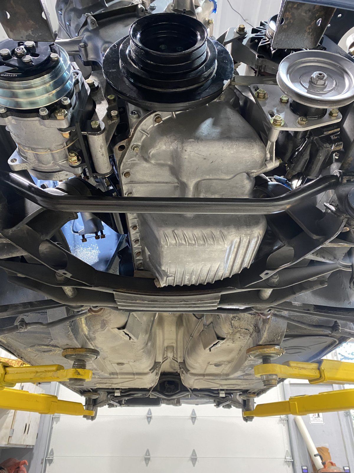

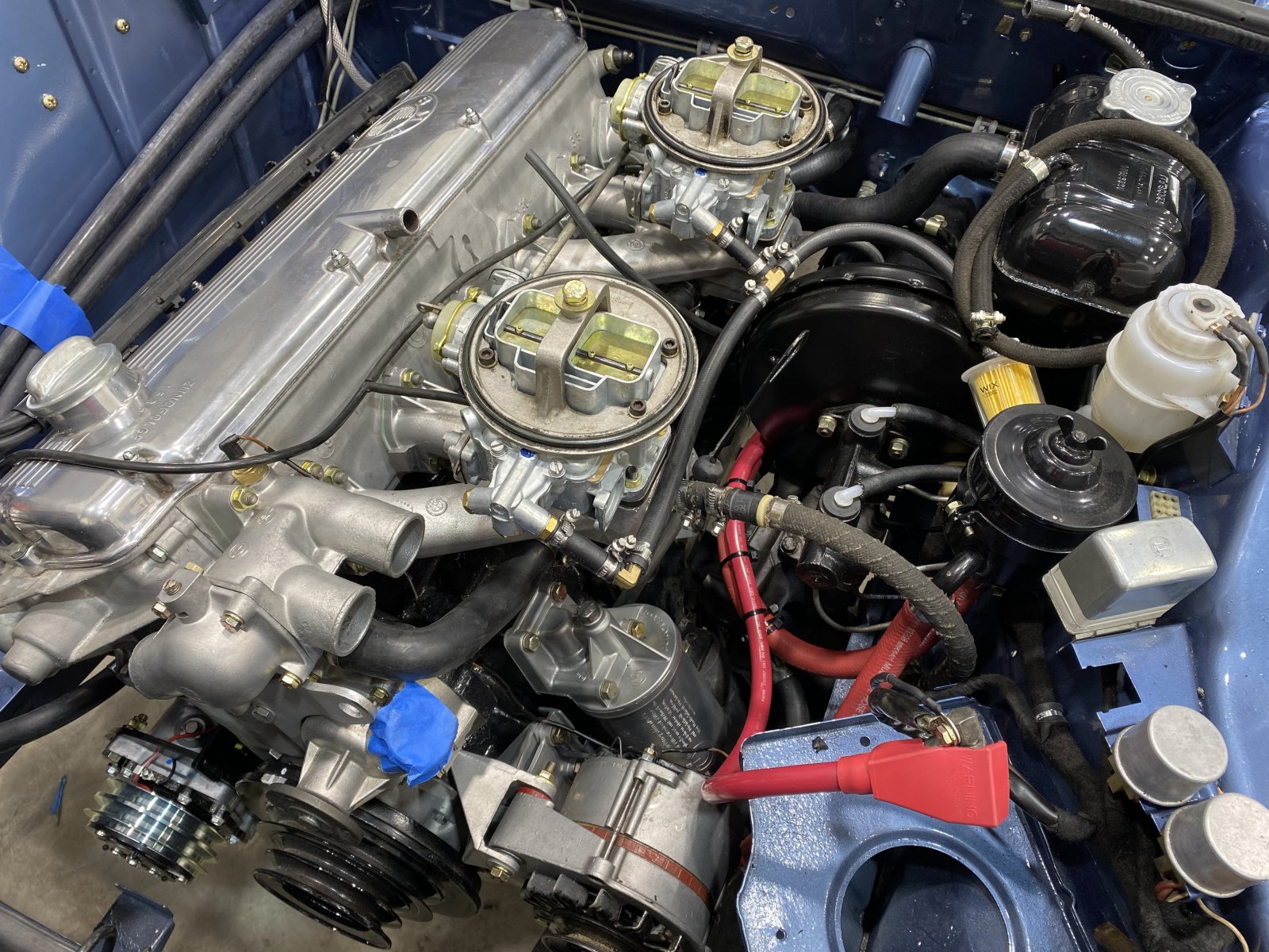

Tuesday I’m continuing on with the engine bay mounted the power steering pump, alternator and installed the Sanden AC compressor…

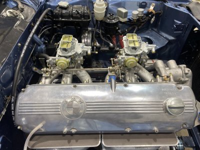

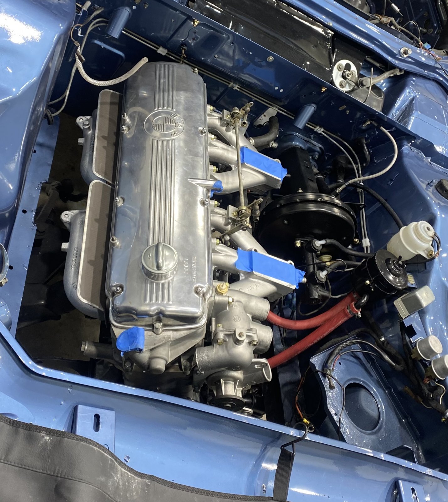

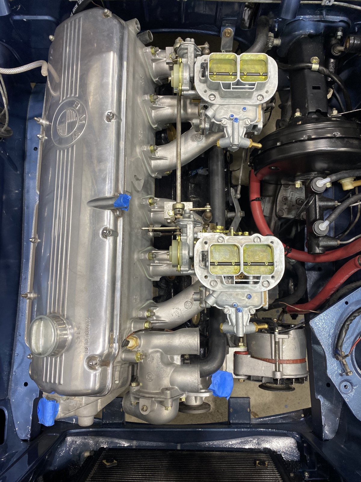

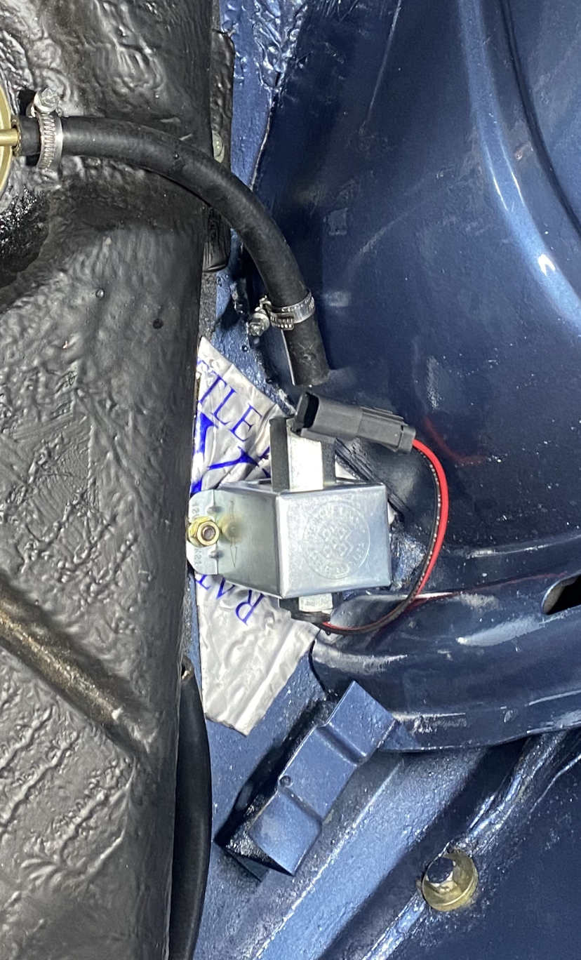

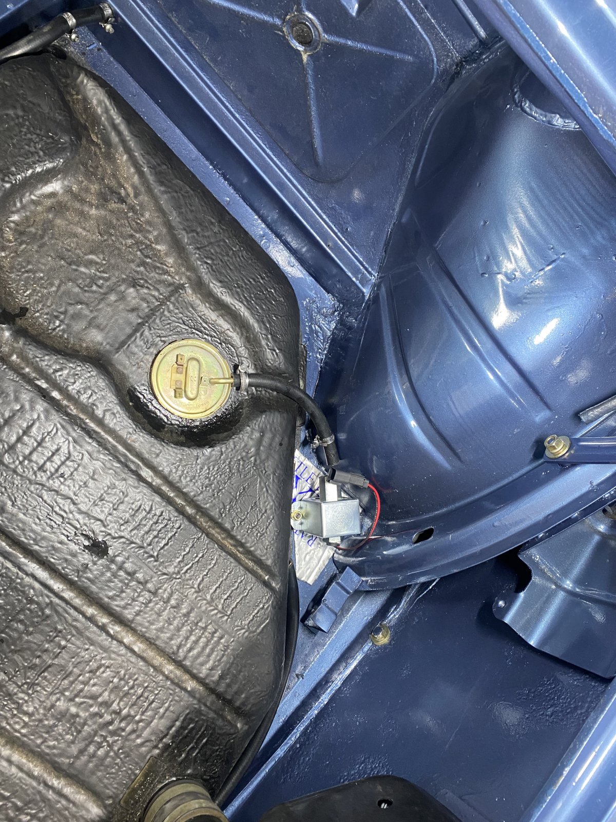

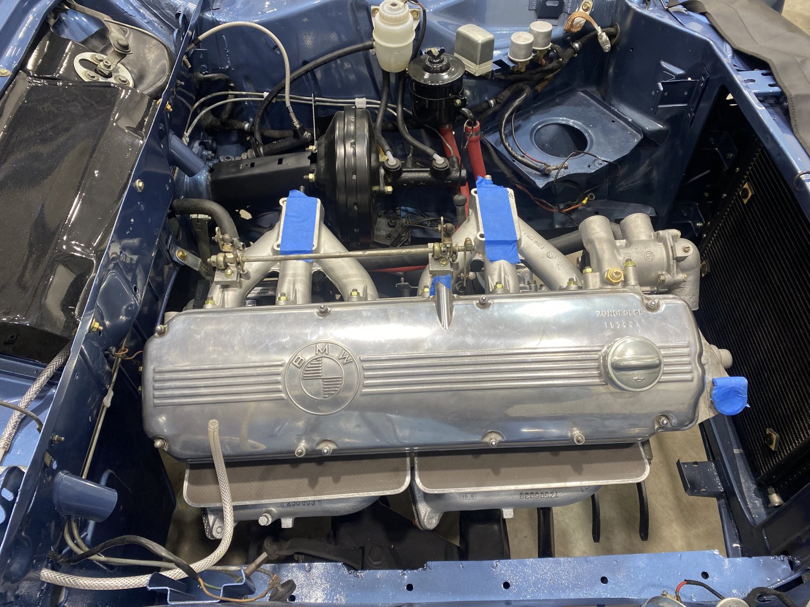

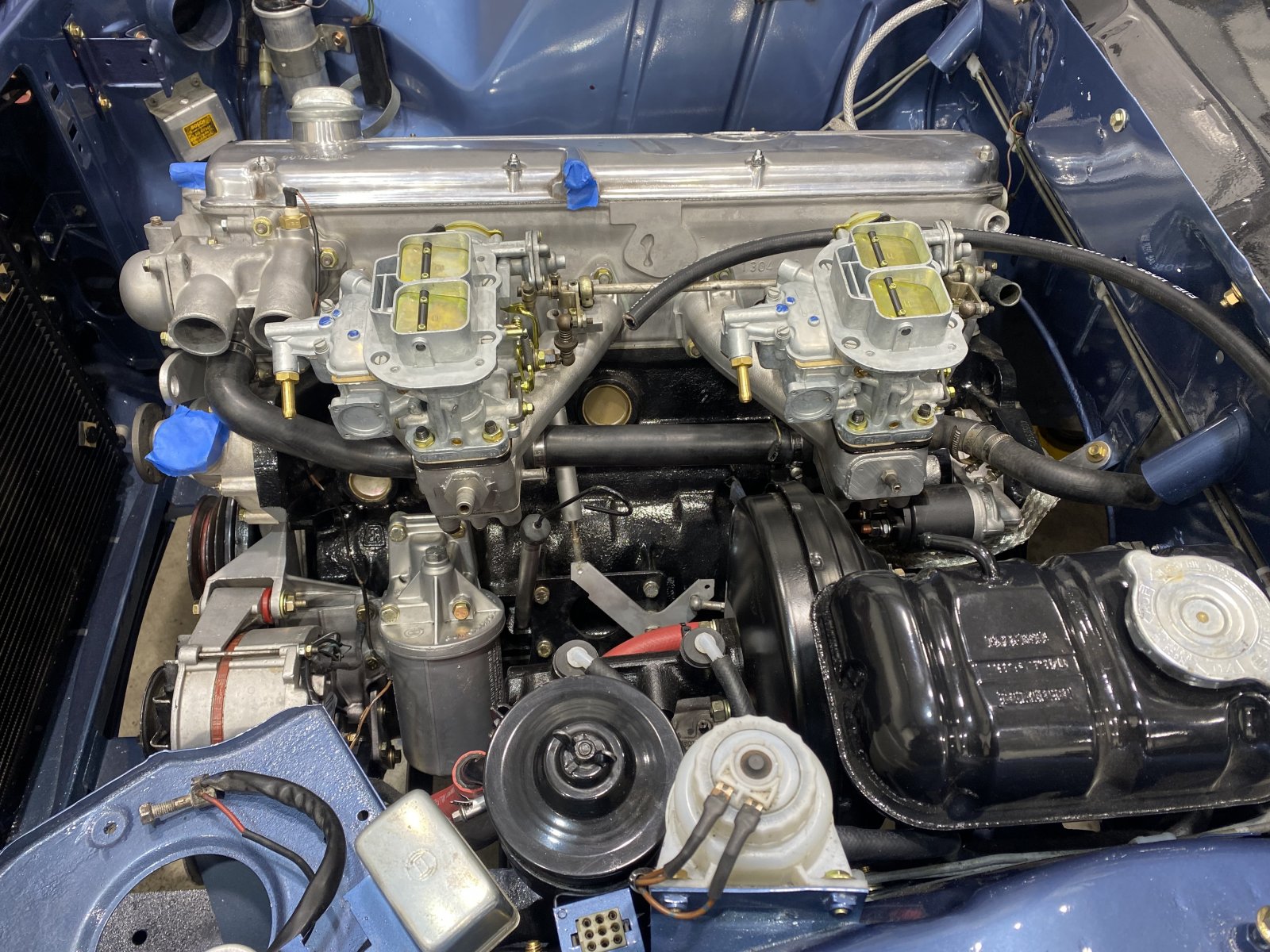

Fuel pump, fuel line and carbs today…

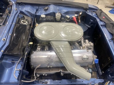

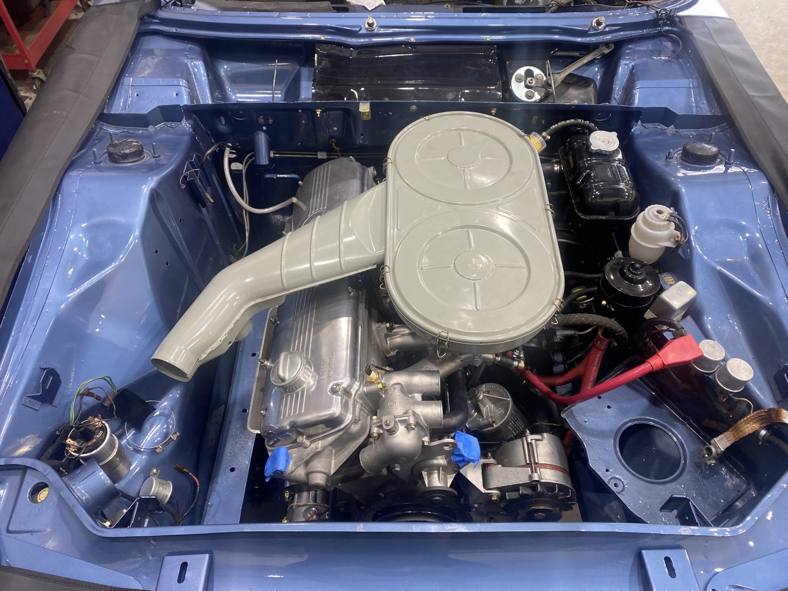

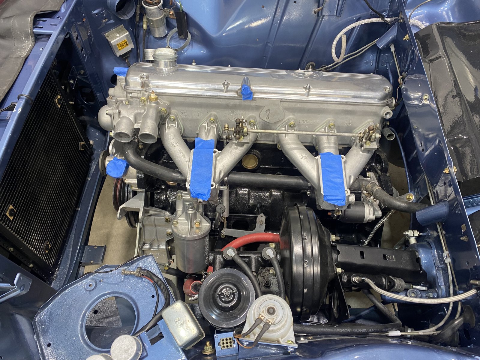

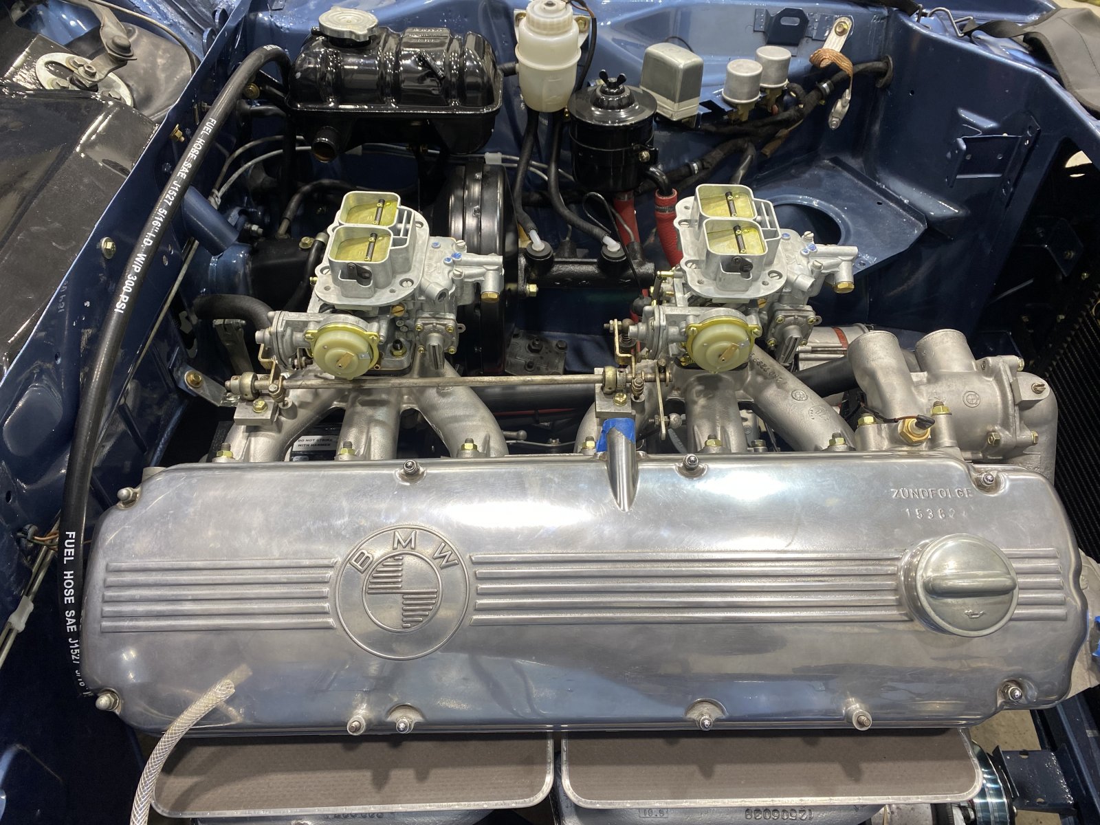

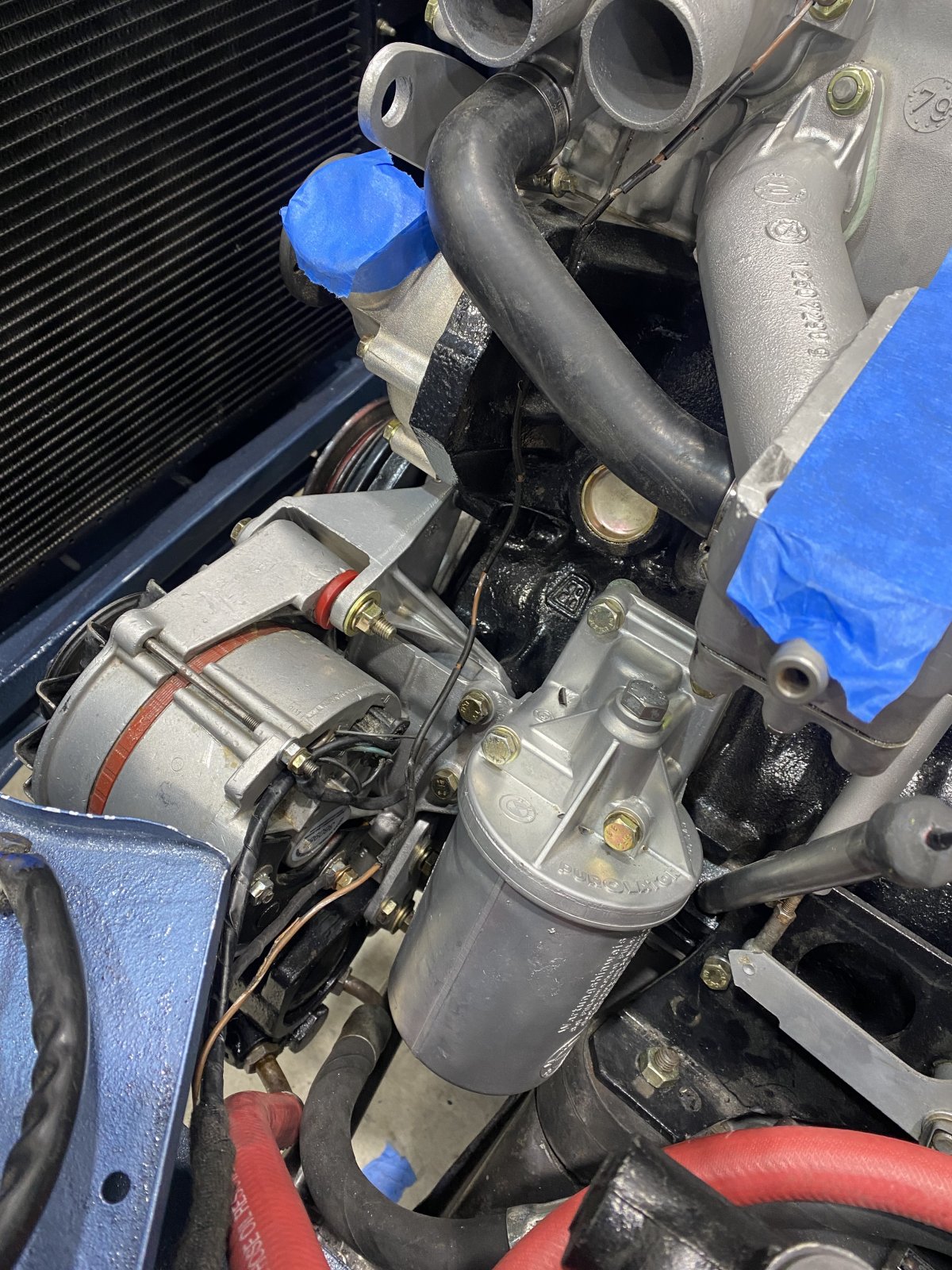

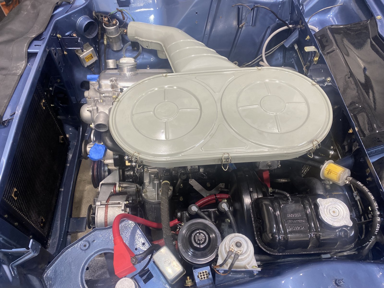

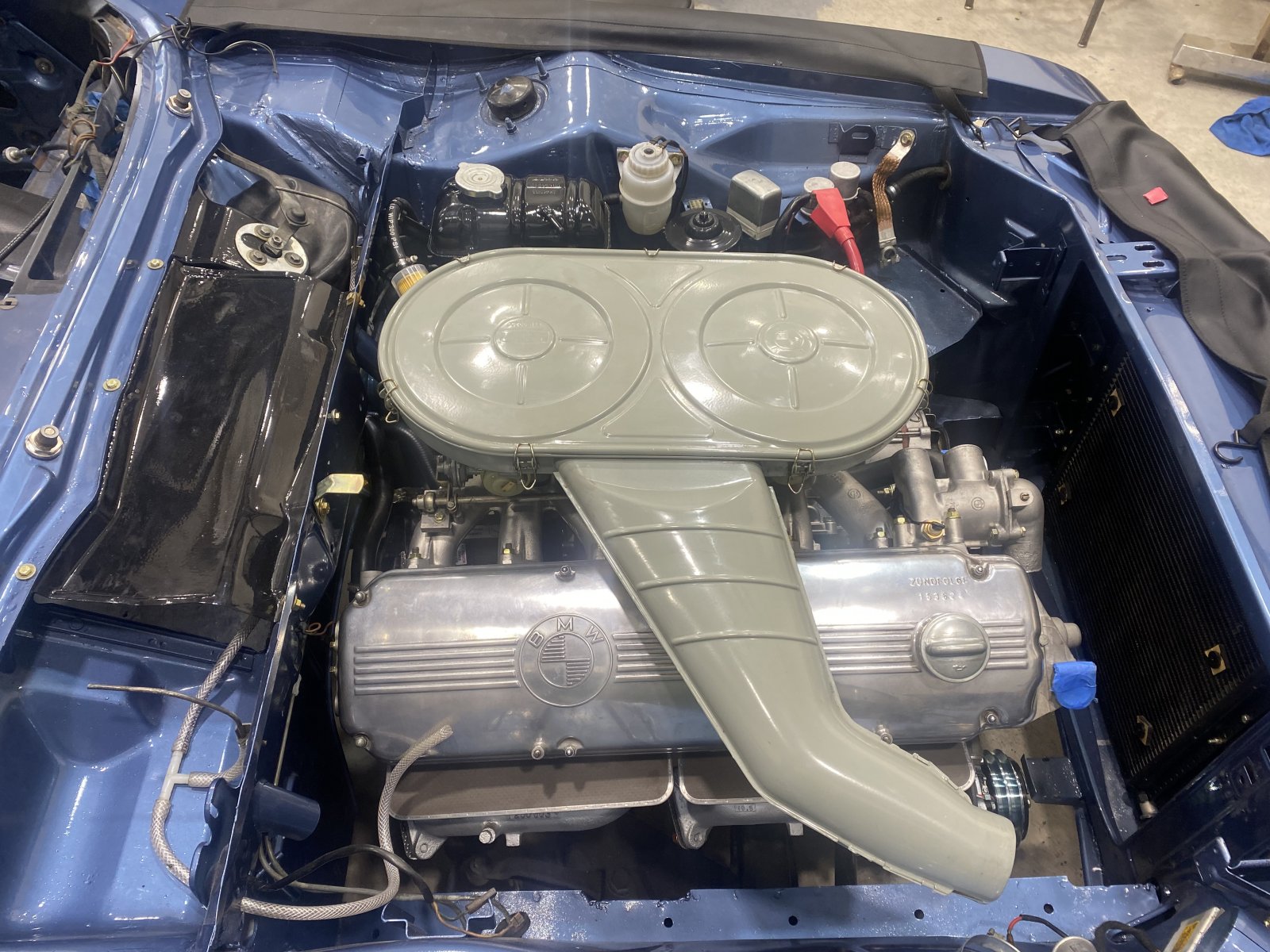

Fit the air filter housing / installed oil filter today, I’m about finished in the engine bay. I need to run into Austin and pick up some fittings and start the air conditioner hosing next before finishing up the fan, radiator and hosing in engine bay..

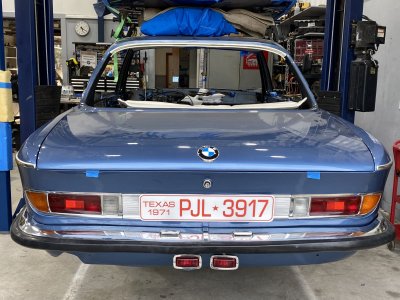

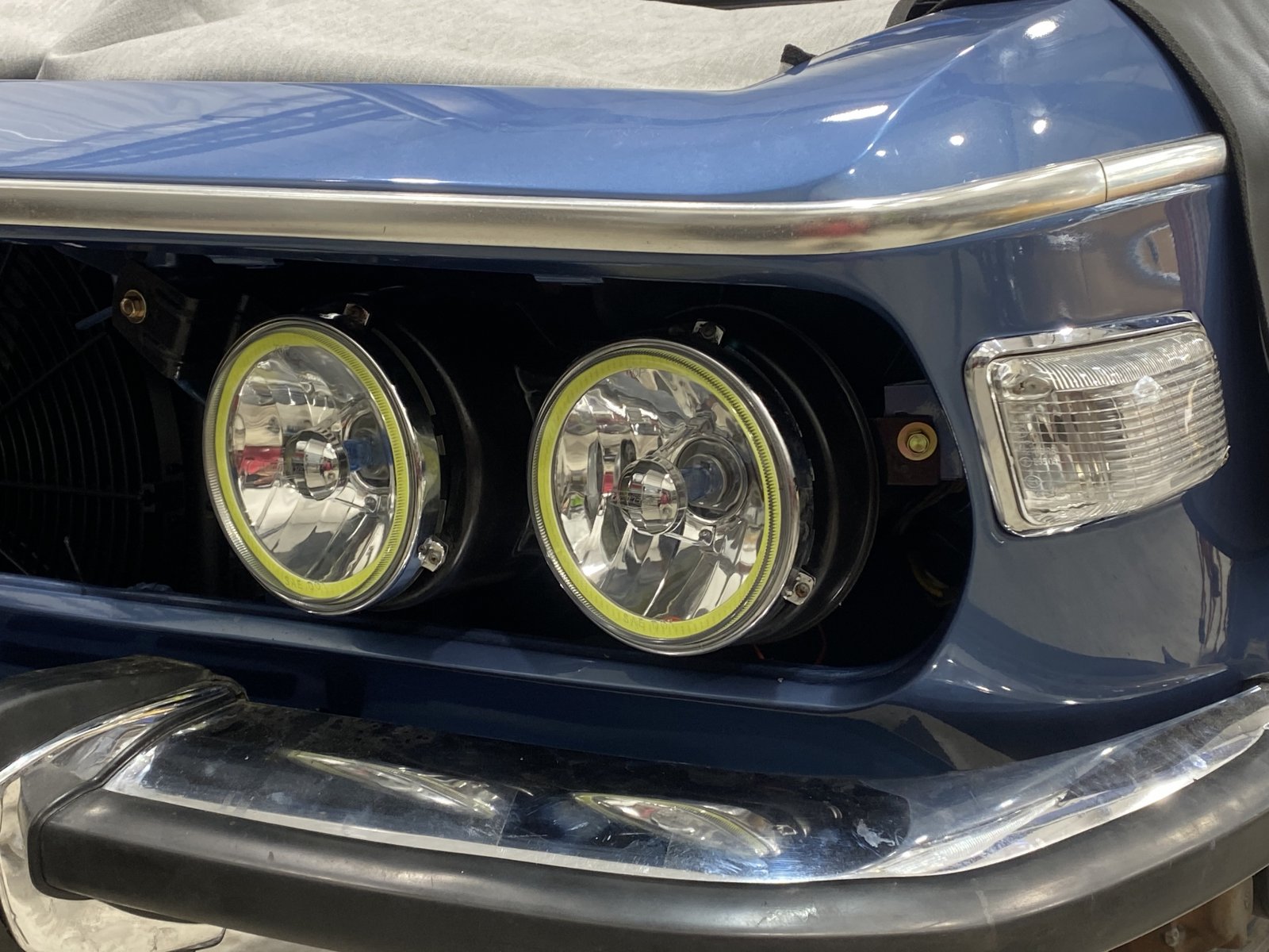

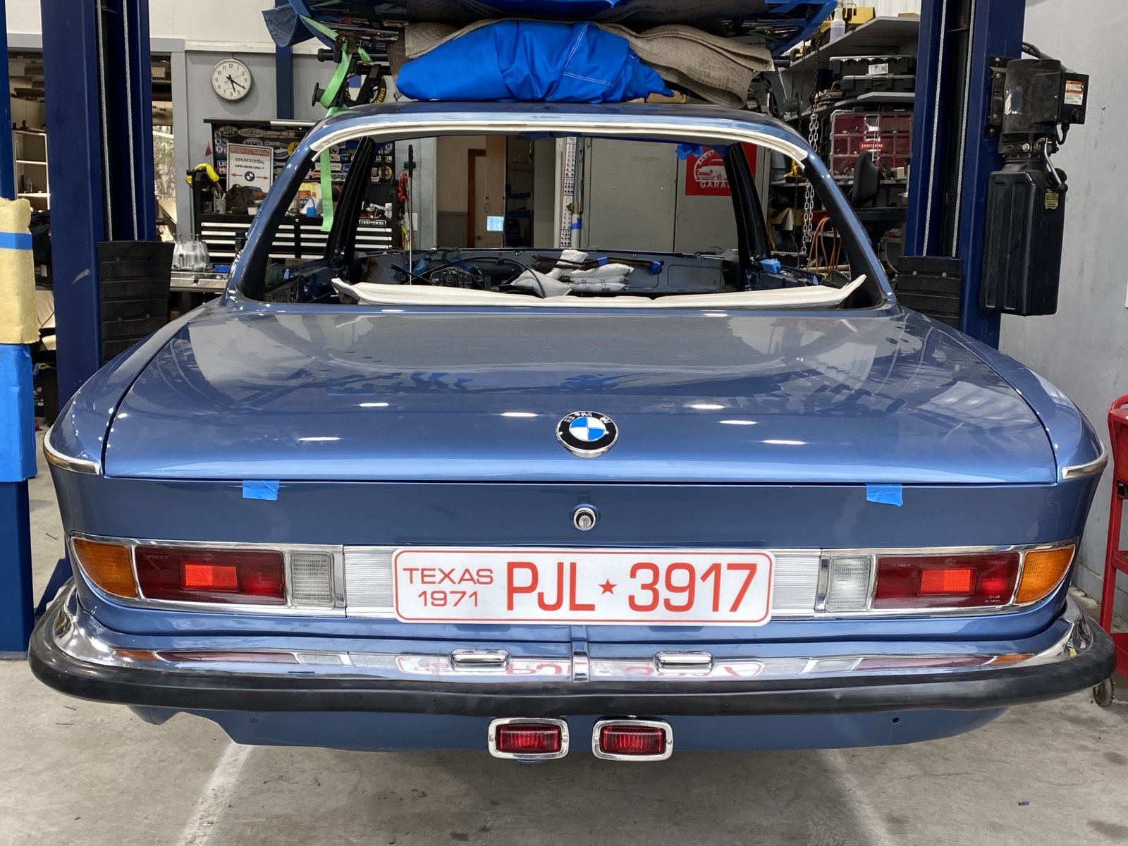

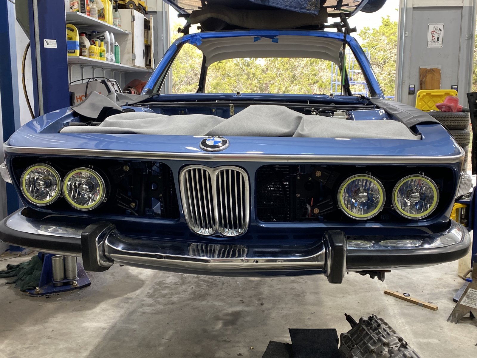

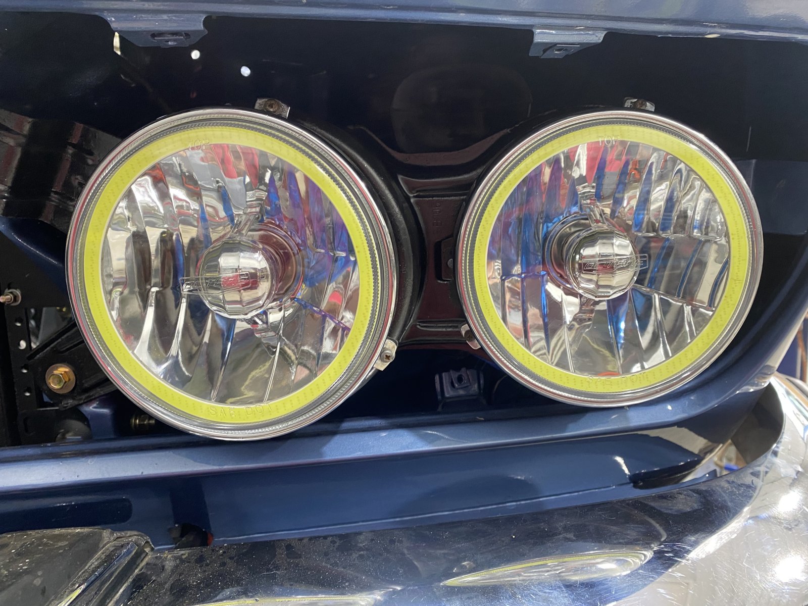

A few more parts bolted on the coupe on Tuesday…headlights/taillights/front turn lights.

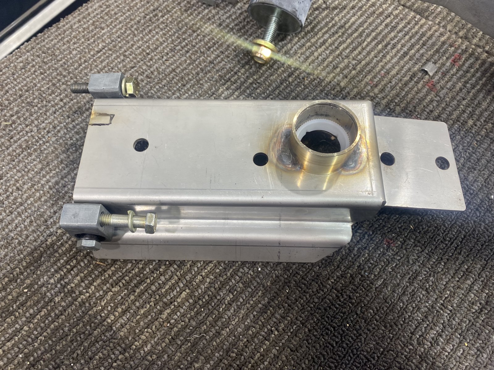

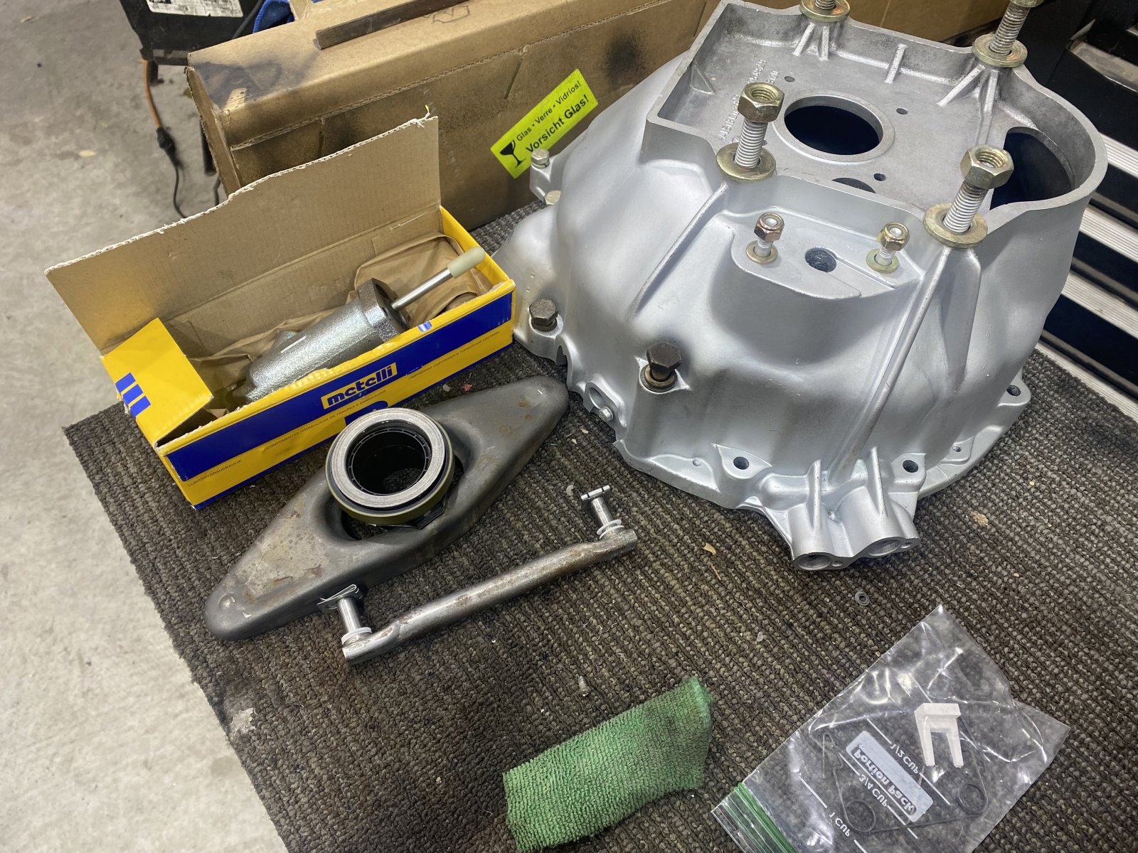

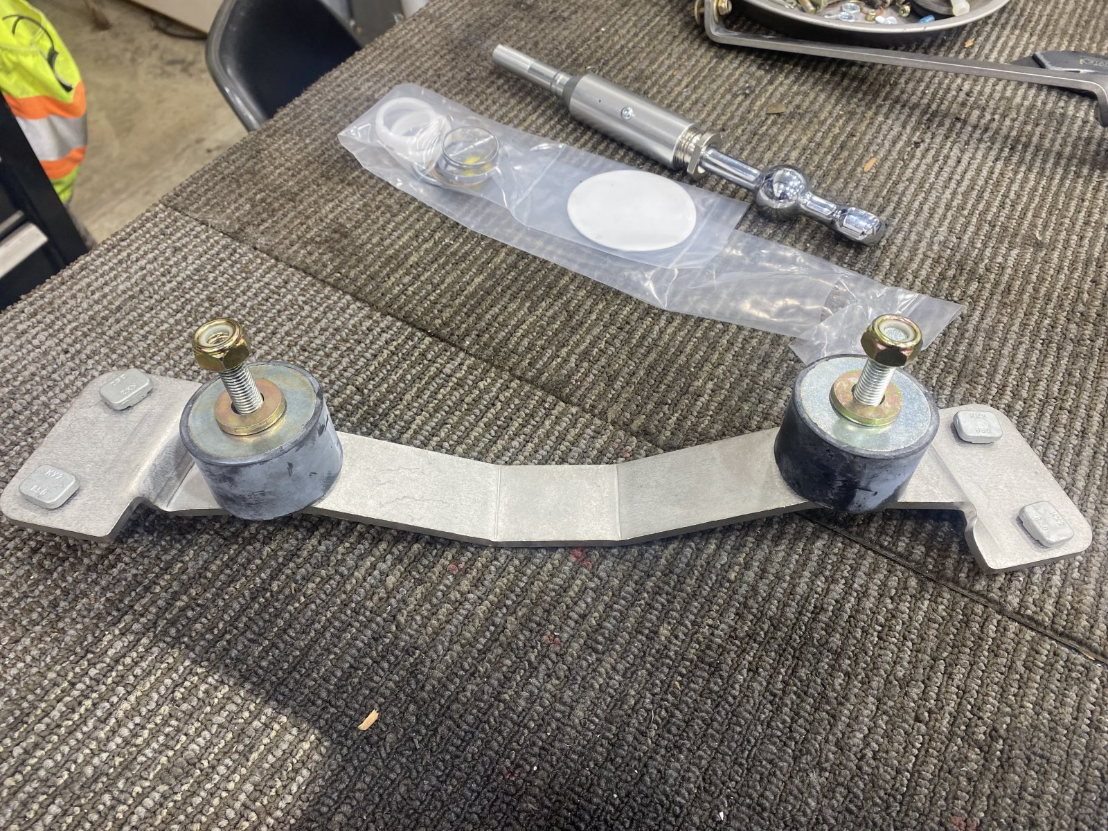

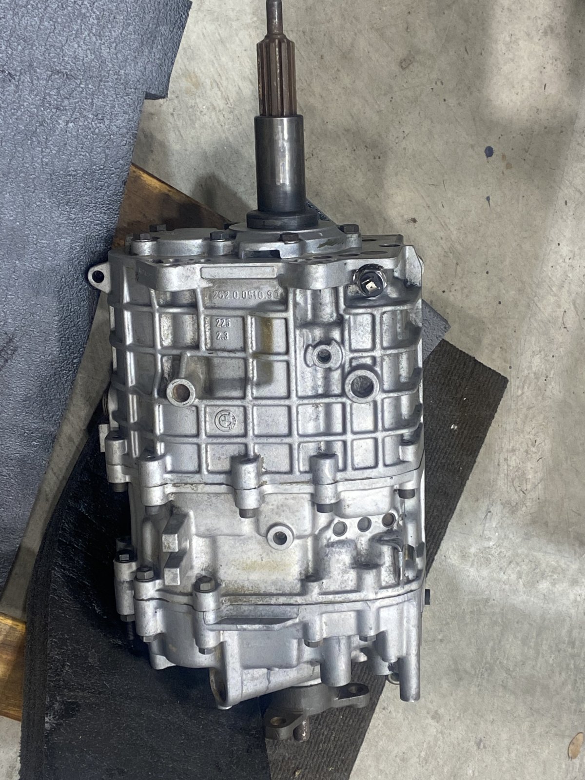

Getting the five parts together tonight, hoping to get transmission assembled and installed with the next couple days…called me today to
say the cut down driveshaft is ready for picku.
using the Hal Boyles five speed platform.
IE five speed support bracket

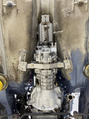

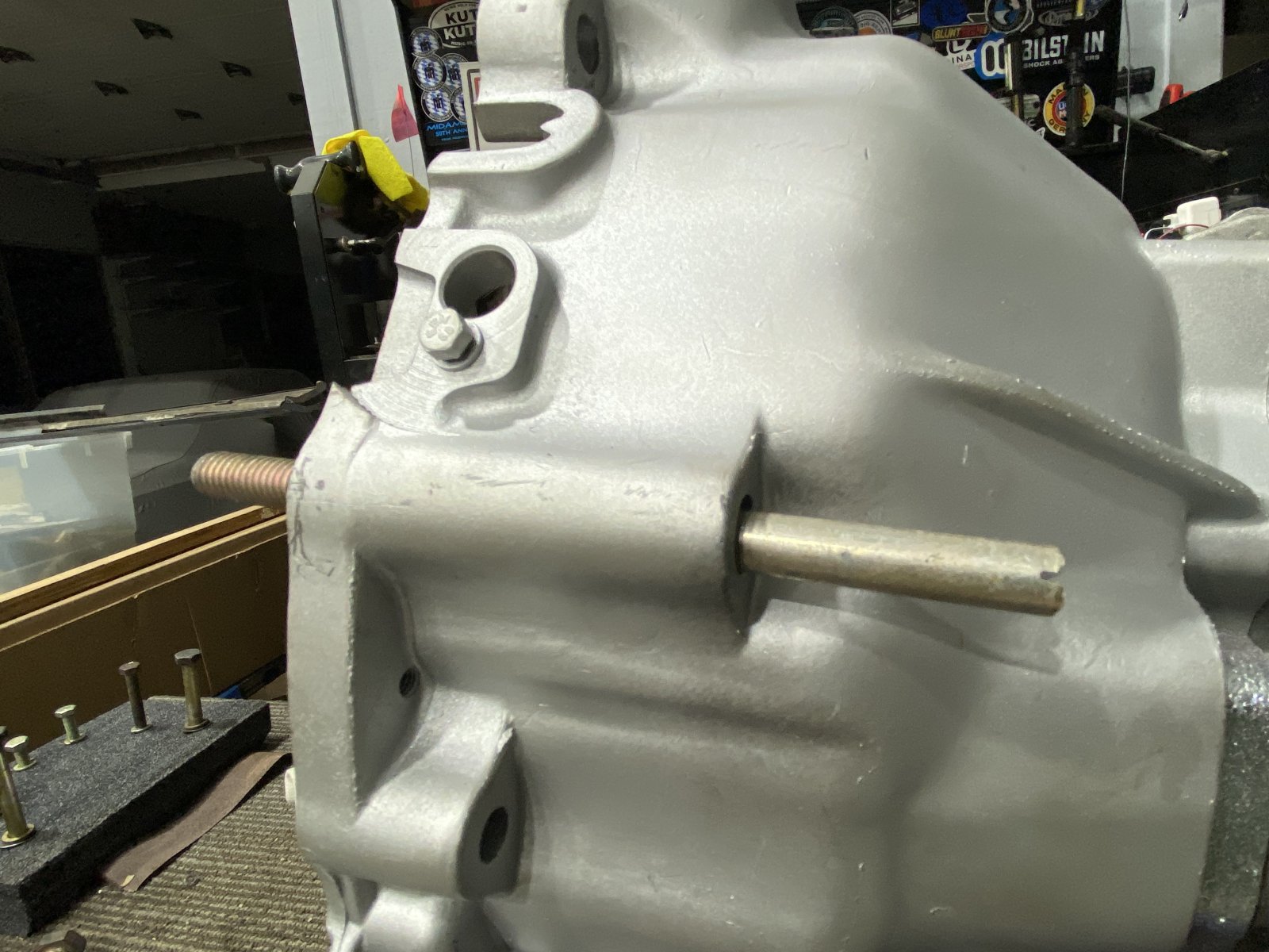

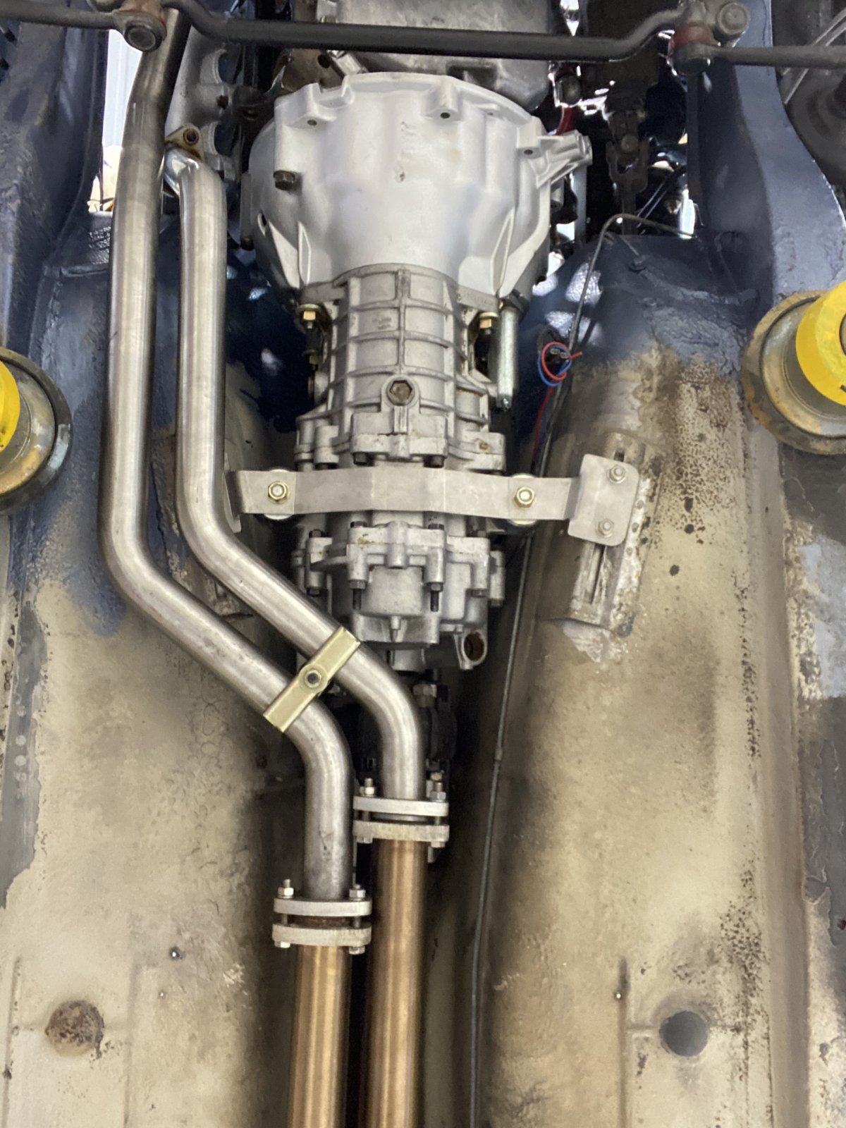

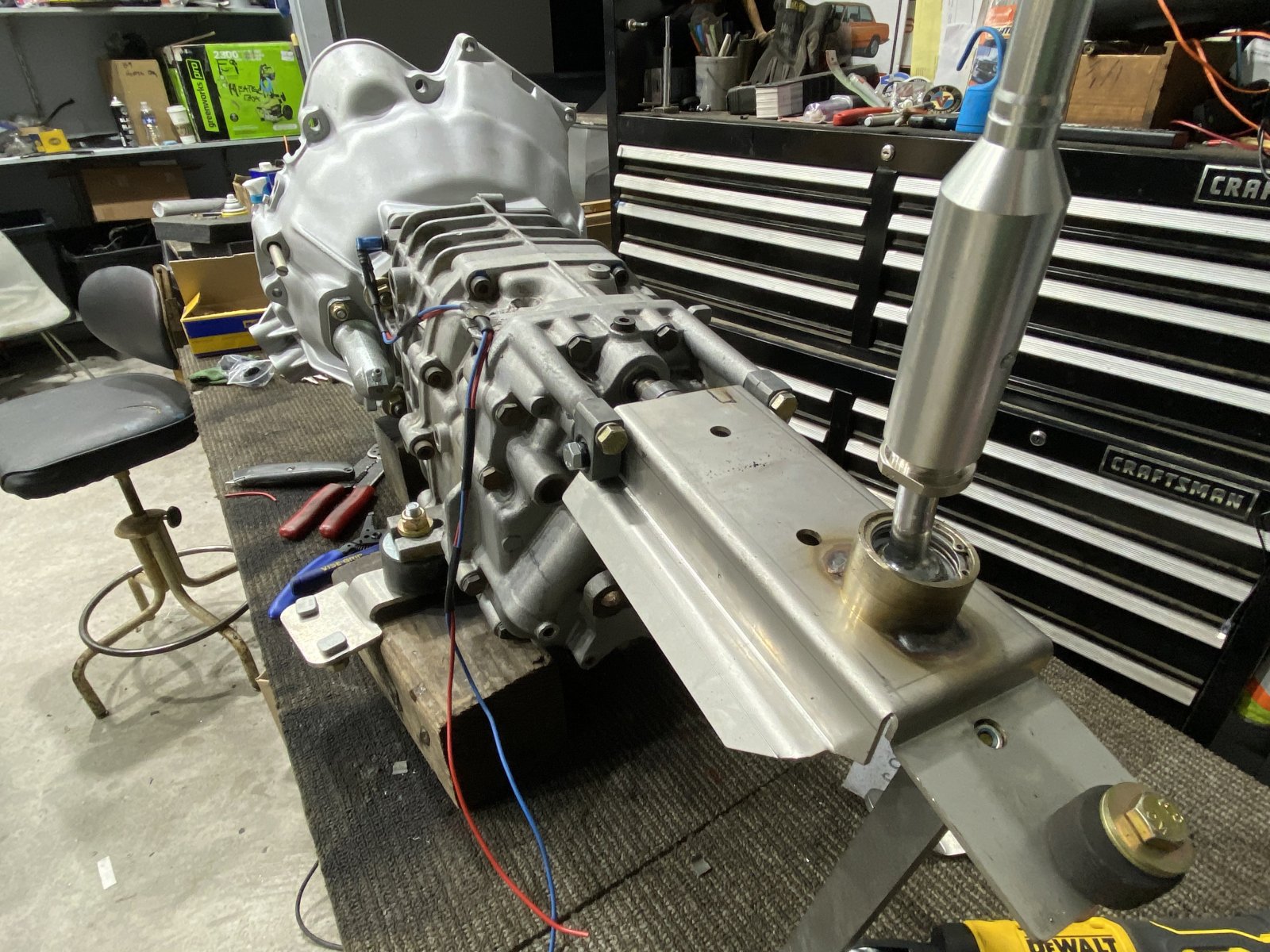

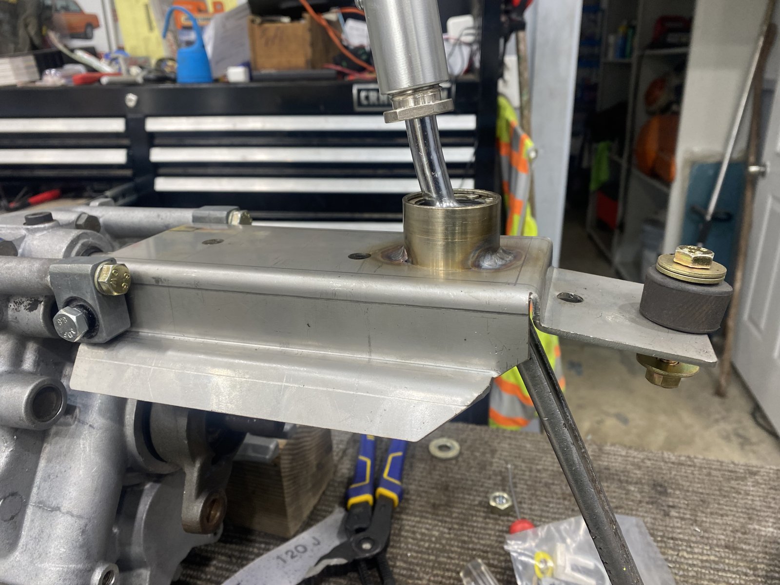

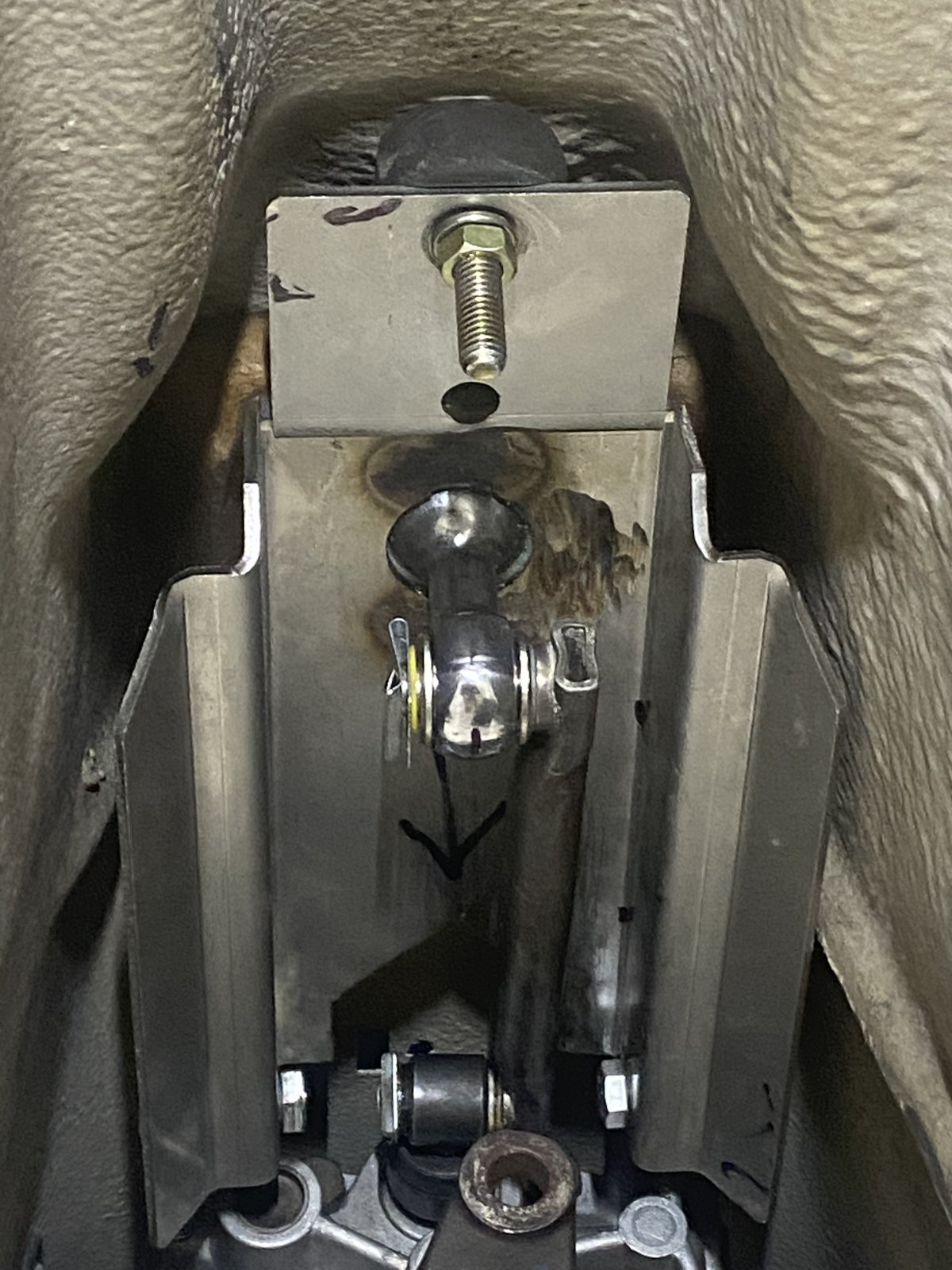

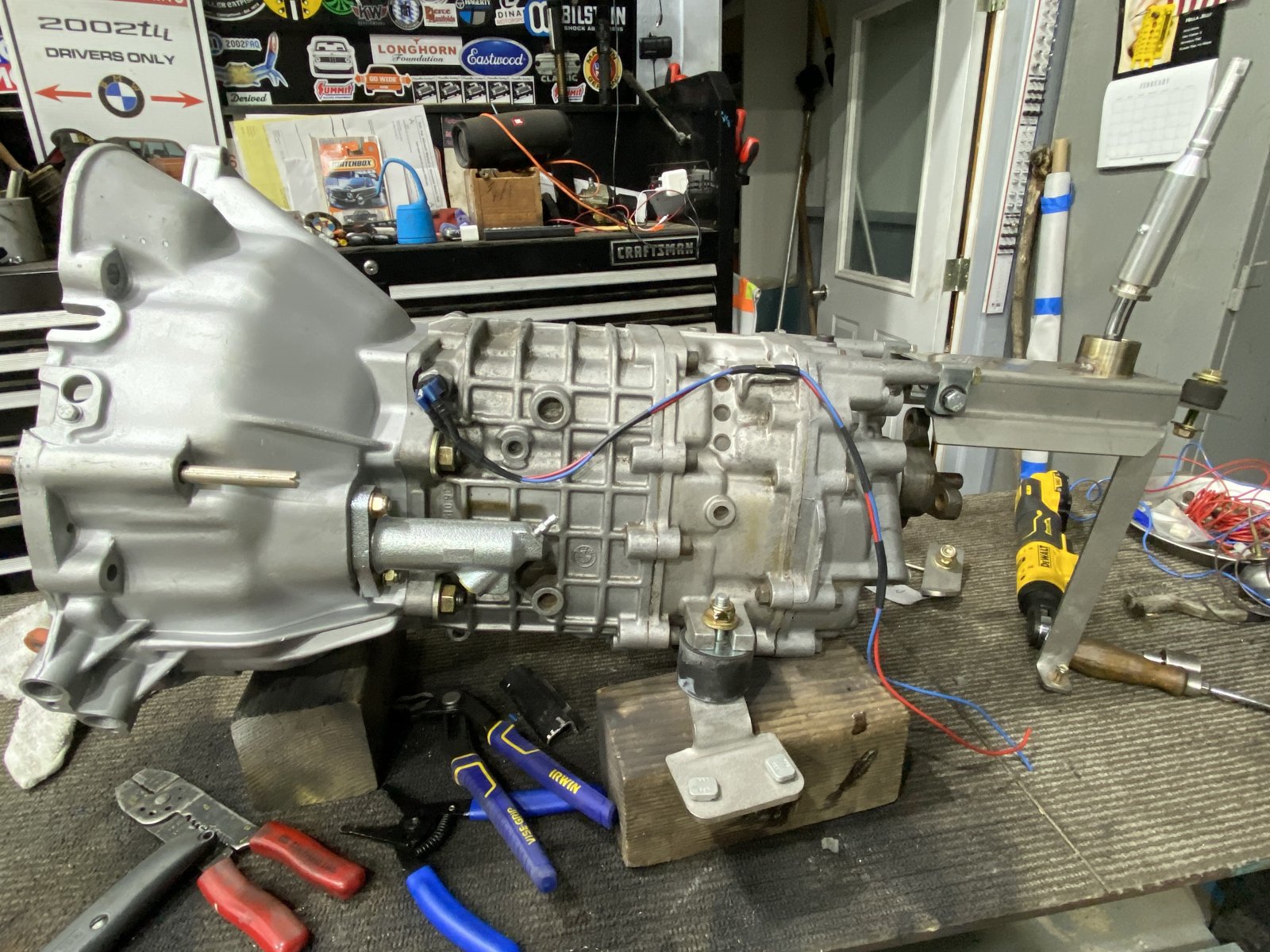

Dry fit transmission parts together today before install, using the five speed shifter platform that @halboyles produces.
Per Hal’s suggestion I fabricated two alignment bolts, long enough for me to set the transmission on them, and then slide it into place.
Maybe Saturday install…

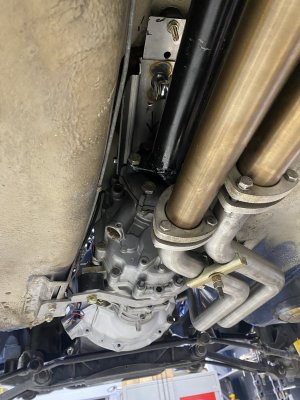

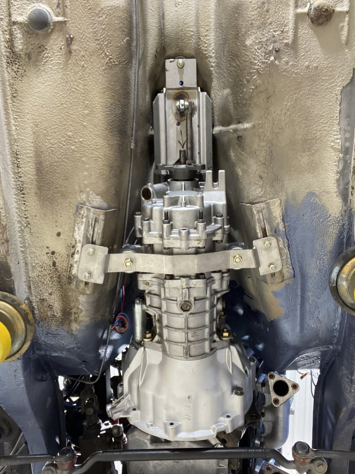

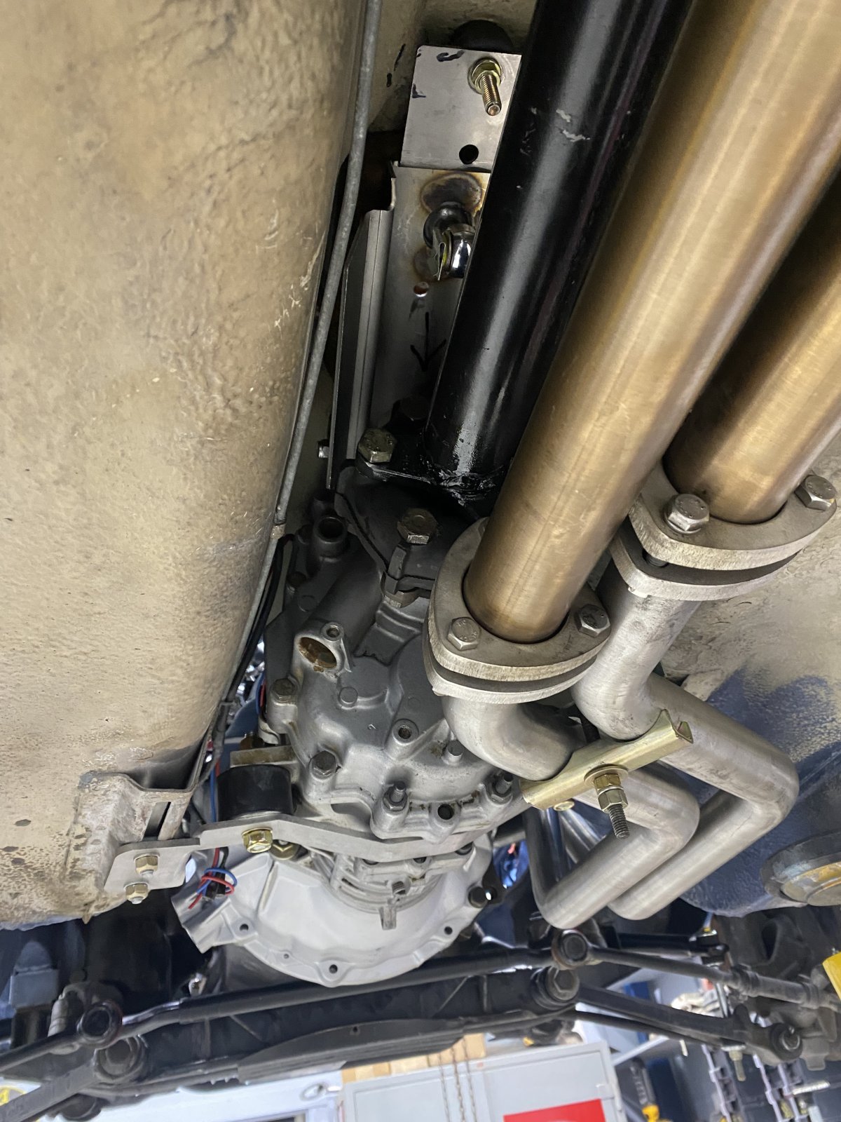

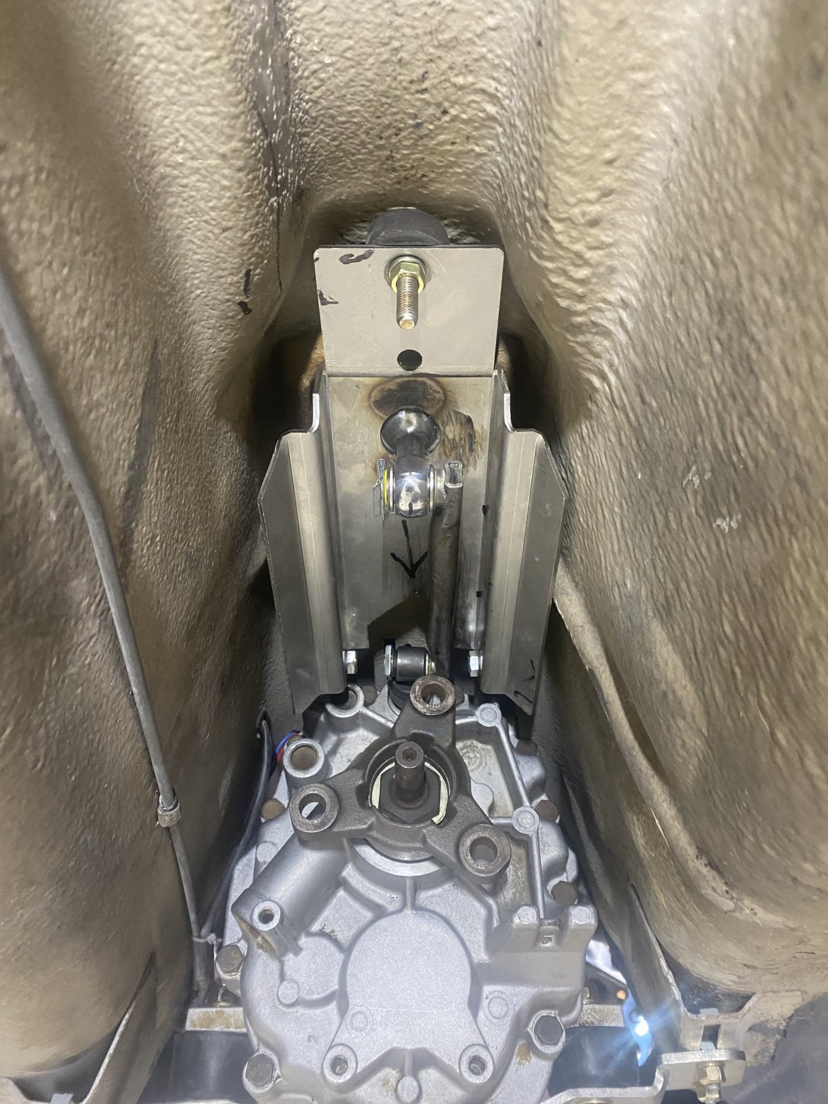

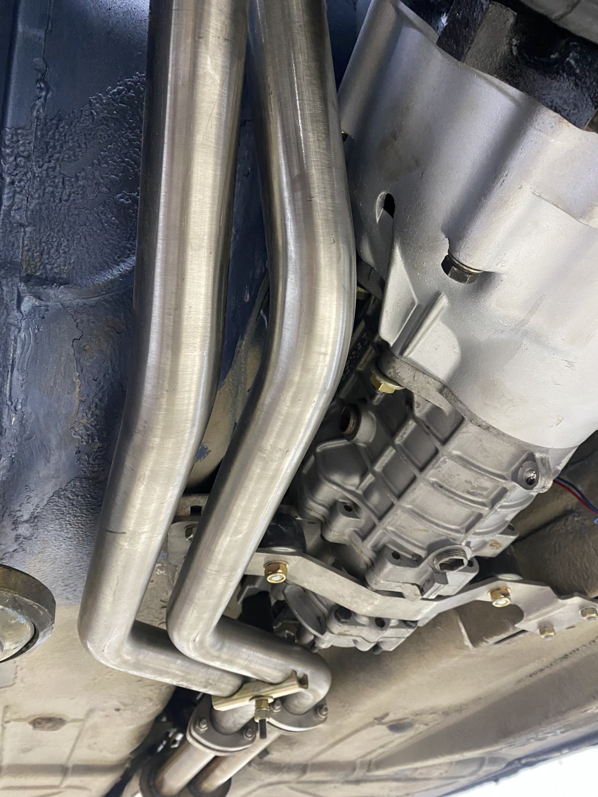

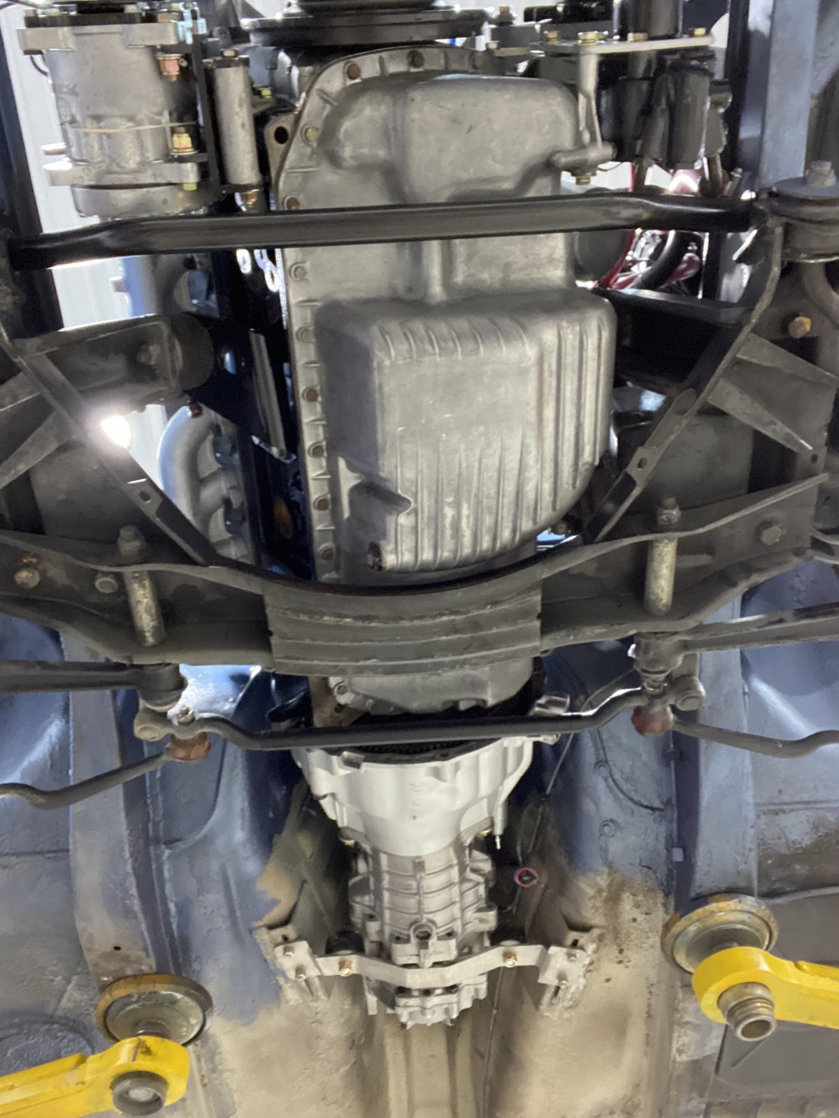

Five speed installed today…View attachment 158526
That right corner looks pretty close to the transmission tunnel. Do you think there's a chance that the transmission would shift enough under load to contact the wall creating noise and wear? With new rubber mounts, it might not be an issue but the yet to be replaced transmission mounts on my 2800CS are so old and squishy the motor moves a lot under normal loads.

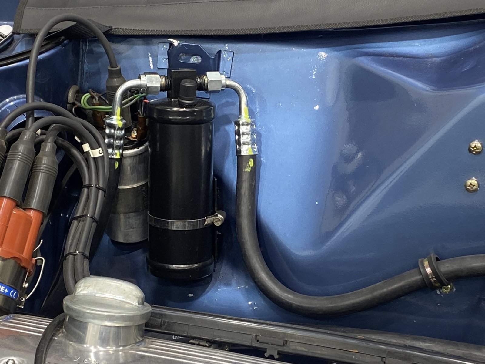

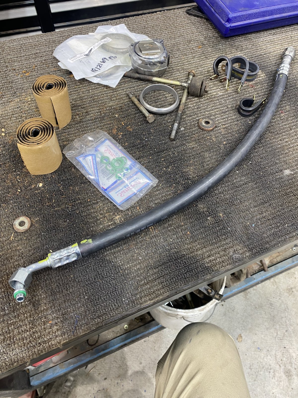

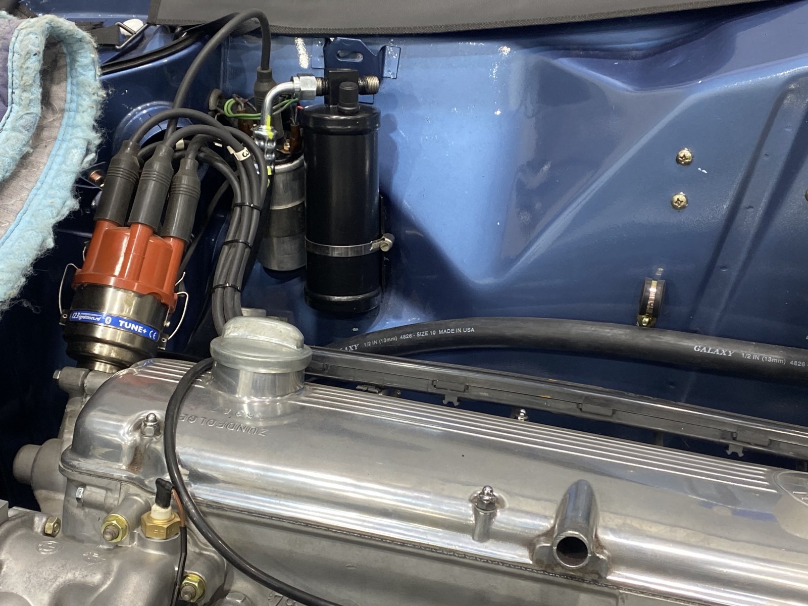

Slow progress, but 5 speed transmission /shifter and rest of drive train installed and Fritz bits exhaust mostly…
Last a/c hose to install and that’s complete.
I’m gonna button up the radiator and the front of the engine and hopefully be running in a week or so…
