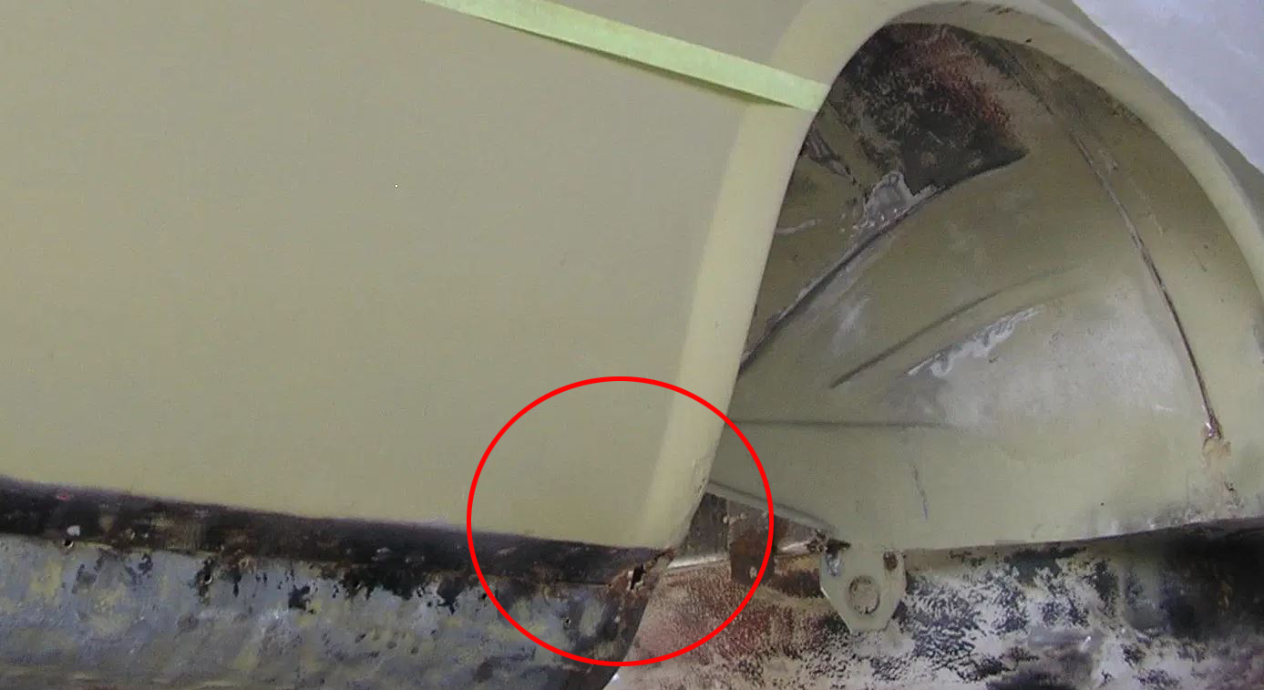

Well, I'll stand by my earlier statement. If they wanted to make it correct to that extreme they should have deleted the reflectors etc. Zero pics of the known problem areas and fresh paint could (not saying they do) be indicative of a high end fluff. I mean, we're talking about a coupe. They hide rust better than any other car I know... Then again he could have just forgotten to focus on those problem areas when he was taking the other 415 pictures![]()

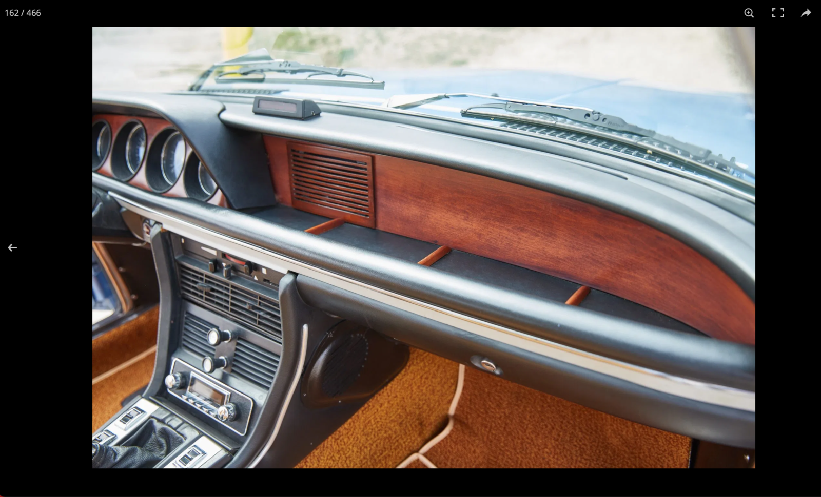

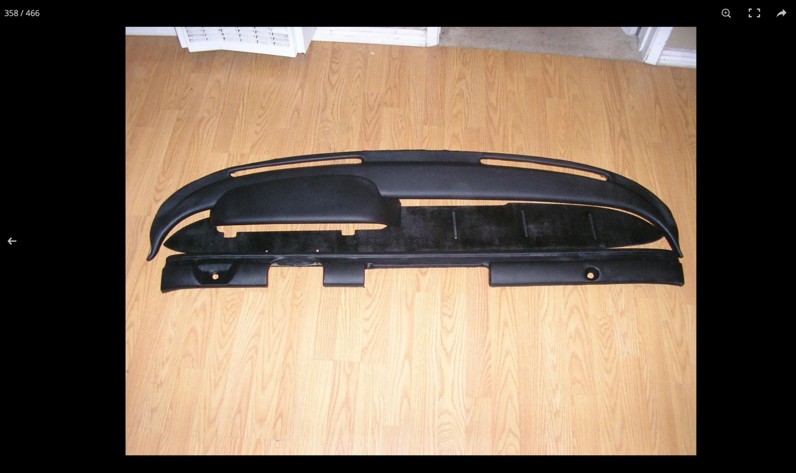

Strange also is the US dash with seat belt warning, they added a US EPA sticker maybe to get it registered in CA, painted the trans, plenum/manifolds and valve cover (that will look poorly in 2-3 years), Motronic 1.3 dizzy and crank sensor but no AFM, throttle housing has the arm for an automatic along with the vertical accelerator rod, pebble paint coat in spare tire/trunk areas, e12 jack (the head is much too wide just like mine!), tools have been ordered but they won’t be complete or correct, body work done in some guys back yard in Calimesa near San Bernardino, that’s a lot of filler on the tail panel, homemade spare tire hold down post with a wing nut, black kick panels, no rubber seal on B pillar cover to fender, screws in front door wood strips at rear, based on window switches and lack of breakers it has sardine can motors but no access plugs, clock keeps perfect time as long as it 9:58, gas door boot is not attached to body, yes most is nit picking but at the price this will sell for these details should have been fixed. And I can’t unsee the side stripes which are not level to the belt trim!

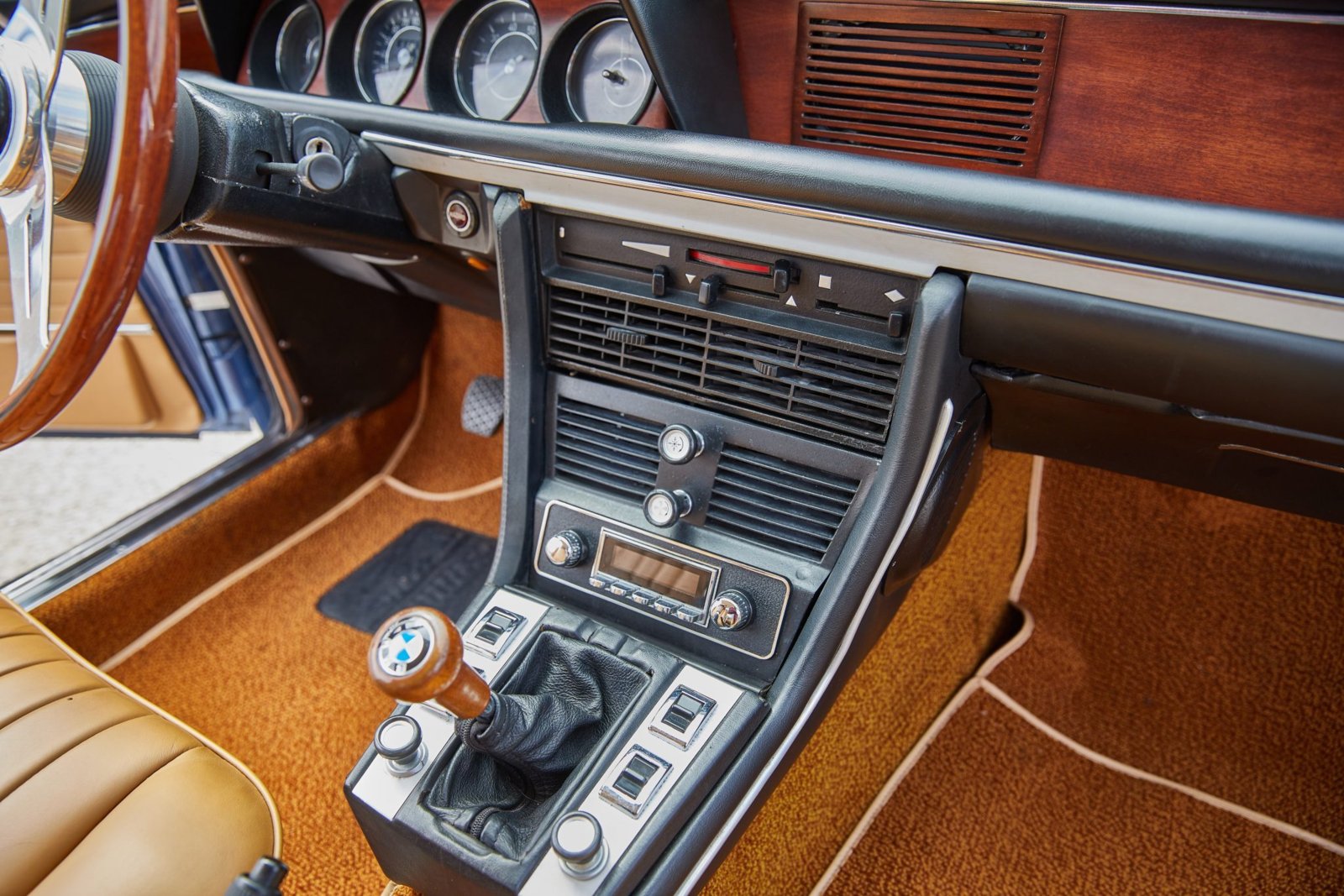

Is this a true csi?
Would not have an automatic.
Thinking the m30b35 came from an automatic if it has said rod.
I'm planning on getting a Miller MAF to hide inside a csi airbox as the original afm is kinda ugly. I wonder if that's what this owner did.
Agreed. The VIN says it’s a CSI. Not disputing that at all. Pretty sure that no CSI came with automatic transmission.It appears to be a true CSI that got many parts from a donor car.
Surprised. They could have done a better job. Peeling the vinyl and filling and sanding the grooves in the wood left behind by the auto selector trim is not hard. I did mine and its not that noticeable.Receipts from Carl show auto shift platform conversion.

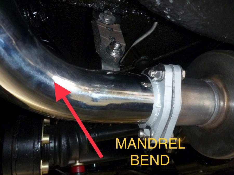

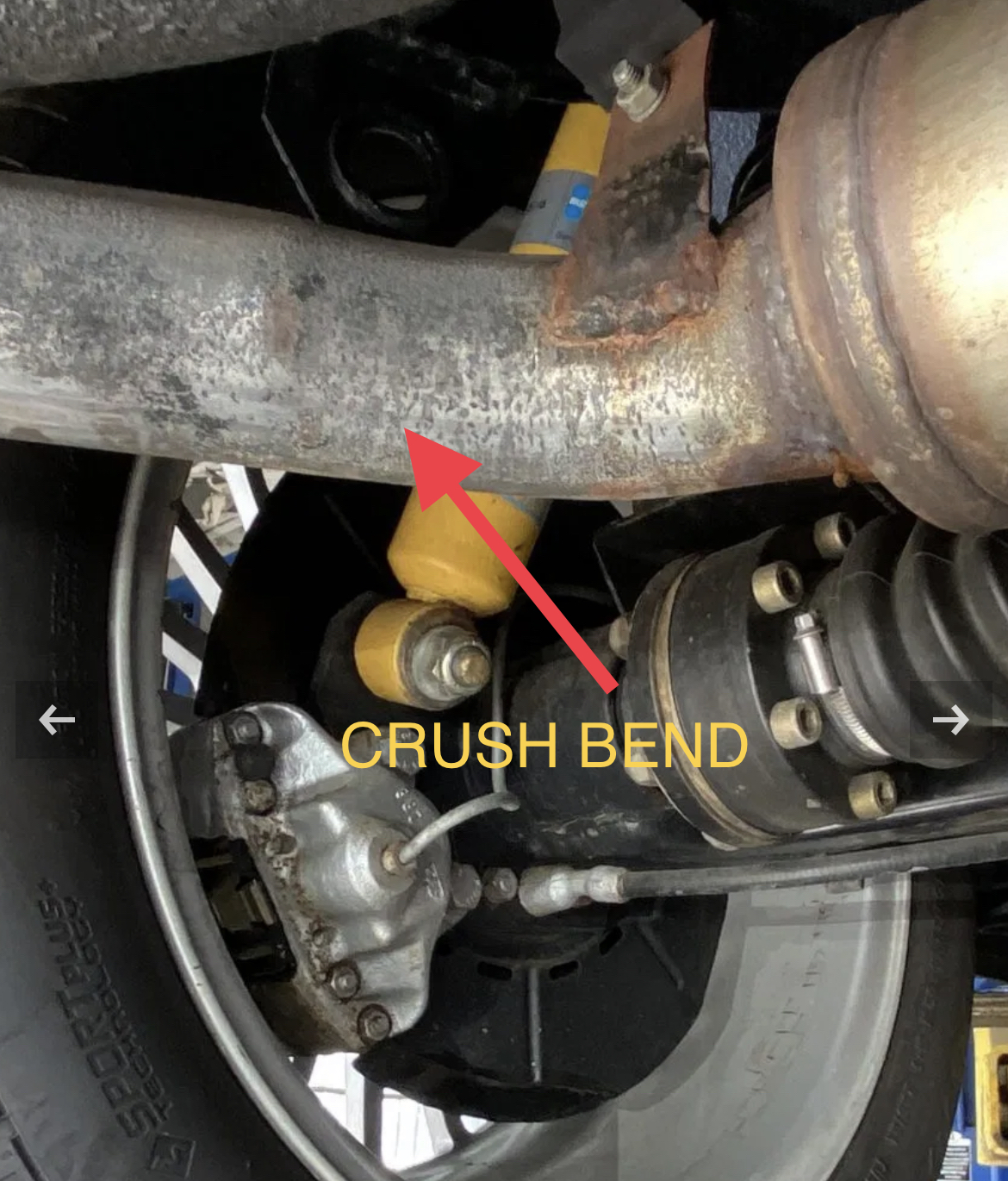

If that's a Coupe King stainless exhaust, the tail end should have been installed higher. I have one on my car and it takes some adjusting to get it up in the rear valance groove.

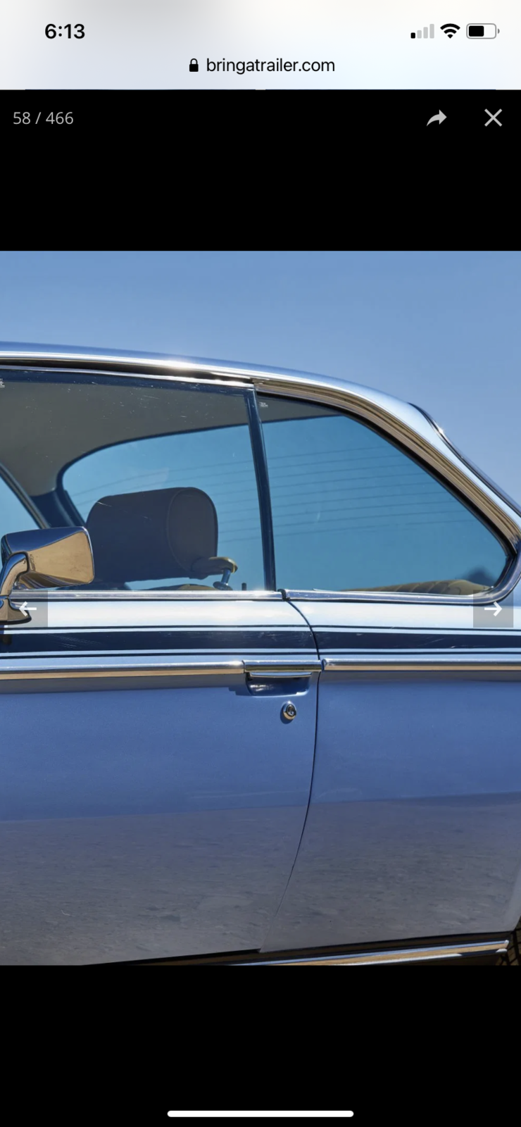

I notice that the higher the BAT prices go, the more picky the forum comments get. Which makes sense. I don’t care for a couple choices this owner made (e.g. the stripes) but overall this thing has been showered with love and money and who can fault that. One thing that bothers me is the driver side shut line - pretty fundamental.I agree that zero reflectors look better. I think “correct” is highly subjective. The reflectors are not only correct for cars residing in the US, they are a period correct modification. If the goal is to look like a standard euro CSI, there are a number of other changes one might want to make. The vast majority of CSI’s had
