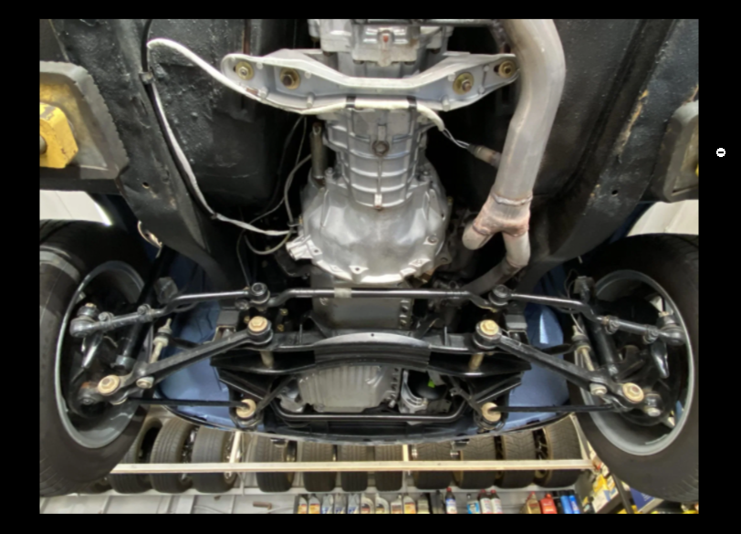

Looks like they painted over the sound deadening material on the front towers. You'd have thought with all that money pouring into it, that would have been the first place to start... Worrying absence of any pics from the bottom up or of problem areas... Hmm. Could be trouble
seriously worried on how they lifted this car: see how the rigt pad is just slipping off? It must rest also on the very flimsy floor section just out of the pic on the right side.

Well, I'll stand by my earlier statement. If they wanted to make it correct to that extreme they should have deleted the reflectors etc. Zero pics of the known problem areas and fresh paint could (not saying they do) be indicative of a high end fluff. I mean, we're talking about a coupe. They hide rust better than any other car I know... Then again he could have just forgotten to focus on those problem areas when he was taking the other 415 pictures;)
Strange also is the US dash with seat belt warning, they added a US EPA sticker maybe to get it registered in CA, painted the trans, plenum/manifolds and valve cover (that will look poorly in 2-3 years), Motronic 1.3 dizzy and crank sensor but no AFM, throttle housing has the arm for an automatic along with the vertical accelerator rod, pebble paint coat in spare tire/trunk areas, e12 jack (the head is much too wide just like mine!), tools have been ordered but they won’t be complete or correct, body work done in some guys back yard in Calimesa near San Bernardino, that’s a lot of filler on the tail panel, homemade spare tire hold down post with a wing nut, black kick panels, no rubber seal on B pillar cover to fender, screws in front door wood strips at rear, based on window switches and lack of breakers it has sardine can motors but no access plugs, clock keeps perfect time as long as it 9:58, gas door boot is not attached to body, yes most is nit picking but at the price this will sell for these details should have been fixed. And I can’t unsee the side stripes which are not level to the belt trim!
