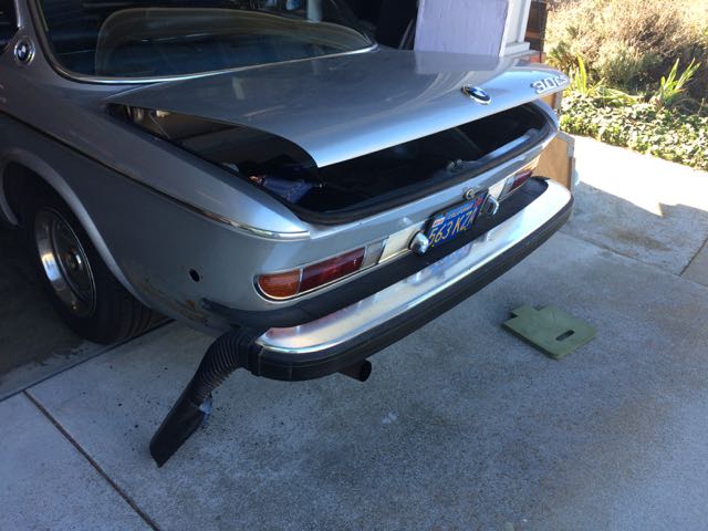

December 31. Test fitting of the rear bumpers. They need some persuasion to get in line. In particular, on the 74 there is an added bracket between the wheel well and the rear bumper shock which makes access to the side bumper bolt extremely difficult. I like a lot of the added things the 74 has but definitely not the reduced access!
