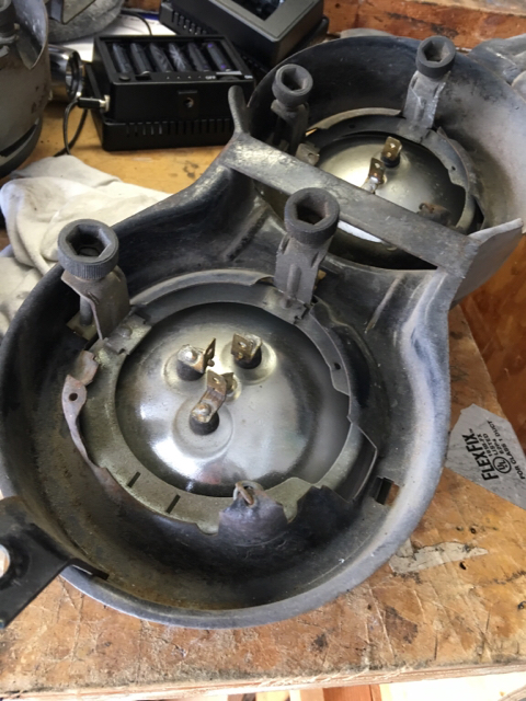

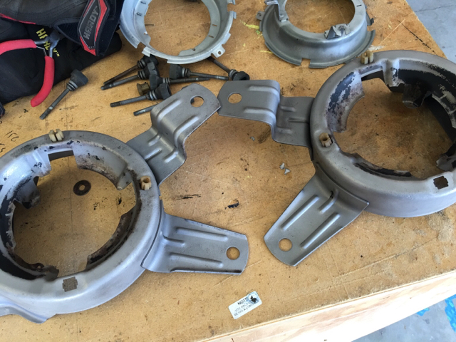

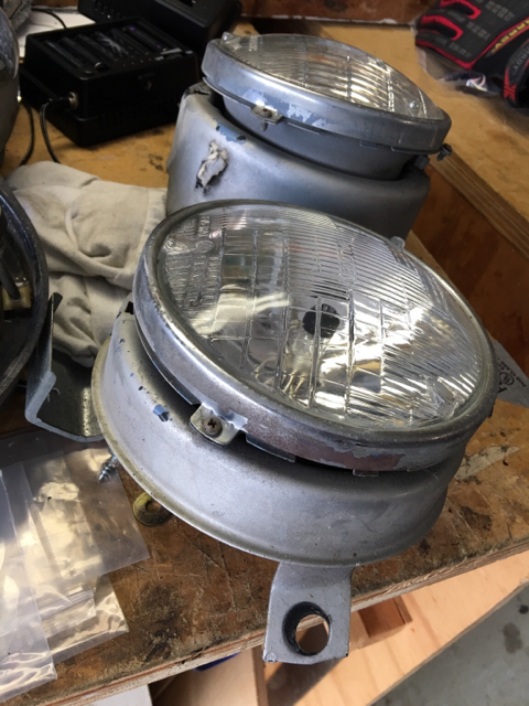

June 26. I discovered that it is extremely difficult to disassemble the headlight buckets from their bracket. They were obvioulsy designed ONLY to pressed IN and never to be taken OUT. After trying various brute force options I fnally came up with a little gizmo which made it possible without destroying the whole thing.
http://www.e9coupe.com/forum/threads/separating-the-headlights-buckets.22503/
Once separated, I can finally repaint them!
15. Refinish the headlight assemblies.

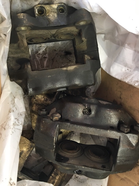

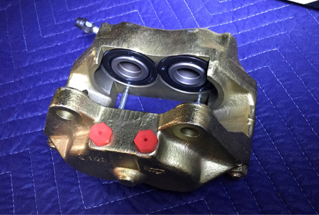

July 22. Brake work time. I have a few hours available today so I decide to get the calipers out so they can be rebuilt. While I'm there I also remove the old rubber brake lines and replace them with a set of steel braided ones I got from La Jolla.
While I am down there, I notice with horror that the ball joint boots are completely trashed. Great. Now I need to buy new lower control arms as well...
The front calipers were definitely ready for rebuild. The seals were all perished.
And... darn, my front disks are right at the lower limit! While I'm there....
Good grief... Where are we? Must be Plan K.
16. remove and rebuild all calipers.
17. Replace rubber brake lines with steel braided ones
18. R n R Lower control arms
19. R n R front brake disks

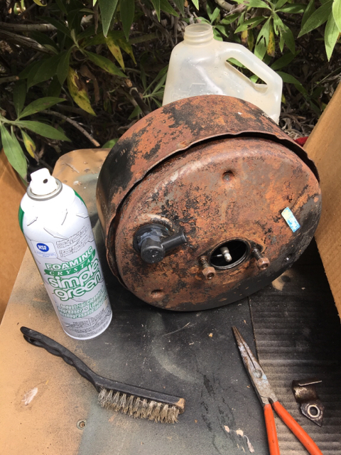

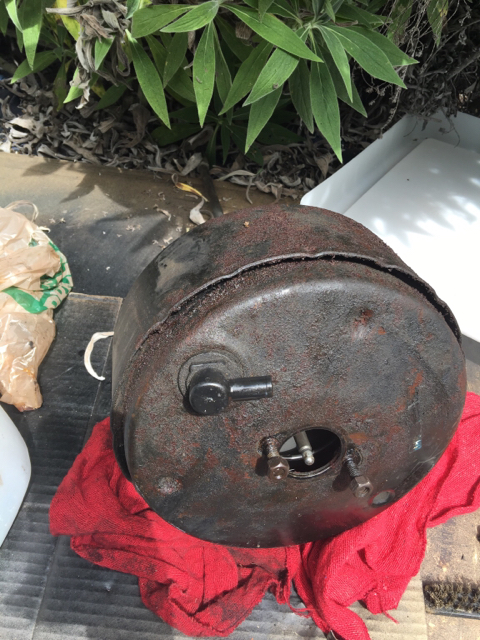

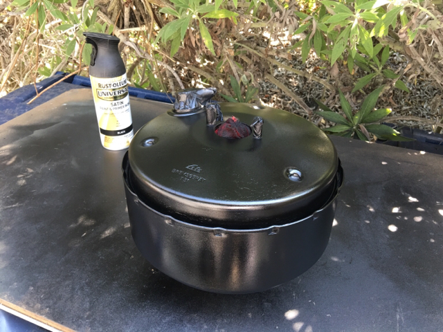

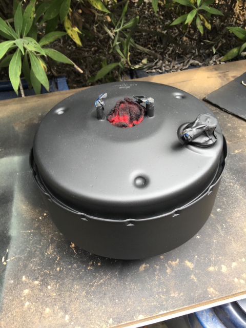

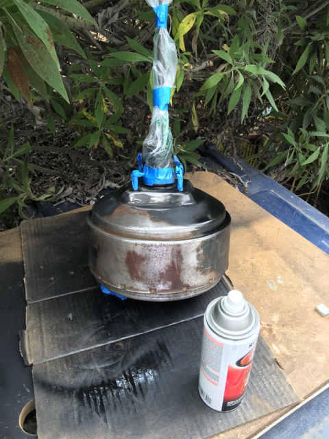

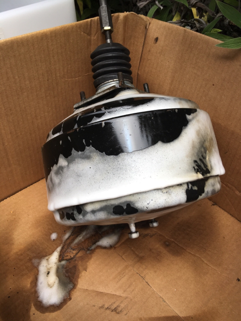

Time to refresh the brake booster. Lots of fluid had apparently spilled on it at some point causing serious cosmetic issues.
Great job on the booster! You appear to be a rattle can artisan! I didn't know they made foaming simple green in a can. I must have it!
Bo, since you are going into such detail (I love it!), regarding the paint, from what I can tell the modern rattle cans can be really good and Eastwood sells some pretty good stuff as well, the satin clear-coat that Steve mentions above is available in High-temp and I find that a little better than the regular clear coat. Also, even though the factory did not prime allot of the stamped steel pieces I find it worthwhile so prime them, they look smoother and hold up better. Hey, as long as you're in there :-)

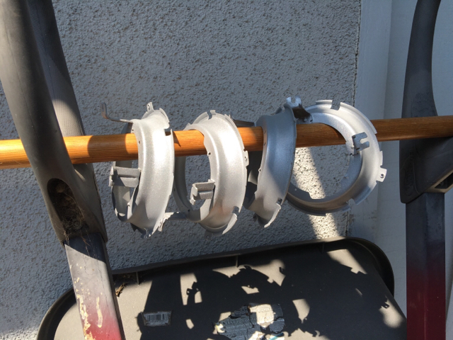

Hectic summer with family vacation, the whole Monterey thing and some work to do in the house.

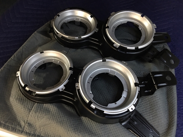

But little by little some things get done. First removing, bead blasting and refinishing the headlight buckets.

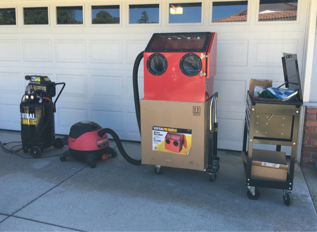

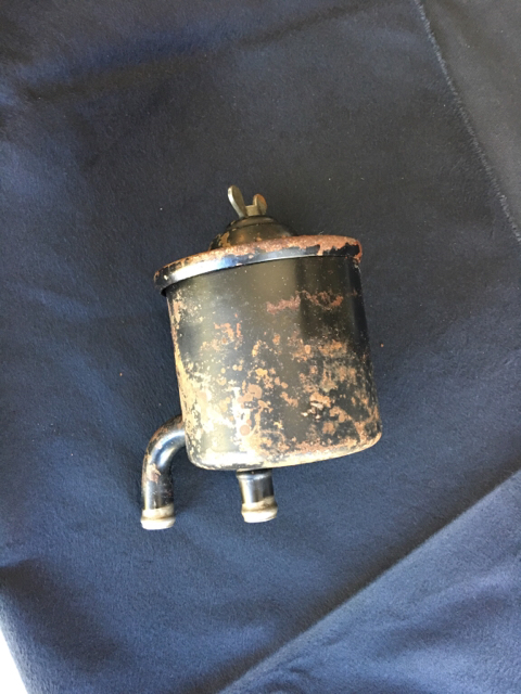

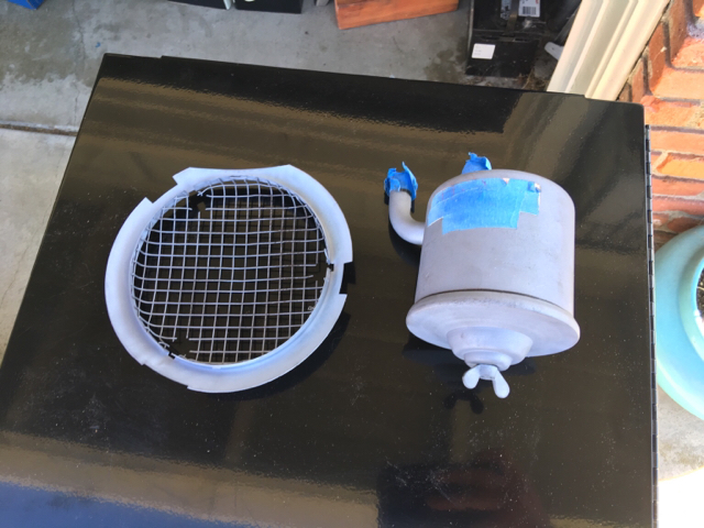

Then I finally got a home blasting system that can be rolled out when needed and back in a corner of the garage when the weekend is over.

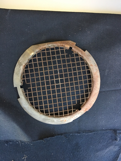

First items I tested it on are the PS fluid reservoir and the heater fan grille. Before and after:
