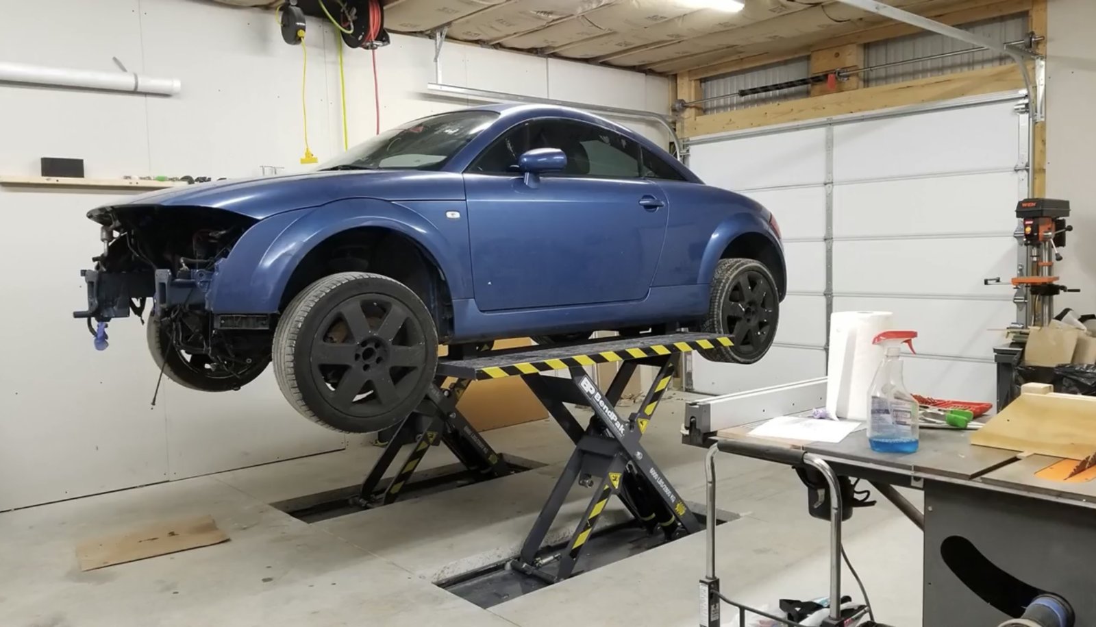

Note to self. Looking at mid lift options. His garage is 10’. Audit TT about 53” tall, same as e9. Looks like I could lift it full height without hitting an 8’ ceiling.
@rsporsche you mentioned the deck width. They seem plenty wide and I can space them accordingly.
Bendpack MDS-6LPF
My concern with this lift is the non-linear loation of the e9 jacking points. The rear point (sub frame bushing bracket) doesn't line up with the front point (frame rail) which is inward by about a foot or more, so would you have to point the fronts of these lifts inward or??

this looks pretty interesting. curious what kind of block he put between the deck and the car - a rubber or wood block? the downside of this unit - most people would need to redo their slab in order to recess the lift so that it is flush. very interesting but might not be right for me.

Bendpack MDS-6LPF
They have identical low profile units that sit on the slab and you drive over. They cost less also.
Bendpack MDS-6LPF
I think a really well designed height and tilt adjustable rolling chair would make that an excellent option for pretty well all types of jobs. Build LED flood lights into it and add a cup holder.
I talked to Bendpak when looking at one of these a couple of years ago. They did not recommend trying to jack an e9 on one of these specifically because of the point Steve makes - the fact that the rear jack points are inboard from the front ones.

I’m not particularly worried about that. I can make a bridge that places the lift points exactly where needed. IMO, this is by far the best option for a small garage. My garage will only be 10x20 with an 8’ ceiling.
Markos - I bought an engine support bar several years ago in order to change the steering box in my e39 to the M5 box. It supported the engine while I dropped the subframe a few inches. If I had gone in the direction of one of these jacks, I was thinking of using that bar across the scissors jack. The bar could rest on the scissors jack directly underneath the rear subframe bushing attachment, with the rubber blocks on top of the bar between the top of the cross bar and the car.
