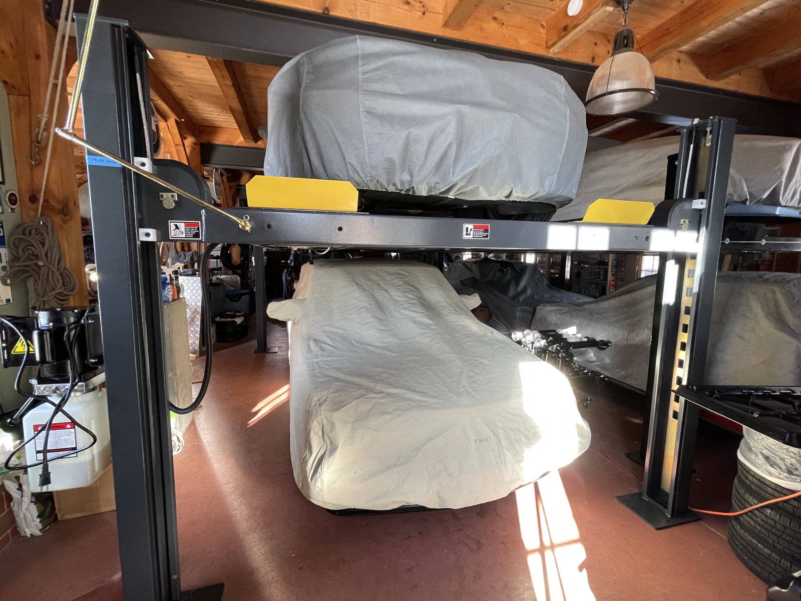

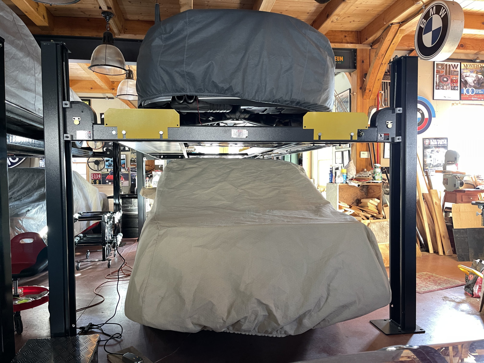

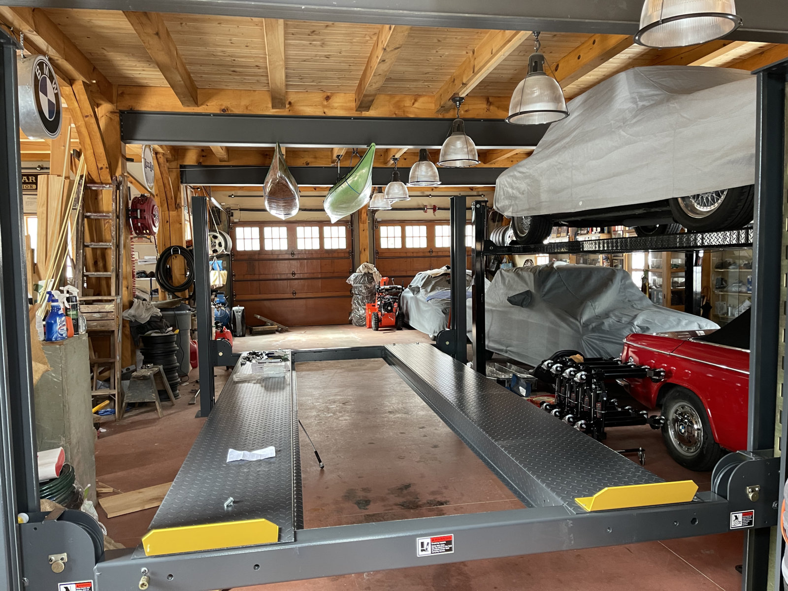

my 2 post is asymmetrical and you can use it in forward or reverse. if I back in to the asymmetrical I can open the doors all the way. At least on my e30s. I haven’t tried it with the coupe. It’s pain to walk around the 2 posts if you are doing chest high work. Especially in a narrow space.But I would definitely use a 2 post for engine /subframe drops.. If you need to store a car on the 2 post it helps to take the tires and wheels off. the worst part of a two post is getting too old to enjoy crawling on the concrete to position the arms.
The four Post makes it easy to clean up shop. pile all the stuff on the ramps and raise it up! Boom, clear floor...I made some wooden bridges that I use to support, say an exhaust, or with bottle jacks to lift the car or drain pans to catch drips. But I find the 4 post ramps are in the way for many jobs. for example, you can’t get a clear shot at the rocker panels on a 4 post.

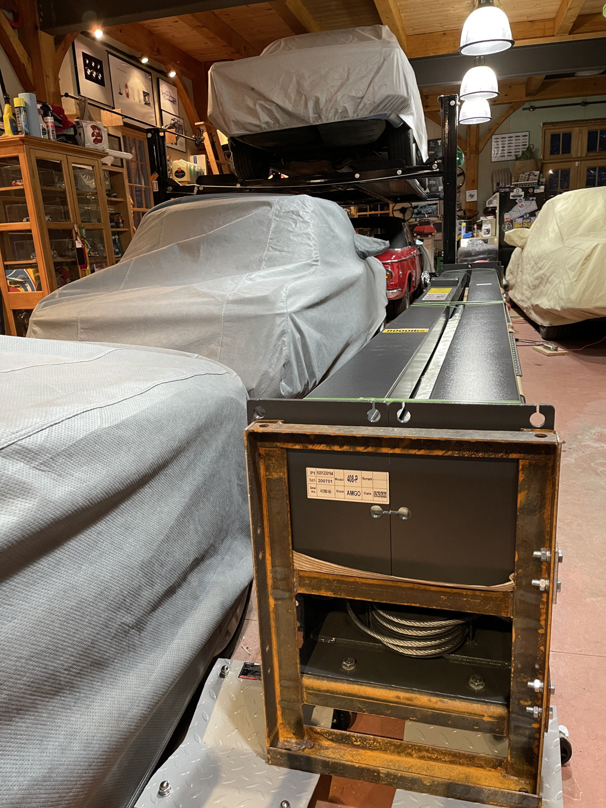

Recently bought an an Amgo 408-P: https://www.nhproequip.com/4-post-lift-8000lb-408-p-amgo-hydraulics

Andrew - Are your lifts bolted to the floor? My four post is not.

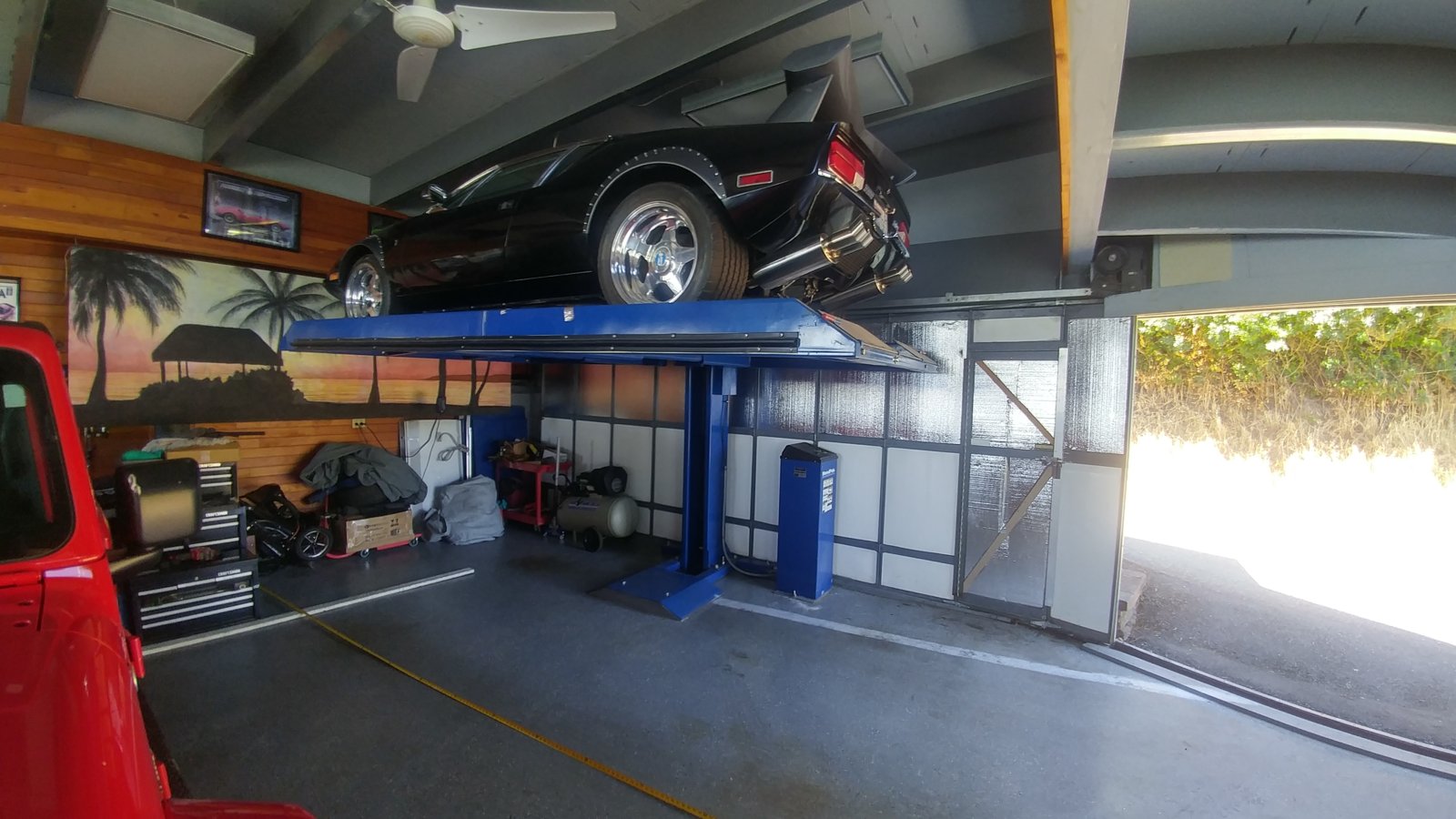

Have a mobile scissor lift in the home garage and a automotech 2m rise scissor lift in the workshop.
The mobile lifts cross brace does get in the way but the arms that extend out and round it are very helpful with a coupe, takes up minimal space too.
Couldn't live without the mobile lift. Not used the big one enough to comment yet.
