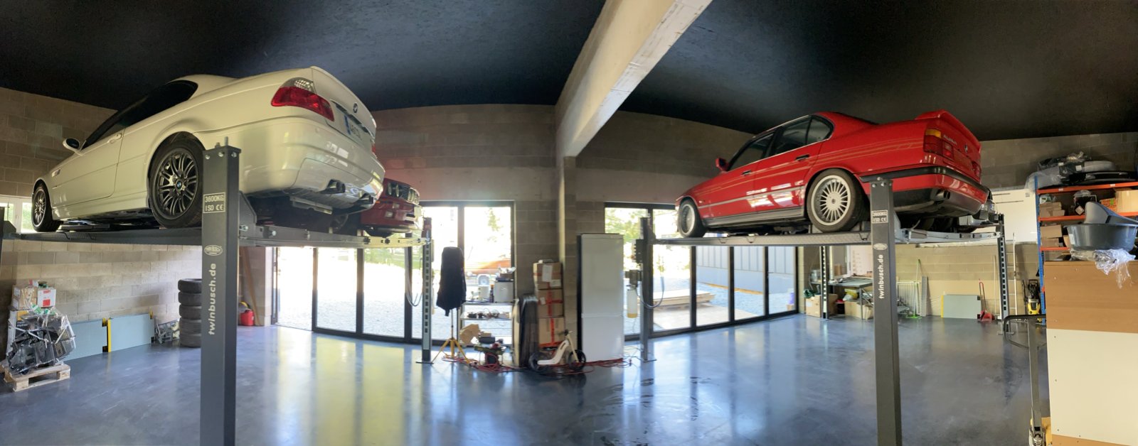

I have 2 double car 4posts in my garage. Mostly for storage use as one side is blocked by the car next to it… but more space for toys :)

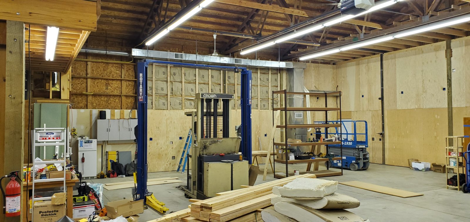

In my shop - the PO had a 2 post (offset type) installed when he had the building built. He had 12" of the correct concrete put in for the entire slab... and had power run to where the lift is installed, so it is a pretty clean installation. It is a pretty slick set-up and has worked well.

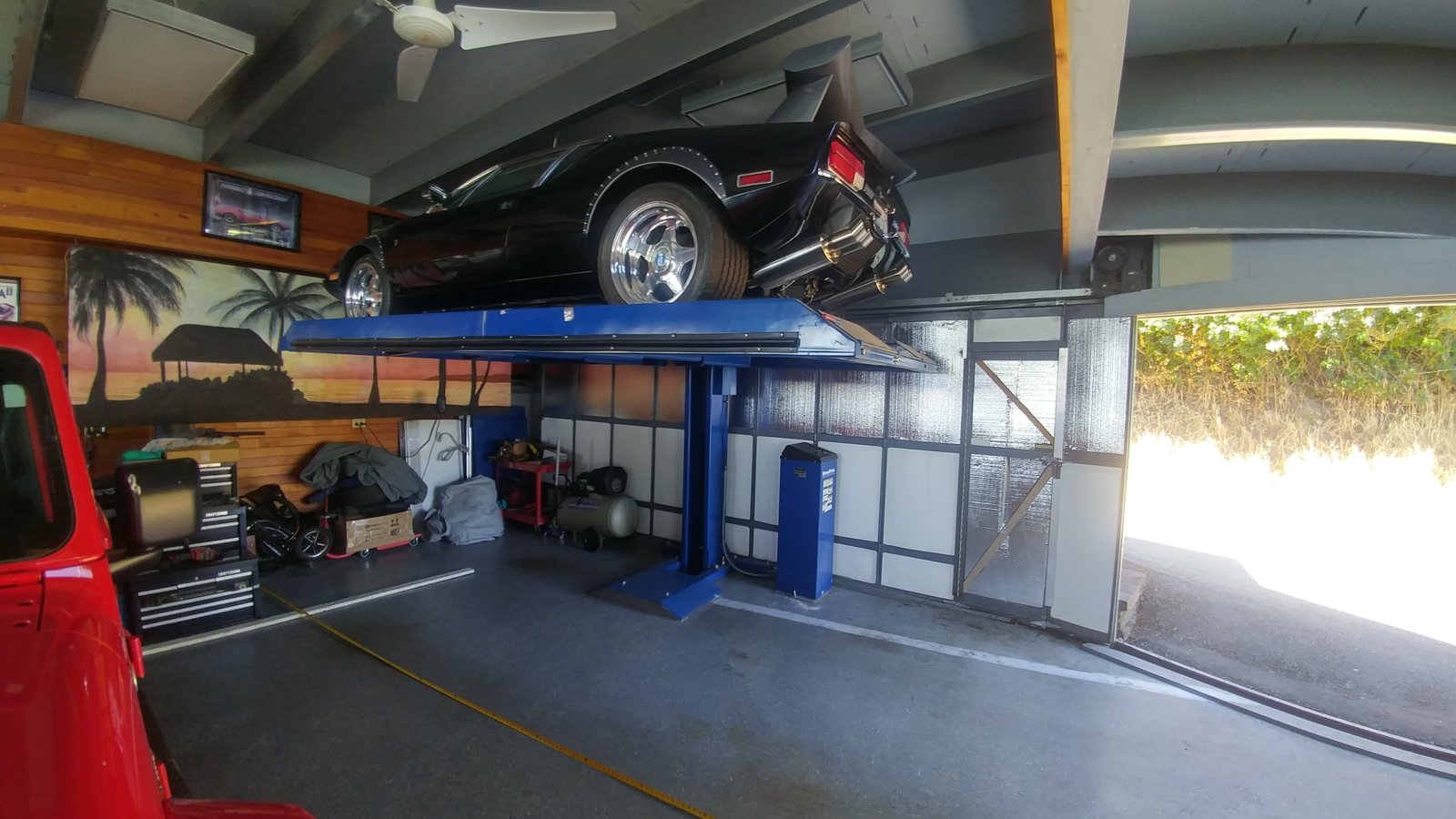

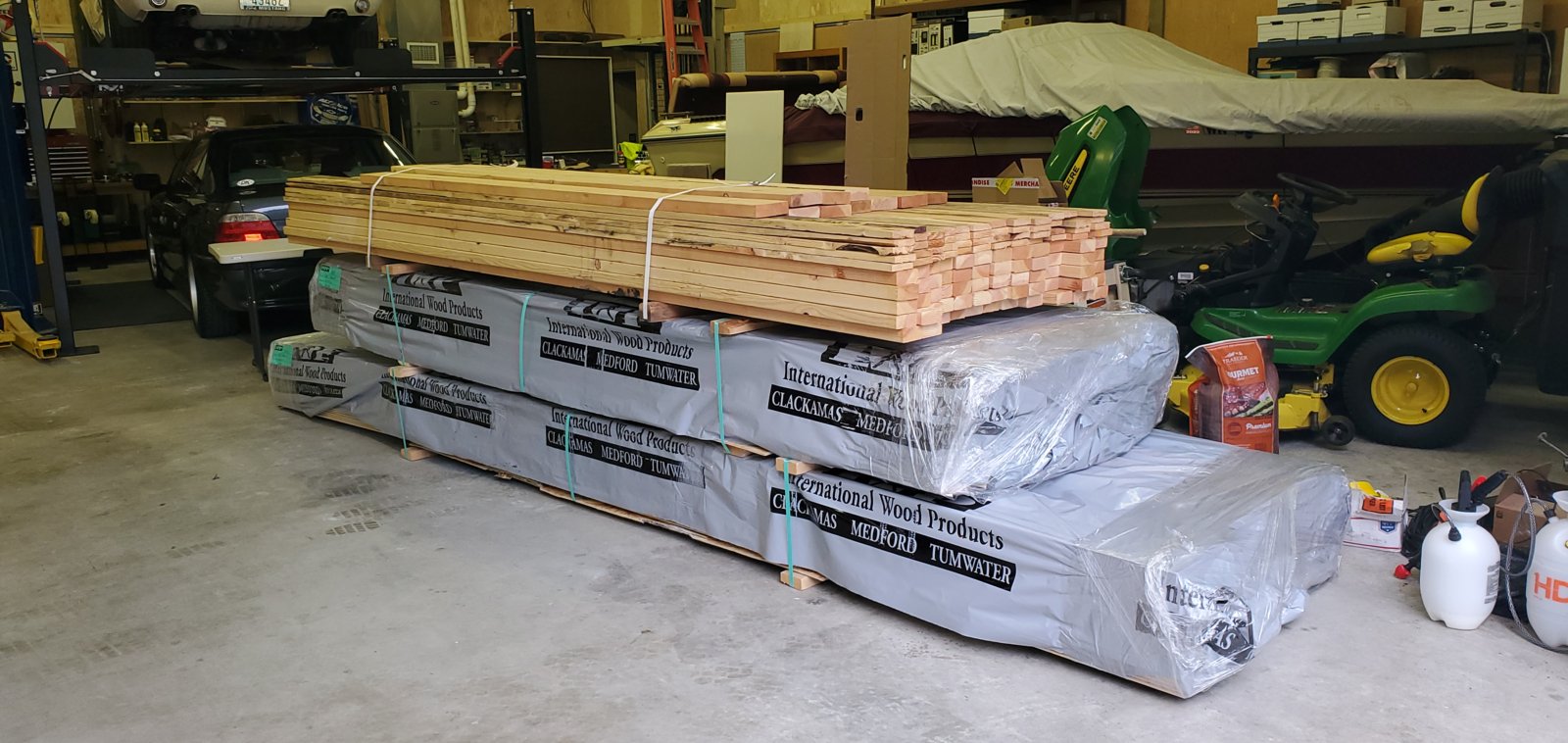

So - I bought a 4 post lift from a place near me and had them assemble it during the summer. I have my Mustang on it now and the E38 underneath. Both are stuck there as I had to put a big pile of lumber behind them... I have a couple of pics showing both lifts (and the mess in my shop - lol).
While there was a two post lift there already when I bought the place, the interior of the shop was unfinished. I have had to (kinda) move in at the same time as I am finishing interior. I do NOT recommend that method of remodeling, but... oh well... It was necessary...
See pics showing the two lifts....

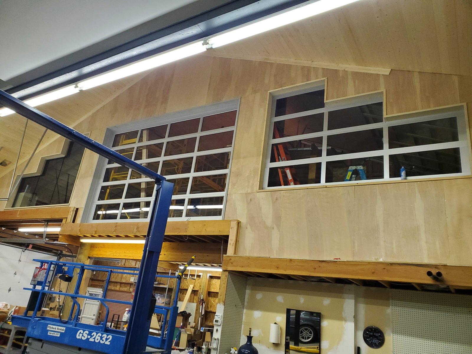

They were taken at different stages of work on the shop... but they show the lifts. On the 4 post one, you can see a bit of the 2 post one as well. FYI - the shop is 52'x70' with mostly 16' ceilings. There is a loft area (to the left on both of the lift pics - but not in frame) that is what I am finishing up now.... (See last pic showing that)

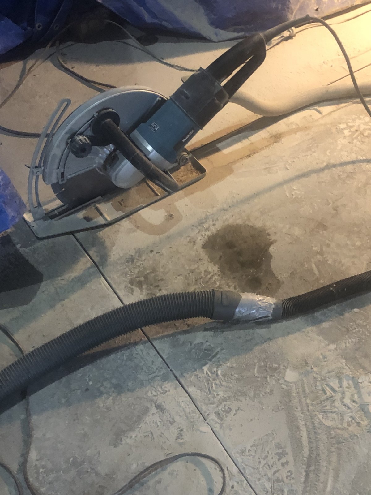

The area I’m putting this one only had 4” at 3500lb, they asked for 4” a 3000lb.!
I’m cutting out 4’square and pouring 8”, rebar enforced base and drilled into existing perimeter every 8” and epoxy rebar in 6”” with 6” sticking out, and 4500lb concrete. And key way around perimeter of existing slab also 4” under.

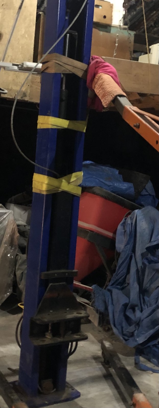

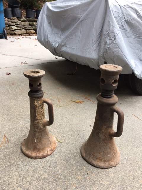

Things are tough around here..here's a pic of the two post system that I got the other day. Cost me six bills. ($6) Pretty cool tho.View attachment 129580
Are those instruments from Whoville? I thought the Grinch returned them all. I sure hope this doesn't mean little Wendy Lou Who or her siblings have fallen on hard times.
