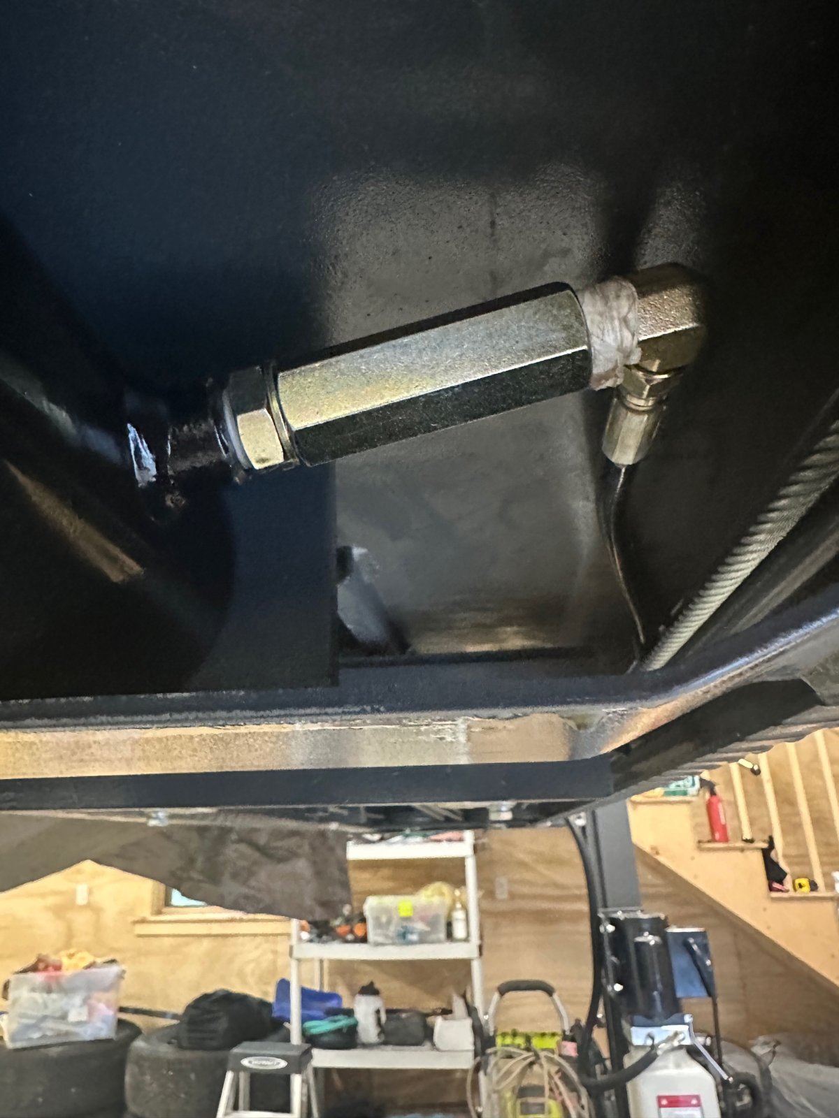

I'm in the same camp as Chris. I have a 7000lb AMGO 4 post lift, and bought it a year and a half ago. I have a nice flat concrete floor, and the installer told me I am better off not bolting it to the floor. So I didn't. No issues in that regard. The issues I have had are that a hydraulic connector under the ramp keeps leaking (weak seals) and needing replacement. I have it replaced twice in the year and half of service. Though replaced under warranty, they told me this part comes from "offshore" and "fails frequently." Not very reassuring, especially since i have used the lift maybe 20 times in total. The other issue is the locking release hangs up on one post, making for an instable lift, which is a real problem. They have been to fix it once, and I am just wondering when the latch breaks again. So bottom line, I would find a lift that is truly made in America. Hope this helps!
