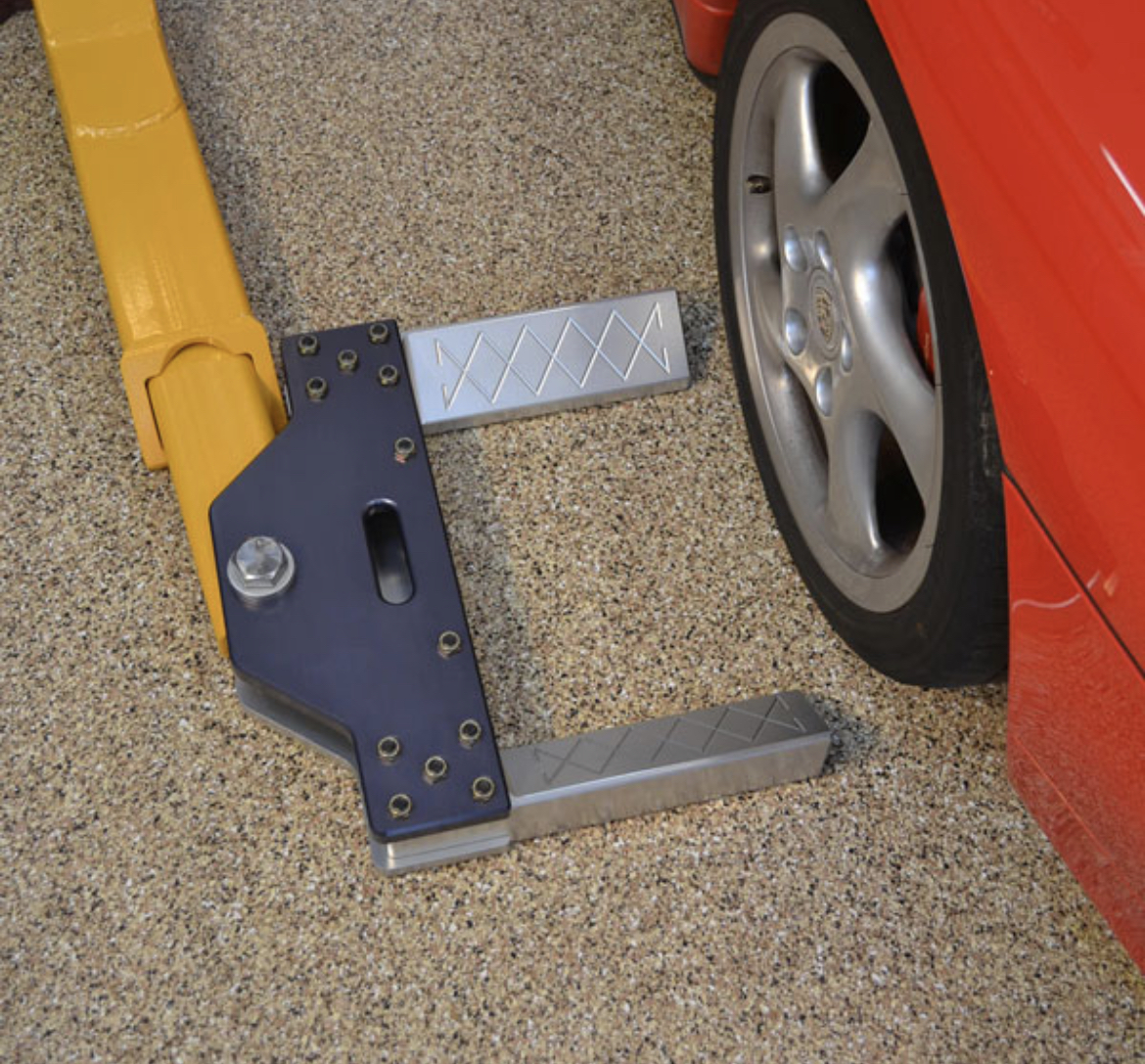

Is there any model of the 2-post lift which is having accessory option for the wheels stands in place of scissor-like arms?
I'm wondering if keeping the car with the wheels hanging freely is good for suspension.
From construction of the floor garage is prepared for 2-post only and scissor-shape lifting arms are very useful for repairs of the suspension.
Not sure it is possible to have the lift for both: long time car storage and repairs with the same type (but accessories).
You mean like this one ?
Tire engaging adapter
Which looks very convenient to use if your lift arms are long enough
or
I think a home made could be even better
Custom adapters
Or like this one ($$$)?
Drive-on adapter

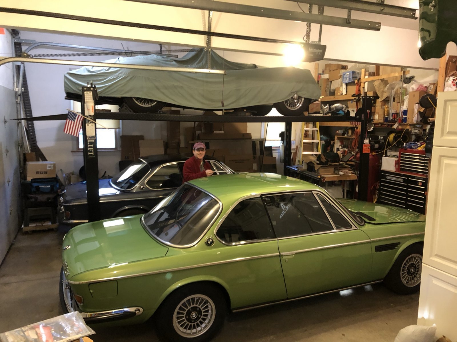

If your main use is storage, I recommend a 4-post storage lift. I have a 4-post drive in storage lift with a sliding bridge jack (1 but 2 of you prefer). I also drilled the cross members for a narrow and a wide ramp spacing. The narrow spacing is good for narrower classic cars and the wide for a modern SUV or small truck. I have $10 sliding metal drip trays because all my classic cars leak a bit of oil but I use the area underneath for a second car and as workshop space (LED strip light to the underside of the ramp).
4-post is less convenient for suspension and brake work, but great for exhaust, powertrain/drivetrain. It is also better if you park a daily-use car next to the lift because there is no post to block opening the doors of that other car.
If I were doing repairs every weekend or a bare-body restoration I would buy a 2-post lift with lifting arms.

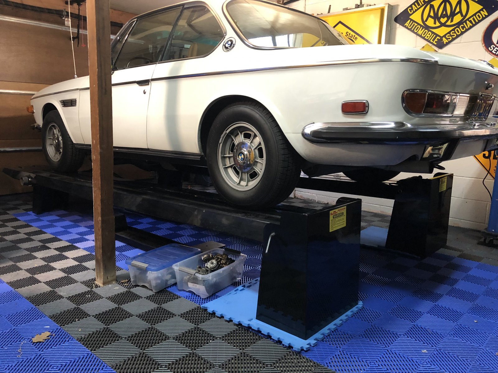

When working I had access to a shop with a 4-post lift and loved it for all types of work. Unfortunately at home I have low garage ceiling height and the pad thickness is unknown, so I have a low-tech drive on lift that has a fixed lift of 20" from the floor to the bottom of the tires.
This is a real compromise and I would prefer a 4-post or, there are some really interesting single-post lifts that I would consider.
The lift shown is a Kwik-lift (no longer in production), with a lift bridge that will allow the car to be jacked up for suspension or other work.

I’ve never seen this before now. That design could be improved so that it’s more of a curved plate to cradle the tire and help it from flat spotting in one or two locations. Thanks for sharing this pic. Got to get or fab me some of these to stick in my lift for storage solution
Sure. If my garage were 10ft wider, I’d get a 2-post lift and make a set of adapters like this. You could get really fancy and design them w an adjustment to fit a variety of tire diameters. One advantage of my 4-post drive on lift is that I can stand on the ramps to work on cars that are up in the air when there is still a car parked underneath. I just have to remember not to take a step backwards :-o to be safe, I only do that on the ramp that is up against the wall (12” gap).

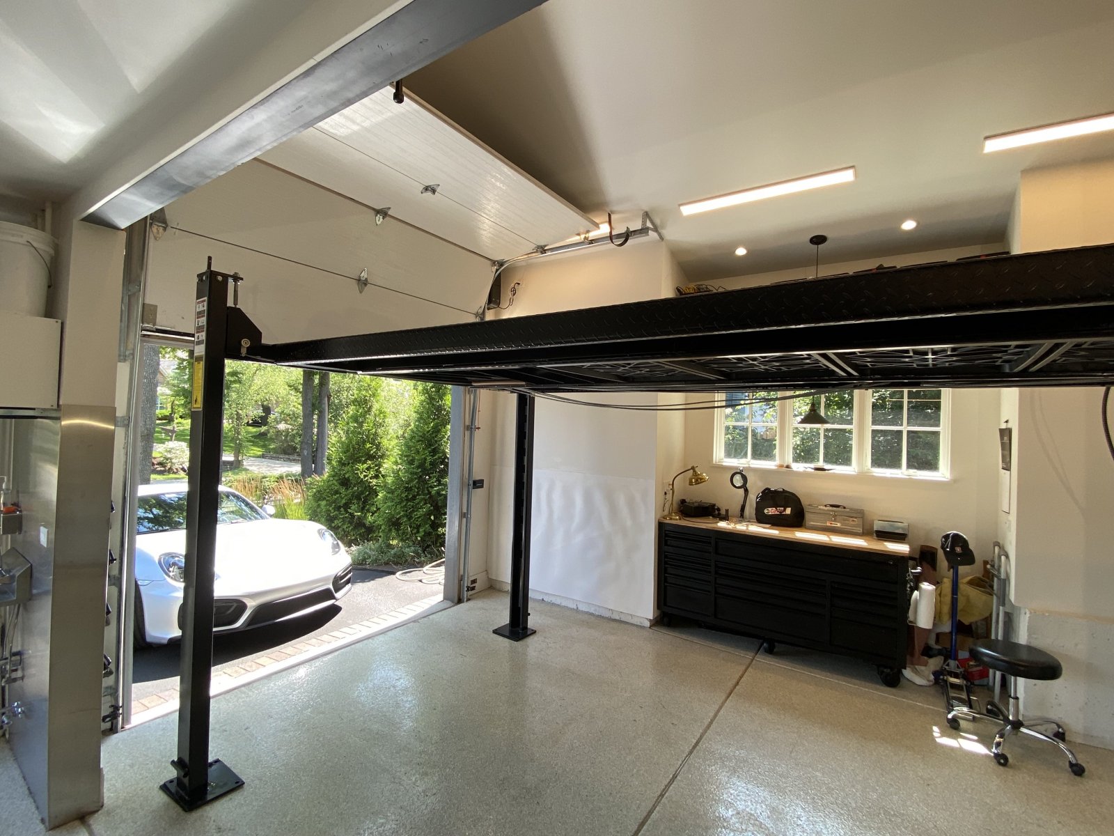

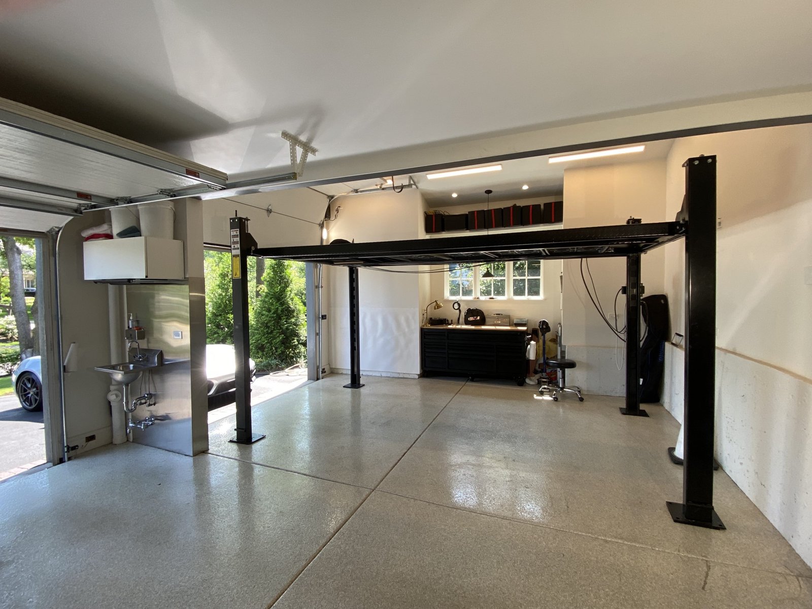

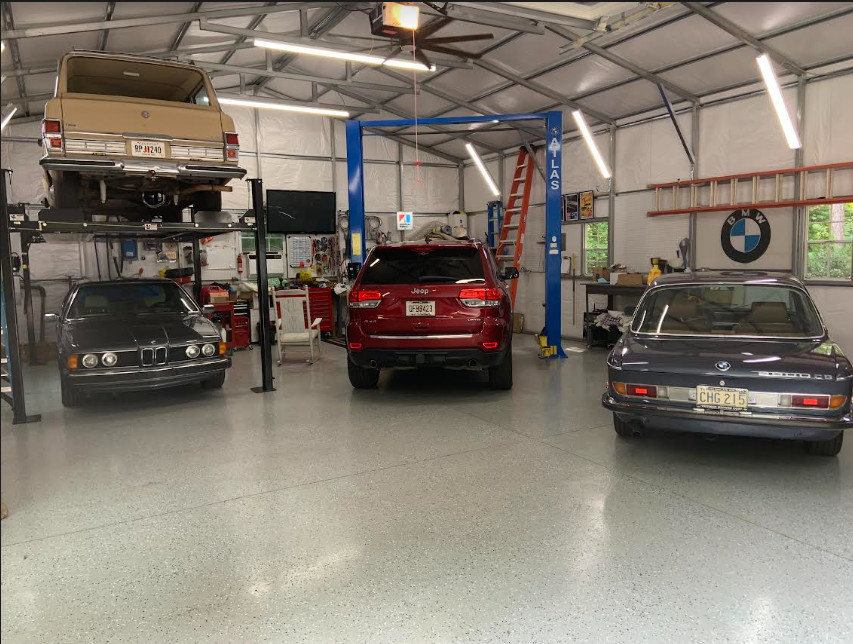

If this is useful info to anyone, here's my lift details. I have an Atlas four-post with extended height. (XH-PRO8000EXT) I've had the hydraulics replaced under warranty (leaking cylinder) but other than that, it's been a champ. I opted for the four-post because my garage floor has radiant heat and thus I can't anchor posts to the floor. I was more interested in storage, anyway. In terms of overhead height, my lift is in an bay of the garage with a shed roof above, 13' at the peak where it adjoins the inside wall. The track for the door's horizontal run is at 134" off the floor. Even when I max out the lift with my coupe on it, the rear window is still a good 12" from the top edge of the garage door. Obviously, a bigger car, or one positioned farther to the door end of the lift wouldn't clear the door at max opening. I'm 6'2" and I can fully walk under the lift when its at its maximum height. Atlas does make jack accessories that let you use a four-poster to lift a car on the frame or jack points, but I don't have those...
Pics for reference. (I was actually repositioning the lift with its wheel attachments today so....)
