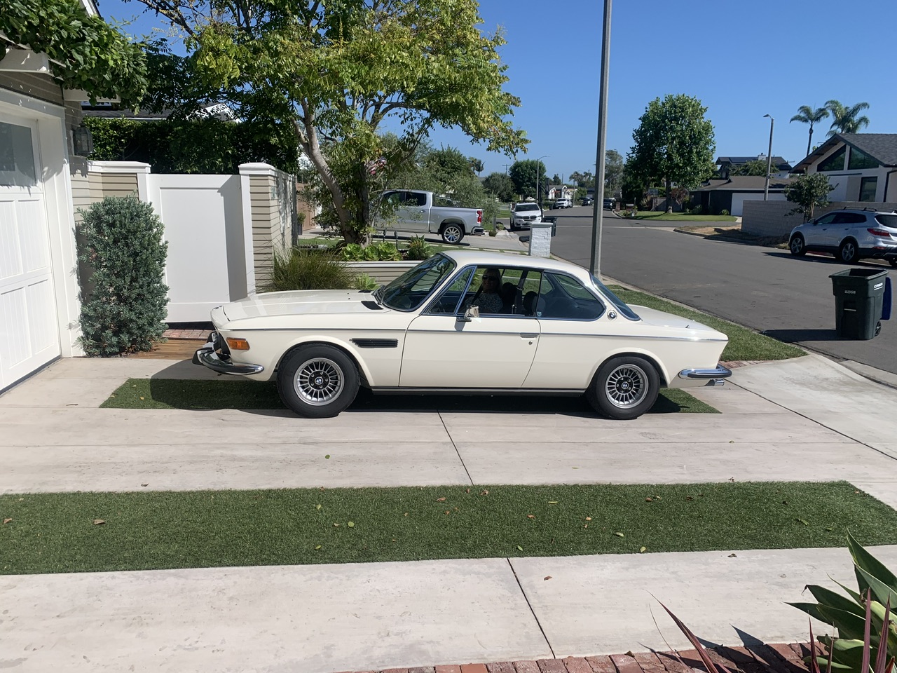

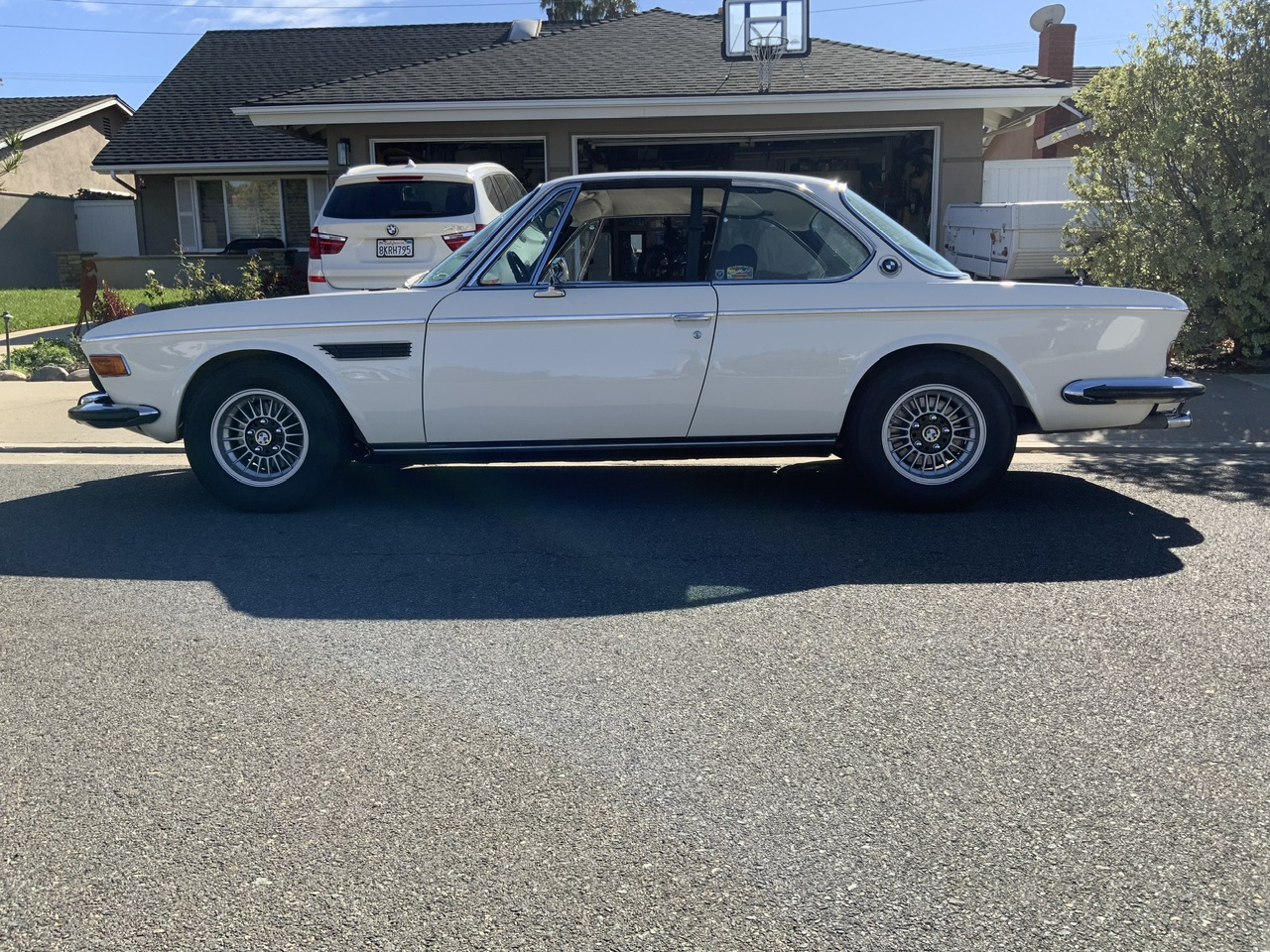

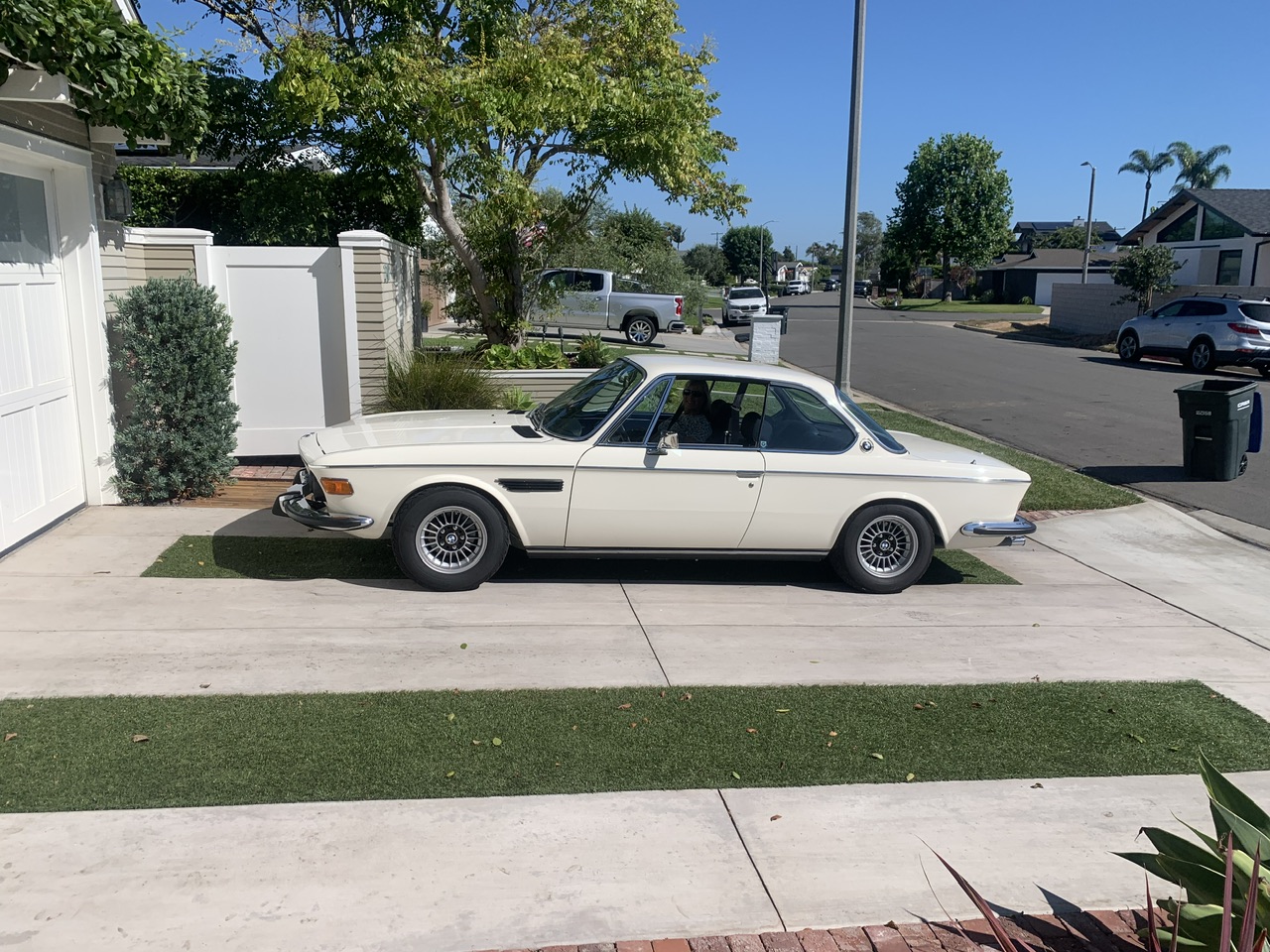

What a beauty! Congratulations ChrisA/C is done and carb issue finally solved! It was too late to take to Monterey but while I was gone Ron Inchausti did an amazing job of diagnosing and correcting several issues. Besides the interference issue with the manifold which kept the main throttle plate from closing, the main jets were too lean. He drilled them from 117.5 to 125, and the dizzy had a wonky mechanical advance but I drove it home today and voila! Starts nice from cold, idles well even with a/c on, accelerates amazingly well so I am thrilled. After ten months without a drivable coupe I can enjoy it once again, what a long and winding road it has been. Pic taken at the Cain household.

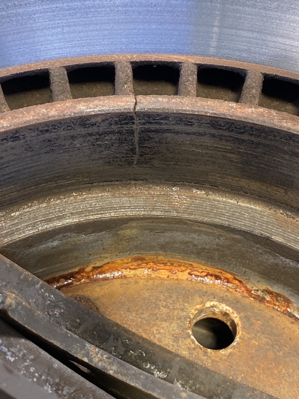

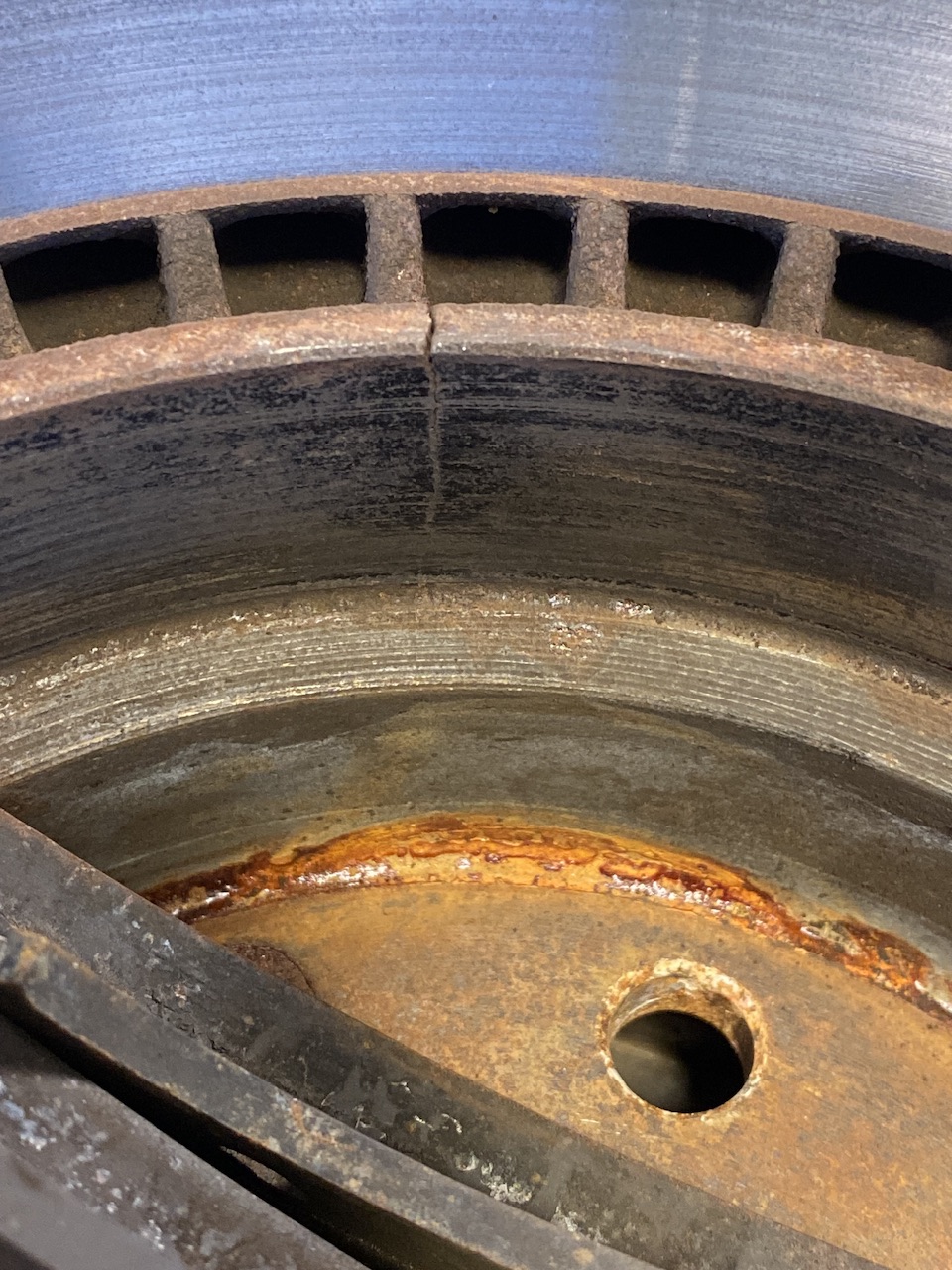

Does this just happen spontaneously?Rear rotor, crap! View attachment 169642
What was the symptom that made you want to look here.Rear rotor, crap!
