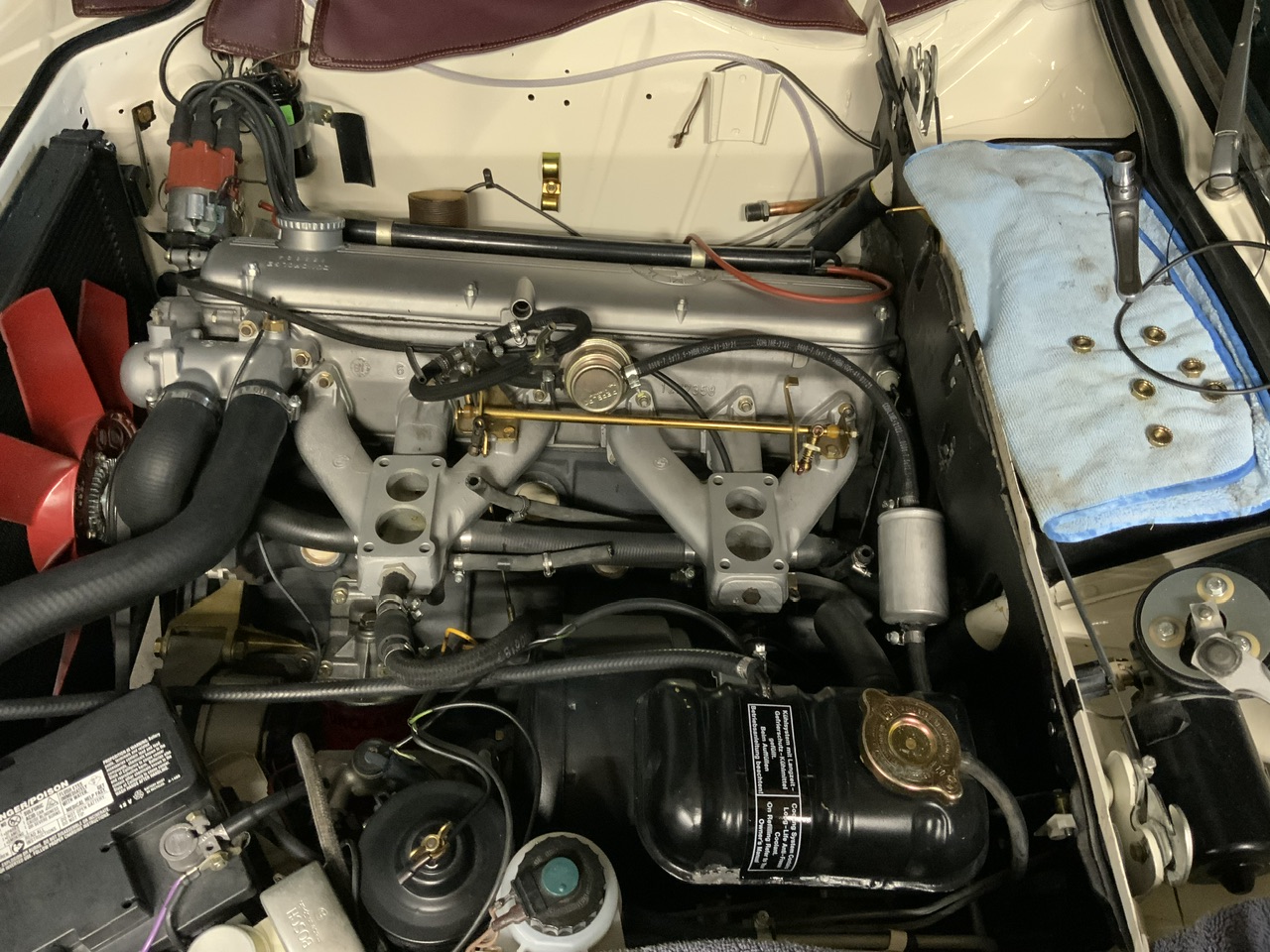

Still dumping fuel after five attempts, I’m done! Sent to Carb Refactory in Richmond, Ca. Hoping I can get them back in three weeks so I still have a shot at driving it to Monterey as I only need to get the a/c done when it is running again. Twenty minutes to remove them from the coupe, pretty quick I think.
Bummer, let’s hope they make it back in time.
That engine compartment is beautiful! :love:

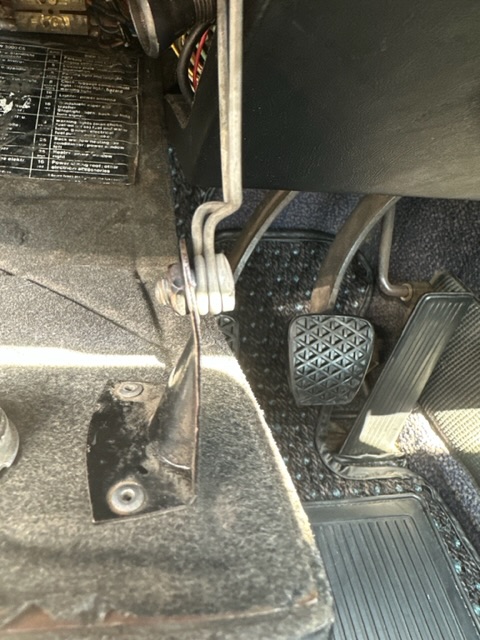

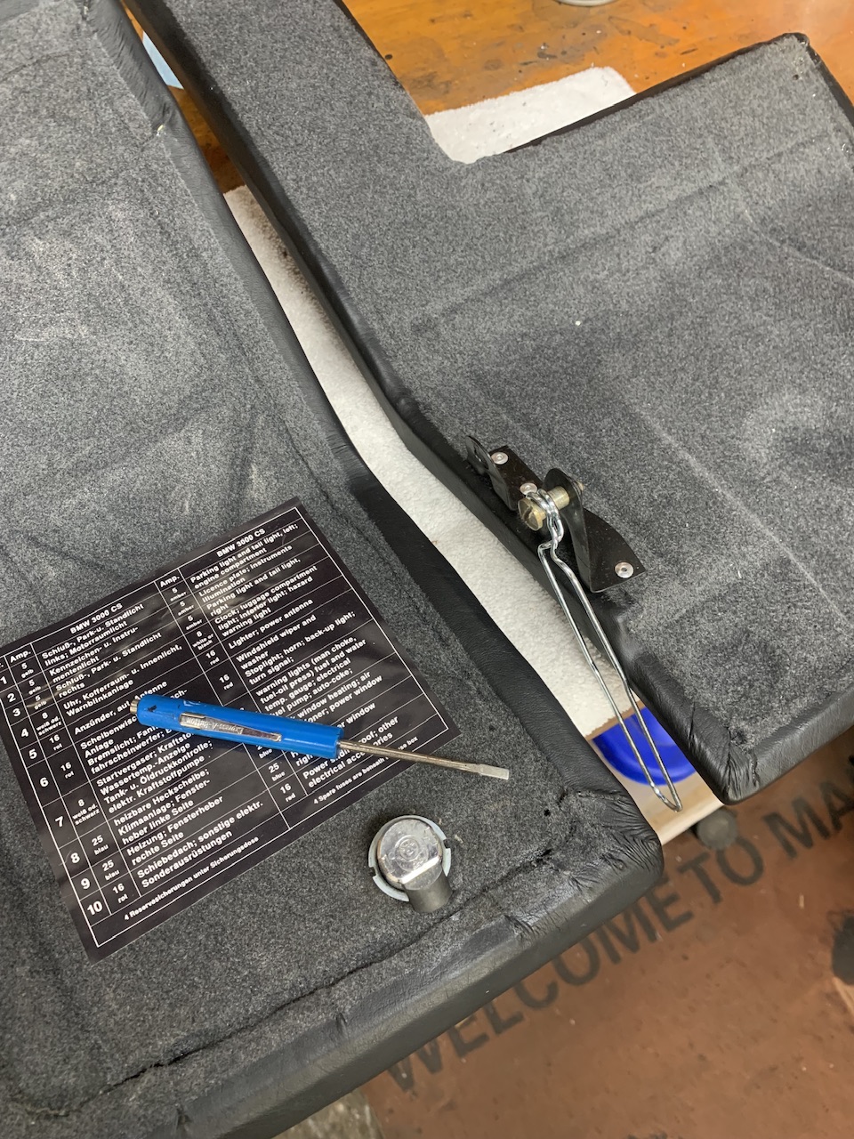

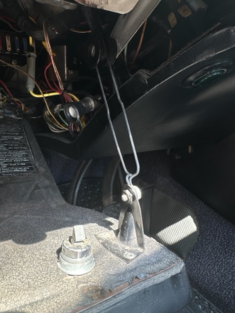

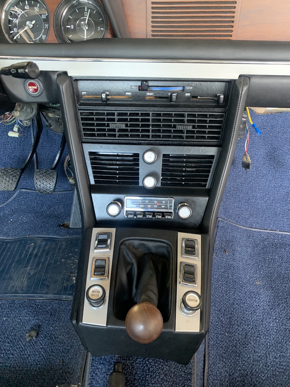

Pic needed to show how underdash cover mounts and bracket missing on hood release door please.
Chris, i am presuming that you have said bracket? be careful putting in the pop rivets - try using as short of a rivet as you can to keep from disturbing the outer portion of the door / getting a good tight fit
