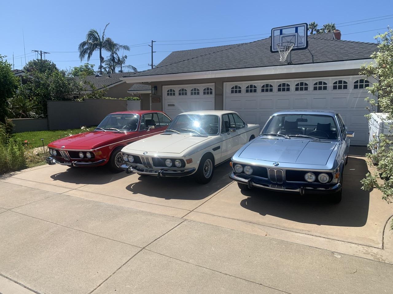

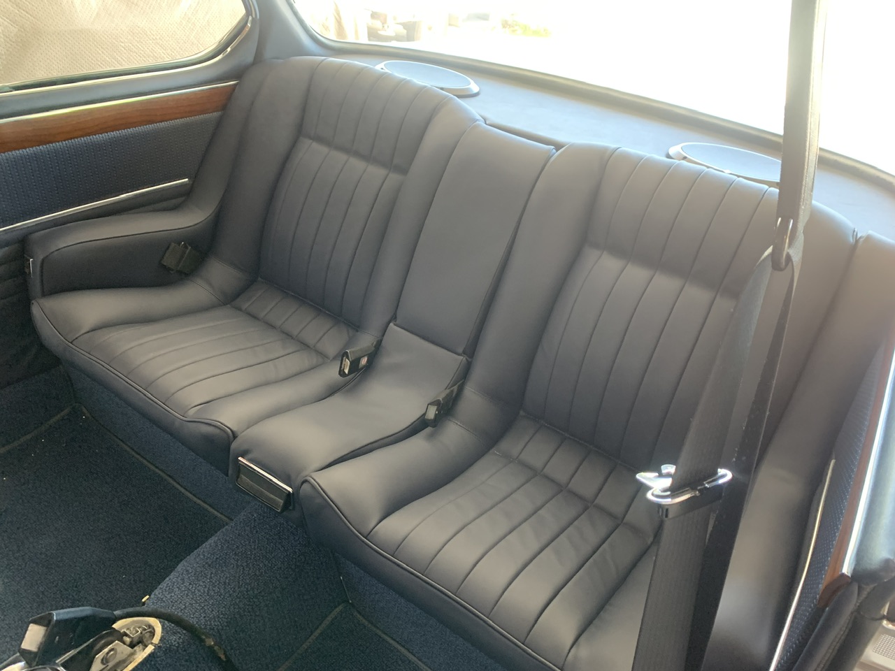

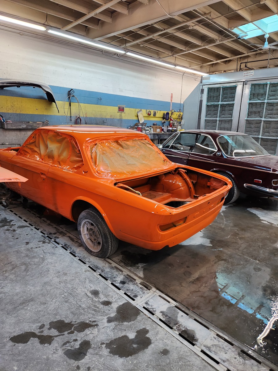

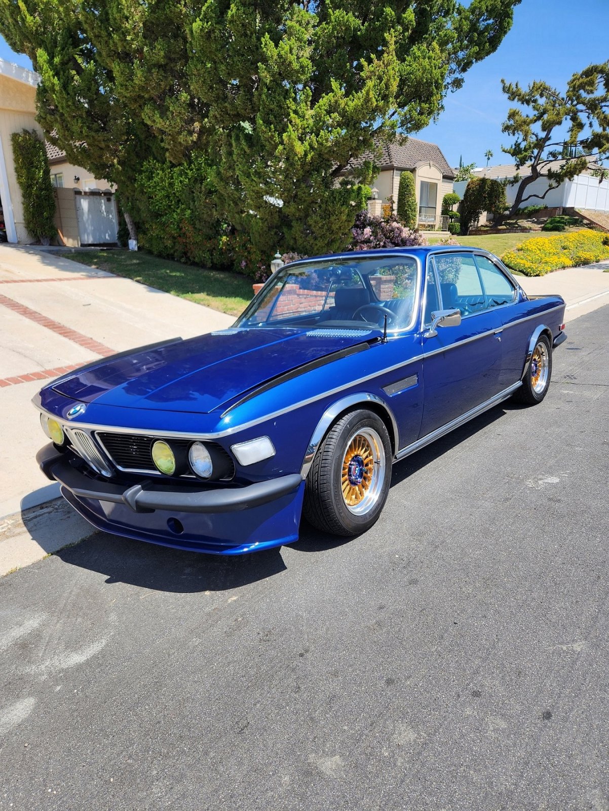

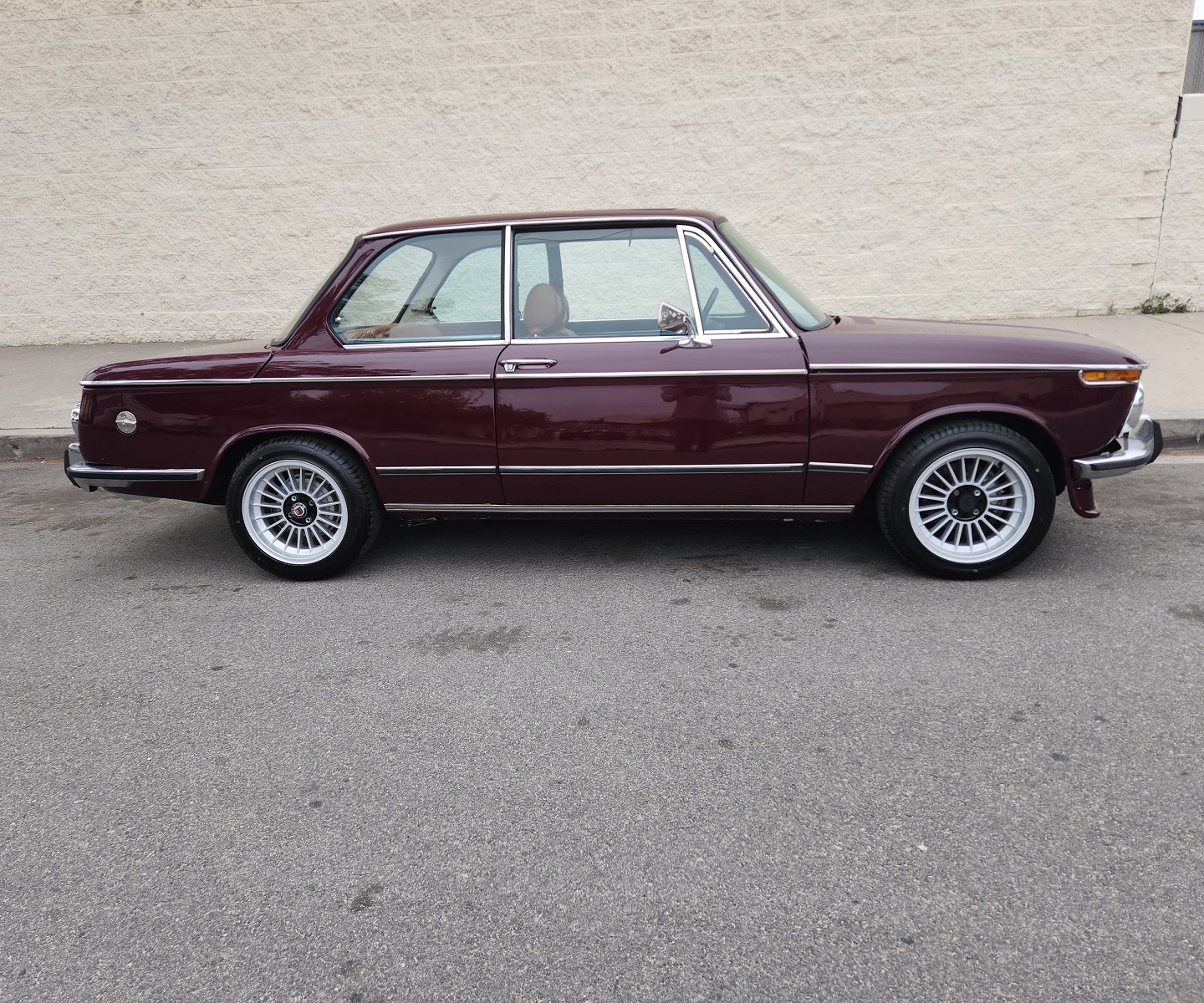

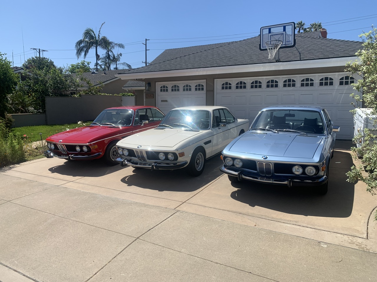

all three are beautiful but I like the blue one better I have a 3 E9 to the colors are Malaga, navy blue and Inka Orange but 3rd One is striped and I have to put it together paint is completed, and I have 1972 2002tii in Malaga, but I decided to sale them all I only will keep the Inka orange.
I love this navy blue but is not an original E9 color

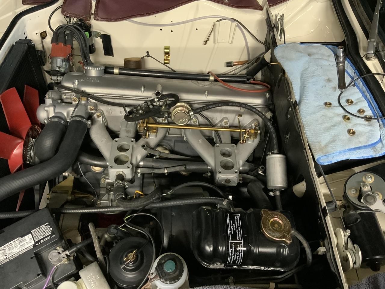

Still dealing with a sluggish acceleration. Cold idle high but good, just takes a bit to drop down, I will adjust those darn screws soon. Warm idle good. Air meter shows same air draw down both main throats, no gas dribbling in throats, accel pumps squirting when needed, timing is good, been advancing it a bit, replaced dizzy vacuum dashpot with a spare, still running retard as well, correct points gap, everything is new. Last detail to make it an enjoyable drive to Monterey but only a month to go!
@stphers Any advice?
Hi Chris
Are all inlet and exhaust valves adjusted correctly ?
How are all 6 cylinders have you done a compression test just to make sure all is well.
I am just shooting in the dark really with those suggestions, but at the same time it’s no harm checking all the same.
How is your fuel pressure going into the carburettors ?
Is the fuel tank vent pipe working.
And last silly question, I assume you don’t have any binding brakes .
Hopefully you will get it sorted before the planned trip :)
Good luck!!!

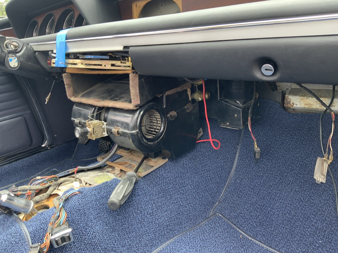

installed Alvaro’s vapor barriers but put them on the door cards instead
Chris, you do amazing work. I’m kind of picky but you are a perfectionist and it shows in the results.
Does the way you installed the vapor barrier risk water getting into the car in a very wet situation?

Still dumping fuel after five attempts, I’m done! Sent to Carb Refactory in Richmond, Ca. Hoping I can get them back in three weeks so I still have a shot at driving it to Monterey as I only need to get the a/c done when it is running again. Twenty minutes to remove them from the coupe, pretty quick I think.
