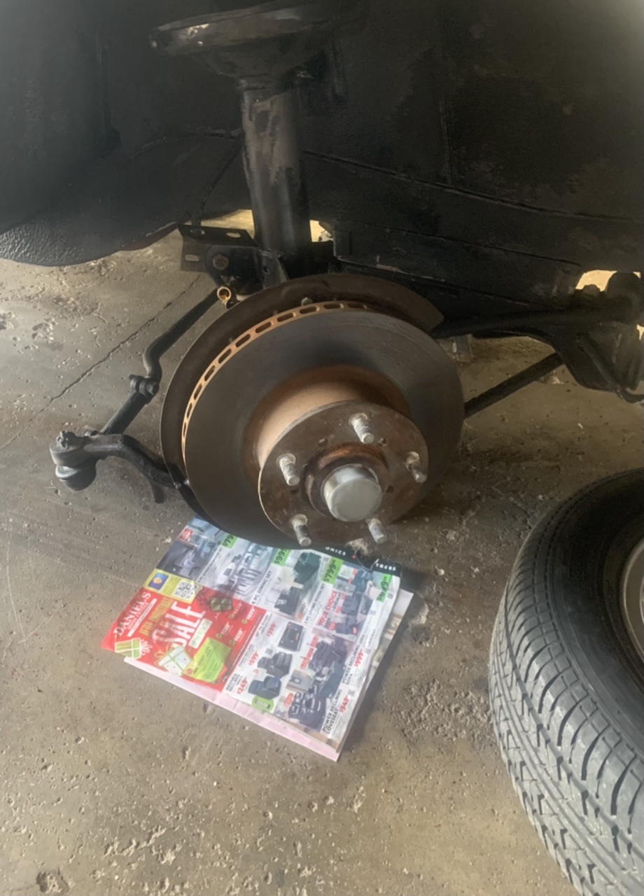

Pulled all four calipers as I couldn’t get any fluid through the bleeders. As I suspected the hoses were swollen shut with 2002 date codes. Might as well pull half-shafts too, a miserable job but done and needed anyway. Calipers will be rebuilt, it’s a miracle the car even rolled.

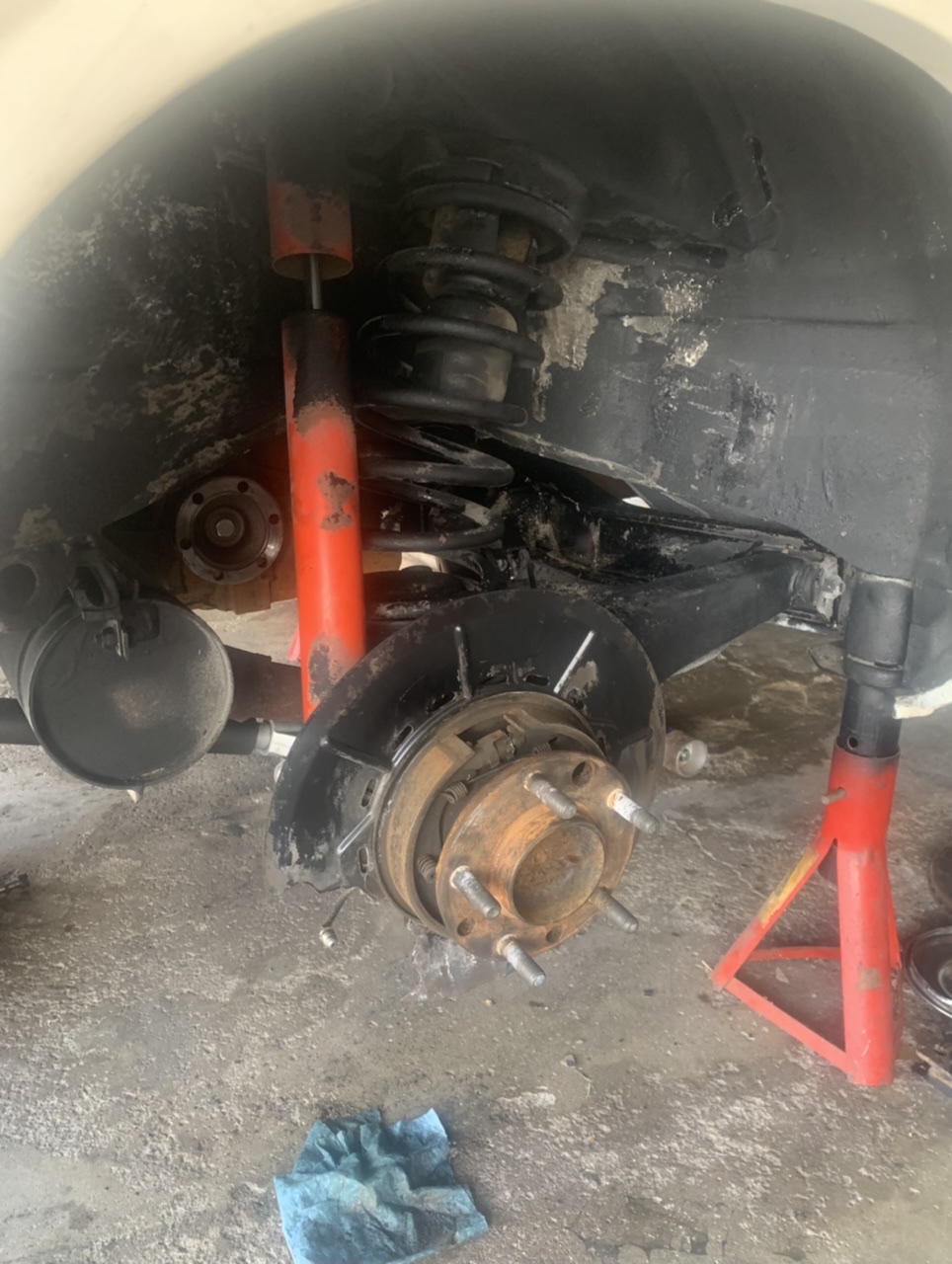

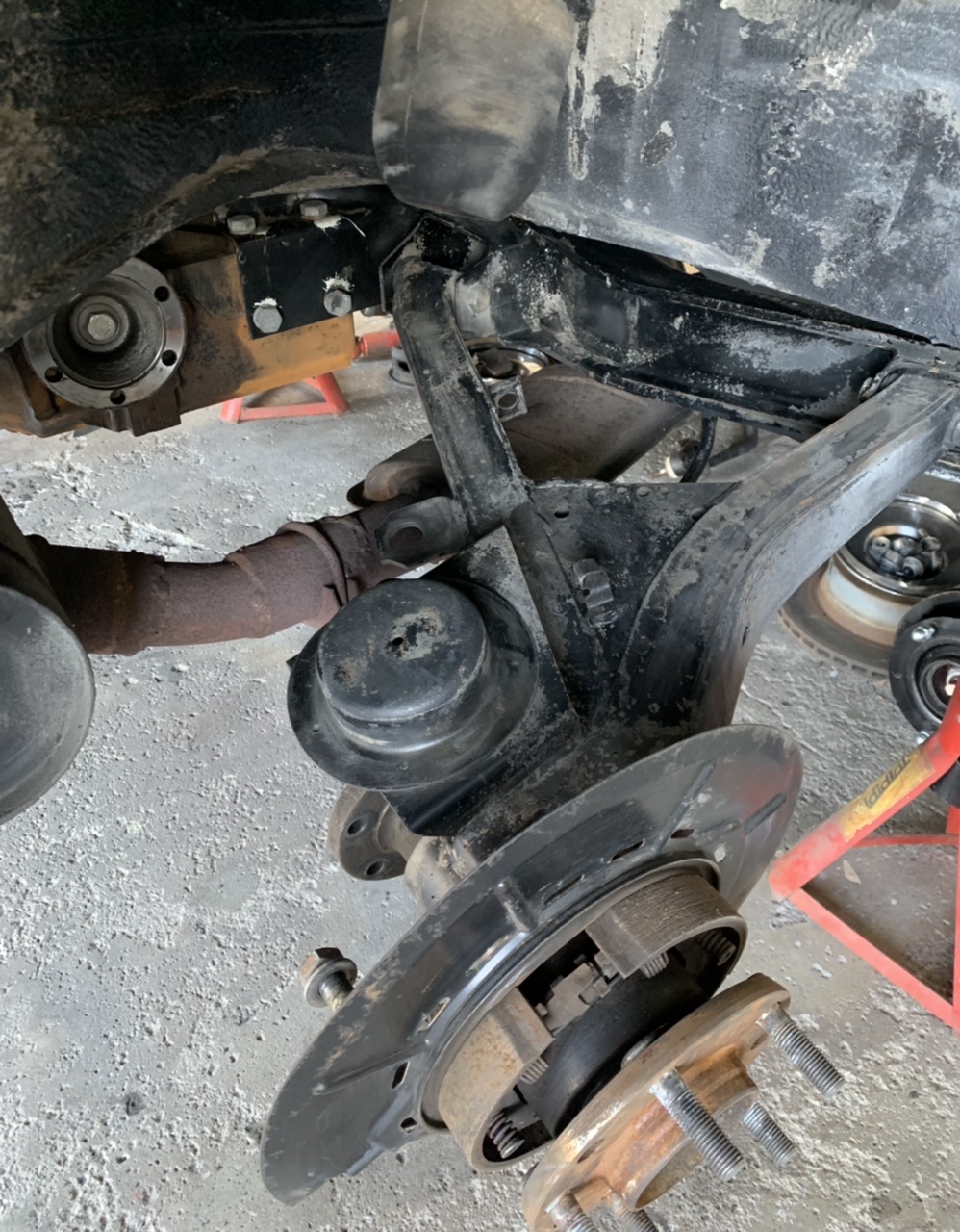

Calipers and half-shafts out for rebuild. Next is to pull struts and replace control arms, tension strut bushing, stabilizer bushings, idler arm bushing, wheel bearings, strut mounts all with yellow zinc washers, nuts, etc. Hope I can find a center track rod! No sense cutting corners here.
I removed the struts, control arms, tension strut, track rod and tie rods today. I now have several flesh wounds! Calipers out for rebuild (super nice guy and shop in Signal Hill area of Long Beach), half shafts already rebuilt, took brake backing plates, tension struts and a few other item to powdercoat. I will replace bearing next and start scraping black undercoat from wheel wells, I had rattle cans mixed for Chamonix to paint the wells. I already have yellow zinc washers, bolts, spacers for install and am sending a batch to resupply my hoard.

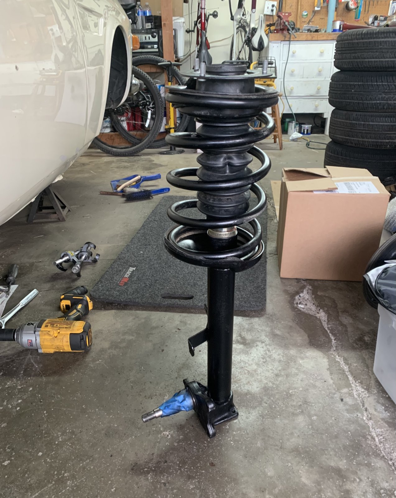

Nasty work today scraping out the pass side wheel well with a wooden handle wire brush so i can paint in there. And rebuilt/painted the strut for that side waiting for calipers to be ready for install. I cleaned and repacked grease into the strut bearing as the rubber looks great. Also replaced fuel hoses and filter in engine bay. Like the brake hoses they were dated 2001 and were in terrible shape.

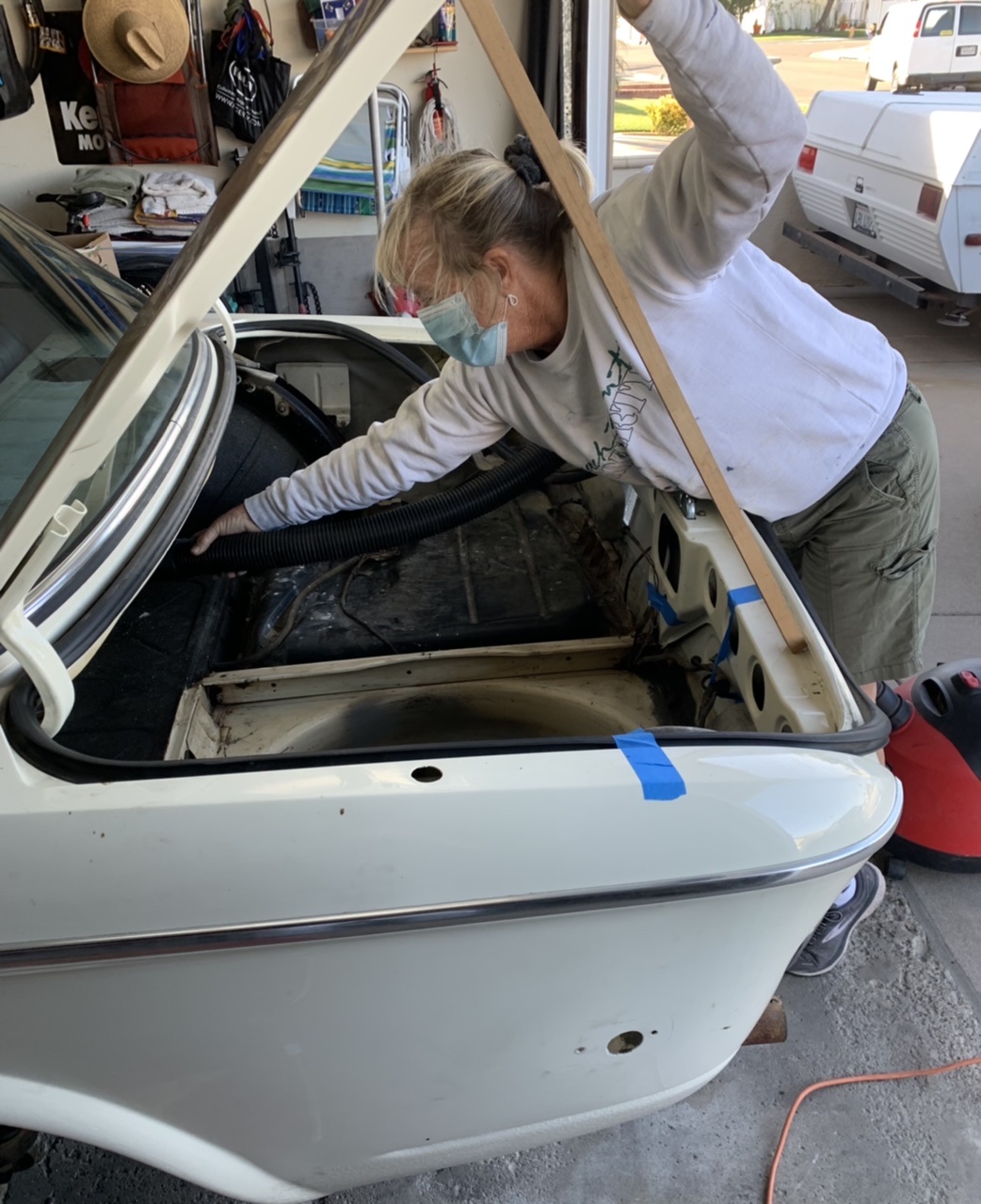

I’ve been scrubbing subframes and wheel wells. How many of you have wives who would willingly crawl into the wheel well to help? I have an awesome wife although she does expect her share of the proceeds!
Great. It is good for some of us (including me :cool:) our ladies are supporting us in our hobbies in different own ways!
Look like a new idea for thread: "What my wife did in my E9 today"
