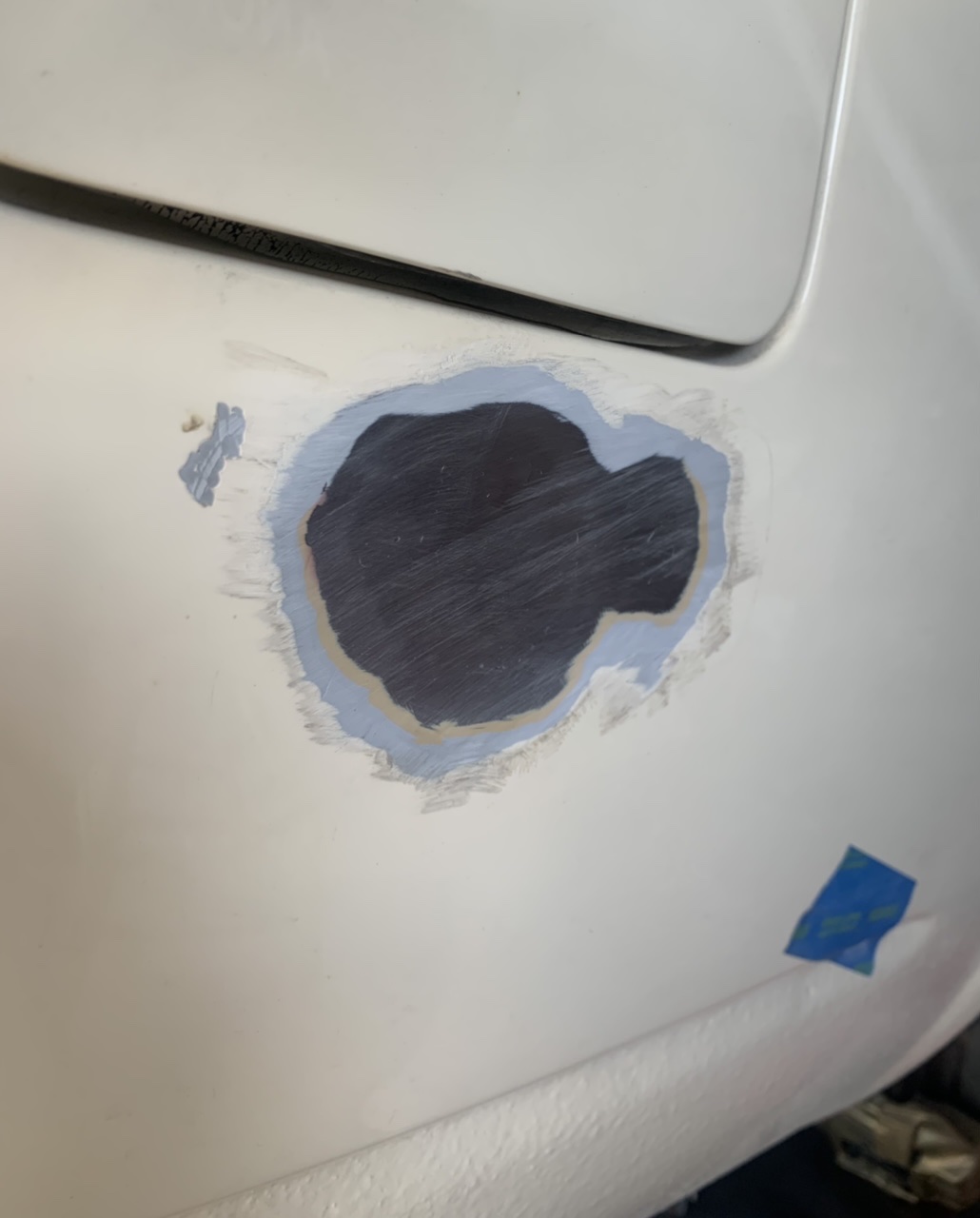

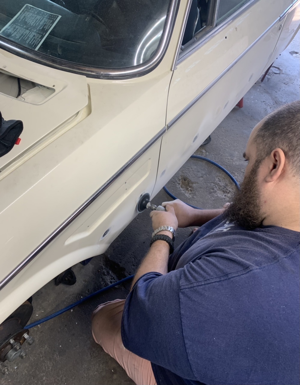

Remove everything, sand with 120 grit and/or a scuff pad, etching primer on any bare spots, wipe down with Prepsal, mask and shoot. A local paint shop put the Chamonix in rattle cans which are fine for engine bay and trunk.

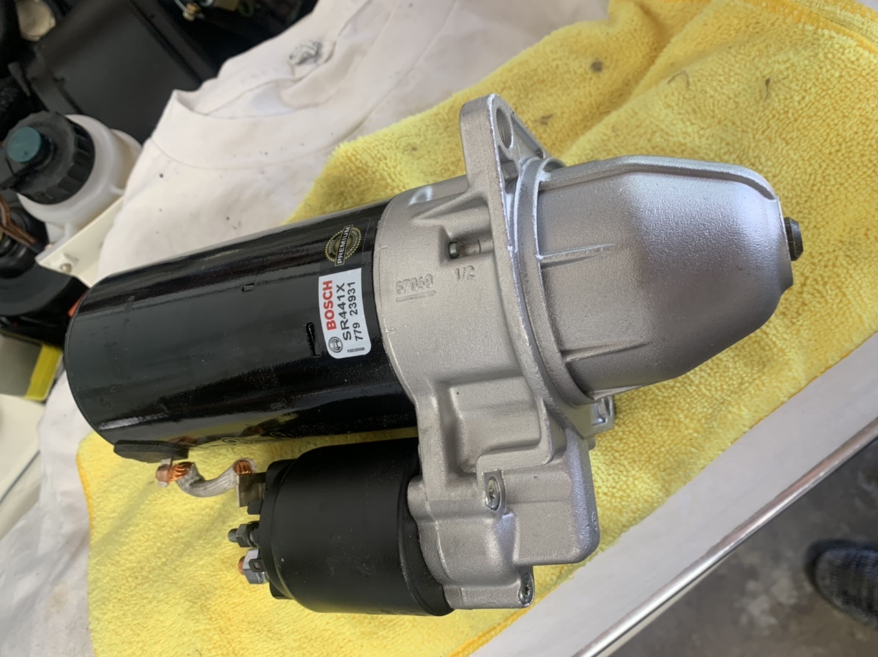

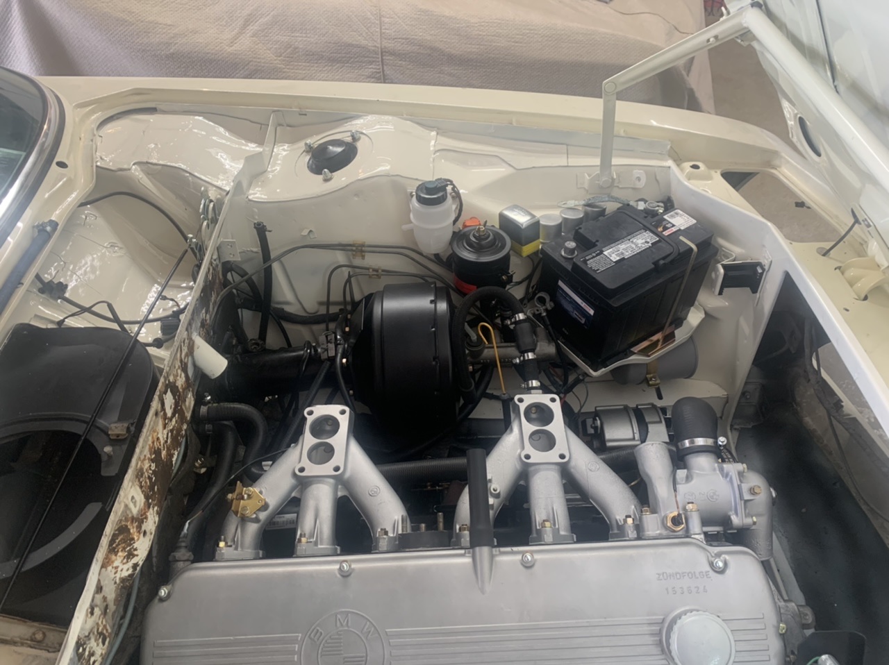

I also tested compression dry as it hasn’t run in four months and got around 150 on all, with some oil in cylinders it should do better. Once new starter arrives carbs will go back on and I will start it up, yippee!

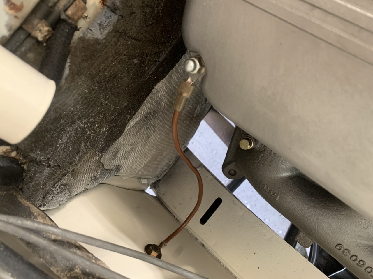

Made a bit more progress as the Bosch SR441X arrived with the correct small case. I added an extra ground cable to the valve cover, swapped the battery ground cables to no avail. Radiator back in along with all new hoses and new hose clamps, expansion tank in to.

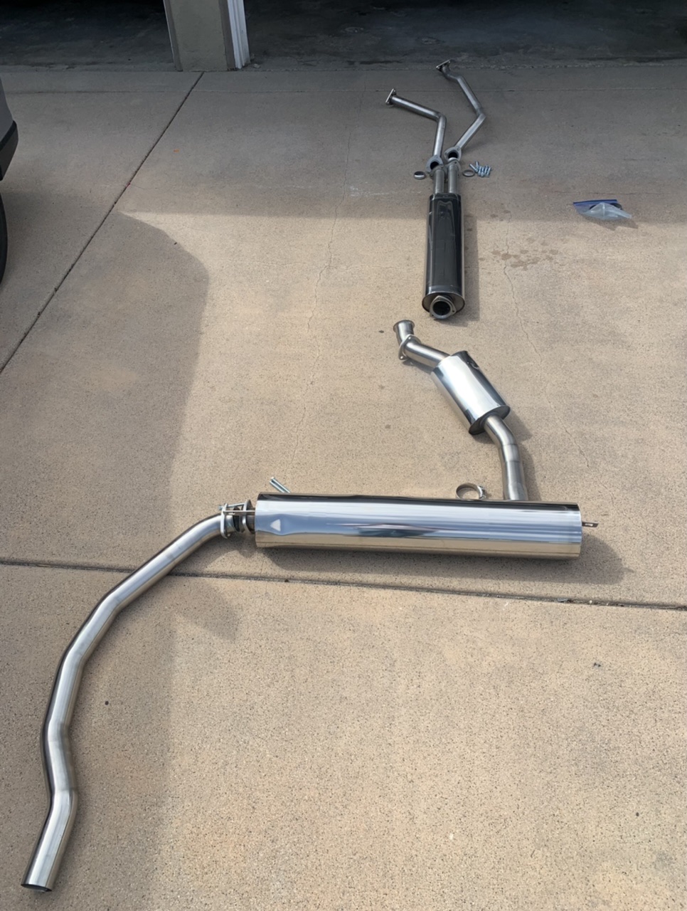

I also laid out the Fritz Bits exhaust that will go in Malaga and its fairly new stock exhaust will go into Chamonix.
