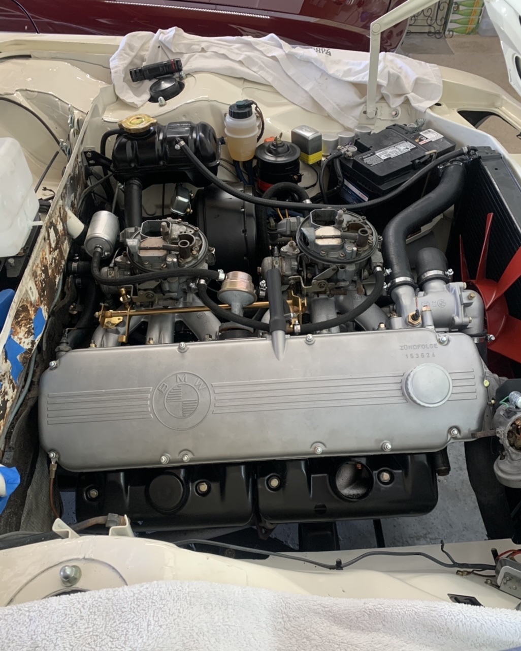

Exhaust system from my Malaga coupe is now installed and should be ready to fire up for the first time in four months. I’m always nervous at this point although I shouldn’t be!

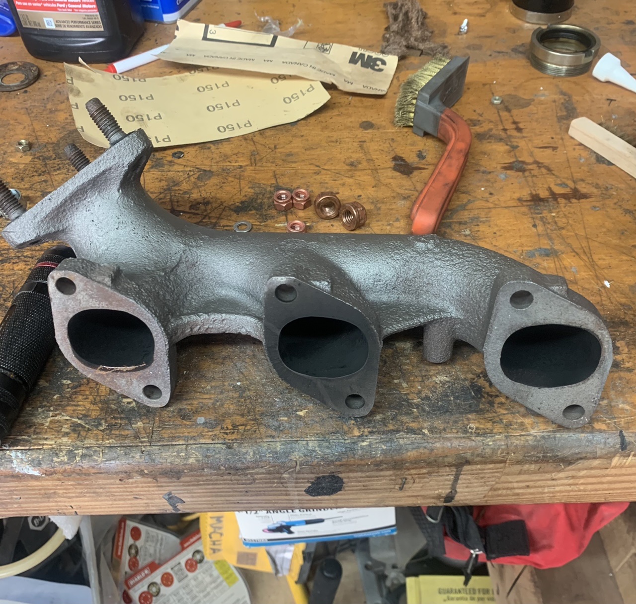

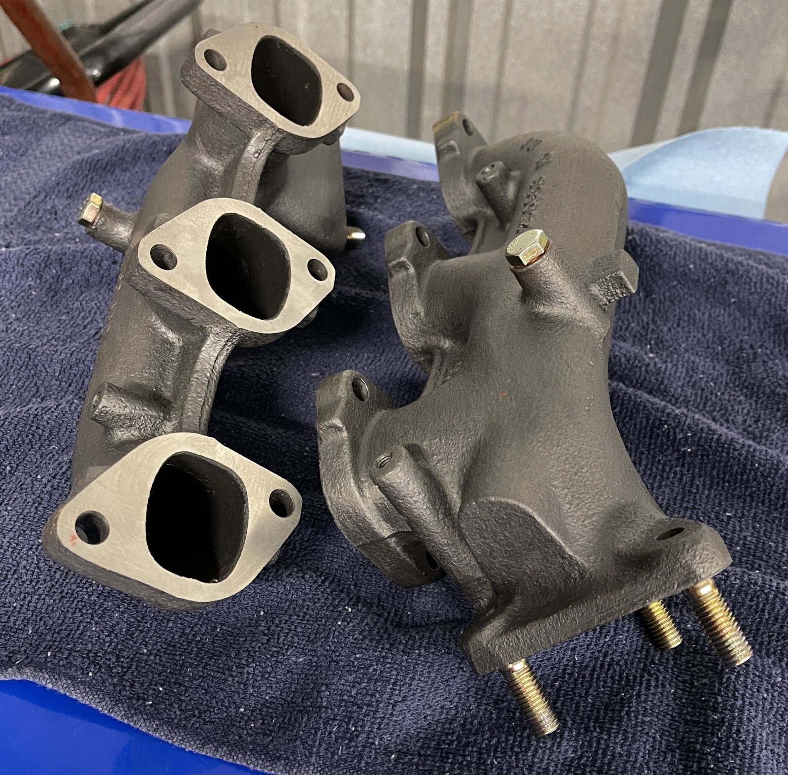

One step forward and one step back it seems. When Paul was here yesterday I fired up the coupe only to find a massive exhaust leak so manifold has been removed for machining (guess which cylinder). This was after I had no power to the coil which I quickly diagnosed as I had dislodged the triple GN-SW wires from the spade on Fuse #6 when tracing burnt wires three months ago.
Just had mine done, surely they warp over time.

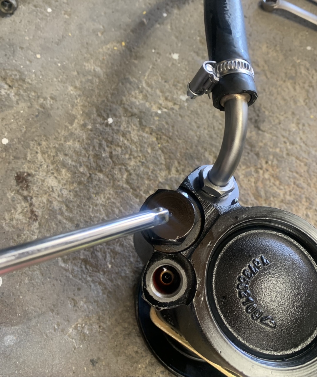

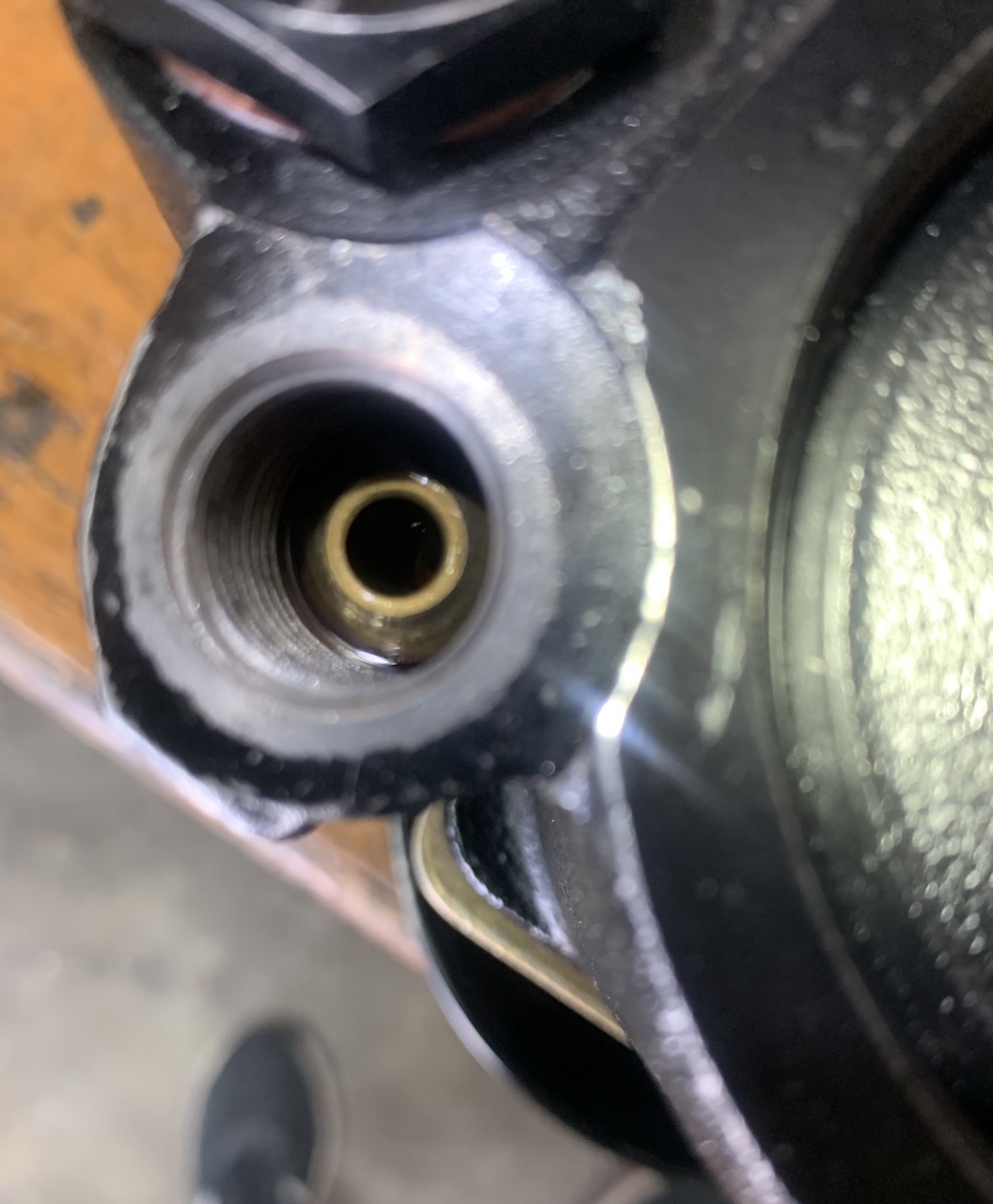

I had a leak at the PS pump where the high pressure line enters the pump. The hose end has a flare which fits over a cone in the pump, I messed with it for too long and then Paul gave me a spare HP hose, got it in and same problem! So I pulled the pump, another unpleasant task without a lift but not too bad. I turned the pump over and the 27mm nut above the fitting was finger tight, not good and the real source of my leak. Tightened it up, installed pump and finally no leaks.
