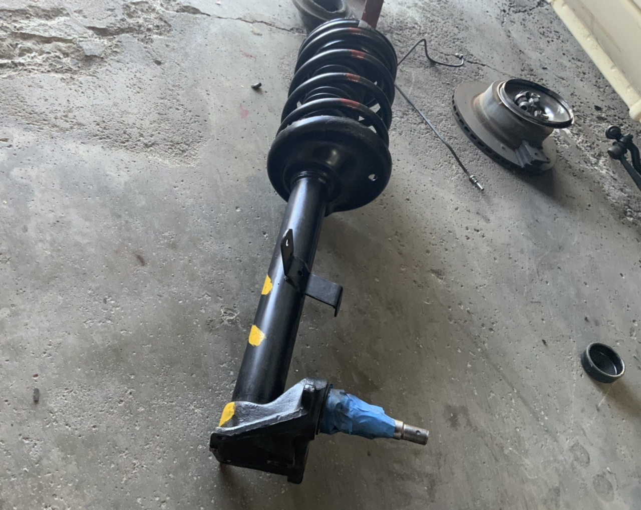

I’ve been busy cleaning and painting. Wheel wells were cleaned with wooden handle wire brushes and a scraper then prepped for paint. After using Chamonix base coat in a rattle can which took two coats didn’t achieve my desired results, I listened to Paul Cain and bought white DTM primer with a catalyst and reducer which I applied with a 4” foam roller and a cheap brush. Black undercoat is now invisible, over this I shot single stage rattle can Chamonix and the results are outstanding. Front struts are done and painted with the factory yellow brush strokes, strut bearings cleaned and repacked with grease, backing plates powder coated, calipers yellow zinced and rebuilt, new control arms, tie rods, idler arm bushing and track rod ready to install along with new brake hoses and tension strut bushing, subframe painted, rear springs painted as well. I just have to decide which shocks to use in the rear, the current red Konis, a used pair of Boge from Paul or find some gently used Bilsteins to match the front. I still need to paint front frame rails and finish the subframe and then install everything and get it back on the ground. I cleaned the spare tire well of the nasty black undercoating by using charcoal lighter fluid and a brush, I shot some paint but it still needs more work as you can see.

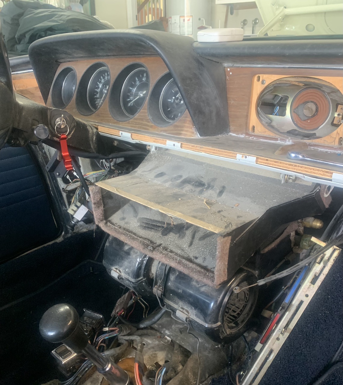

How do I even begin to repond here? Stan, next I began to strip down the dash and a/c box to work on electrics and to redo the wood. I just haven’t been very motivated but Paul tuned my carbs a couple of days ago and they are running very nicely.
Turbos are something I have very little knowledge of, except I once owned a 1982 Volvo 244 GLT Turbo, what a great car. @Ives can share what he has done with his turbo install, it was a very challenging task.

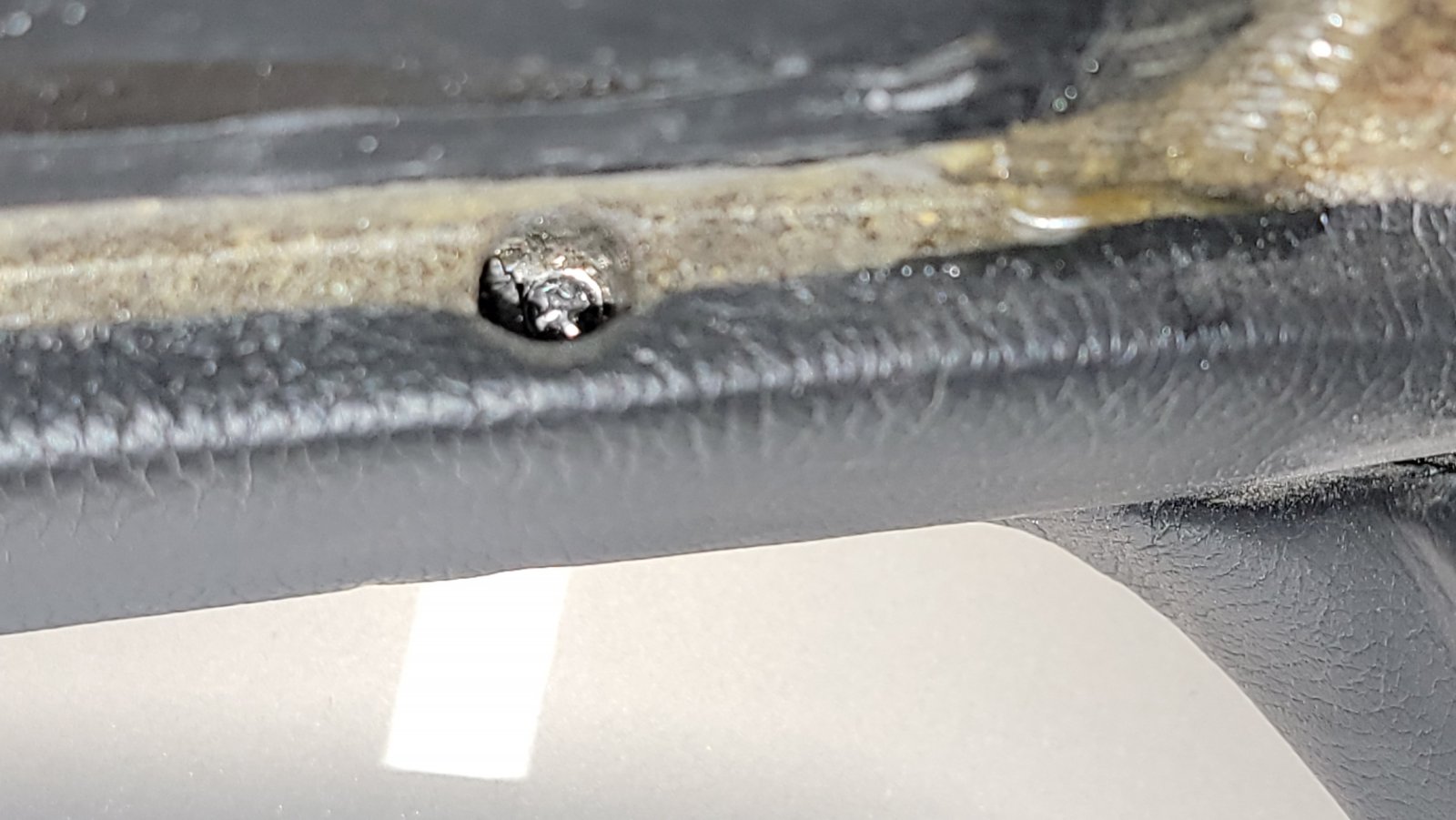

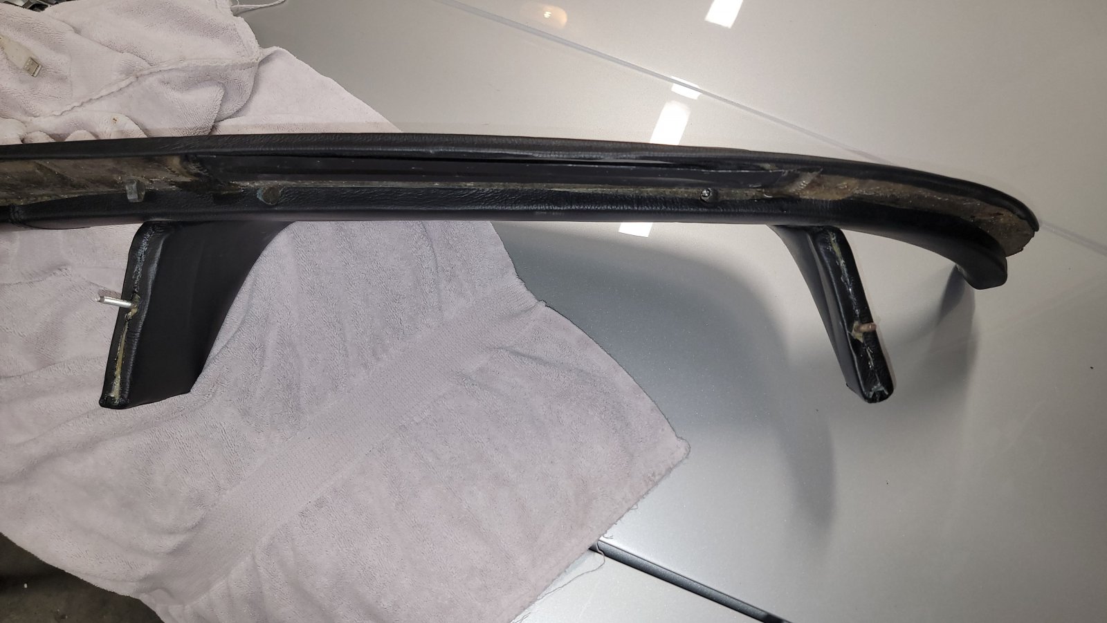

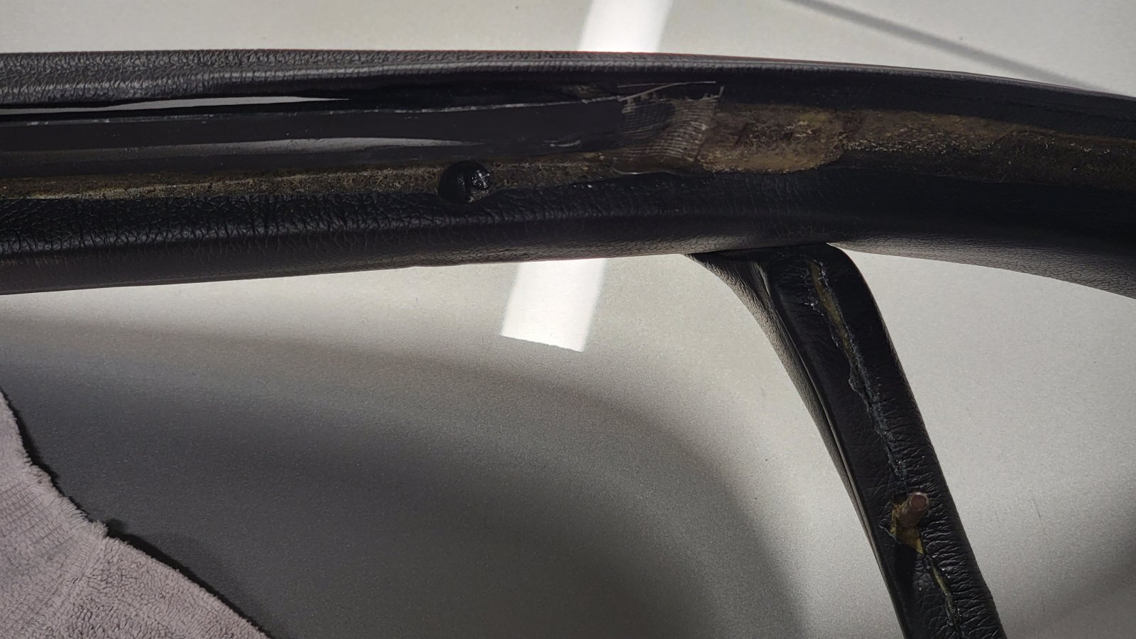

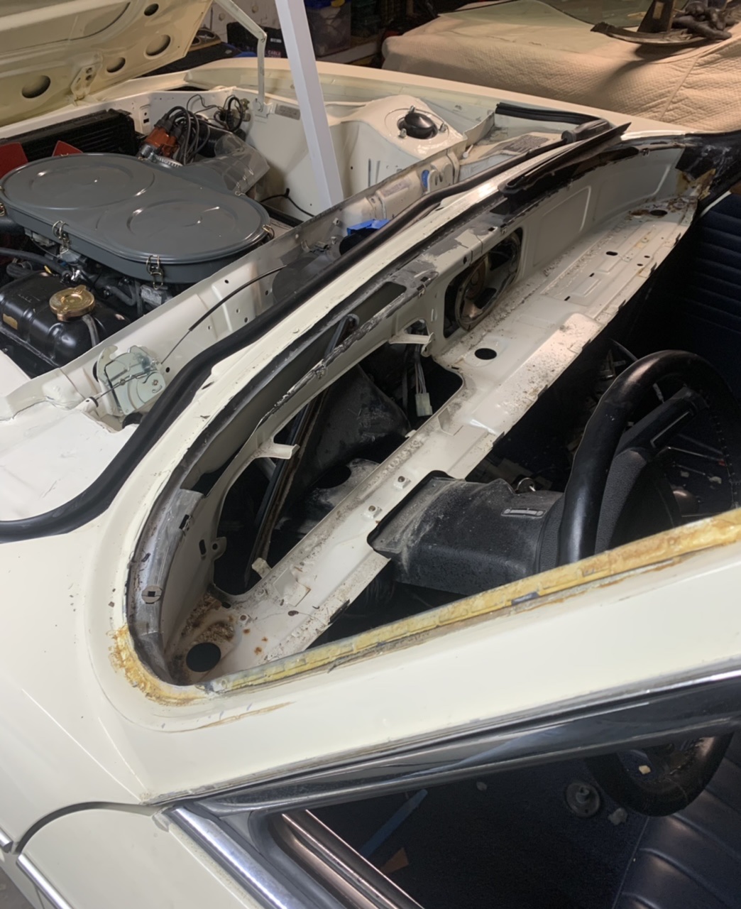

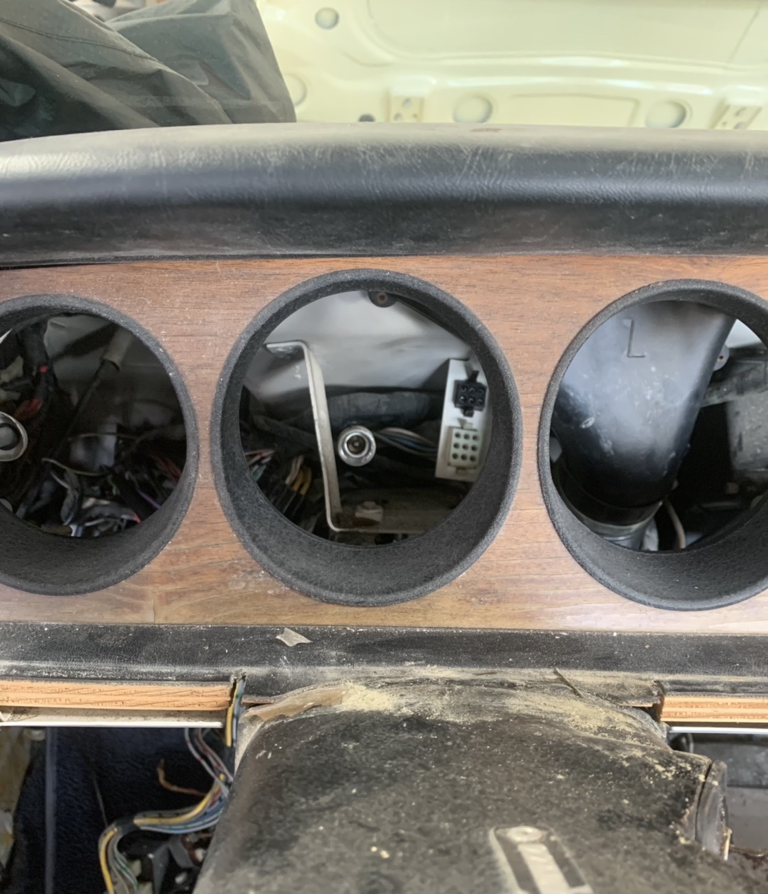

Anytime I tackle a routine project I proclaim it to be the worst task ever. I thought the a/c box would be one of those but as I did it years ago on the Malaga coupe it wasn’t so bad. The instruments however is always a challenge. Now I forget how to remove the binnacle, two Phillips screws underneath removed, nuts on the long horizontal bolts removed, I seem to remember it being attached to the upper dash, but does it? Grab rail already off.
Hi Chris

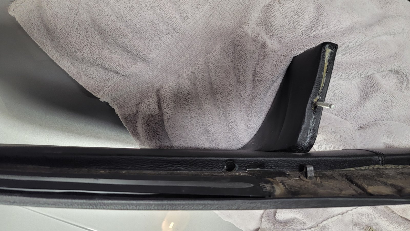

I am not sure the LHD and RHD dashboard is the same but maybe have a look at my one .
Yes Chris. Two Phillips screws from back edge of dash pad attach the binnacle cover to the dash pad. But with the grab bar off you can pull the wood instrument cluster out from the front without unclipping the dash pad.

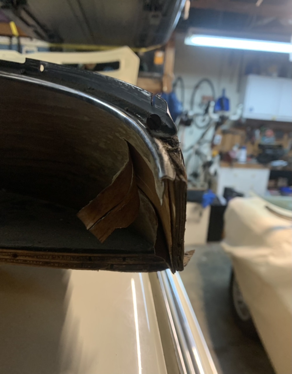

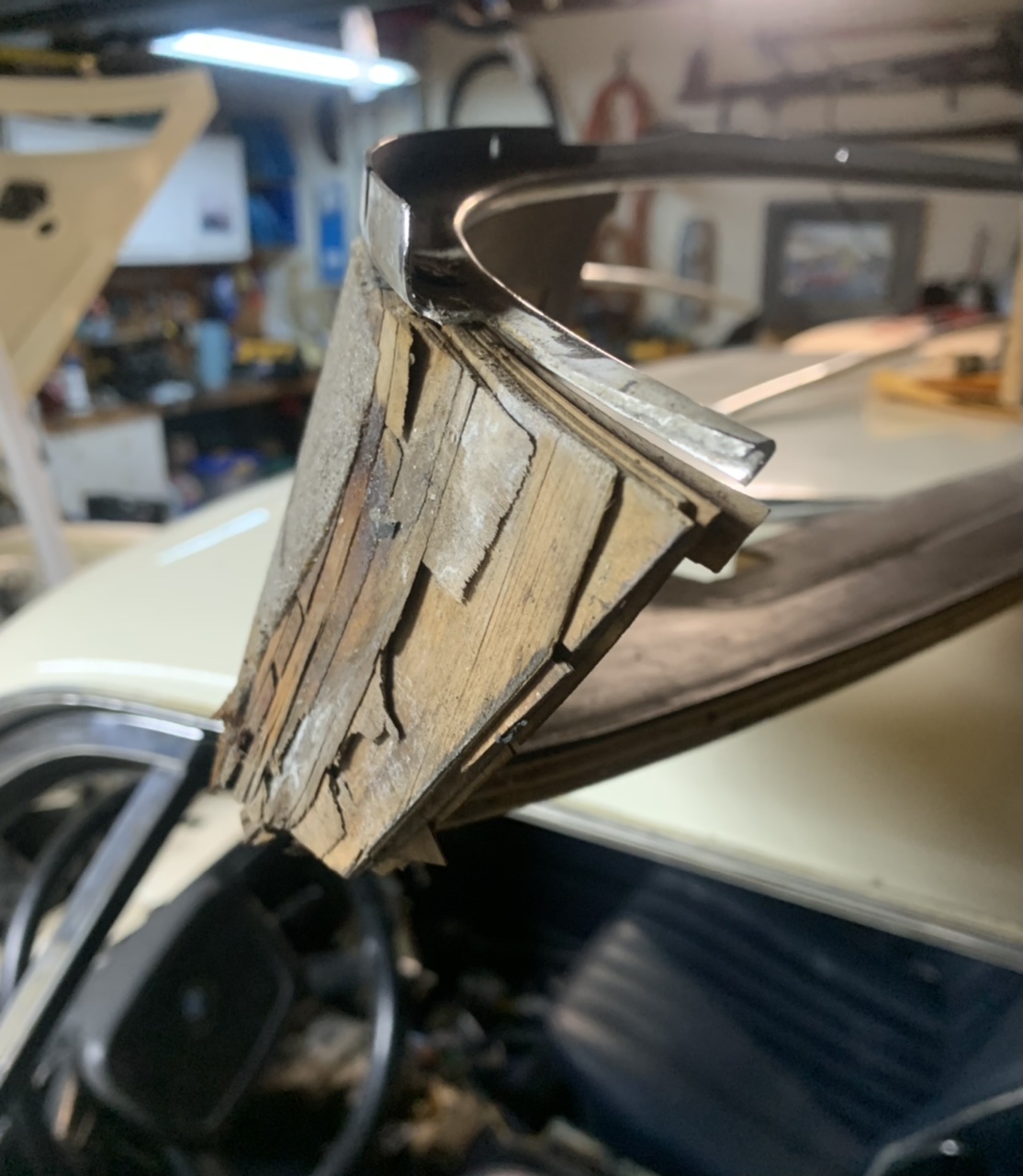

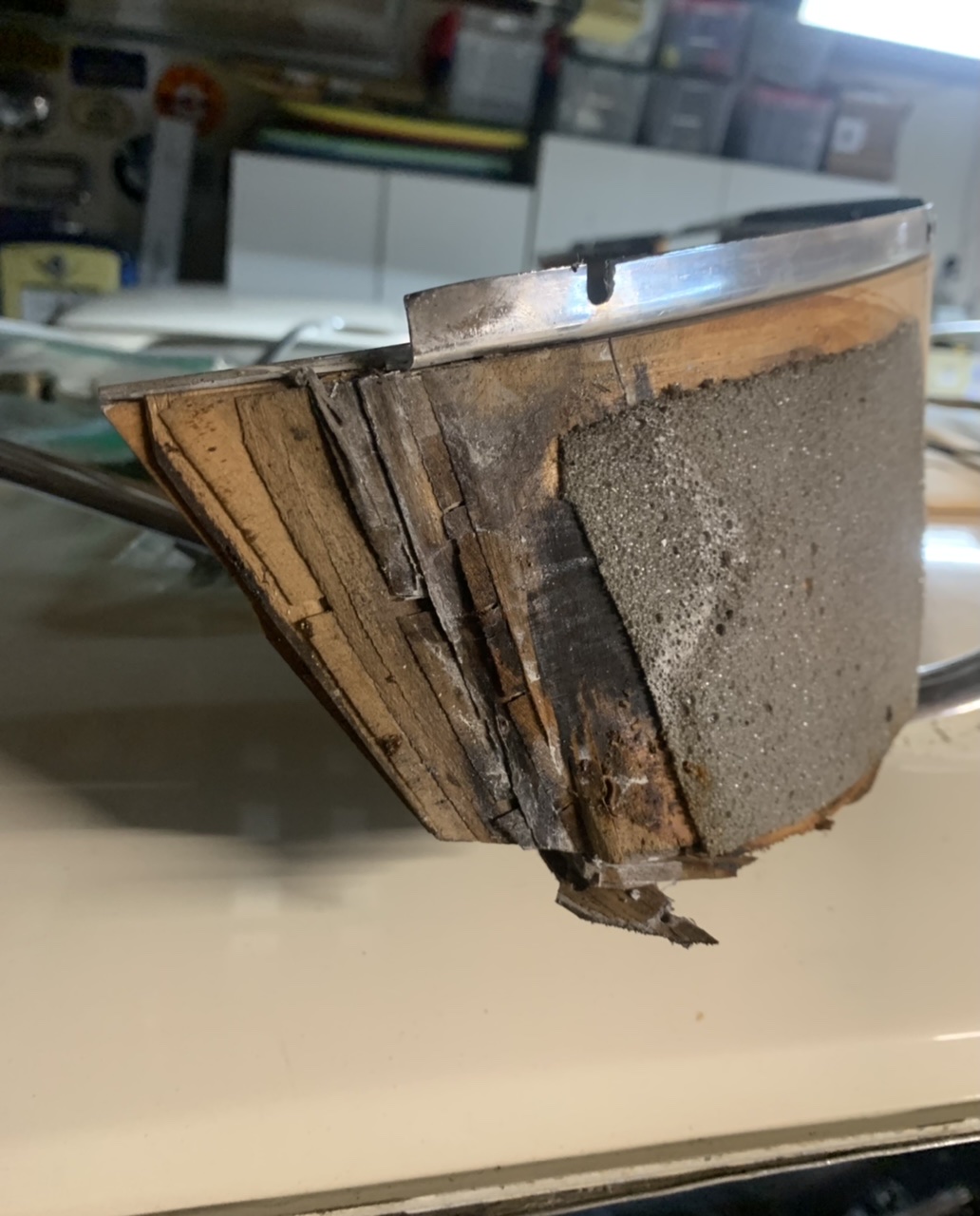

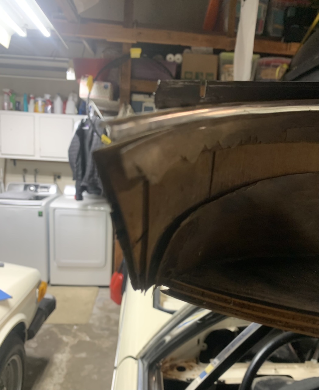

Yep the binnacle is held by two horizontal screws recessed in the binnacle and must come off with the upper dash. Not bad for a day’s work. Q: is this wood too far gone to be veneered?
