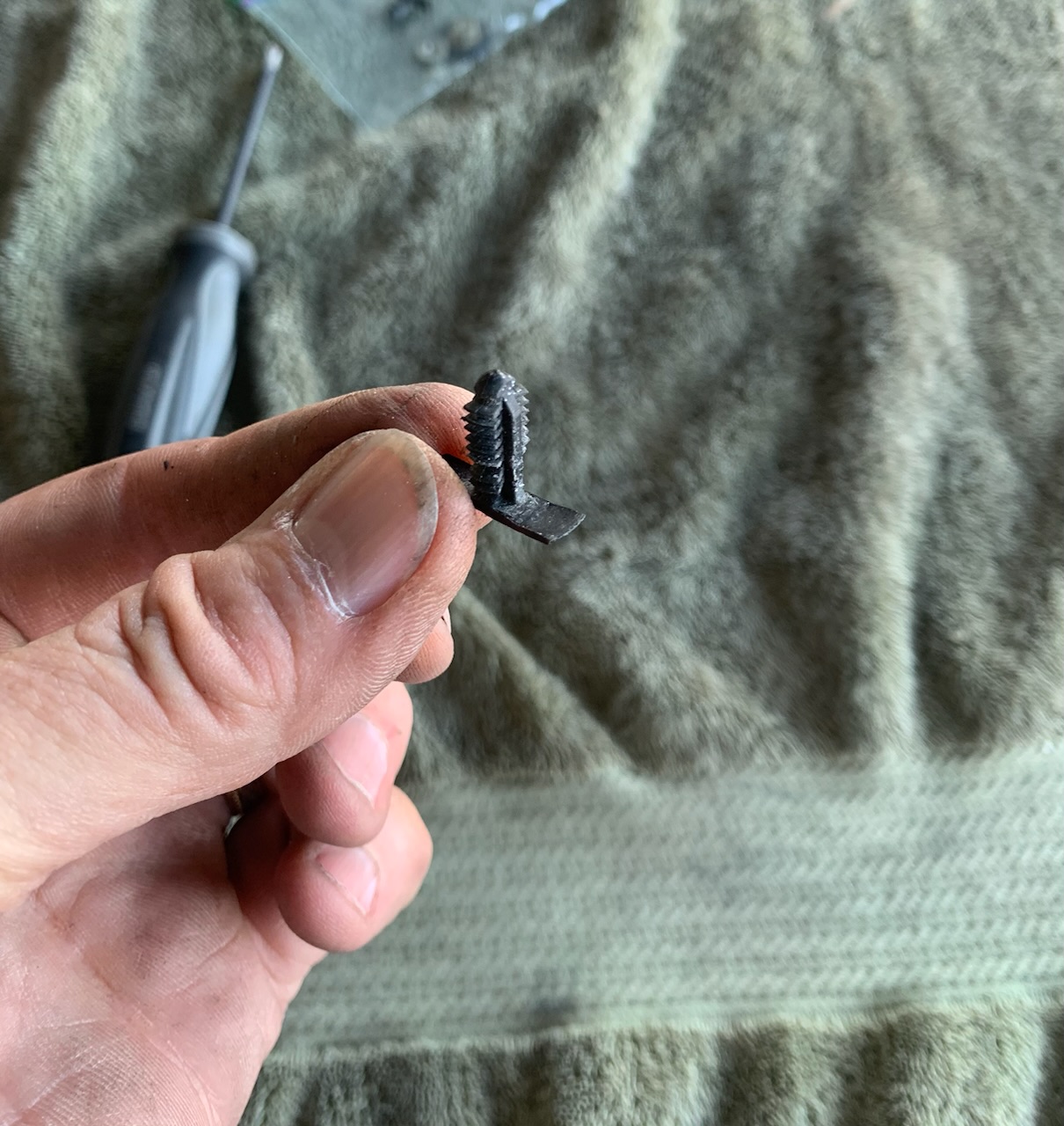

I am stripping off all trim to prepare for paint. Check out these thingies holding on some of the trim. Innovative maybe, cheap and frustrating.

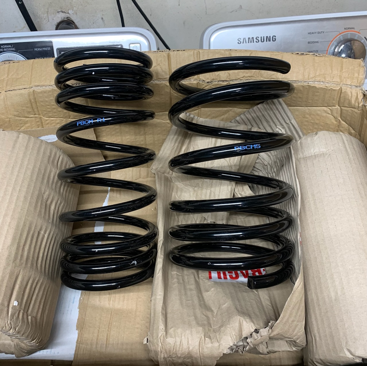

Are the spring rates and height posted somewhere and a comparison to others? I did a quick search and could not find data. I gather the spring rate is variable based on coil set up.
Spring rates are not posted anywhere, and Paul is keeping them to himself:
Here's yet another thing I didn't know about until now. With a set of Carl Nelson lower springs sitting on the shelf, is there a comparison (commentary or pictorial) anywhere of the two?
I bought a set from Paul too. I have wanted progressive springs for a while, there are not a lot of options out there, and as Chris notes, reports on these have been quite good.
Send me the height

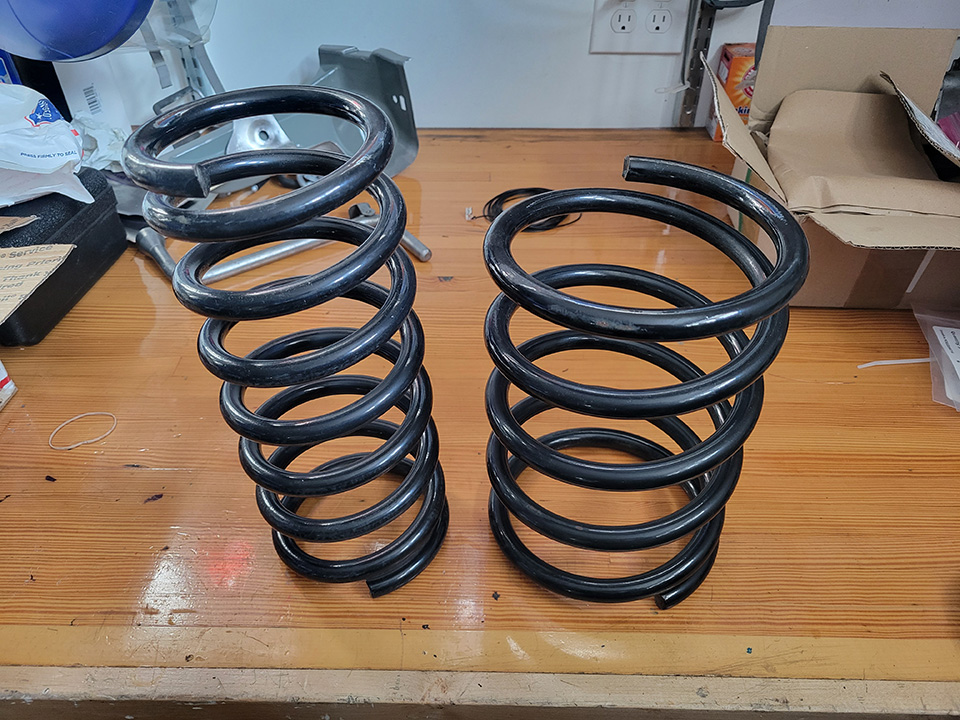

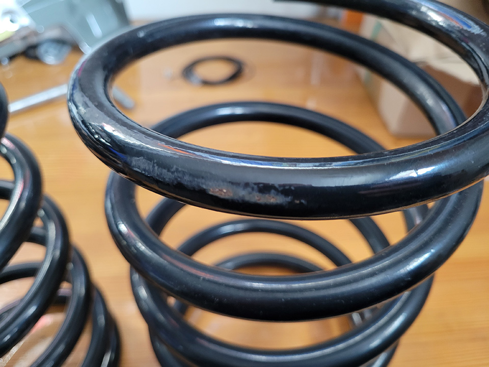

Sorry in advance for side-tracking Chris' thread. Here's probably too much information about a set of Carl Nelson springs I purchased two or three years ago. I bought these while at Carl's shop in La Jolla, but had him ship them to me. They've been in the box he sent them in since. When I opened up the box and pulled the springs out today, I was sad to see that there is some abrasion on at least one of the springs and it has rusted. I doubt this could happen while living in my garage - I keep the humidity below 20% year 'round. This is evidenced by the bare metal chassis that lives in the same space and doesn't rust.

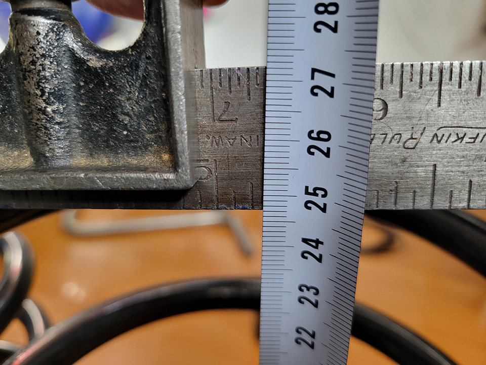

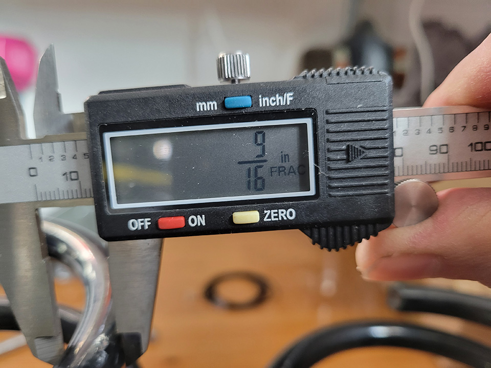

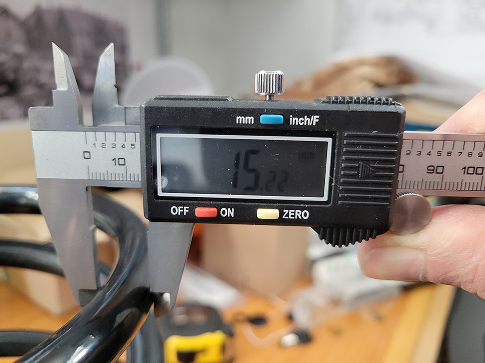

As for evaluating what the ride height might be with these springs installed on a car, I suspect there are aspects of the metallurgy and tempering that affect the outcome. But here are some basic measurements of the springs unloaded/relaxed for comparison sake.
Front Springs = about 5.4 coils:

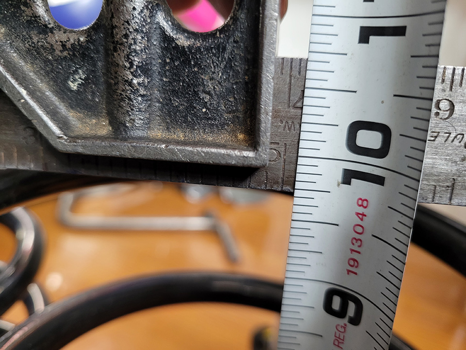

Height = 9 11/16" or 247mm:

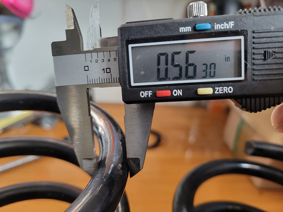

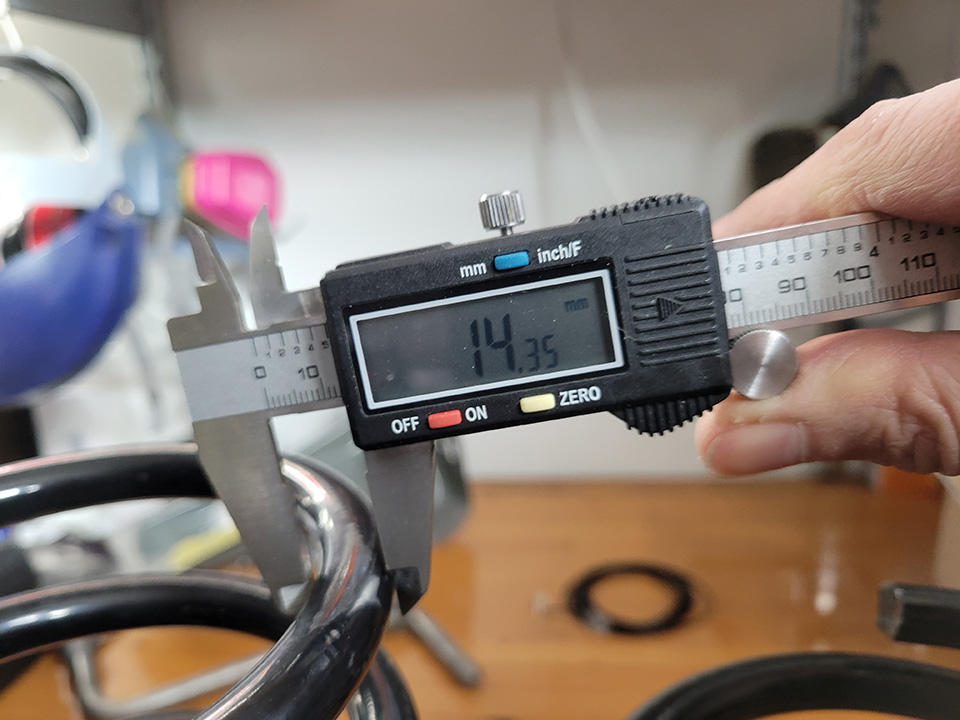

Diameter of coils including the powder coat/paint finish (metric, fraction, and decimal):
Rear Springs - about 7.8 coils:
Height = 11 7/8" or 301mm:

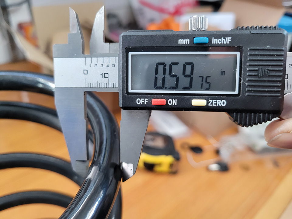

I’m not sure it’s a fair comparison out of the car as Carl’s springs are linear rate springs and Paul’s are progressive. The latter would generally ride better with two different spring rates all else being equal. What we don’t know is at ride height the compression and how many of the lower rate coils bind. I have to say I’m pretty interested to see how they are.
