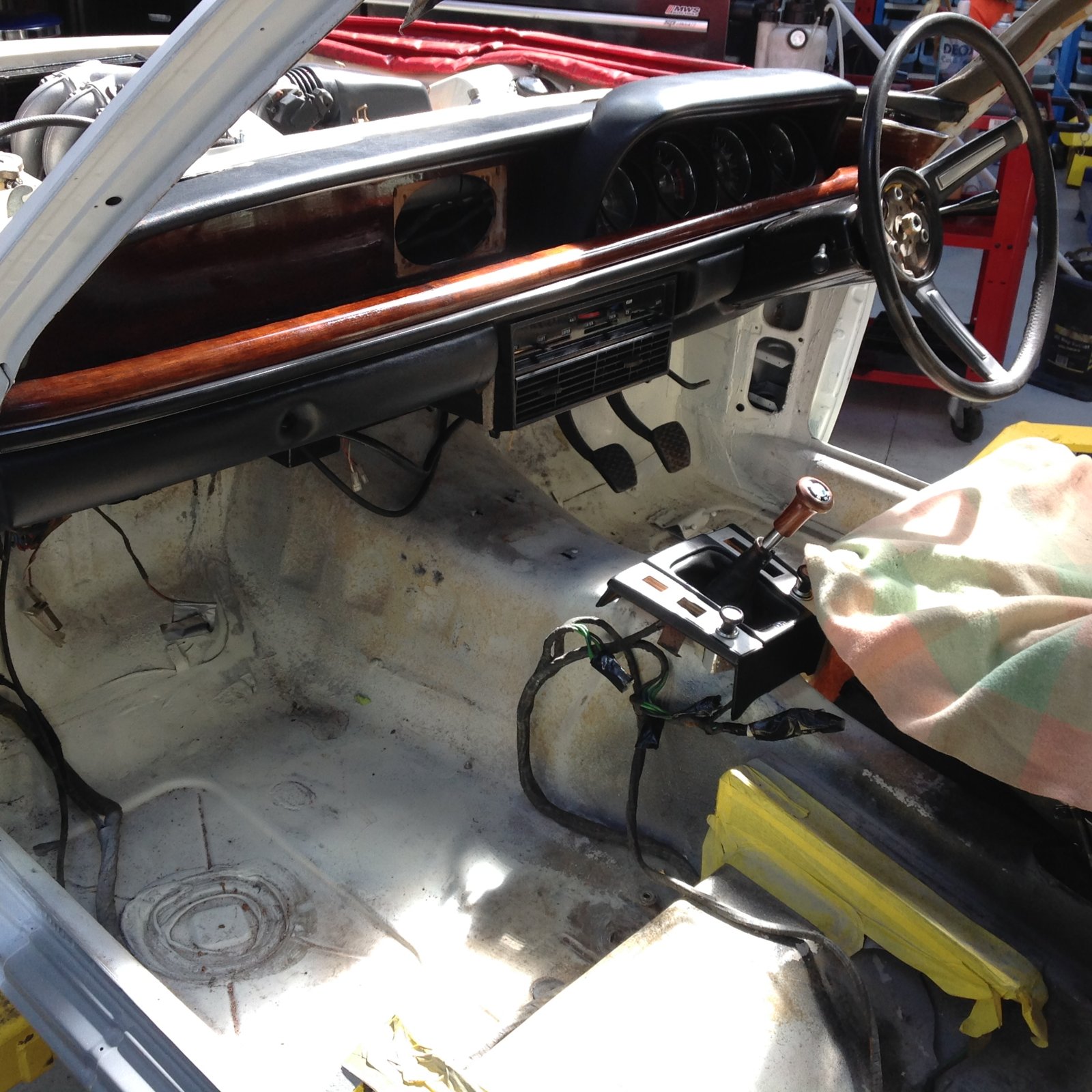

Have finished all of the major mechanical work and re-installed the dash and heater components.
Car starts and runs well but still need to diagnose the occasional lazy miss we can still hear.
All it can be is either an issue with the spark leads or a sticking injector as we have been through everything else.
Will re-visit that one when we do final tuning as will need to pull out the throttle valve to get get back in to adjust the tappets. Plan to replace all the terminals and potentially send the injectors off for testing.
The car will now sit for a week or so before back to the body shop for its final paint. Fast running out of time this year but all going well the aim is to have paint complete by the end of the year.

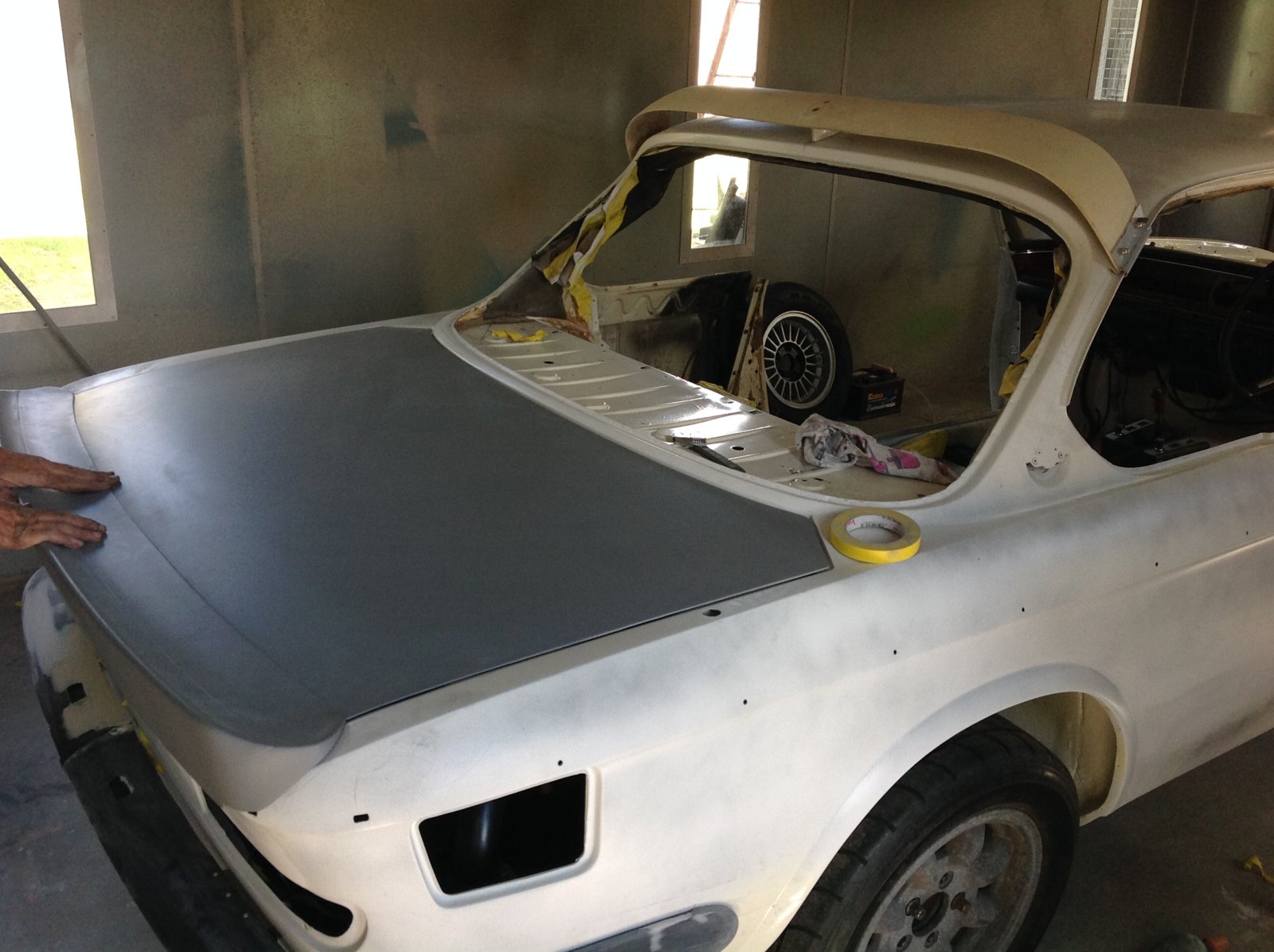

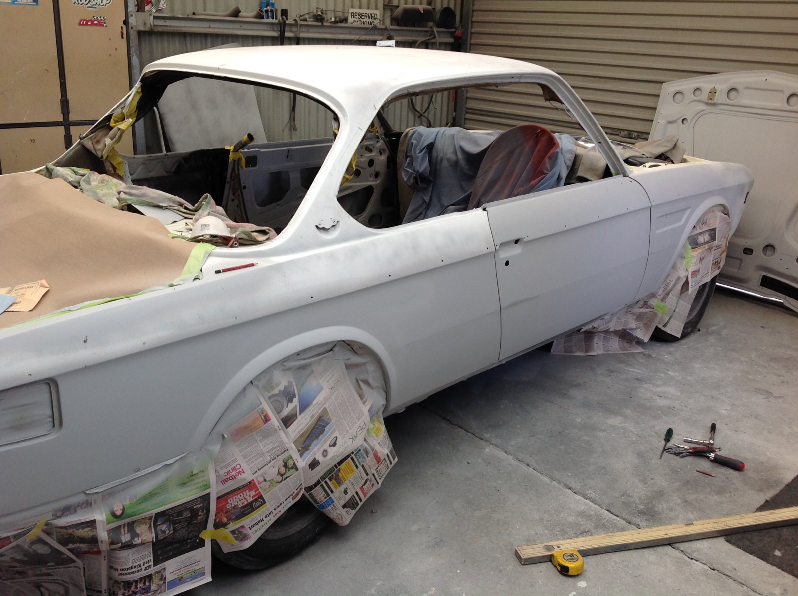

As you can see we have test fitted the boot, roof hoop rear spoiler and all of the other hanging panels.
It's really coming together well but to my thinking there seems to be a little too much overhang for the duck tail spoiler. It's from Zaprace and the fitment is excellent but it seems to overhang the boot lid a little more than it should. The overhang isn't uniform either with the maximum overhang at the centre line of the car. I know there are threads on here that I haven't run down yet. Any ideas guys?
Hi Wes,
My duck tail which I just put on recently is an original CSL one. It also has a bit of an overhang and slightly more-so in the centre area @ about 5mm. That's the way many are, as far as I can ascertain. I think they were designed with slight overhang otherwise if they were flush when you slam the boot the fiber-glass could shatter (or I could be giving the designers too much credit and it could just be typical near enough, is good enough, 1970's hand made body panel manufacturing)

Hi Wes,
That's the thread I was thinking of mate. Mine actually seems to also come down too low. As in when the boot is shut the leading edge of the spoiler comes down to a point where it sits over the rear of the car - meaning its come past the edge of the boot lid and the rubber seal. I may not be making sense so will get some pics next time.
It shouldn’t hang down lower than the bottom edge of the boot lit. Mine sits level, but just sits about 5mm proud due to the thickness of the fibreglass and brackets.
I got mine from Zaprace also and had to scribe the ends to fit over the rear wing panel so that it eliminated the overhang at the rear. Then I had to fill the bottom of the ends of the spoiler as you could see a hole when the boot lid was up, looks OK now but if I was doing it again I would try to find the spoiler that stops at the uprights for the bat spoiler like in the attached photographs and does not go over the rear wing panel.

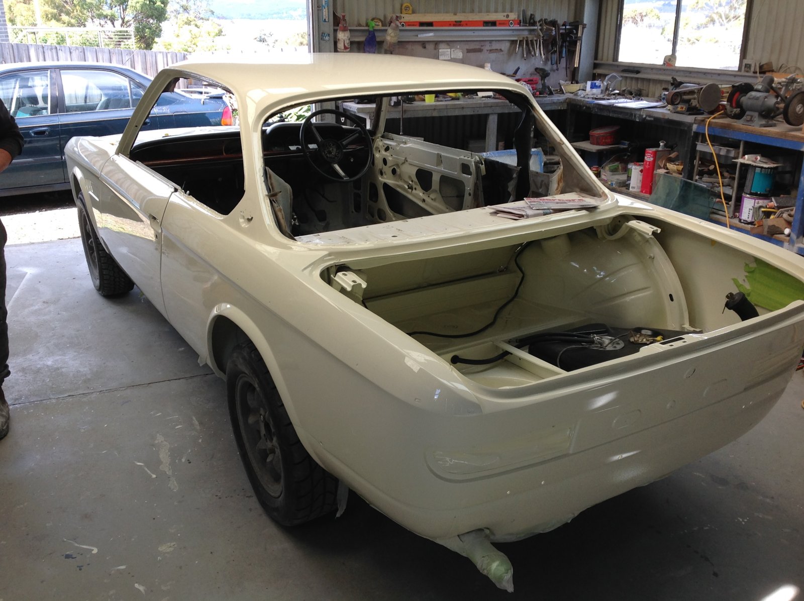

More progress. All of the lower car is now in final paint along with the A & B Pillars. The doors are also finished out.
Have to say I really like the colour.

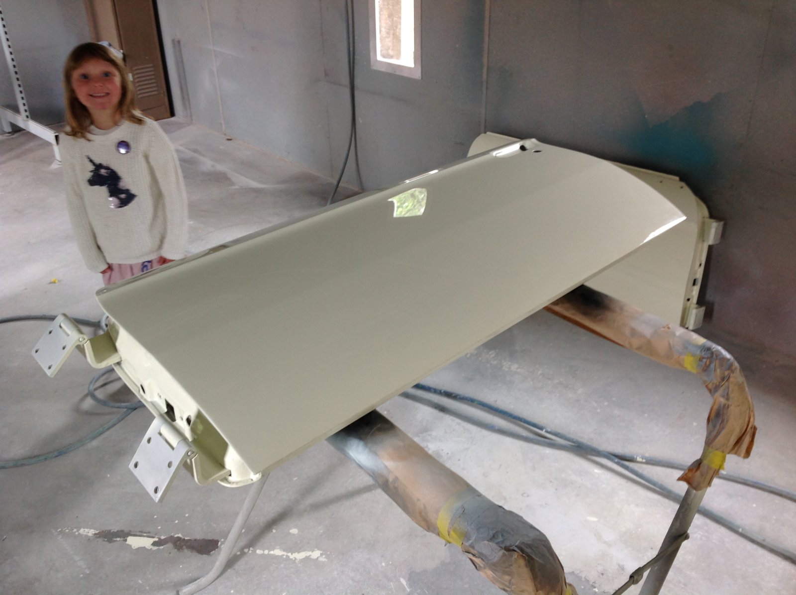

The underside of all the hanging panels are also done.
You can see where we haven't applied new paint to where the hinges seat. The reason for this is the panels still carry the original factory numbers presumably from the production line and I didn't want to lose them. The rest of the car should be in final paint this week. Then we need to do all the detailing and start putting it all back together.

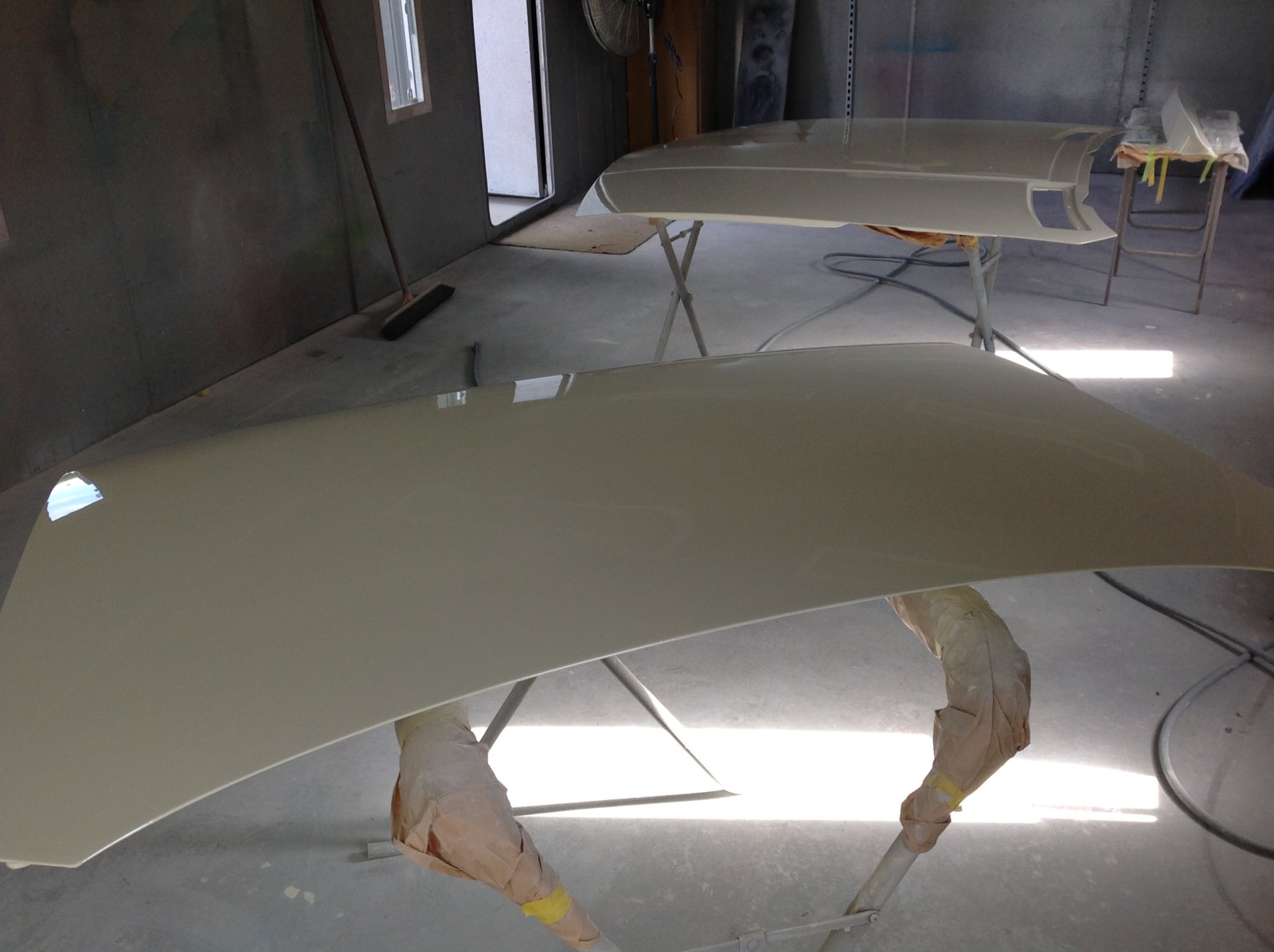

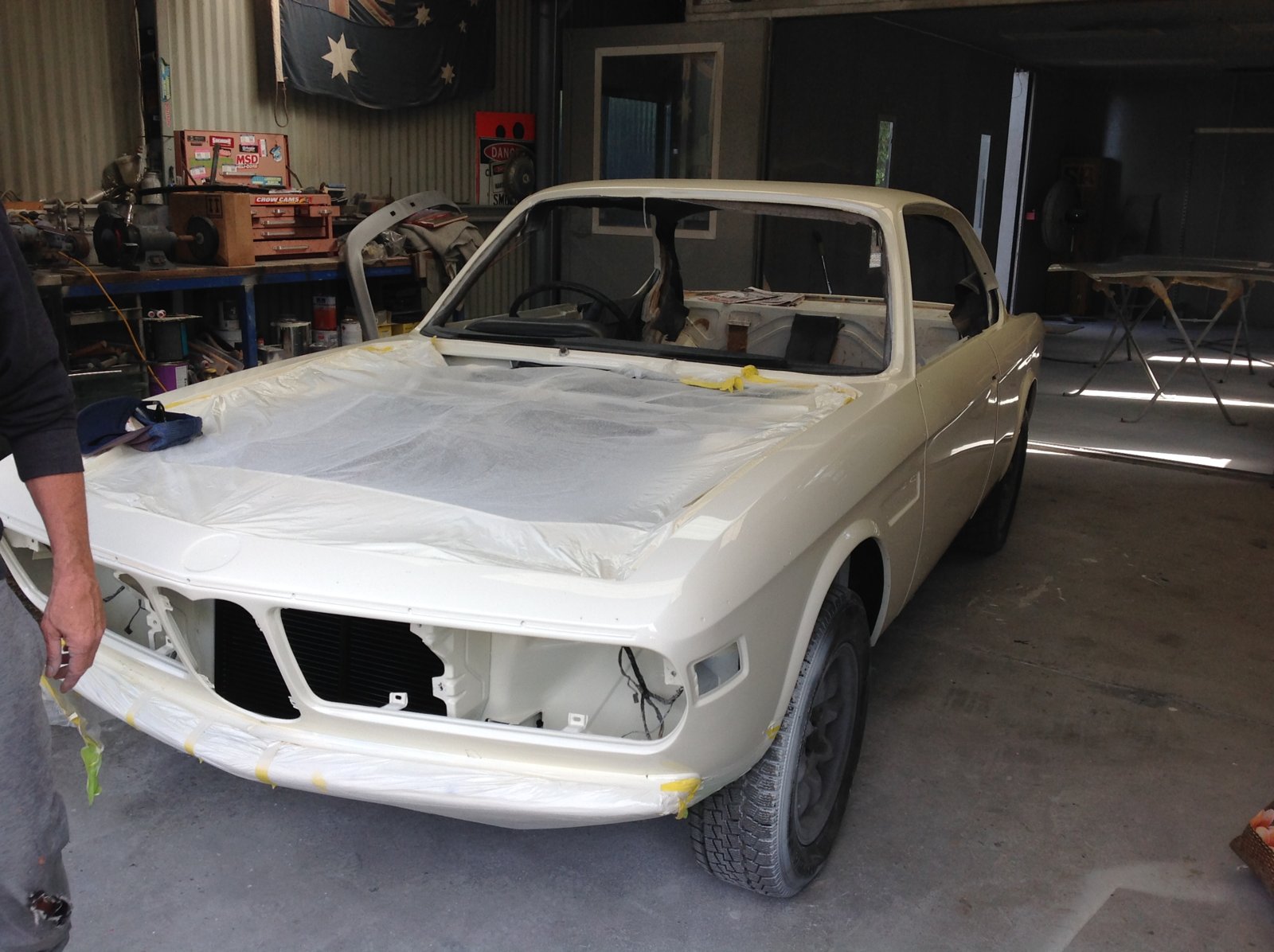

Big milestone this week. The car is painted!
Four coats of factory colour right there.

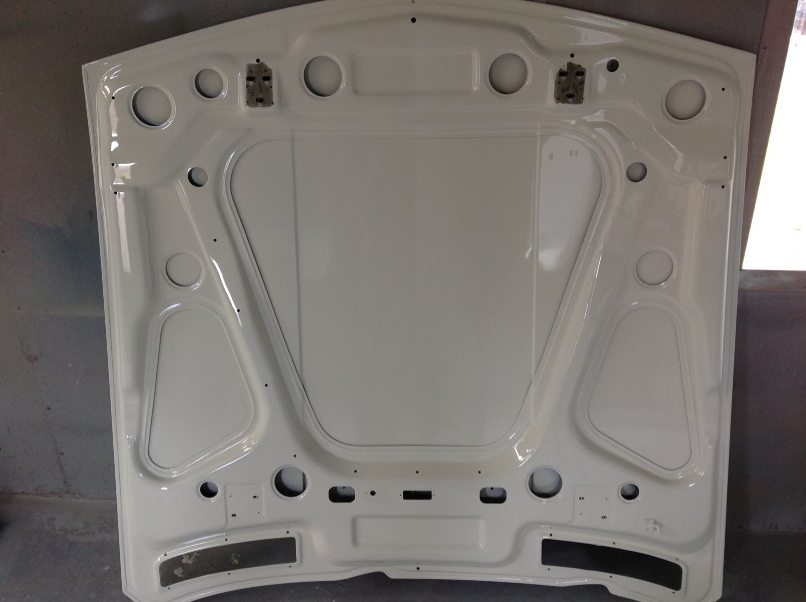

Hanging panels also done.
The next job is to cut and polish the finish to remove dust/dirt that always settles on it after you spray. This should happen in the next few days, we just want to make sure the paint has cured. After that the re-assembly really starts. This should come together fairly quickly as most of the trim has already been restored. There are still a load of small pieces to clean and lots of tricky jobs such as stretching out the headliner again without ripping it.

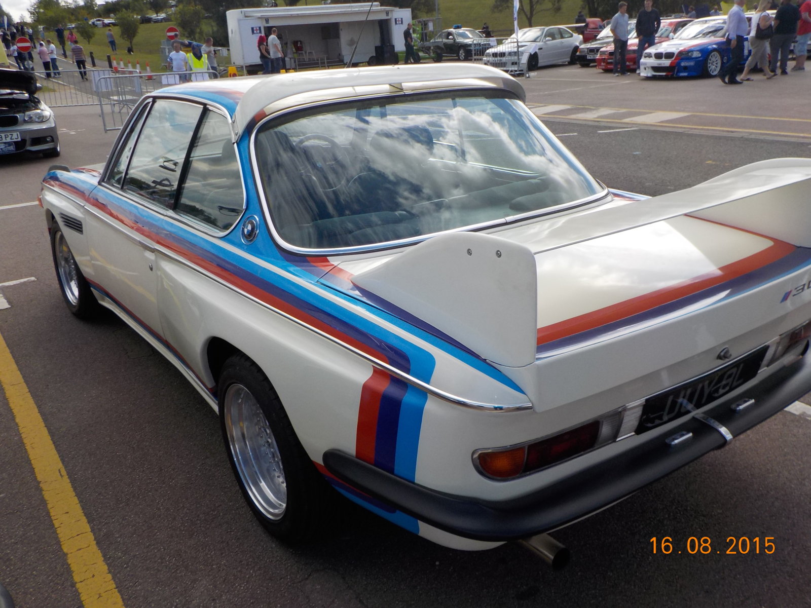

Looks spectacular Wes.
Are you planning on the black CSL side stripes or how about the tri-colour BMW motor sport stripes? Technically the tri colour stripes were only on LH Bats as I know, but for me the blue, purple, red looks great on a Chamonix.

BMW motor sport stripes Mal. They look great and if somebody in the future dislikes them they can be pulled off.
