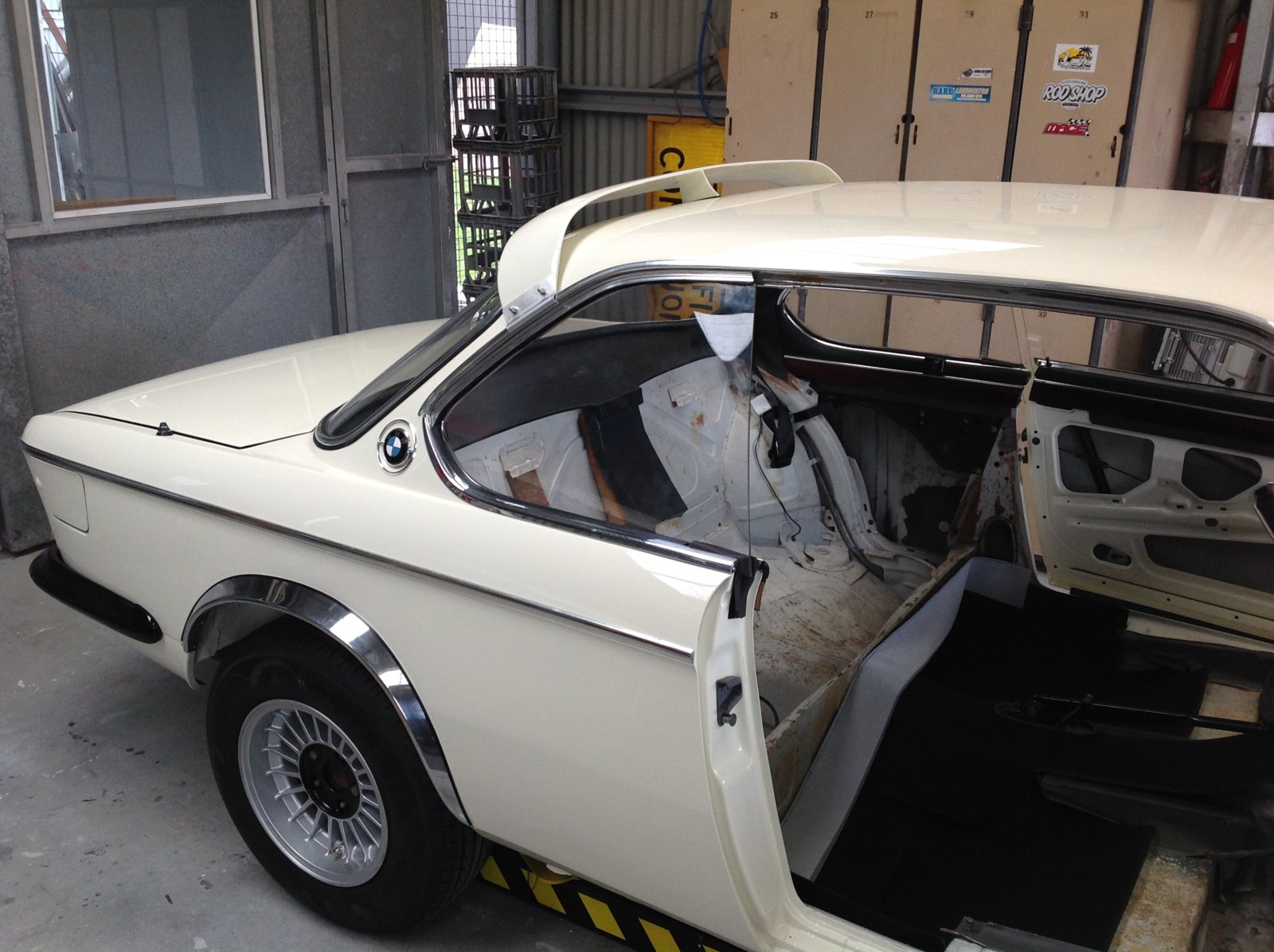

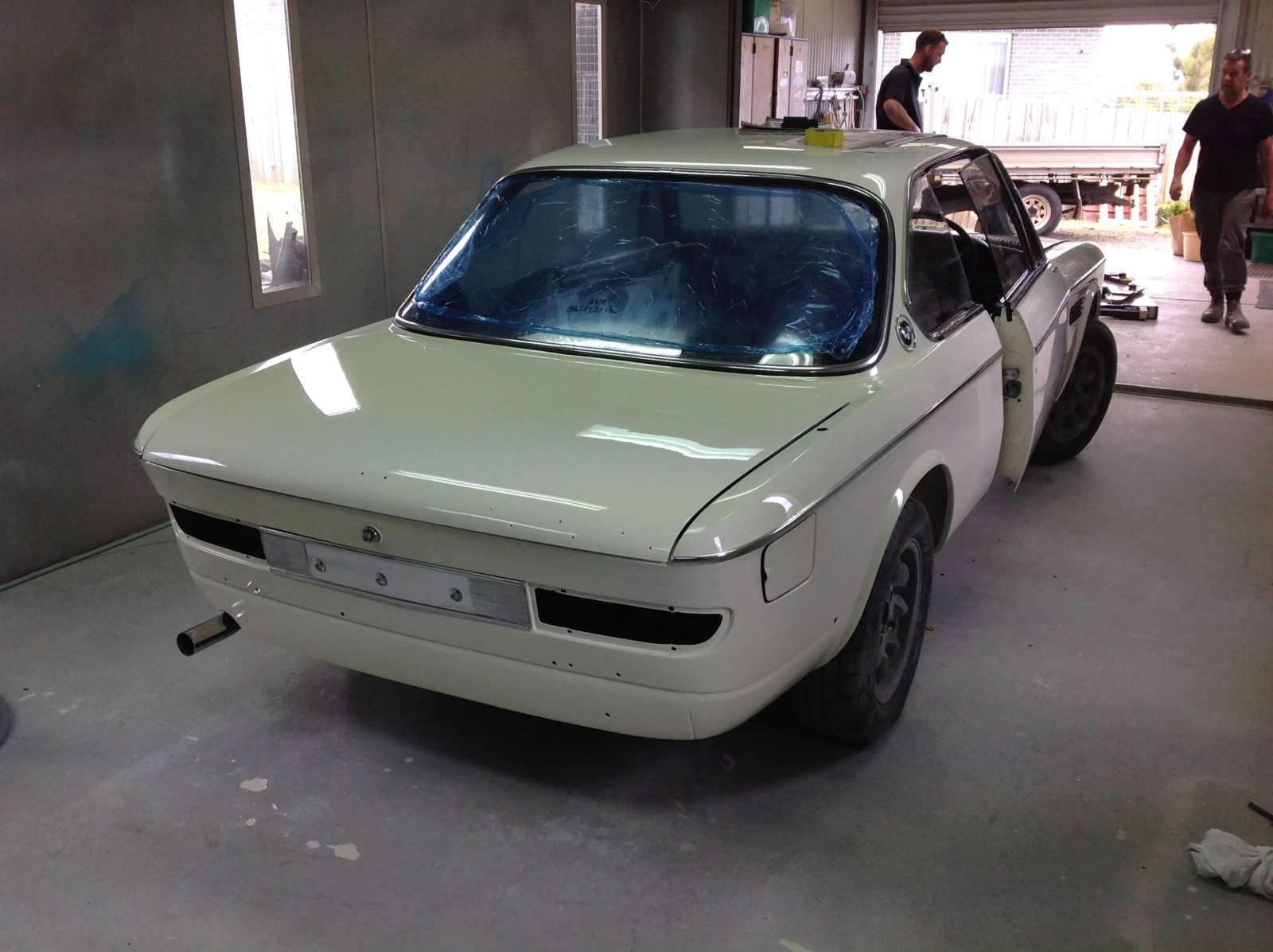

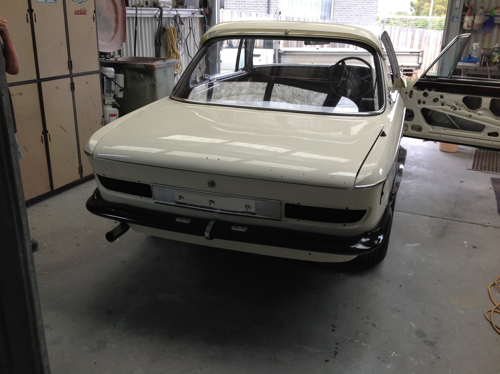

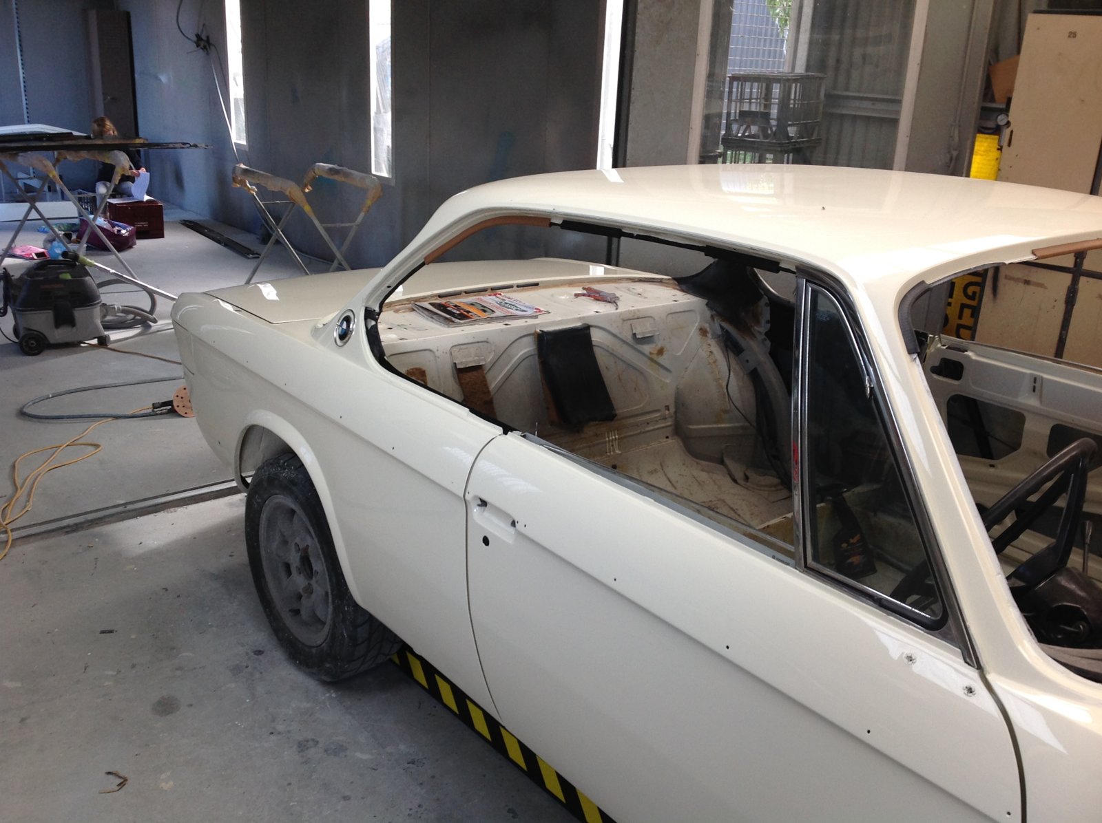

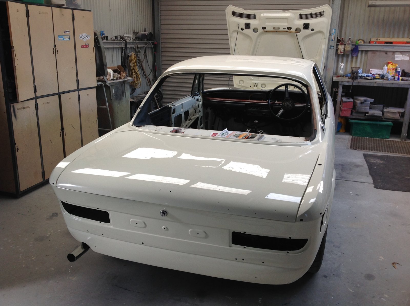

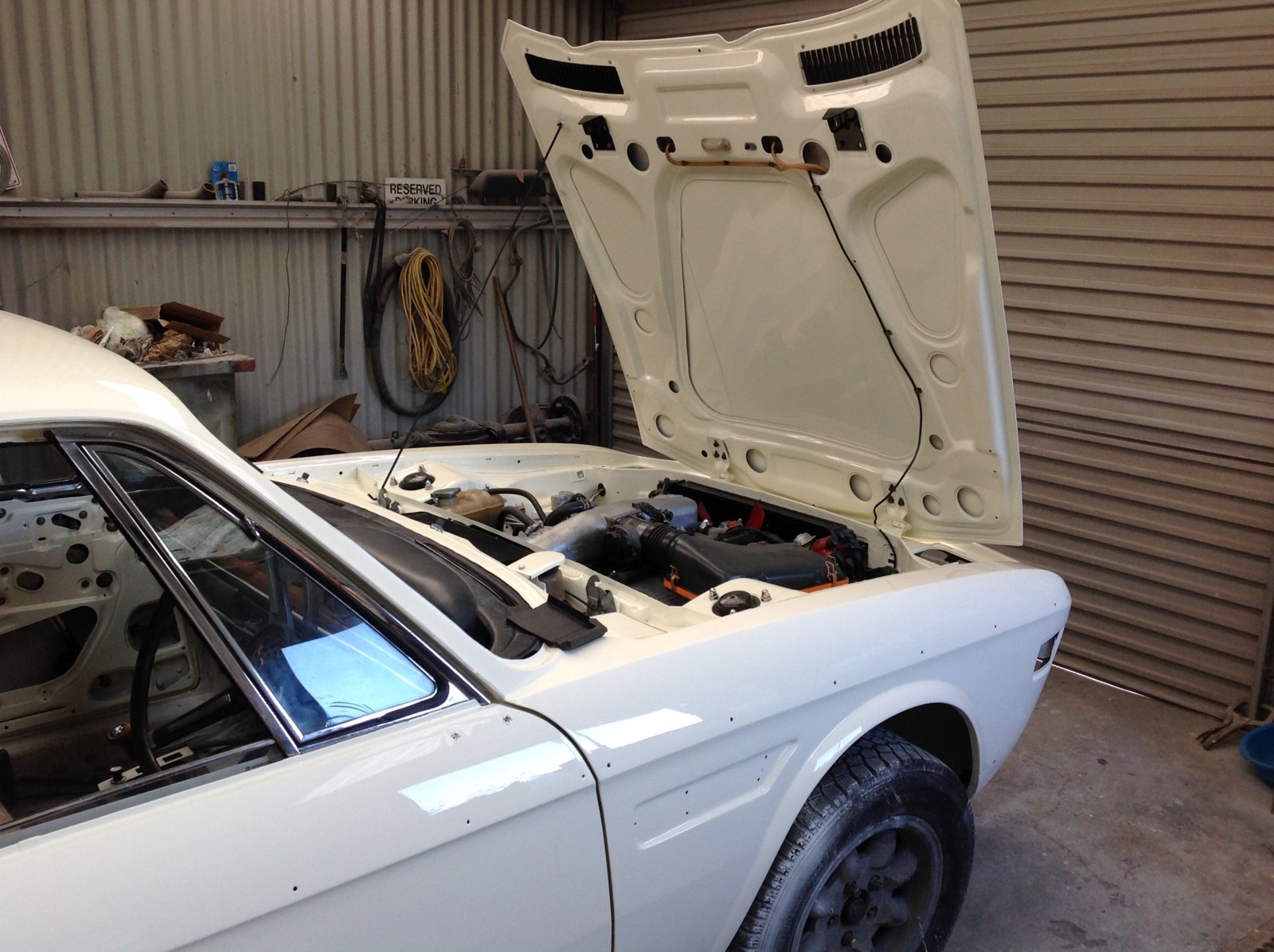

More progress on the car. The bonnet and boot have now been fitted. The window mechanisms are also back in the car. A particularly tricky job was getting the hood lining back in place as it was very dry and had shrunk roughly 2 inches on each side of the car. After a couple of days of misting it down with a mix of water and cabriolet cleaner it stretched out back to where it originally was. Have also trial fitted the rear quarter windows and them seem fine. Still a lot to do but feel like things are coming together fairly quickly now. This week will see the parcel shelf and rear seat belts fitted in order to allow fitting the rear screen. The front screen will also be fitted.
Ideally the belt trim will also go back on this week but can't find the 2 x front fender pieces for the life of me. I know they came off the car so must be in the shed somewhere. How do you misplace something so big...

Looking great Wes. Did you decide with or without the rear CSL small boot spoiler?
(They are a PIA getting them to fit neatly)

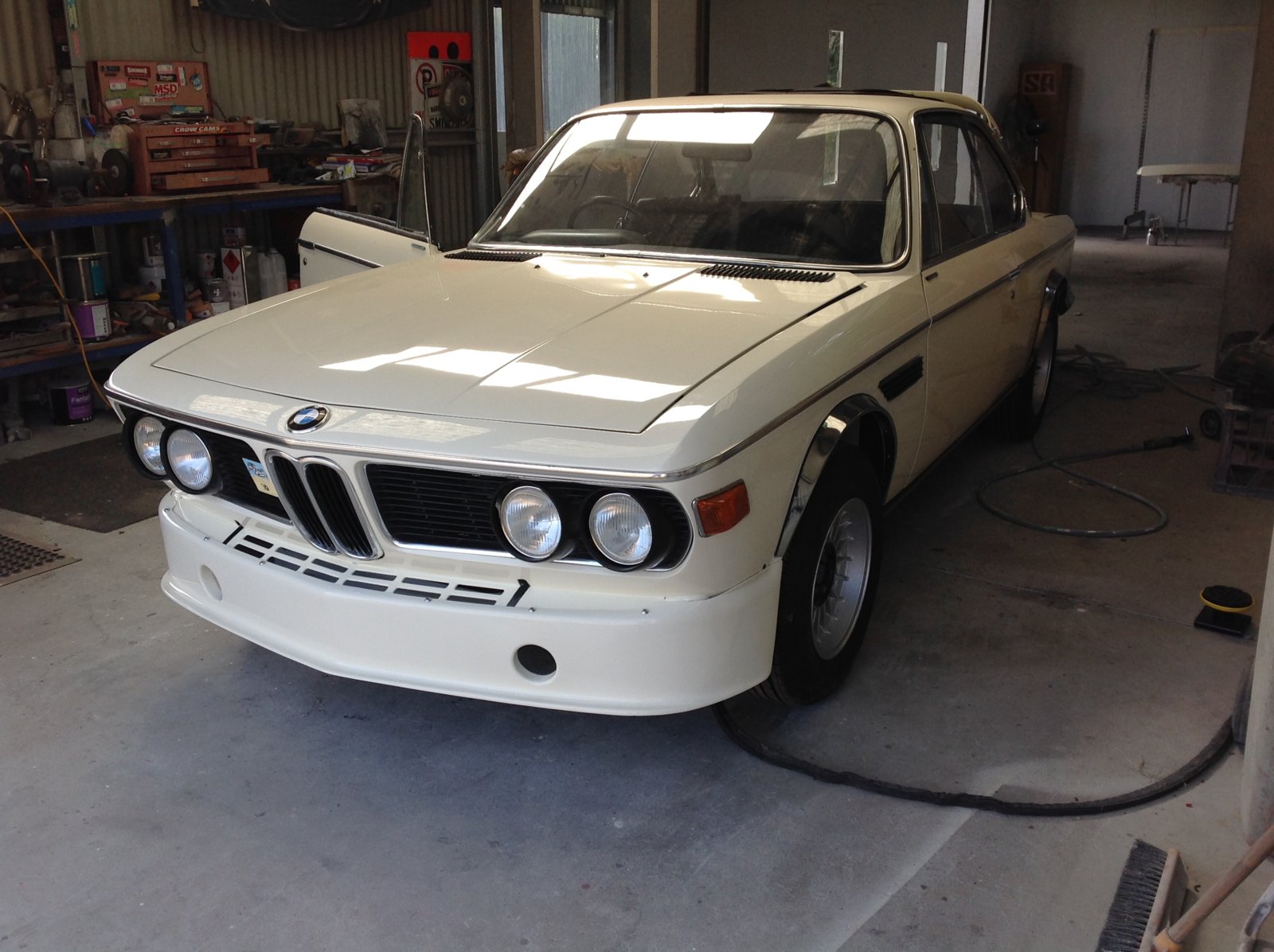

More progress this week.
Both the front and rear screens are in after some jiggling and holding your mouth just the right way.
The rear screen and quarter windows are perspex as it should have been in the Limeys hadn't messed with it.
The door windows are glass but have installed manual regulators for the same reason.
Also found the missing belt trim - it was where I left it 18 months ago....
The remainder of the external trim will go on after hopefully my last W&N order arrives.
This week the aim is to finish installing the second rear quarter window, mount front seat belts - this requires some messing around on account of the fixed windows.
Other jobs that can also now occur include roof hoop, carpet, rear seats and bonnet rubbers (when they arrive.
Then we turn our attention to finishing the rear bumper, outer sill covers, door trims etc.
Aim is to be on the road prior to April 24..

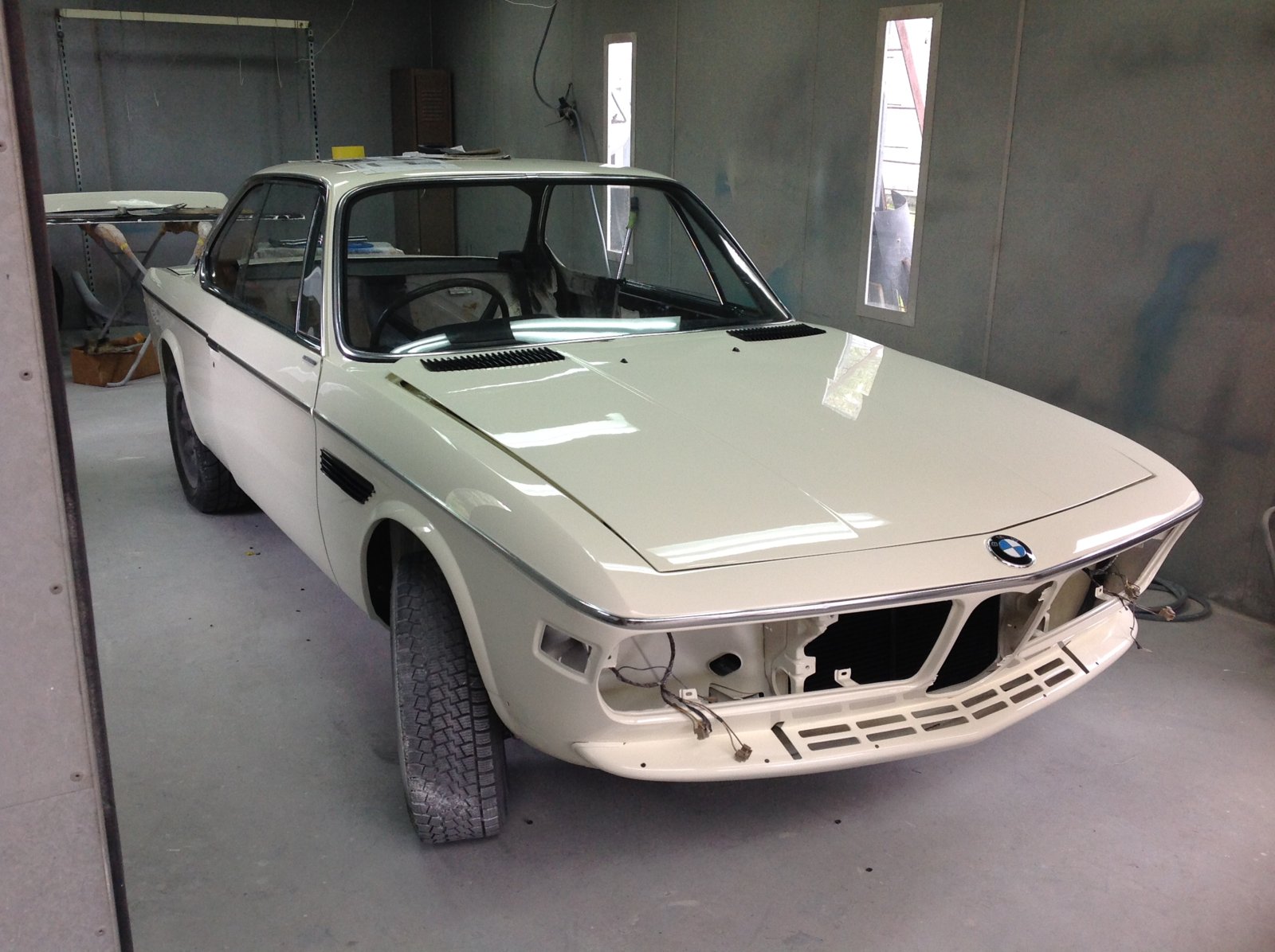

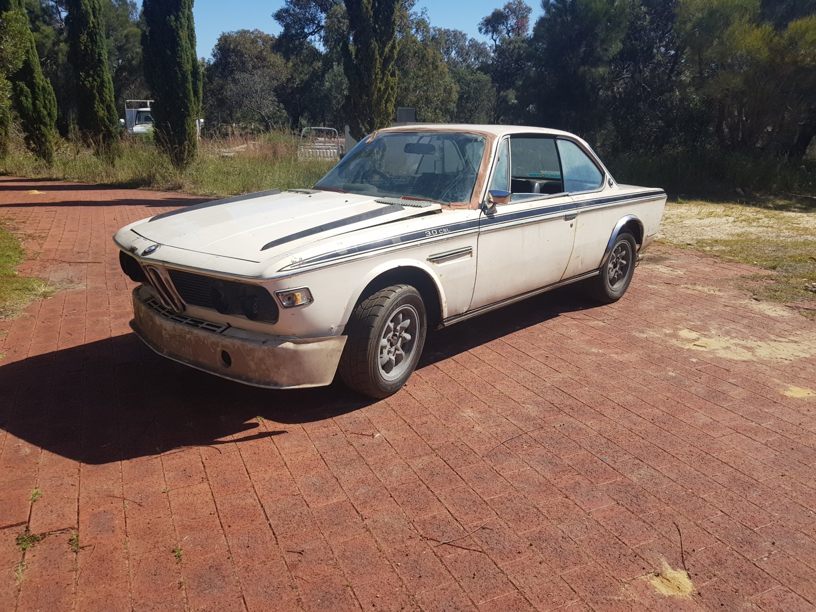

For comparison:
And again:

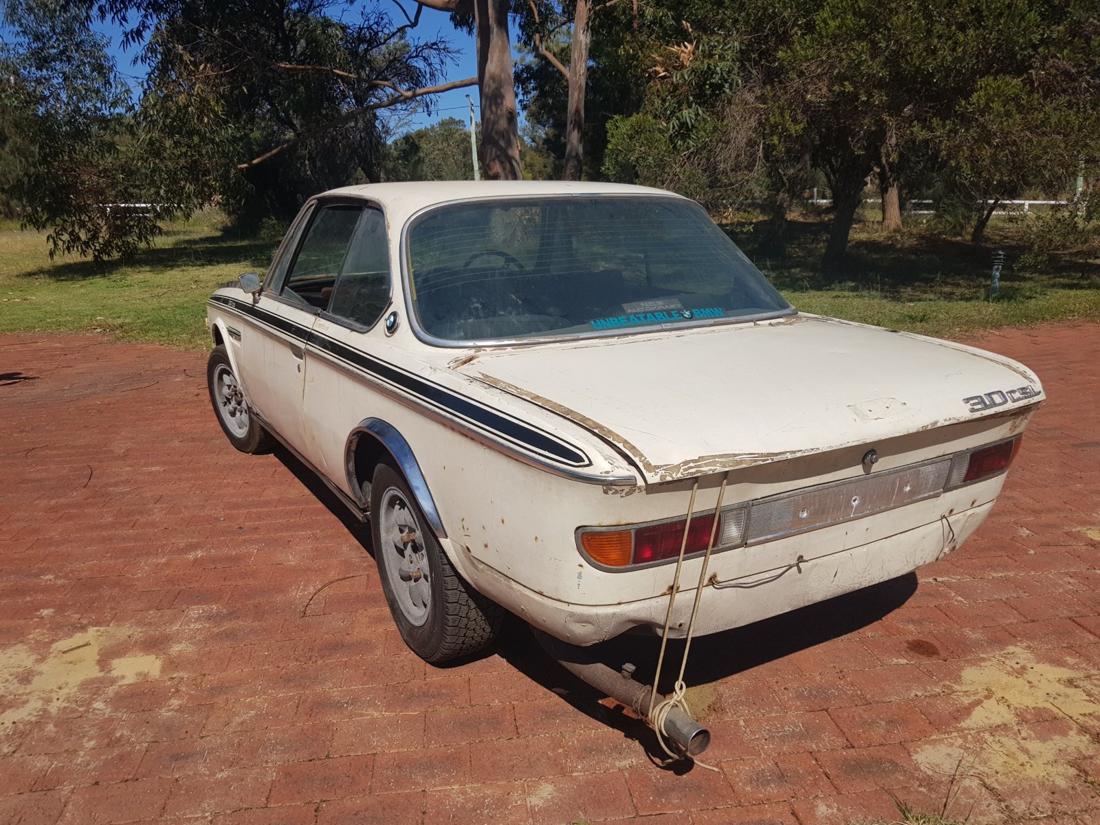

Note the exhaust...
Wonderful stuff for the Unbeatable BMW!

Air dam installed - tick..
@BBOY that's your nose trim and CSL arches. Before anybody asks they are the proper BMW ones as have the original stickers on the back and the sharp edges.

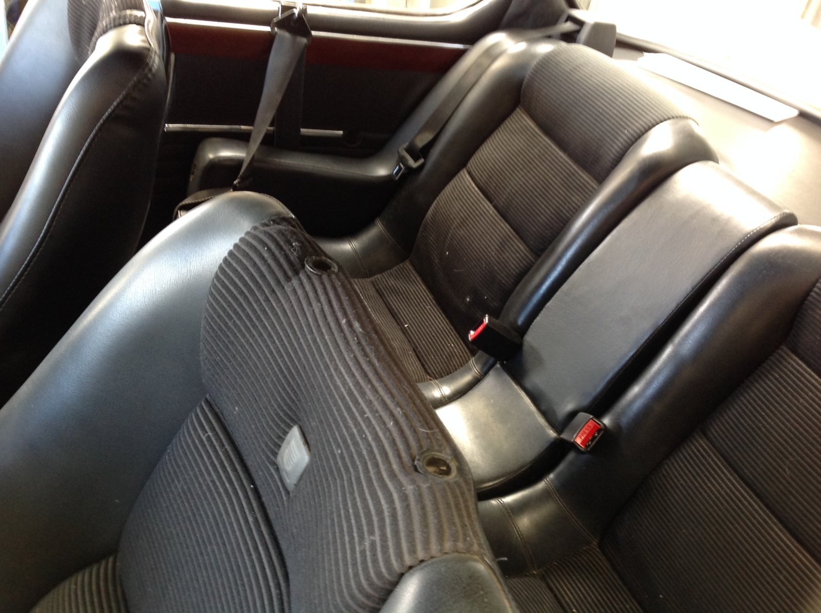

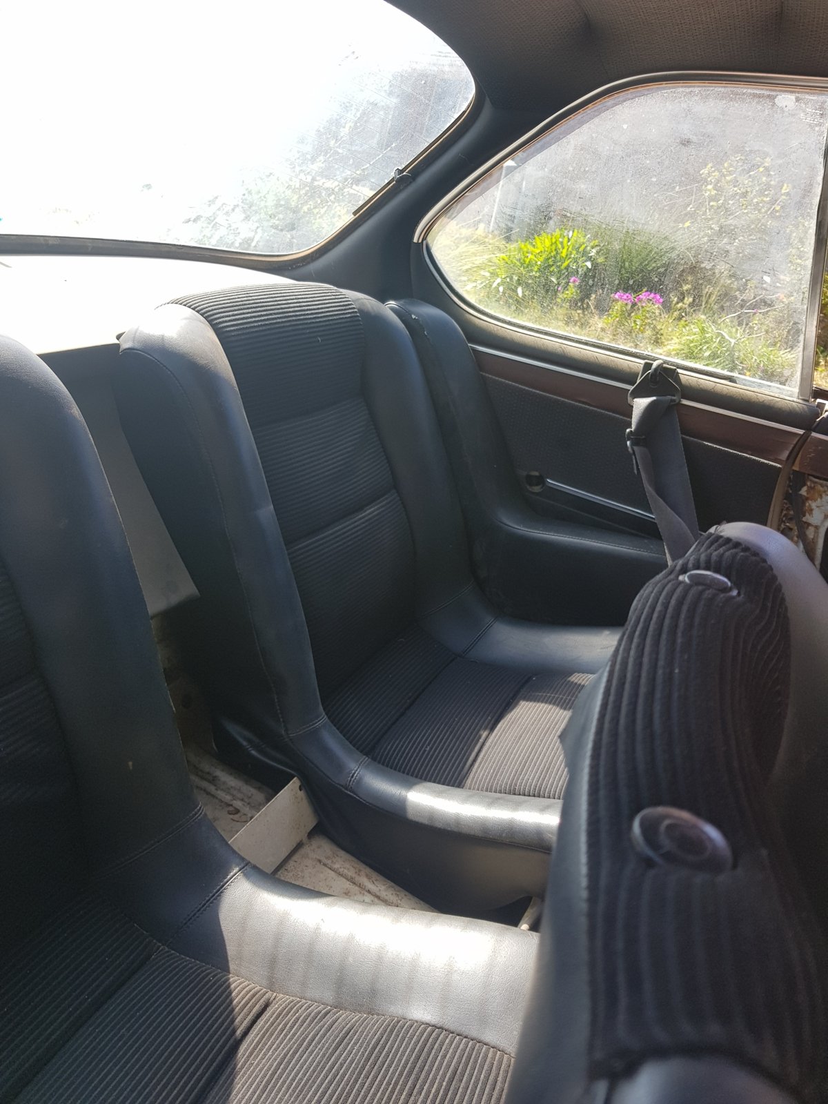

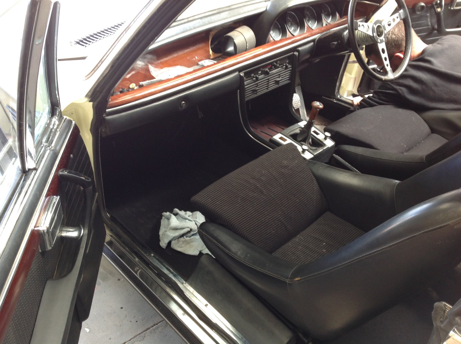

Other jobs completed included fitting the seat belts along with the inside trim below the rear quarter panel windows. Anybody know what the large hole in the card are for? The parts book doesn't show anything fitting inside. Have seen another CSL with rubber grommets.

Back seat is basically complete.
And before:

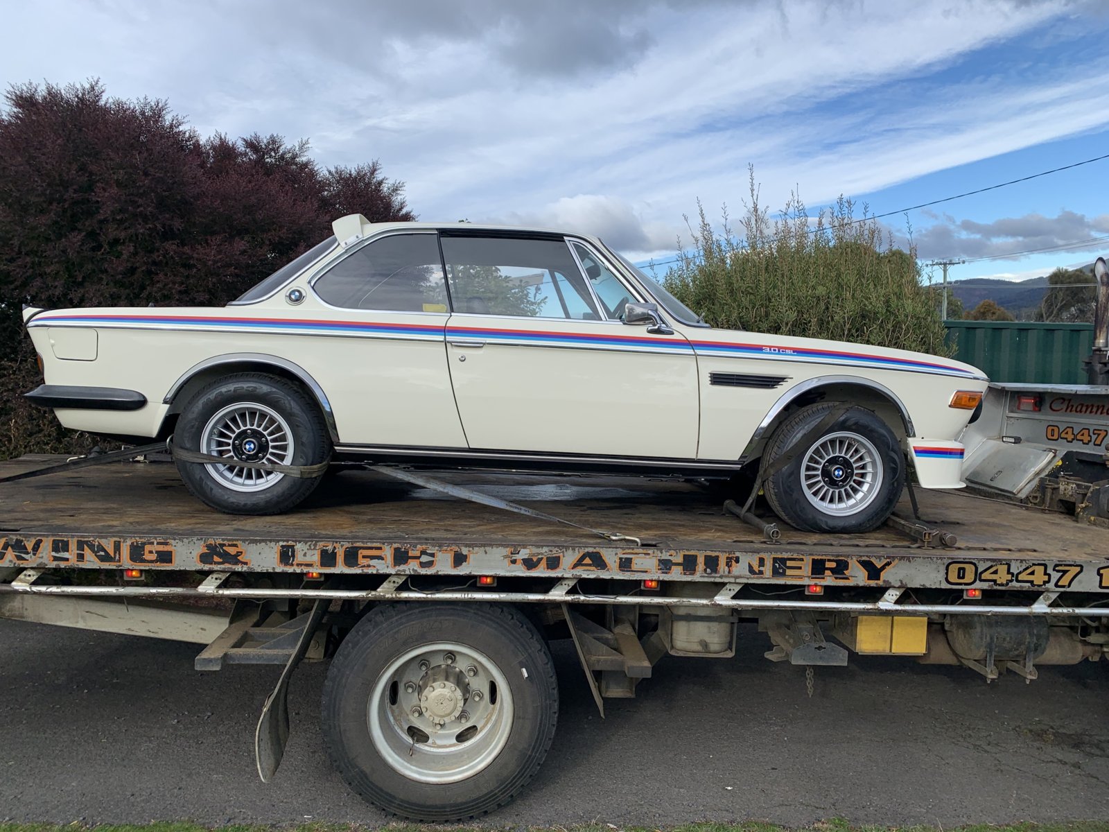

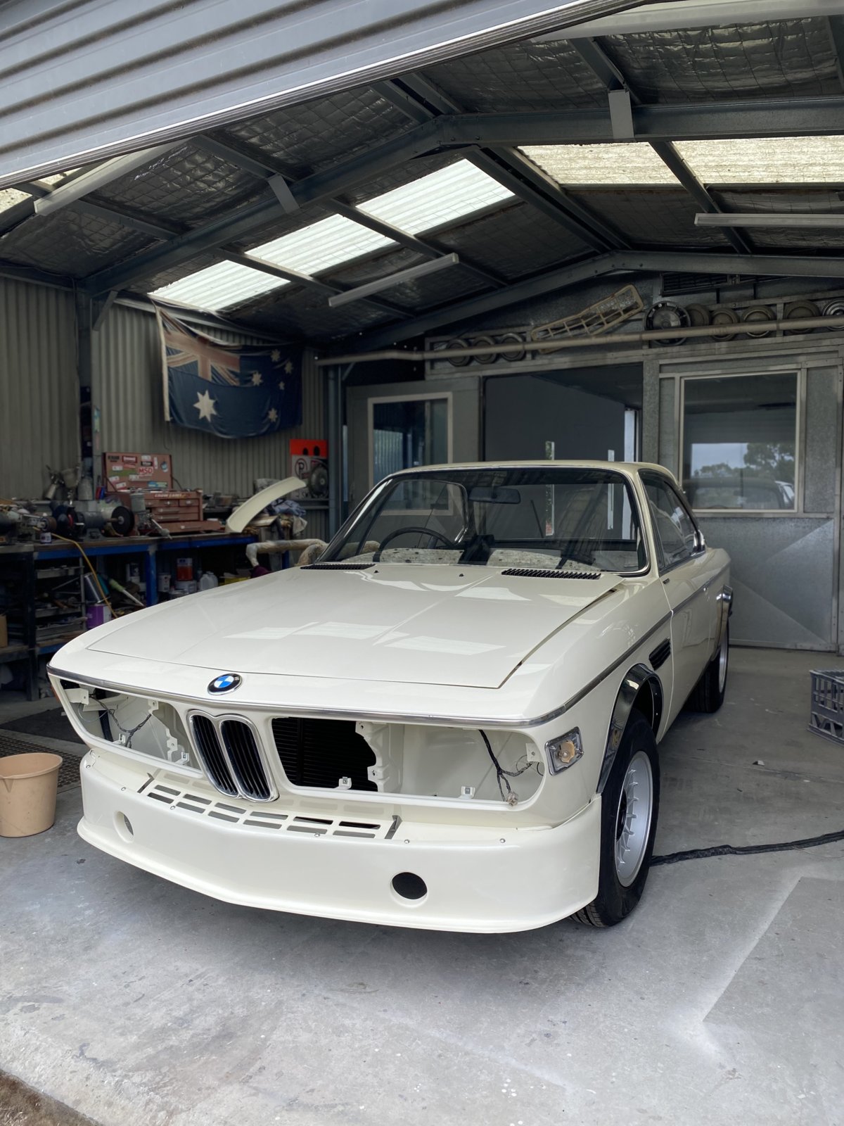

I have had some time to keep the car moving along though. Today the tow truck arrived to take my baby to Hobart BMW for the final commissioning work and to get it's road worthy ticket ahead of restoration. They are going to keep hold of the car for me while I'm moving and will display it in their showroom. It's going to feature as the backdrop for the Tasmanian launch of the new M3 and M4.
There a still a few small jobs to do like run down some small interior trim sections and the like but I'm basically done. True to form it wouldn't bloody start this morning. Seems the fuel pump is dead.

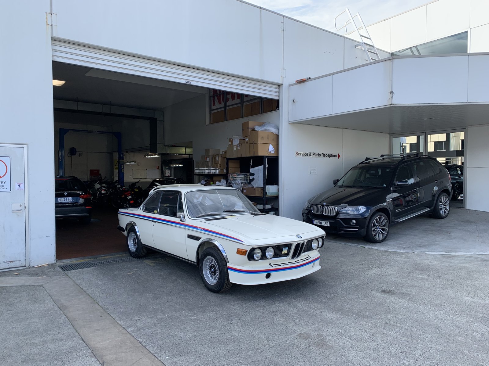

Anyway here are a couple of pics.
*Before anybody chimes in there's one feature that's not right at present but it will get us over the pit test. @Markos can you figure it out?
Darn don’t put me on the spot like that. I’m gravitating towards the rear tow hook. I can’t see it in any pics.
My eye is drawn to your black wiper blade holders. I’m surprised that the dealership accepted it t in that condition!
Looks amazing! Remember, we are hard on process, not on people!

Nup.. :)
