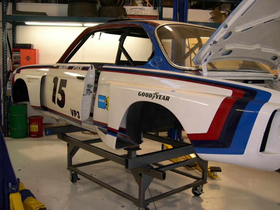

Well, everything is about out of the tub. Here are a couple of shots as it sits today. Tim and Johnathan have been making great progress.
We are finding a bit more rot and wreckage then we expected in the tub, but nothing that cannot be fixed. It seems the former owner did a bit of off track sightseeing, leaving the floor panels bent and torn in a couple of places. :oops:
Next is finish cutting the old cage out of her, get the tub on the chassis cart and over to the body shop while the engine is crated and sent to Korman.

Ah road rash! My last off resulted in a driveshaft comeing though the floor board!! you've got a lot less work to do than me!
keep the pic's comming

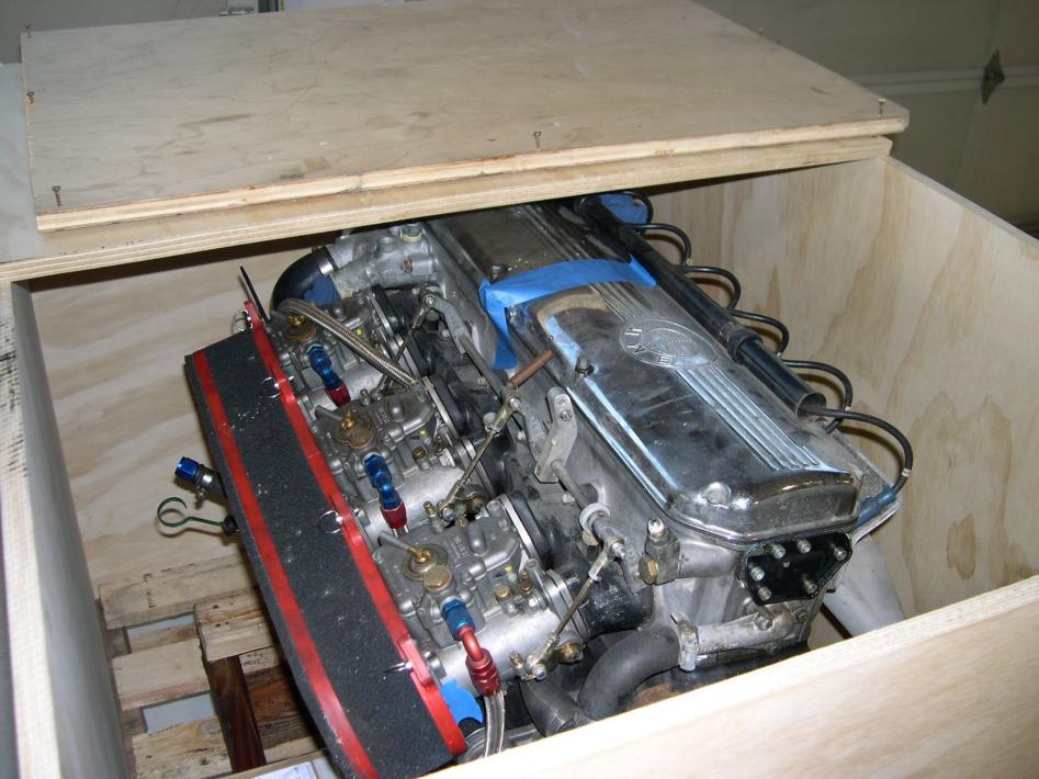

Well the heavy lifting of the disassembly is complete. Shell is ready to go to the body shop, and the engine is headed east to Korman.
I don't think there will be much progress now until after the New Year.
