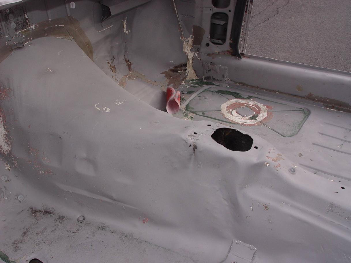

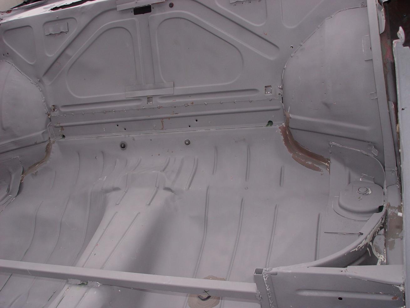

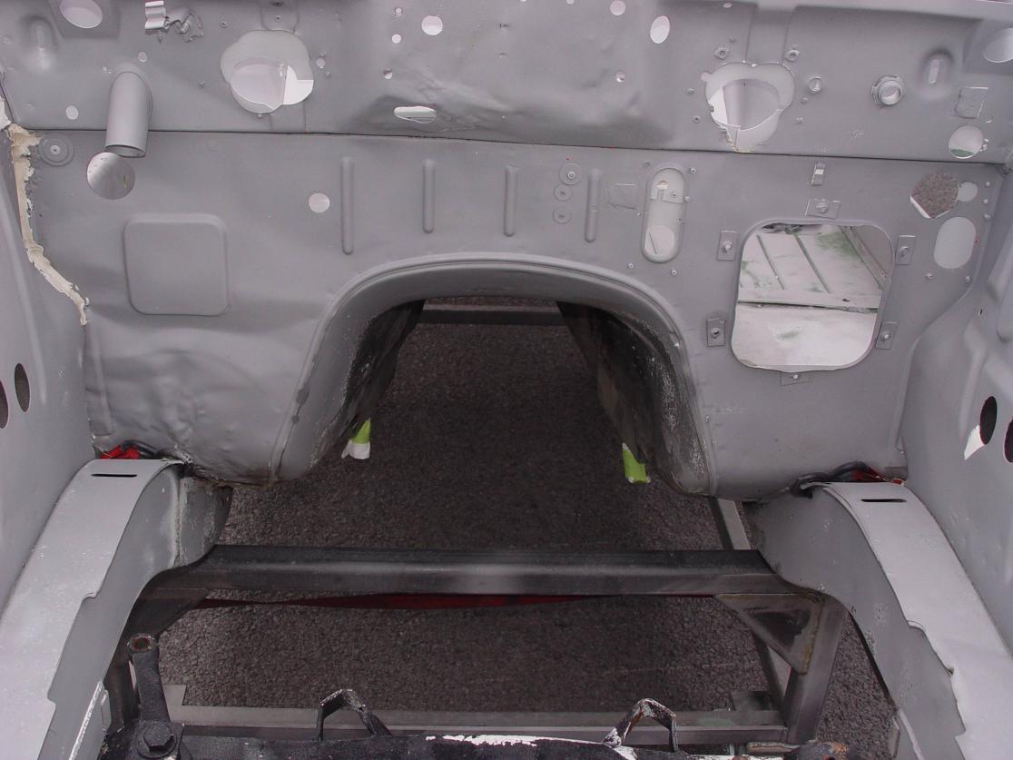

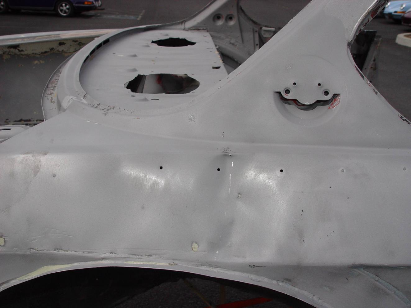

I finally got some shots of the tub showing some of the issues we are dealing with. Once we straightened the tub to factory specs we had several wrinkled panels that were straight before. Floors, tunnel, and rear quarter panels seem to be the worst.
At this point I am researching what panels are available and their cost vs tubs that we can cannibalize. I am also planning on going over to Bend early next week to meet with the body shop guy to go over options and costs.
Here are some shots of what we are dealing with:
I didn't see anything that couldn't be patch repaired. It is certainly better than taking on a new basket-case that you are not familiar with. For some of those interior issues you don't have to worry so much about cosmetics. But for that rear quarter yeah you are going to have to locate a replacement panel or spend a lot of time reshaping the existing panel which will weaken it.

Looking at the two buckled tunnel points in the photos you would think that the differential mounting point just behind the rear seat back would have been pushed forward. The fore/aft distances of this mounting point are also to spec?
Sven,
Yes, all the critical points under the car are within factory specs at this point. What you see in the pictures is as a result of pulling things straight.
I'm guessing that the car was hit in the rear pretty hard at some point in its racing career. It drove OK the three races I ran last summer with it, so whatever repairs were made at least did not overly affect the handling.
