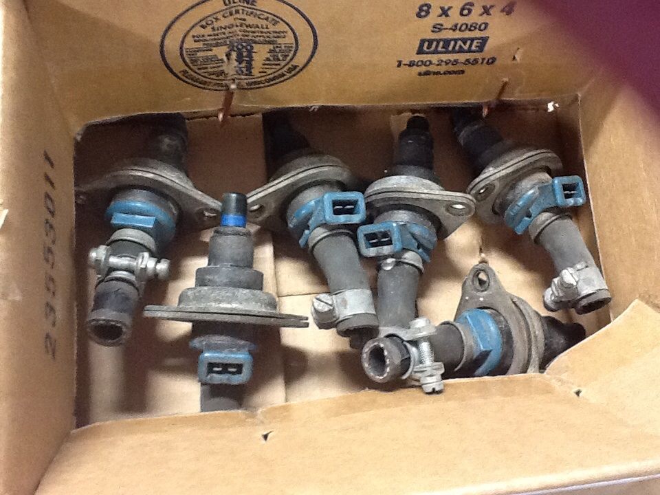

I've decided to mail off these injectors to Fuel Injection Corp for rebuild, per Sfdon's advice. I already replaced the coil, plugs, wires, cap, fuel filter... Found out there were no points -- that there is a Pertronics system in my distributor (don't know what the symptoms are for a failing Pertronics system or what differences there are in setting the distributor/twisting it for timing purposes when a Pertronics is installed, so I am floating a reminder in my wide-open head to research this next). The electrical leads to the injectors? I received the new ends to redo the leads but they don't fit on my injectors... Maybe Fuel Injection Corp will have the correct male leads.

The injectors are out and getting ready to ship.

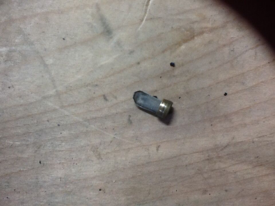

Starting to get this multiple photo process. What's that little f-ER from? The regulator? Tiny filter screen appeared when I dismantled rail...
