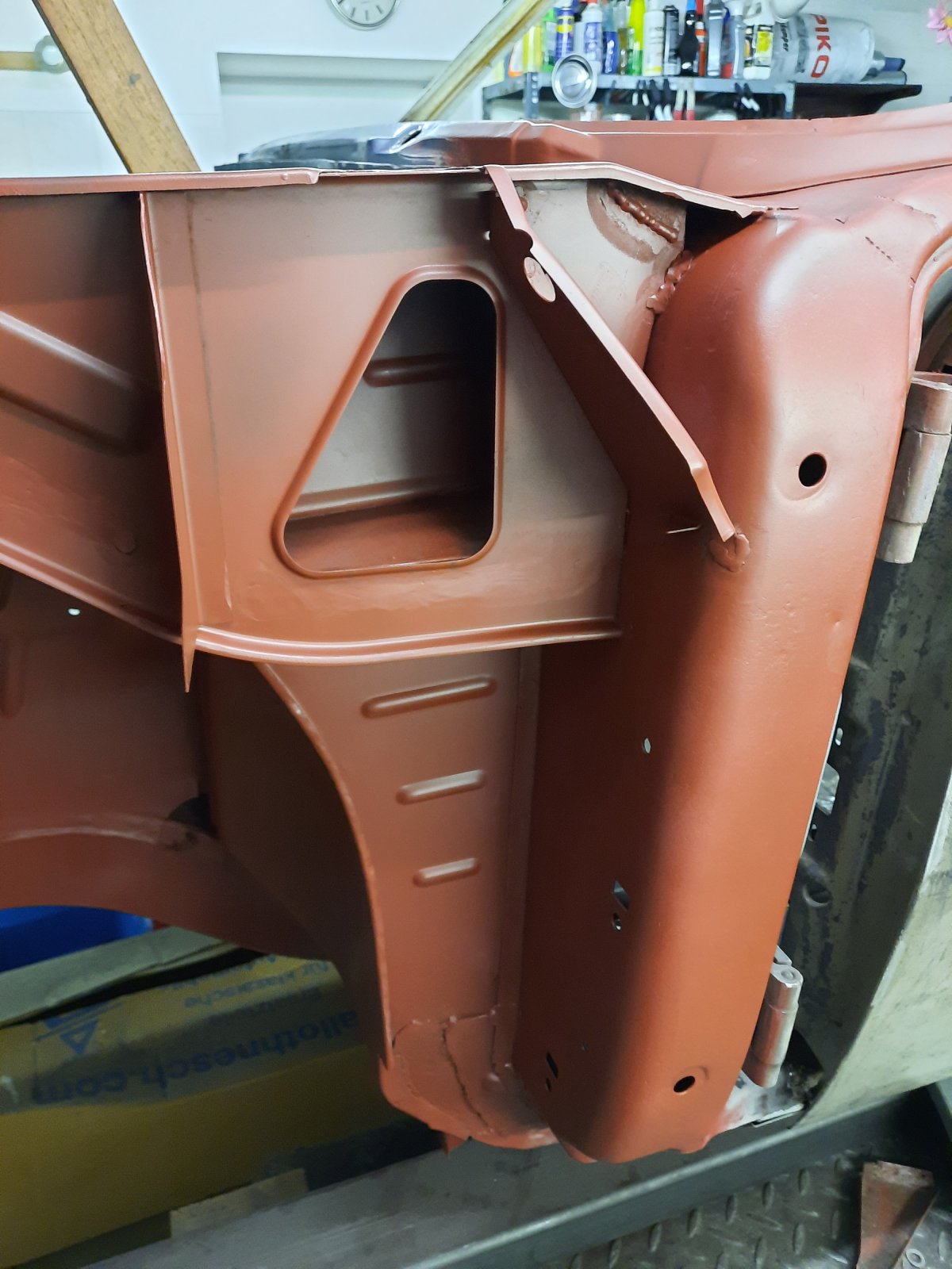

But then it's also missing the 4 reinforcement strip, 2 each side on the fender tops.
It wasn't the best fix by the PO, but I'm happy he did it to keep the car alive and likely saved it from the crusher

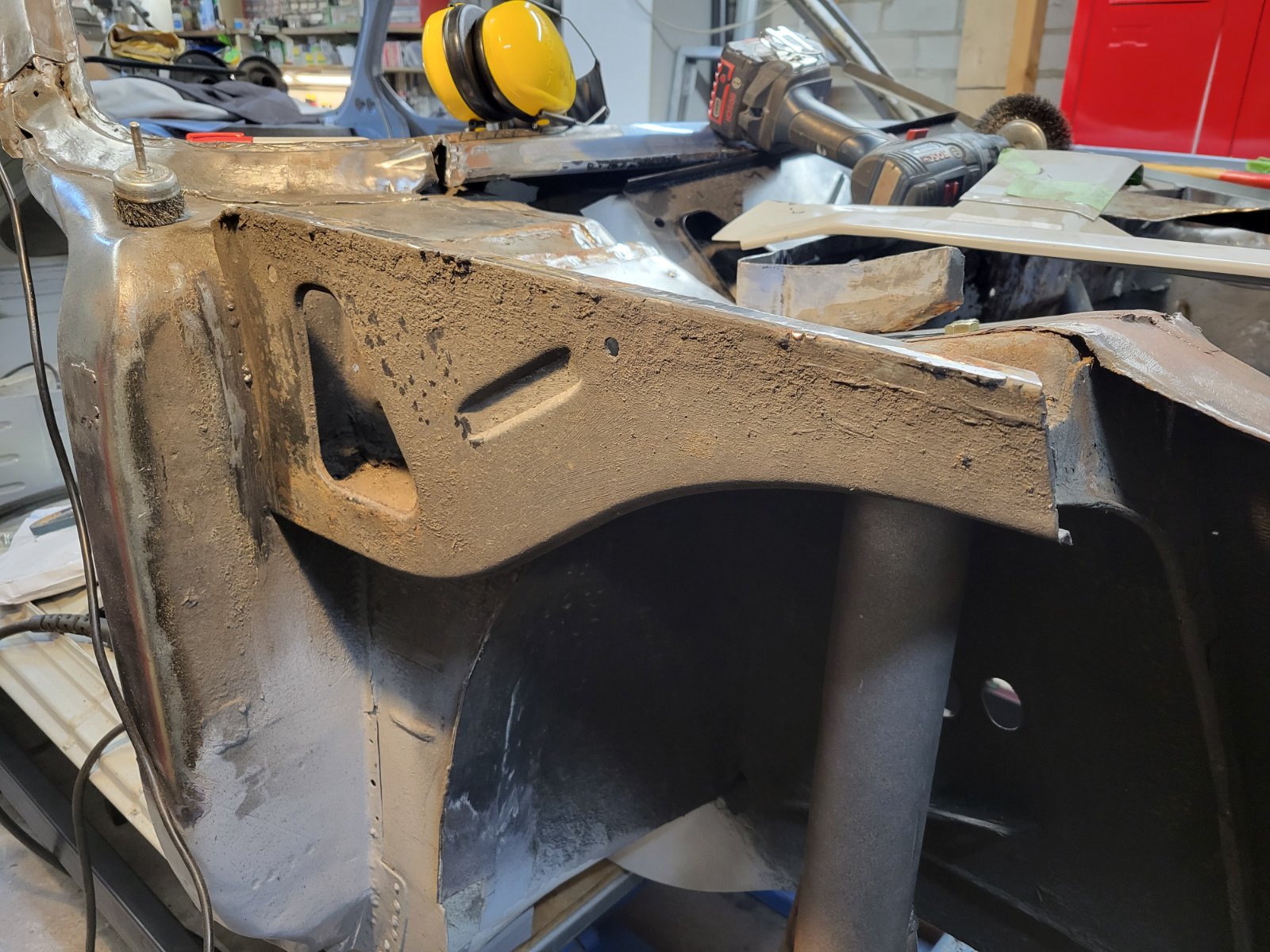

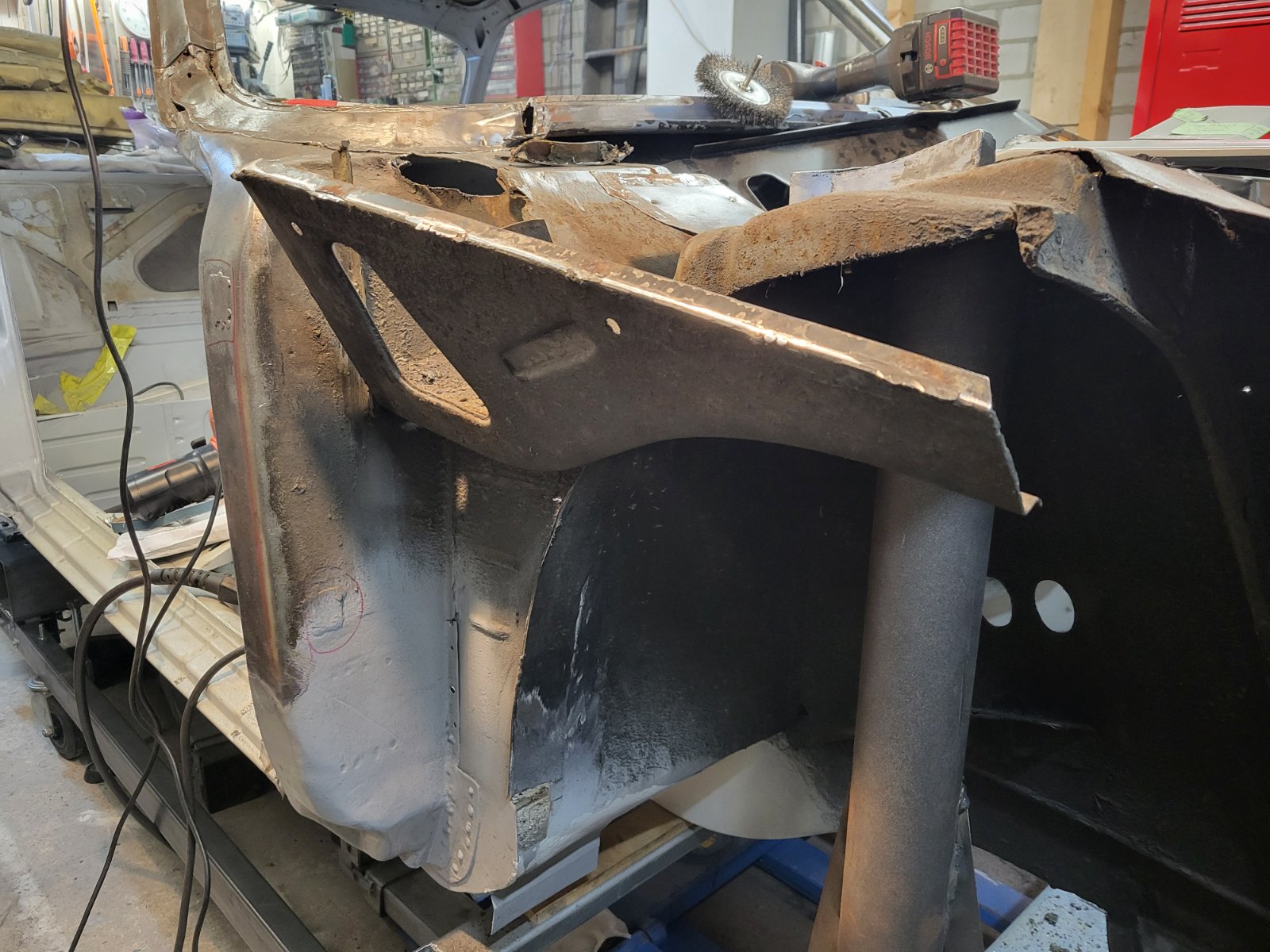

Another interesting find:
The front of my car was replaced at one time; It has new nose and also the fenders have been off before.
Original parts were used, and rust protection on the new stuff was quite OK, but....

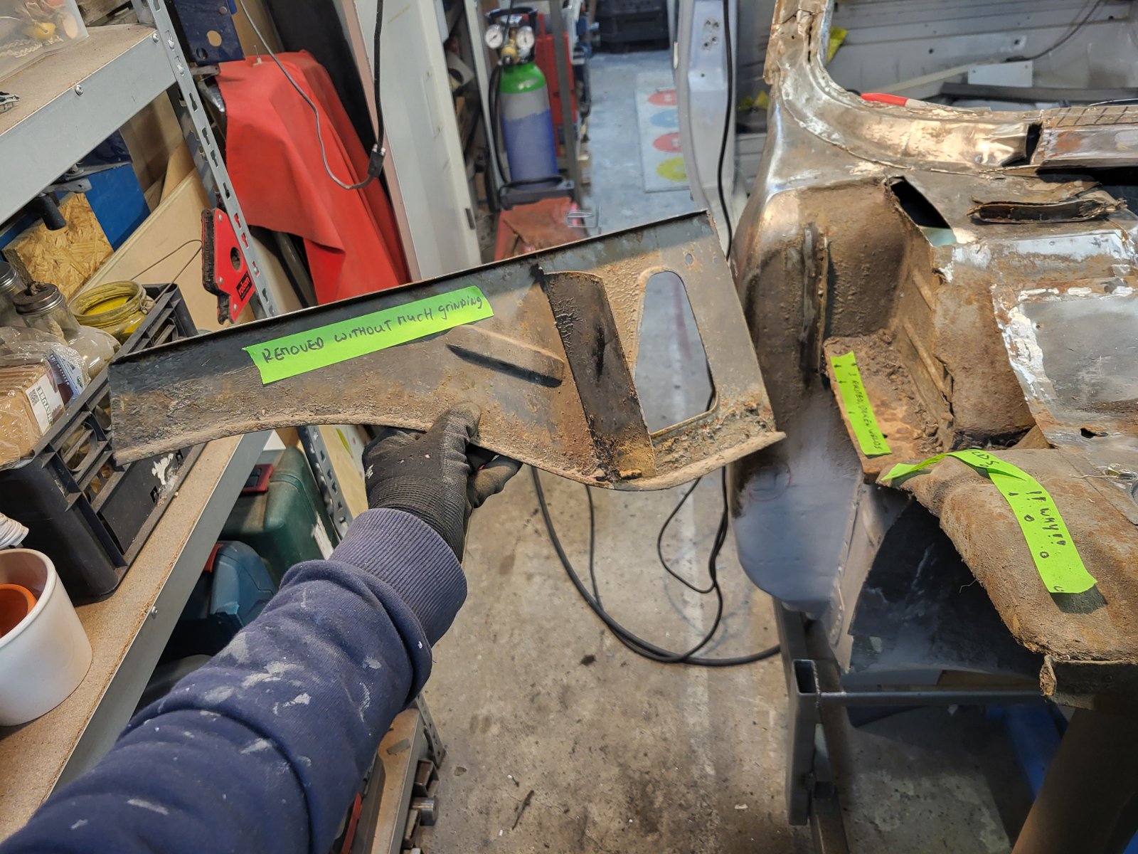

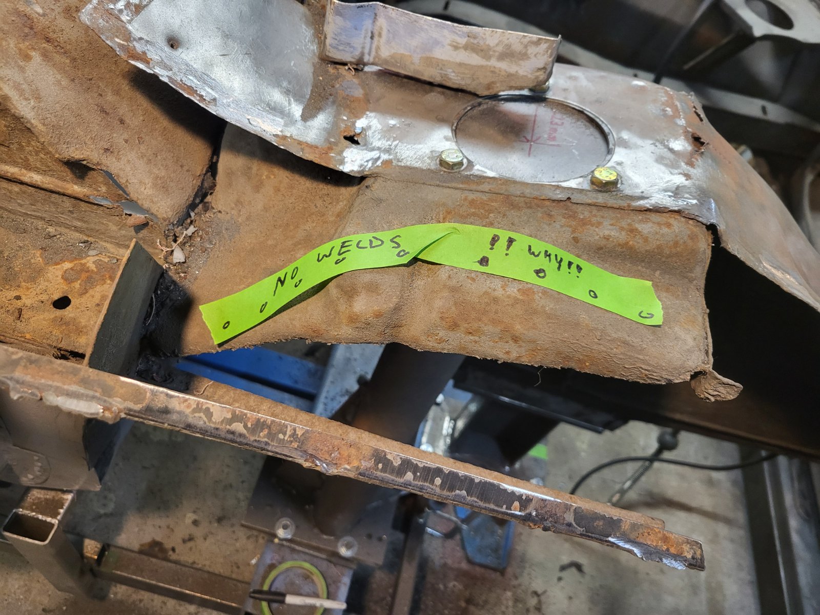

Remember the supporting strut part? The one where the left part was mounted on the right side in my car and vice-versa? I just found out that it was only welded on the vertical side and horizontal edge, and not welded along its curved underside AT ALL!
So it wasn't even welded to the strong, thick strut mount, which is it's main load bearing connection! Nor was it welded to the flat plate that makes the bottom of the notorious cavity.
For reference, a pic of the BMW shop tech manual:
As a result, after chopping it loose from the A-pillar and separating the plug welds to the inner fender, i could just ease it out. I guess no-one ever got that part out so unharmed. If I fix the edge to the A-pillar, I could even reuse them....
All the more confirmation that my choice was right to go down deep.
I think it's going to have a bit more of a firm ride when I'm done with it.

Looking into how the supporting strut needs to be placed, I noticed that there seems to be some variance in the way the part is mounted. I was sensitive to this, as on my car the vertical flaps were mounted inward- steeering me towards some checks.
So I checked a bunch of resto threads, BMW tech Manual, NOS parts, and cars, and I spotted another difference.
In 3 instances of the checked pictusres, the edges of the supporting strut (not the vertical flap) are facing inwards , and on 17 they face outwards.
The Tech manual shows the edges pointing outwards as well as can be seen in the post above here. So you'd think OK, clear - whoever placed these parts with the edges to the inside needed a coffee.

I guess that also matches the notches at the top of the small funny triangle plate that slides over these:

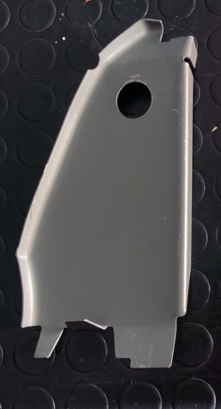

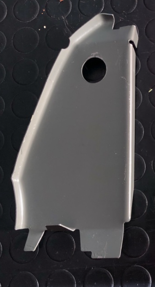

Does anybody know if this piece is available as spare part:
(center in image) It is the part of the wheelhouse, connecting the inner fender to the thick strut top plate.
I want to remove them to pull the top plate out and remove any traces of rust. In doing so, I'll likely destroy them as i want to keep my inner fender as untouched as i can, so i want to drill the spotweld from the wheelside.

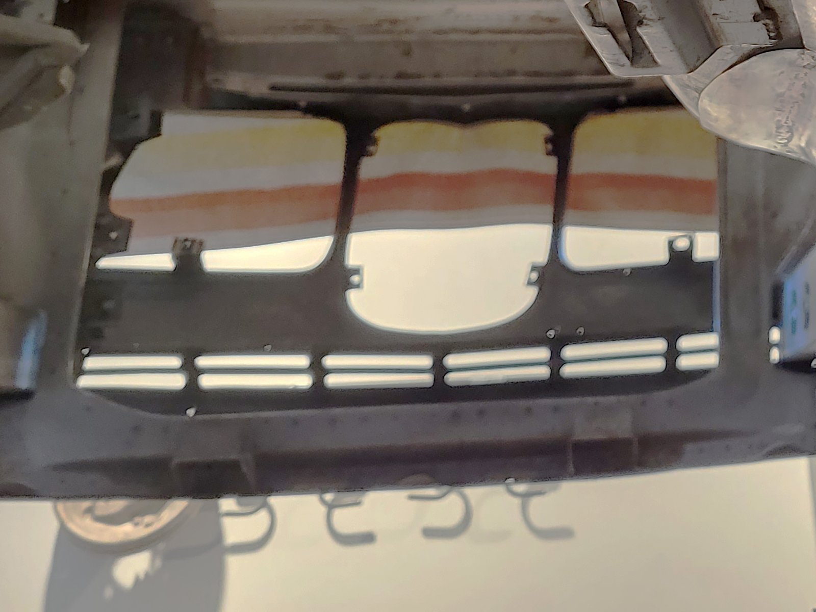

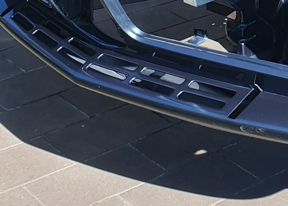

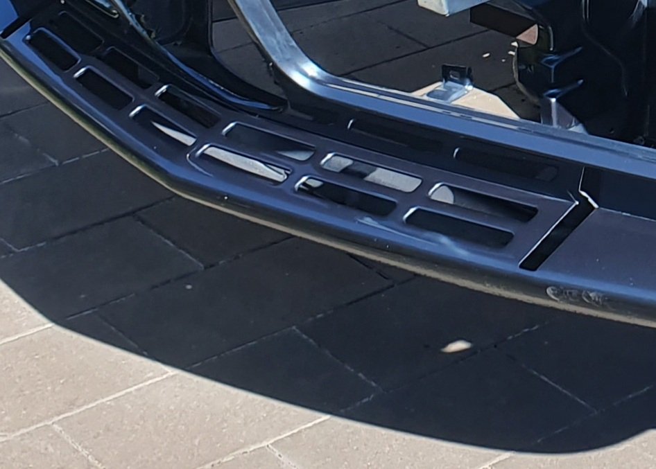

My car, somewhere in it life got a new front nose. Visible because it has blob welds inside the wheelarches and on the edge of the top to the fenders. It also sports the shorter, post 1973 chin part with the narrow slits to allow for the cut out of the US style bumpers.

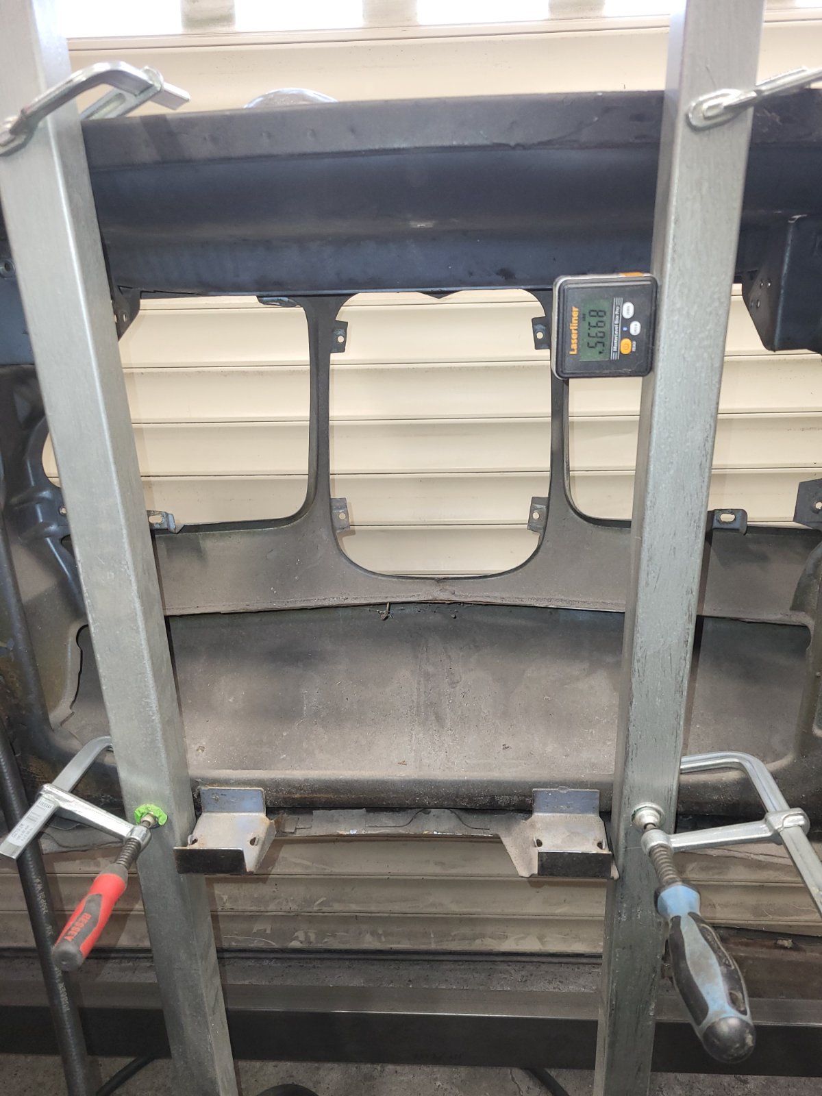

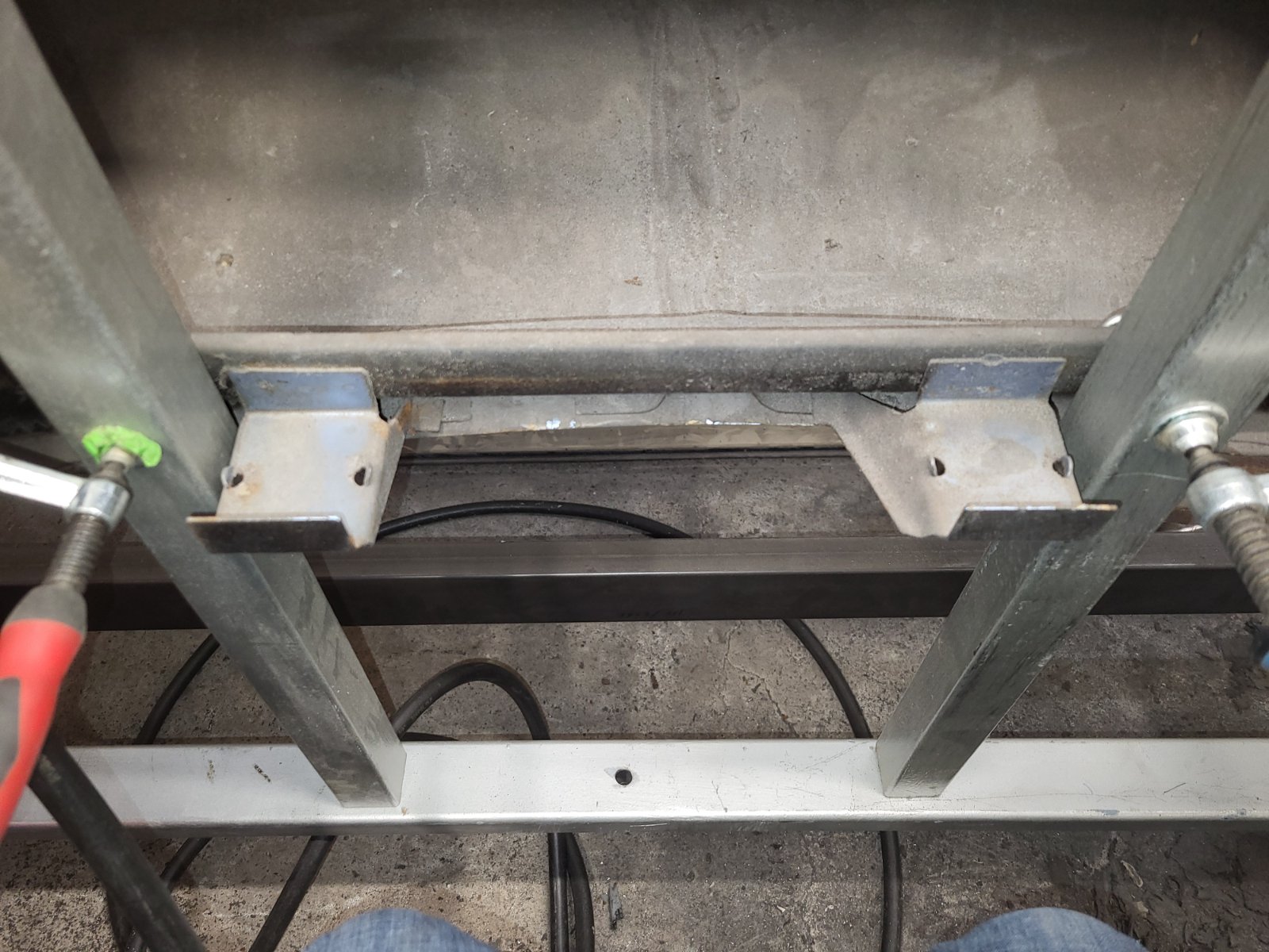

Anyway, in prep of cutting out the front end to send it out for acid dipping, I am preparing a jig to aid in it's relocation later on.
And, yes, I am sitting in the engine compartment....

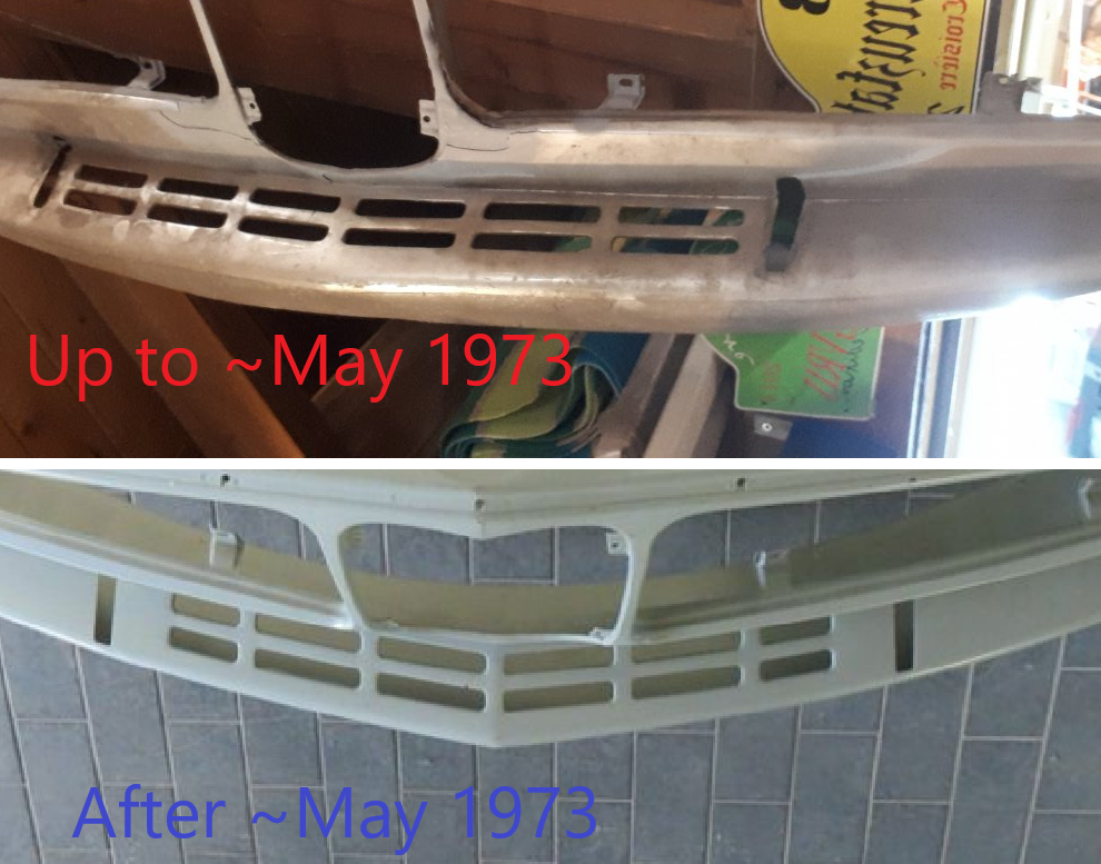

Could it be that it matches the differences we know on the front side; the length of the slits on the outside being shorter in post June 1973 to make room for the cutouts for the US 5mph bumpers?
@autokunst - is your car still having it's original front and being pre ~June 73? Does it have the longer slits in the front?
@Ian C - same question; what build date is your car/ original front / long or short slits?
fyi: short vs long slits in the front:
as discussed more here:

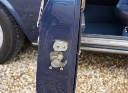

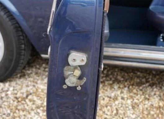

Dont froget the plastic bit on the lock - it makes the car go faster! - on mine it added 32 mph to the top speed!
I was slamming my doors like an idiot because they wouldn't close, just stay in the middle position (just before fully closing)... until some guy installed those plastic bits... Now both doors close perfectly... I am a mechanical engineer... and still don't understand how those plastic bits help out...
