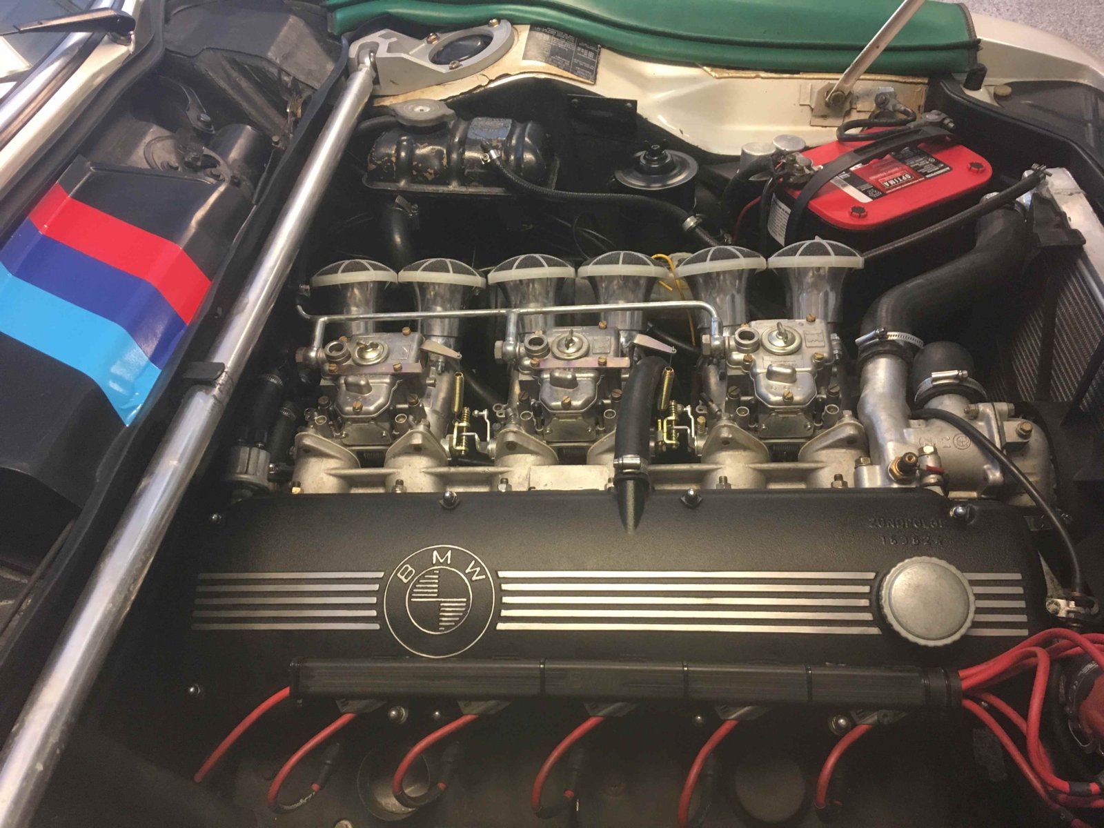

Engine, AC, stereo, sub and almost all the wiring is done.
Great help from Don L and Chris on the AC circuit and the little diode. ;)
Boy trying to get the probe for the thermostat back in the AC evaporator was no easy task. You can't even see it from the front.
Had to get my endoscope out and look in there to be sure where it was. It's been 3 years and probably should have installed the switch with probe before I put it back in car. Just leave switch taped to front. I had to get some 2x4's and lift the dash to get the space between the AC blower housing to see the hole for the probe. Finally got it in there. If you are reading this and haven't done this yet please install the probe before you install in the car. Life will be so much easier.
