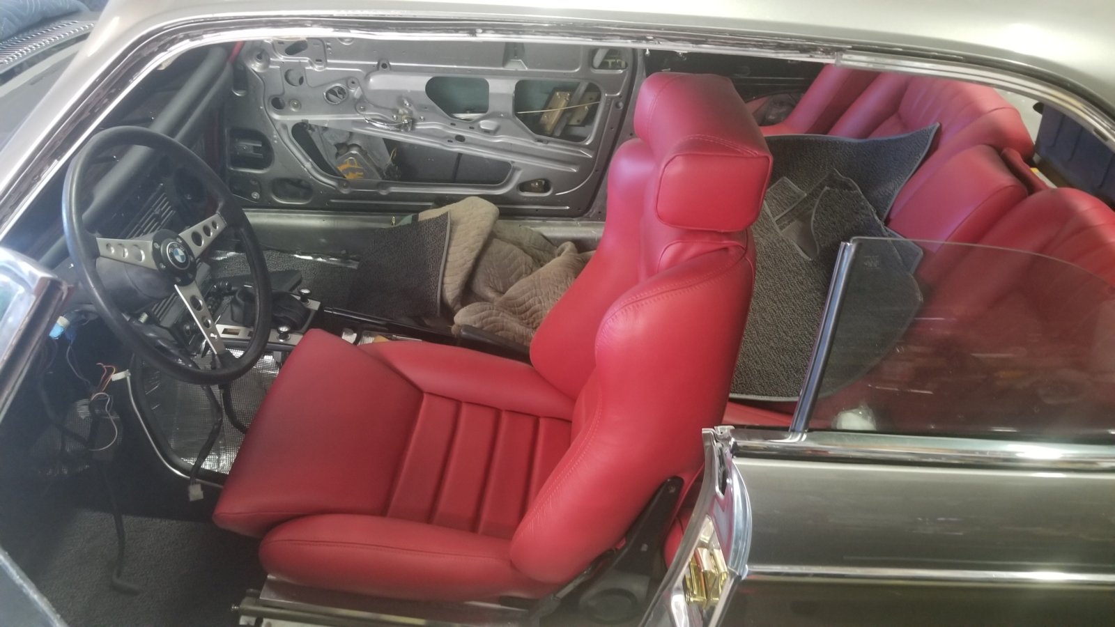

Actually moved out of garage today............ because that was the only way I was going to get the drivers seat in.
Just too close to a wall of cabinets on the driver side to get the seat in the correct side and certainly wasn't going to lug it across the inside of the car and tear up something.
The Scheel seats are heavy. So put a stool on the drivers side and cranked her up.
Got the seat in which with a totally new bracket was tricky because bolt access is limited.

Gary, first that is an awesome color. Probably one of my favorite colors I have seen on an e9. Would like to see your Scheel seat bracket that you used in your car. I am at the same point of installing my Scheels but need to fabricate a bracket. Found that the Scheel adapters mounted to the factory sliders make it a bit short to mount the seats width wise. I know Dave Varco at aardvarc makes one for the e24s, but a friend told me that it may be short for our e9s. Here is how mine came in with a Mickey Mouse aluminum bracket that the seats came with. Would like too see which one you went with.

Dave Varco's bracket fits the e9. i have almost the same seats as Gary - his have a lumbar feature that mine do not. i bought the brackets and the seat installed easily + quickly.

Mine are less than spectacular so sounds like the ones Scott mentions may be the best. I never knew about them.
Those look nice...plus saves me hours of trying to fabricate them. Thanks Scott.
Those are nice but my metal guy made me some and attached them to some new sliders. Problem is the sliders are a POS.
The whole mechanism then attaches to the bottom of the Scheel seat. Then you have to slide to the front and back to mount to car. I was able to use the back hole with the captive nut but had to drill a new front hole. Getting them in the car is hard work as they are pretty heavy and you can really screw up your back reaching in and trying to position them. I'm ok but it was close.
They're in there now but may have to revisit this at a later date. Good sliders that aren't $300 are hard to find.
Lesson learned- you get what you pay for.
Gary, what I did with my factory sliders is I had them sand blasted then Blue Zinc plated. After they come back they look really nice. Throw some PB Blast in there and they work really nice and look brand new.
