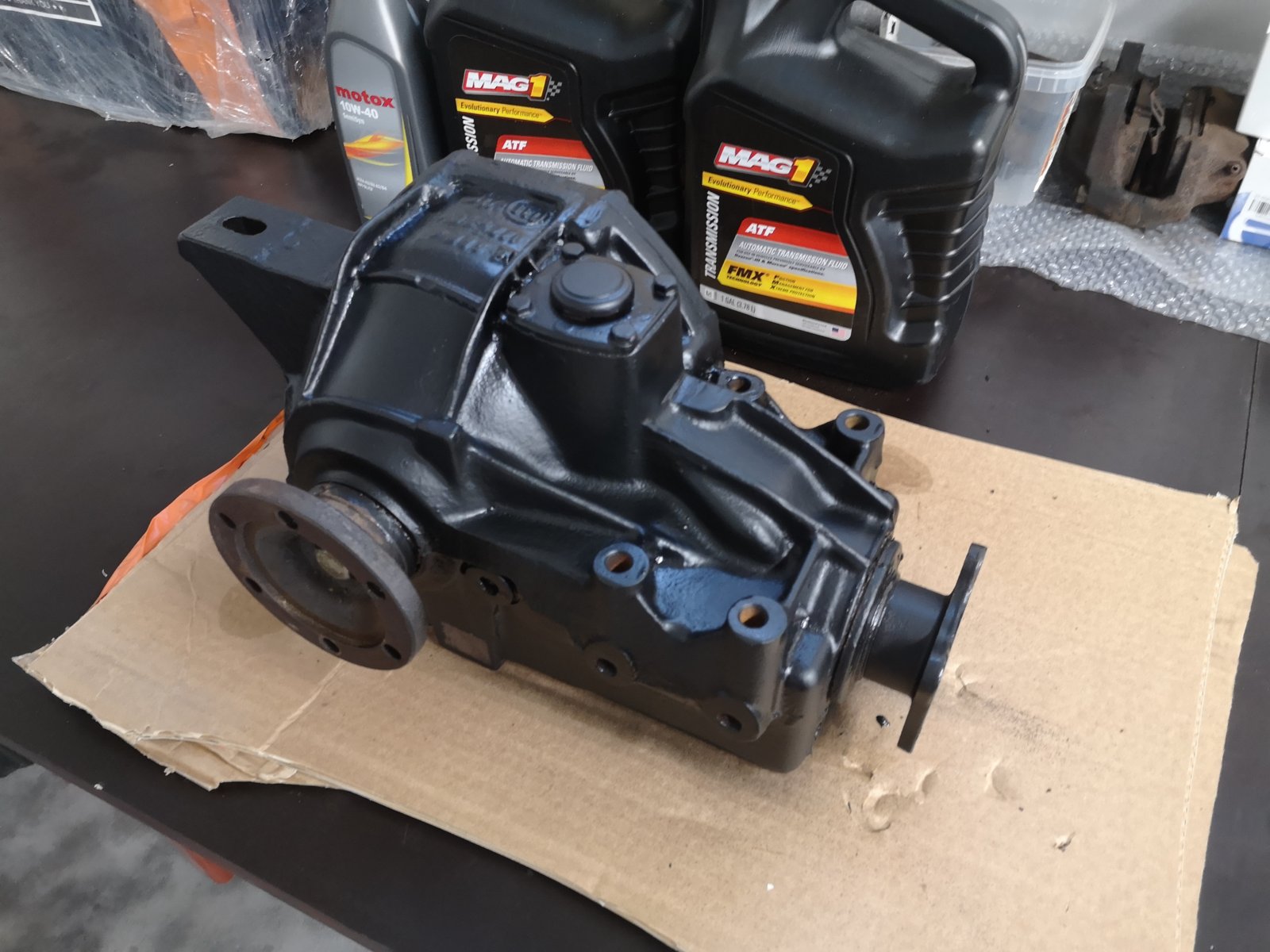

The 265/6 wasn't exactly perfect to mate with the 3.25 diff, so I was close to buying a 3.45 LSD from Germany, but the seller backed out last minute, and at the same time I saw a cheap local 3.45 non-LSD for sale so I bought that just to try out the gear ratio. The result is pretty good for my driving so now I'm just going to keep my eyes open for a 3.45 LSD.

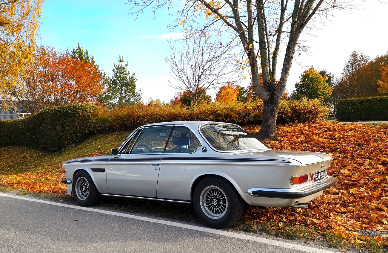

I'm quite bad at taking pictures from everyday driving, so when I'm going for the last drive of the season I always remember that, damn, I need some pictures, so here's some pics I took last weekend when I went to dry it out after the last wash before going into the corner of the garage again.

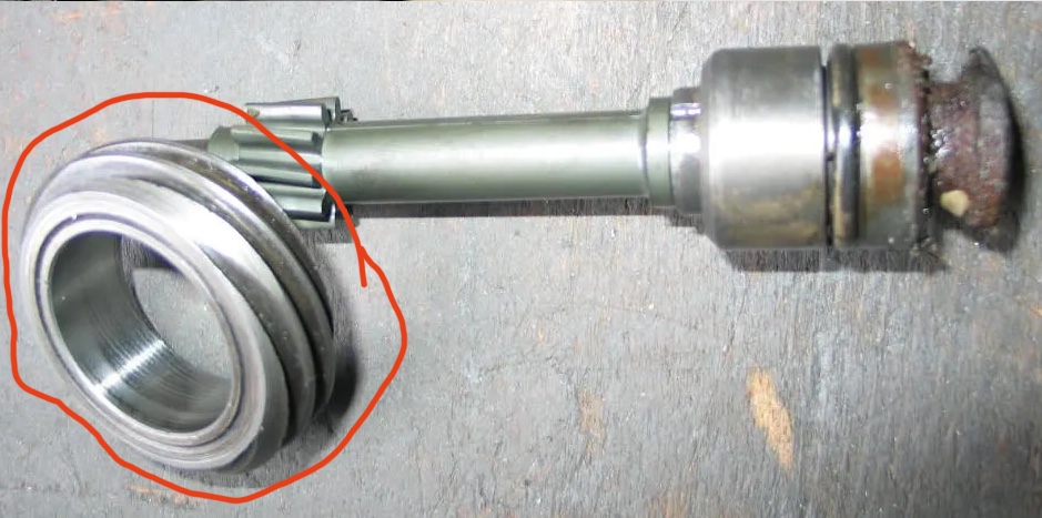

The speedo cable is plug&play as long as the G265 has the speedo drive, I took my speedo drive out of the 4-speed Getrag and put it into the G265 but you still need to make sure that a G265 without the speedo drive has the internal gear that drives the speedo drive (photo attached), otherwise you can't simply swap over the speedo drive.
Easiest is to find a G265 with the speedo drive already installed.
I've read that you might need an automatic speedo cable (it's a bit longer) but the manual speedo cable worked well for me.
The work itself was straightforward, but that's because I spent many many hours reading and figuring out what I needed to order, before I even touched the car.
The list of parts I wrote should be pretty complete for a 4 speed to 5 speed swap, but I'm happy to answer any questions that anyone might have :)

Don't shy away from a 3.07 as you can swap the gears from the 3:45 into it as long as the ring gear has the same bolt pattern
Yes I'm aware of that possibility, however we don't have a local diff shop that could help me with that task. And I'm not comfortable with setting up the backlash and preloads etc. myself, so finding a 3.45 LSD ready-to-go (maybe replace clutches and dogrings) would be so much easier than shipping it across the country back and forth.
Looking at side half shafts mounts bolts, that diff on Robert photo above is an early style 3.45, so it will be 8 bolts crown gear mount, later 3.07 will have 10 bolts mount, so they will not be interchangeable.
Thanks for making that clear, Wladek!
I had the last one I did, by a shop that does large tractor gear box/differentials. He did my first one years ago complete with with me furnishing bearings and seals for $300 but was to busy to do the last one I did a year or so ago but let one of his guys do the gear switch and set up on the side. He charged me $200 to switch the 3:45 into a 3:07 and vice a versa and set the lash so maybe that is a an idea

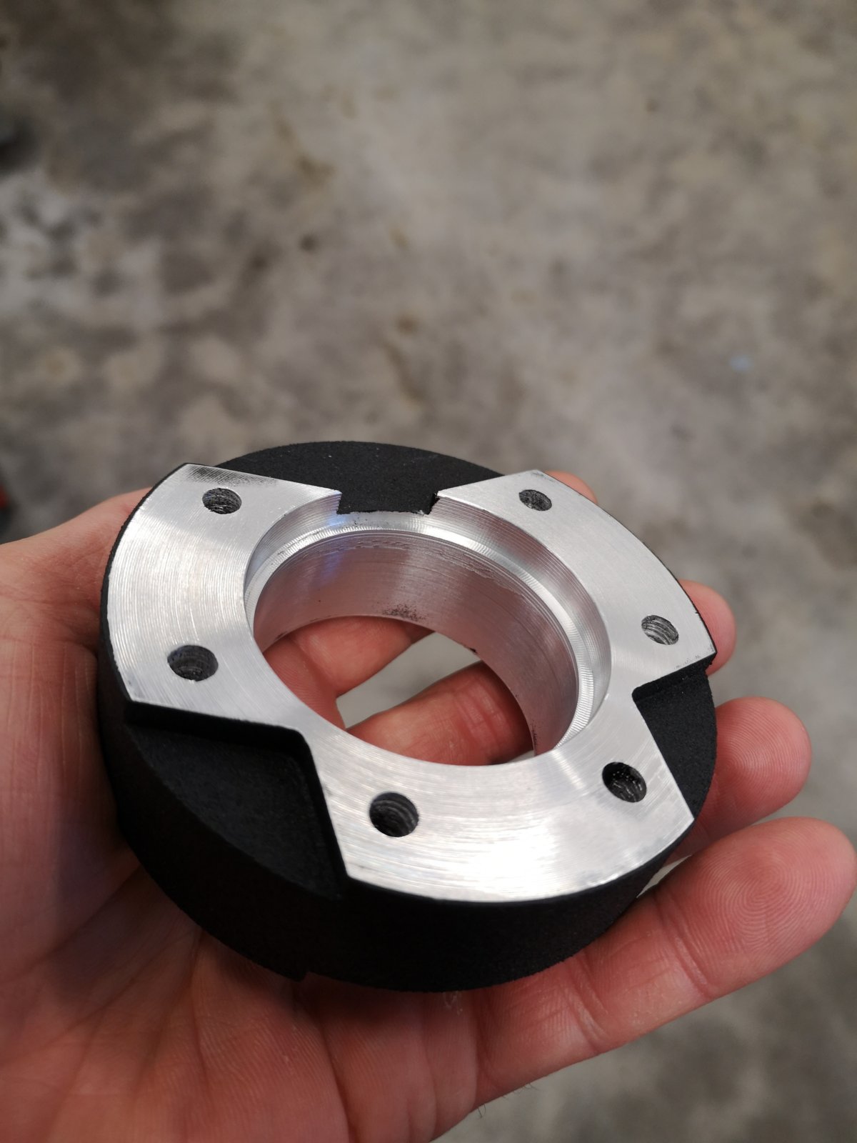

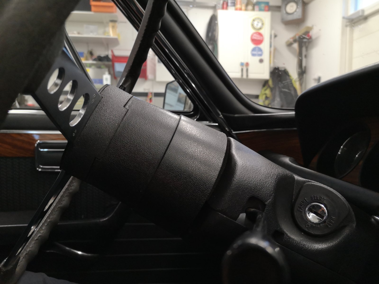

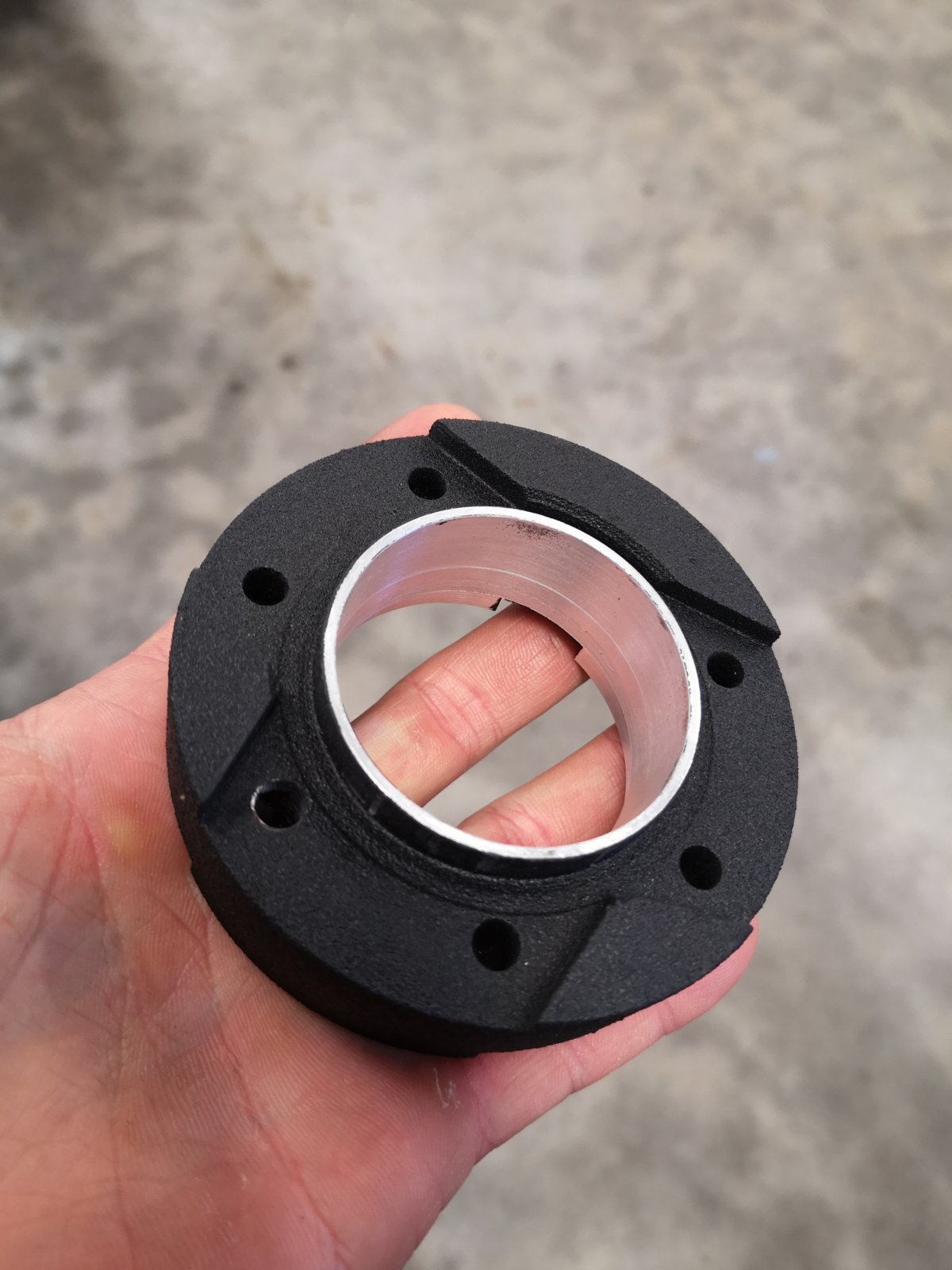

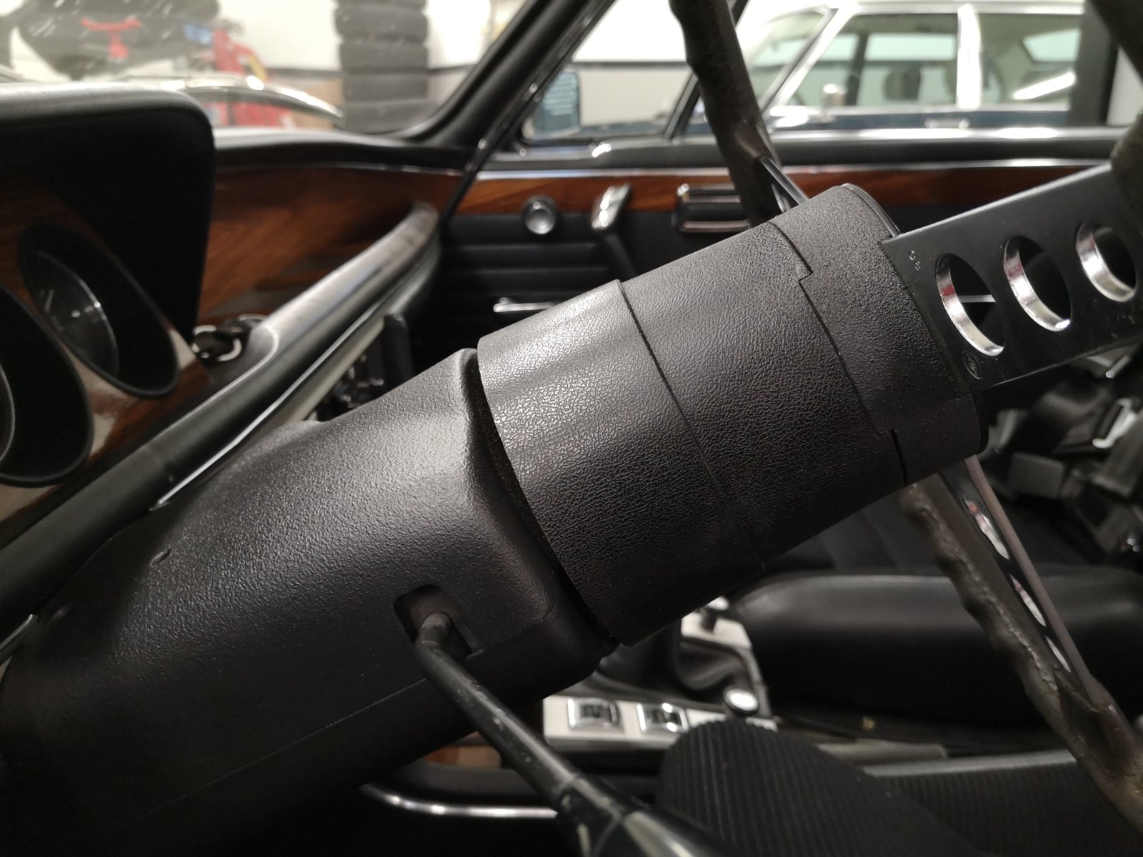

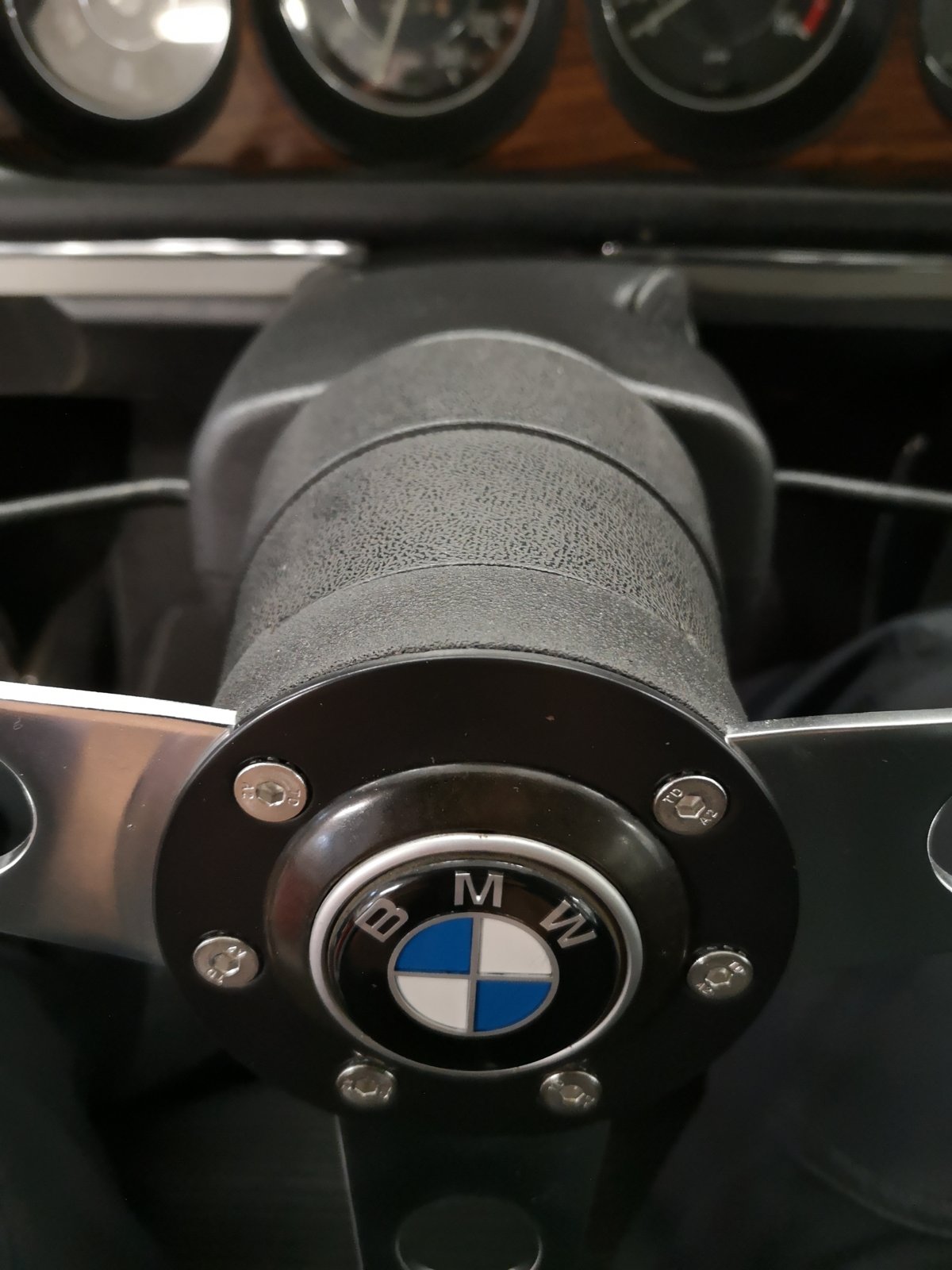

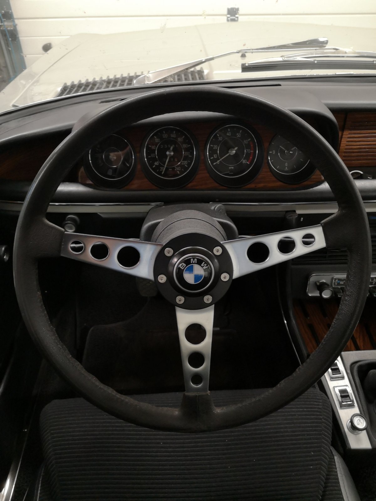

Small update on the coupe, @Wladek has helped me with creating a better driving experience, I've always thought that the steering wheel is a bit too far forward for me, don't know if it's the Scheels or just my body. So he made me a super sweet spacer that goes between the hub and wheel:
As you can see on the last photo, my Petri 38 is a foam version with tapered ends on the spokes.

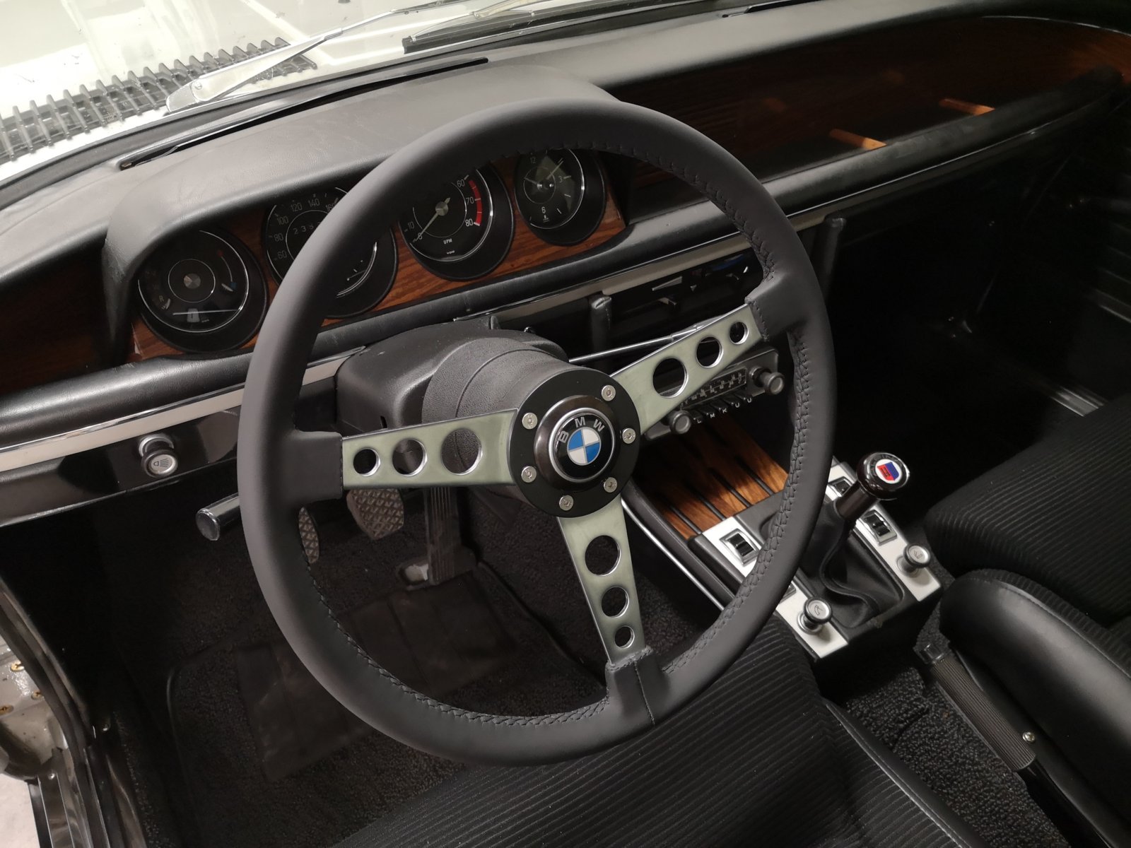

Then @Wladek had another Petri 38 for sale, with a very nice leather re-wrap and modified ends on the spokes to mimic the CSL Petri.
So I just had to ask if he wanted to give my Petri the same treatment, and that's what happened.
Just got it back, it's Perfect.
