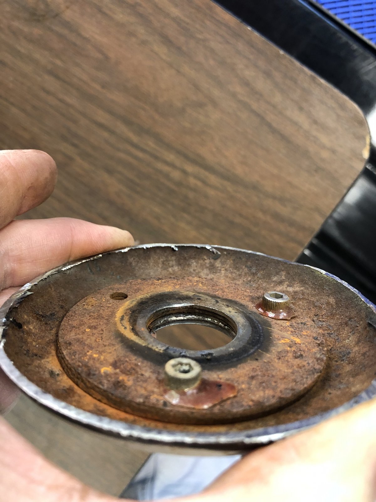

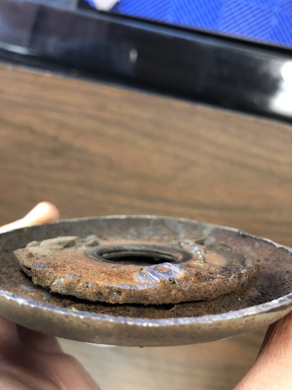

The method of failure for the original parts is that the large washer on top is spot welded to the shock mount top resulting in concentrated stress points which seem to cause fatigue cracks that grow over time until they meet and the shock is launched out the top of the mount by the weight of the car.
Welding around the perimeter of the washer will greatly strengthen this part and should evenly move the loads further out toward the sides of the mount instead of the point spot welds. It alters the look a little bit, but I think it's a good trade-off as it's being done by a lot of members already in an effort to forestall failure. The maker of this part is wisely leaving the decision to modify the part to individual owners. Making non-standard parts would reduce the number of people who would buy this product, IMHO.
These new parts are not designed to be put over an existing shock mount because that would not address the possibility of existing fatigue/damage of the stock mount which should be removed/replaced rather than covered. Let's be real. Just as pretty much every coupe has some rust issues somewhere, the rear shock mounts are all probably starting to crack by now. There are numerous posts on the forum encouraging owners to do preventative repairs to their towers by sad owners who didn't.
If you really want to keep things stock, an appropriate repair would be to drill out the spot welds, remove the large washer, and weld up the existing cracks at the top of the mount and then reweld the washer back on, with some extra weldment to strengthen things. But that's a lot of work that no one will likely do, in part because access is a huge issue for such work, and until they fail, we'd rather think of ourselves as lucky and drive on. The easier procedure, now that this part is available, is to amputate the old shock mount top and weld on the new one. Since our cars aren't daily drivers anymore, once repaired by any method, the shock mounts should last the life of the car, race cars possibly excluded.

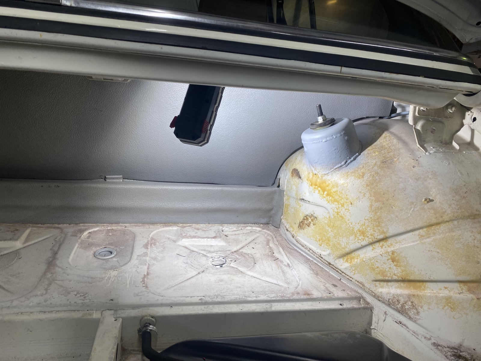

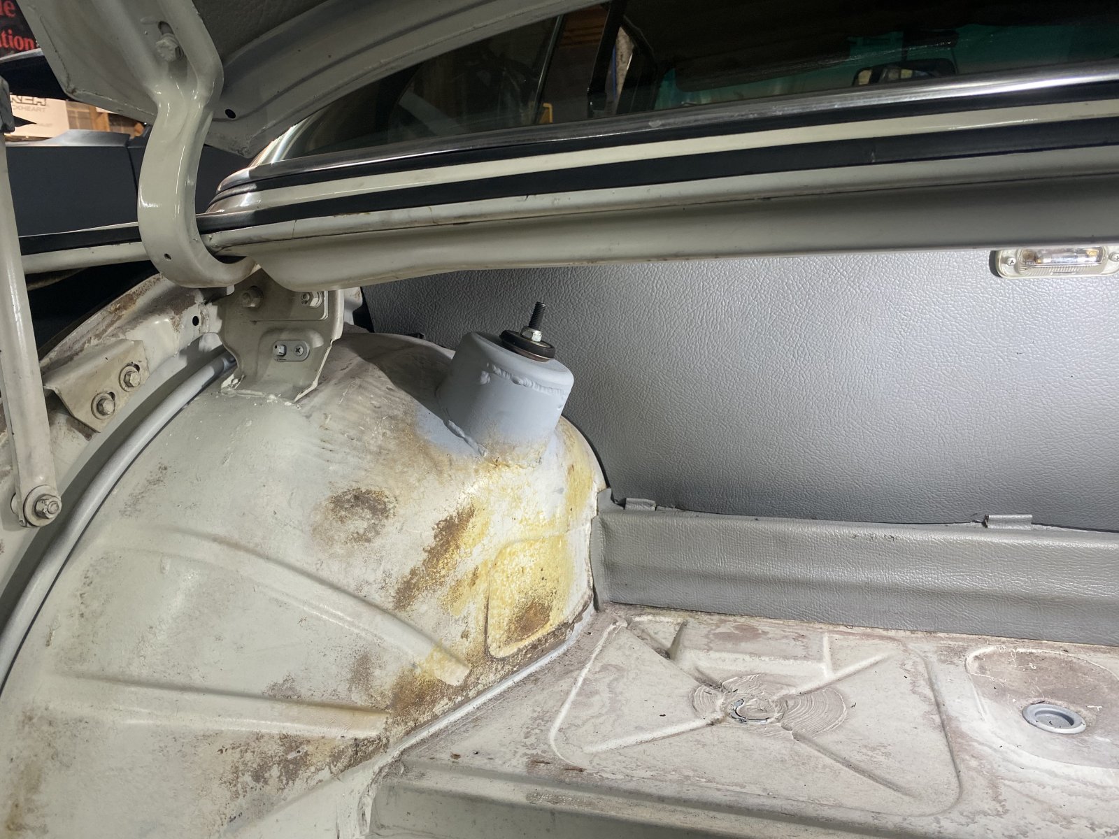

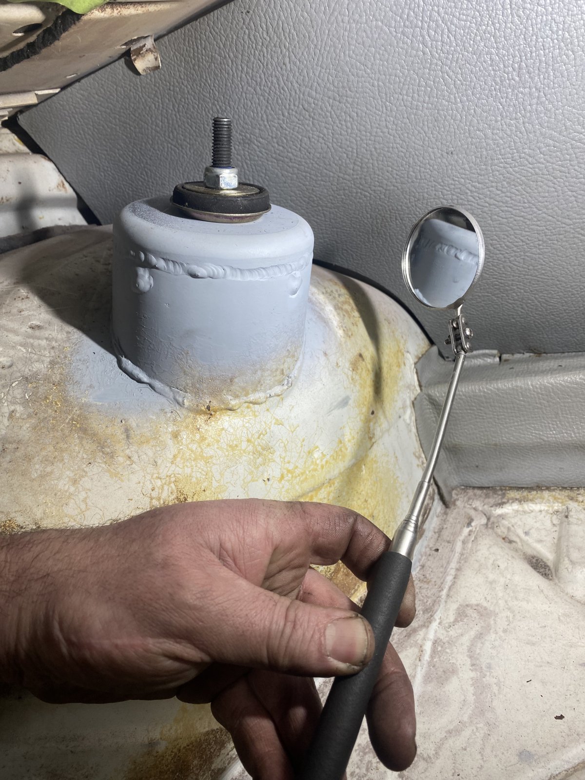

I purchased a set of the "caps" that @halboyles mentions. I delivered the coupe to the welding shop on Monday and it was finished earlier today. Here are some pictures of the completed installation.

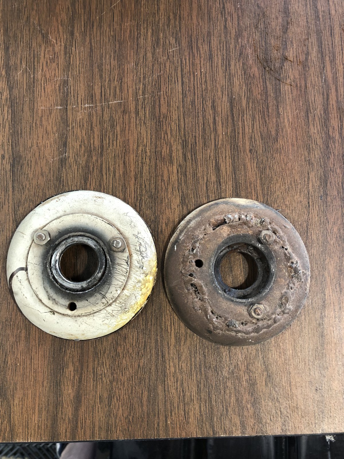

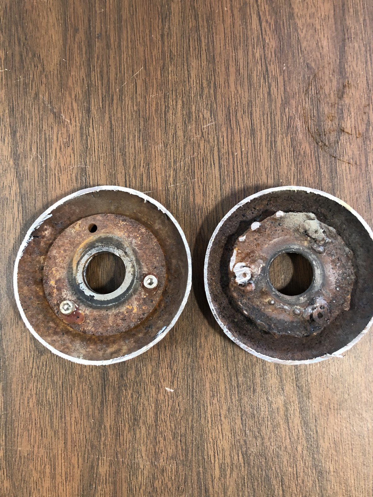

I dropped by the body shop where the coupe is being worked on this week and picked up the original rear shock tower tops that were cut off (see repairs above). This will provide a look at aged tower tops. Really glad they were replaced, especially the one that is damaged.
