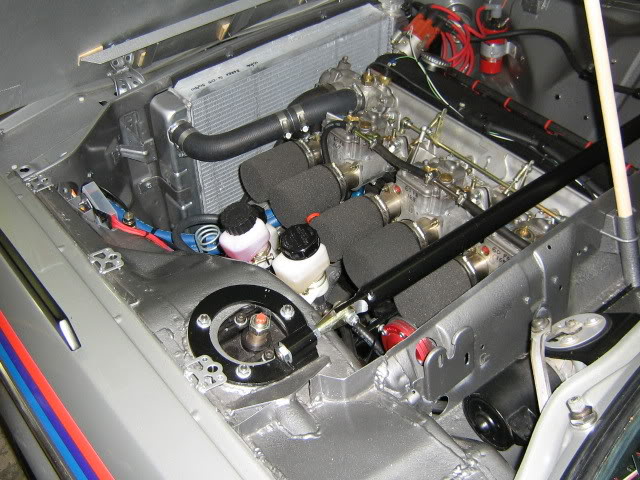

I have been out in my garage building my CS coupe hotrod, which I started in the fall of 2001. Consequently I have not been online all that much. My coupe is finally on the road and driving, but with open headers. Let's just say that the neighbors aren't happy... I've got about 12 miles on it, driving the local rural back roads, but I'm pushing my luck with the local police. I am constructing the exhaust system now, (three into two into one) and will get the car corner balanced and weighed later this month. The first track outing should be in mid-june or July sometime. I'll post some pix as soon as I can

Stahl Headers visible, with EGT ports-all 6 plugged. Speedway Motors Alum radiator installed, fitted easily in position, but not with OEM fan- instead an Electric fan is fitted in front of rad.

I have run the ole girl for 210 miles so far and have had a minimum of problems and issues. I'm still tweaking and tuningand getting used to the car: brake balance, clutch feel. nut-and-bolt checks.... no big parts have fallen off yet :D It pulls like a freight train and has that classic seamless BMW torque-y feel. The exhaust system came out well and has 3" tube from the header collector pipe set-up all the way to the rear. It is not too loud, but at WOT it makes a good growl. I ended up without the cherry bomb center resonator-the exhaust just goes to a flowmaster 50 series with 3" in/out. I also had a corner balance and a 4 wheel alignment done by a local shop; weight is at 2620 lbs with full fuel, no driver. I was hoping (dreaming) for a lot less.
Malc, The dash is a repro fiberglas Motorsport dash shell I purchased from Dan K in colorado. I fabricated all the other bits to make it work. The cage's cross-tube runs in the lower-most part of the dash, tucked up and out of the way, located horizontally just over the steering column. I also drilled and tapped into this tube to retain/secure the lower part of the fiberglass dash. The main inset instrument panel itself (tan in color- directly in front of the wheel) is retained with six 10-32 screws with big,flat heads on them. I resined in six "L" shaped aluminum retaining brackets in the back sideof the fiberglas portion of the dash, around the opening. These six sccrews are tapped into each of these six brackets. That way, I can remove those six screws from the front face, and pull out the inner dash panel from the black fiberglass portion for service/access. I left enough of a "service loop" of wiring forall of the gauges, in order to sneak that panel out (toward the steering wheel) without removing the whole black fiberglass dash portion. The three canted gauges on the center right of the dash are fitted to pieces of 16 gauge aluminum, bent into shape. that aluminum sheet is glued in place with glass cloth and resin. the 2 1/6" holes are drilled into these aluminum sheet pieces to retain those three gauges. Those gauges can be pulled out when the fasteners are removed from the back side of the fiberglass dash. However, that would require some gymnastic head stand/arm bending maneuvers to get them out without removing the main dash. I hope they stay there a long time.

I don't see a brake booster either vac or hydraulic - can you describe your setup? Also did you convert to manual steering box?
