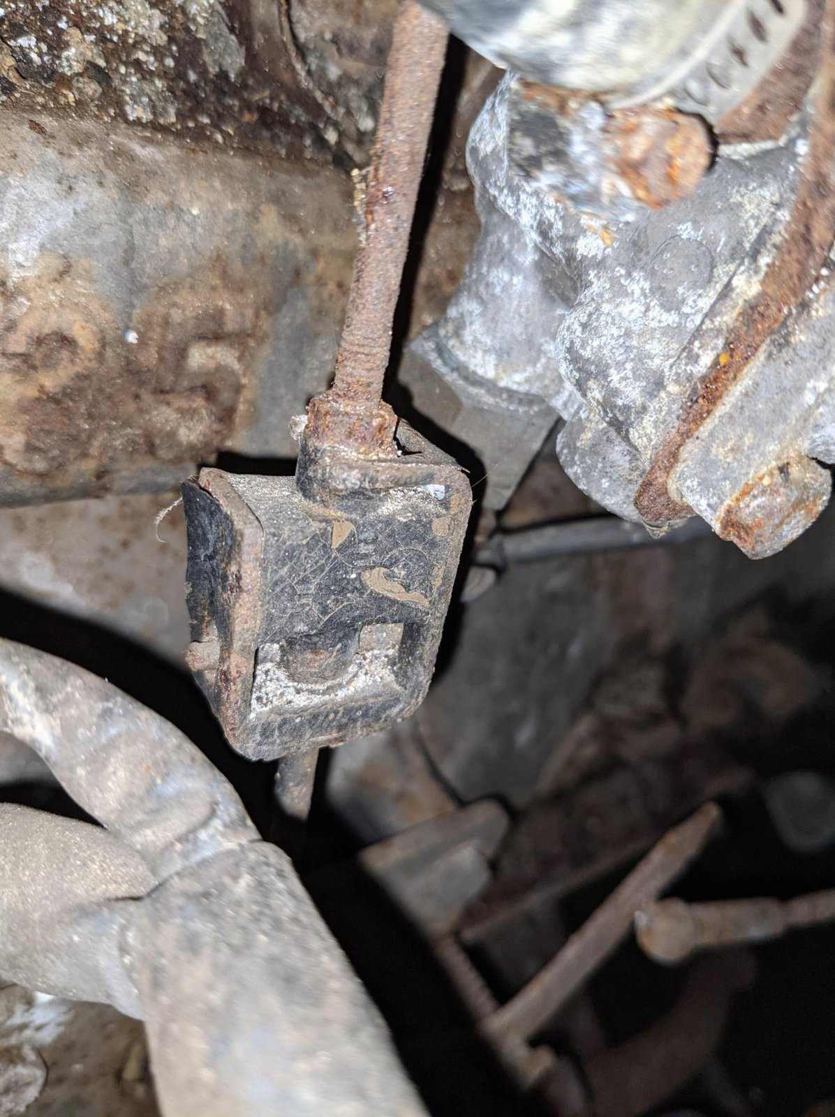

My take on that block is that it would be an m90 from a euro model 535i or 635 Csi. If you wanted to verify the actual displacement of the engine without separating the head from the block, you could take the pan off and measure the piston diameter/stroke from underneath. This is hard to do accurately without another engine as comparison but is do-able.
So the 3,5 marked on engine denotes factory replaced it?
There are two motors pictured in this thread, I was referring to Richie’s as being a 3.0 as you can see the stamp where the VIN would have been. Yours has a casting saying 3.5, it is a 3.5 motor, can you provide a pic where the VIN is?
What are the clues you are seeing in the picture that tells you that? Curious minds want to know. :) (and which engine picture are you referring to as "that block"?)
Most m90’s don’t look like the 3.5 pictured above. If it is an M90, it is a late production run.
I'm a rookie at this. What are you guys looking at to say it is or isn't an M90? How does the picture shown help differentiate an M90 from an M30?

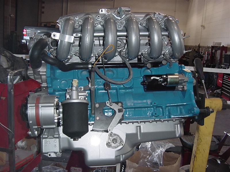

The m90 had a distinct horizontal water passage up until about late 1980. A few weeks back I referred a friend to an m90 donor built in 02/81. It is a motronic m90 and doesn’t have the water passage. Hence my point about “unless it’s a late model”...
The car I’m currently wrenching on is from late 1979 and has the water passage as visible below. The Seattle motor may be for sale btw @Dick Steinkamp if you have a change of heart. The dogleg is gone however. ;)
Hard to see in this pic but the horizontal passage protrudes a good 20mm+ from the block. It runs the length.
Here is a random forum pic of an m90, note the water passage:
