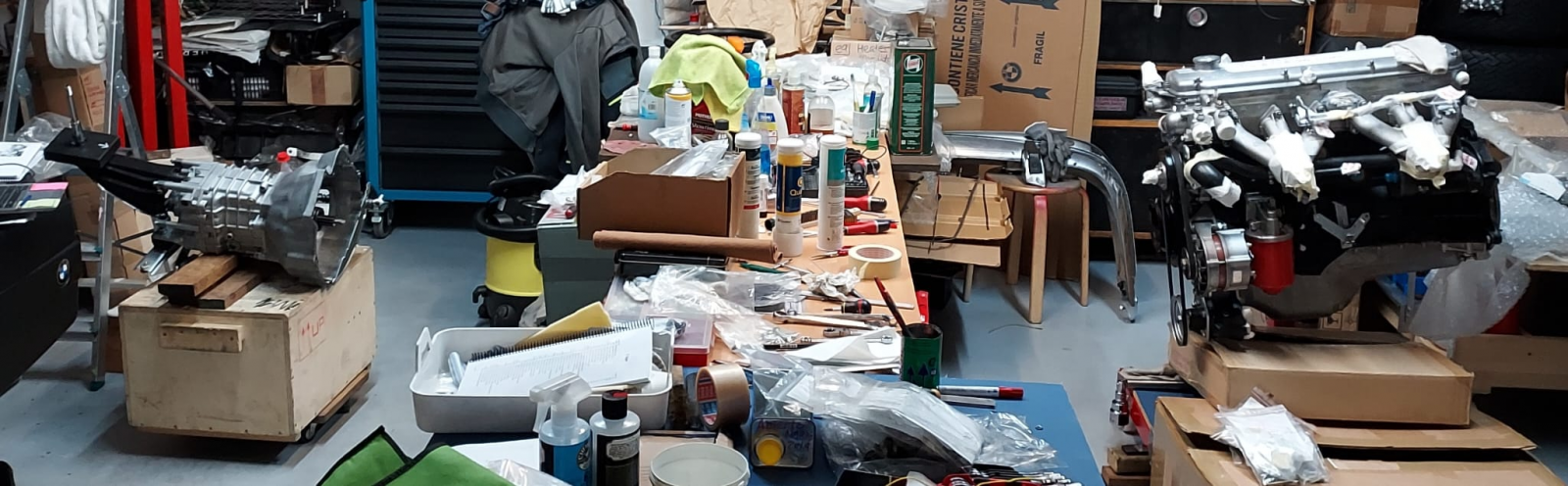

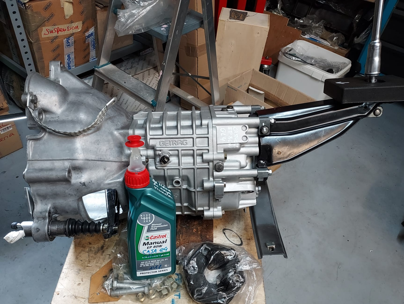

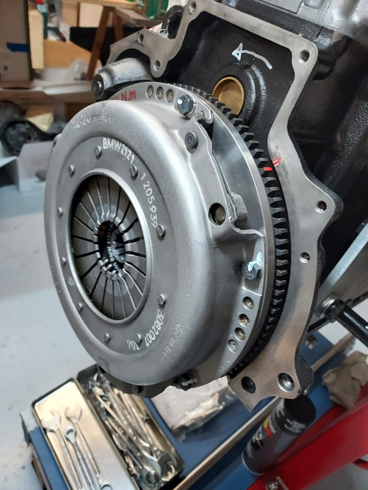

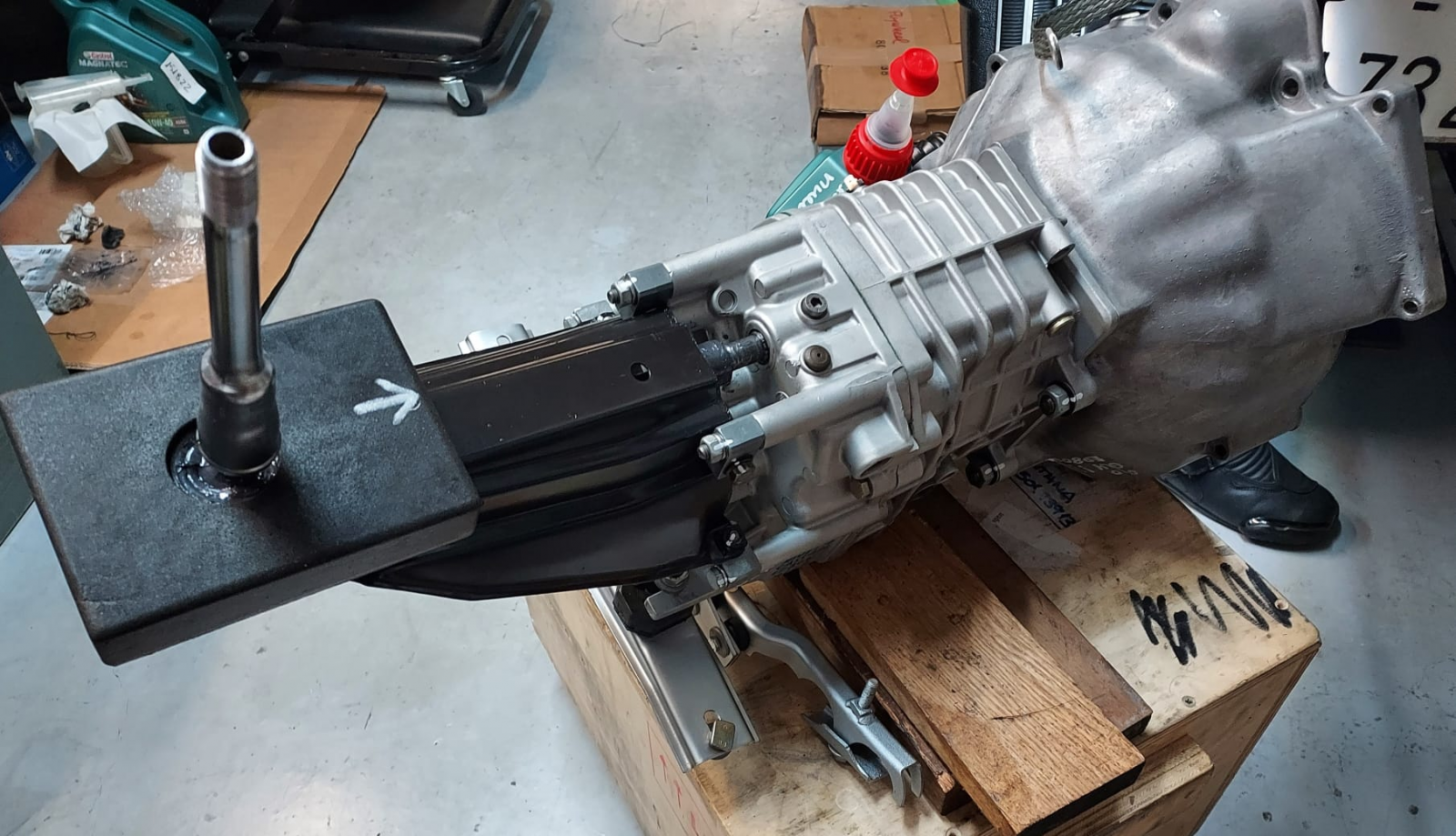

renewed gear box ready
the love song...

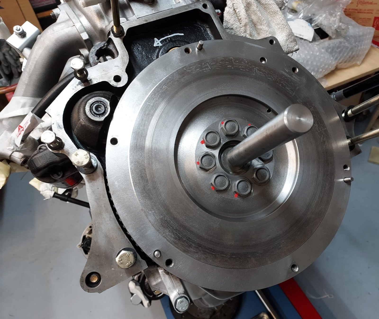

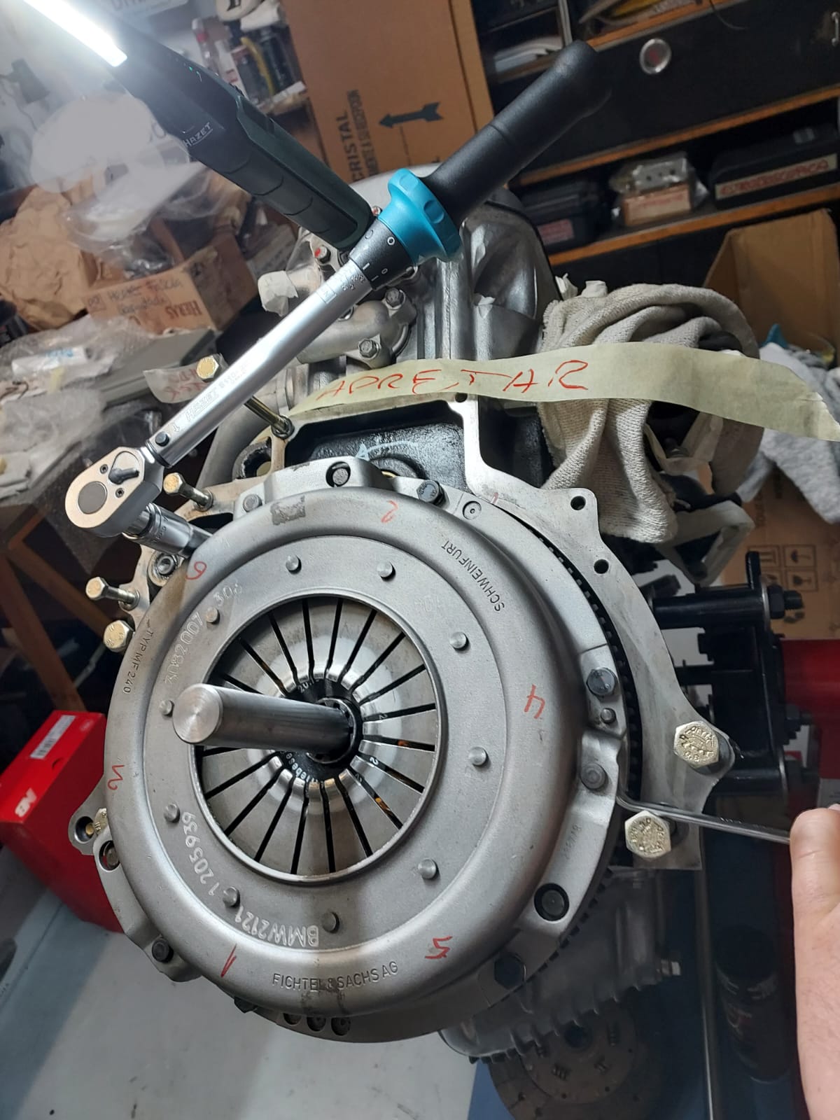

first start >2 years

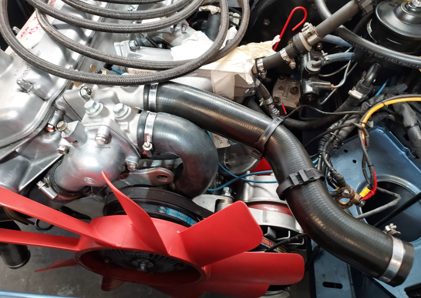

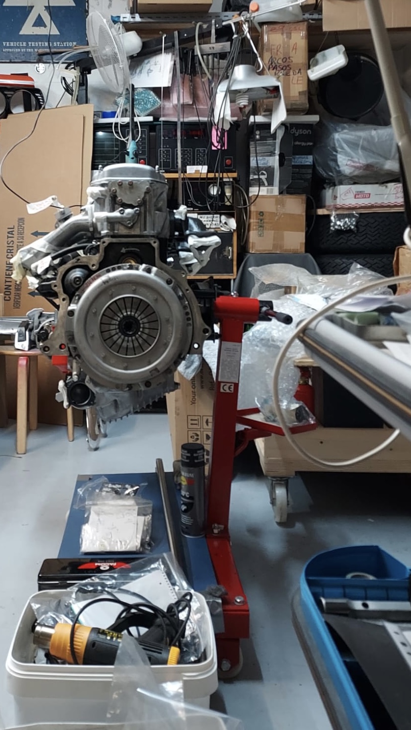

full renov engine and carbs;
(engine and head dissasembled and reassembled in house after shop machining)
valve gap set at .25
static timing
+ dynamic by means of strobo light and ball mark
+ carbs synchro
+ CO% pending
pretty smooth
smoke of all new paint on exhaust pipes will be subsiding in next starts
...proud ! :cool:

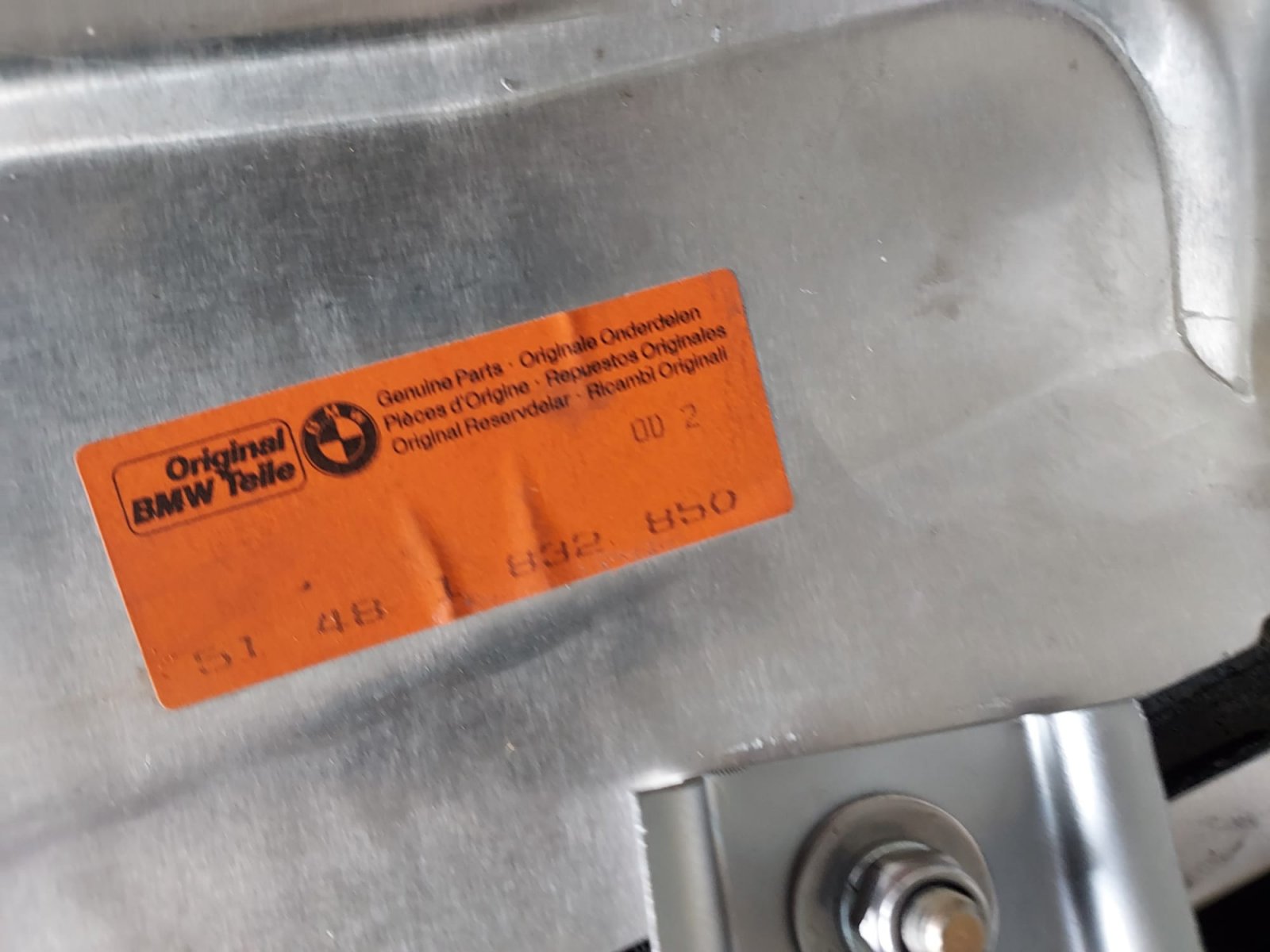

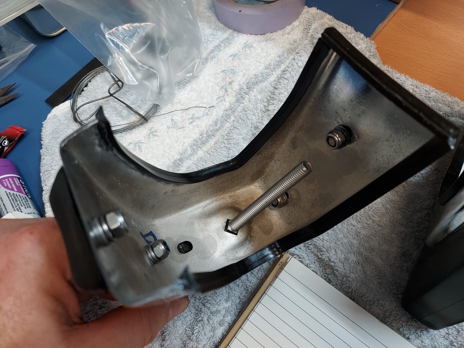

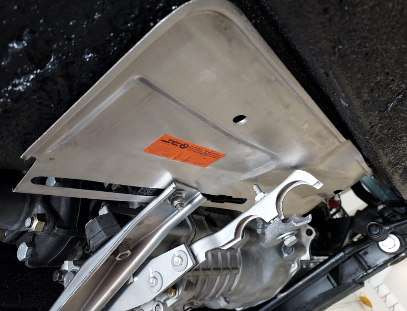

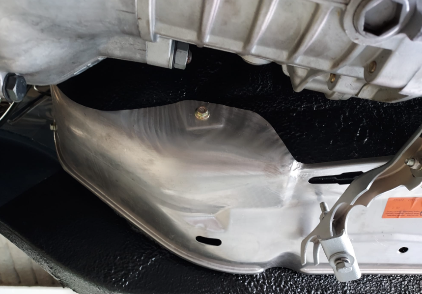

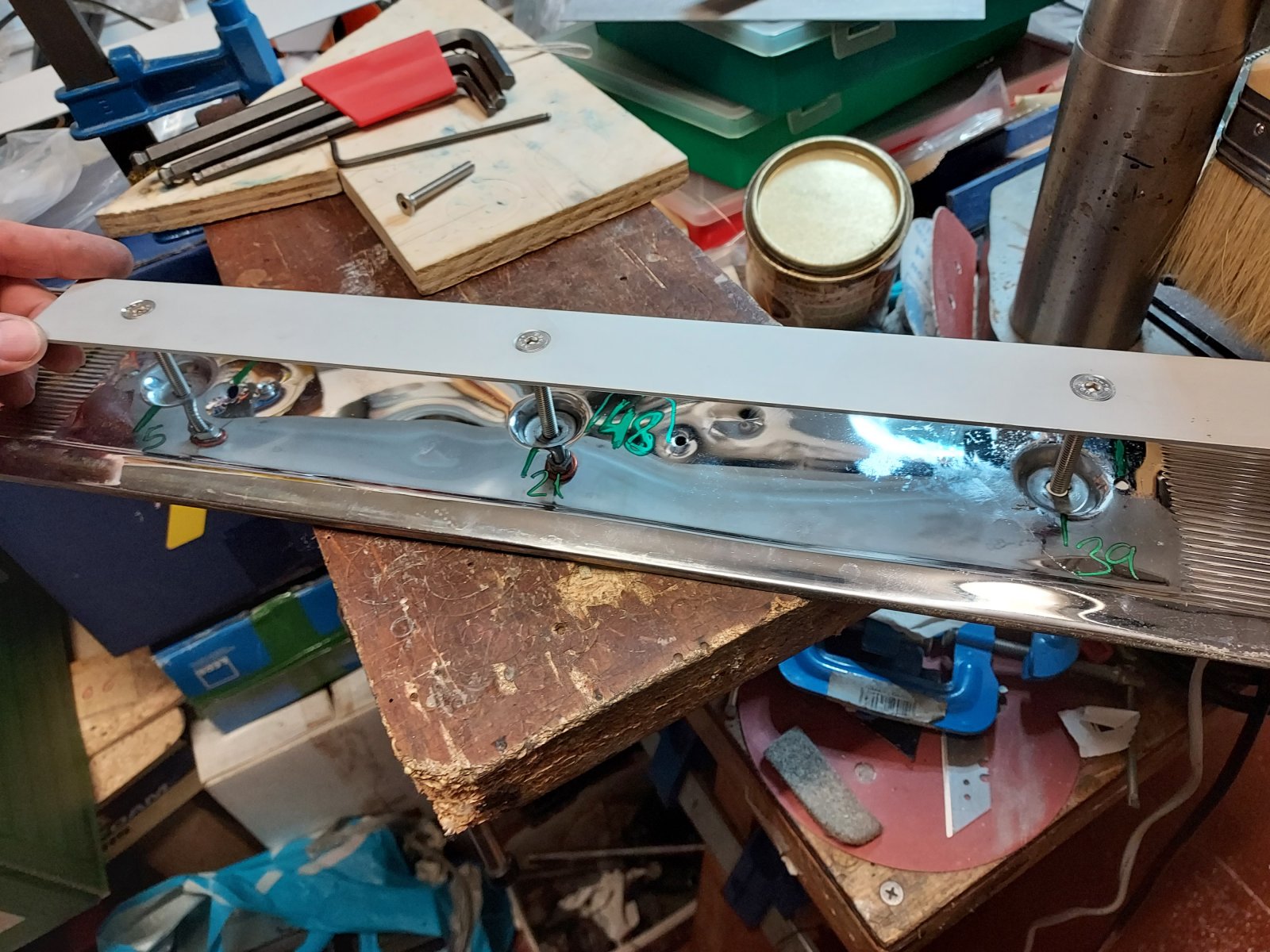

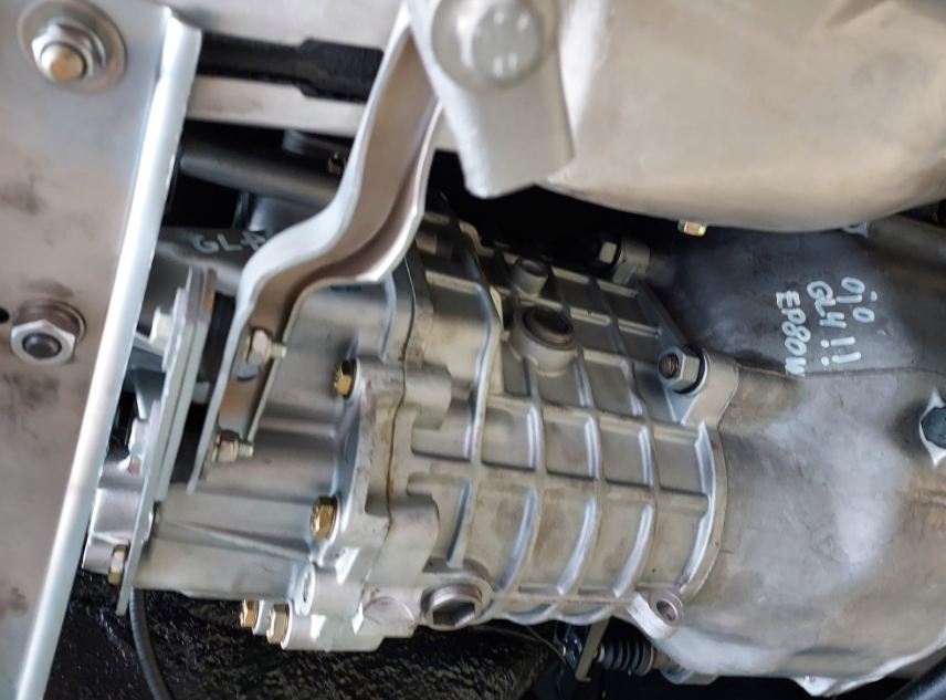

51481832850 es para E12 E24 E28 como hiciste para que te ajustara en el túnel del E9?
hola Alvaro, muchas gracias por tu interés, por respeto a nuestros colegas de otro países te responderé en inglés.
the mentioned part follows the body shape very well, the only thing that you must provide is two welded studs in order to fix it to the body, the third fixing point is the slotted side that follows the body channel that holds the gearbox support
that is all

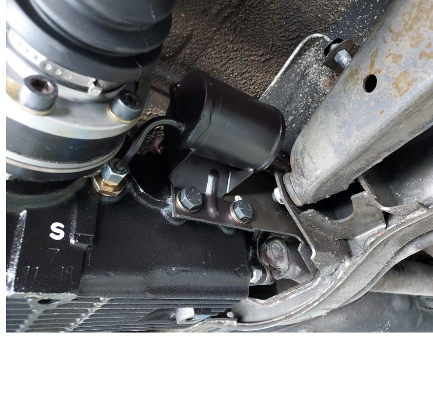

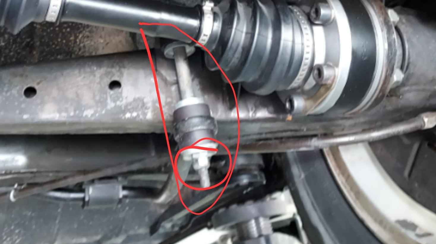

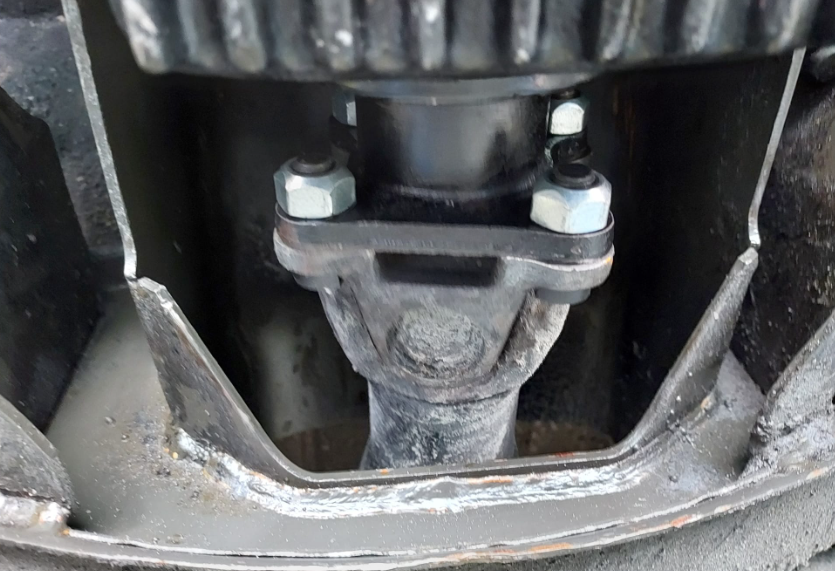

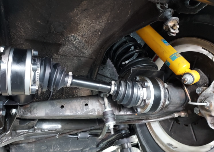

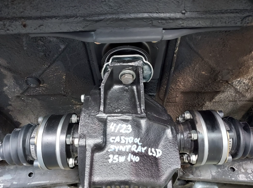

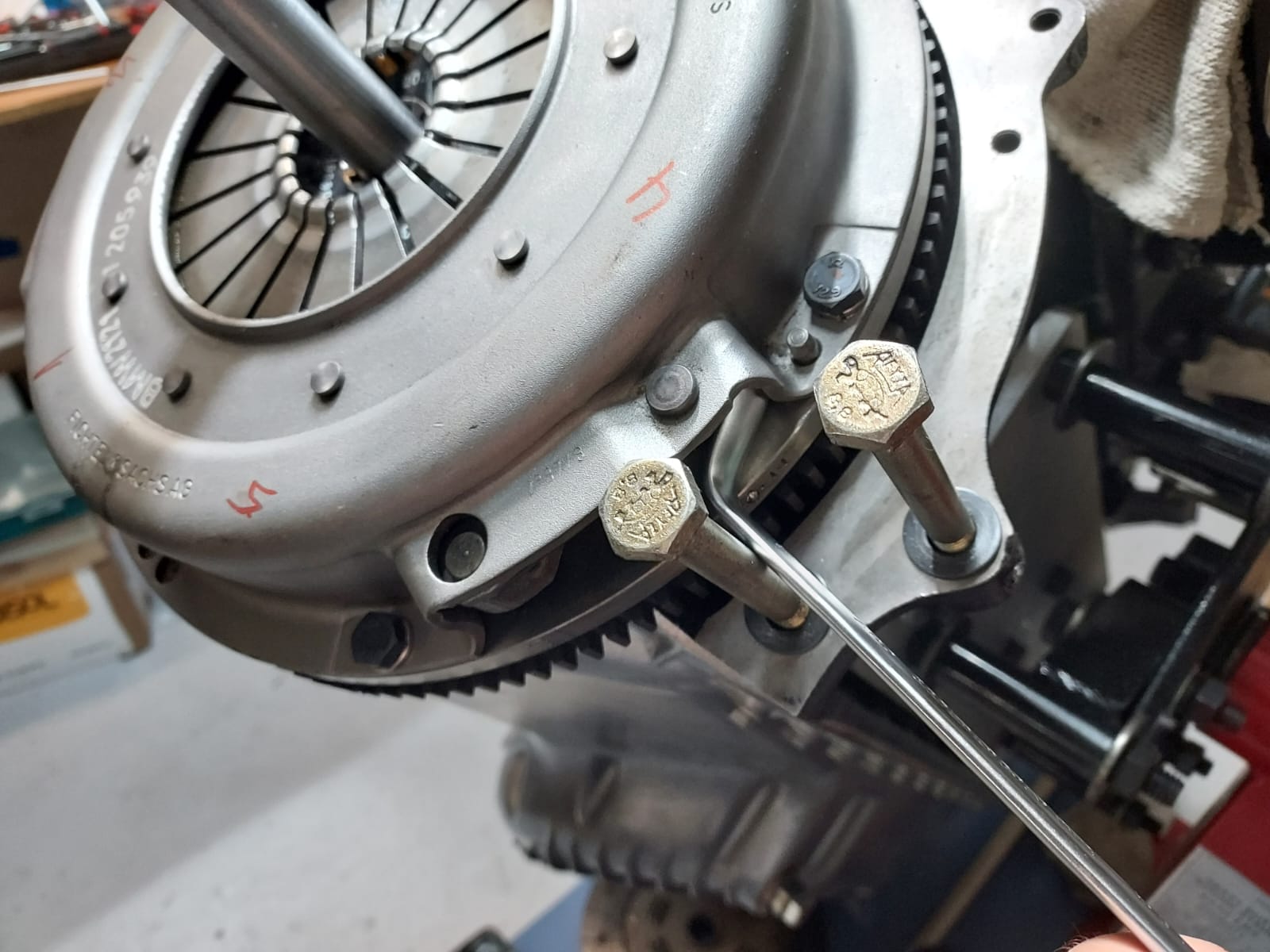

Just something I was pointed to when I assembled my rear axle.
The threaded end of the bolts of the torsion bar are now pointing down, and may catch things while driving. If you flip the bolts upside down, it's better.
