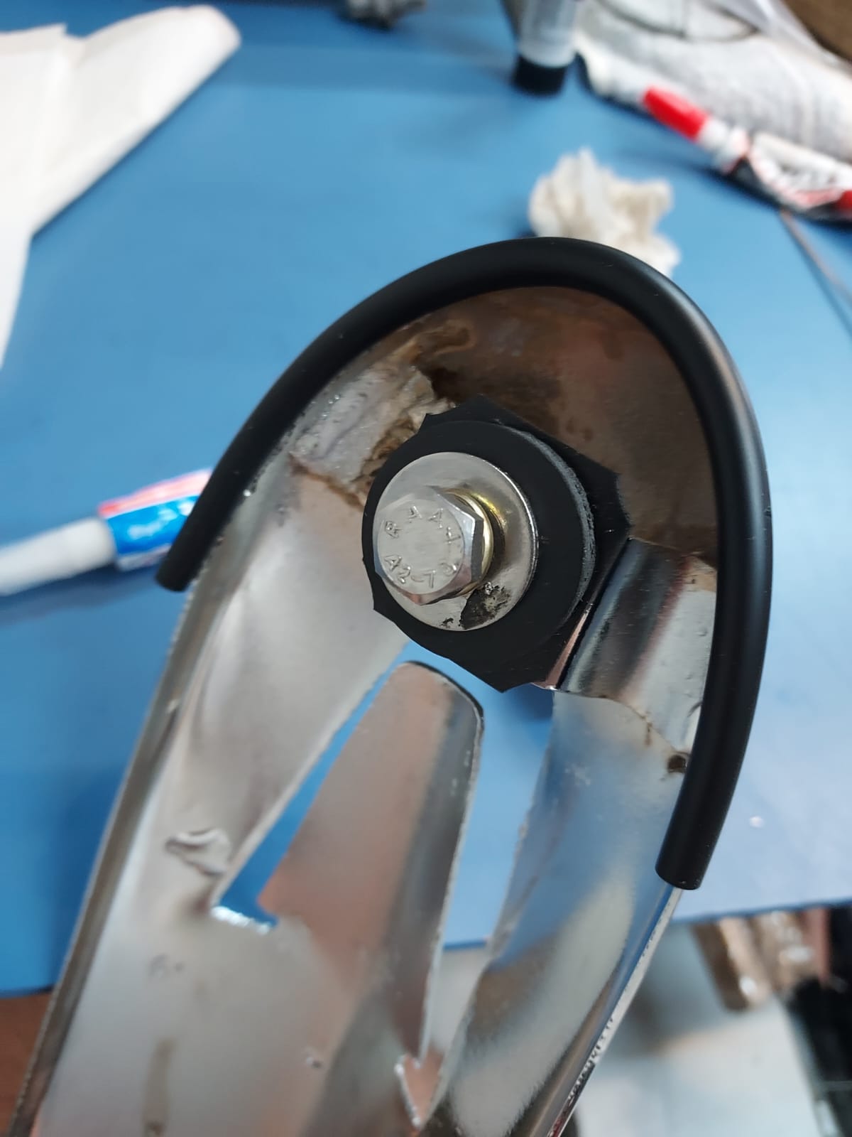

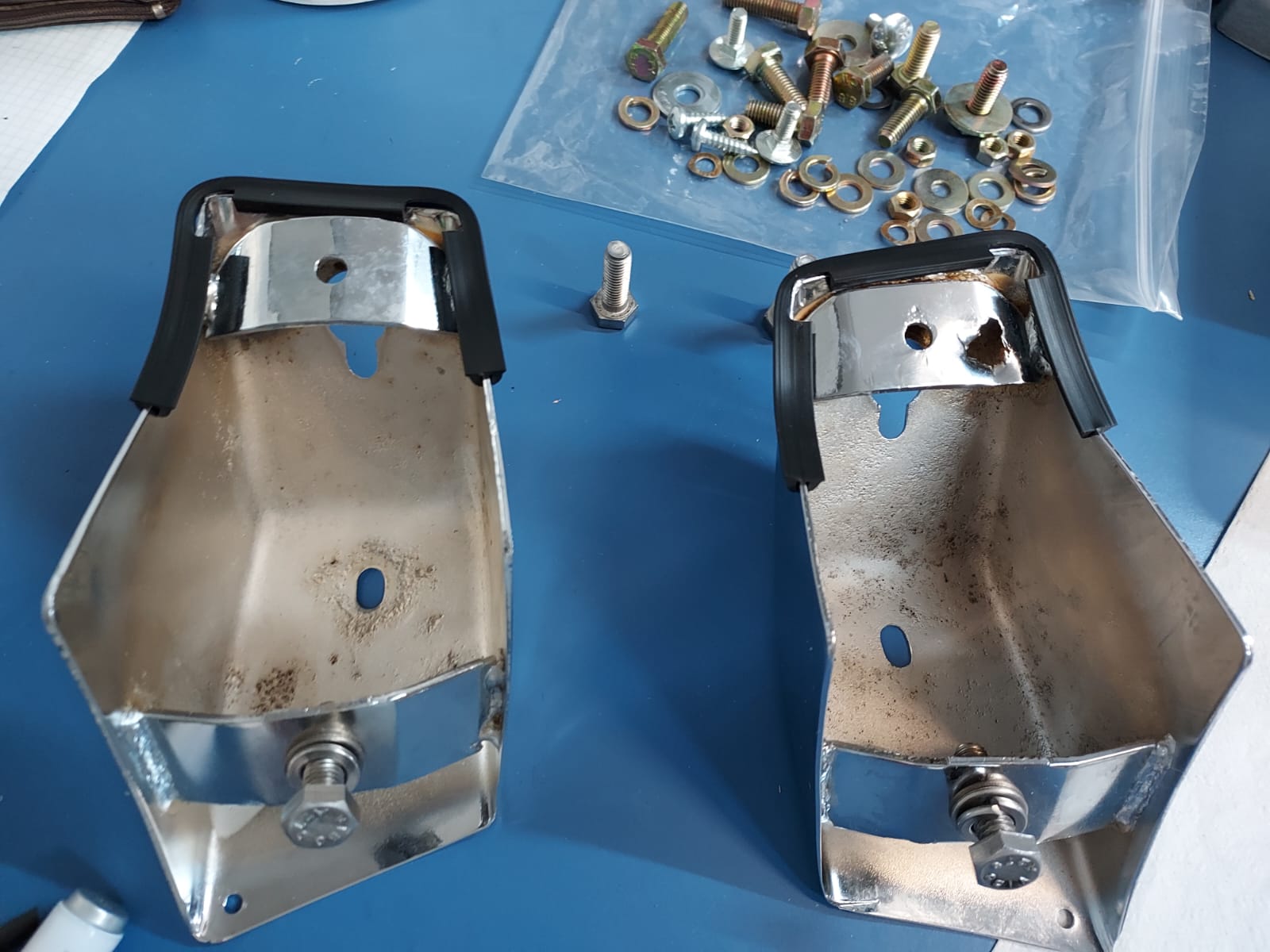

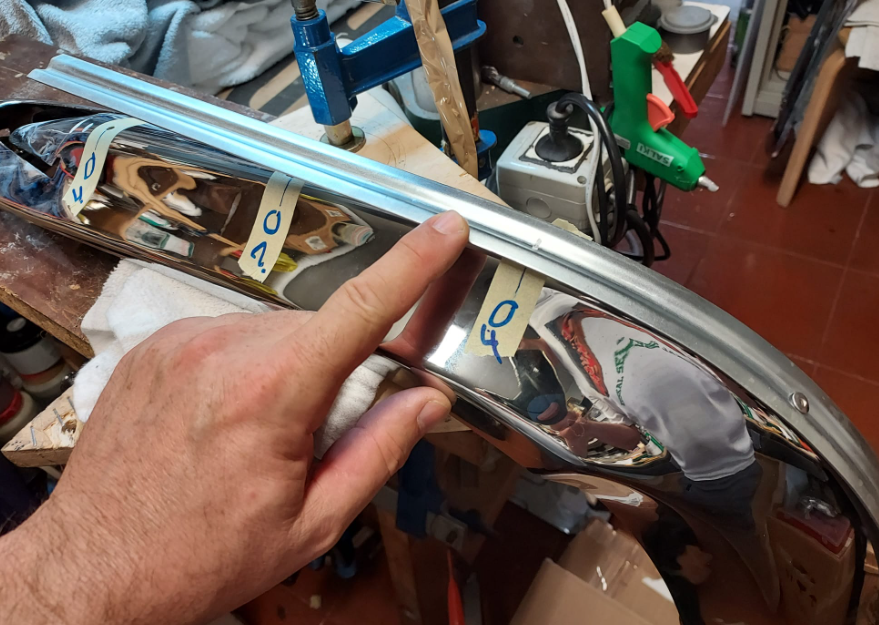

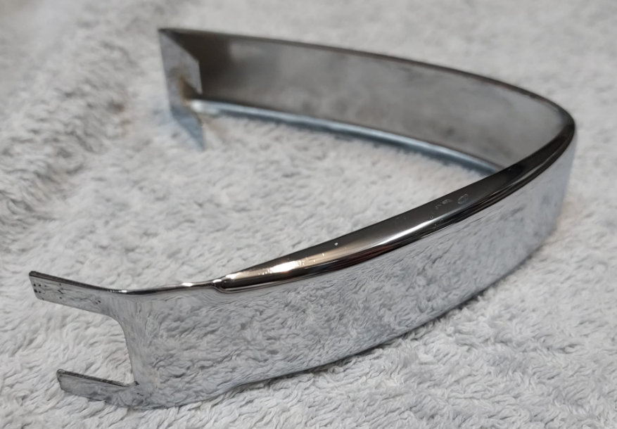

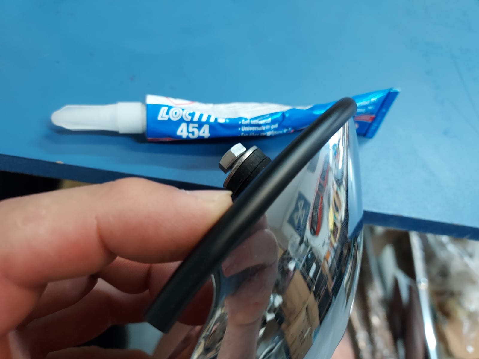

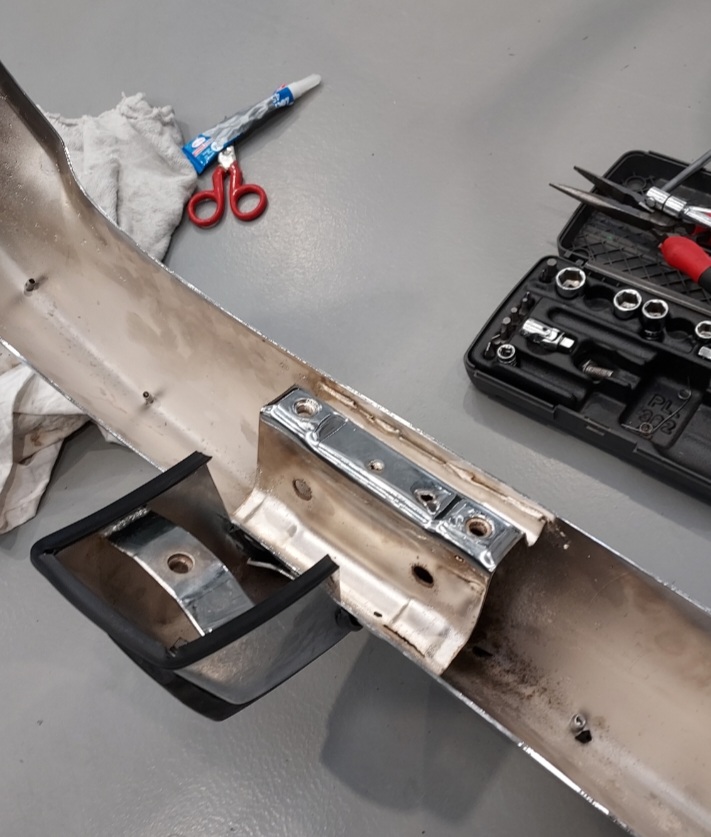

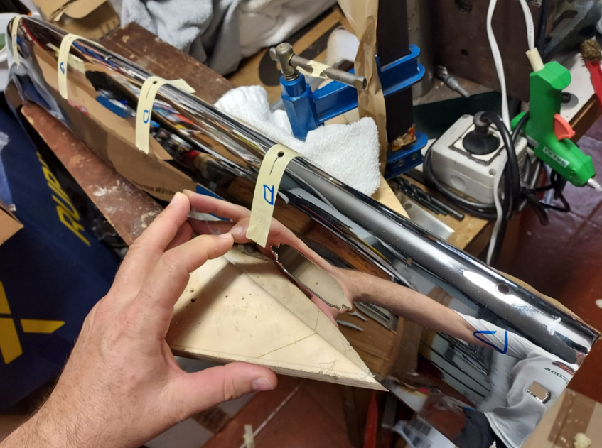

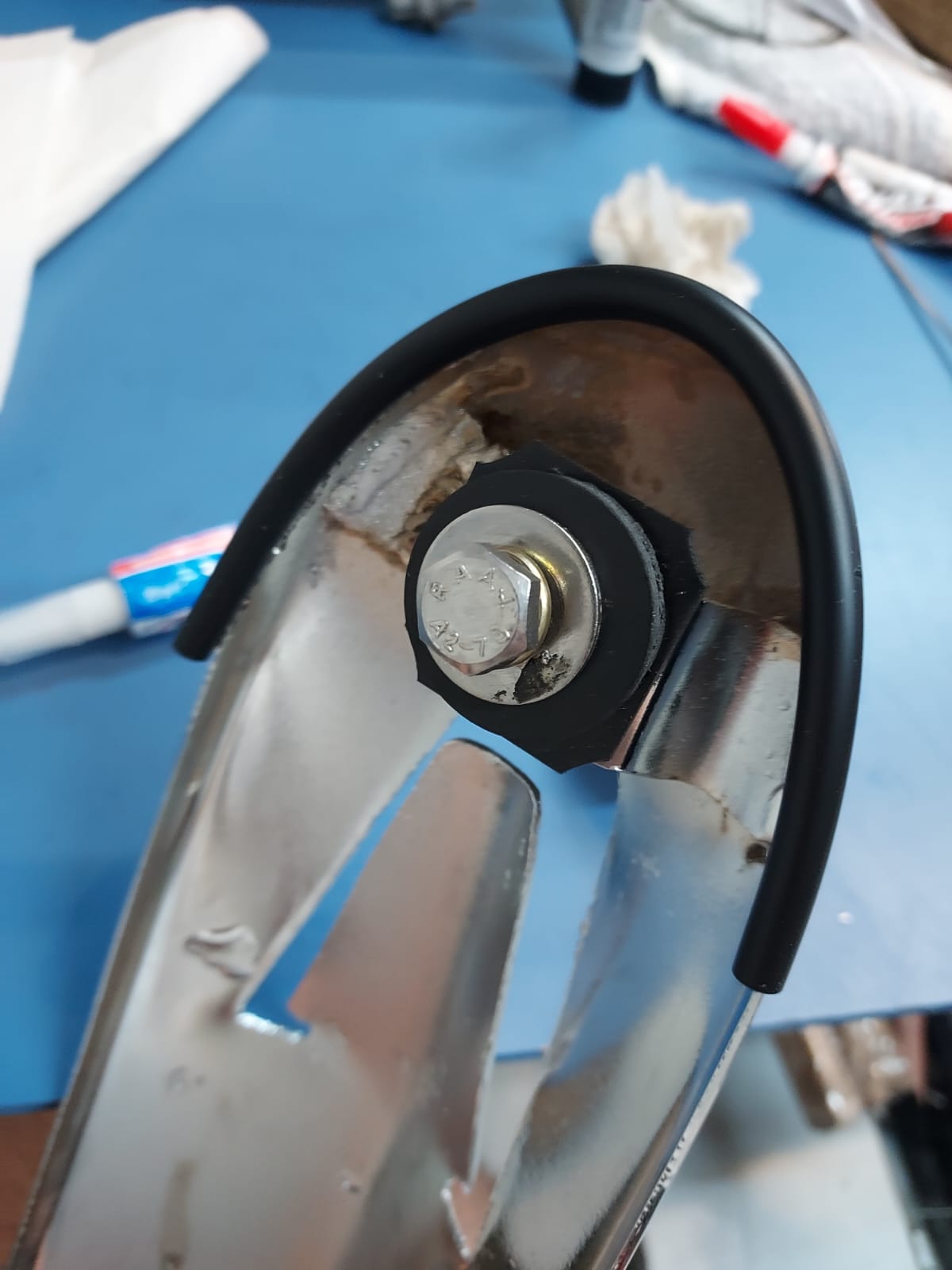

rubber plastic corners glued using cyano gel
best way to avoid defects is to glue only in the inner side

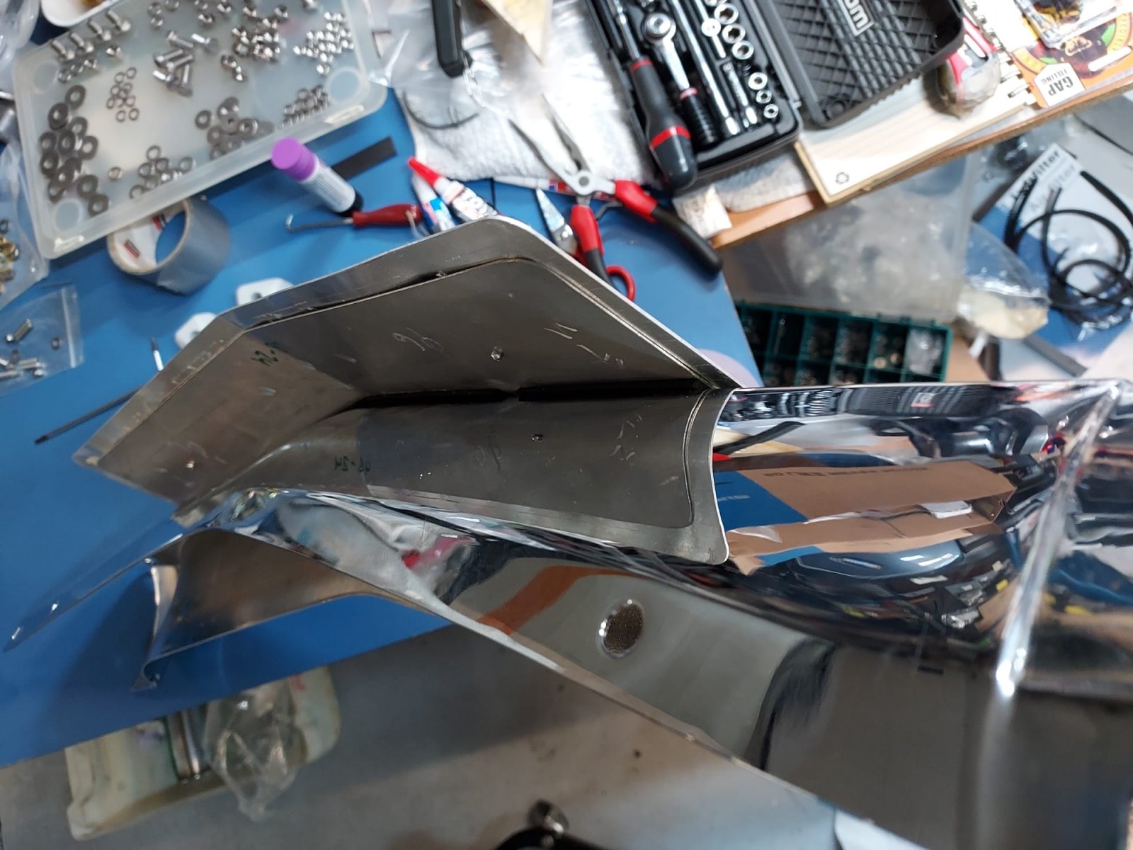

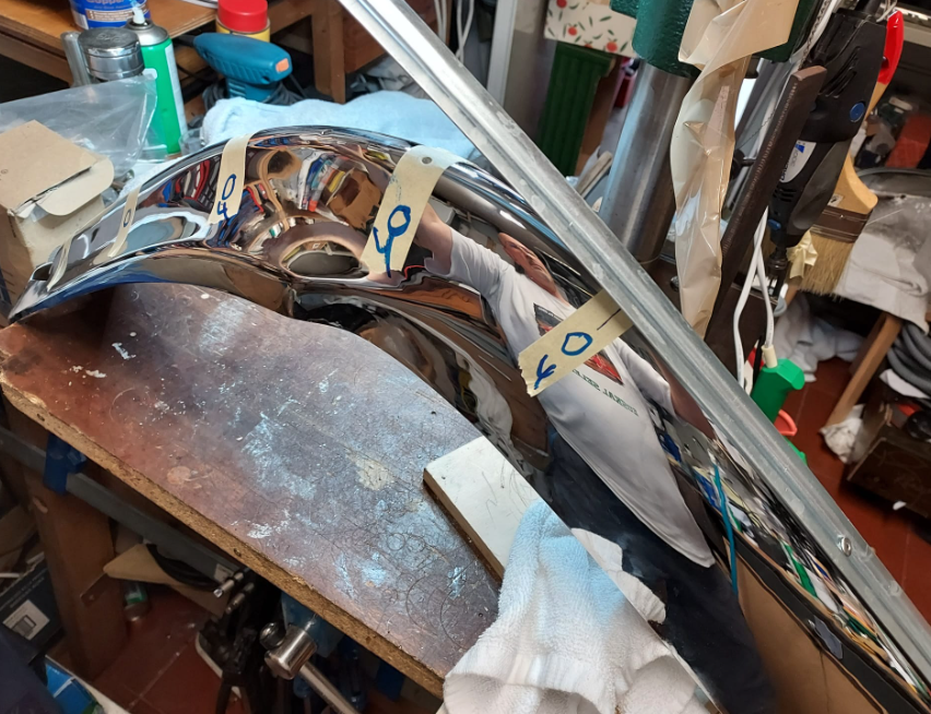

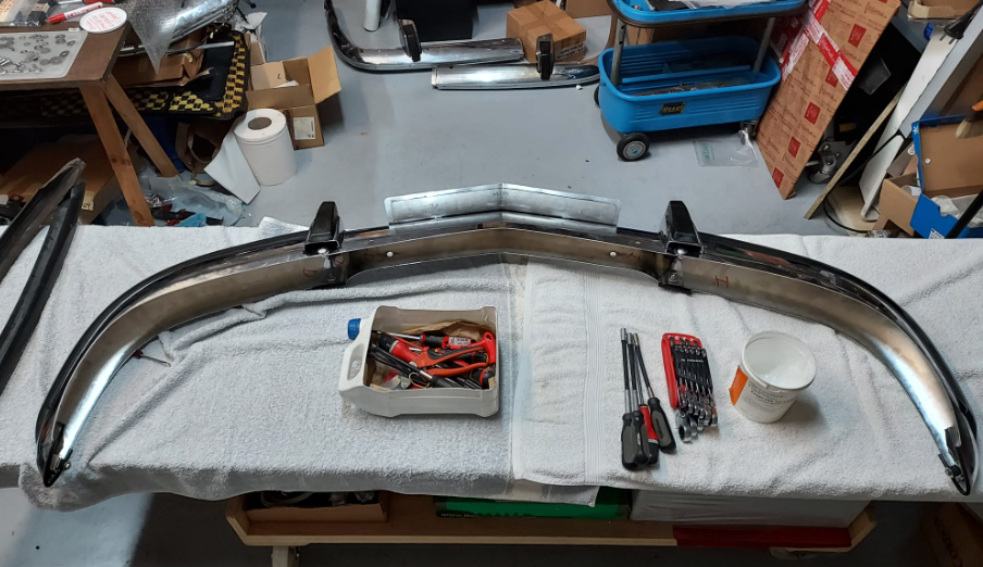

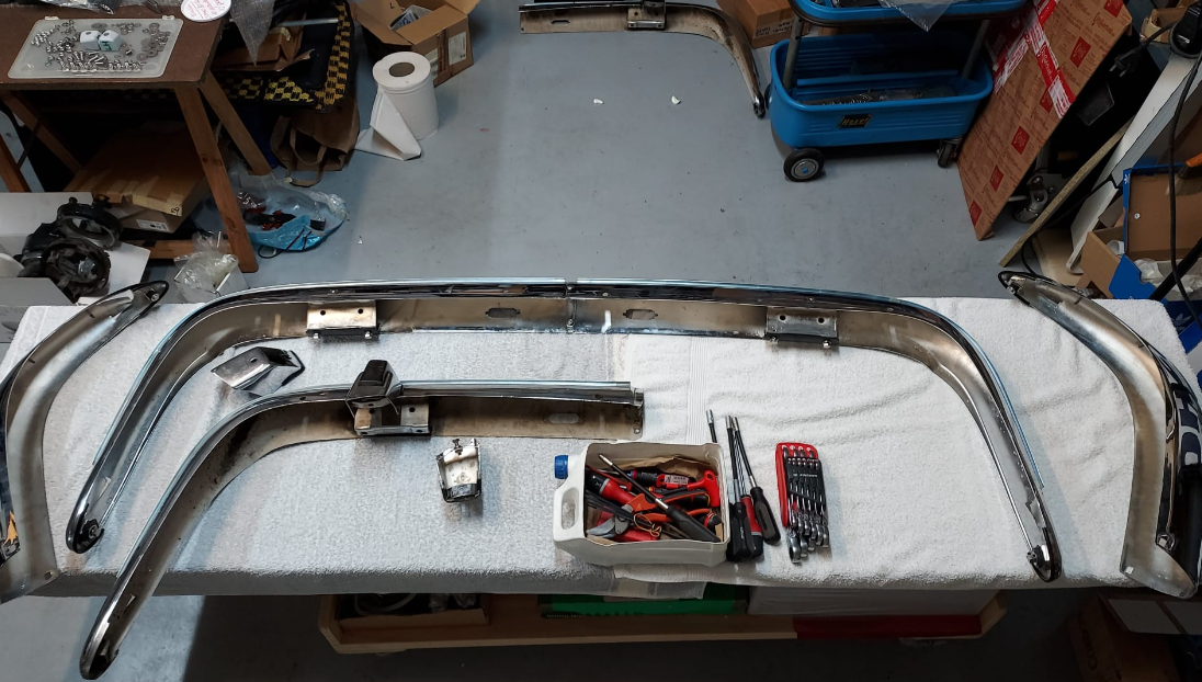

the bumpers job...continuation

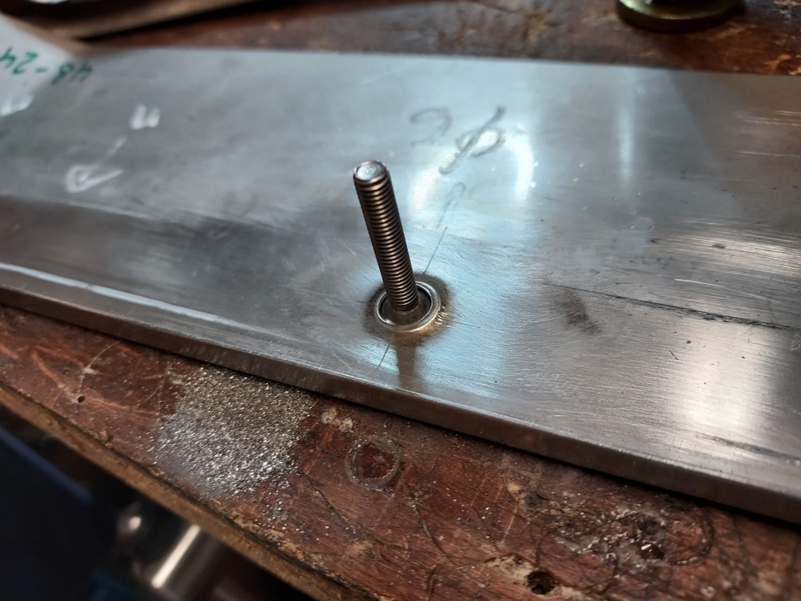

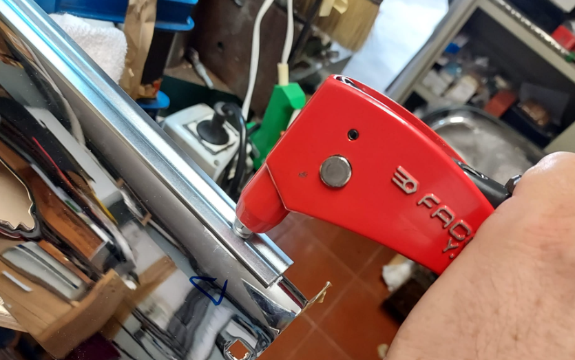

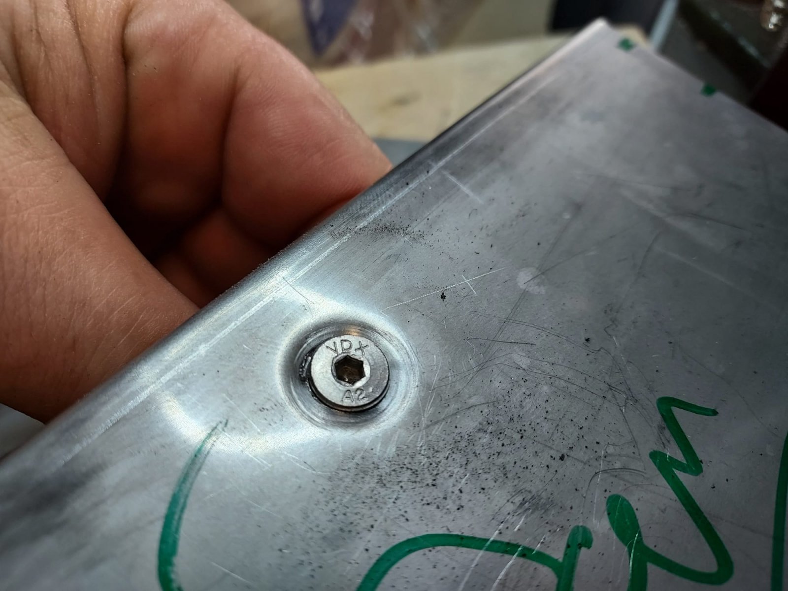

using 4mm SS rivets

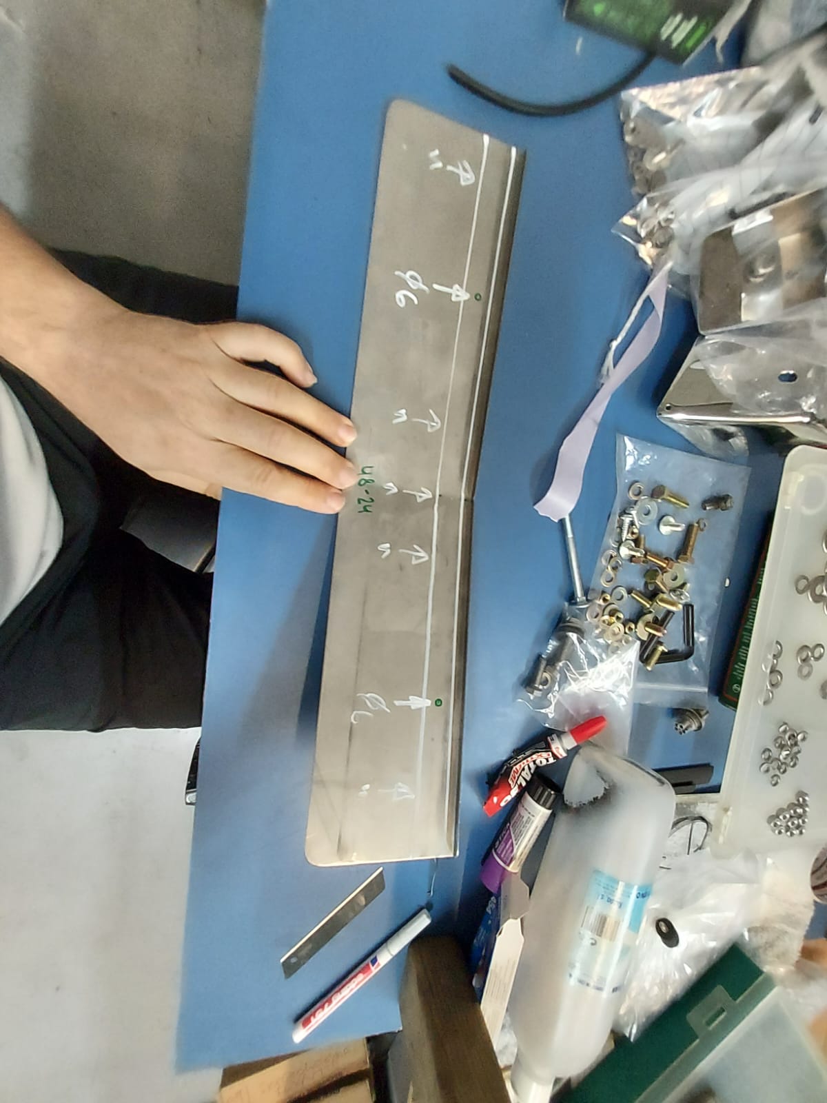

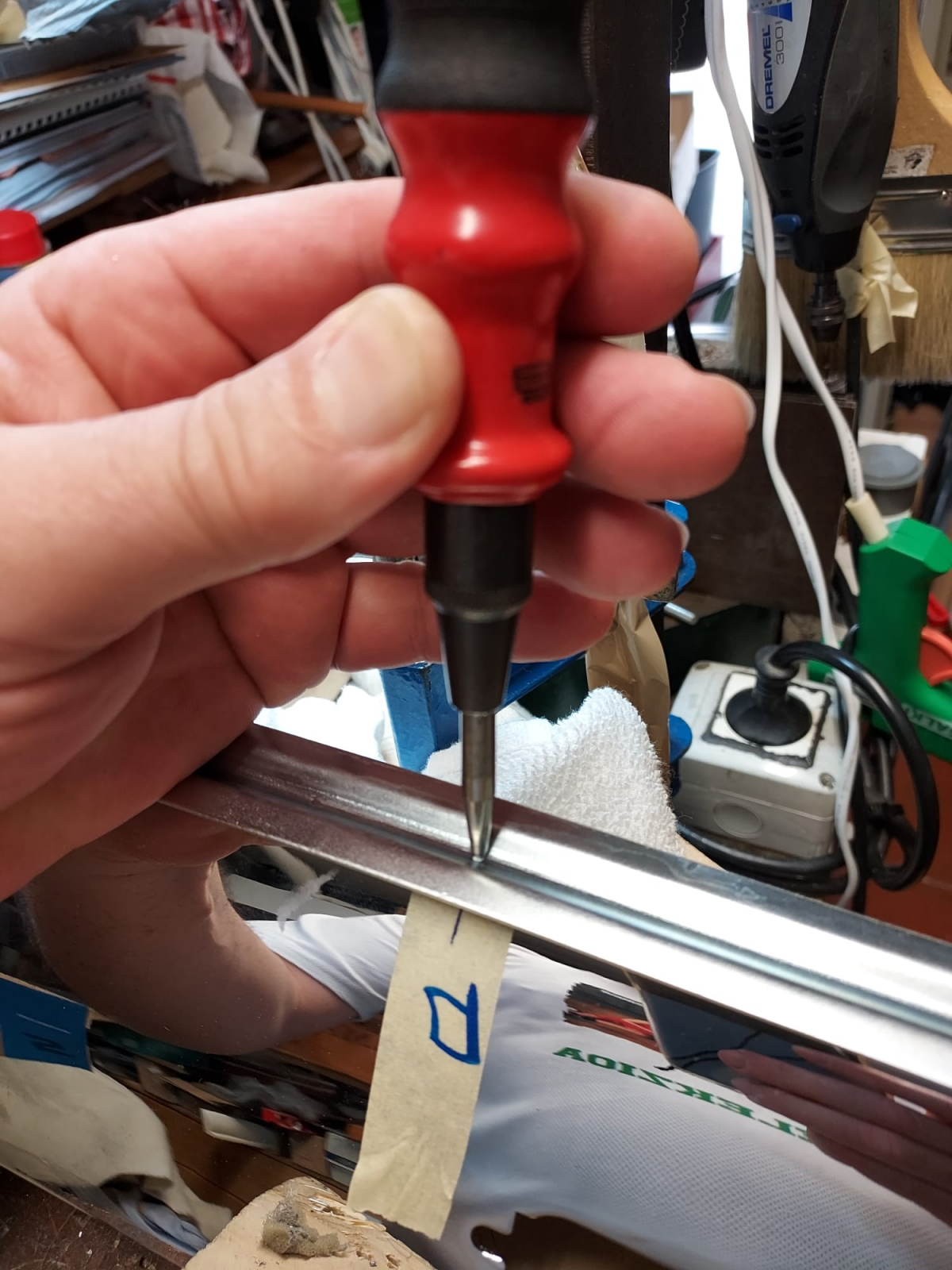

mark the position of the holes, and make the first one, start center and move towards ends
mark, punch, and drill
adapt the shape
and fix with rivets

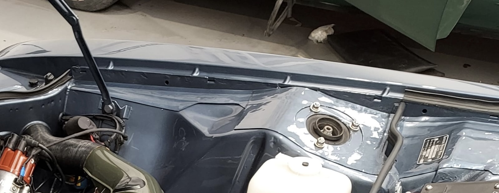

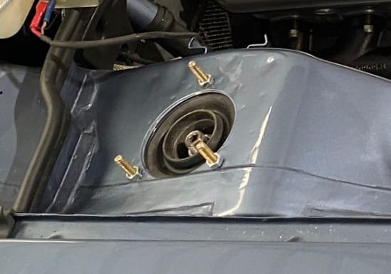

A way of solving the concern about the replacement of sound deadening pads
once you consider a repaint,these pads might be an obstacle your first thougth might be to put them as the factory did, glue them to the body-in-white and then spray the paint over them, but this will create the same problem as the one we know our karman product has
the other option is not to install them
a third possible option is to paint two times, first paint the body to ensure the rust proofing of the sheet metal, and then paint the pads themselves
here we go:
and then separately paint the sound deadeners
finally place the sound deadeners on top

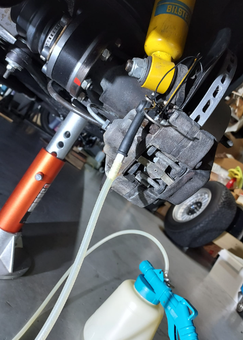

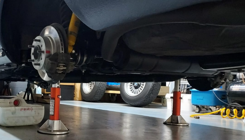

a good session of brake bleeding: for a second time, as first did not get to brake too well
also bleed the clutch
