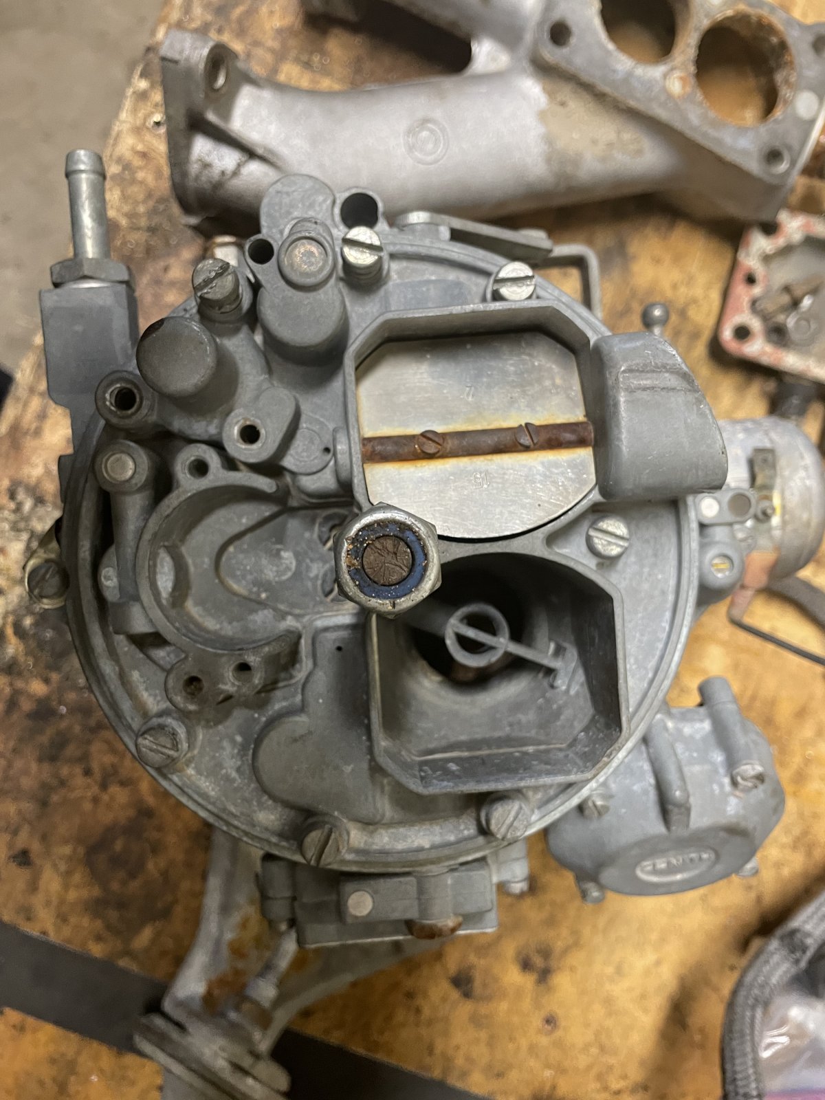

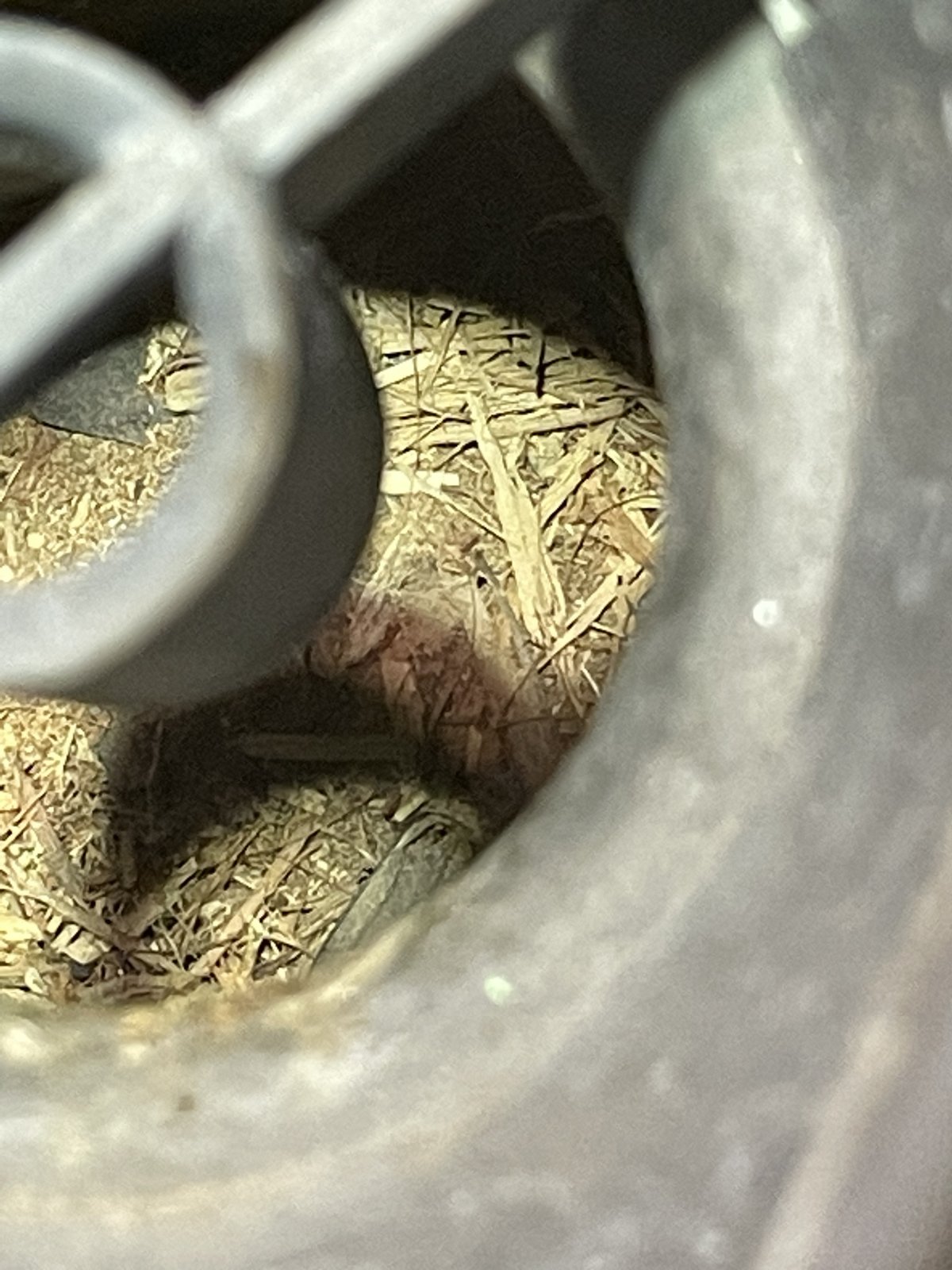

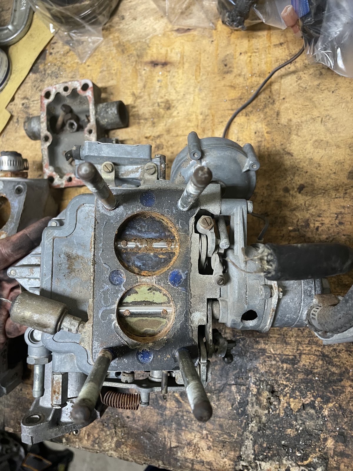

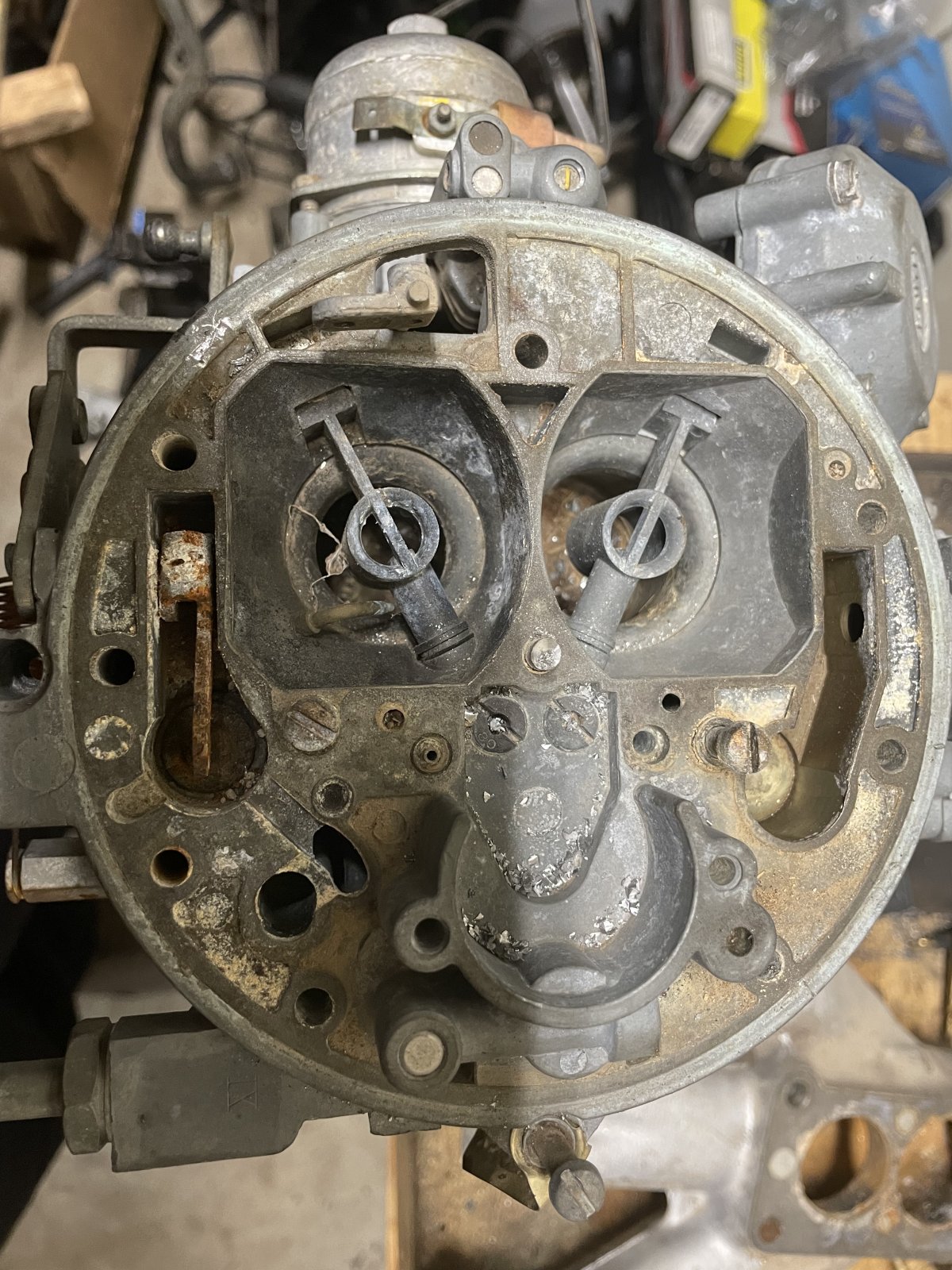

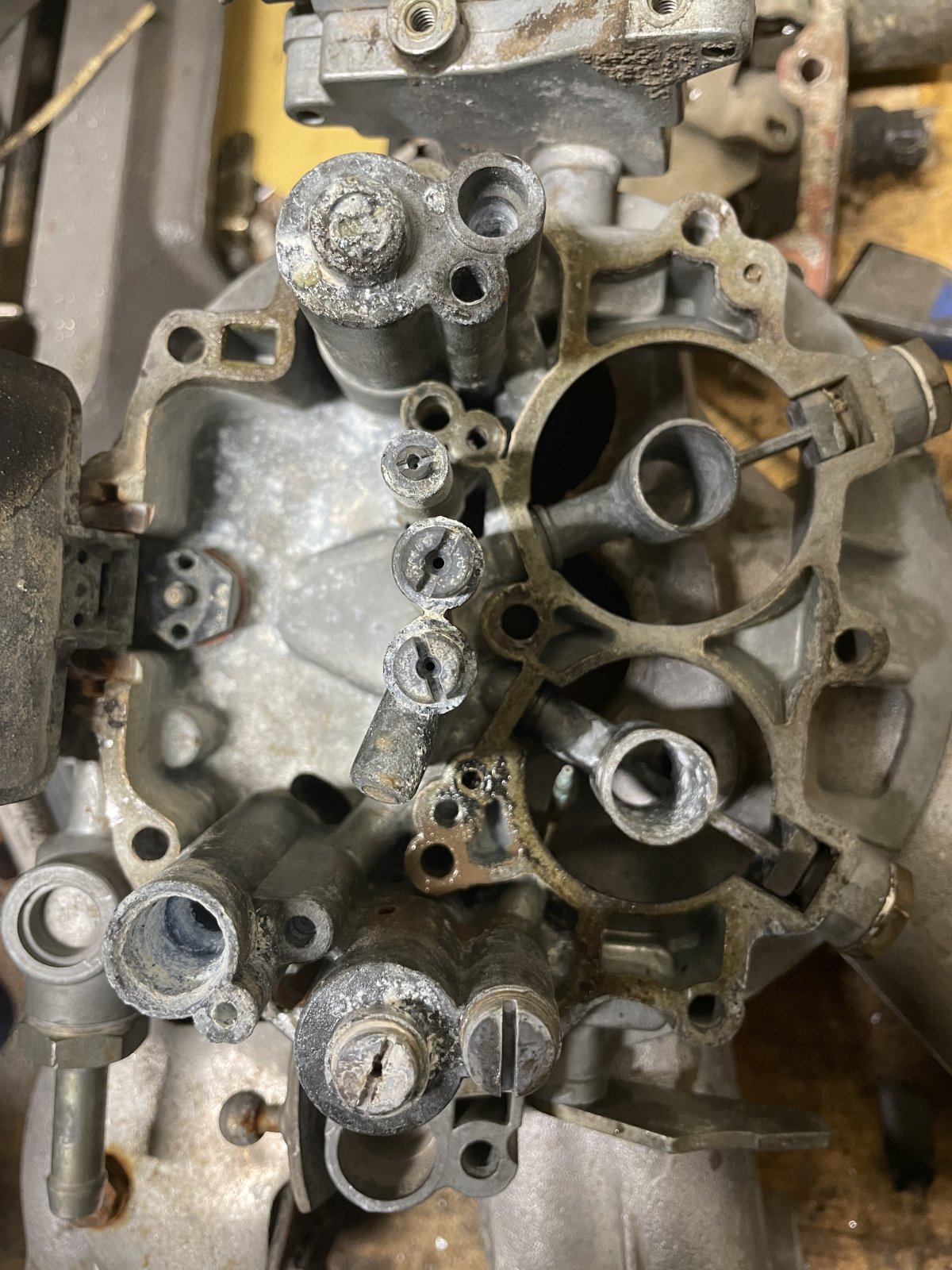

And here some pictures showing the condition of the carbs I got. They do not look good and not sure if they are worth rebuilding…

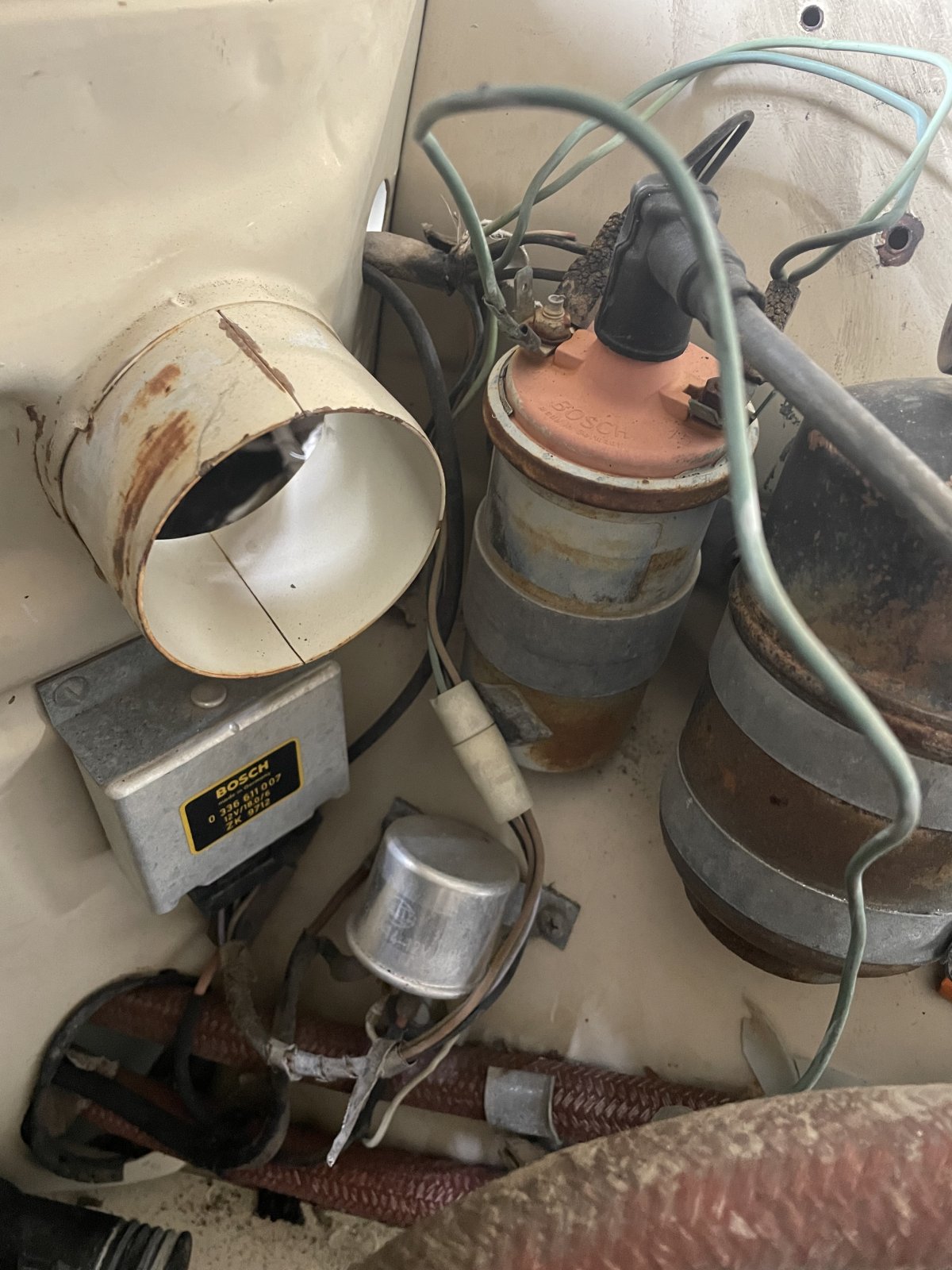

I have #1,2,3,&5
I am missing #4,6 and the upper timing chain cover. I do have the worm drive that attaches to the camshaft but not sure what I need to make fit the b32 camshaft.
I also have the mechanical fuel pump but that is not going to be useful i think.
I might have read somewhere that I need the original engine thermostat housing to clear the carbs but not sure if I miss read that or confusing things as I have been doing a lot of readings. Anyways, i have that too.

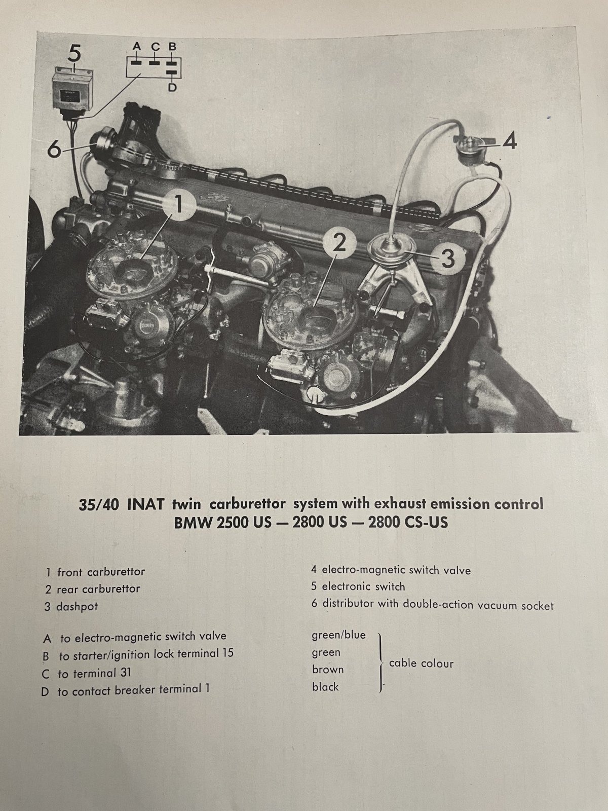

You don’t need 3, 4 or 5 either, just smog related stuff. Remove that wiring to/from the box (speed relay) and vacuum hoses.

As to carburetors, I think you have a couple of options. First, you could perhaps rebuild the Zeniths you have, but they don't look great.
Second, you could hunt down a set of Zeniths that are in good shape. Loks of people took these off their cars, so there are probably some around. I gave away a pair last year. If you go this route, however, you probably want to hunt down the BMW tuning data for the 3.3L, which used the M30b32. Zeniths tuned for a M30b30 may not work well on a M30b32.

Thank you great info! I am first pursuing the zeniths if I can find a set with reasonable price. I could attempt rebuilding the ones i have but there is a lot of corrosion and some of the valve screws stuck.

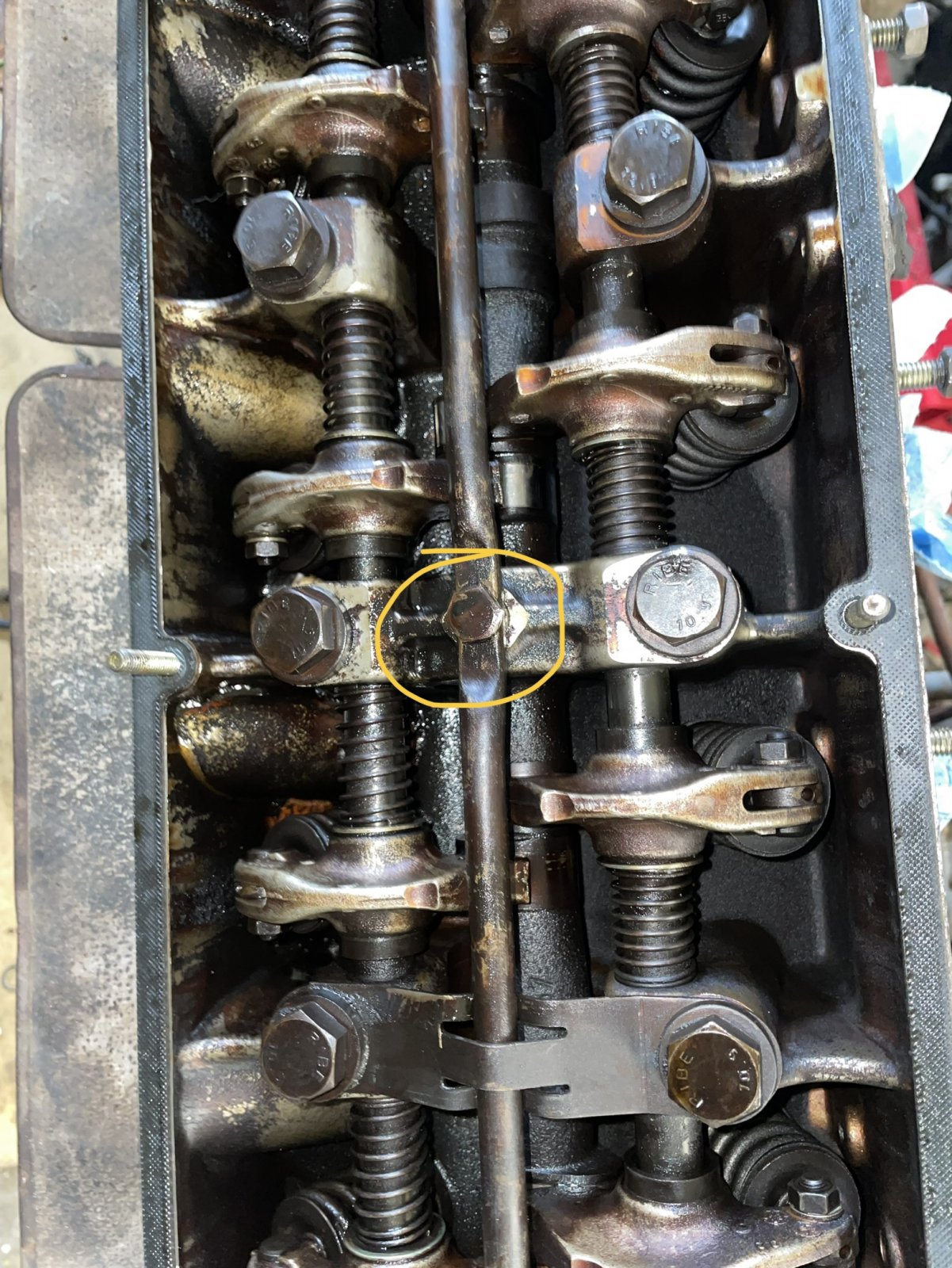

2. Valve cover off pics
This bolt was loose:
