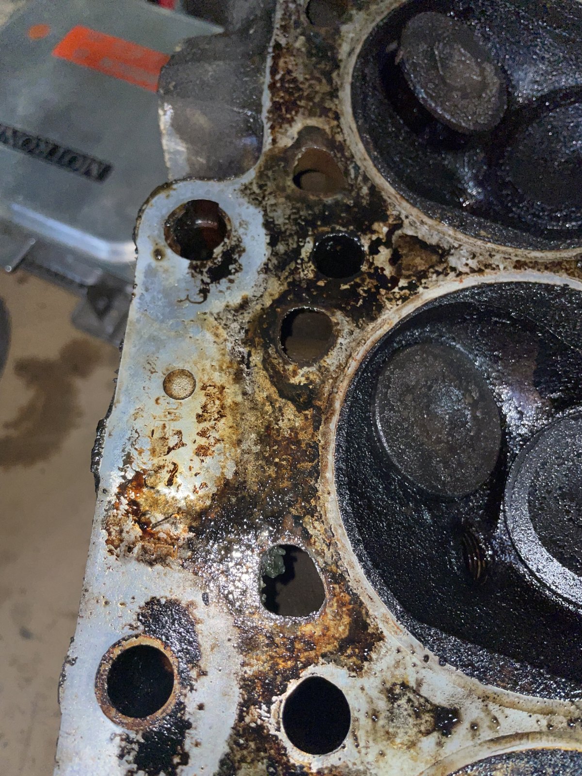

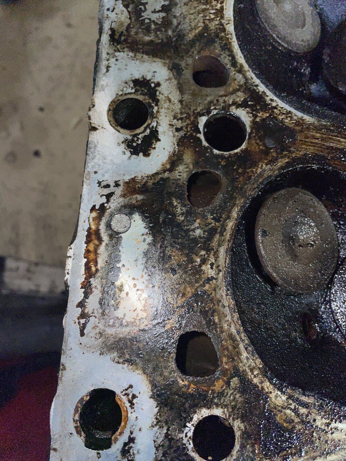

Post a pic of underside of head, are the two shallow dimples still present on intake side? If not it has been cut to minimum thickness. If they are there and you keep it, take it to a machinist to pressure test for cracks, if good then clean up valves, replace any bad valve guides and all valve stem seals. If you go b35 then use the b35 head as ports are larger and it has dual valve springs. The loose oil pipe screw might still be okay, if it fell off you would lose oil to the cam and rockers.
The oil screw was there just loose enough I could turn it with my fingers.
Here is the underside of the head with pics of the dimples, I think…

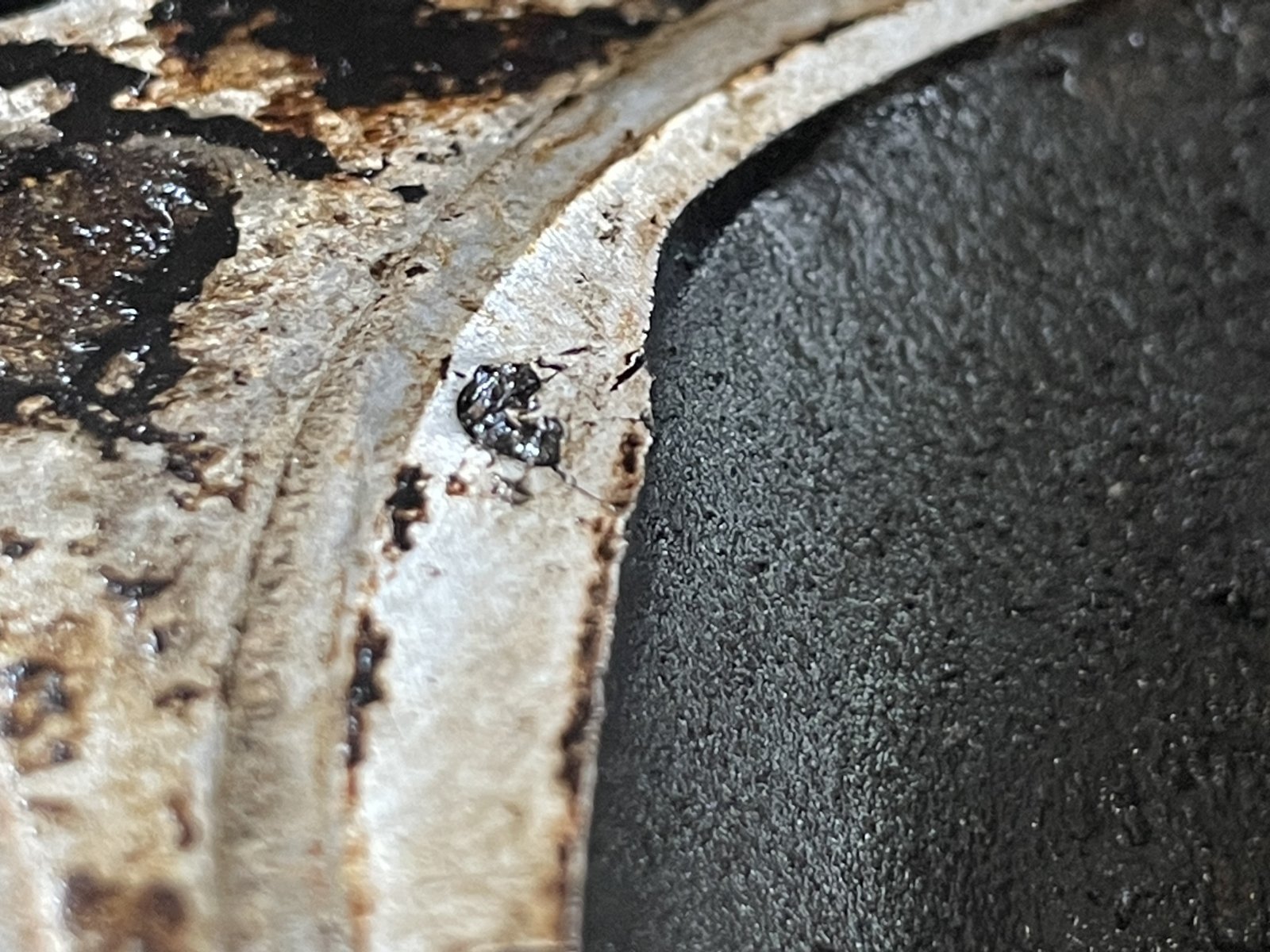

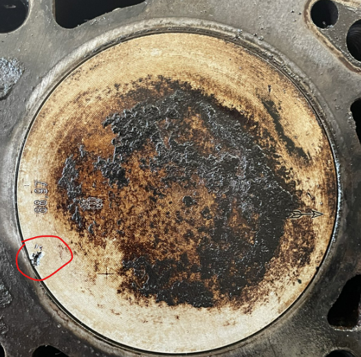

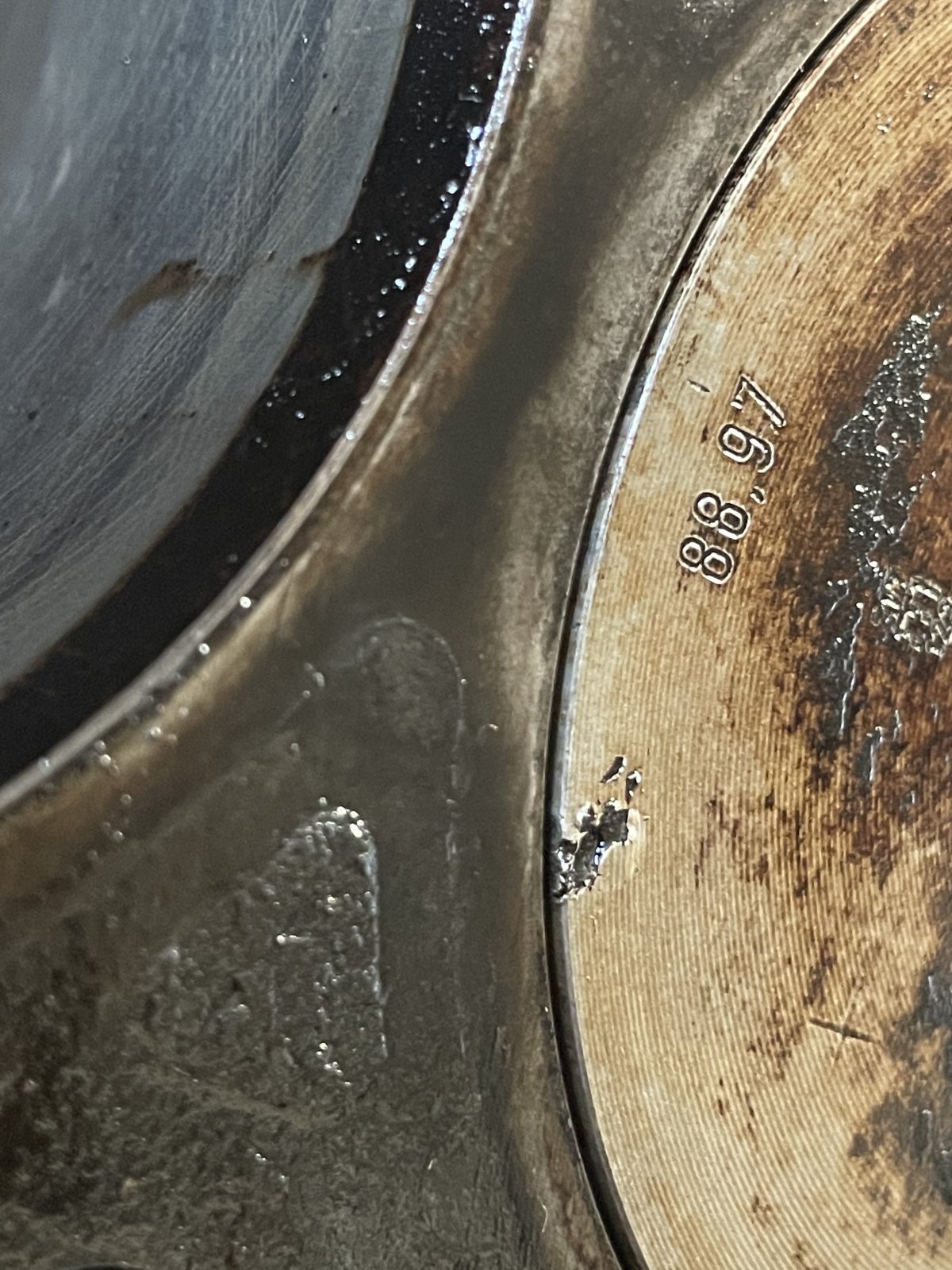

I just noticed this on head and piston #1: obviously, it is outside the head gasket sealing area, but how bad is this? any hopes for the piston to be reused? head?
Looks like it’s had some sort of foreign body through it! Personally I wouldn’t worry about the head, piston doesn’t look beyond use to me but I would be concerned about the state of the bores - it does look like it’s been standing with water in a couple of the cylinders so unless the marks hone out, I don’t think I’d but anymore time into the bottom end.
There is a lot of oil burned onto those valves which I think indicates piston ring issues.
