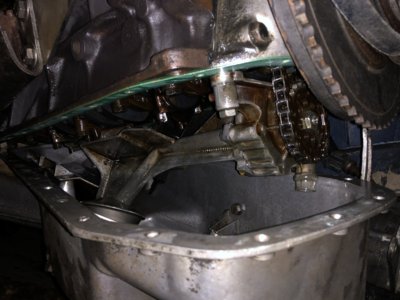

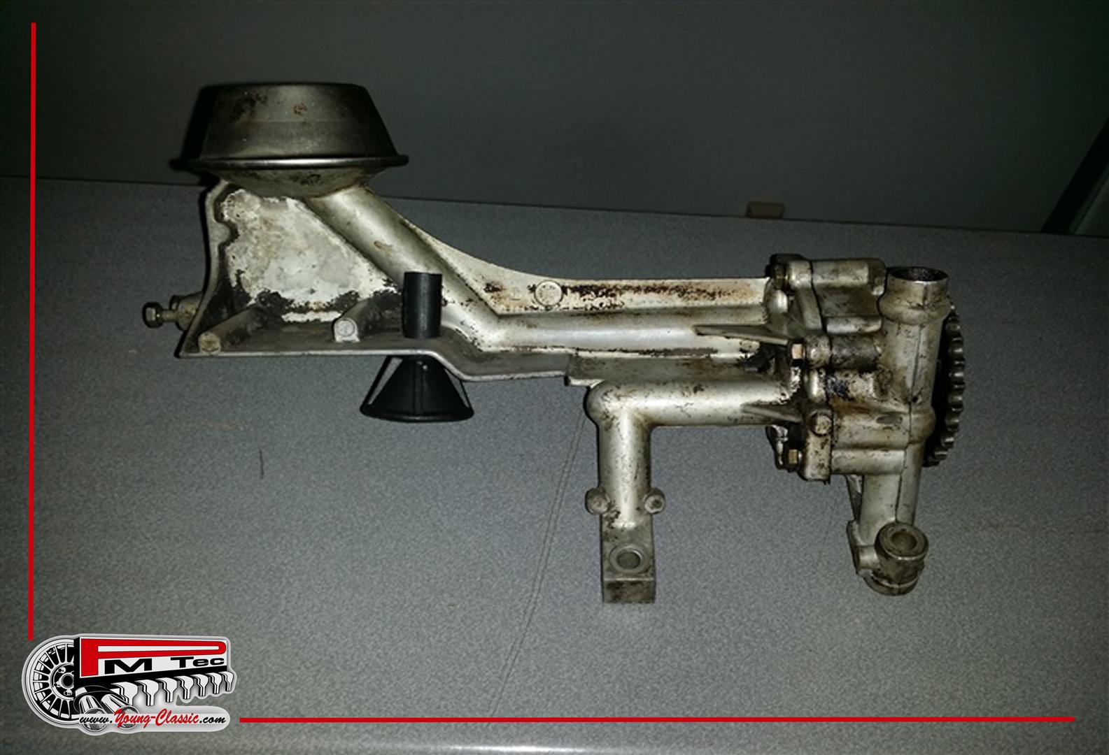

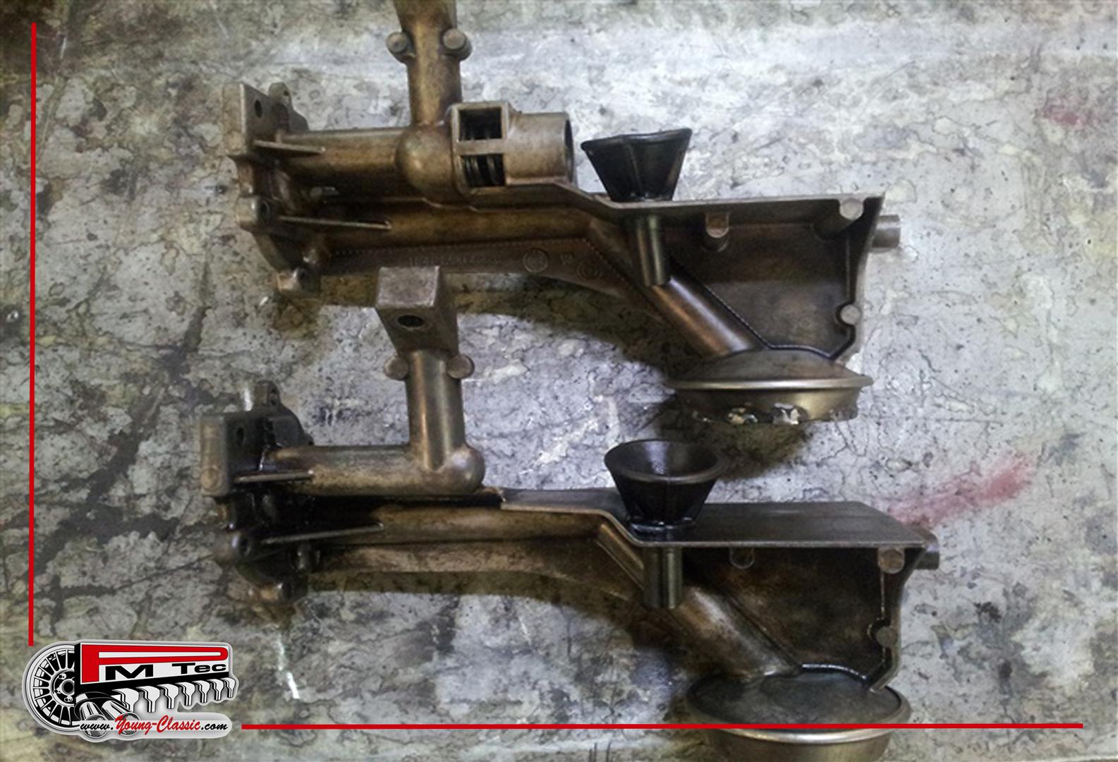

to adapt the b35 in the e9 I had to change the oil pan and fit a longer oil strainer
apparently it's an old version not great .. what do you think?
this is the bottom version that I have
a version without spring

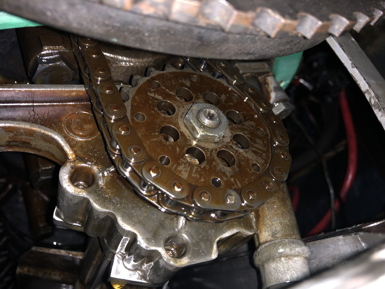

show us a pic of the front where the gear is
Is that a b35 front with a b30/32 back?
did you relieve the shaft hole?
did the pump spin easily.

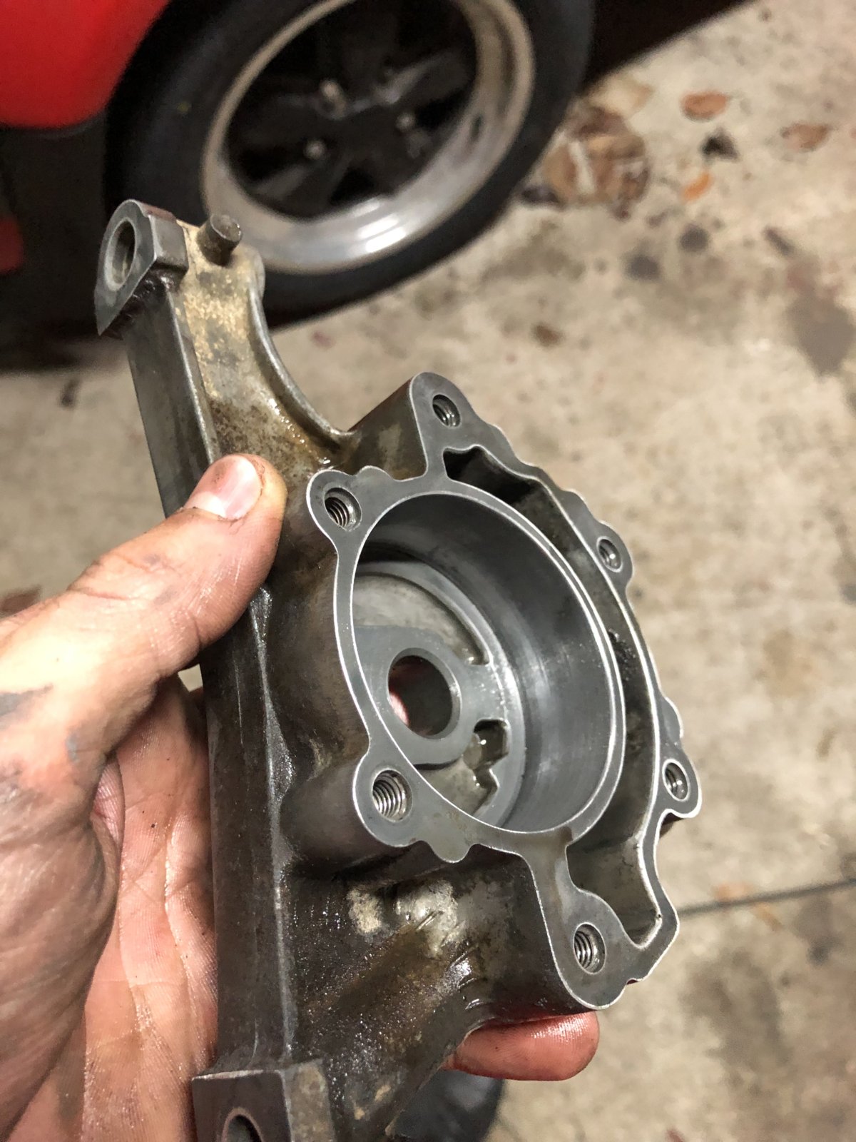

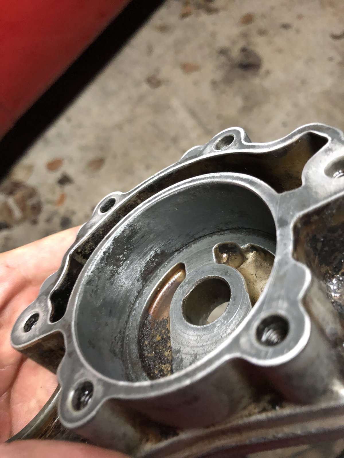

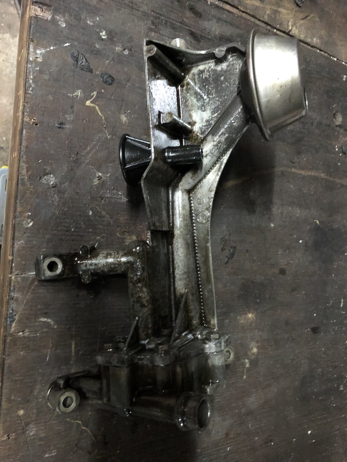

I will disassemble the oil pan to check my pump
I will try to reassemble the original pickup of the b35 with the oil pan

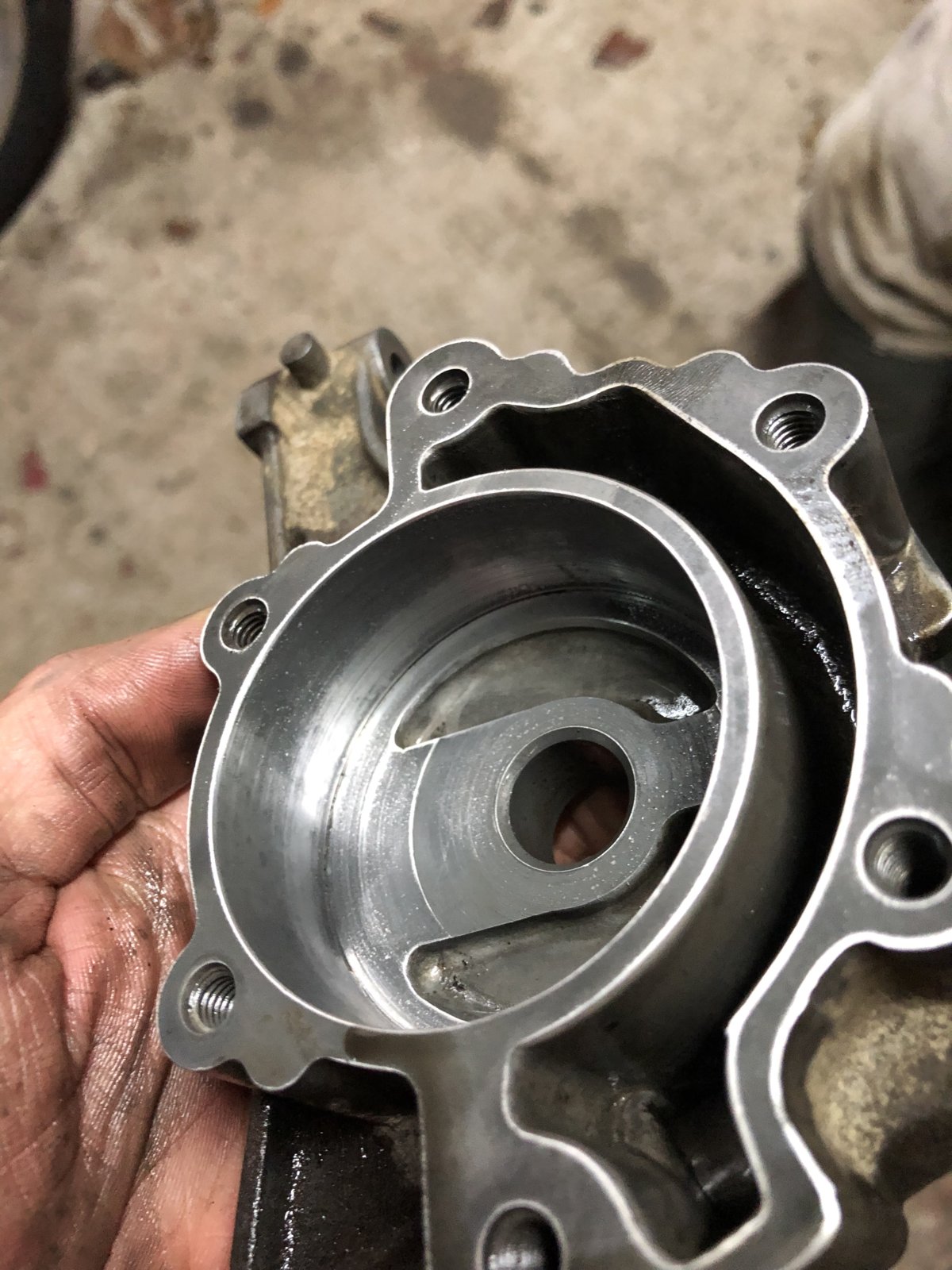

the oil pump of the m30b35 which has the piston stuck is really not beautiful inside
I cannot replace my current pump with this ..

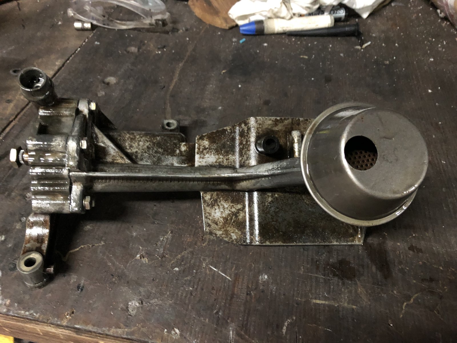

my other pump is much cleaner inside but I can hear the spring moving around in the pump and I still don't know if it's normal or not

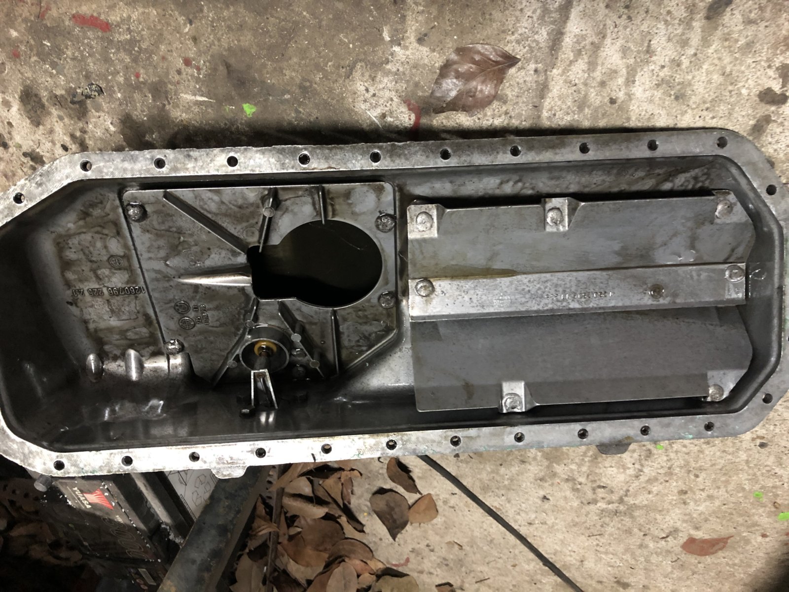

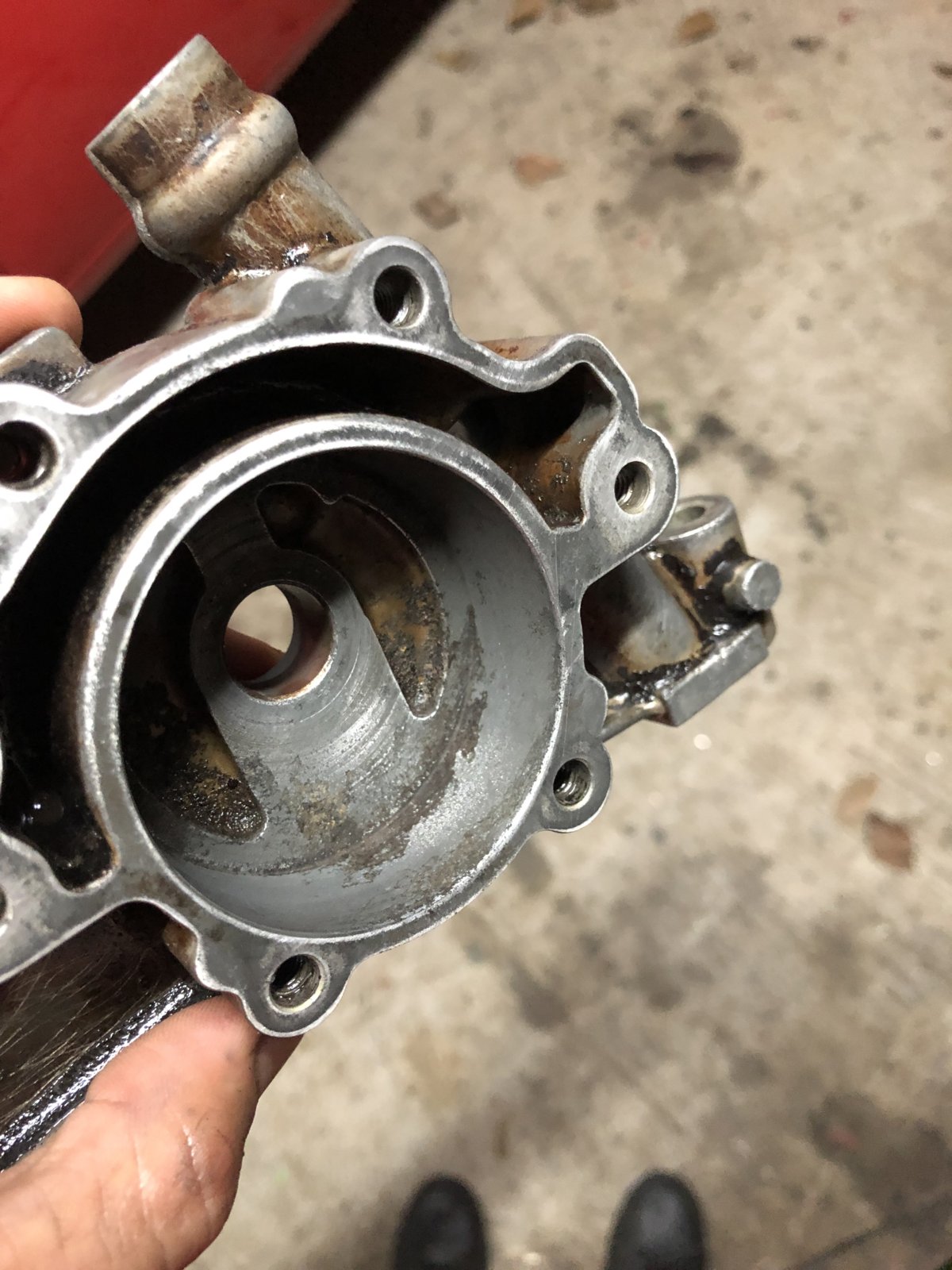

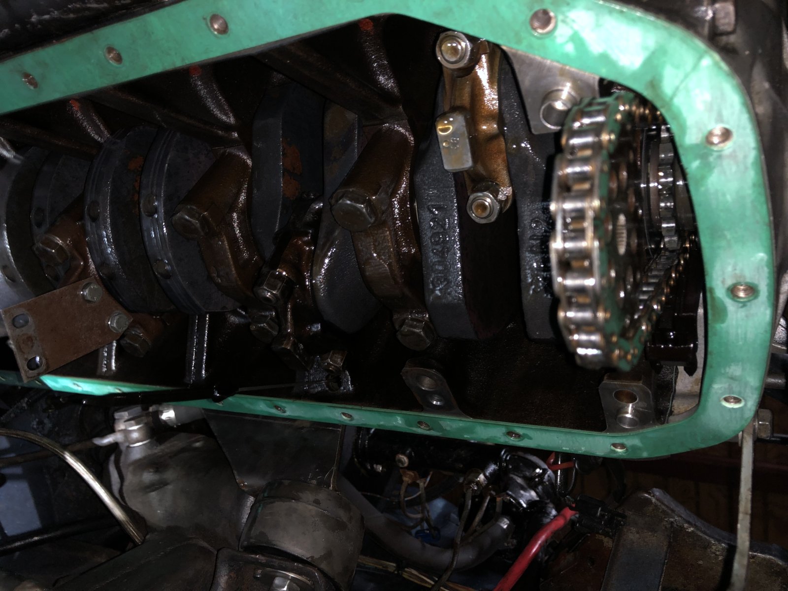

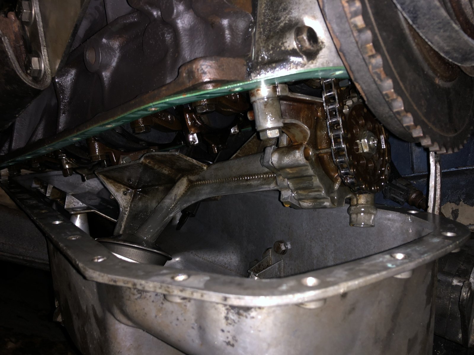

So I got motivated this evening I dismantled the oil pan, and the pump and its pick up we will be able to move on to the investigations
My skyline motor did this and it did not end well. Move with caution. Use a a very thick oil if you start it from now on, this will bring up oil preassure and probably fix the light coming on however do not rely on that, forever. Is it possible that the gap for the main bearing is too big, did you plastiguaged before assembly, I really hope your oil gap isn’t too big but it is the worst possibility, I’d use a couple new oil pump shims and make sure everything is clean, grease free and flat before torquing it down, if you have multiple oil pumps you can maybe find a way to spin them with a drill at the same rpm and look for the oil pump with the most volume or biggest stream of oil, good luck clean the oil pump with fresh gas and lube the inside, if you think there’s a stuck piston that could be your problem .
I have reassembled new bearings in standard dimension without having measured the crankshaft it is a risk .. because here in Guadeloupe I do not know anyone who rectifies the crankshaft, but it may be my problem
but I will try all the other options first before thinking about this one ..
I use 15w50
ouch try 20w-50 if its not very cold outside, unfortunately it could be that but like you said try and make sure your oil system is 100% first. you should look into "plastiguage" to double check oil gap.
