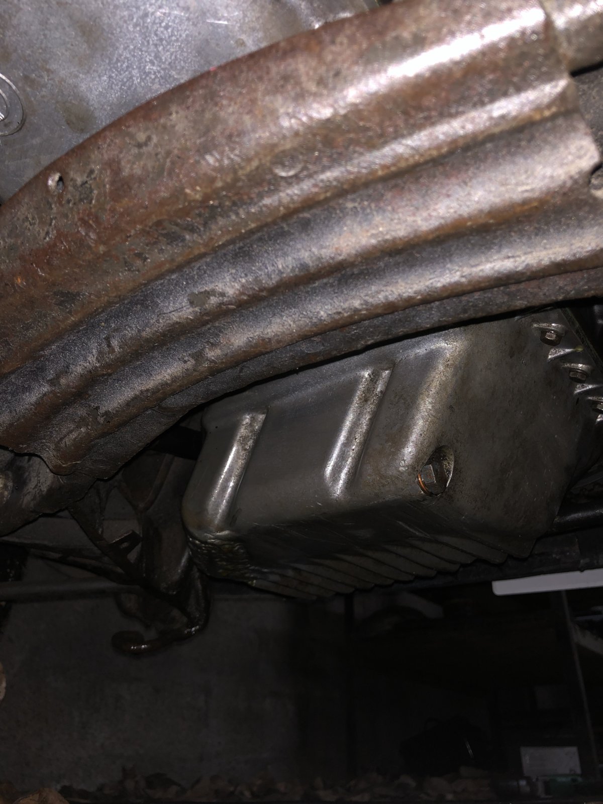

One more question- which oil pan and oil pump did you use?
you have a pic of your spare pump? Pic of your oil pan.

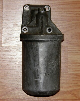

I say, plug the hole and get an early top-bolt canister. Like the one on the right there (one on the left is the really old bottom bolt; more of a PITA):

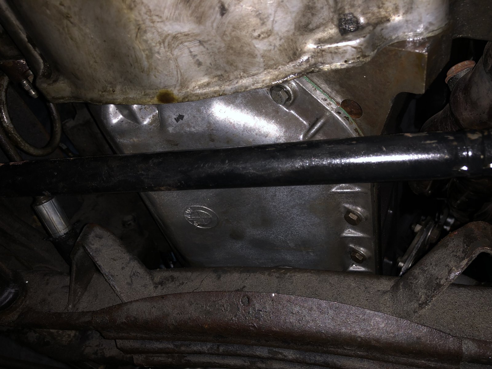

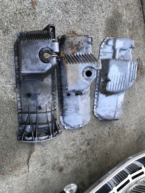

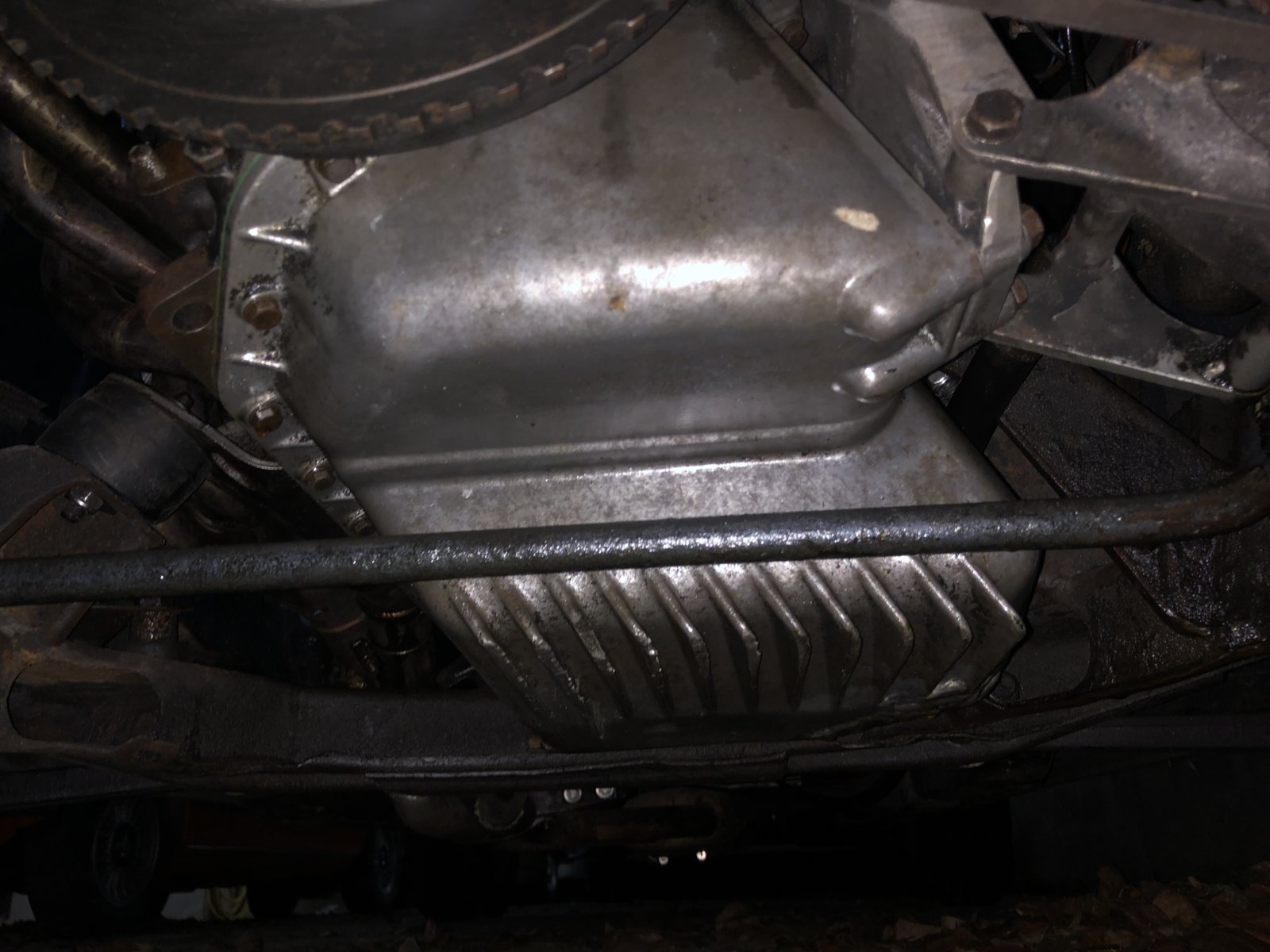

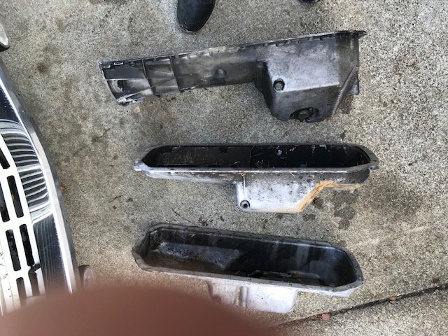

The center pan in the pic is the one on my engine.

so I use the original oil pump from the m30b35 but with a longer pickup because I had to change the oil pan to fit into the e9. I don't know exactly which oil pan or which pickup, but they were mounted on an old 3.3 that I had in stock, I will take a picture of the oil pan tonight, it has an internal baffle

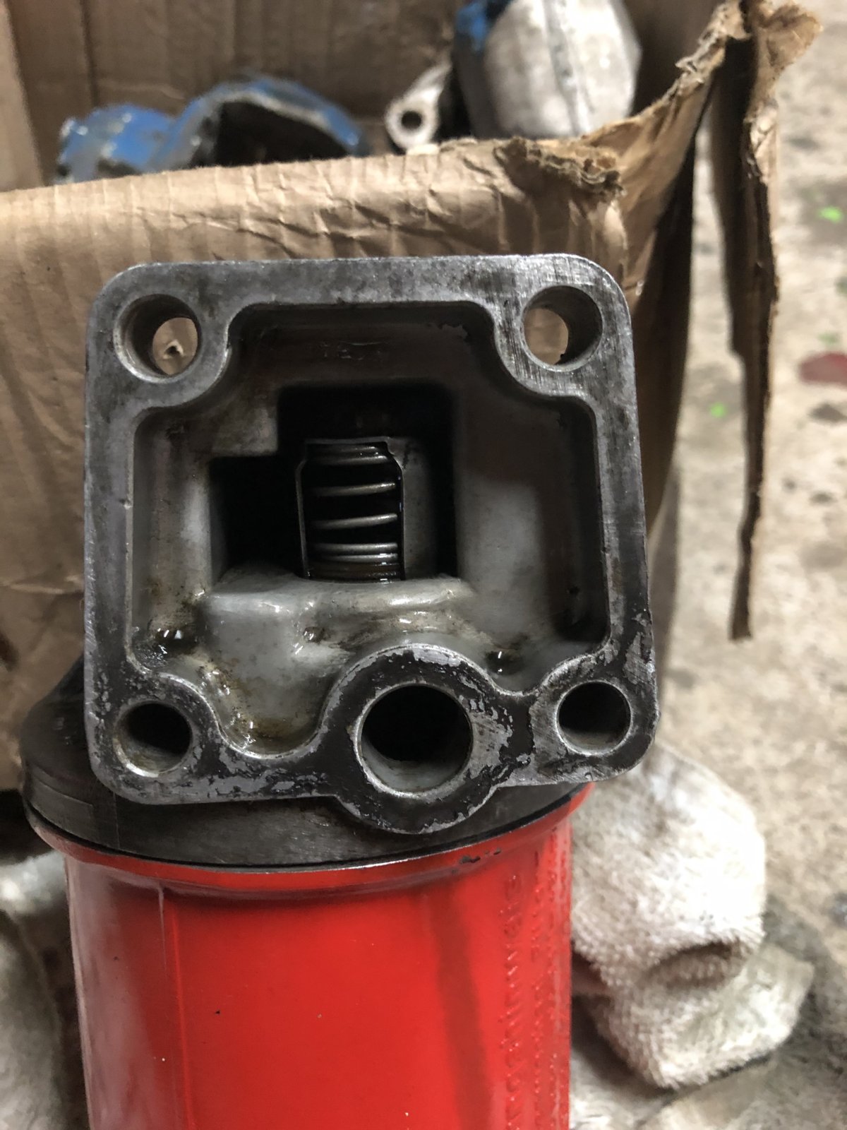

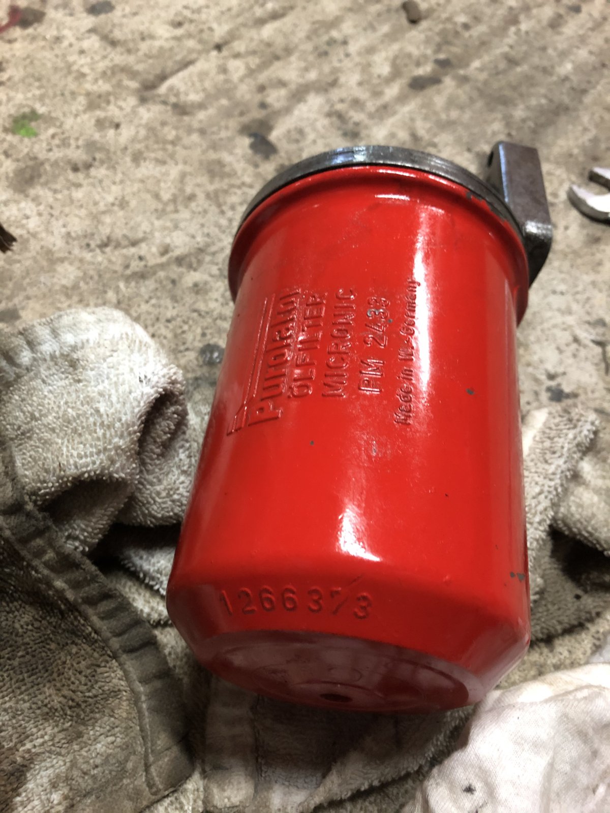

rob I have an oil filter jar like the one on the right in the photo, which I also dismantled on the 3.3, my first engine destruction I had to fit this jar without plugging the small hole on the engine block. . beginner's mistake

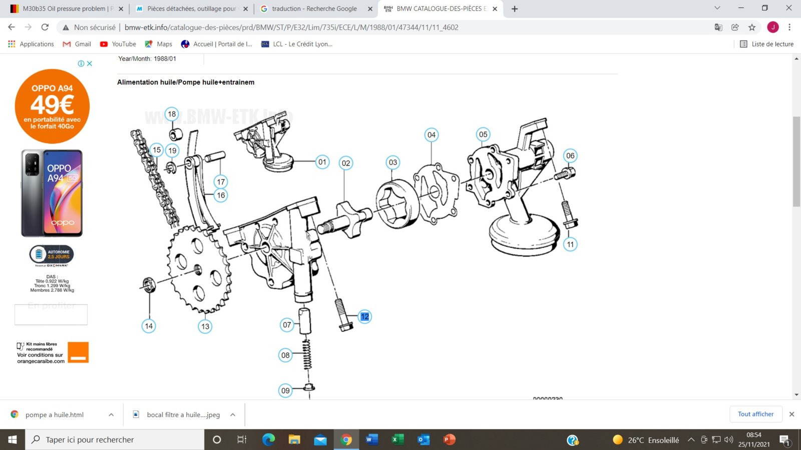

I disassemble part n ° 7 and n ° 8 of the shema to inspect them
n ° 7 seemed to be stuck

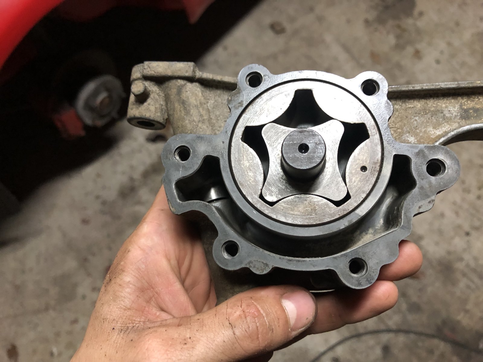

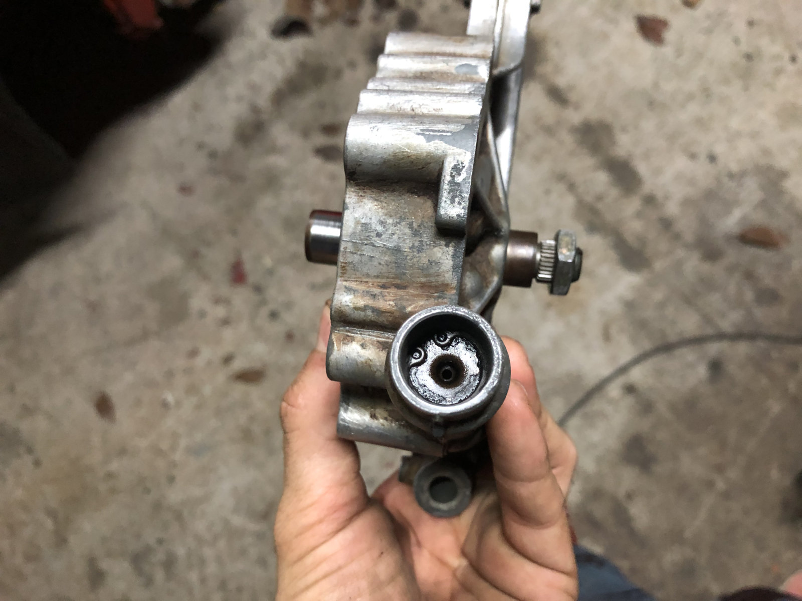

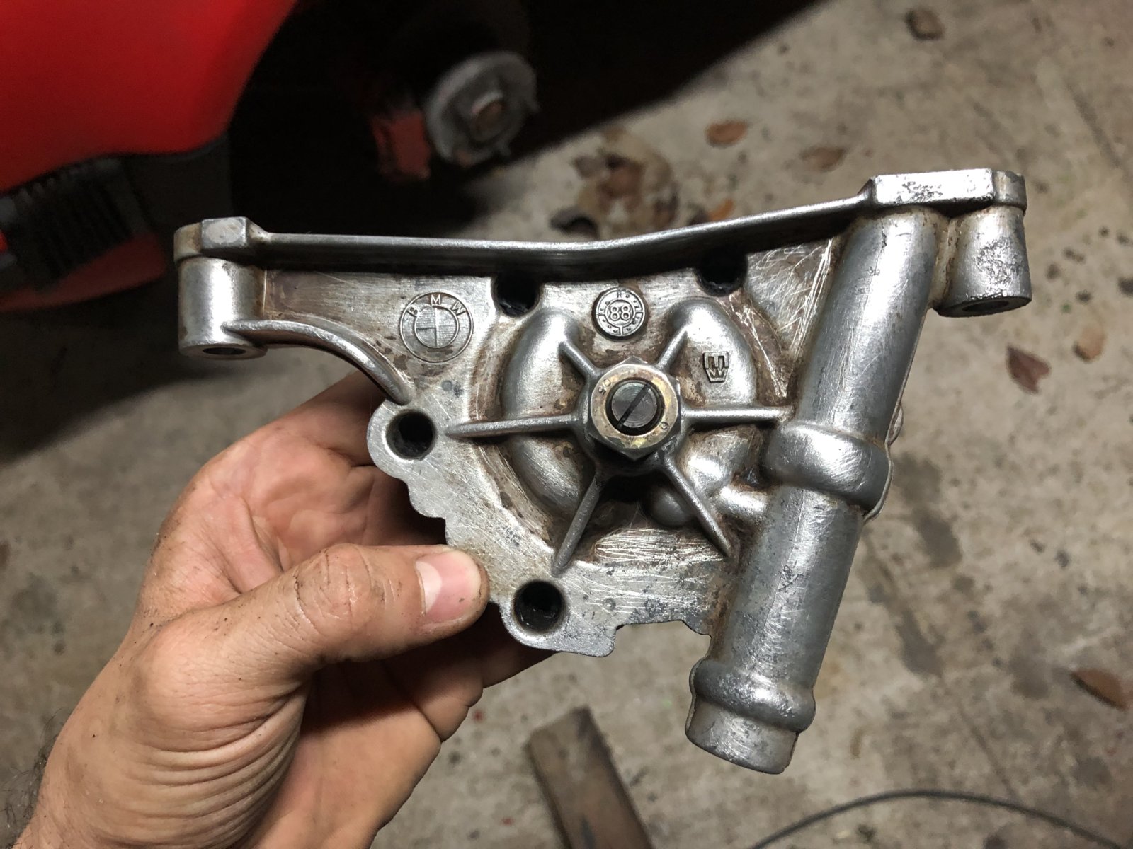

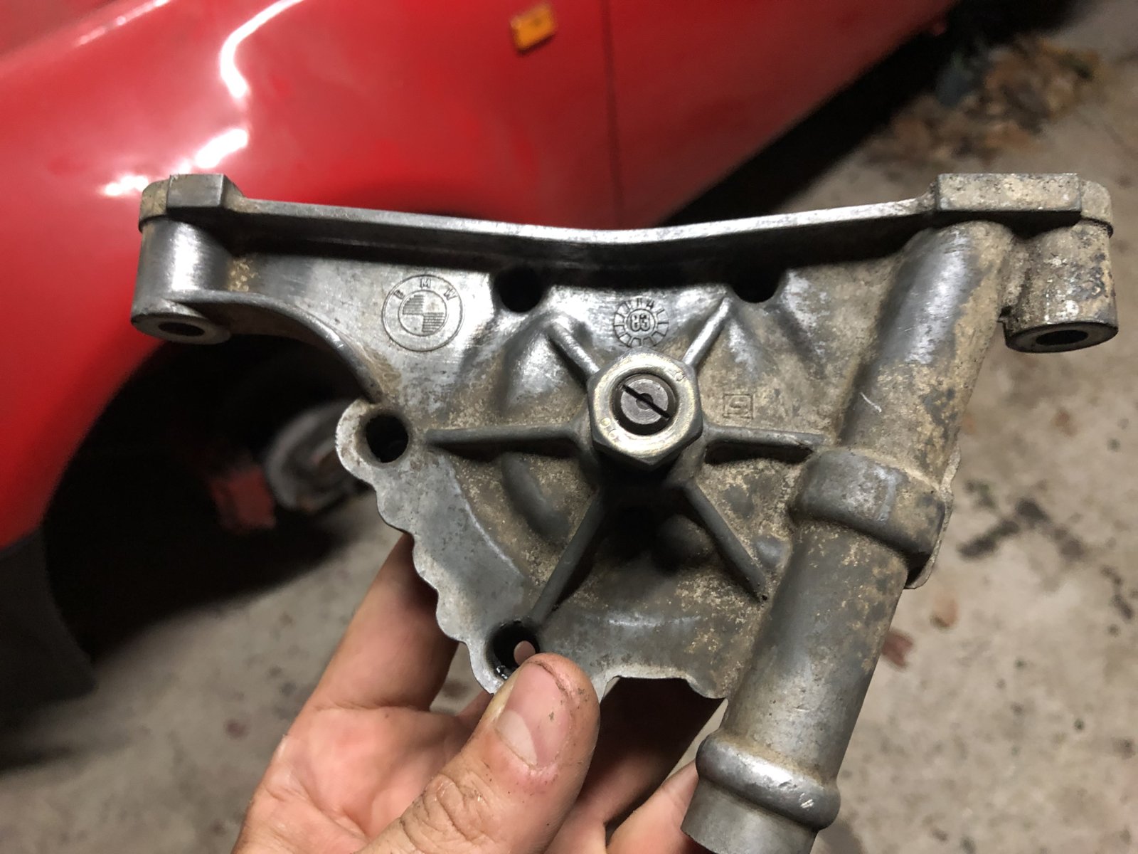

I cleaned my 2 pumps and I noticed a difference in the discharge valve
first pump: I dismantled it on a 3.3 block
the spring and the piston move freely in the cylinder of the pump by shaking it up and down we hear the movement of the parts, I put a screwdriver in the cylinder and I was able to push the piston quite easily up and down low

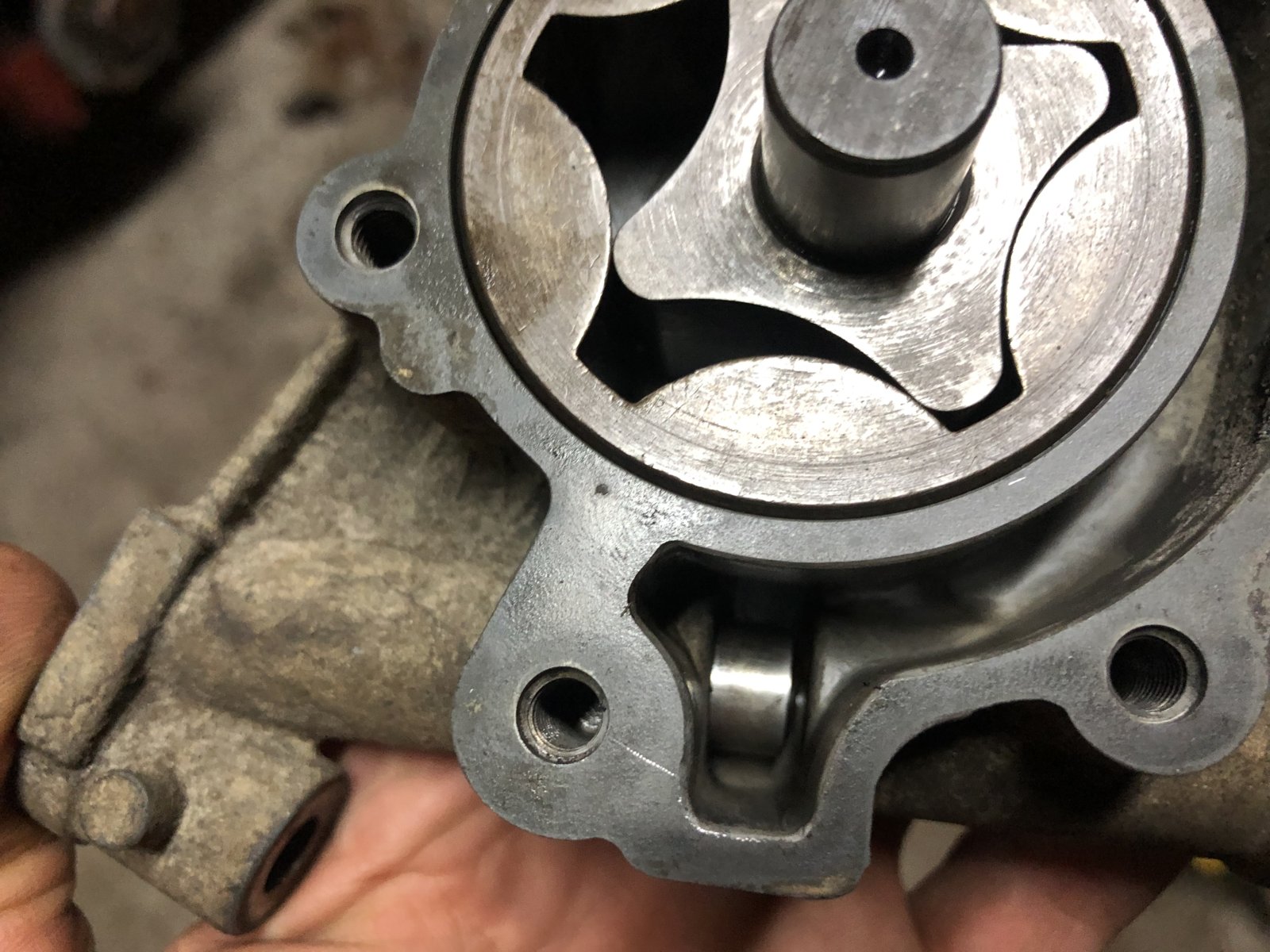

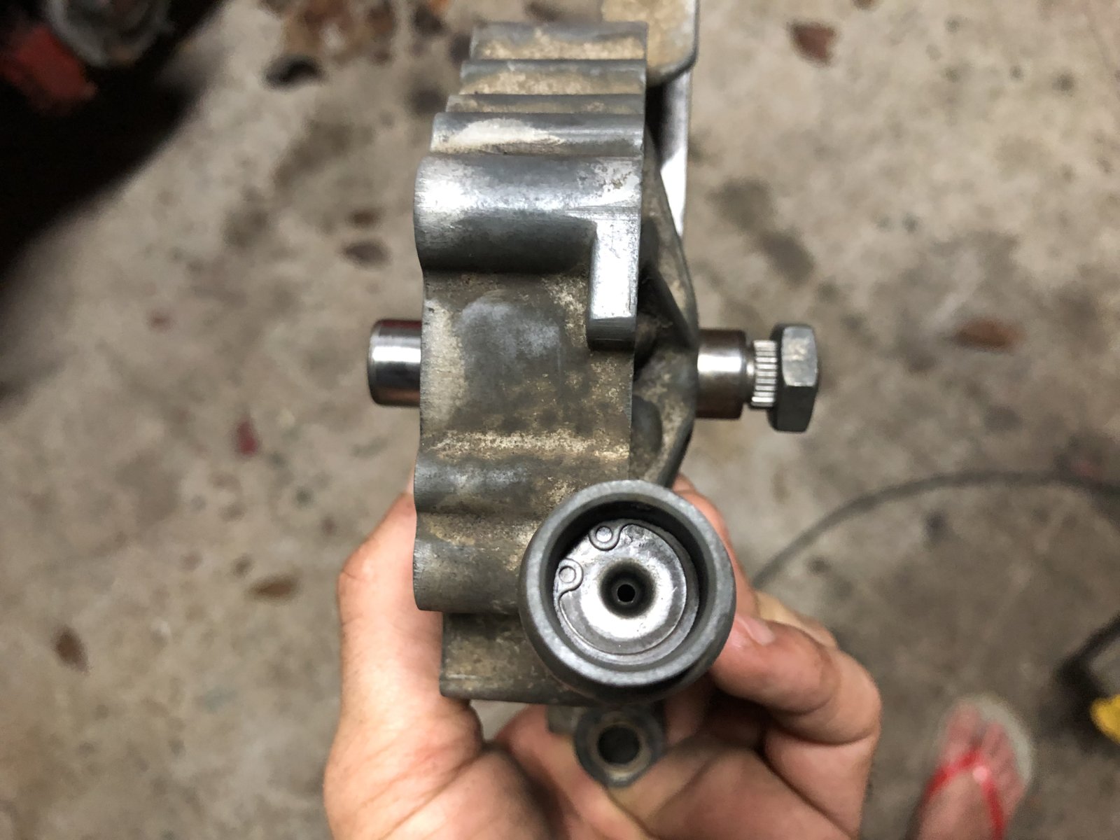

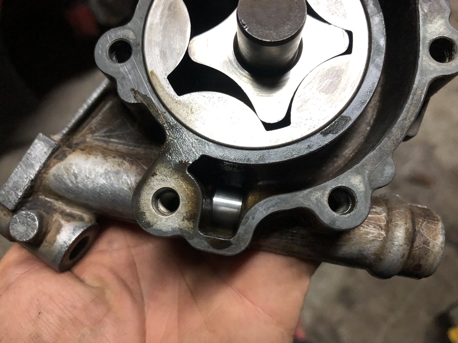

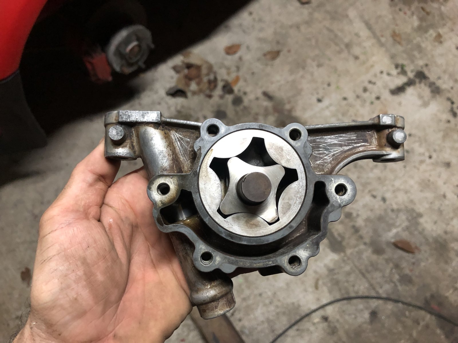

the second oil pump was removed on a m30b35 block identical to the one in my e9 currently
the piston seems completely blocked in the cylinder, I tried to make it move with a screwdriver also but nothing to do it does not move I did not press too hard, the piston was stuck in the pump that I reassembled on my car, before I unlock it, maybe my oil pressure problem comes from the .. is it normal that the piston is completely blocked in the pump of 3.5 and free in the pump of 3.3?

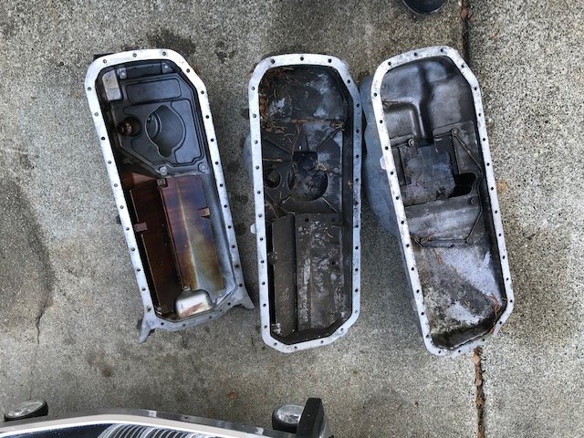

you will also see pictures of my oil pan
