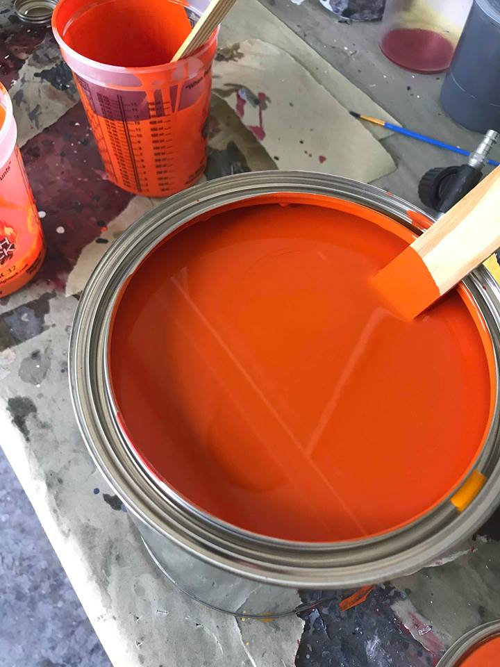

The paint work continues
color looks awesome - who's paint are they using? color formula looks very correct
I forgot the name of company Andy uses , about a year ago he got an inhouse deal where he mixes the paint himself , its a whole system . On the exterior he used a white primer so the color wouldn't be muddy and really "pop" Ill have some exterior shots in a few days
