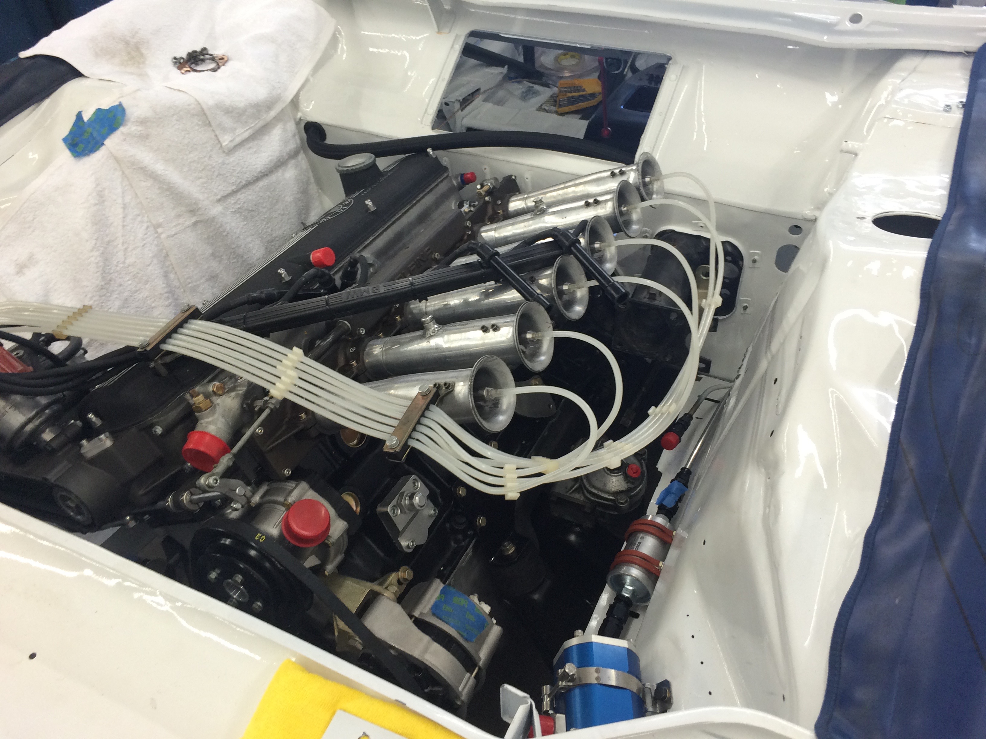

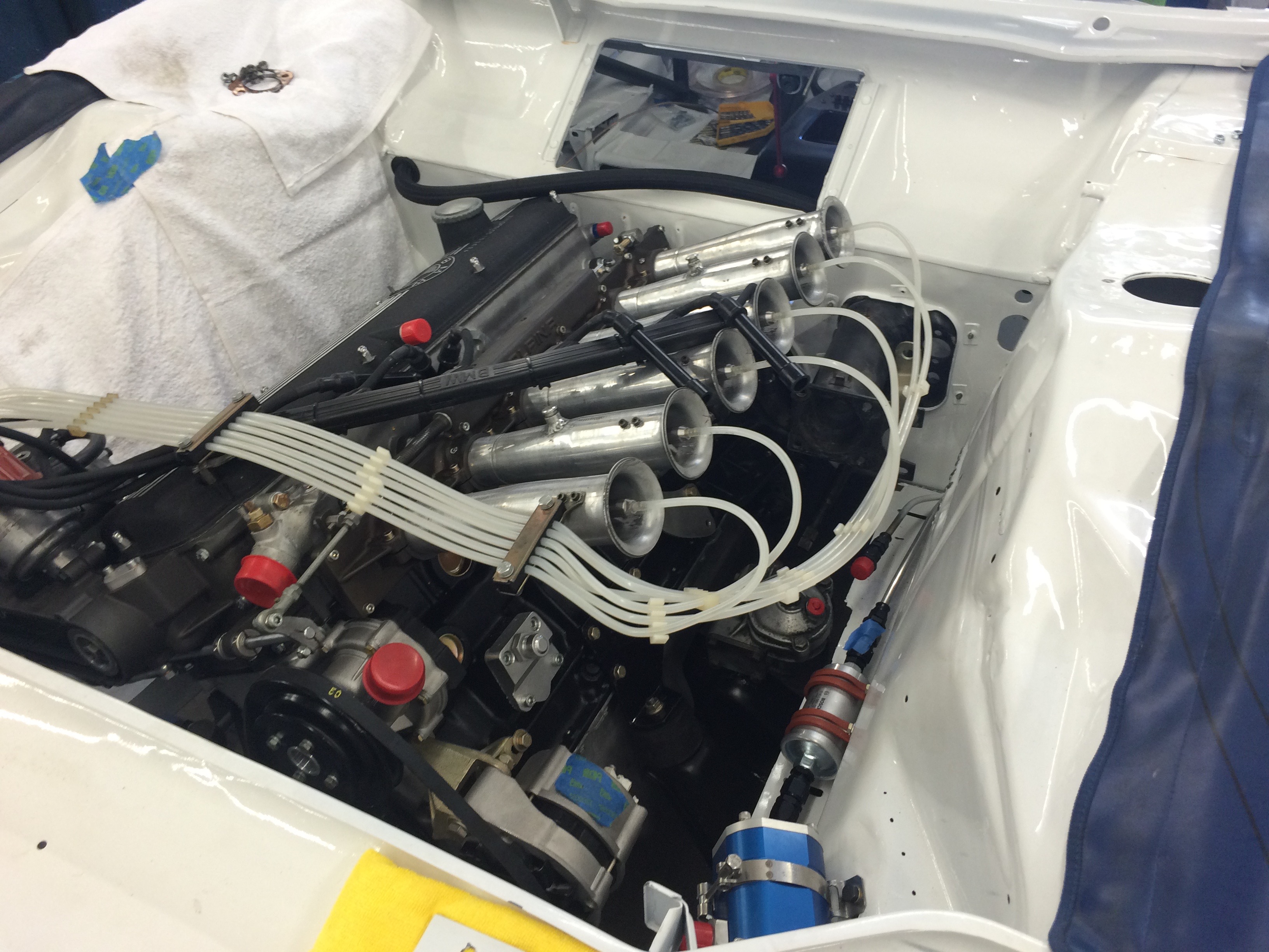

Just because you can't see it doesn't mean it shouldn't be correct... the flywheel and clutch are period parts, and they were REALLY hard to find (as with a lot of the other parts). Gerrit Blankman turned these up. He also provided those lovely original sand-formed Alpina headers and lots of other stuff. Gerrit is a gem!
This is an M30 in late Group 2 trim (known as an M52/2). 3.3 liter, 2 valve. Good for 340 HP in period, and that is exactly what this one made. I'm sure you could squeeze lots more out of an S38. My philosophy on historic cars and vintage racing is that the cars should be as true to the way they raced as possible, within the bounds of safety (modern seat, fuel cell and fire systems, etc.). It is easy (and much cheaper) to "upgrade" components but that is not the point. This car will never "win" its race at Monterey against 800 HP Porsches but that is not the point either... (and BTW I also have one of those).
We finally got the motor installed Wednesday after much messing about with the clutch (getting the stock actuation mechanism to work with a period Sachs racing clutch). Not easy!View attachment 19346
I would love to learn more about those slide throttles and the injection in general. The Gosser Bat that's for sale has the same setup.

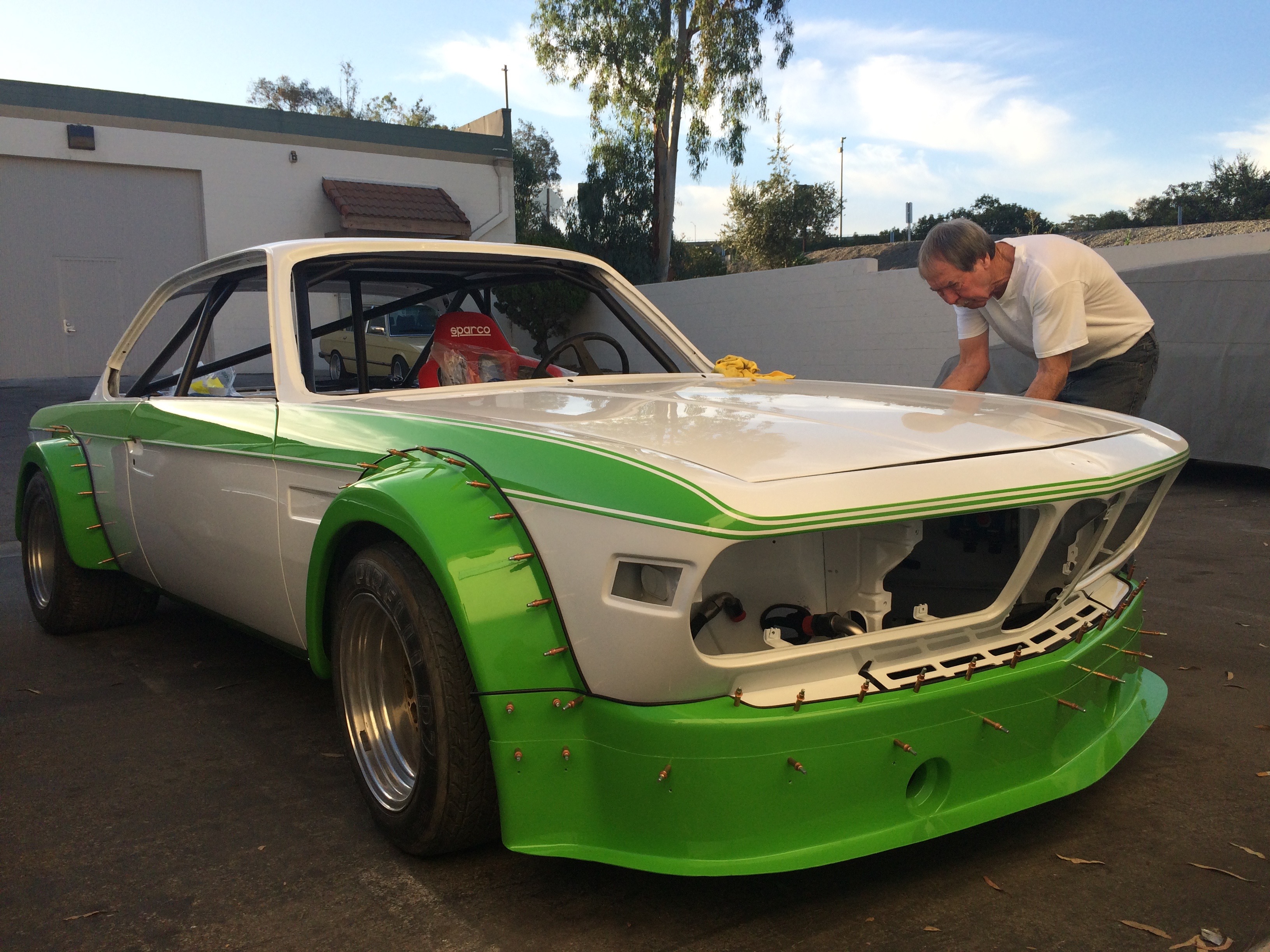

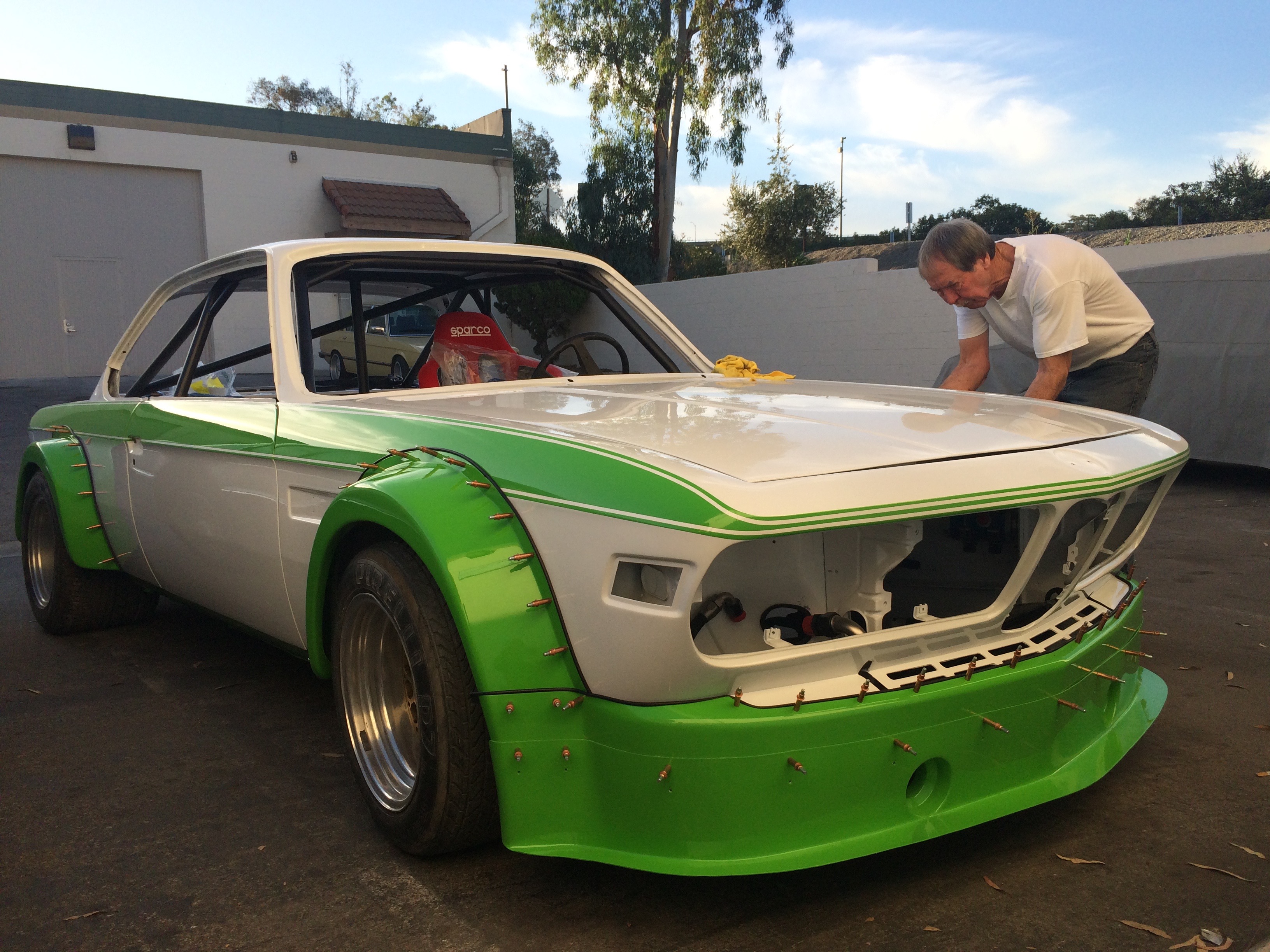

The flares and spoiler are Art's handiwork (with the help of Jeff Freeman, who builds McLaren Can Am bodies!).
