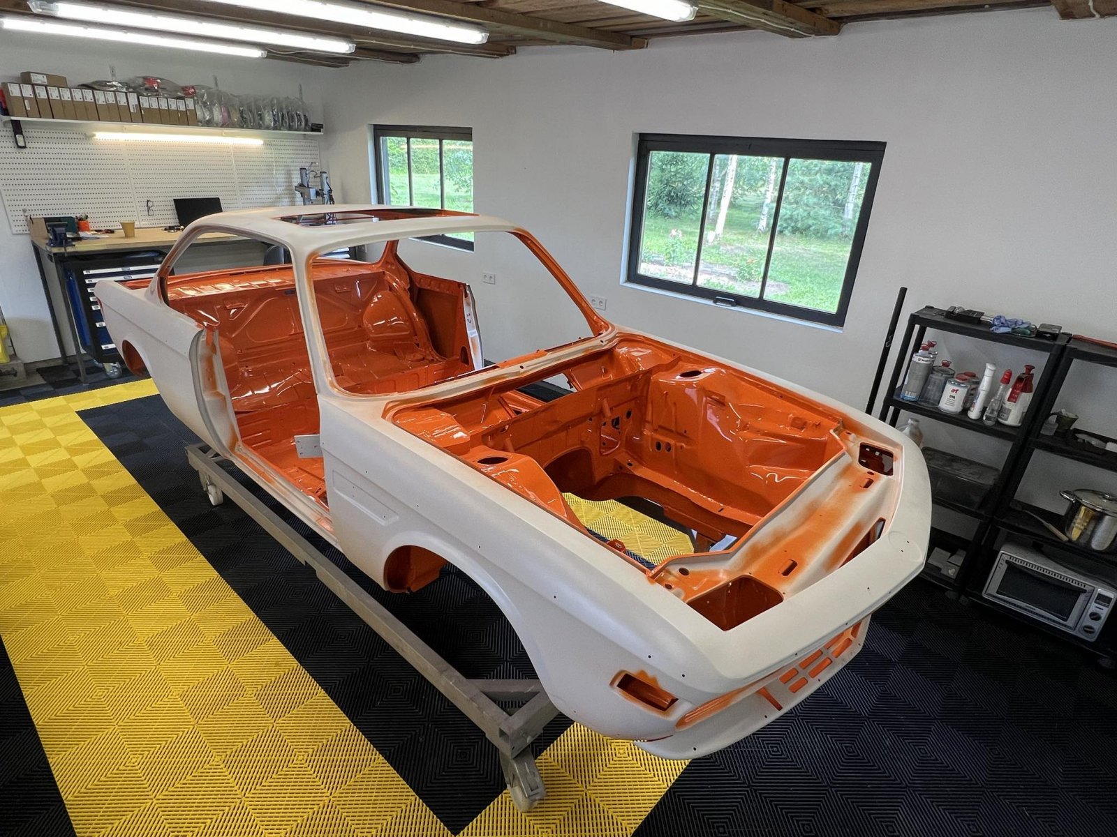

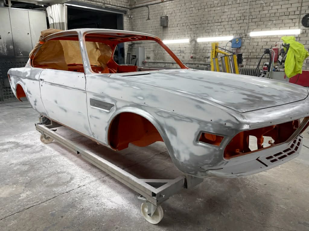

my bodyshop guy does the work and chooses the materials to be honest. I know he mentioned something like lead-filler for the hood etc for larger repaired areas
Im a huge proponent of All Metal filler.., to the point people probably get sick of me mentioning it. Really looks like it in the photos. There are a couple other brands out there.

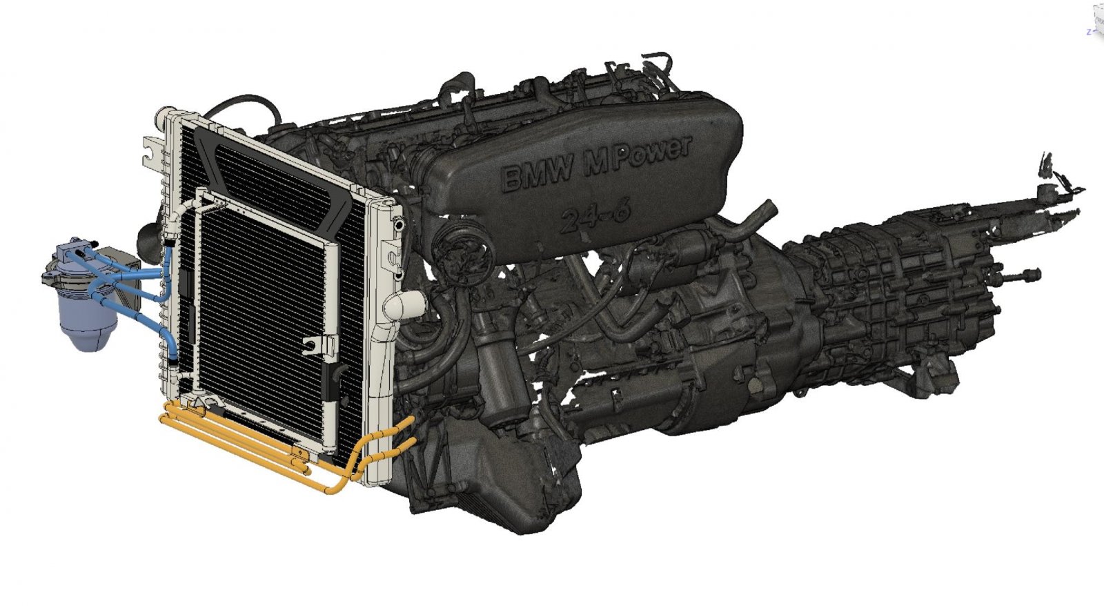

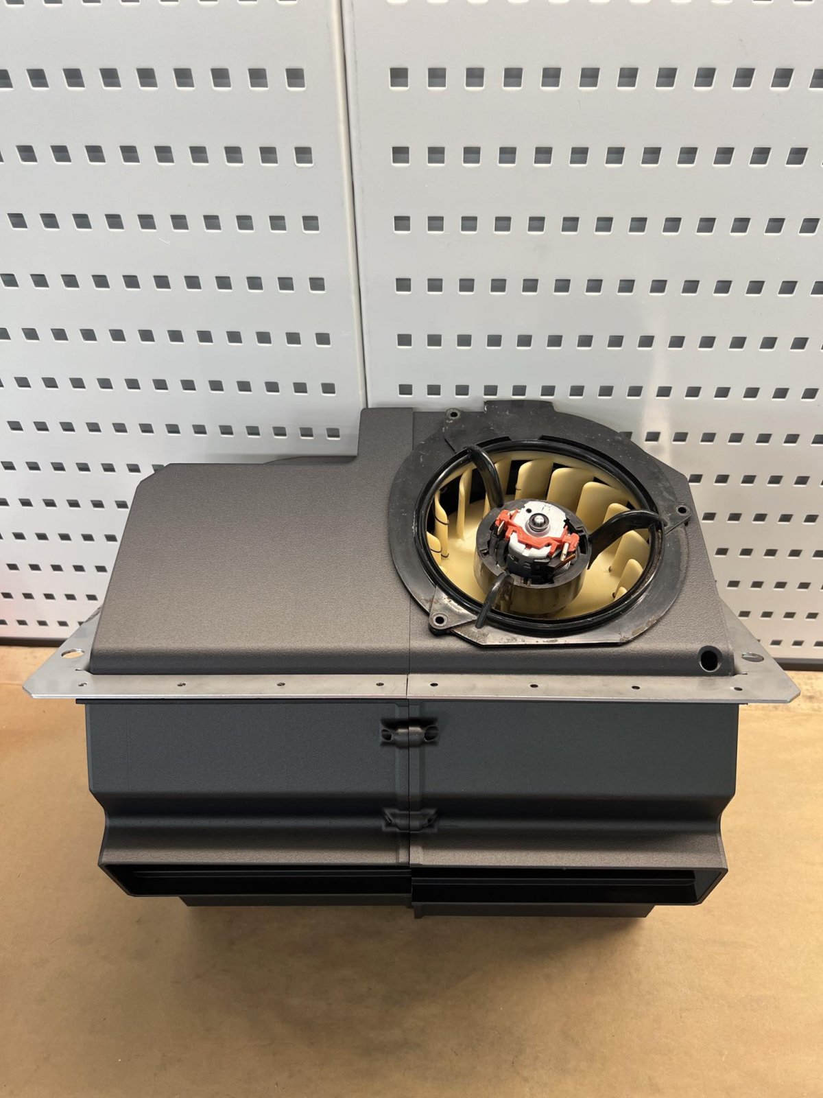

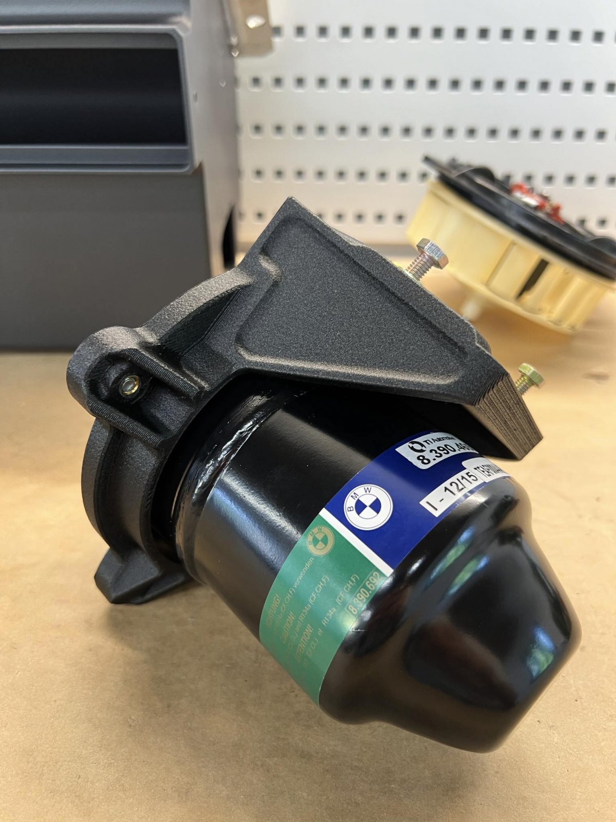

Have we gone mad? :) Somewhat I guess... redesigning and building a completely new AC solution is progressing nicely. PS! The work is done by a specialist shop that has helped bring to life the Kalmar Porsches (Singer reimagined kind-of-work). We still have to test some ideas about engine oil cooling to be more efficient - coolant/oil cooler as one idea located on the intake side.

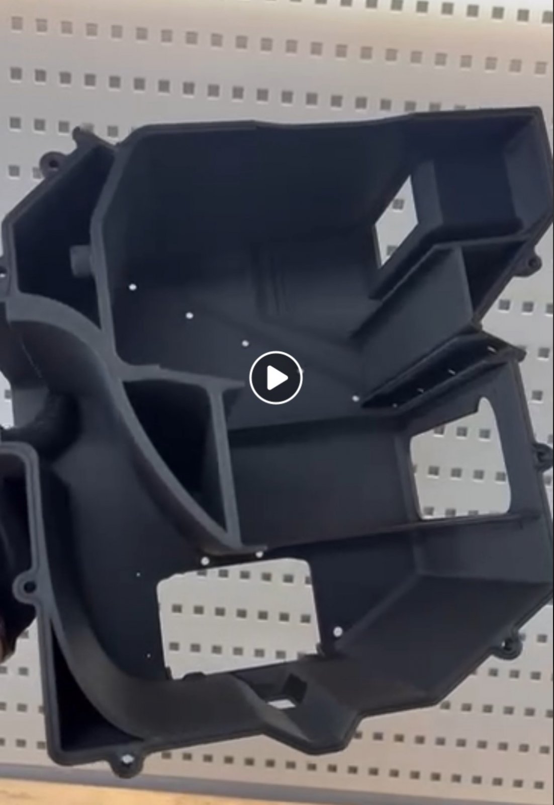

AC housing internals looks like this

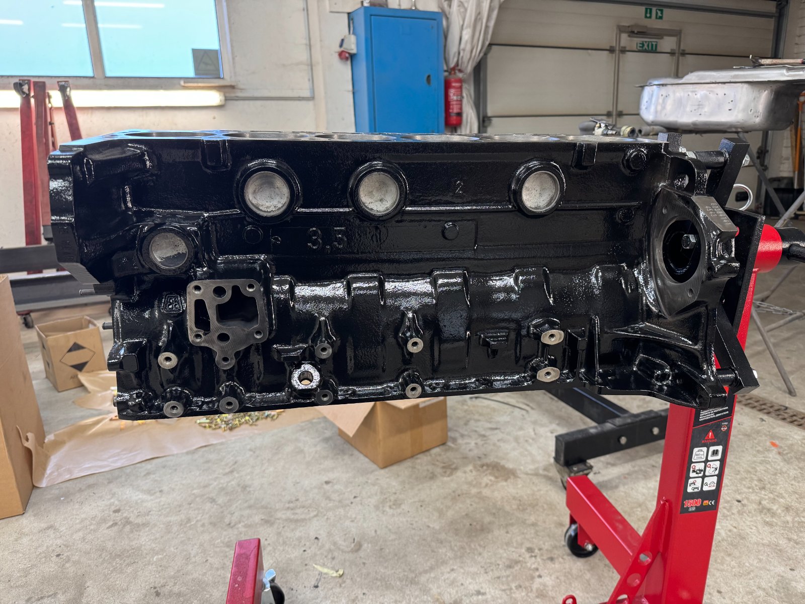

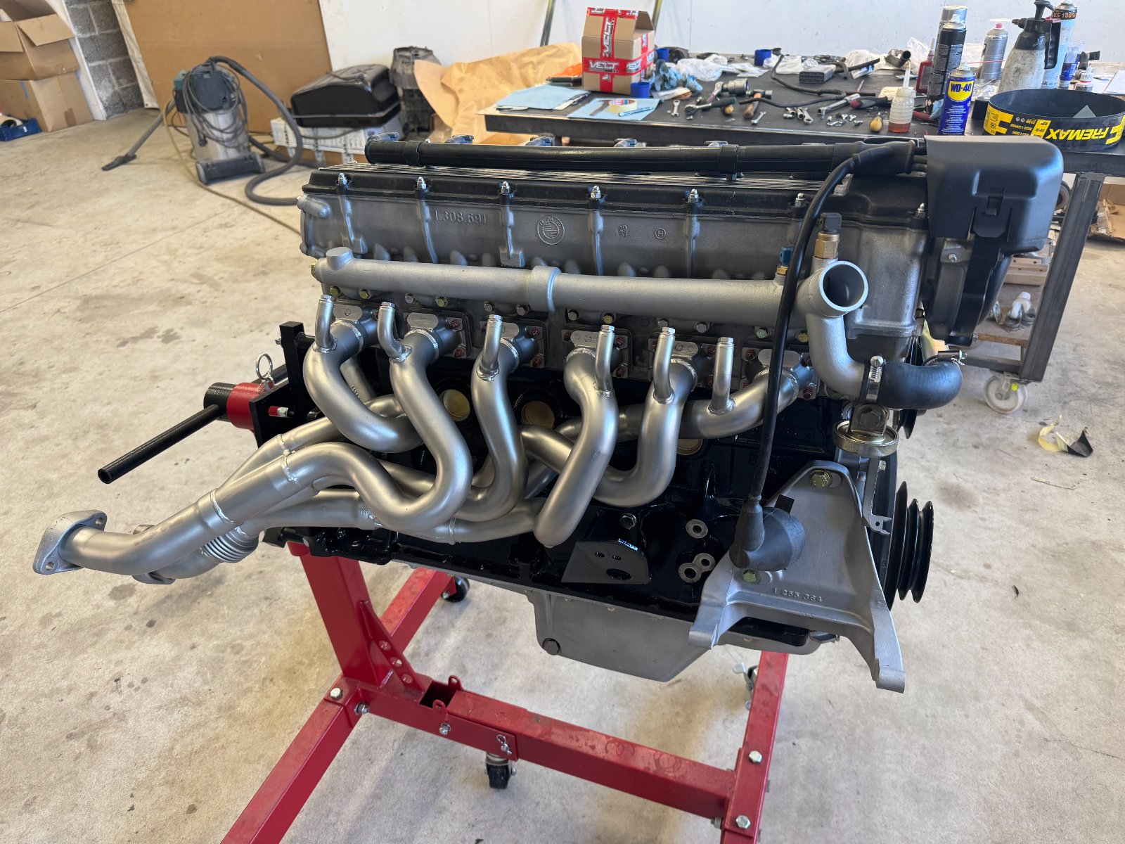

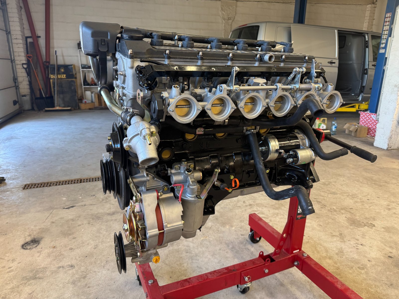

Amazing project. What era BMW is the S38 from? Where would you recommend learning more about installing an S38 into an E3 chassis? Thanks.
The S38 came in the US M5 and M6 in 1987 and 1988 (e28 and e24 chassis). this engine was known as the S38b35. The b35 designation showed that it was a 3.5 liter engine. In the E34 chassis M5 it was enlarged to a 3.6 liter engine for the United States. This designation was S38b36. The last iteration of this engine in the e34 chassis was the S38b38 (3.8 liters)
The history of the engine really starts in the 70s when bmw went racing with a modified m30 engine with a 4 valve head Stuffed into the e9 chassis. These rare engines were designated as M49 engines. This engine gave way to the m88 engines. Initially in the M1 race and street cars (1978, 1979) with mechanical injection and in 1984 in the M635 csi with a motronic injection. The S38 and the M88 are very similar looking to the untrained eye. The US S38 engines had, among other things, different cams, slightly less compression and double row timing chains compared to the M88 single, and lighter chain.
Many members here have installed these engines and their variations. Look though the technical threads for detailed information. One of the hardest parts about this swap in today’s world is that the supply of good engines and their ancillaries has dwindled to virtually non existent.
What I love most about this family of engines is how wide and long it is and how beautifully it fills the engine bay. Looking at one of these engines could sort of be the automotive equivalent of seeing the expanse of the Grand Canyon for the first time. It has to be one of the best looking engines from a bygone era. An era where plastic had little or no place under the hood.
Back in '08 I owned a '88 E28 M5, which had been modified by Frank Fahey. The engine was bored out from 3.5 to 3.9-4.0L. The
engine had a Stroker Crankshaft in it from Scat Crankshaft.. as I recently learned during a conversation with the seller of this item:
My modified S38 had about 425-450hp at 7500 rpm. It was wicked fast.
