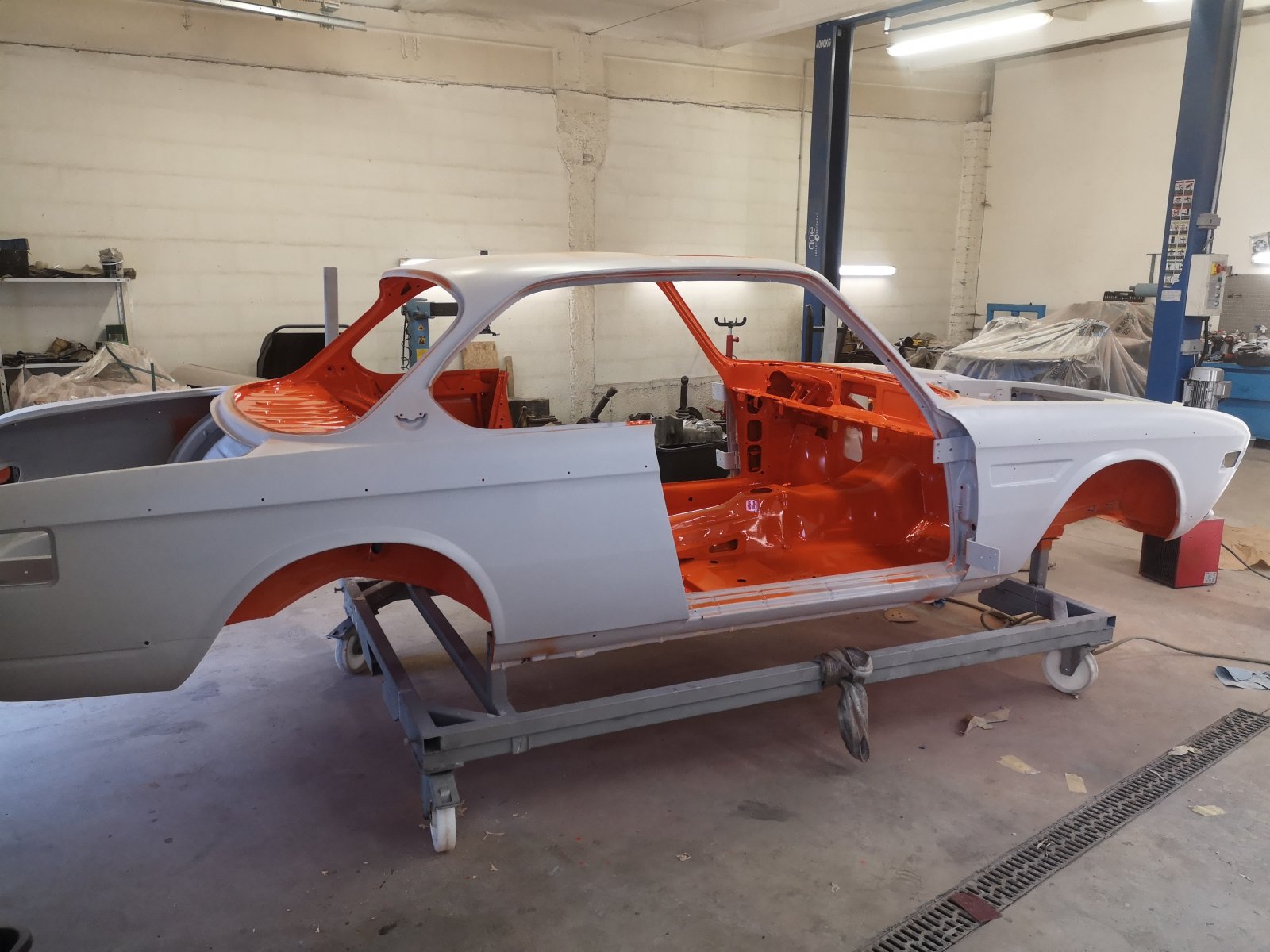

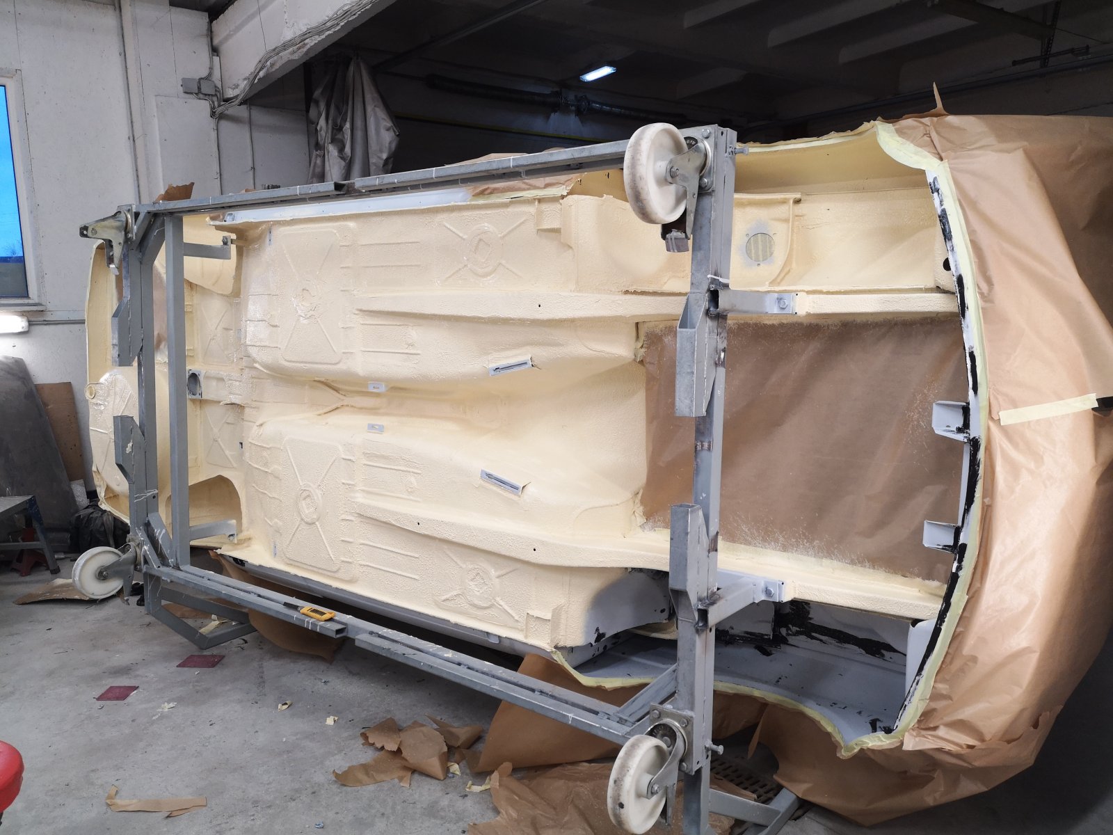

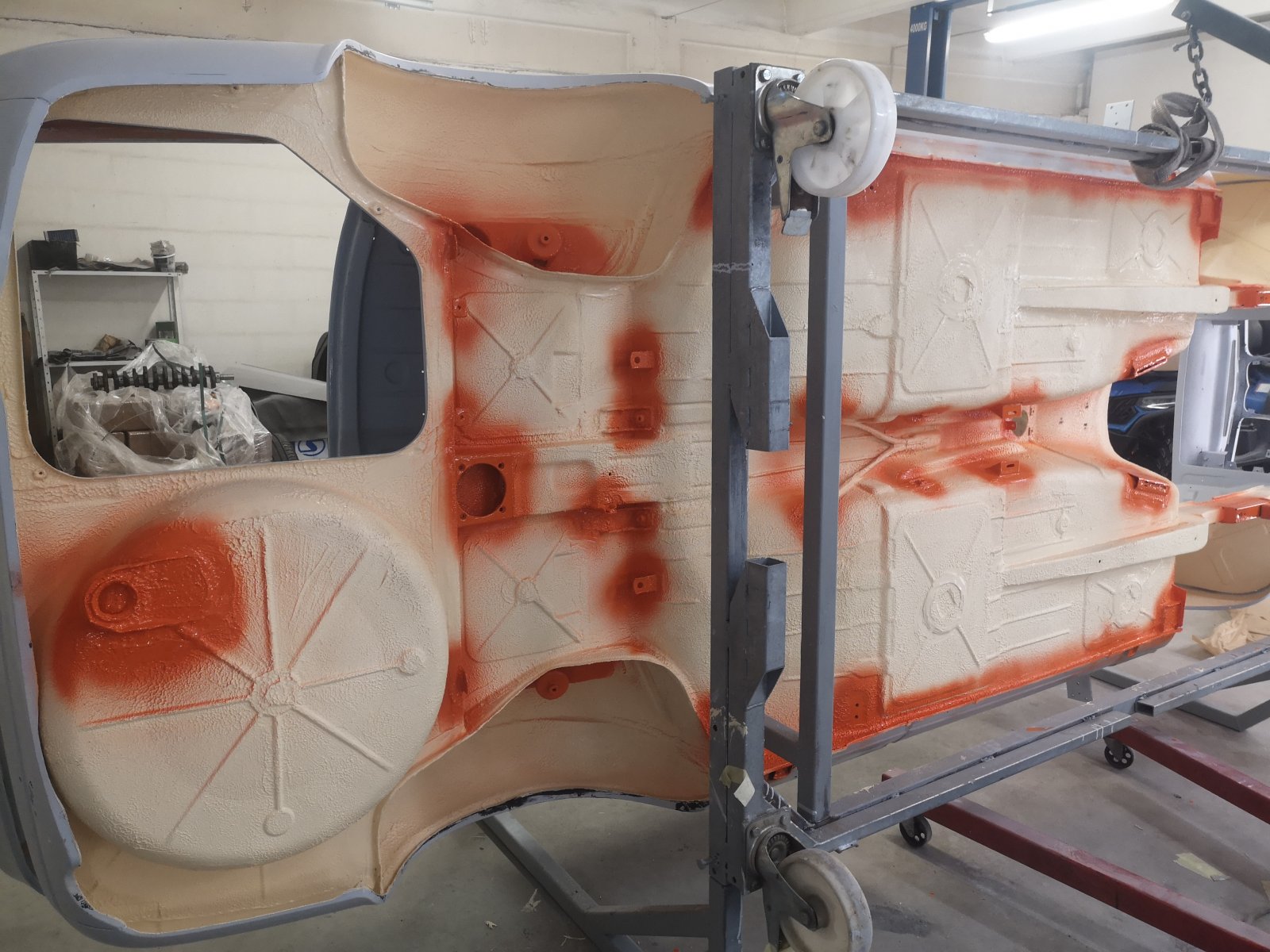

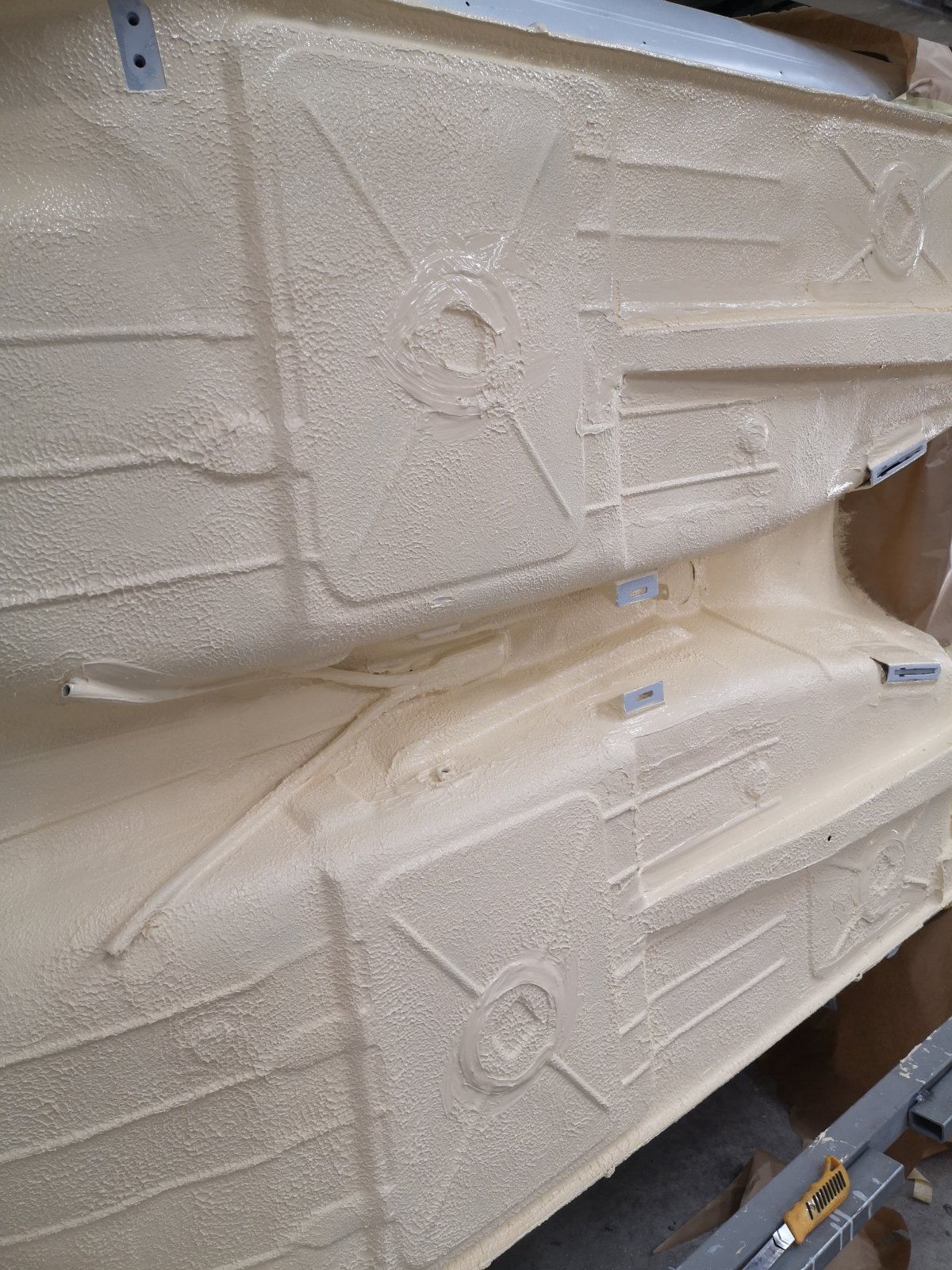

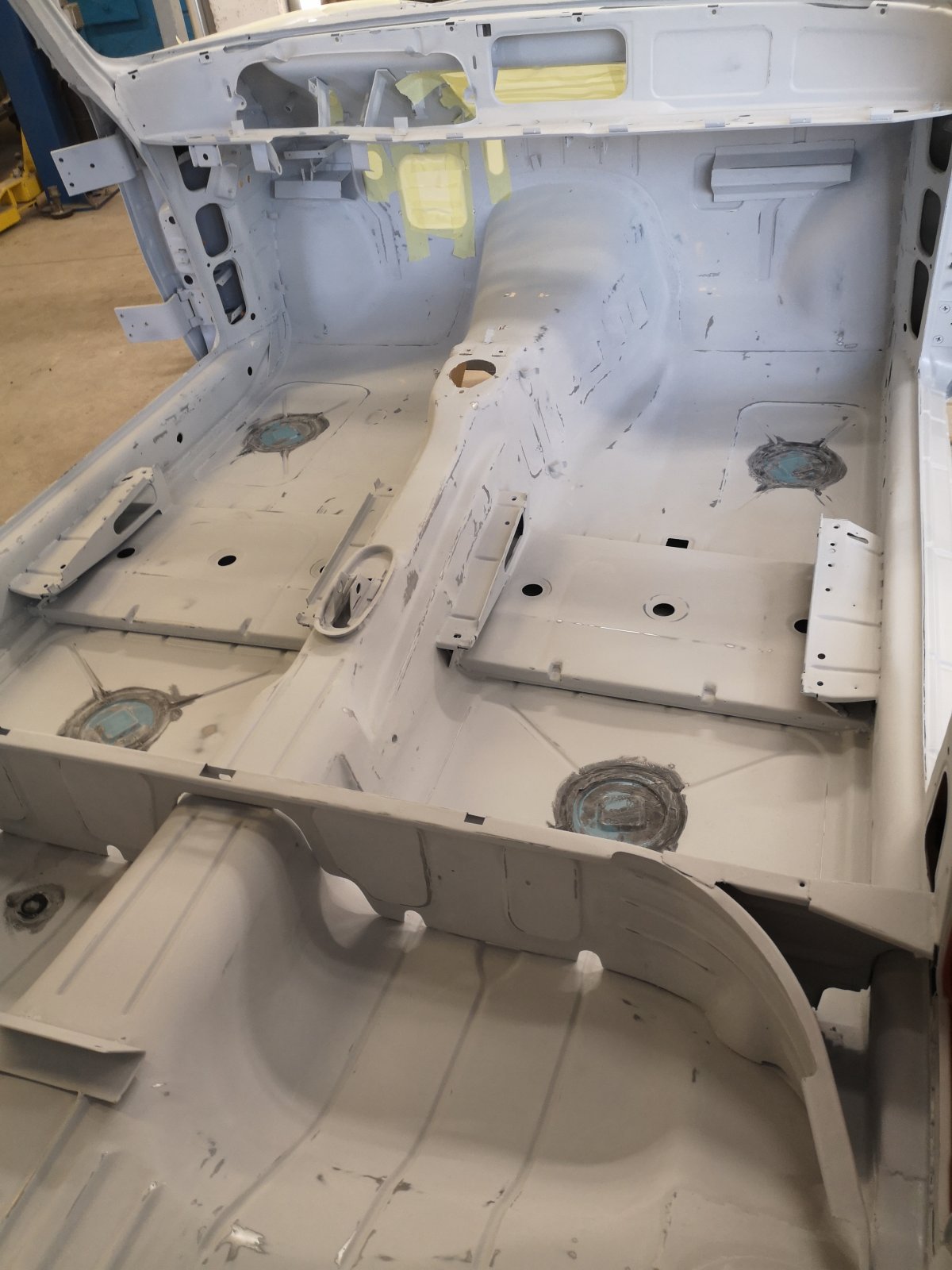

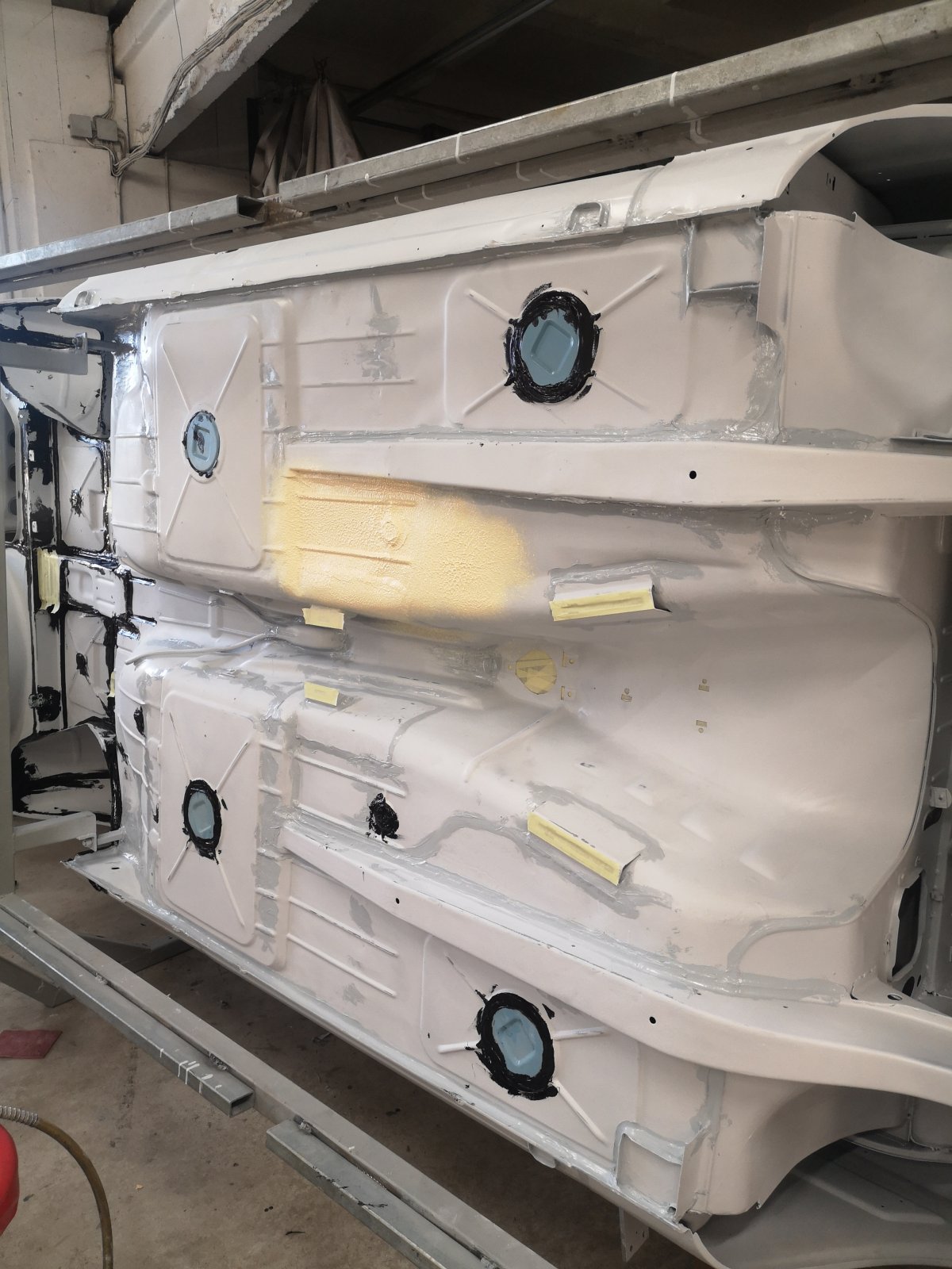

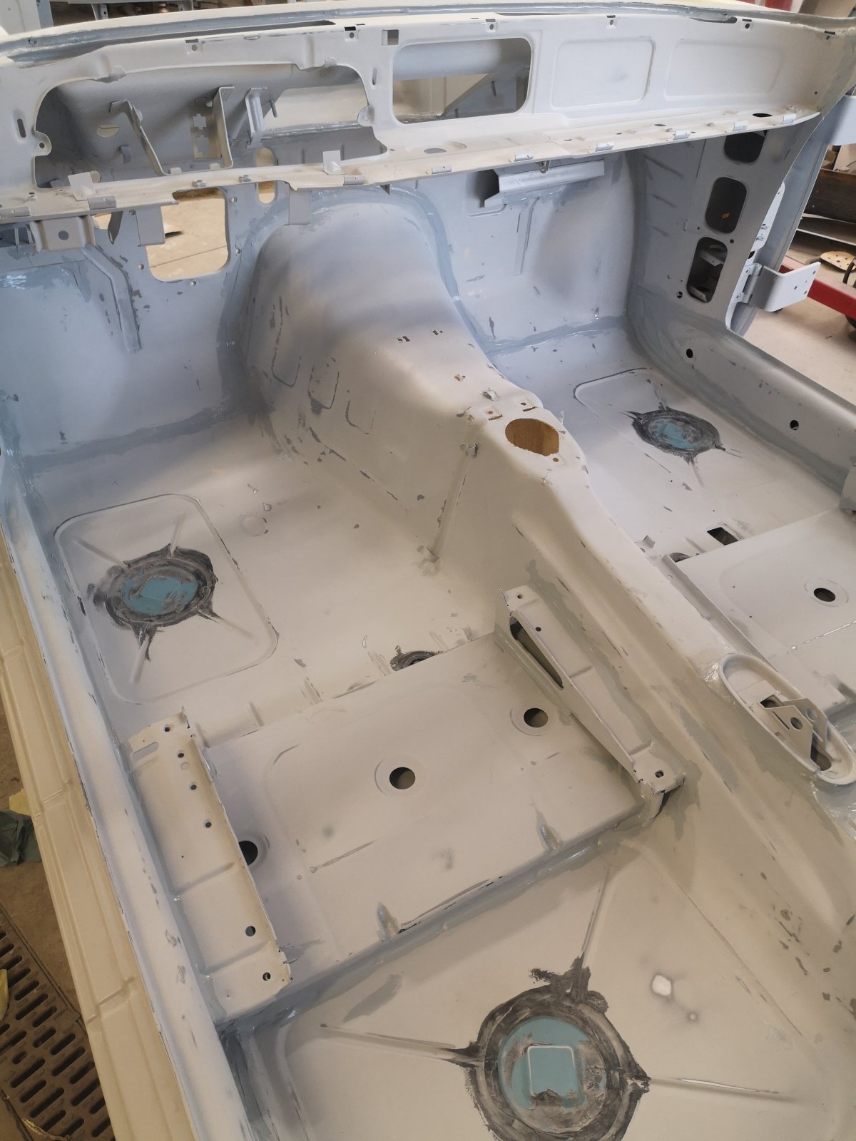

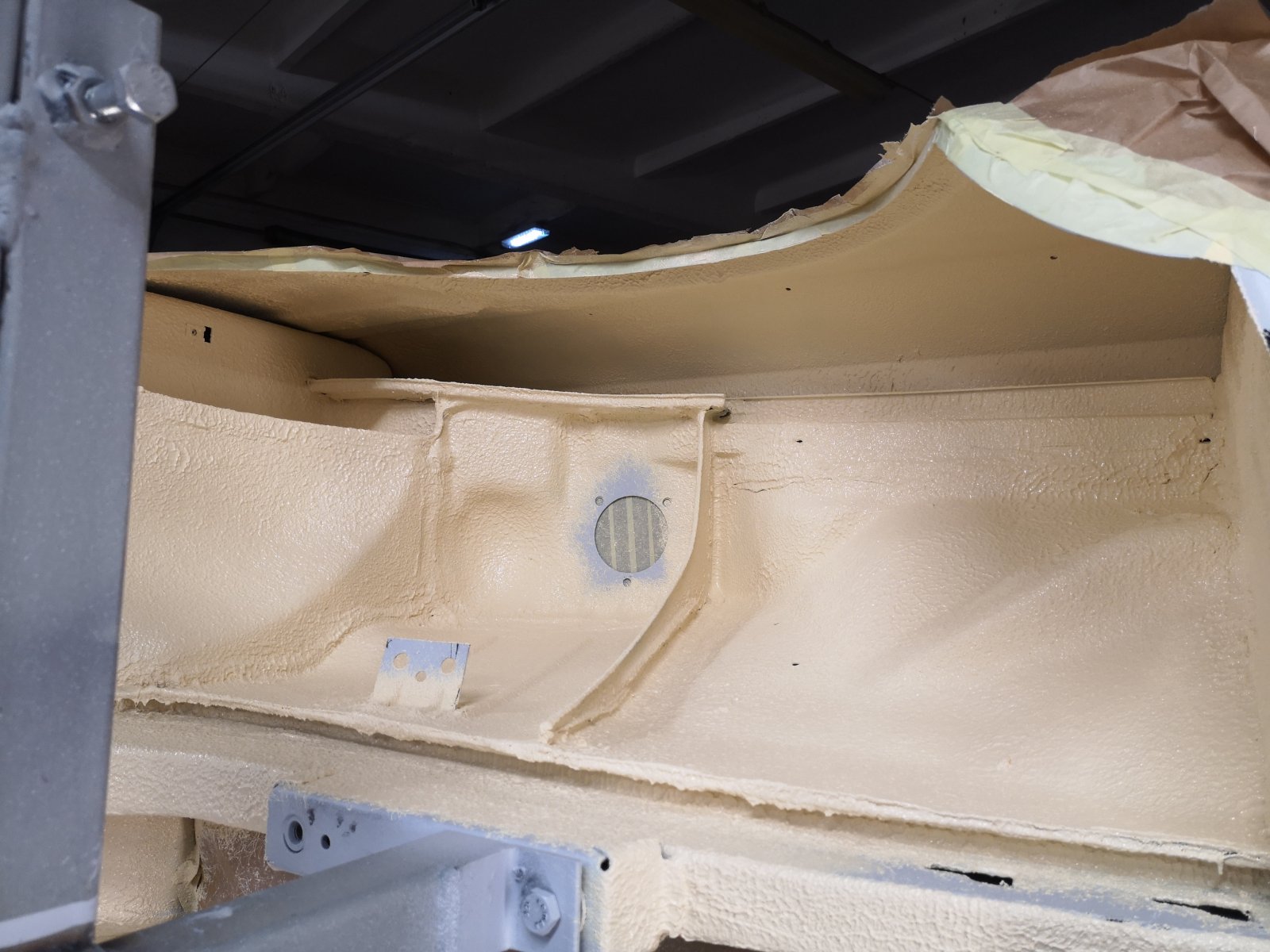

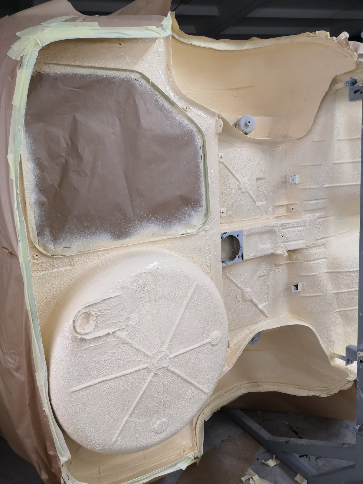

Some good, visually pleasing, progress from February, 92h spent. And yes, we had to source some 10 more cans to cover all the underbody.

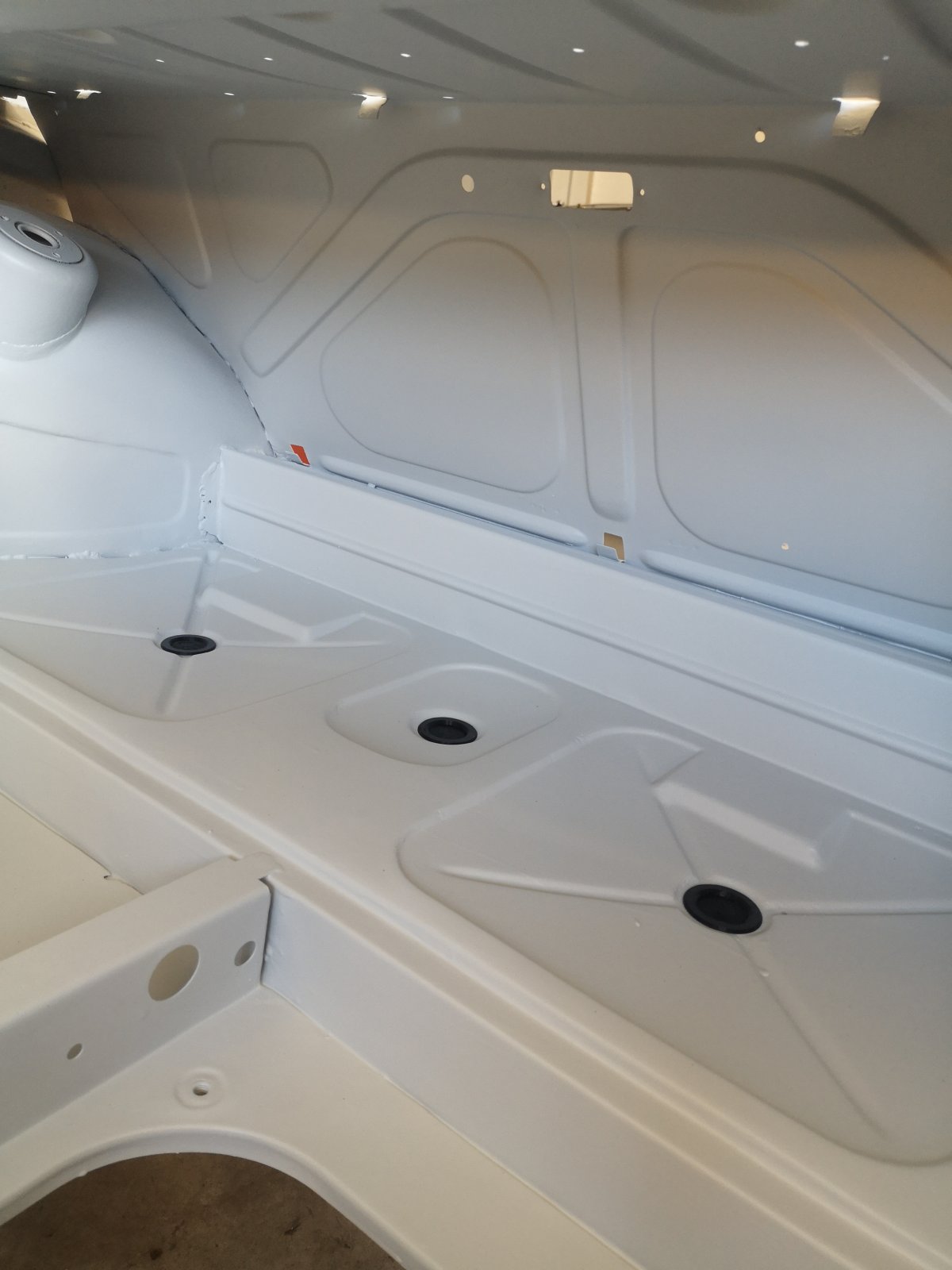

3D-printed body plugs :)
First coats going on
A bit of sanding here and there

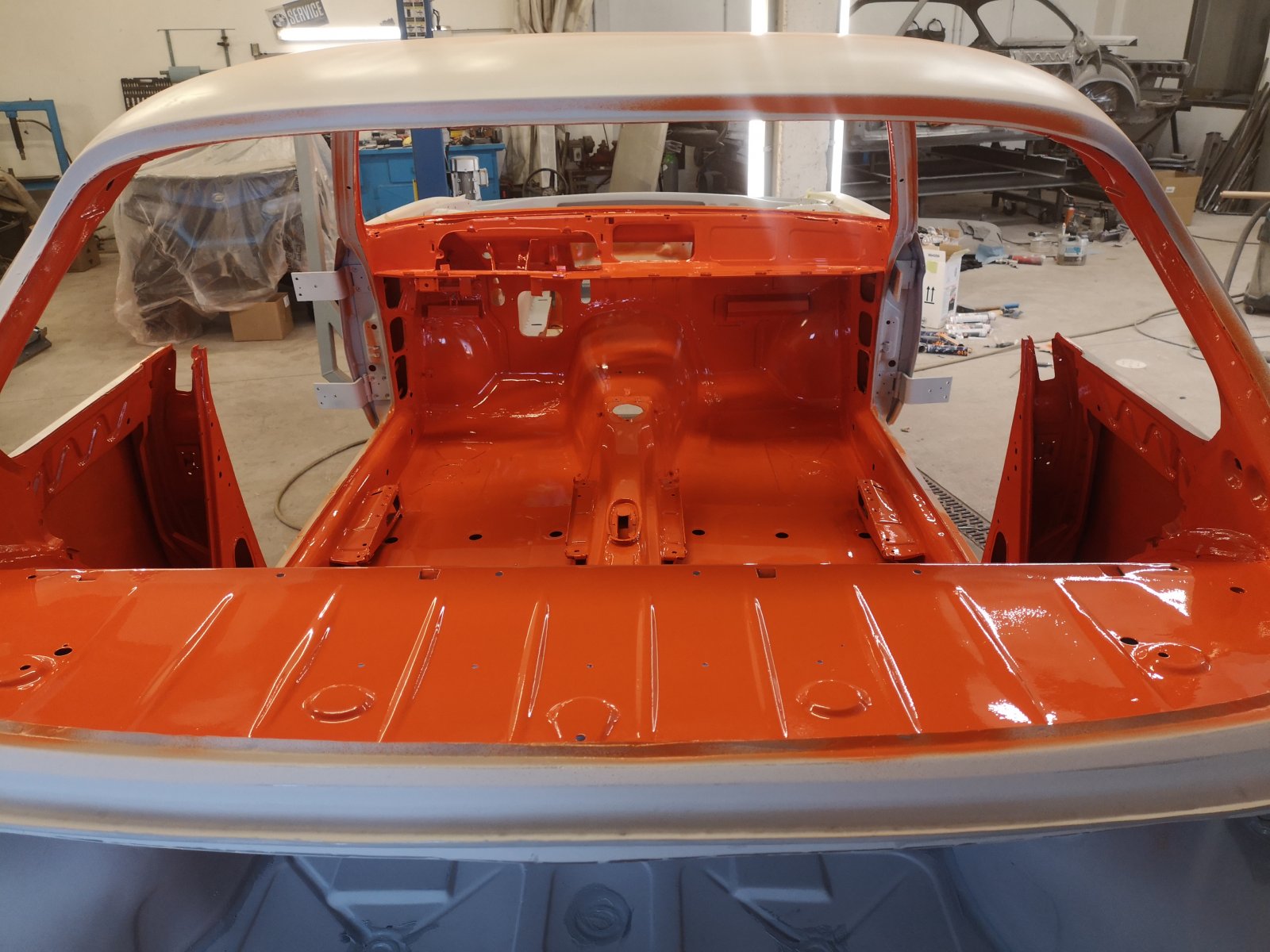

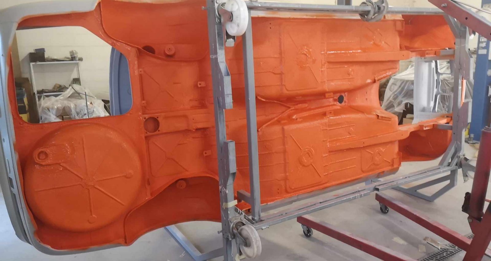

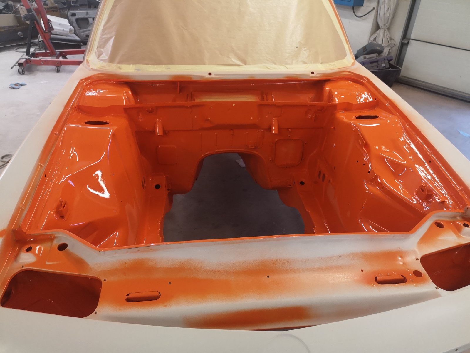

And finally some color :)
Boom!
Orange is said to encourage socialization, which could be an indirect stimulant for the appetite - if not risking getting fat now, it surely grabs attention. :)

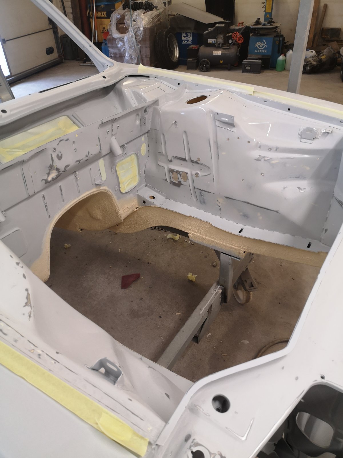

Aha… though maybe it was some new seam sealer I didn't know about
What brand of primer are you using? are you using all metal or something similar as filler?

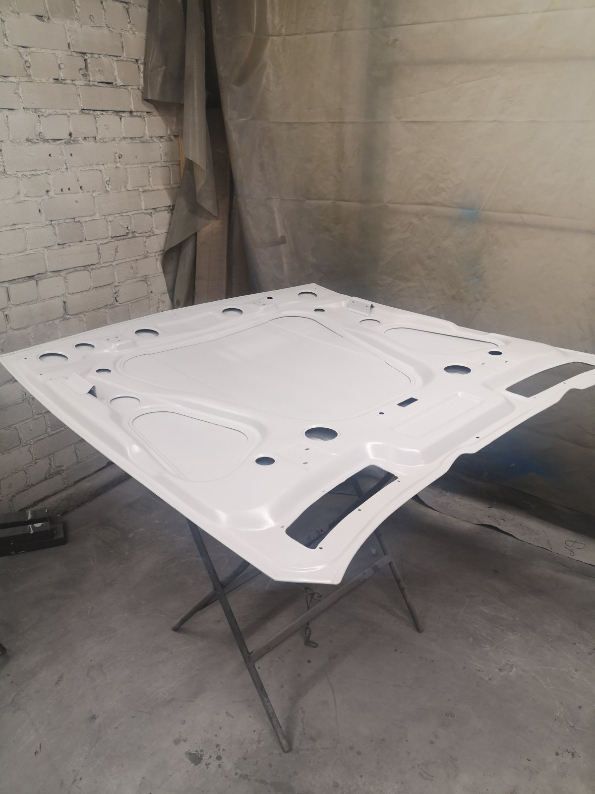

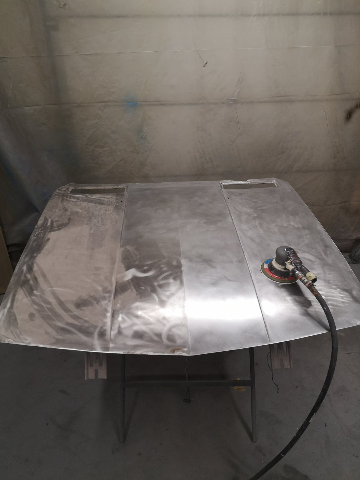

Boom!
That is one un- f-ing incredible restoration!

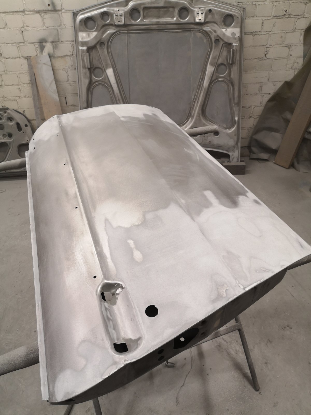

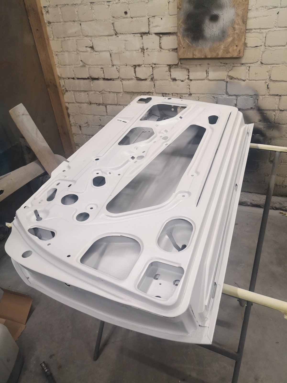

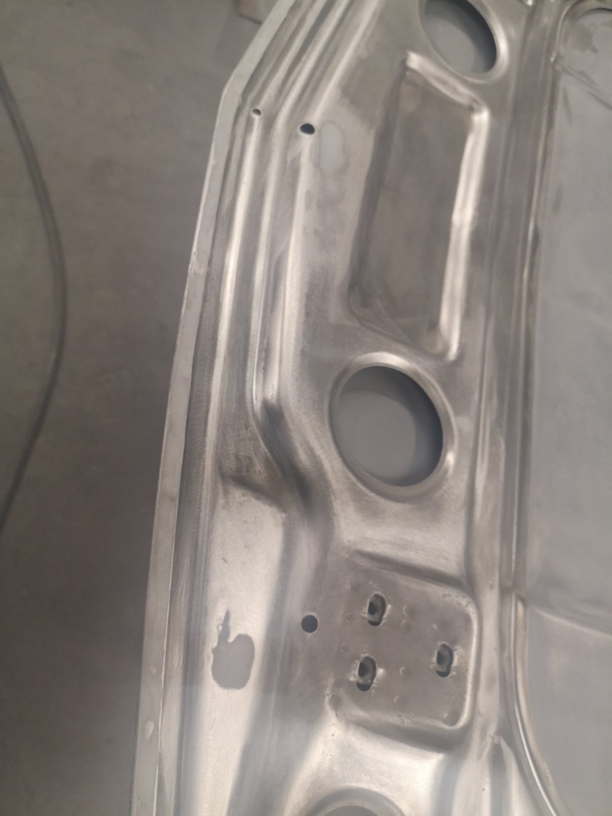

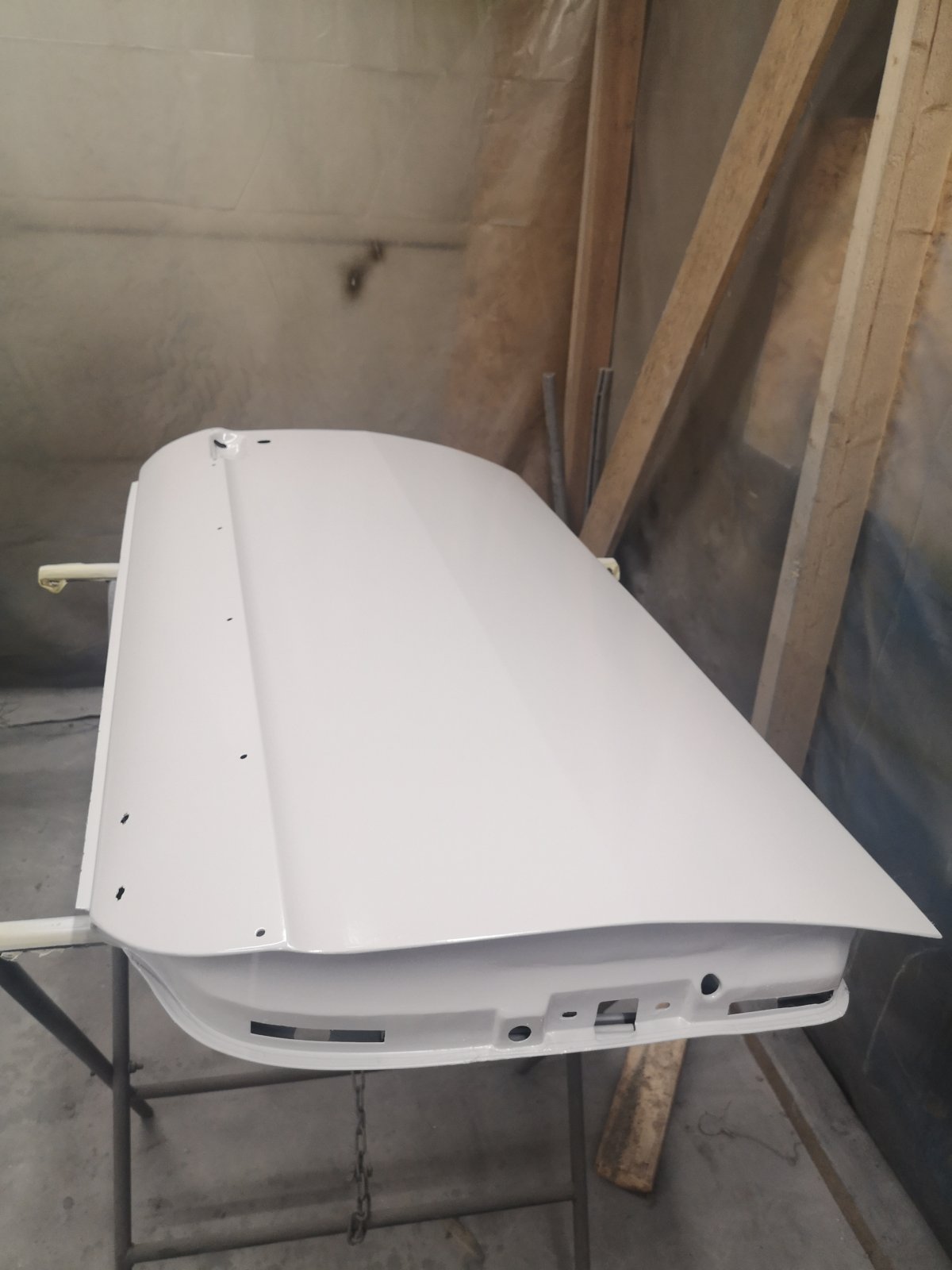

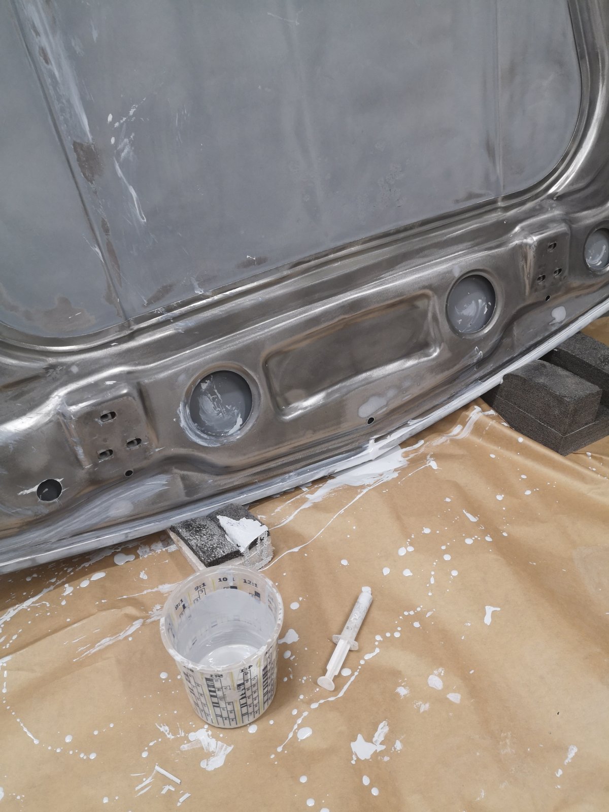

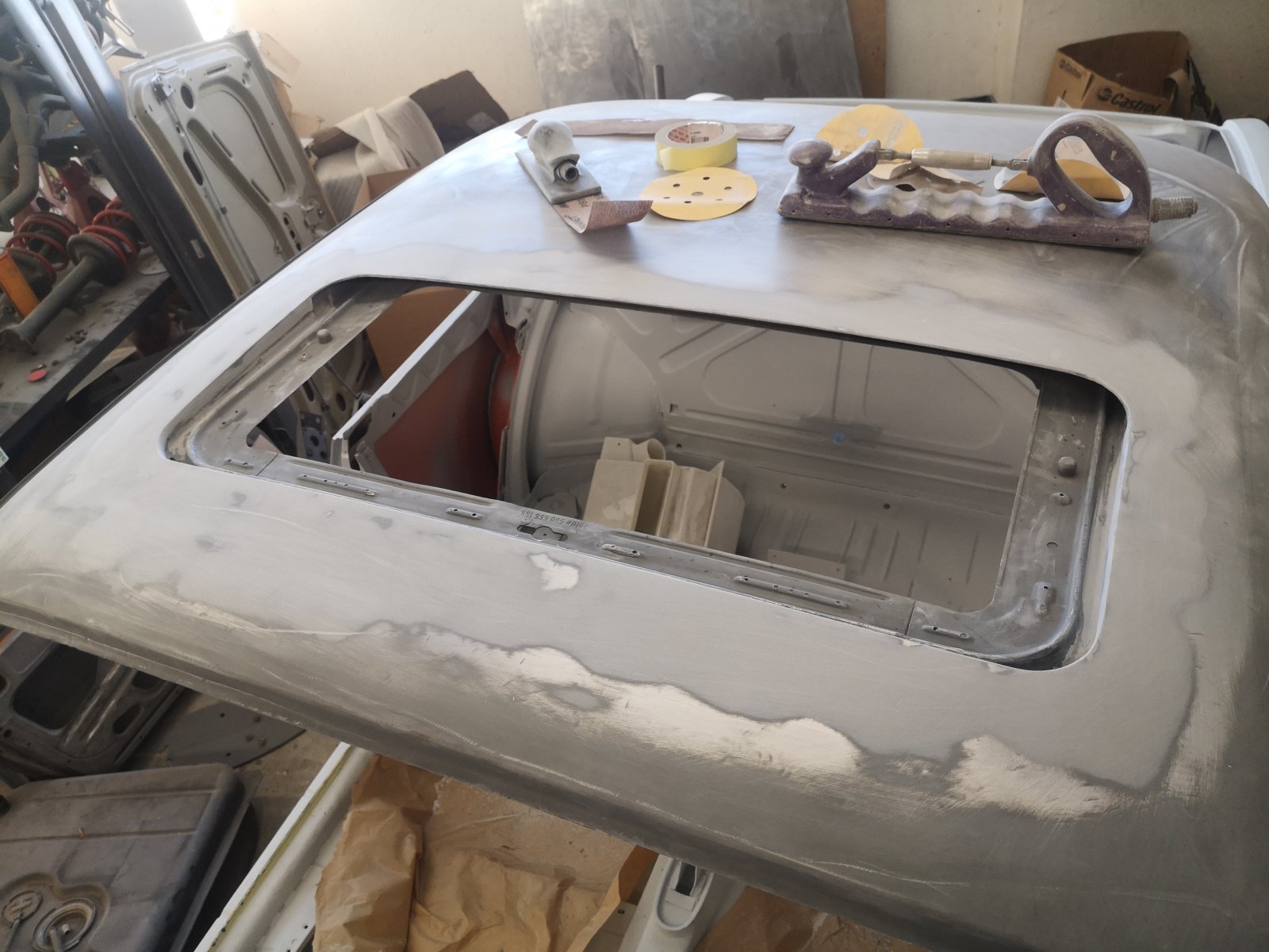

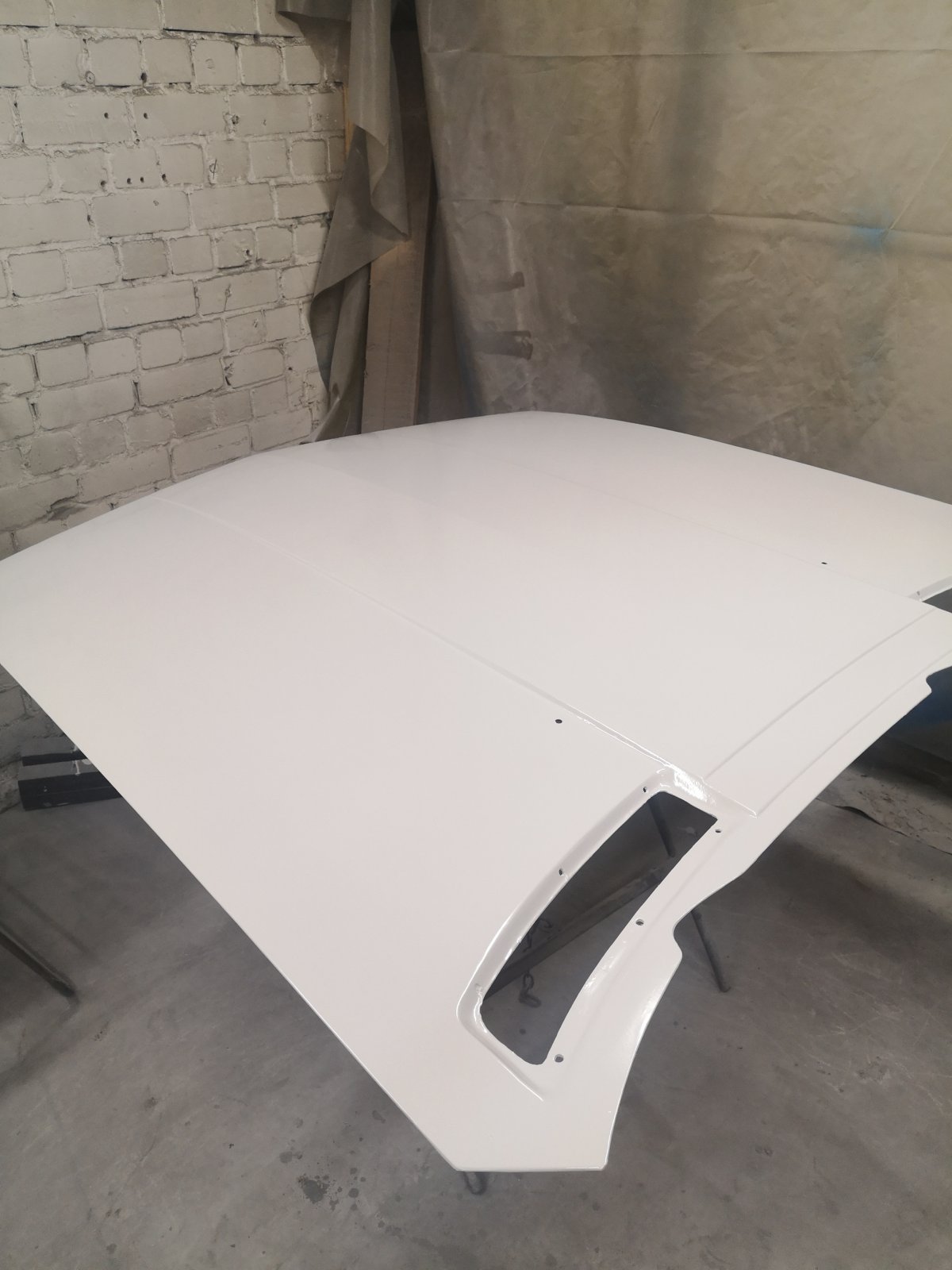

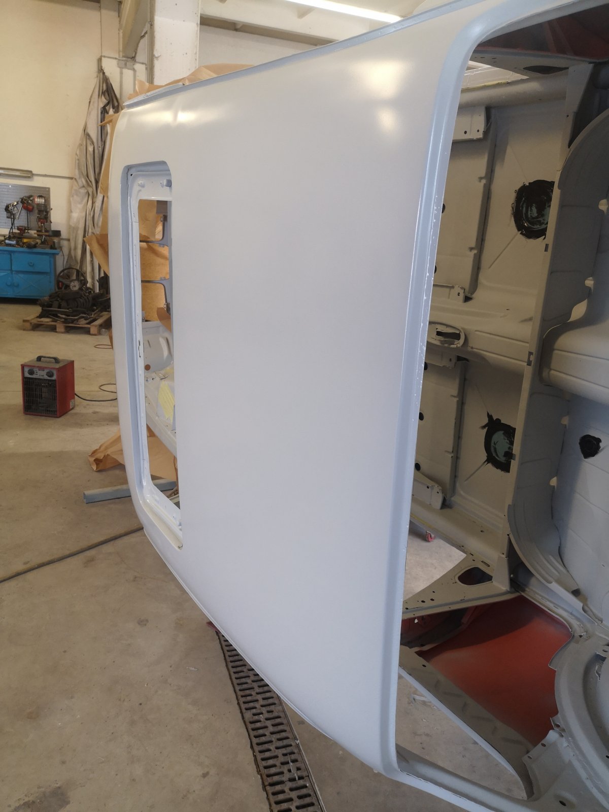

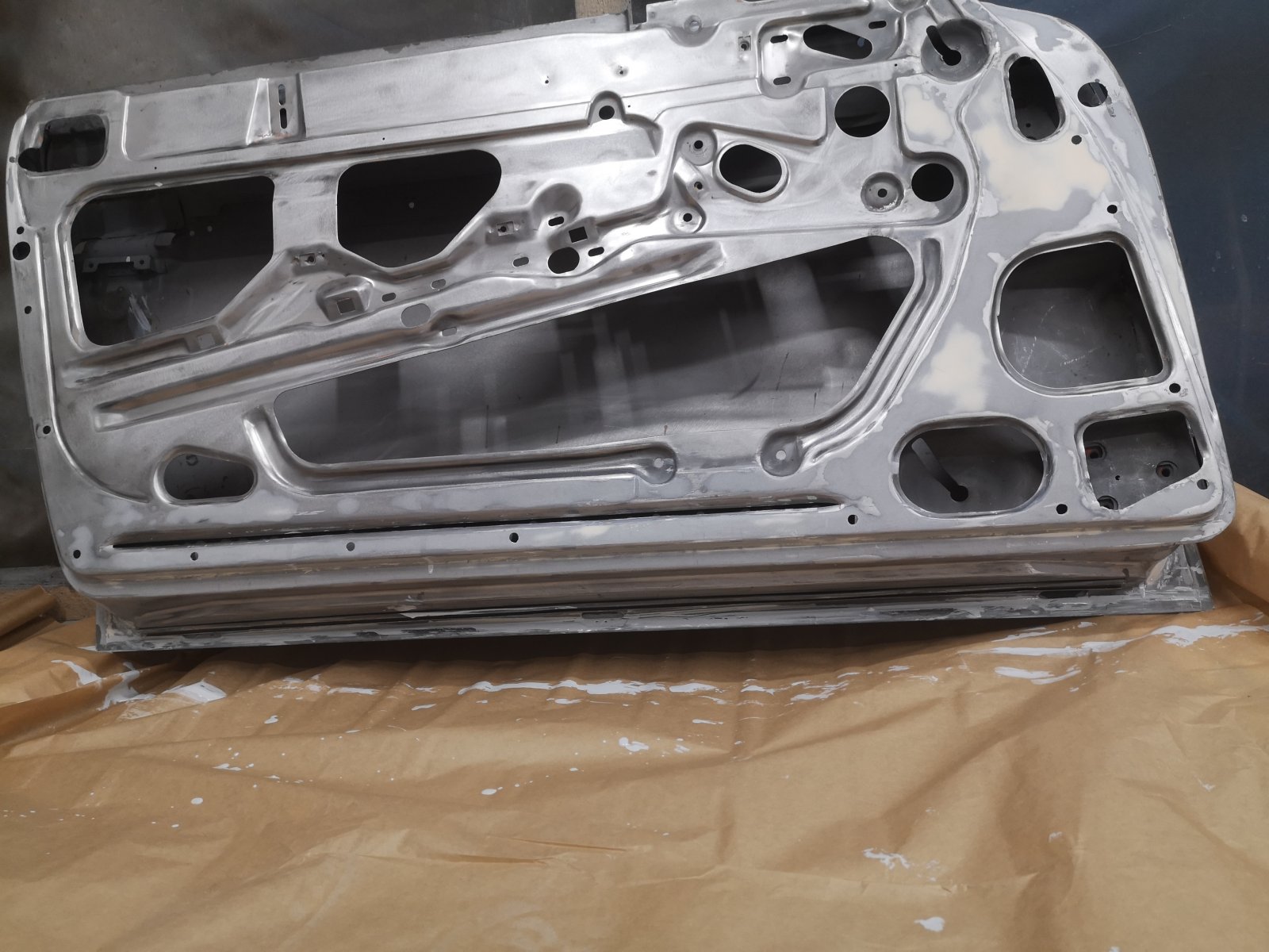

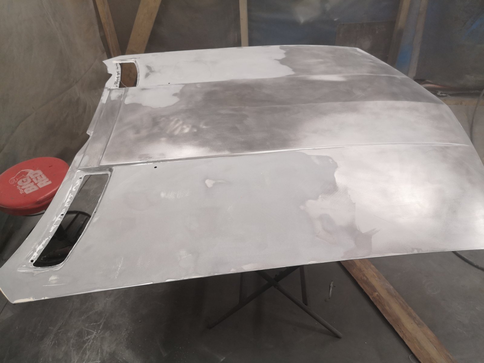

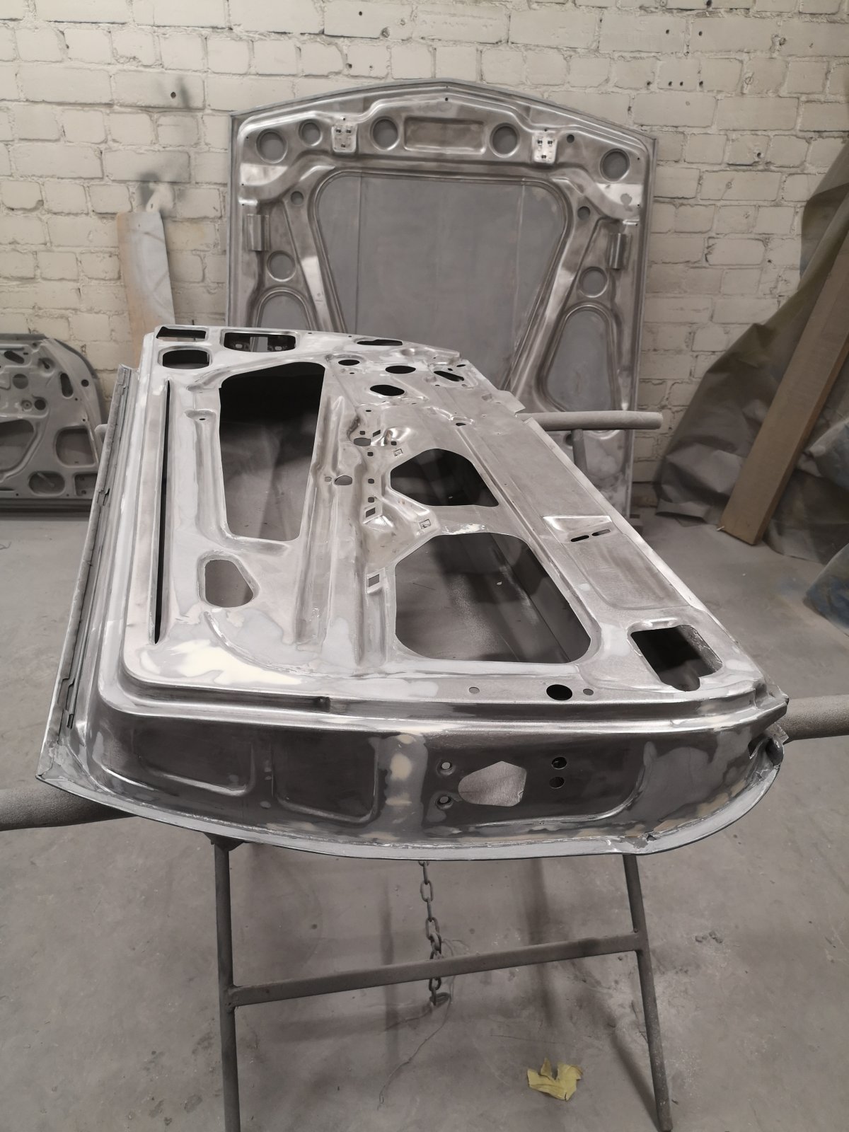

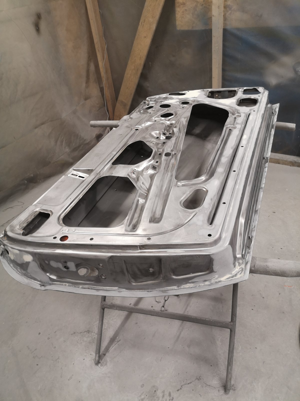

In March, work continued on the loose bodyparts - hood, trunk, doors etc. Cleaning, sanding, filling, primered... hours spent in March - 58h
Next, these will rest a few weeks and then get some color on the inner sides too.

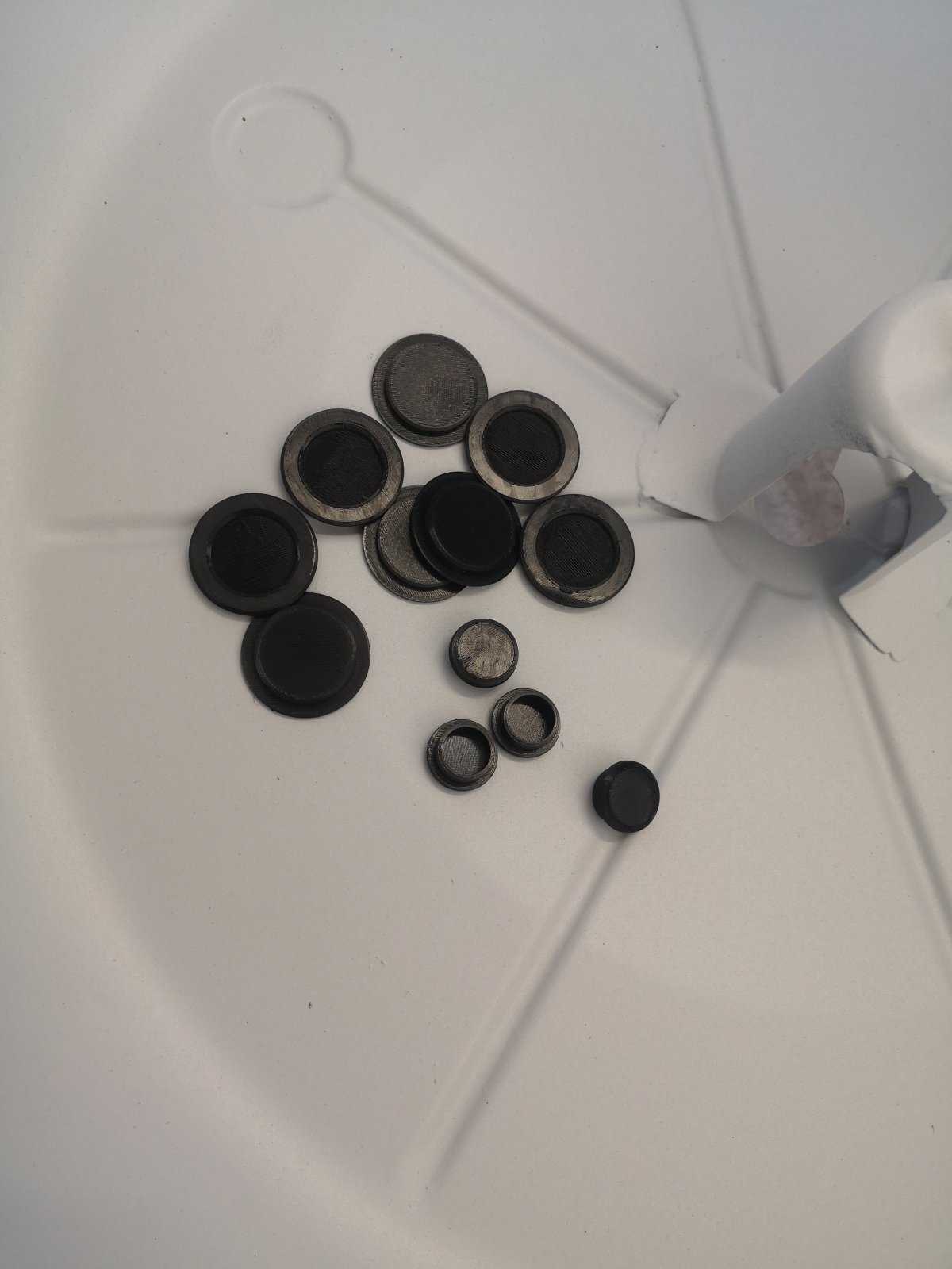

Do you have the files for the 3D-printed bodyplugs?

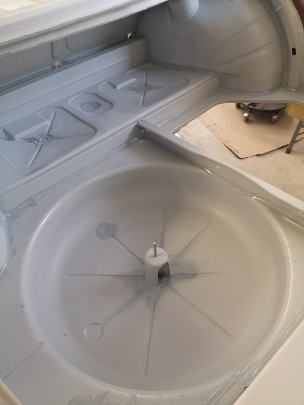

A suggestion to you and @Johan_CS2800 for the larger 3D printed plugs; the originals are rubber for a reason; they are designed to seal very well: they need to hold out water in the trunk and floor sections, and engine (leaking exhaust) air in the plenum.
I 3D print a lot for my work, and most 3D printers can't print materials that are fully smooth - something you'd want if a you are looking for a good seal. Even if you print them in flexible TPU, they would still leak. To get that 100% seal, I'd set your 3D printed parts in sealer.
As these parts are also used on e3's, they do come up once in a while when one is being send to a crusher. There's also someone on Kleinanzeigen who has a bunch of these small parts on offer.
The smaller ones will work very well indeed. I can model them for you if you want.
my bodyshop guy does the work and chooses the materials to be honest. I know he mentioned something like lead-filler for the hood etc for larger repaired areas
Hi @xjan99 , Really, really nice work!
Yes, these have even a bit of slack in order to not damage the paint and as can be seen are fixed with body sealer.
@Johan_CS2800 and other interested, here is the link to the 3D files for both 19 and 35mm plugs: https://drive.google.com/file/d/1AvWeTn0ADTQiDIwCZEOZIDxH_1IxkeyB/view?usp=sharing
