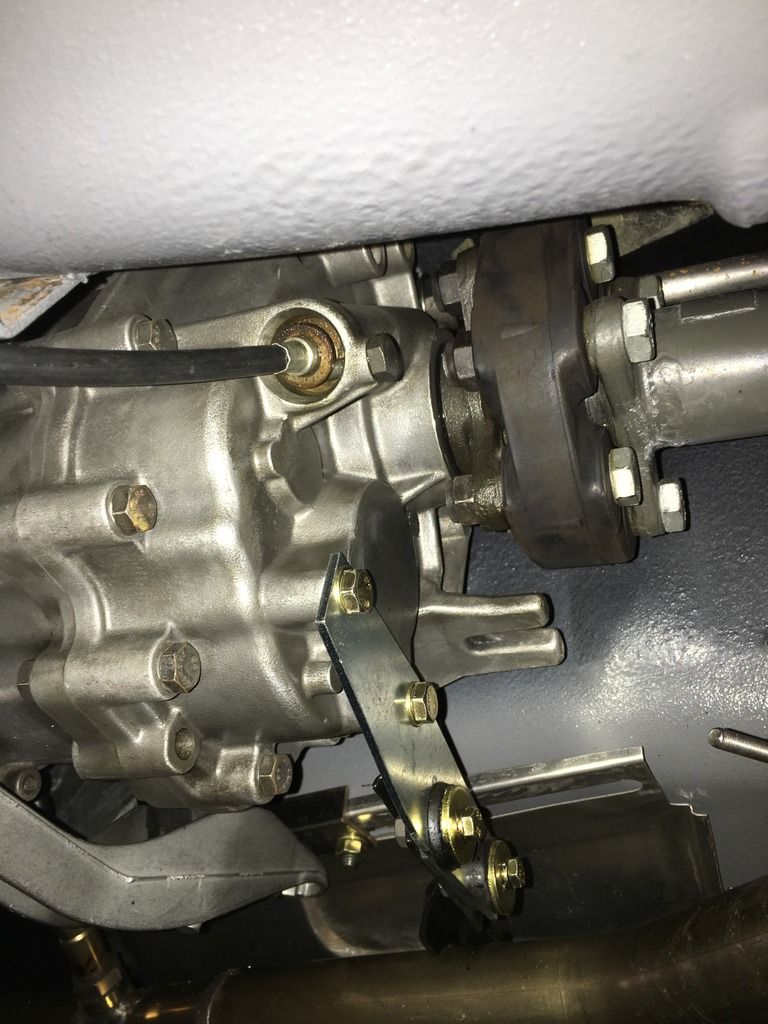

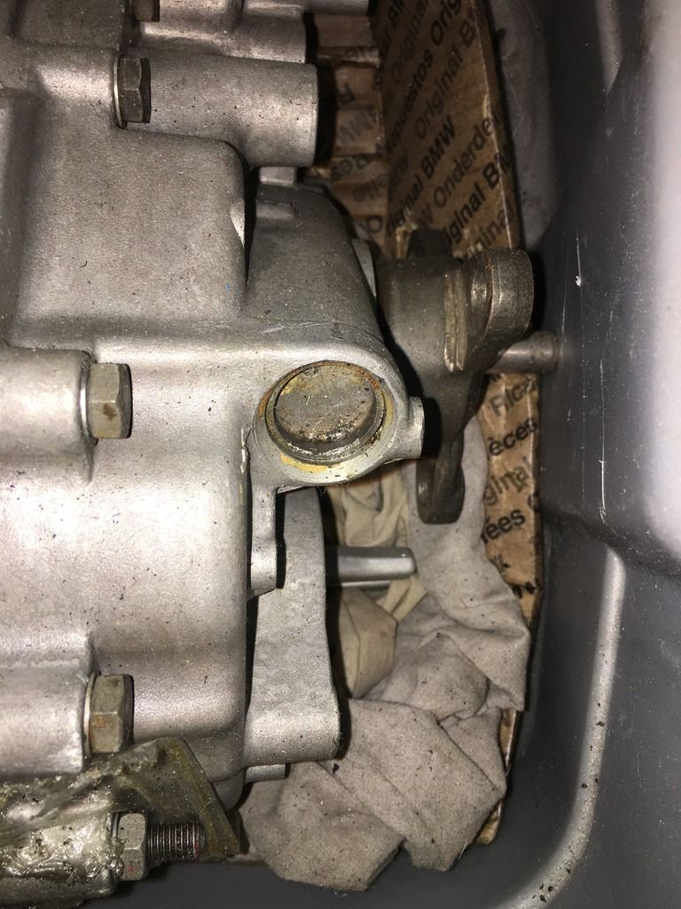

The Inca arrived today! As a bonus it came with a 5-speed dogleg 260/5, which I believe is not going to work together with the speedometer as it has no speed cable... any advice to sort this?

There should be a plug at the same location where the speedo drive is on an early 265 or a 4 speed. You'll need to remove the plug and insert a speedo drive from another gearbox. You will also need to check if there is a drive gear mounted on the output shaft that will turn the speedo mechanism. Some later gearboxes retained the gear otherwise you'll have to open the back of the gearbox and instal a gear from another gearbox. Make sure you seal it up properly if you do open it.
Can you maybe direct me to a photo with the speedo drive/plug placement so I can compare?
I found this on bmwfans...
http://bmwfans.info/parts-catalog/E...ual_transmission/getrag_262_speedometer_drive
Thanks, I will inspect this! And the gearbox also came with a nice Alpina gearknob btw :), seems period-correct and in great condition.

I checked, the dogleg transmission has the speedo drive attachment, not a plug so this helps. I am leaning towards the Inka to be the first build with dogleg box and S38B35, as it does not have the matching numbers engine anyway. But the color, it screams racecar to me, rather than a cruiser so I really cannot make up my mind easily. A CSL or Alpina front spoiler, CSL wing arches and 17"s with lowered suspension... also the ducktail trunk spoiler. Or.. go Heidegger style fenders even?
