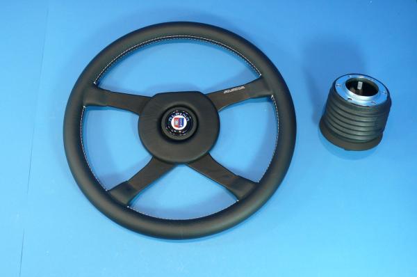

Alpina 4-spoke steering wheel + hub and horn button

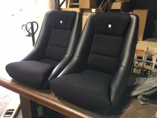

CSL Scheel seats, rails and tilting mechanism, headrests + a few meters of matching fabric for rear seats and parcel shelf

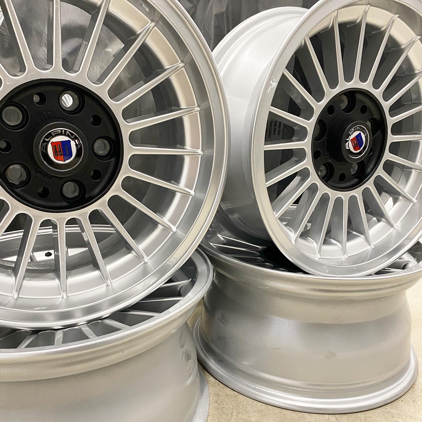

Meanwhile the original 16" staggered Alpinas arrived and were refurbished + as of today, the car and first batch of parts (body) is sent off to the "coachbuilder". After years of sitting in storage, my E9 was again enjoying fresh air, on a trailer :)

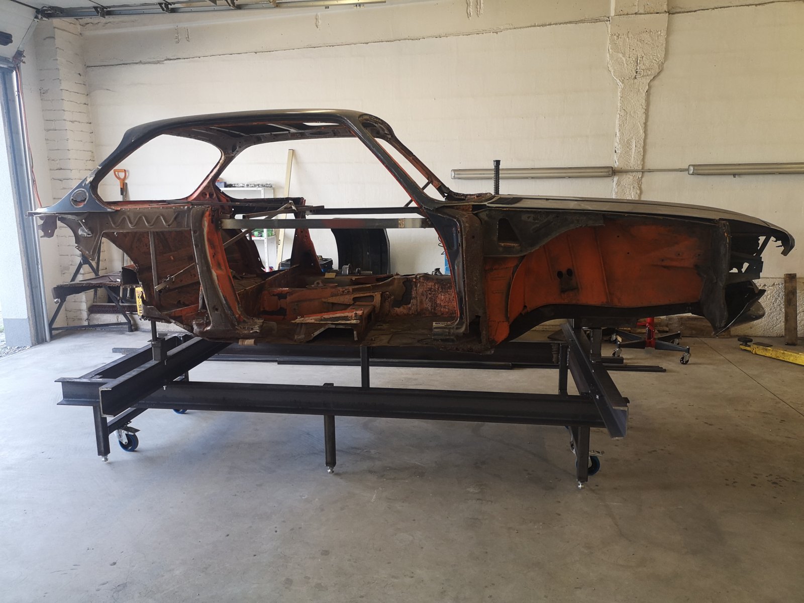

Although it was the last days of May already when the car was sent off to the bodywork, there is something to report for the first month.
Progress for May:

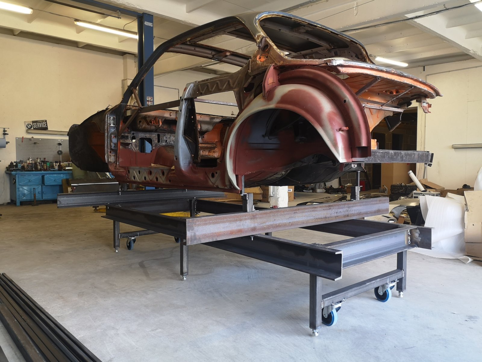

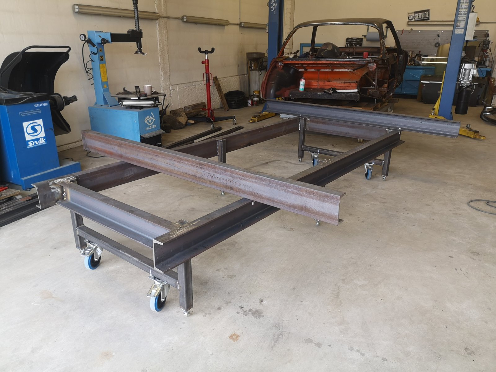

a)
dolly welded up, car aligned and levelled to it. The extra feet under the dolly are for levelling it and help with taking various measurements.
b) a thorough list of additional misc small metal parts needed from W&N also made, total 32 items and ca. 2500EUR.
I will dig through the stuff I still have boxed up at home, and maybe with a bit of luck, there are some parts already there :)

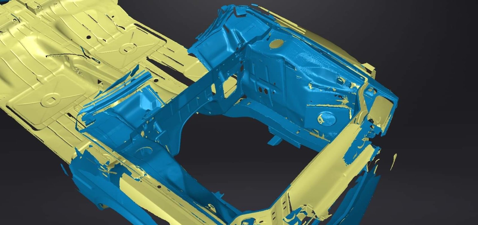

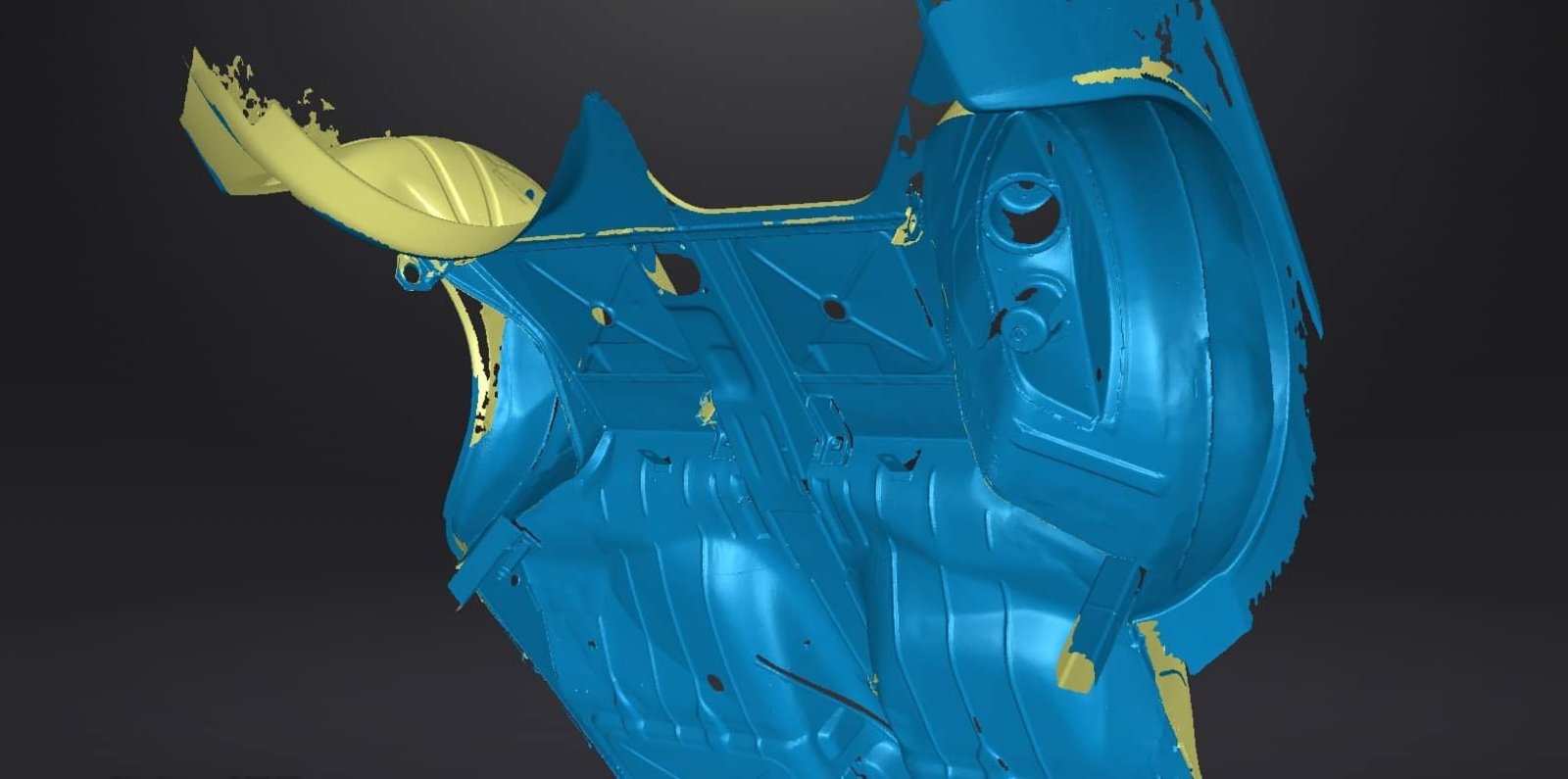

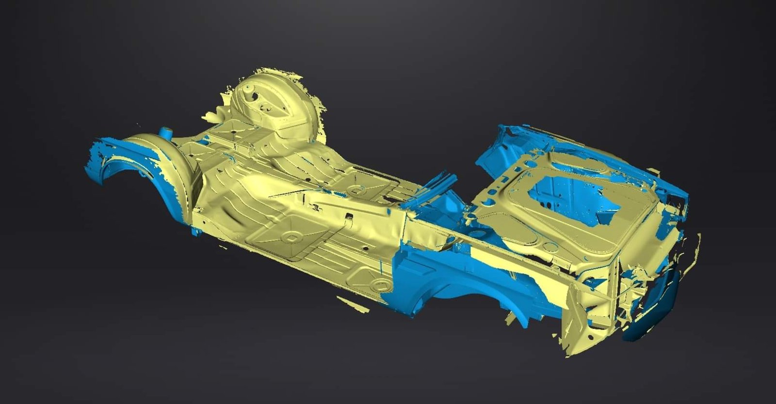

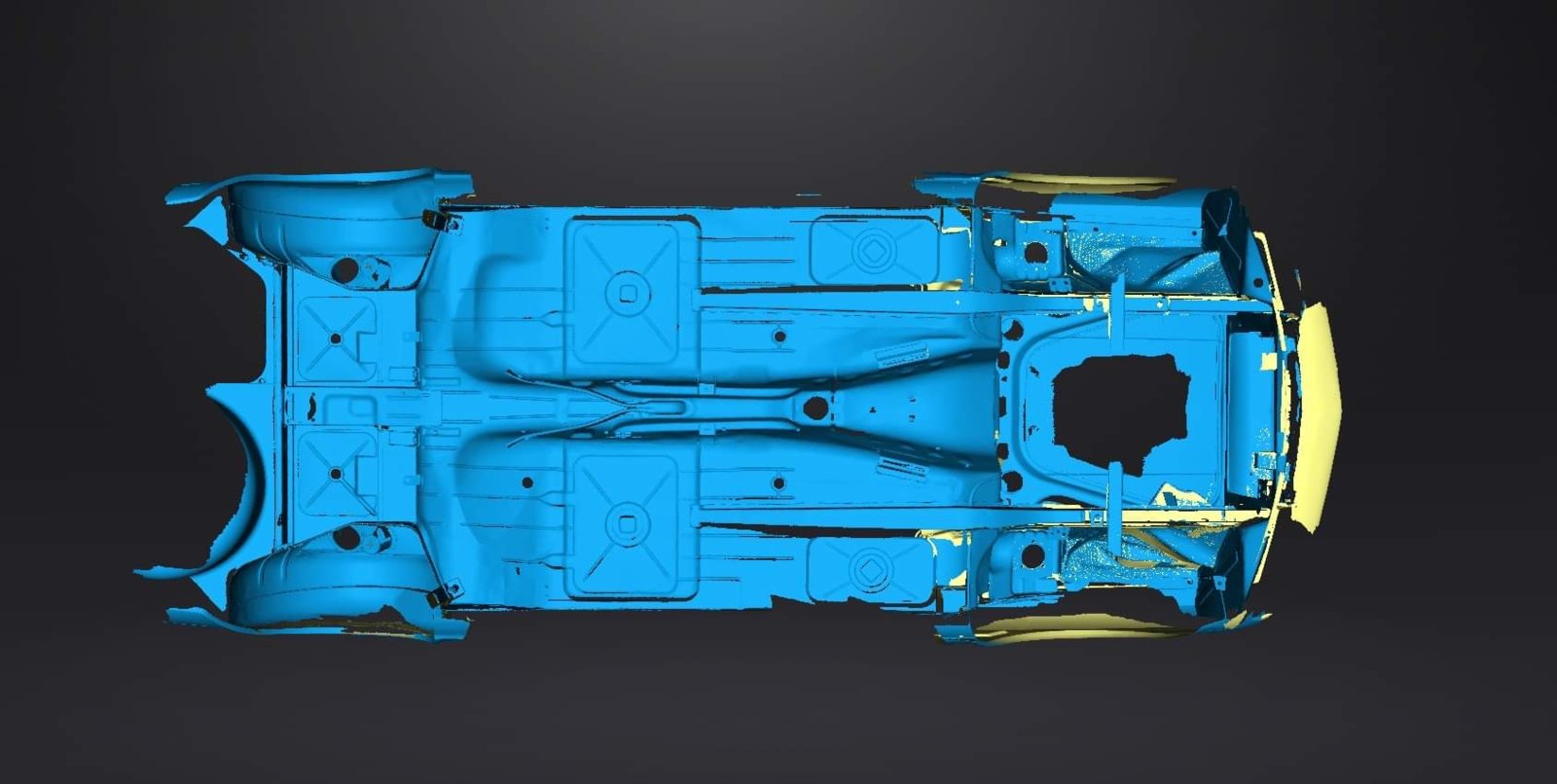

Just for reference points and it might be useful when playing with the engine upgrade, axles etc, we made a laser scan of another restored E9 bare shell. Will scan more parts later on too.

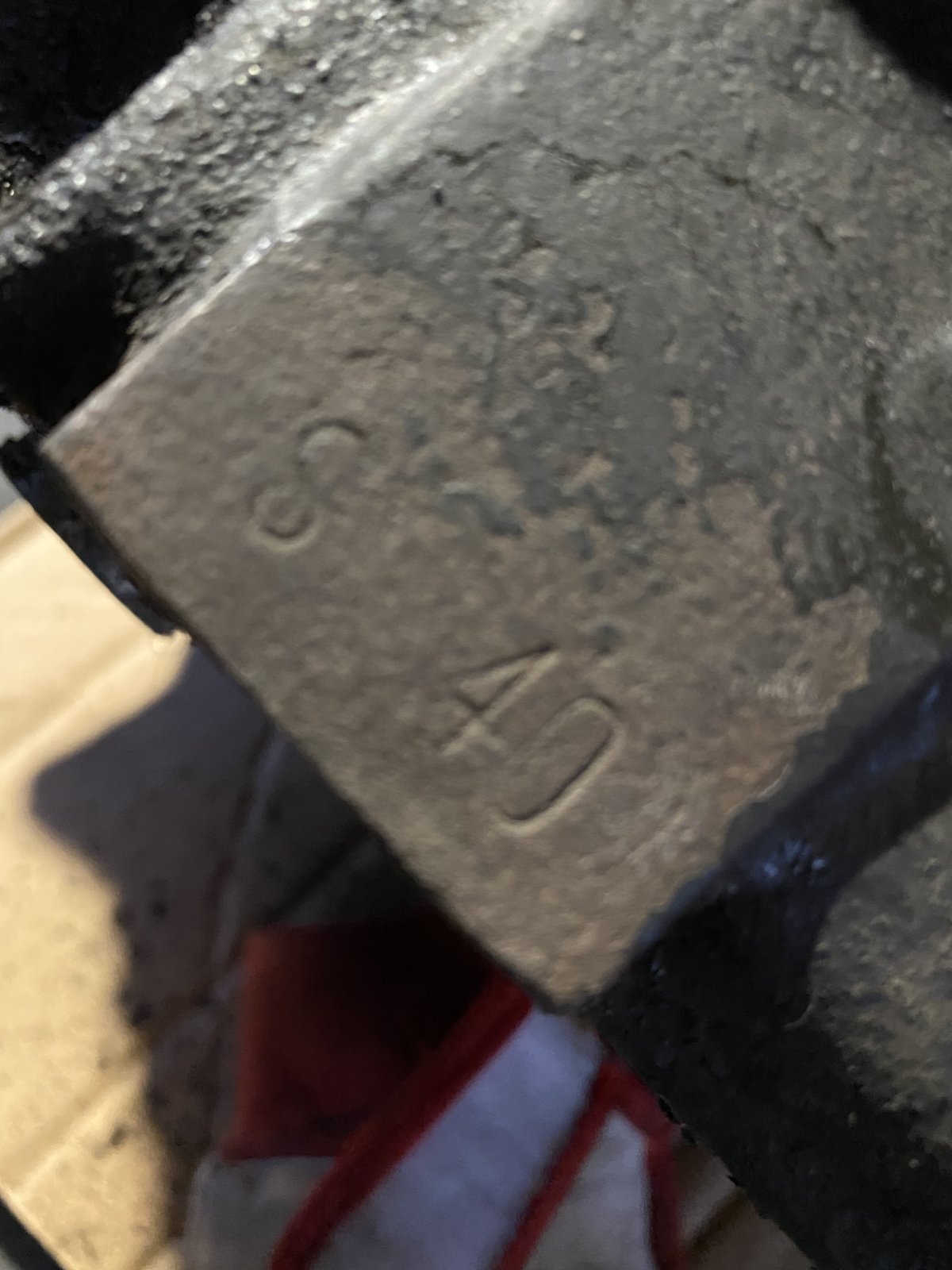

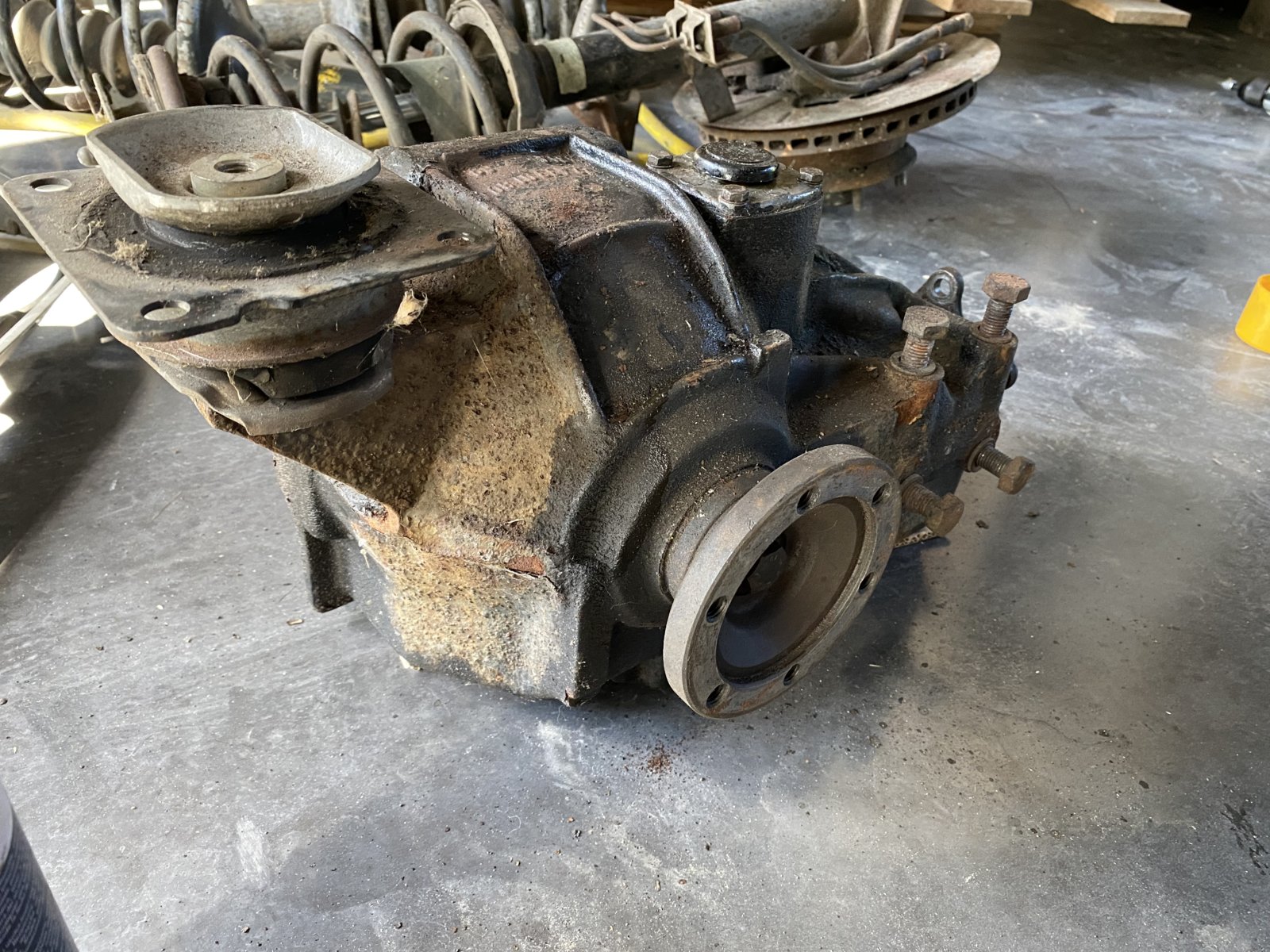

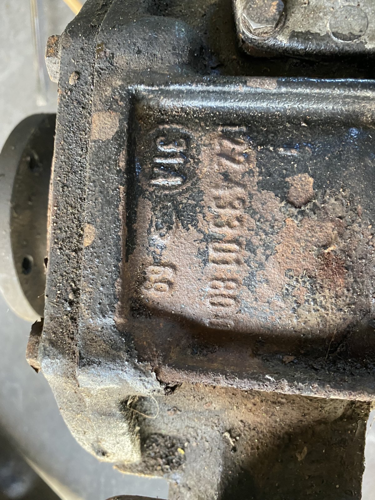

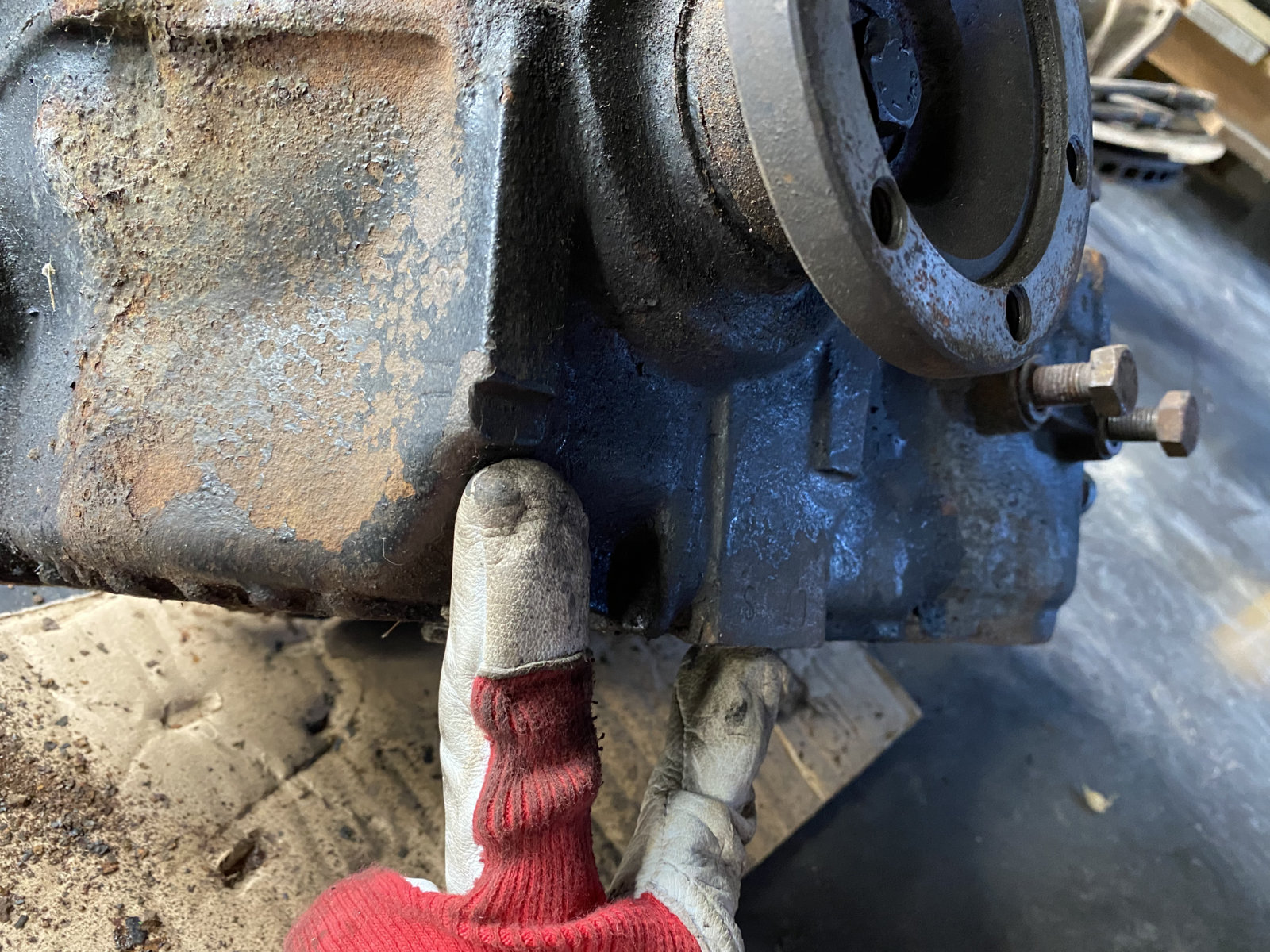

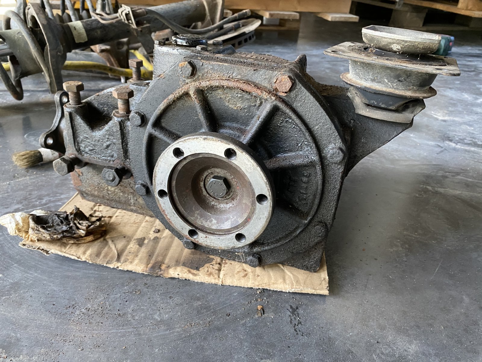

Ps! “S 40” marked on the diff means I have a 40% lock LSD diff? 3,45 ratio probably ?

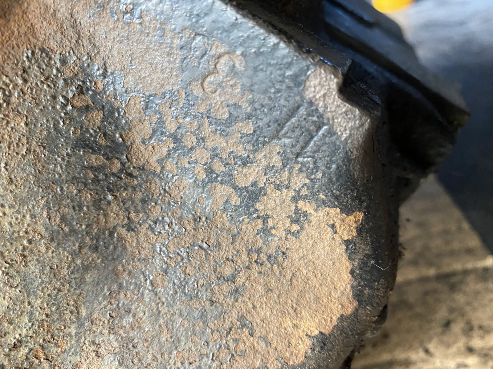

I found the other markings too further back on the diff - 11 38
oil smells like the LSD one, inside does not look quite like the ones on E30s etc that I am familiar with. Casing number is 12243302800 31A 69

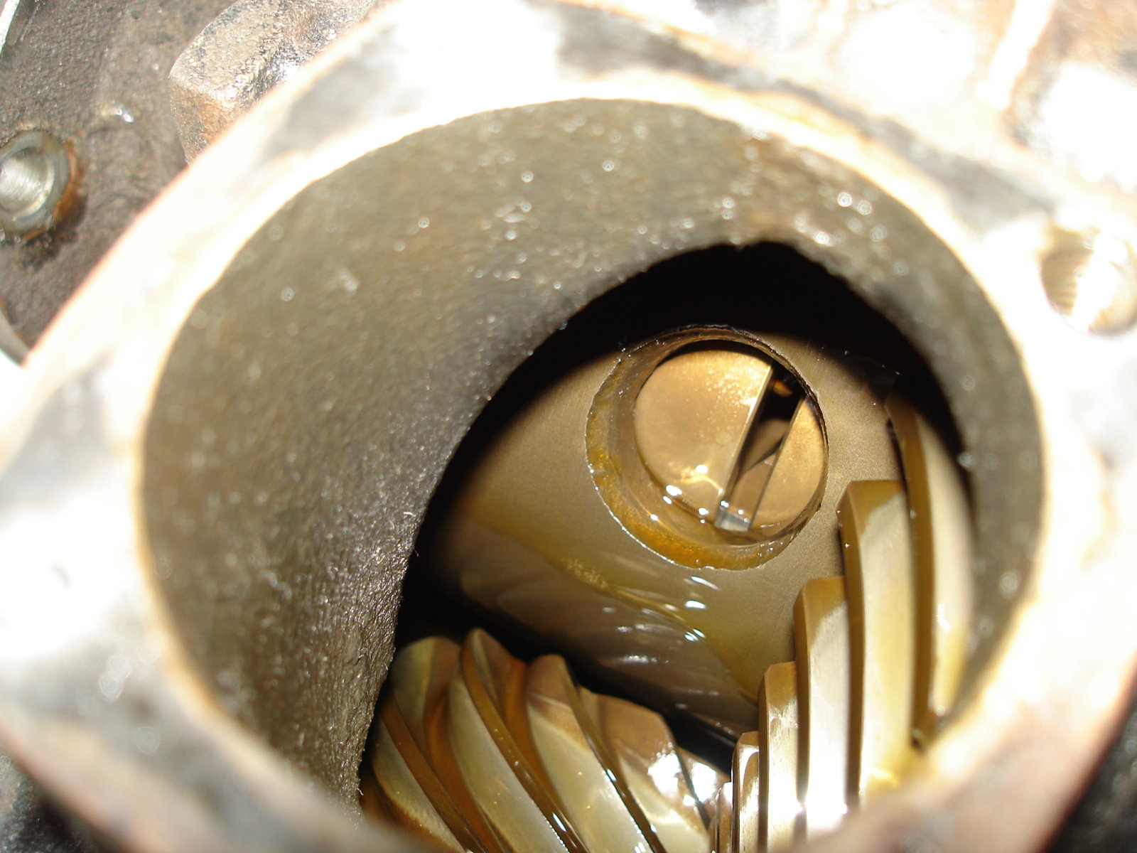

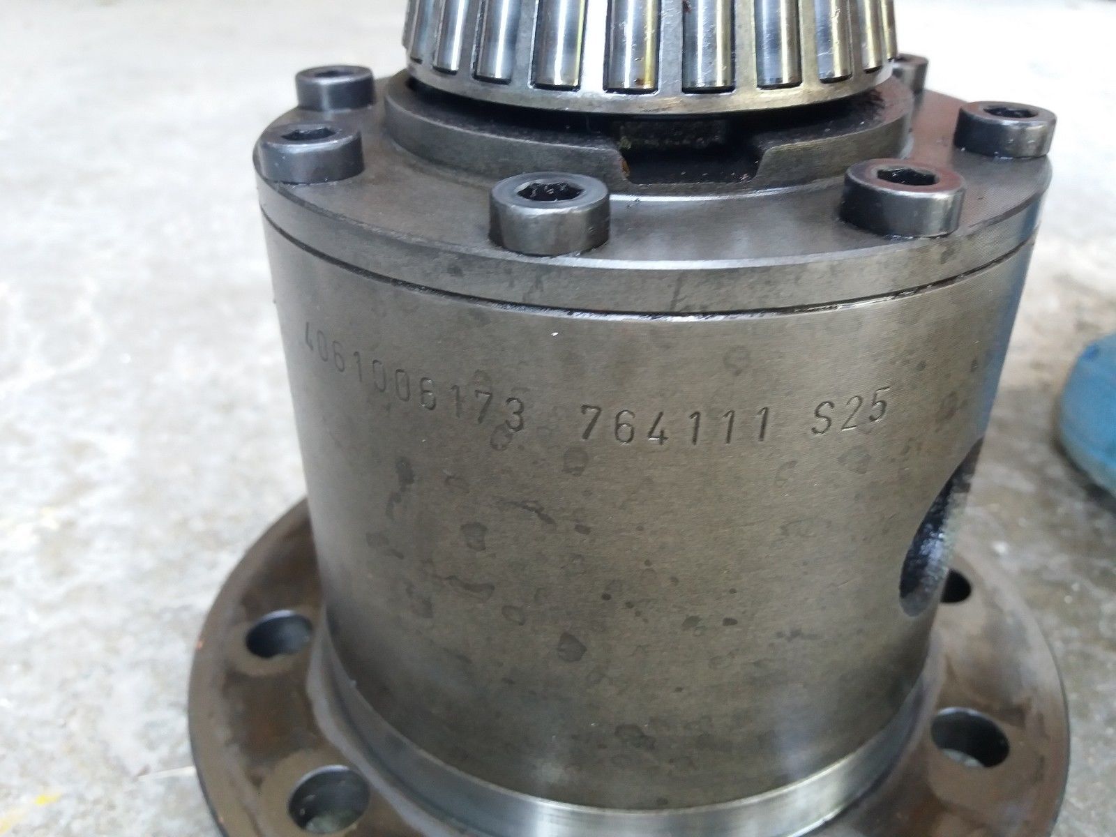

Open the vent on top and have a look inside, if it looks like the first attached picture it's likely an LSD.
With a little struggle you can actually read what the housing is stamped with through the vent hole. Check second attached picture to see what you're looking for.
There are LSD housings that say S0 / S25 / S40.
If you have the S0, it's not an LSD, but an open diff that uses the LSD housing (from factory).

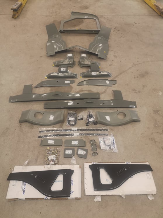

Some more parts. 2700 EUR worth of misc. small metal parts from W&N:

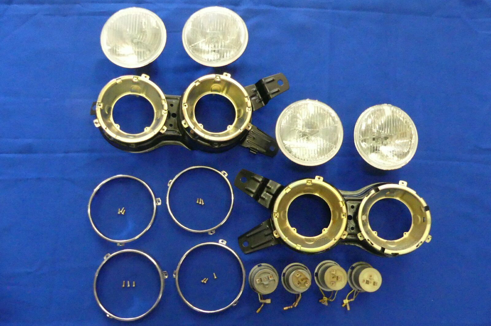

Refurbised headlight set with new lenses

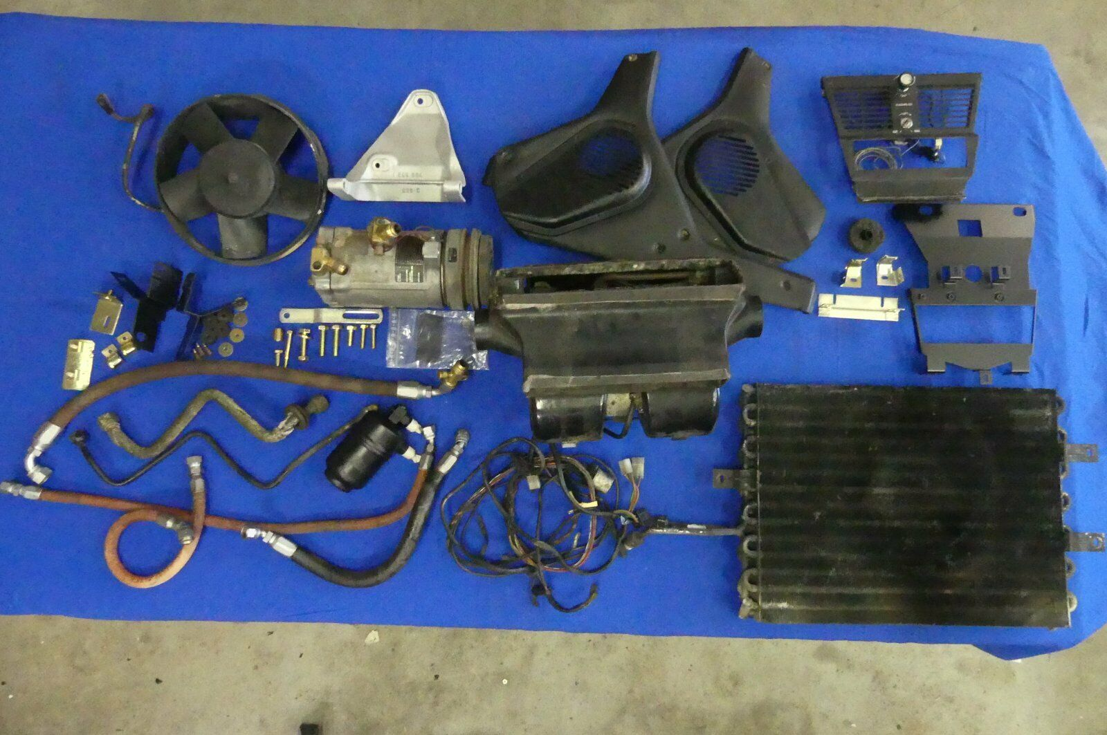

And a complete AC system

maybe change AC condenser fan now? Easy and cheap or is it not needed in Estonian weather?
