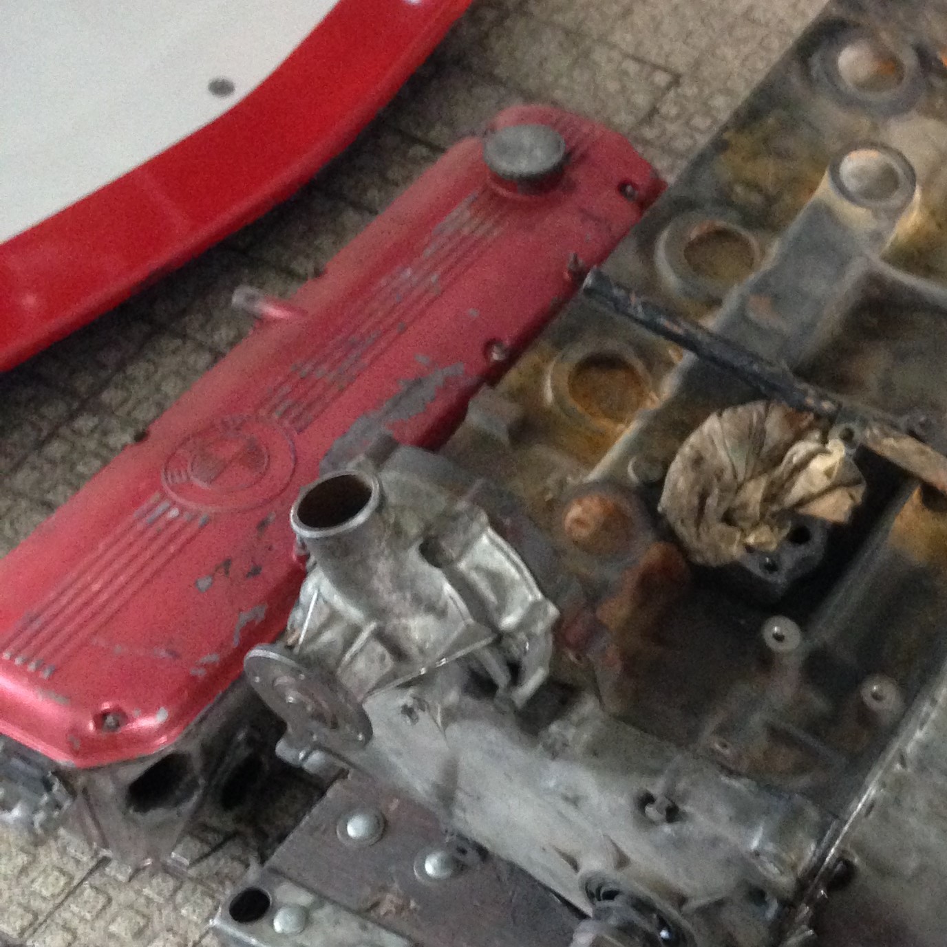

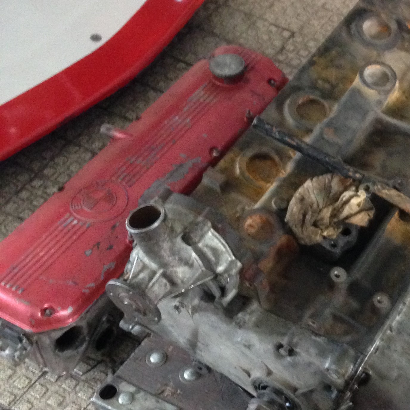

I wonder if Alpina painted the B2 engines with this red color on the cylinder heads cover, like yours had before.
Interessingly I own a B2 built in 1975 which has this same color.
Is it a pure coincidence ?

Well that certainly would be quite a coincidenc if the valve convers were both painted red by the owners..
On my car the alpina airbox and the csi air filter box showed signs of their original (black and grey/green) paint underneath the red, but I don’t recall seeing any other colour on the valve cover.
I’ve never seen another one in red though?
Here’s one in black........
