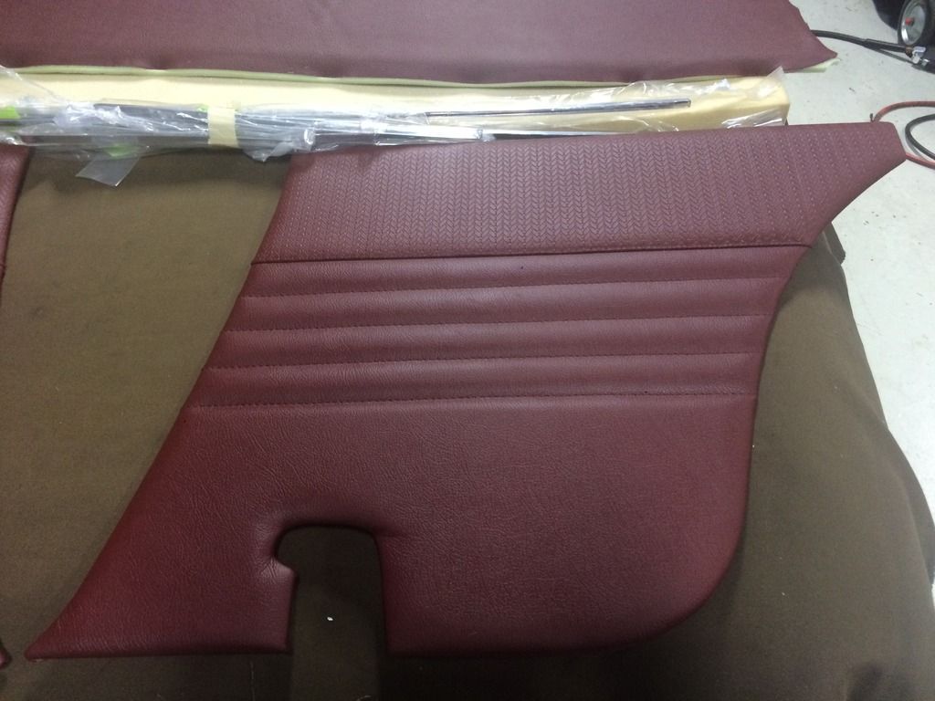

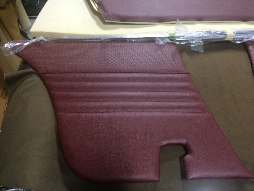

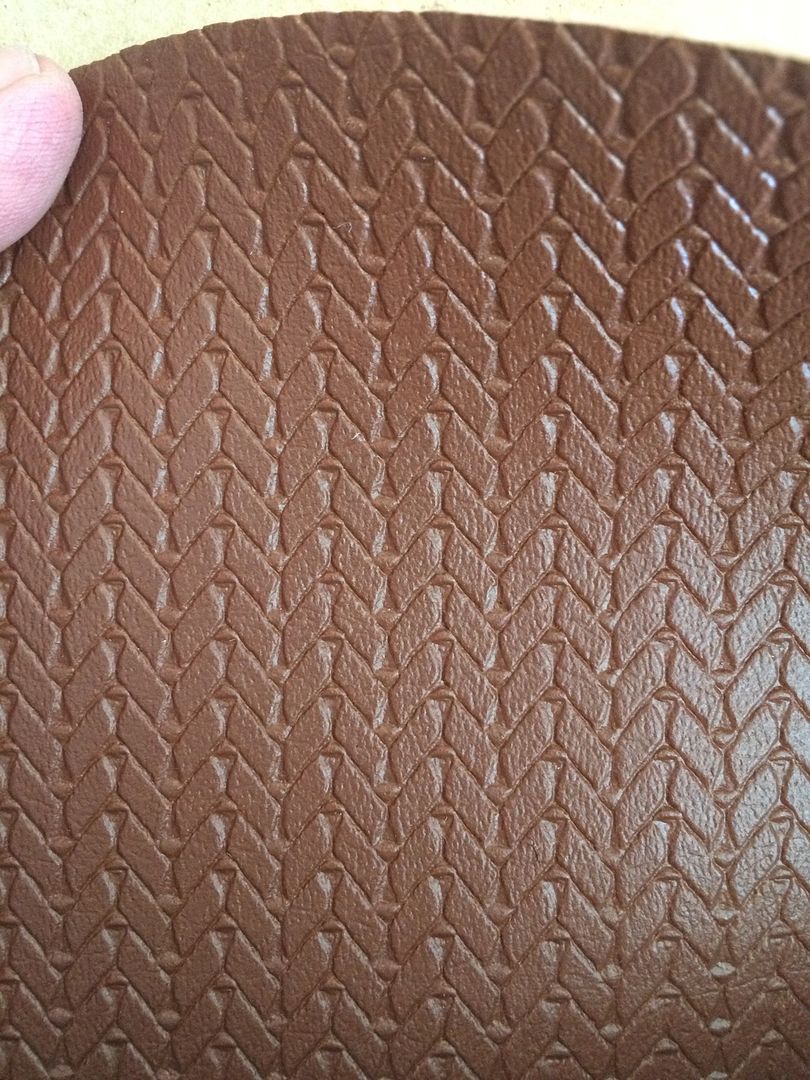

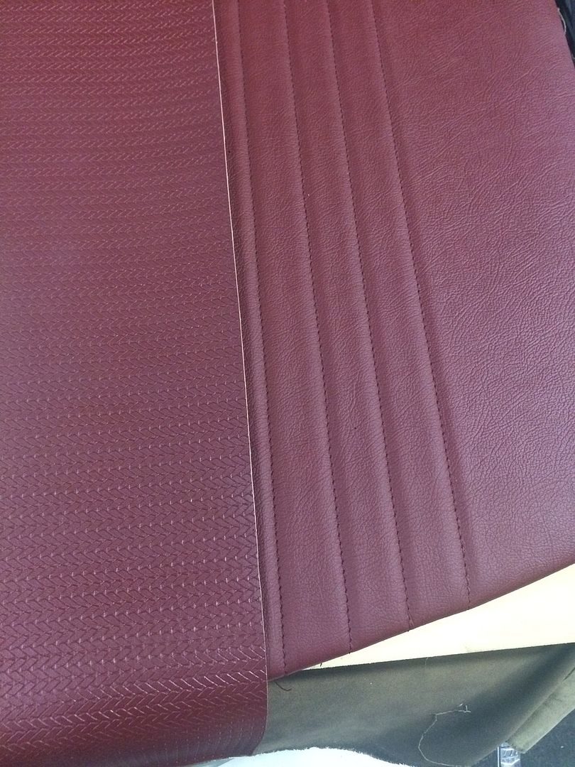

Watching and being involved with the interior has been rewarding. Juan is a true artist and has been very tolerant of my busybody nature. We (he) started attacking the door panels and rear quarters. I brought at least 4 of each panel to him and none were jumping out as being in great shape. We agreed from the beginning that Juan would make the majority of the panel in leather but the basket weave would need to be harvested. Unfortunately we didn't have much to work with. In addition my coupe is a later '73 and doesn't have the plug for the winder access; so I sourced the basket weave vinyl and had some dye matched so that I could paint the material.
Basket weave
Panel
After dying. The match is pretty good but it needs a few more coats.
<a href="http://s907.photobucket.com/user/chileburger/media/AF656E4C-199A-4704-A5D8-289E5D5CDB20_zpsemqzqkm6.jpg.html" target="_blank"><img src="http://i907.photobucket.com/albums/ac272/chileburger/AF656E4C-199A-4704-A5D8-289E5D5CDB20_zpsemqzqkm6.jpg" border="0" alt=" photo AF656E4C-199A-4704-A5D8-289E5D5CDB20_zpsemqzqkm6.jpg"/></a>
Right quarter
And the left

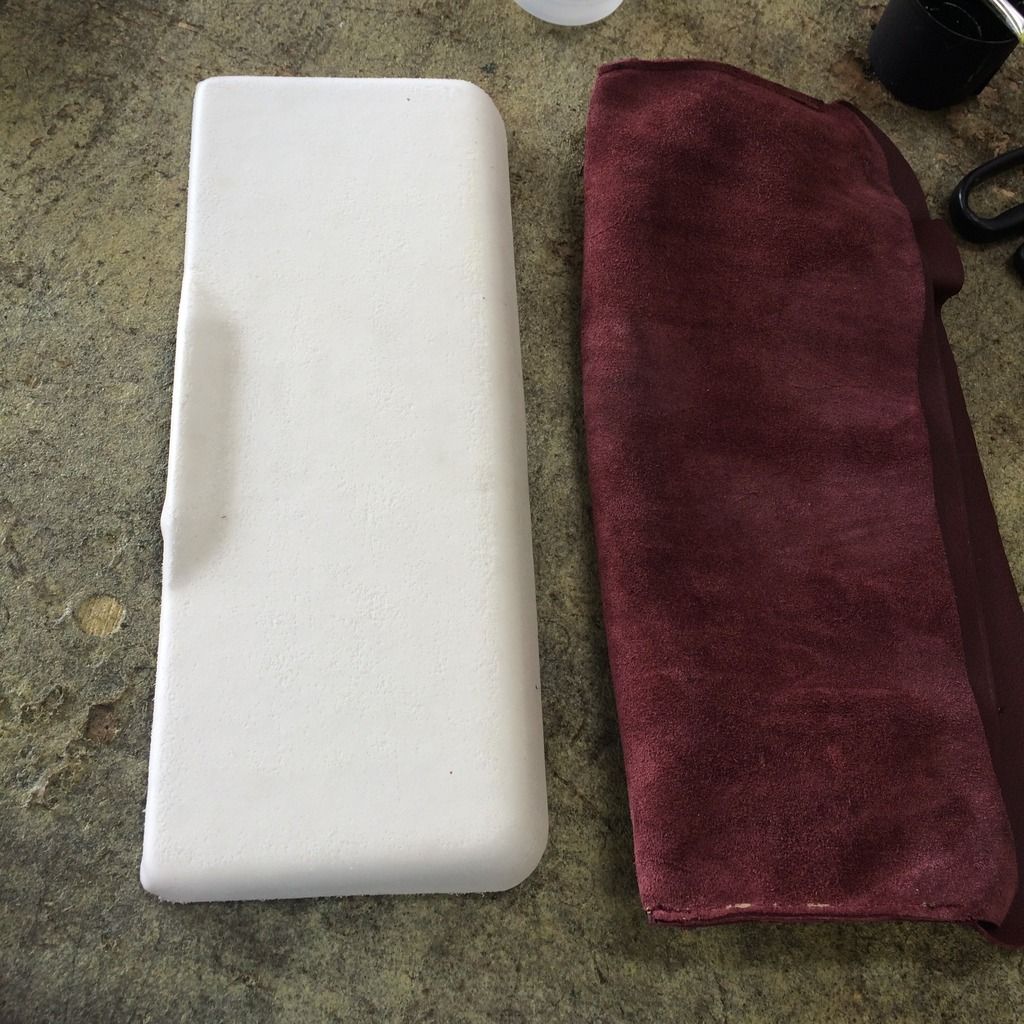

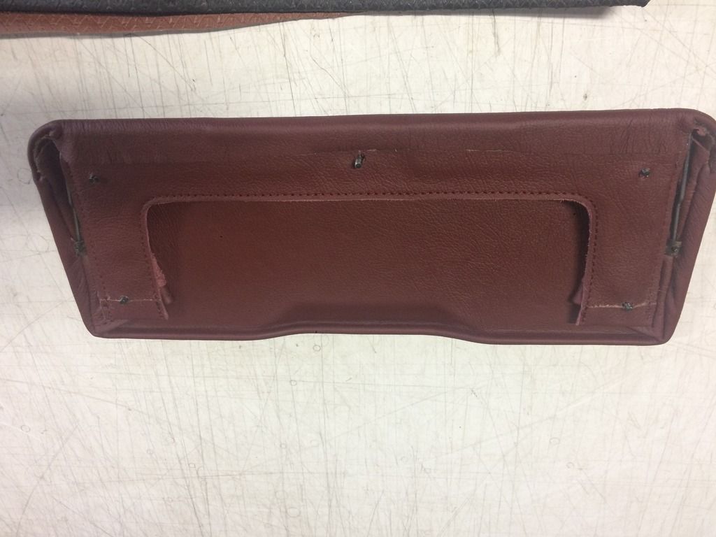

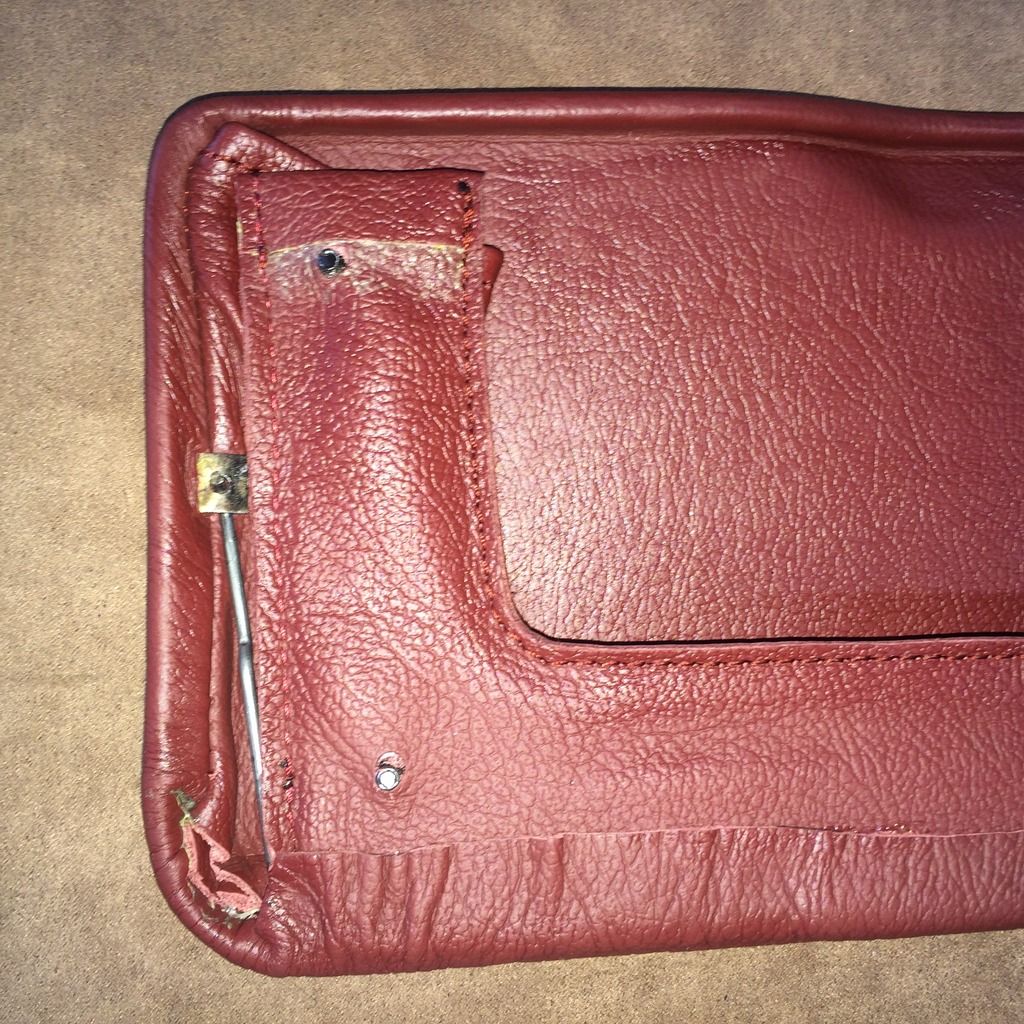

Juan also started on the map pocket. This is really a lot of work and requires a ton of massaging and thought.

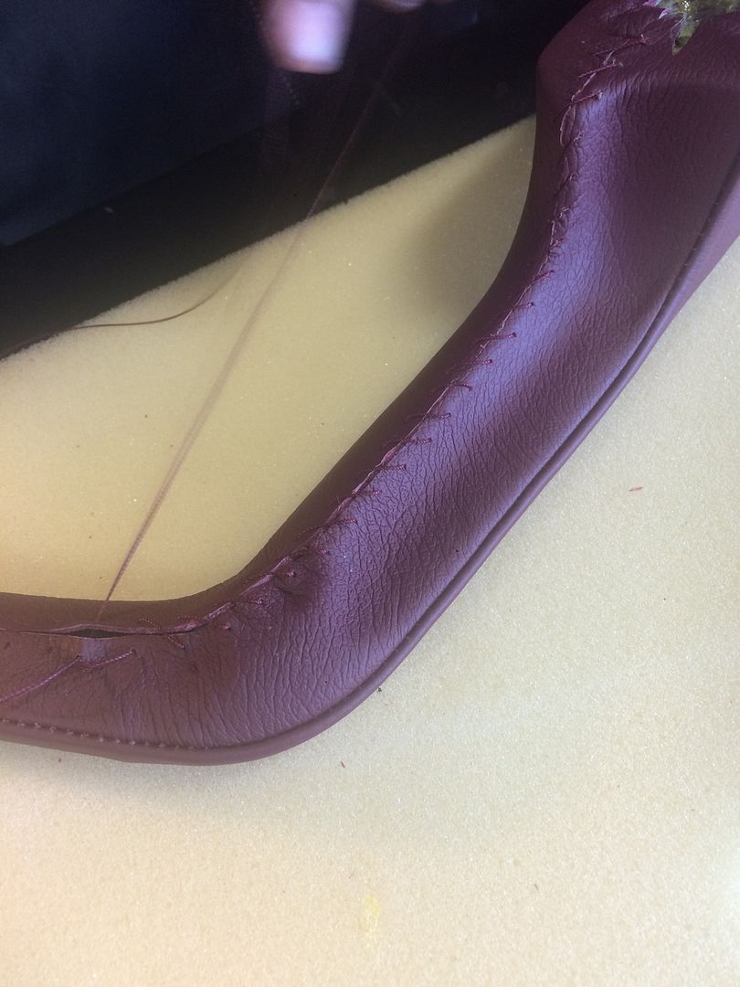

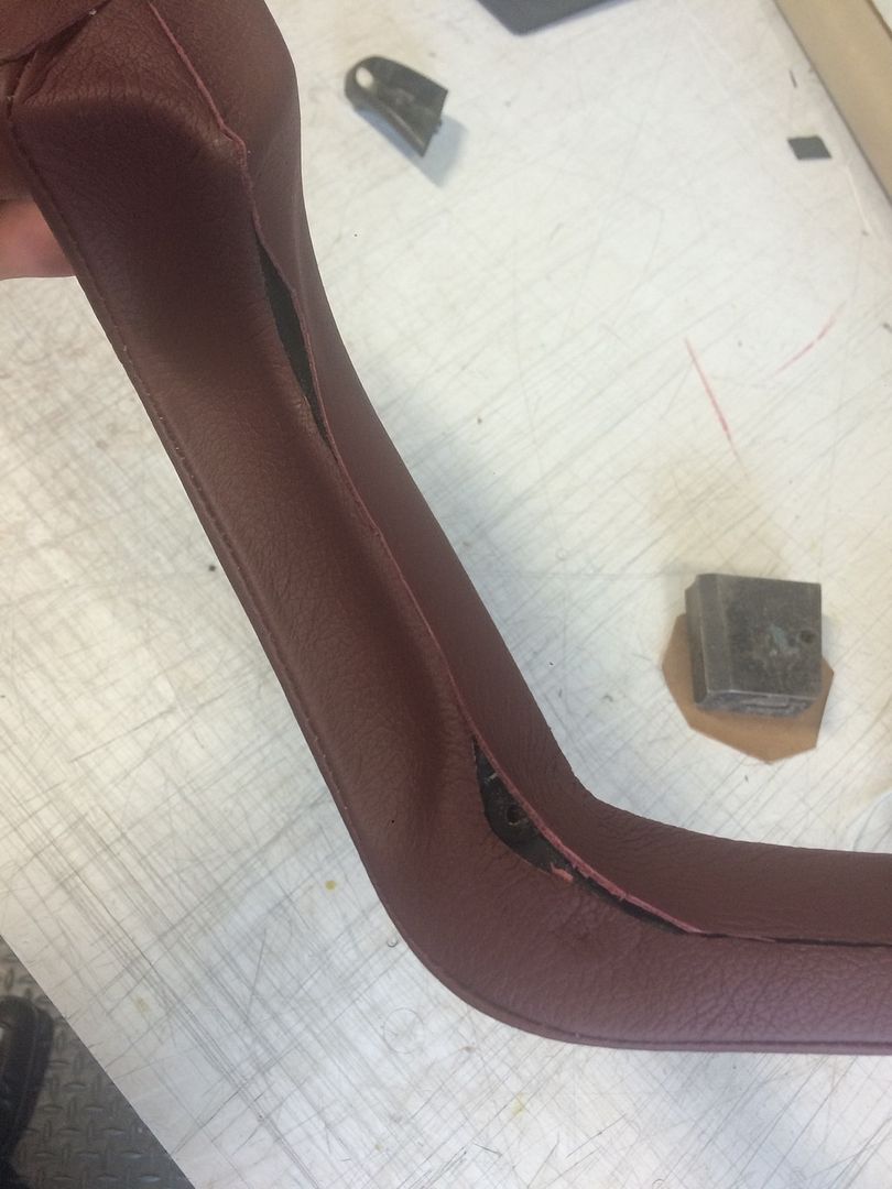

Since I opted for a non standard color we had to make a decision on what to do with the door pulls. Do we dye them or wrap them in leather? I like leathers!

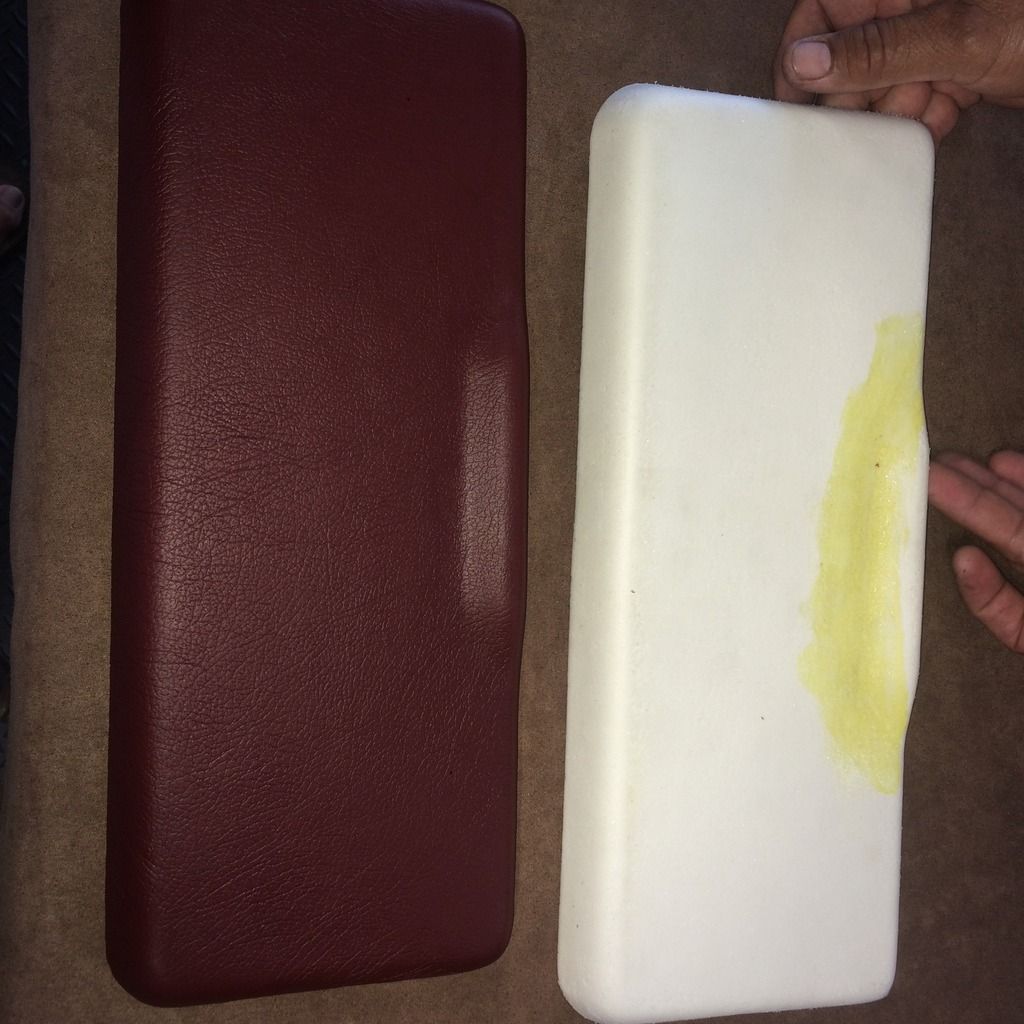

Very nicely done. Regarding the chrome trim pieces that Scott asked about - they probably won't fit due to the enlargement of the arm rests by the thickness of the leather.
I have leather covered arm rests on the car I bought and the chrome trim pieces were not present. SO - I bought the trim pieces. When I went to install them after dyeing the leather in the car to a different color, I discovered the arm rests would not fit in the depressions in the chrome trim.
I like the leather covered arm rests. Another e9 Forum member now has the trim pieces!
