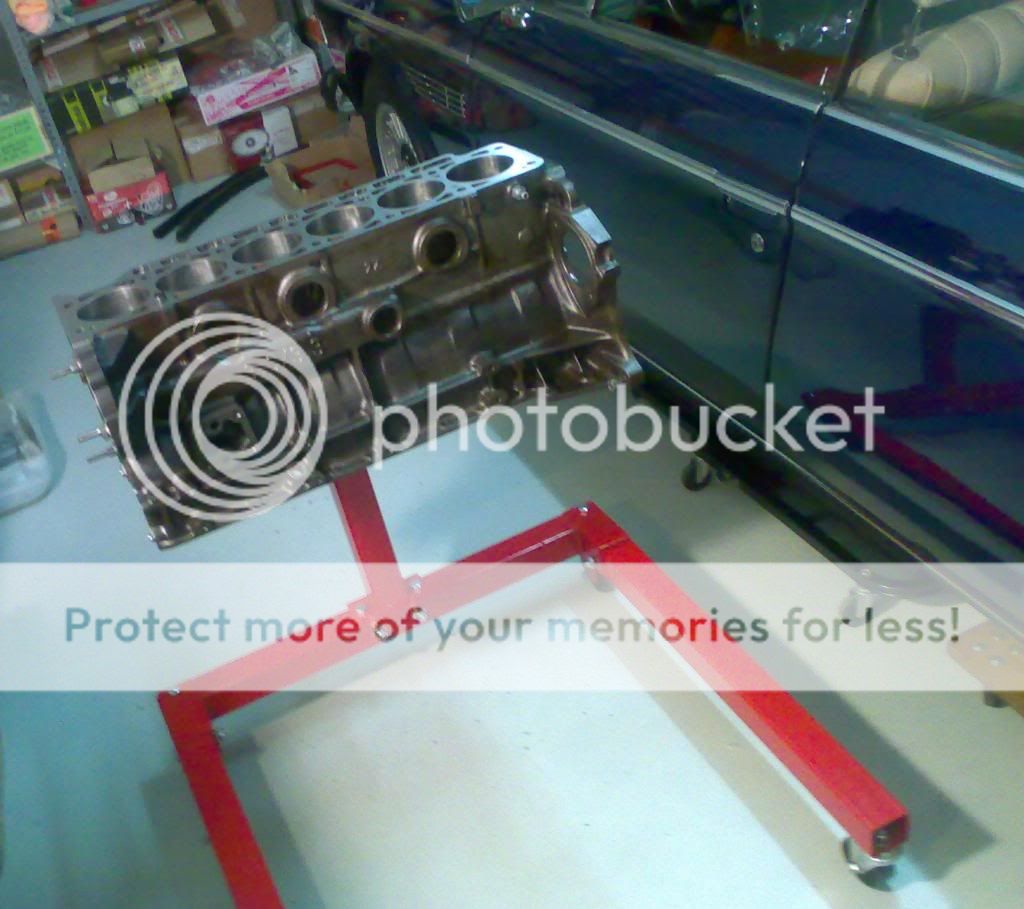

my new engine M30B30

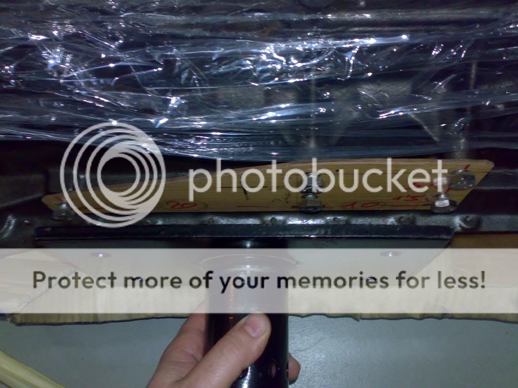

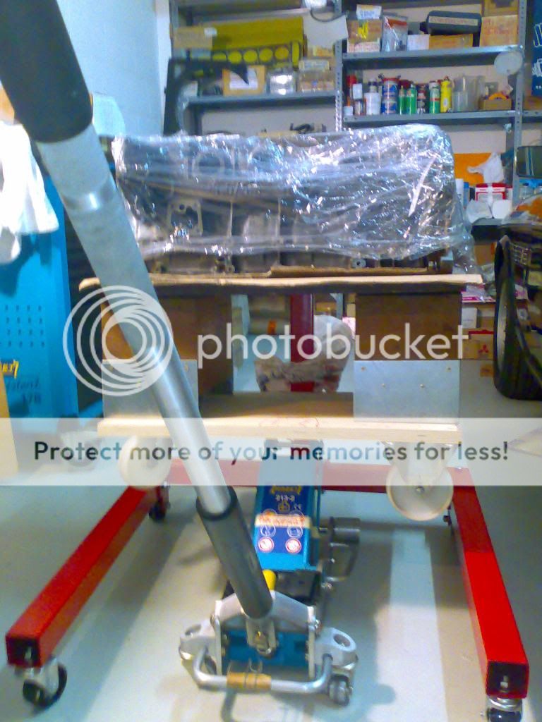

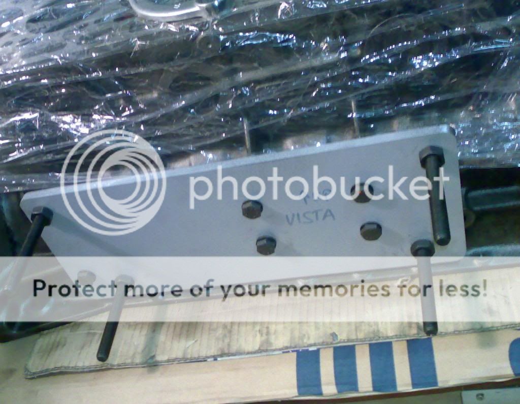

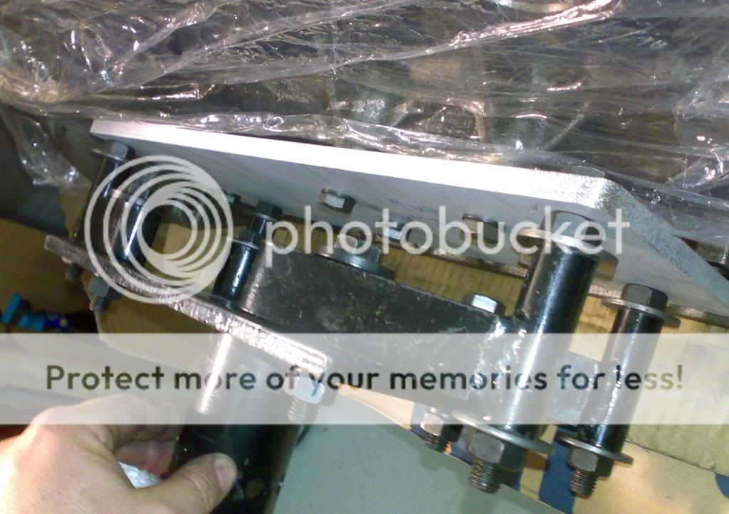

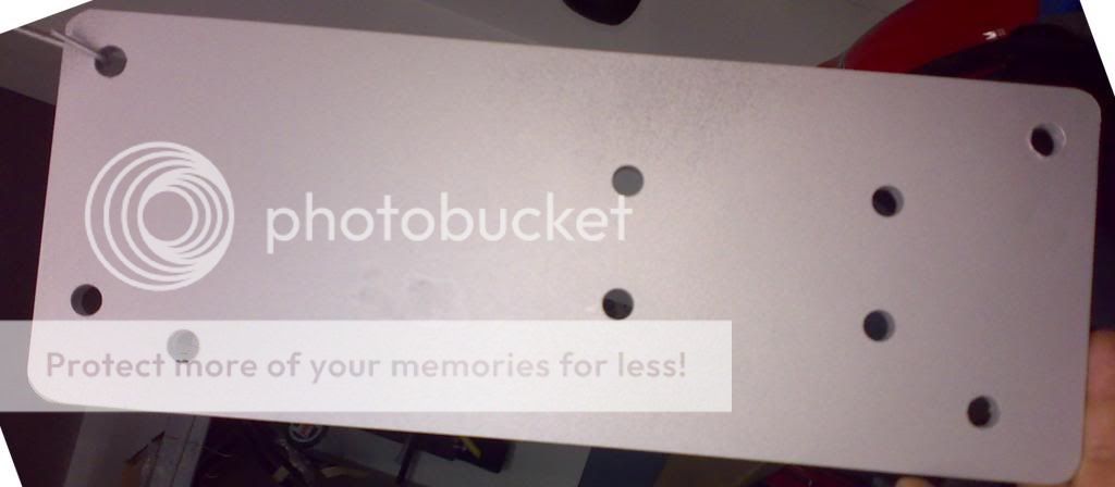

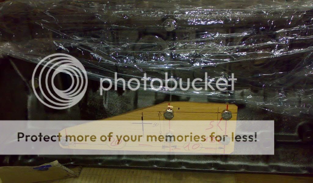

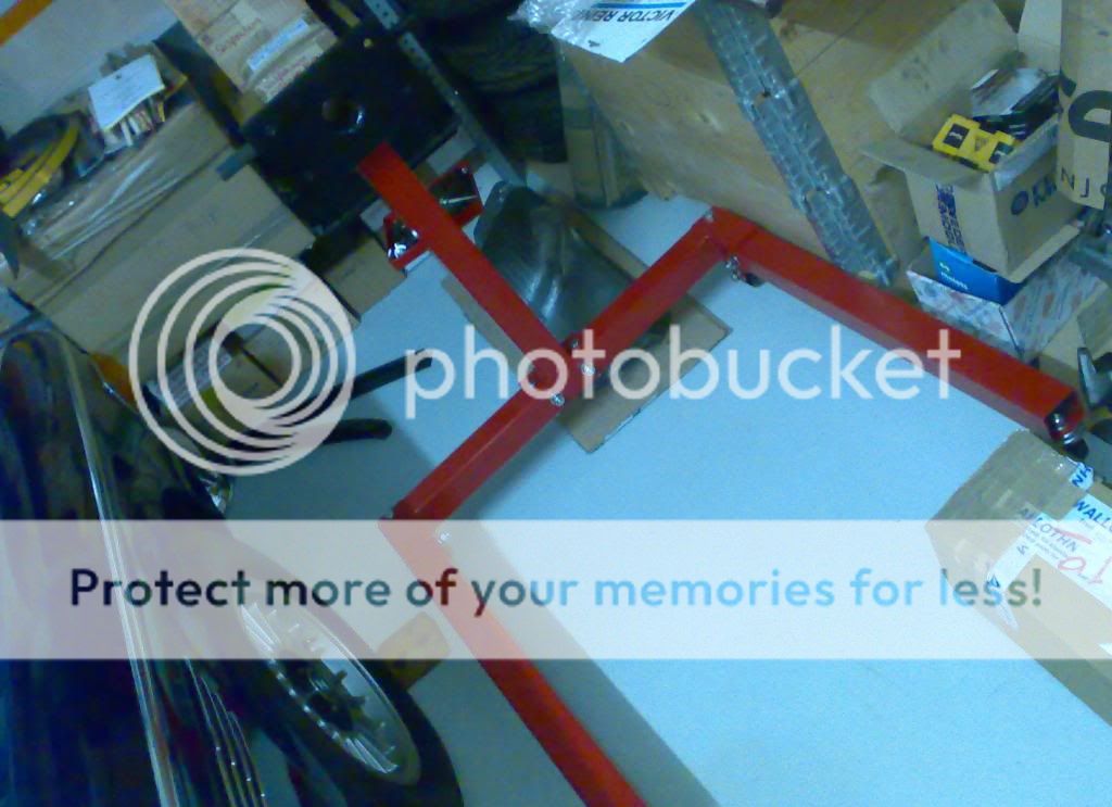

engine support tool
just arrived
i have to fix an addapter, cos usually the engine is placed longitudinally, and bmw states that it has to be transversally fixed in the exhaust area
Hey DQ, looking good. I may have missed in your thread but how did you remove the camshaft/rockers? Do you have the BMW tool or a facsimile of it?

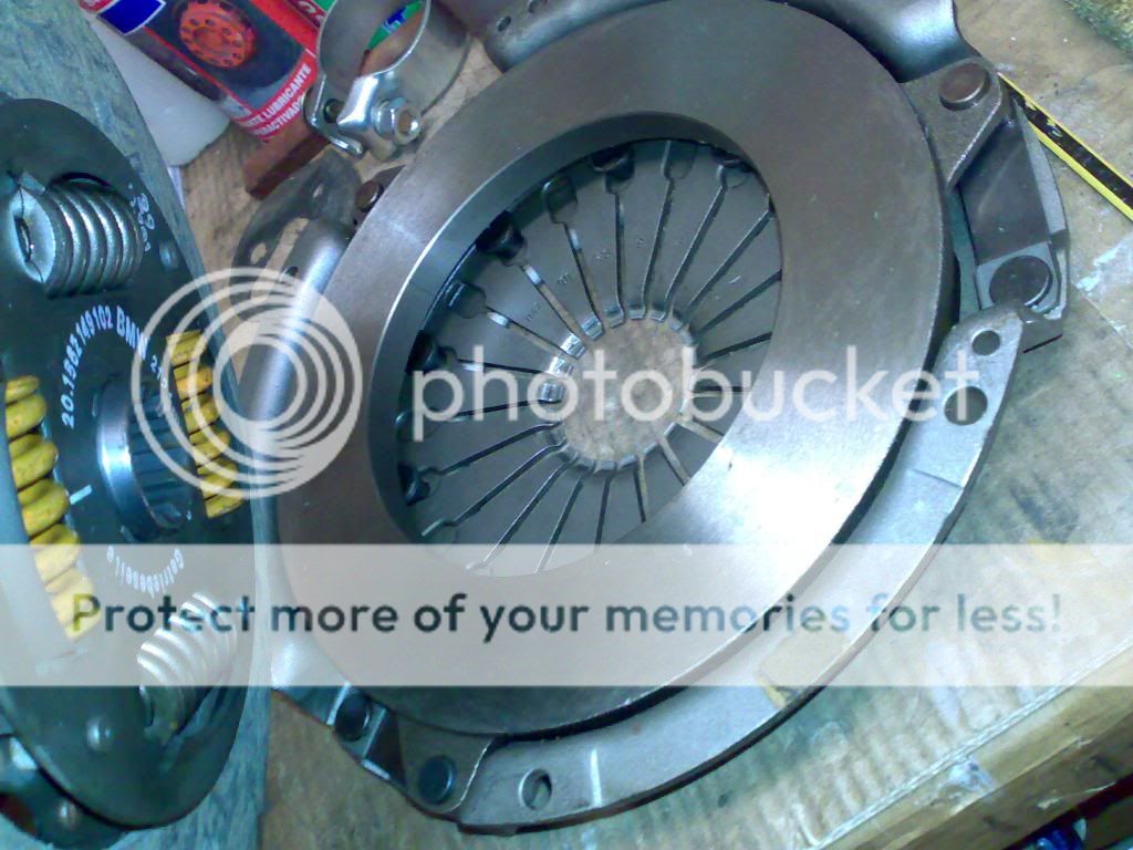

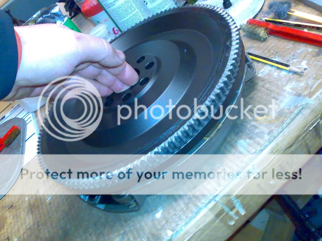

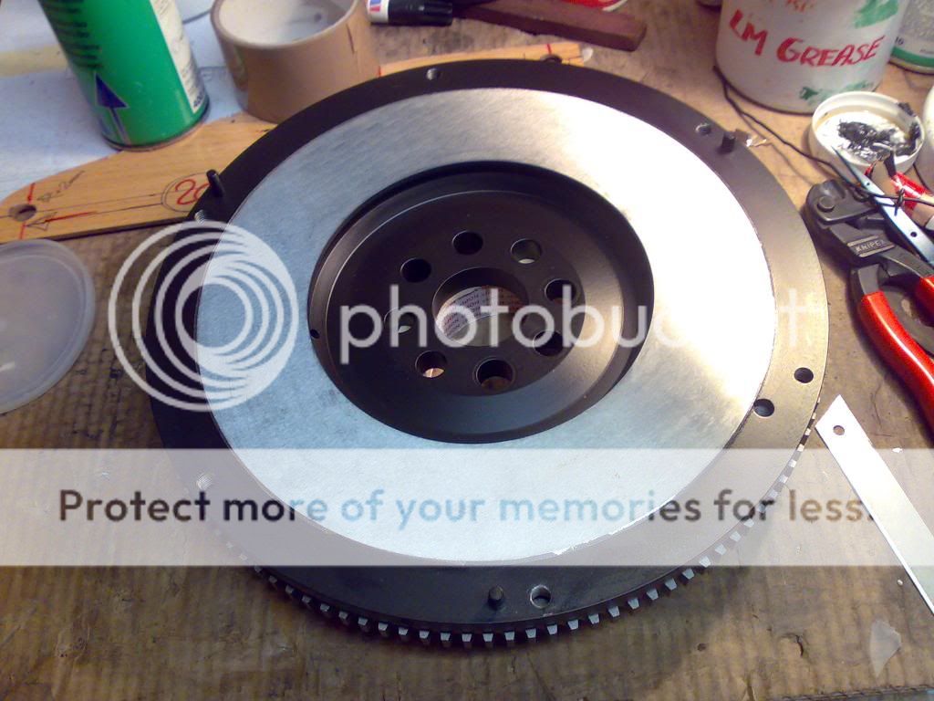

a question on a new clutch
there is a question about the clutch that i can not solve
i found a NOS clutch, brand new, it seems that as per the reference is a clutch for e9 (later than 1973) and e24

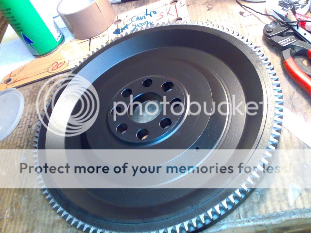

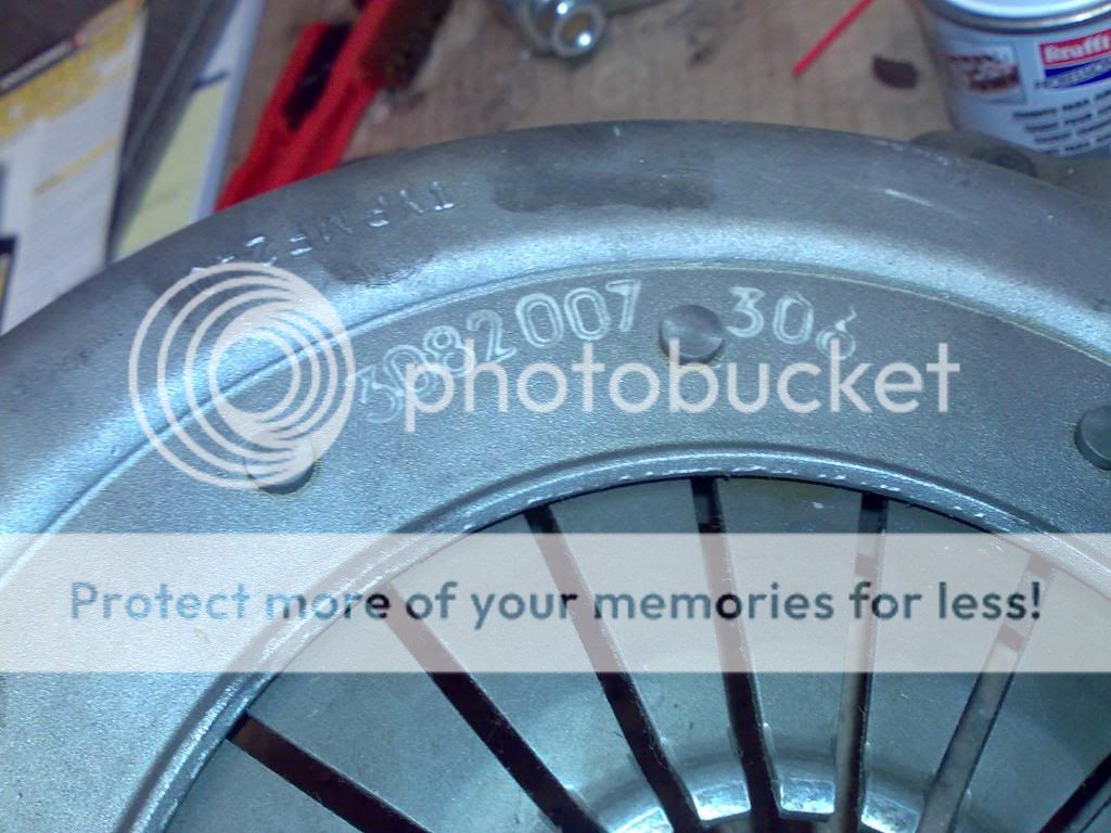

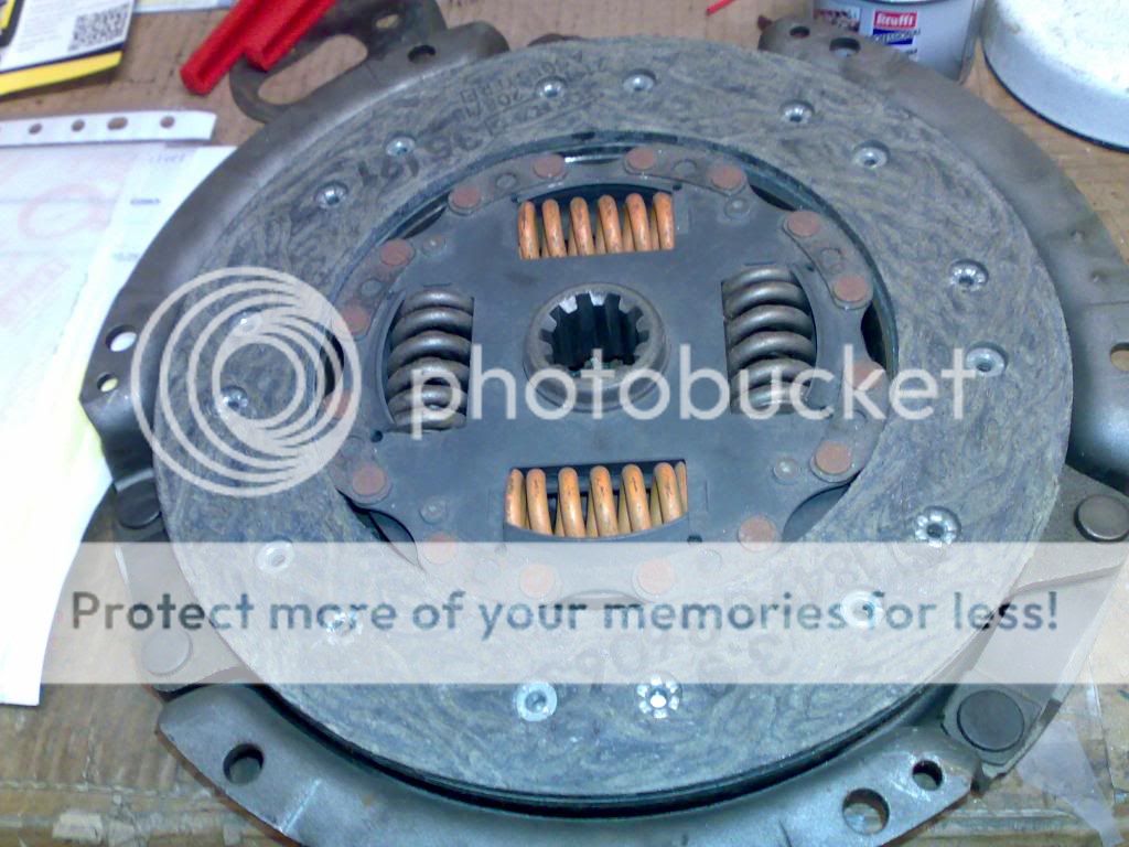

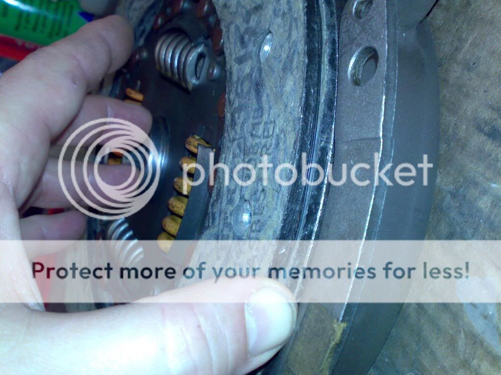

the problem comes when i make a preassembly, see the picture process:

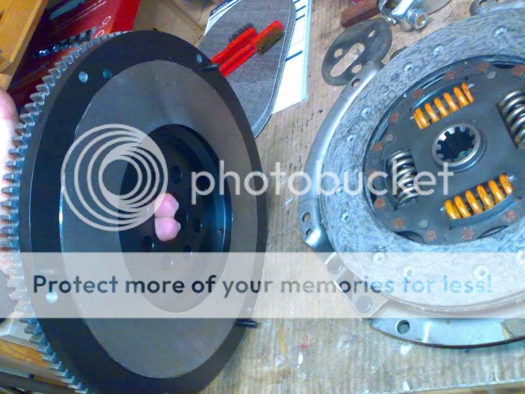

here you can see a gap of 3,5mm before doing the bolts, my concern is if this gap is ok for a new clutch

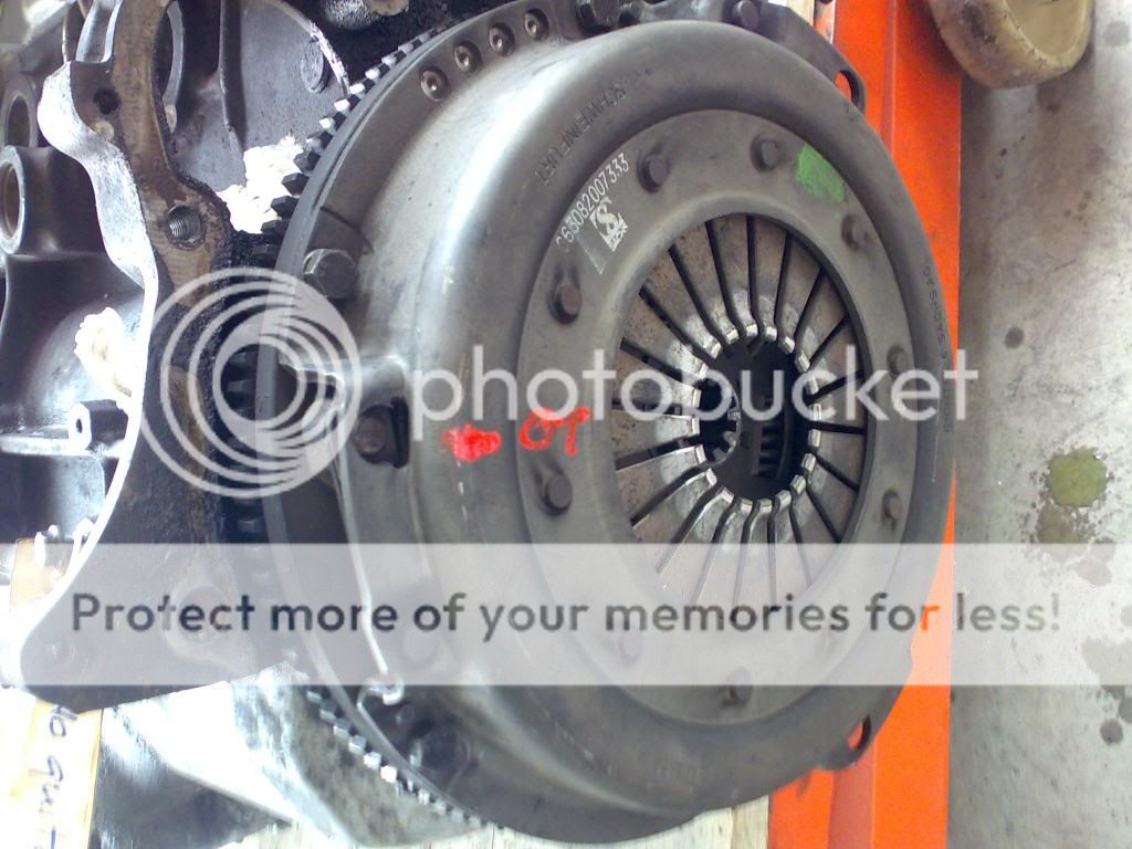

my old engine has zero gap as you can see in this picture
so the question is: is it normal to have such a gap (3,5mm) prior to assembly the bolts ?
that will lead into interference when doing the bolts, is this normal for a brand new clutch ?
thanks
DeQuincy,
Yes.
The 3.5mm you have is the unsprung pressure plate travel. When you bolt-up the pressure plate to the flywheel (with clutch sandwiched in-between) this will result in spring loading of pressure plate clamping the clutch which prevents the clutch from slipping. This is the fully engaged position of the clutch.
Cheers,
Rod
DeQuincy,
Yes.
Cheers,
Rod
hi rod, thank you very much,
very well explained
regards

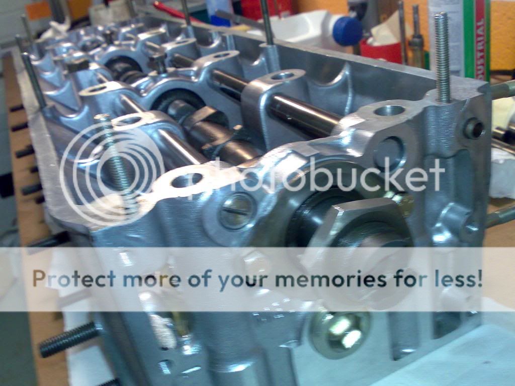

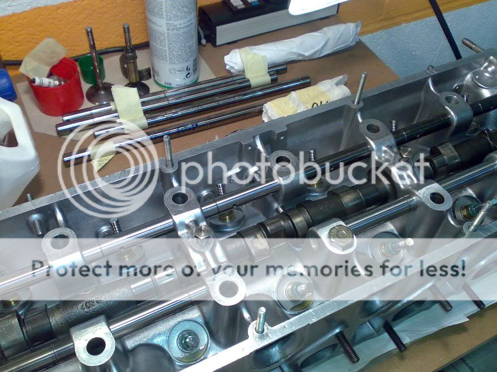

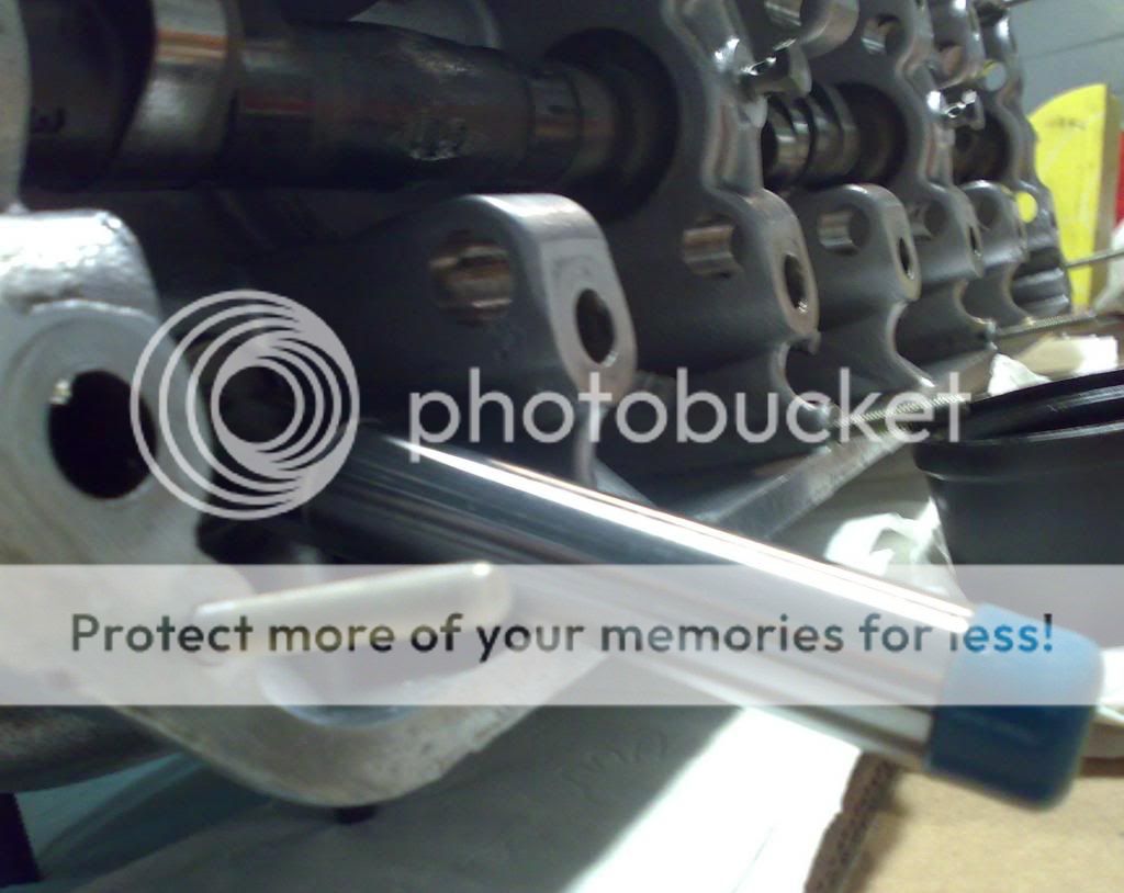

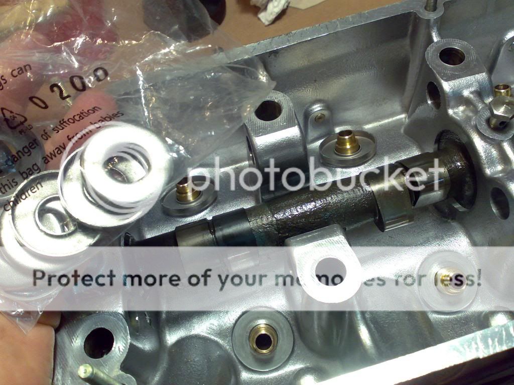

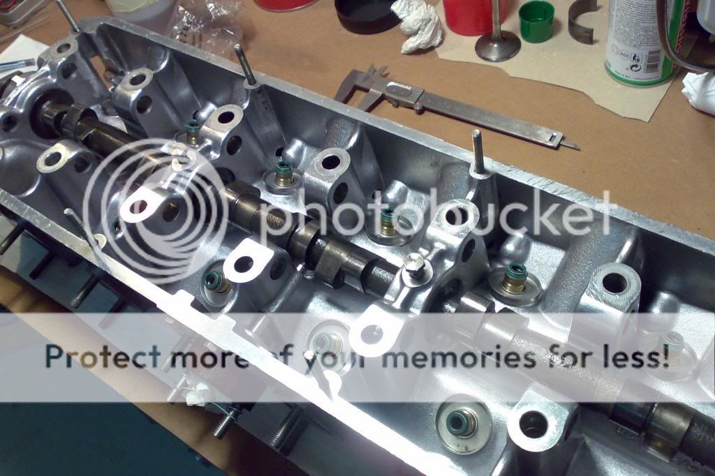

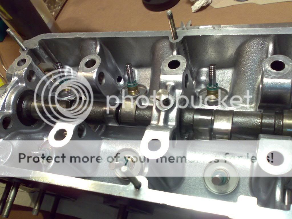

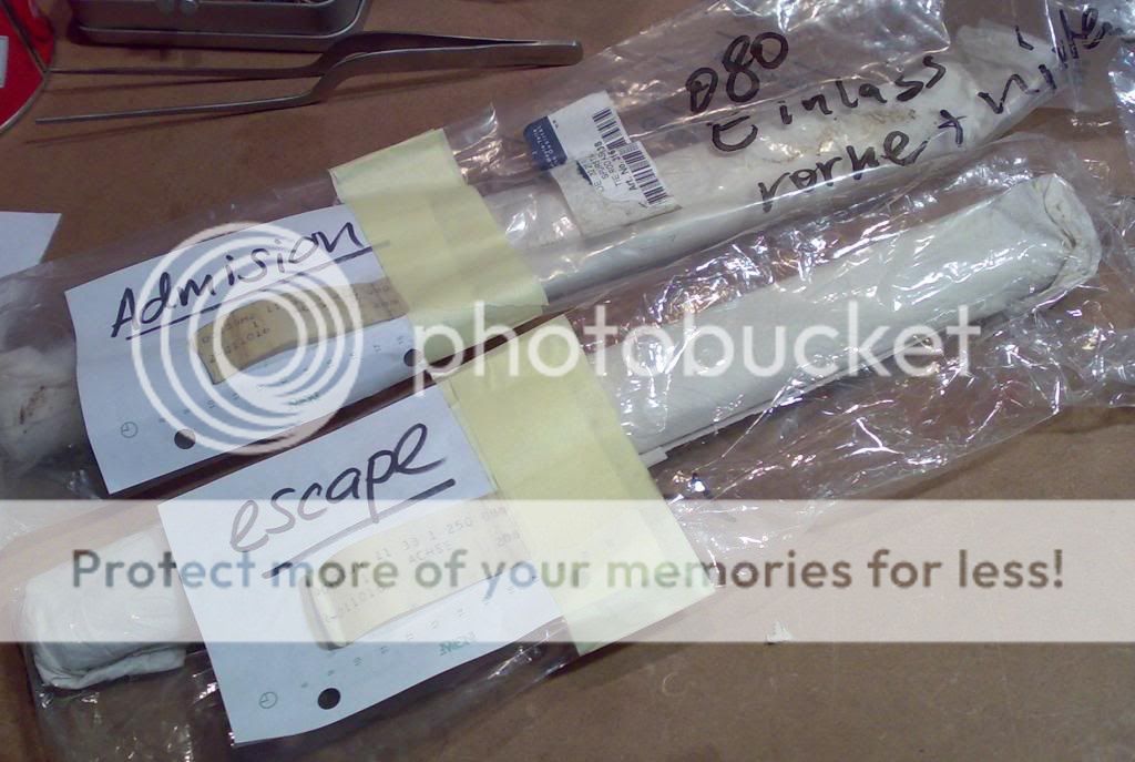

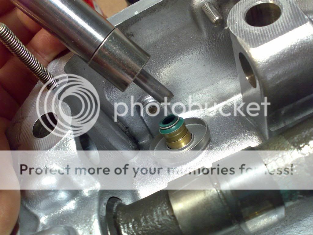

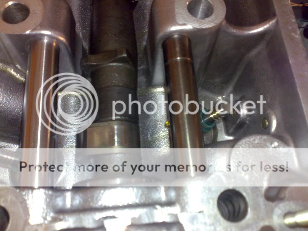

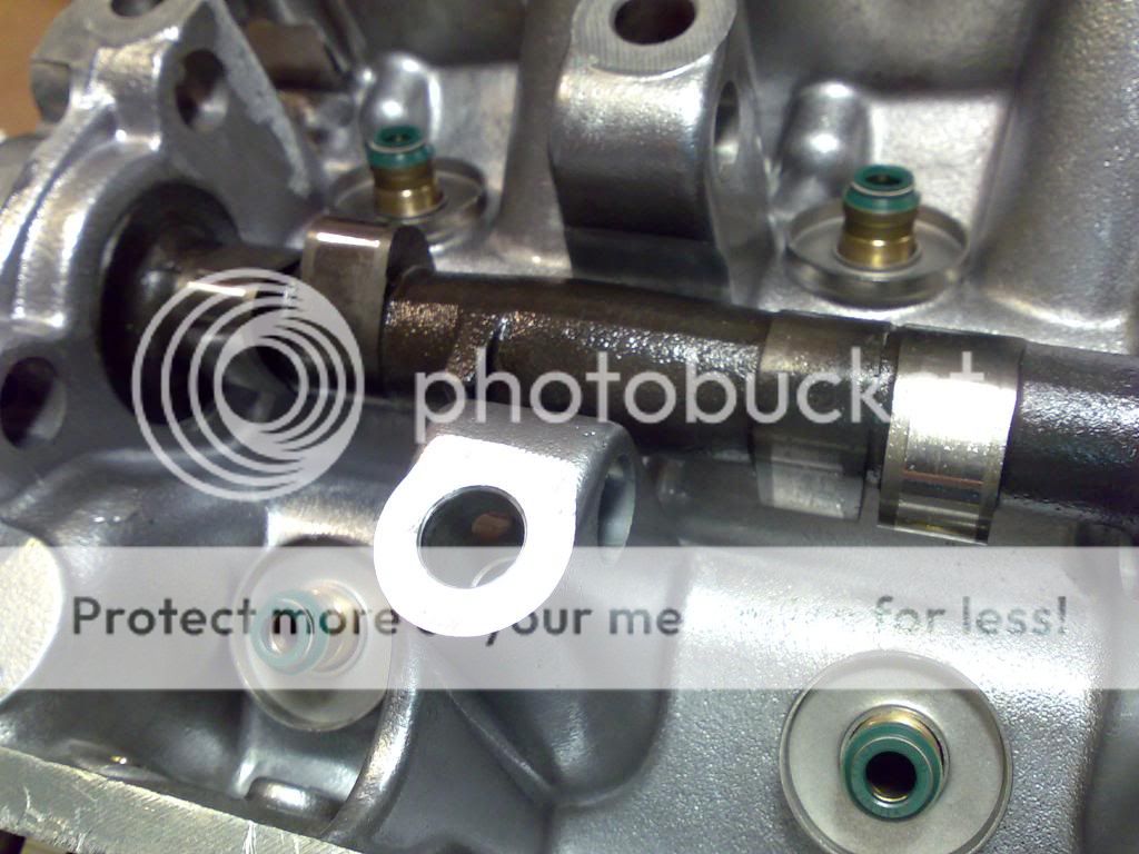

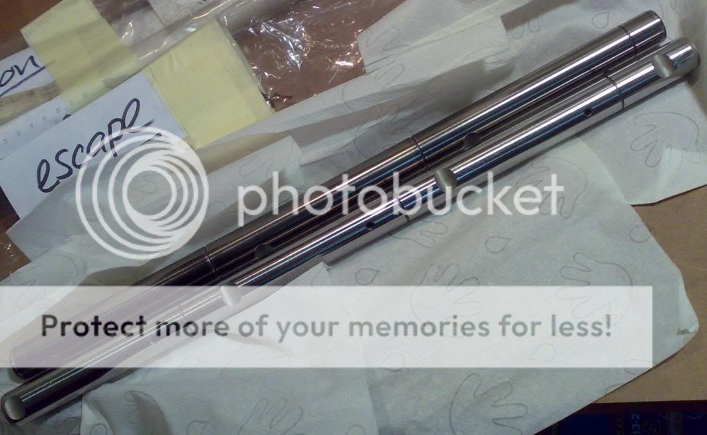

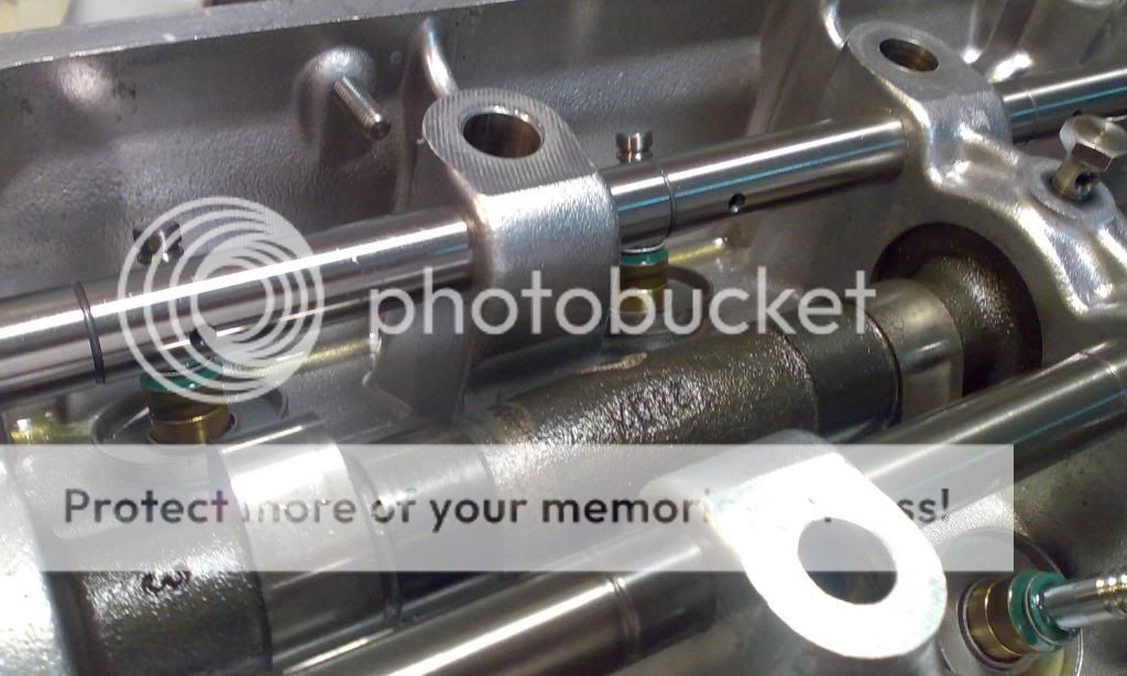

rocker shaft rods
and now my idea for the assembly of the rockers and camshaft
the problem, it is very difficult to assembly the camshaft when the rockers are on their place, on the contrary if the camshaft is mounted, to introduce the the rockers is almost impossible,
there is a tool 7003-1 that press the rockers to lift the pressure from the camshaft allowing its assembly, but in the absence of this tool i have to imagine a solution, this is the idea
