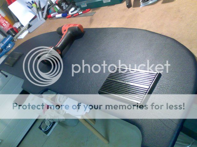

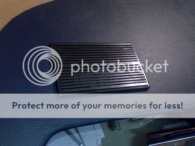

introducing my NOS period correct blaupunkt grille (this is from the seventies, the other one was from the eighties, "BLAUPUNKT" lettering typo coincides with that of the radio fascia, and there is no blue point on it)

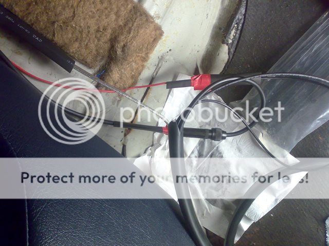

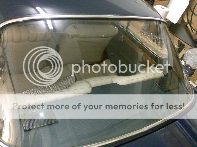

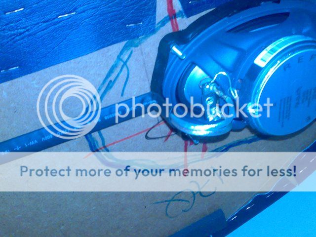

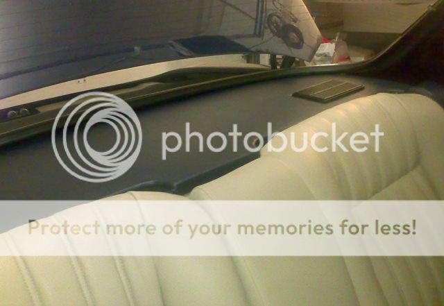

i have finished with the installation of the rear side, i passed the cables through the lateral, using the holes provided in the structural elements, covering the cables with the carpet, once in the rear seat made the connections of the two cables from the antenna, and hide them between the rear panel and rear armrest
glued the cables to the rear shelf and connect them to the speakers, the rear speakers go in series, so they form one unit, that will be regulated by the balancer
now only pending the conections on the front área, including those in the radio and the balancer

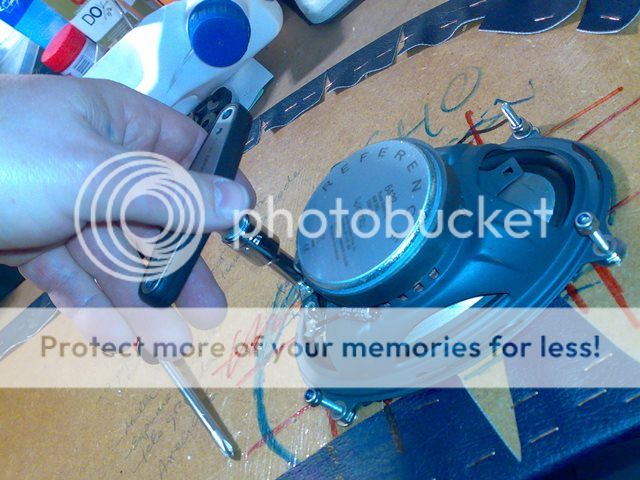

installed

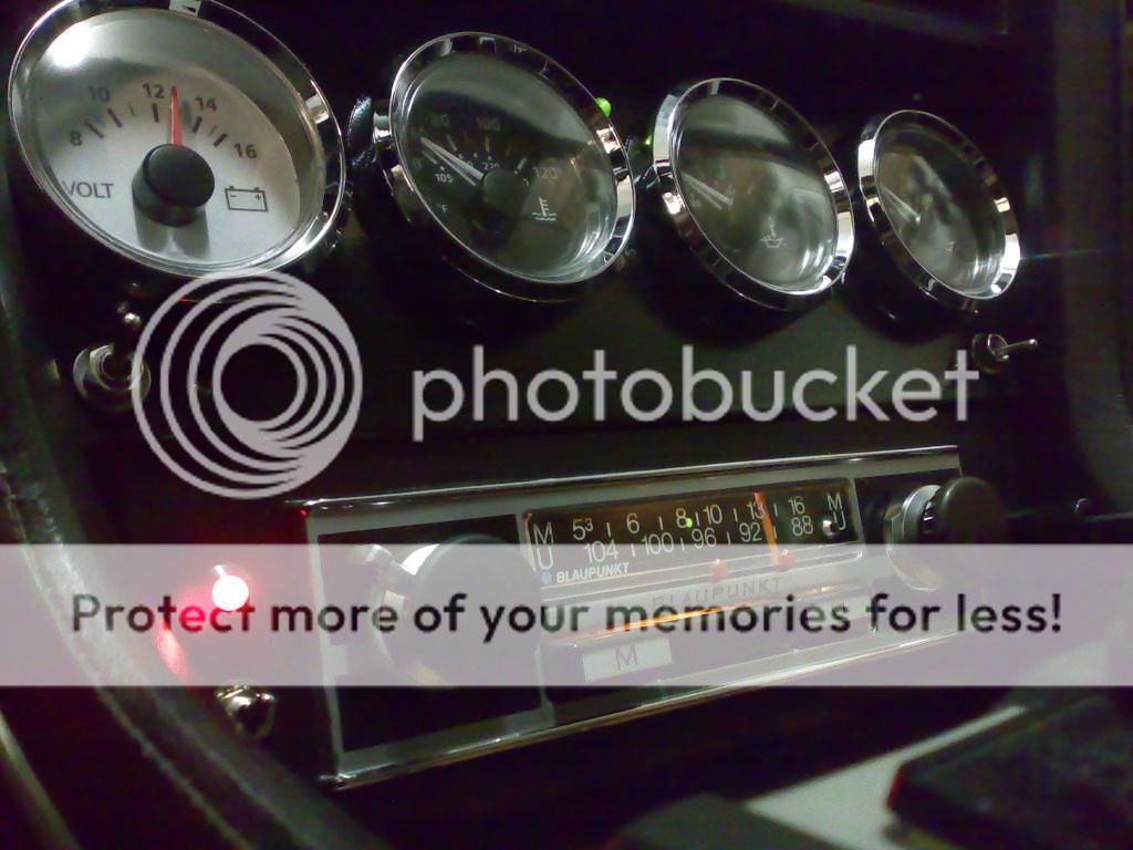

blaupunkt ludwischafen bonn mono radio, converted to a din output for MP3
mono balance switch
4 infinity speakers, rated 4 ohm individually, instaled in pairs in series, two front, two rear and between them in parallel

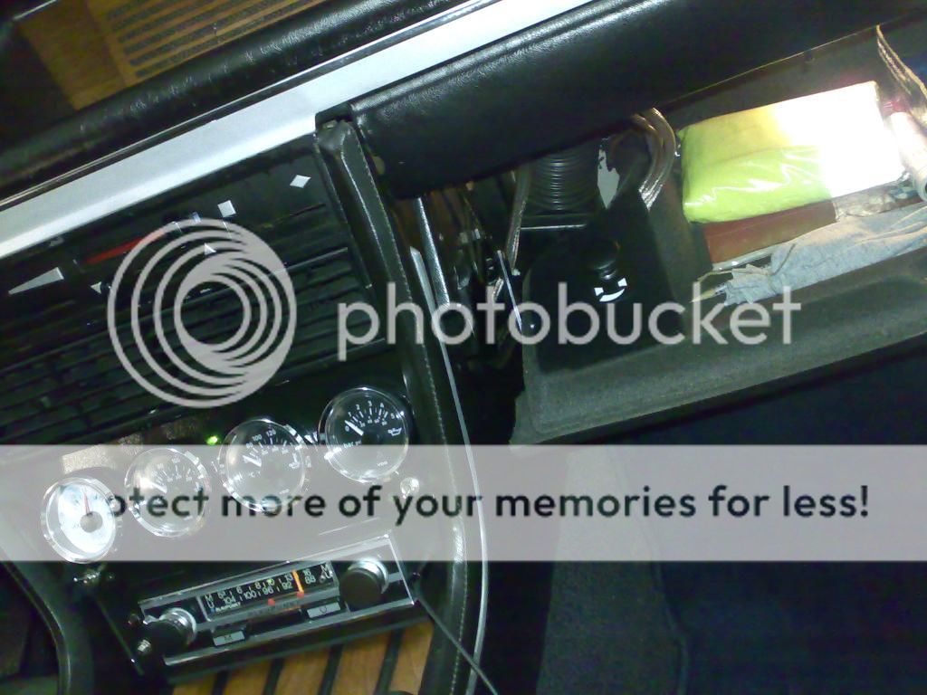

one manual electronic hirschmann antenna
operation includes an external switch for feeding the antenna electronics
the sound is very, very good, i am tempted to say excellent, obviously in the domain of a mono system, this is not stereo, but the reception of the radio is cristal clear and strong, here is a link to a video, the car was in a garage one floor below street level, until the antenna is switched ON nothing is received

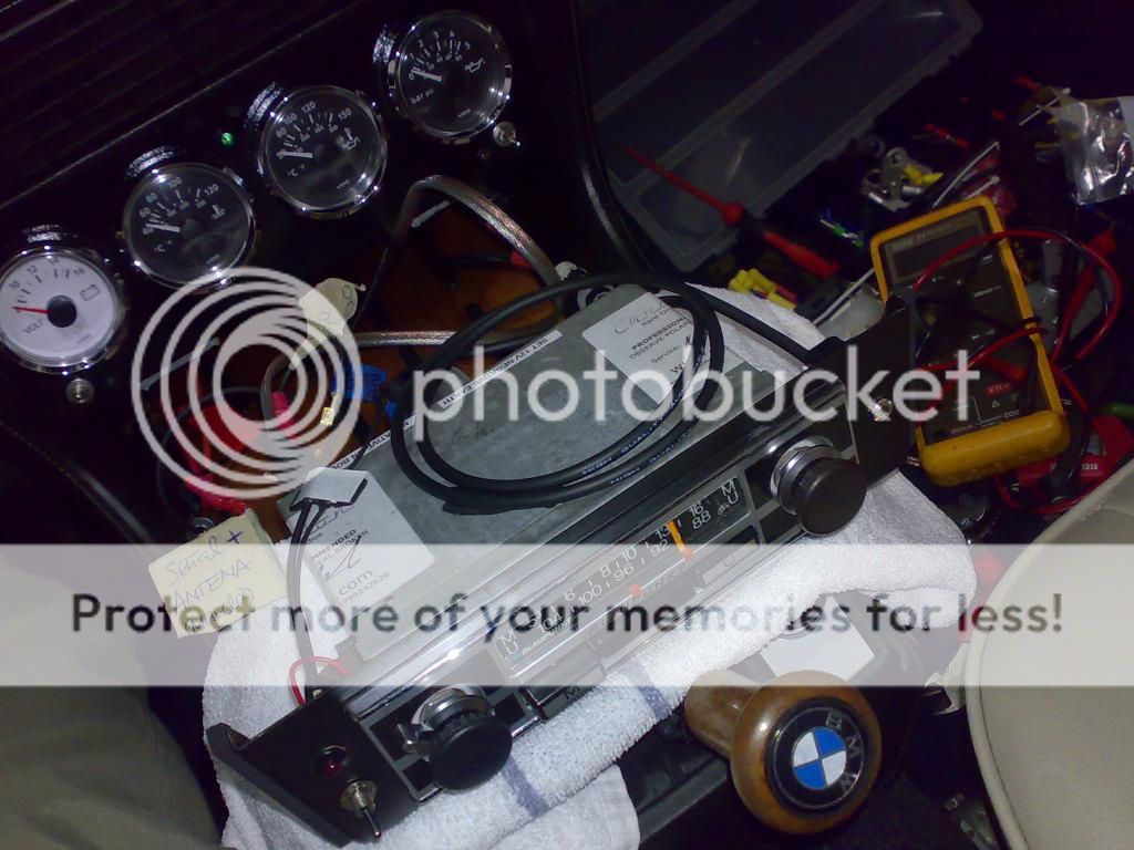

some installation details
i placed an external switch for the antenna electronics

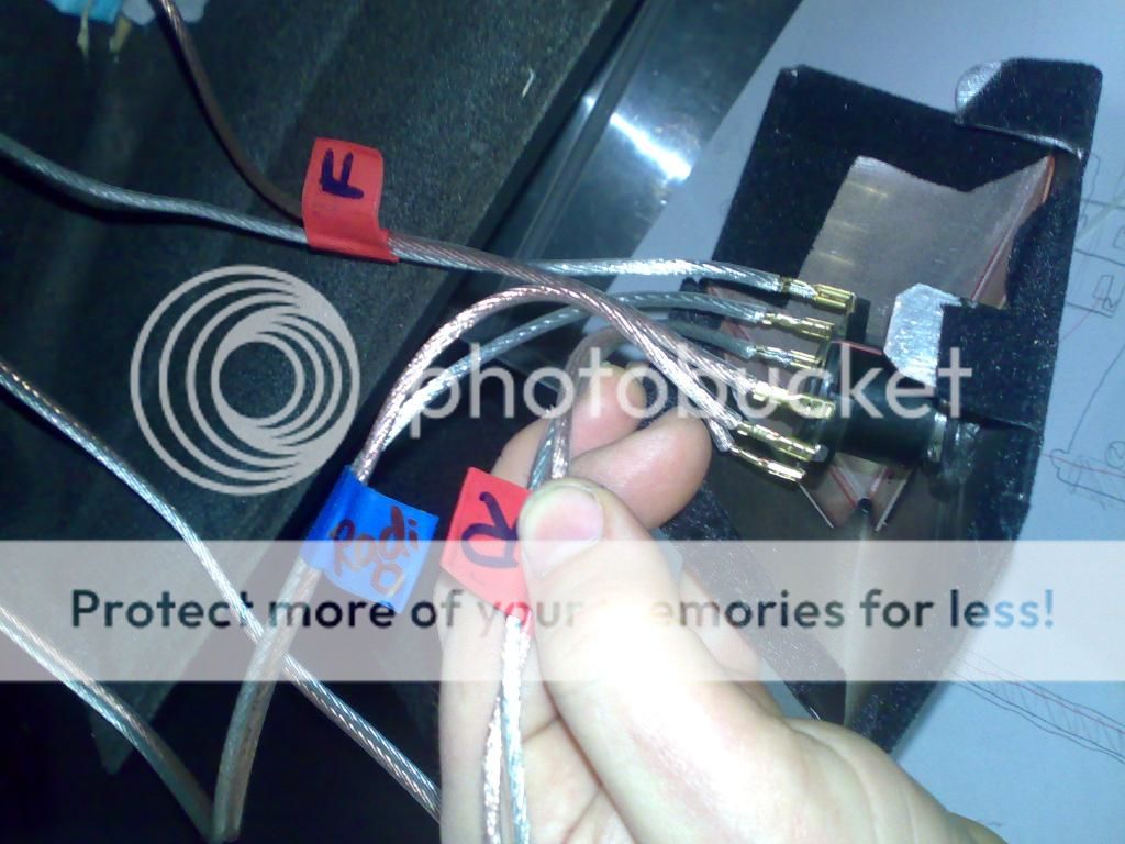

a view of the balancer in the glovebox
connections: F=front R=rear RADIO =input from radio
