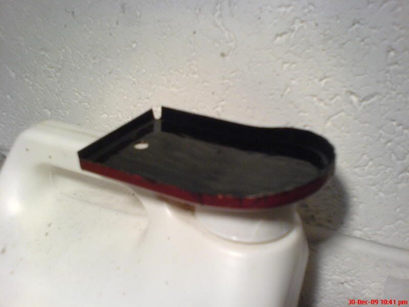

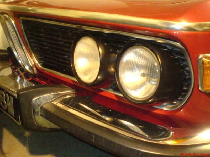

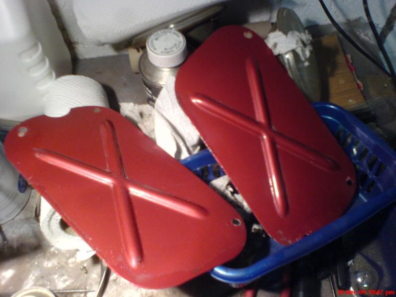

With regards to my CSI, i've been doing the list of jobs I have before it goes in for it's MOT. First up was finishing off the headlight access flaps. They now look like new

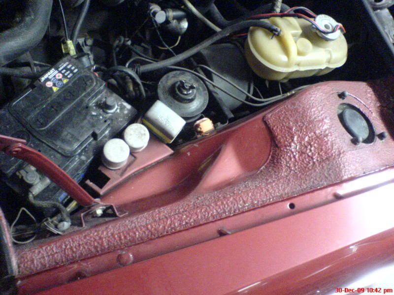

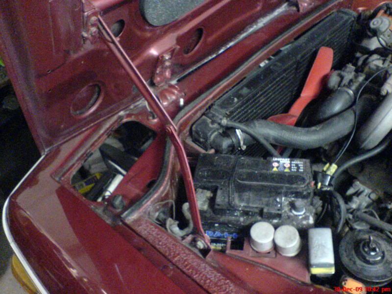

Before they go back on I polished the slam panel to make sure it doesn't look shabby against the nice restored flaps when they go back on.

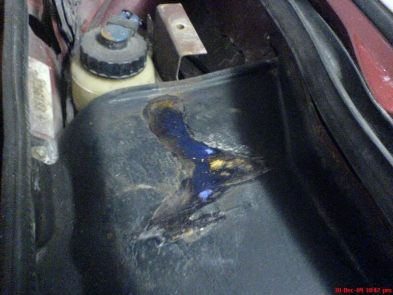

The underside of the metal garnish that covers the brake fluid resevoir was a bit corroded so I ground that out, sealed and painted it.
The cover over the wiper arms had a bit of surface rust so I ground this out and here it is in rust inhibitor - I will be re-painting this is satin black soon.
While I was under the bonnet I did more detailing, here i'm polishing the inner wing.

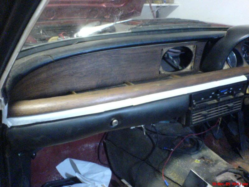

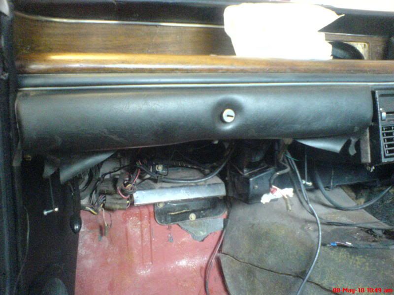

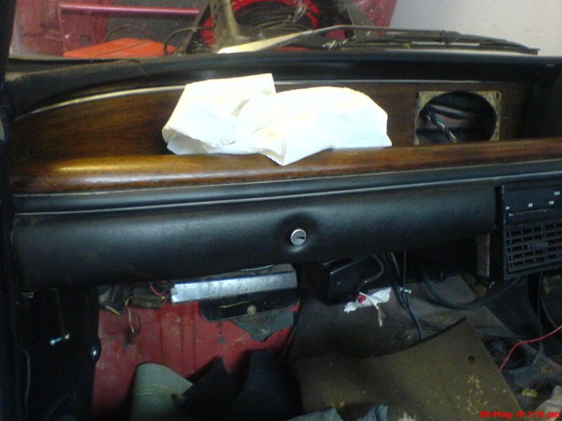

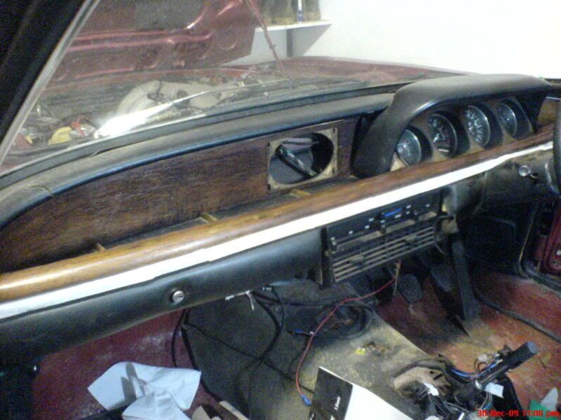

The dashboard staining was done a few weeks ago so here is the first layer of laquer...
And the second...
I did four coats in the end and it looks great!!!

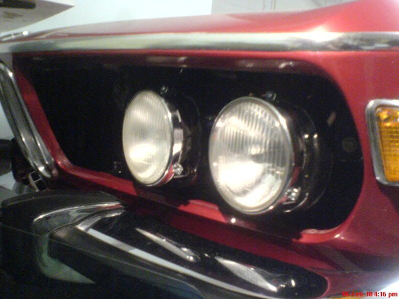

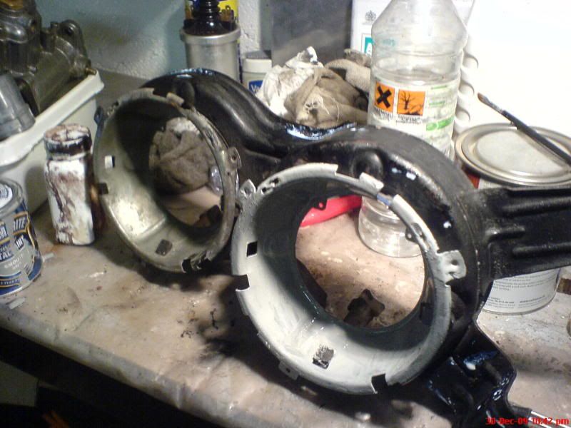

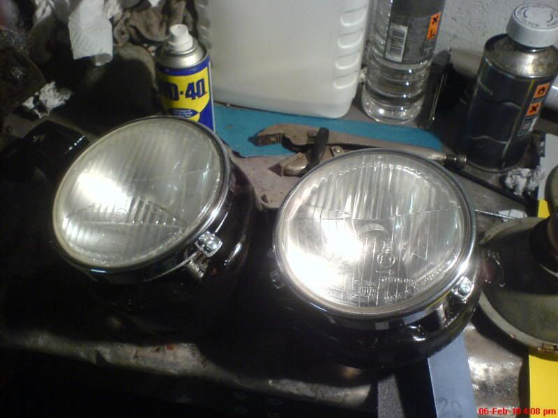

This is the passenger-side headlight bracket getting a re-paint in black and silver - looking great after three coats. I still need to complete the driver's side one.
I have cleaned-up and waxed the headlight securing rings which i'll take a pic of next time i'm up with the car.
