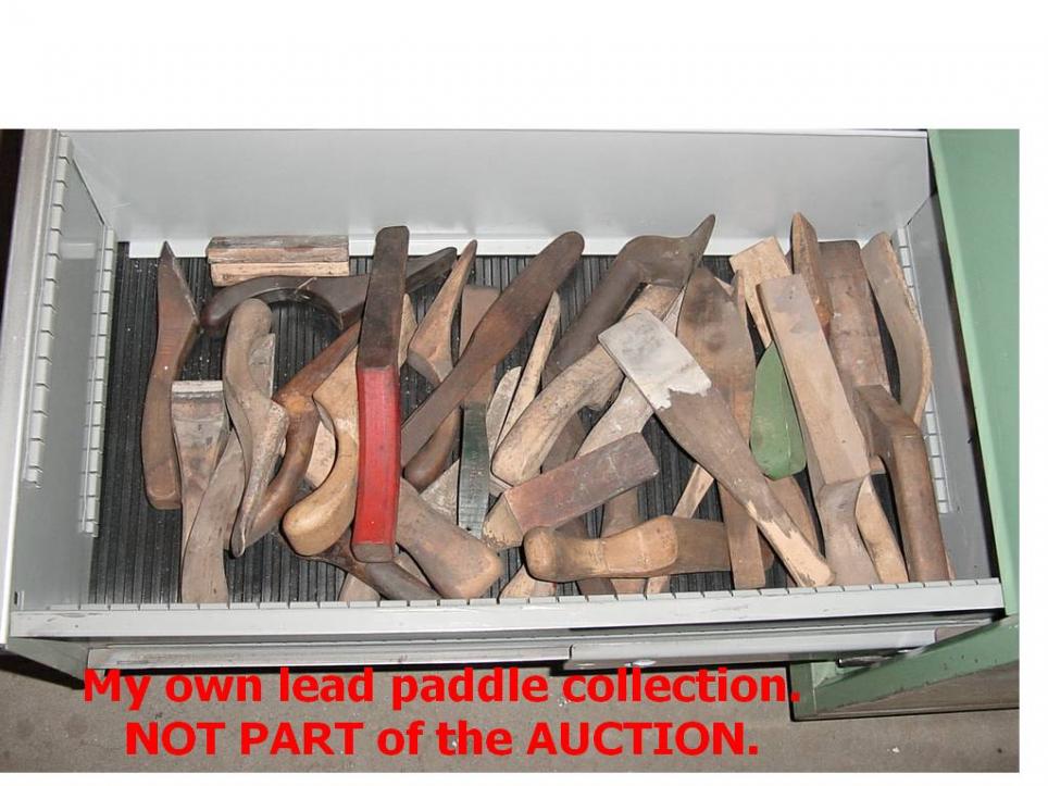

I've always been a believer in lead being superior to bondo.
One of our local top restorer agrees. Another local restorer who I used recently swears modern plastic fillers are far superior to lead.
Both agree that either choice needs to be applied over a properly prepped substrate or both will exacerbate the formation of new rust. Lead, in particular, uses an acidic flux which can cause problems on the underlying metal. The best modern, plastic fillers won't help if they're not applied to scrupulously clean base metal.
The guy who swears by plastic over lead did a Pebble Beach best of show car, and has convinced me both types of filler are fine if used sparingly and properly.
John
The main problem with lead is very few modern auto body men know how to neutralize the chemicals used in application properly. They have a paint job go bad because of flux contamination and then they bad mouth lead to everyone who will listen. Another problem is only 14” flat & convex lead files are still available anymore so cutting it down in some areas is difficult. Health dangers for body men and very few people wanting to pay for the additional time are also problems.
The idea of putting plastic on bare metal is dated by probably 15 or 20 years now. The more modern way is to coat the bare metal with a rust resistant etching epoxy primer, let it dry and lightly sand it to give it teeth. Coat that with plastic (Bondo) and cover that with epoxy after you have sanded the plastic to its true shape. The idea is to encapsulate the plastic (which can absorb water) in waterproof epoxy primer. That is what my friends that still sling plastic tell me, I admittedly haven’t painted or done plastic work for maybe 25 years now. Thank God, the metal work keeps me very busy. ~ John Buchtenkirch
