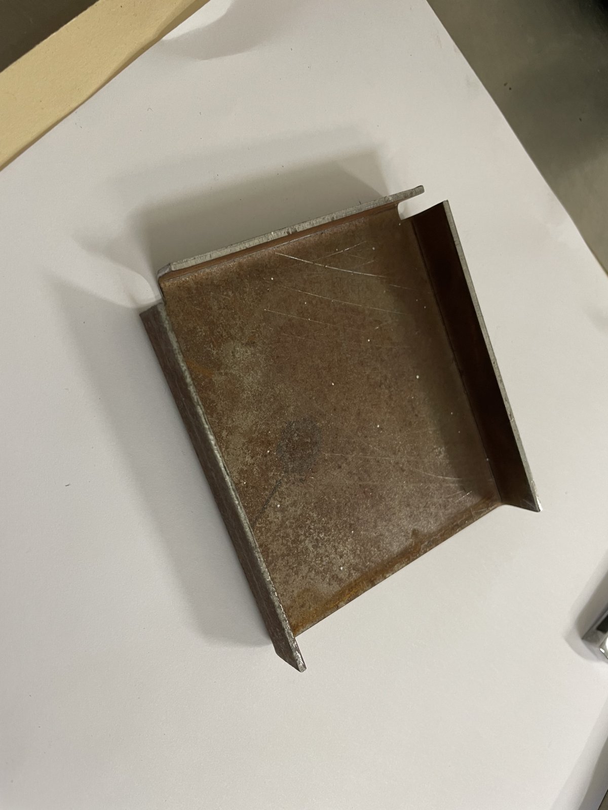

I've fabricated an extra box section for the outside of the footwell.
This fits either right or left side.
If one of you out there is currently in the middle of metal work and rust repairs in this area, and you need this part, its free for the asking. Just cover the shipping. I will ship globally. I would like to see it go on a coupe someday soon -much preferred to sitting in a box in my garage.

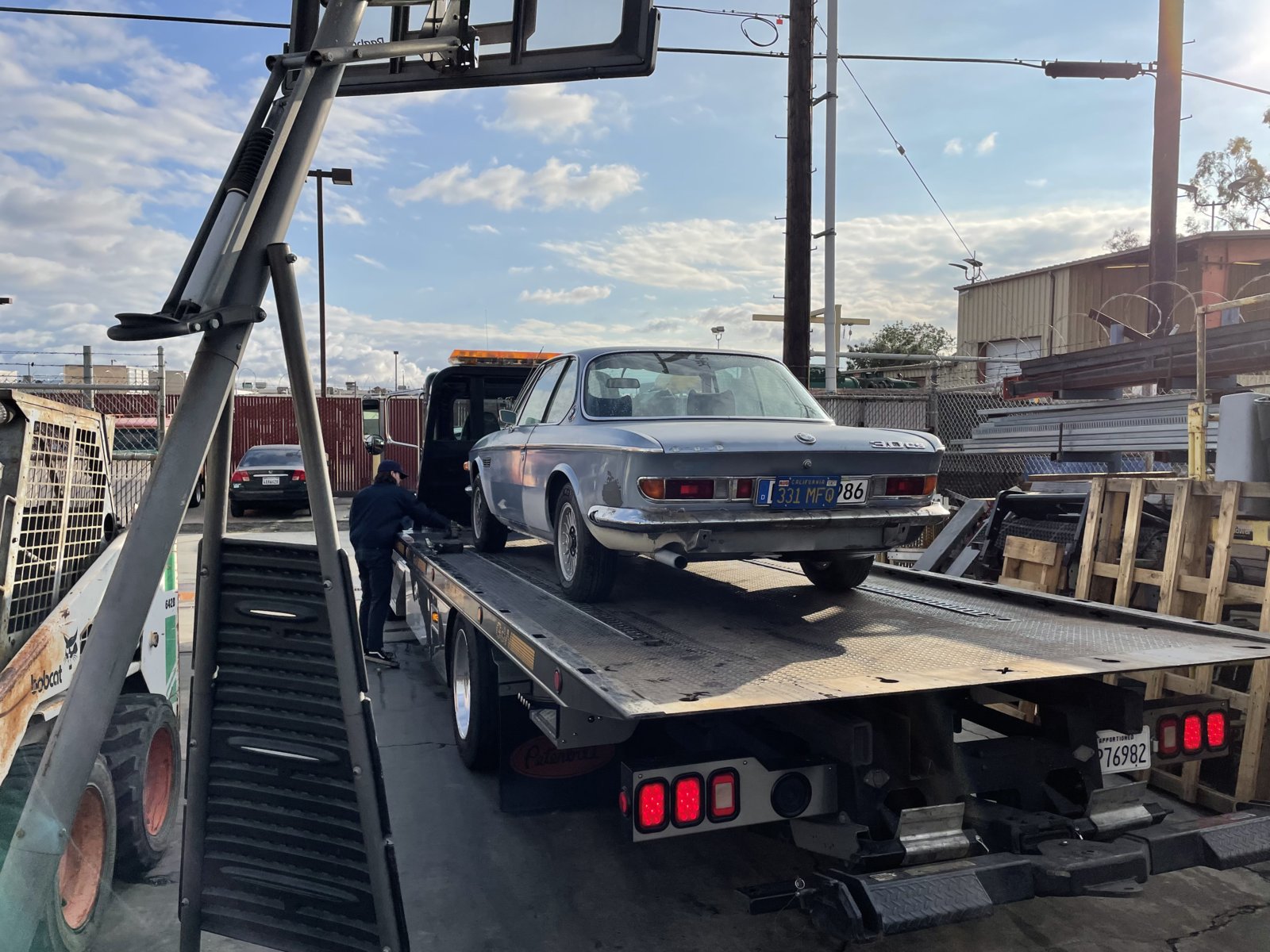

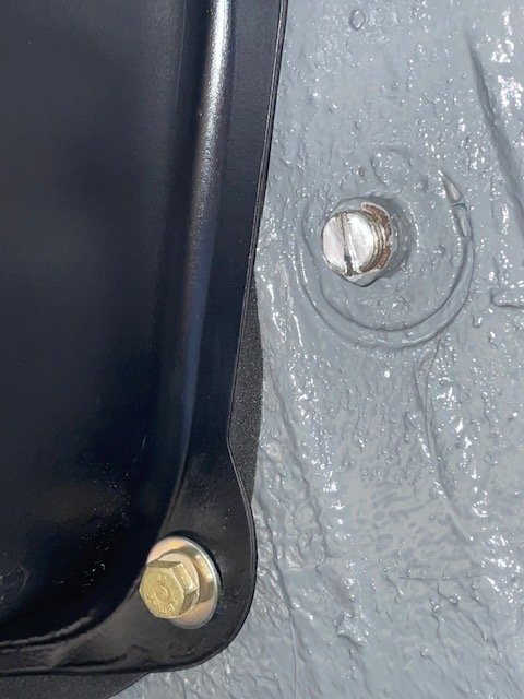

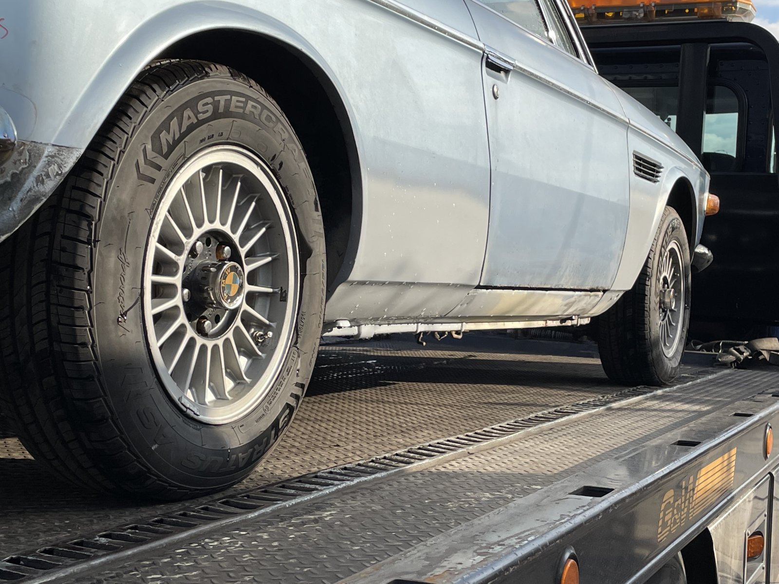

Phase I is finished. Phase I was all the metal work on the car. Rust remediation, Euro bumper conversion, side reflector delete and a full exhaust system are all now done. It's back to my home garage / shop for the next phase. With one more day still on the jackstands, I took the opportunity to pound out a few final metal projects:
Image 1 and 2

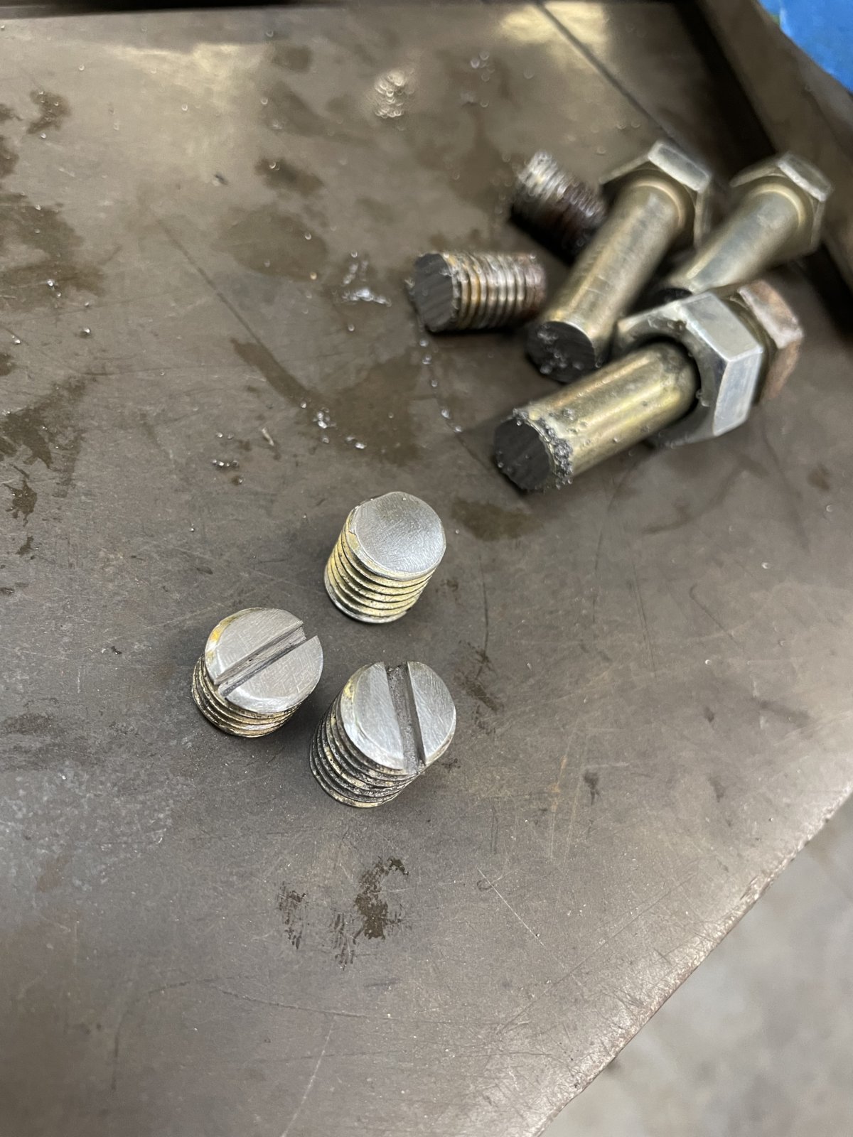

-fabricating three plugs to fill in the old bumper bolt holes as they would otherwise provide a leak path into the trunk area.
Image 3

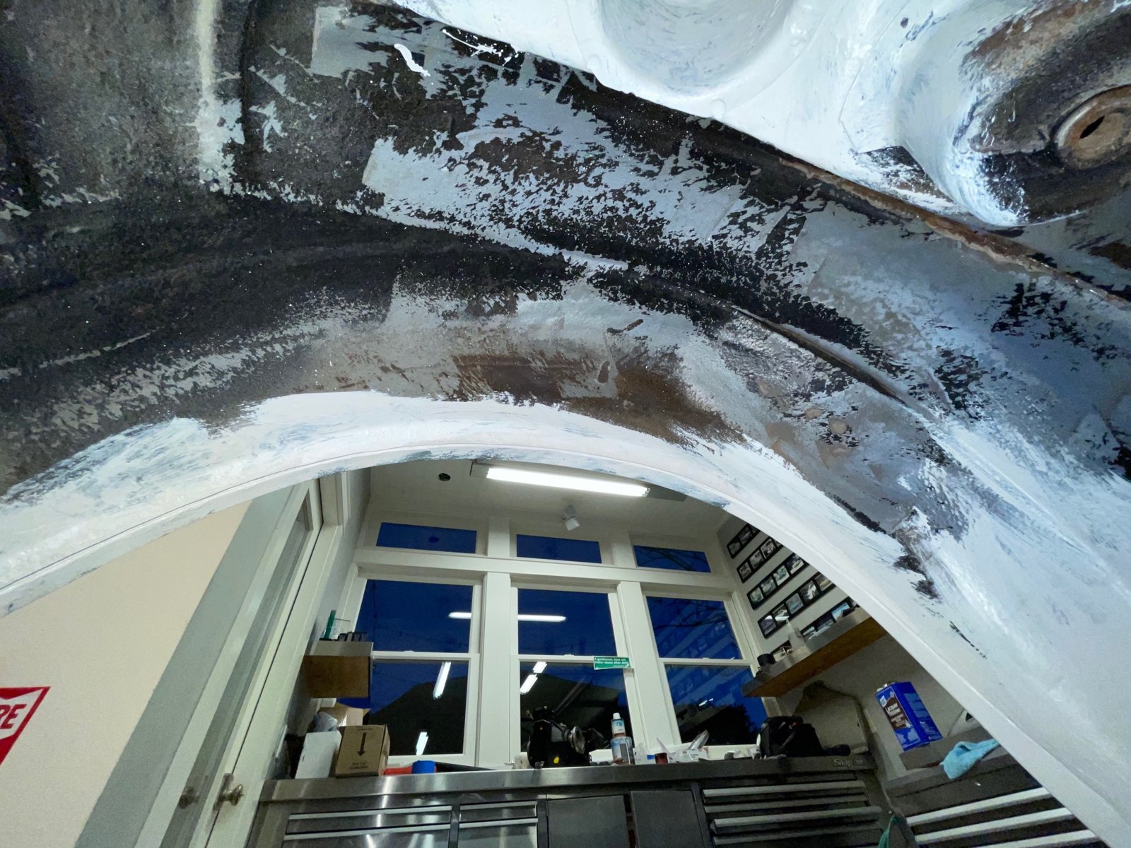

-cleaning up the excessively long 'lips' on the inner fenders (front and rear). Grinding back to the red line. This is 90% of the benefit of rolling the fender lips without damaging all the surrounding rocker schutz. This will all get DTM primer next week. I will likely be putting 16'' wheels back on the car and this (wider) section width might interfere with sidewall at full bounce. This is all excess material outside of the spot welded 'sandwich' that holds the inner and outer fenders together. It is cheep insurance and it is so easy now with the right tools and being high in the air.
Image 4 and 5
back on the transporter and heading home. Its been a great run. Time to move on to Phase II.

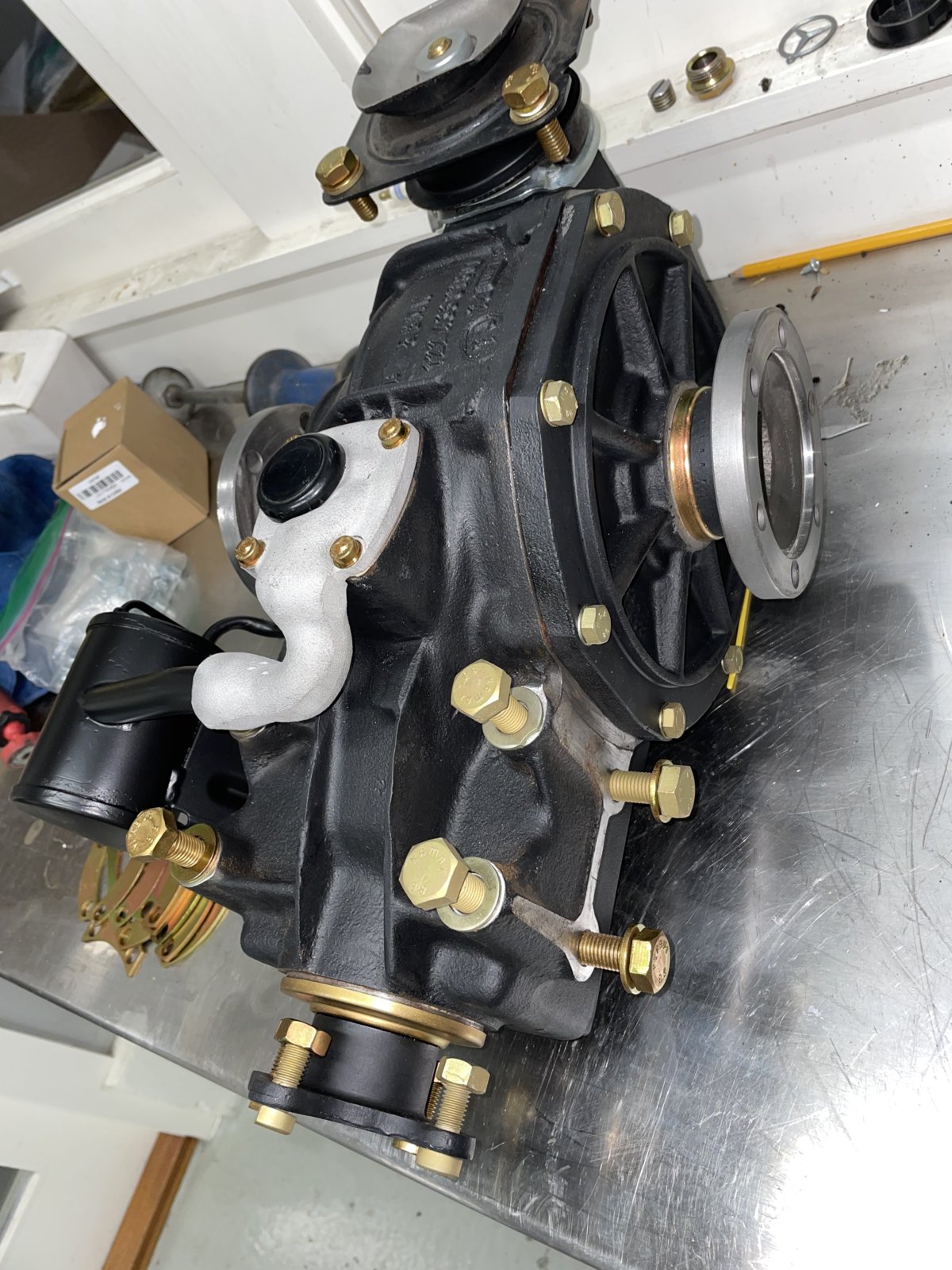

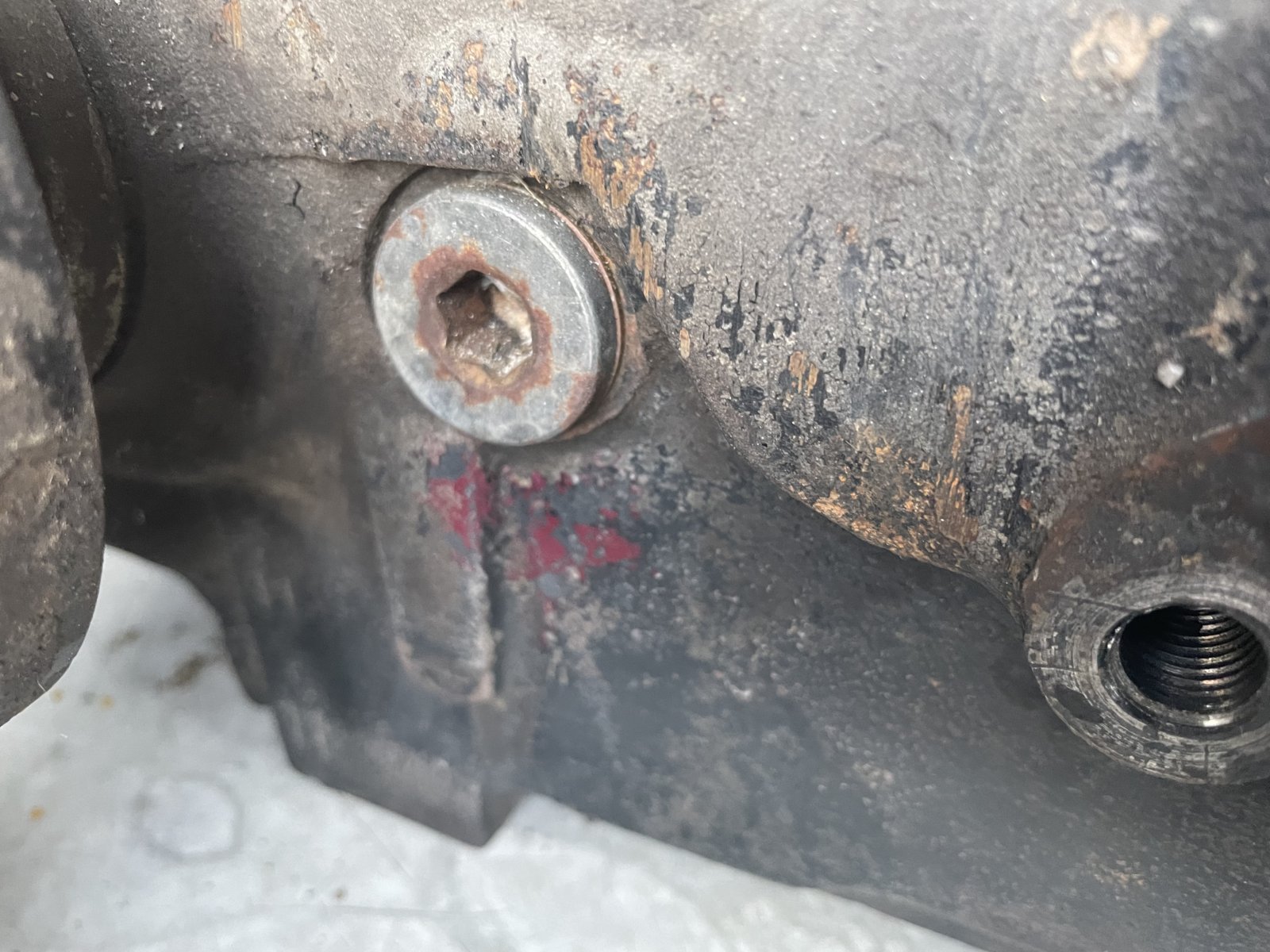

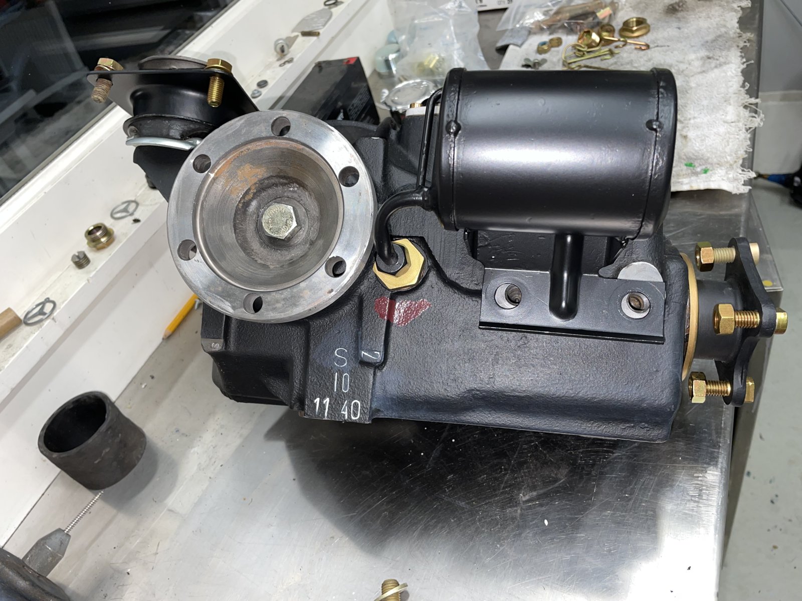

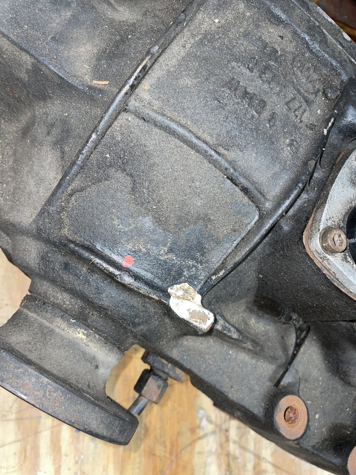

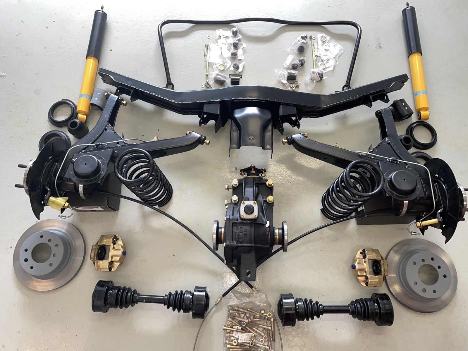

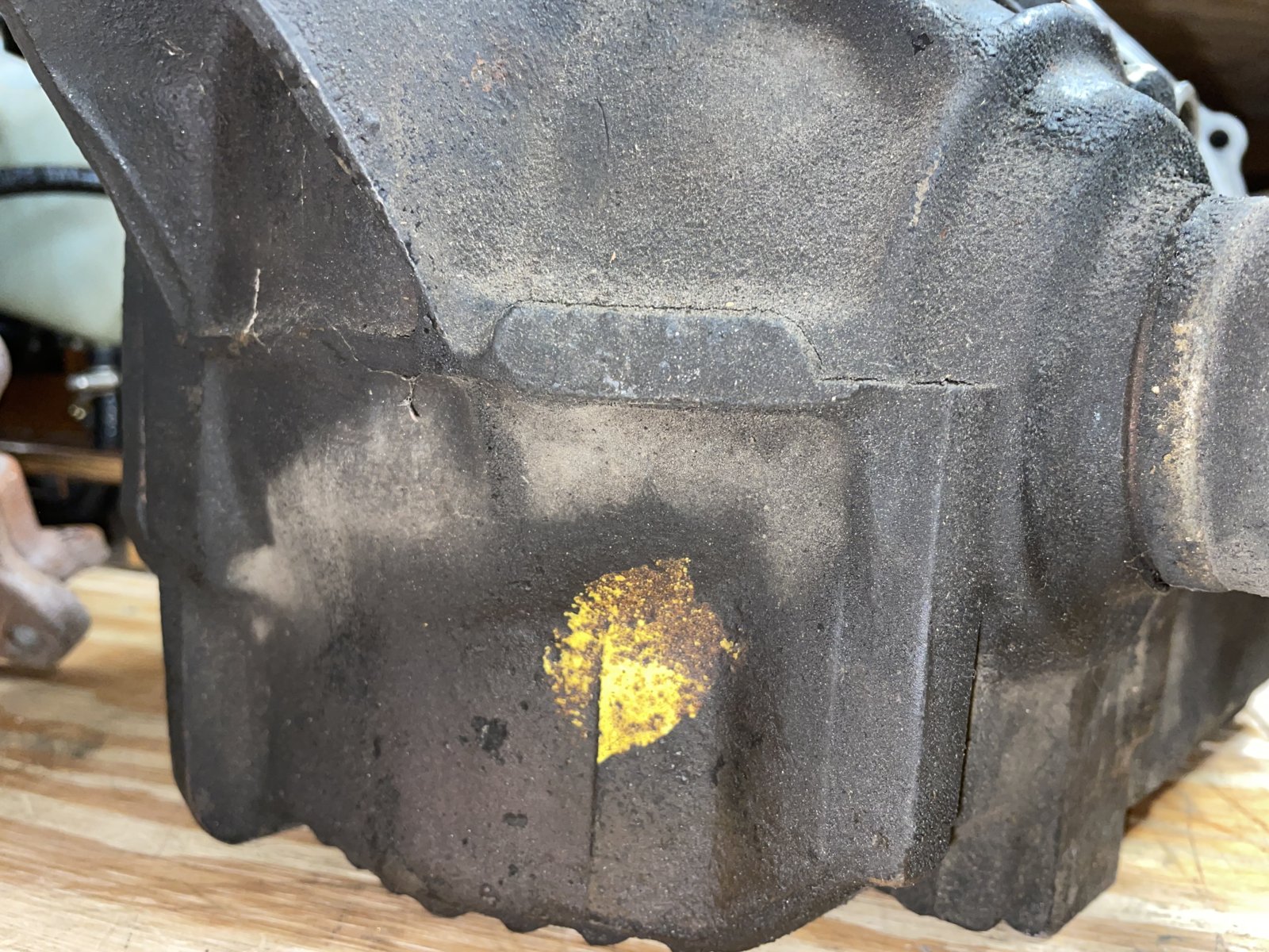

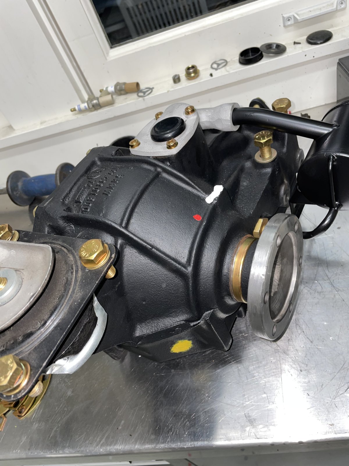

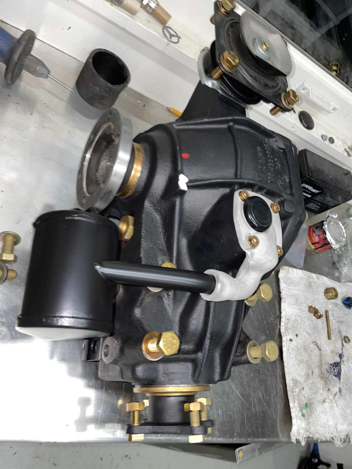

Phase II begins: While we work working on Phase I metalwork I sourced an entire front and rear suspension from a CSi. I've been working on preparing these parts for installation. Rear suspension will be first. The first full sub-assembly to finish on this project is the differential. (Yes, I know the oil reservoir was not originally fitted, I have yet to decide if I am going to install it). Here is the finished diff. sourced locally by a kind member of the E9 community. It got all new seals and the large "O" ring and is ready to be installed. (yes, I know it does not have the '74 threaded hubs). First three pics are for comparison purposes -from my recent archiving of the original color codes used on these diffs.

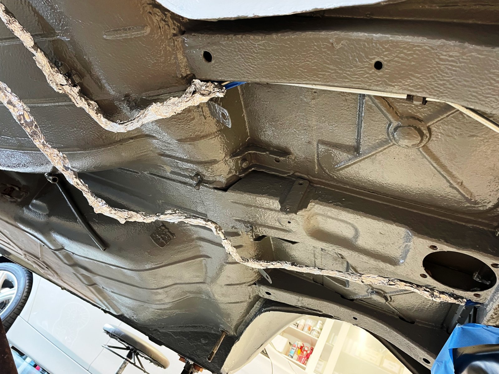

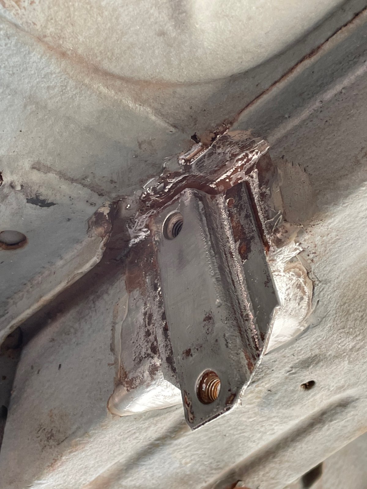

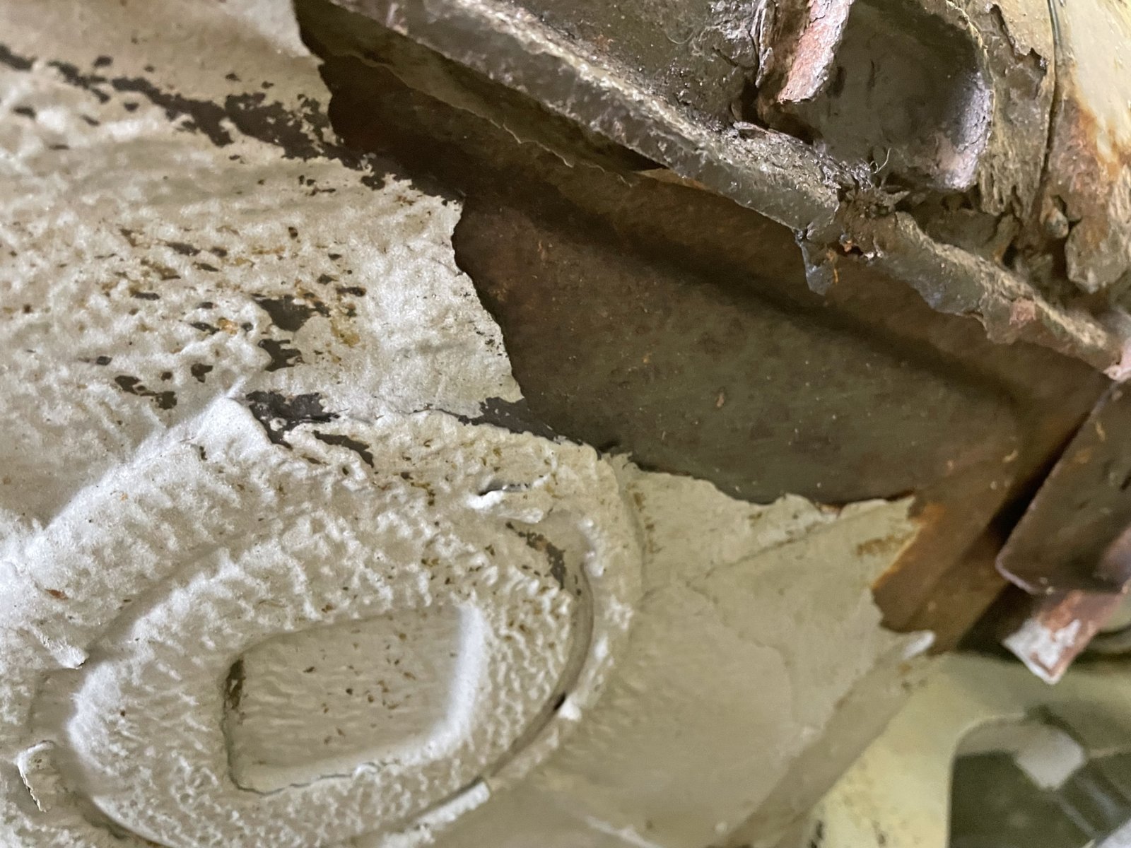

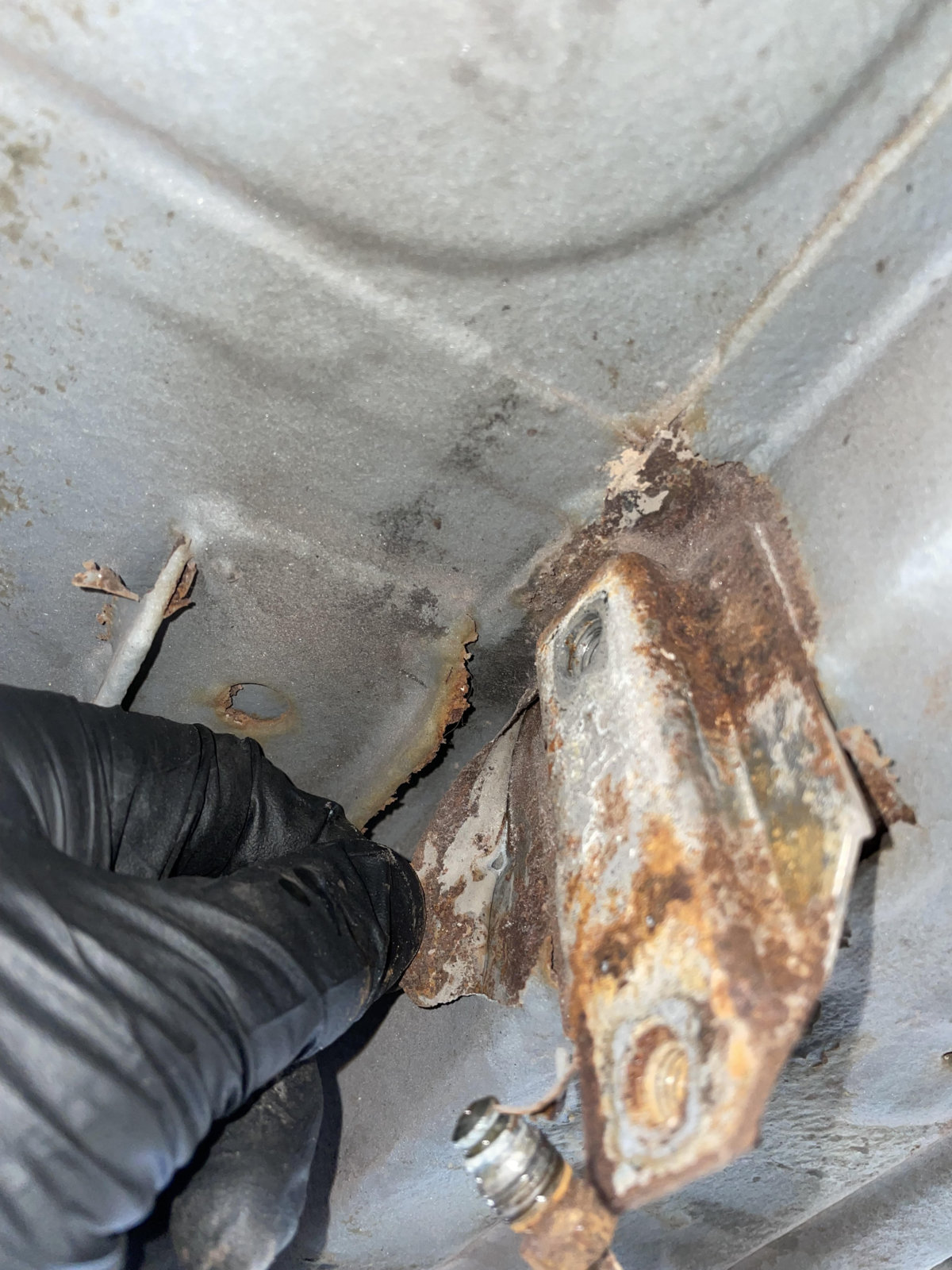

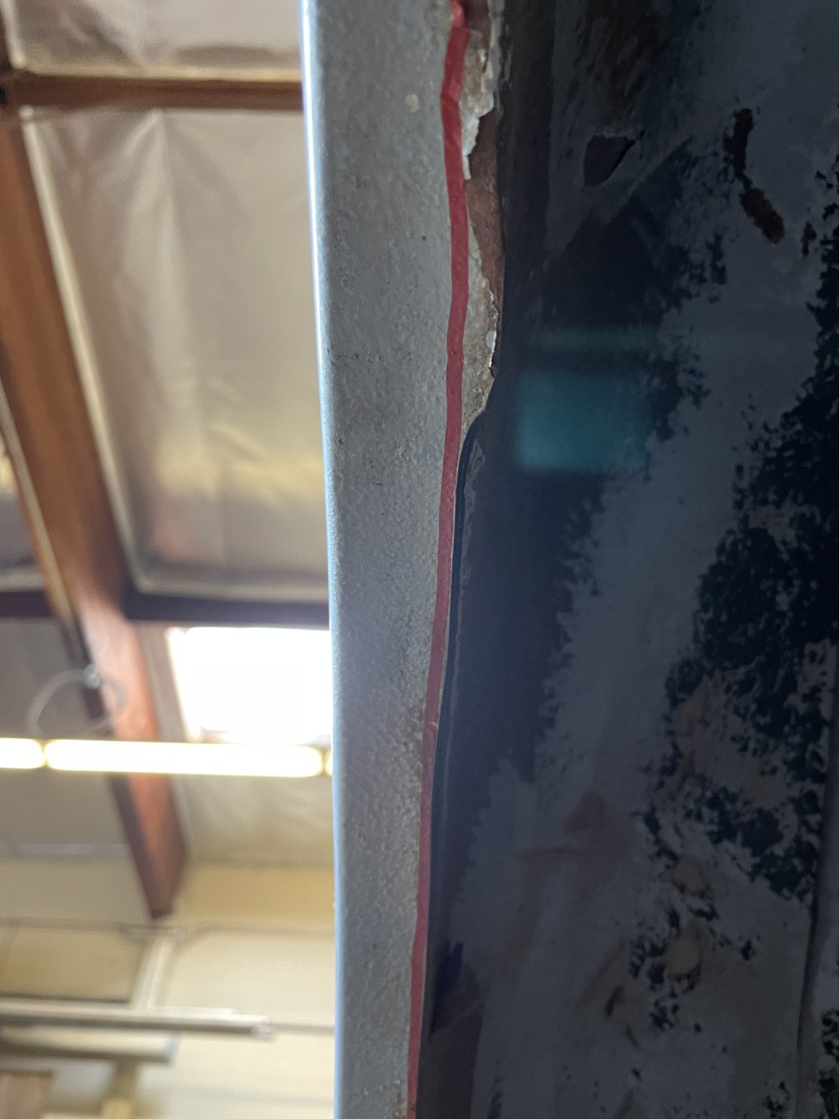

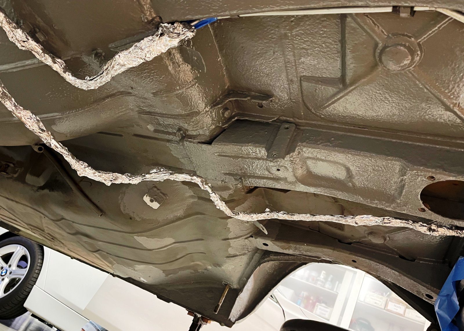

Progress report on Phase II -well underway. The original rear suspension has been removed. Step one is to address all the areas that have pealing rocker schutz in the area of the floor pans and above the rear suspension. This is mostly on vertical surfaces for some reason. Moisture has been creeping under the rubberized factory sealer.
I use and Exacto to cut back all of the areas that are pealing and stop when the factory sealer is still adhering well to the base metal primer (putty beige).
Next step was to grind away the surface rust and create some 'bite' for the primer.
Third step is to two coat the entire area with more modern DTM (Direct To Metal) primer that is very thick and catalyzed (4:1) If only Coupe had this chemistry and layer from the factory. (It is shocking to see just how thin the original paint and primer was applied, these poor cars never had a chance).
Next step will be reapplying the Wurth Stoneguard. (later)
Here is one example area in the rear of the car. This is the rear brake pressure regulator bracket that sits right next to the differential. There are about 6-7 other areas similar in scope that were treated with the same process.
Last image is the fender lips that we were grinding back last month to clean up the edges. I am using lacquer thinner as a final cleaner prep before the DTM Primer. These wheel wells were aggressively cleaned in the Fall with a pressure washer.

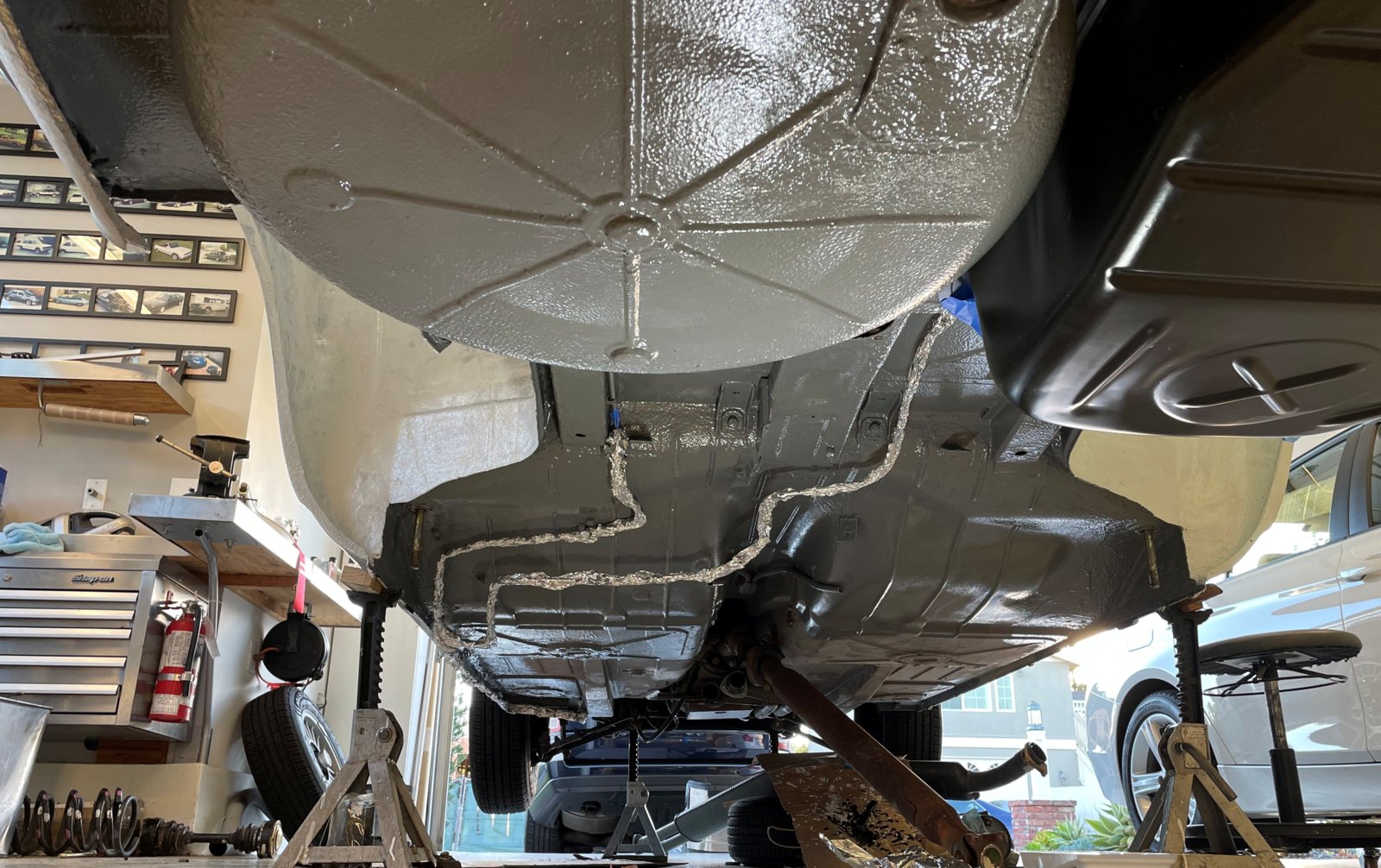

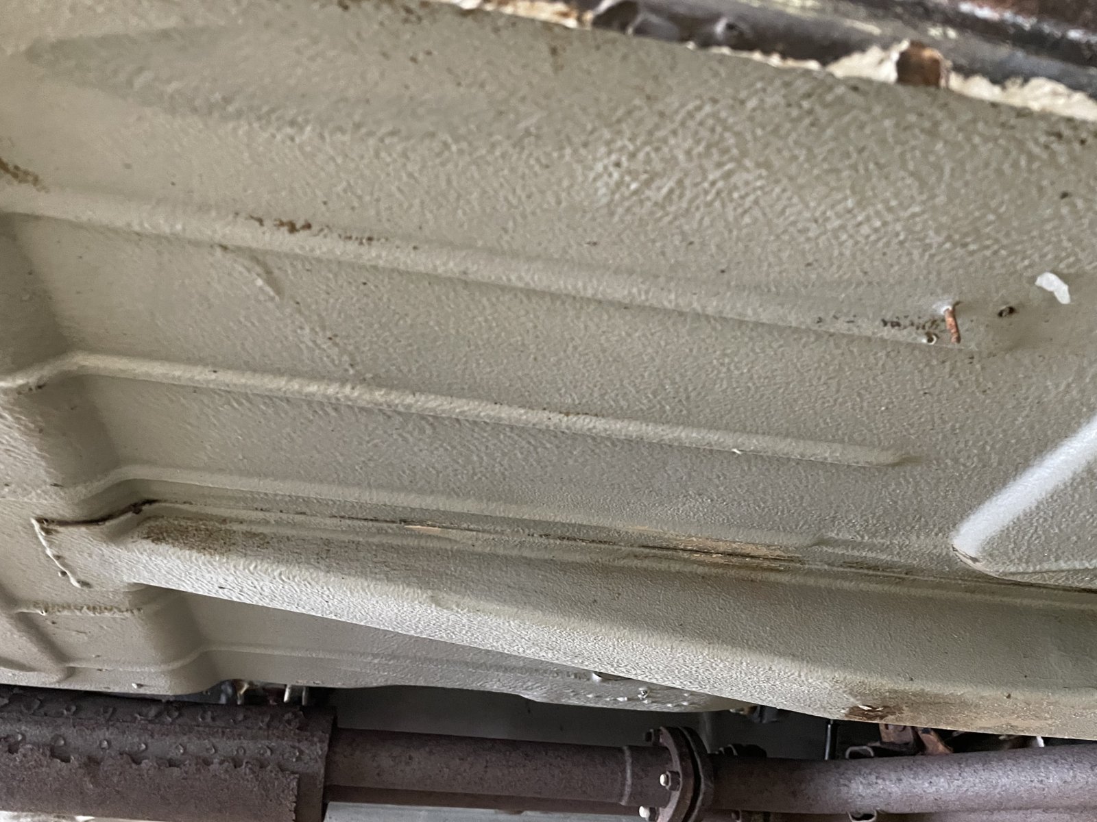

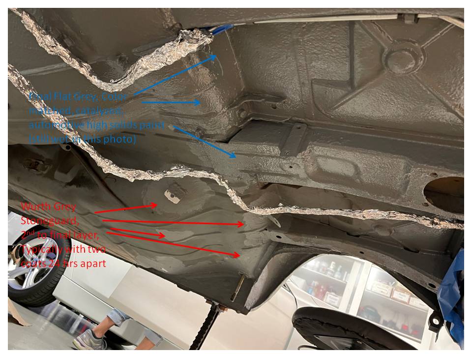

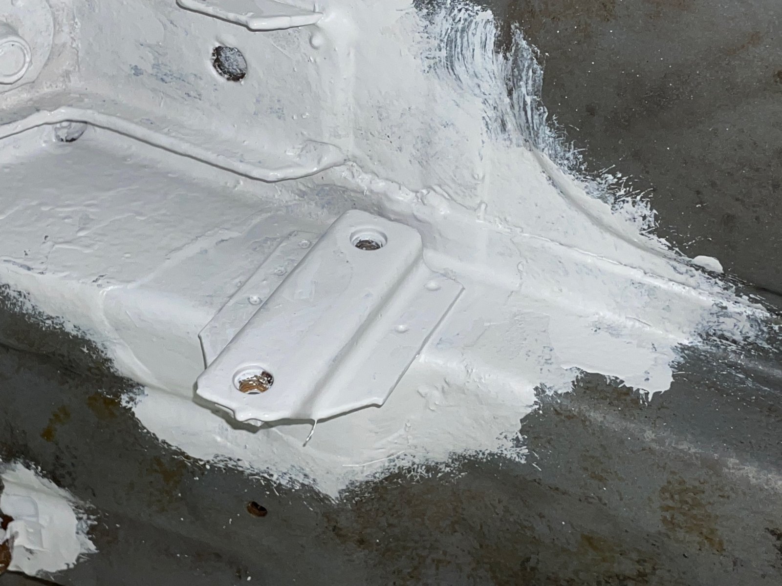

I forgot to photograph the application of the Wurth Grey Stoneguard. If you are going to do underbody repairs on an E9, I can highly recommend staying with Wurth. And this particular product as the best in terms of surface finish, adhesion and lack of shrinkage.
Image: 'final coat' shows that I am about half done with the back half of the underbody. Its slow going to get every nook and cranny.
Image: Slide1 shows the difference between the Wurth texture and the final flat grey sealer paint. This still looks shiny as it is still wet. It'll be tack dry in a few hours. It dries slow and gets less shiny over time.
This is the final surface and will seal off the new and the original stoneguard that I've tried to keep intact. I'll get about half of floor pans done in Phase II and the remainder will be done in Phase III.

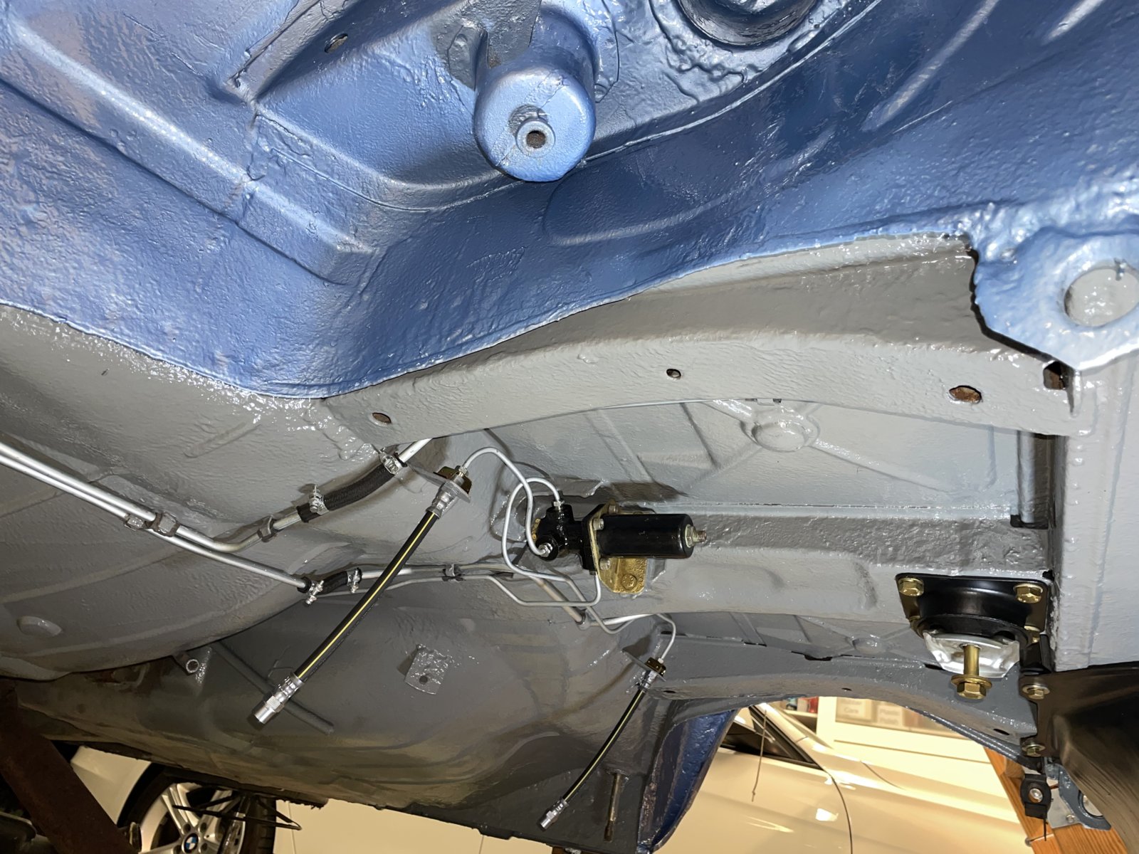

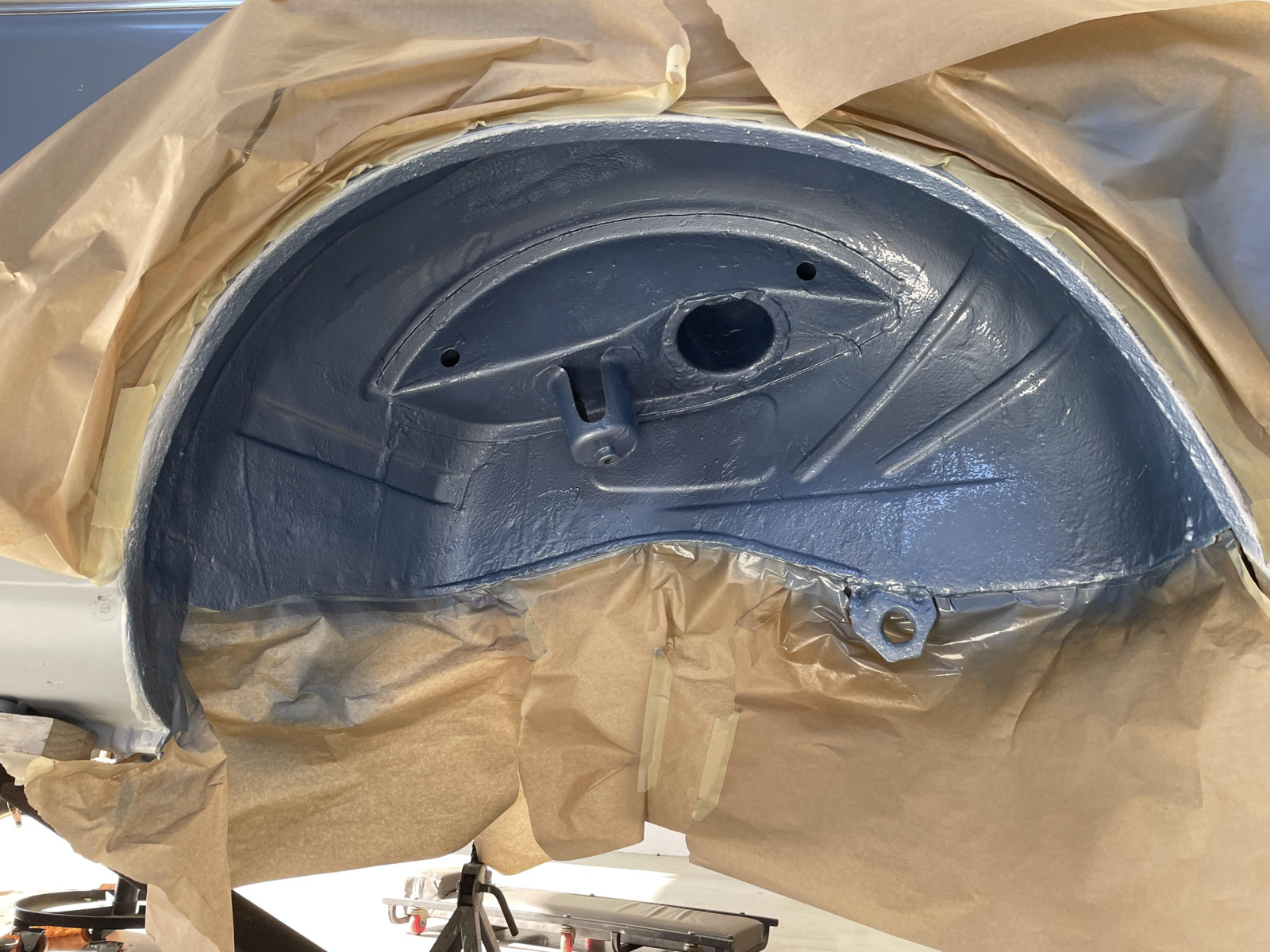

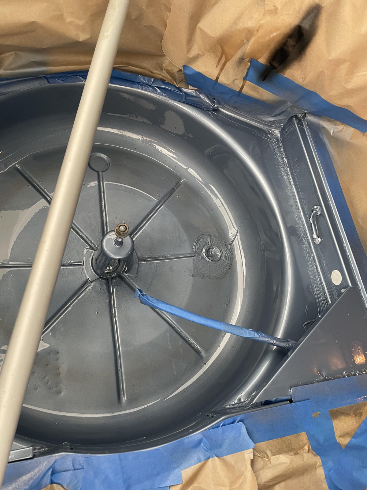

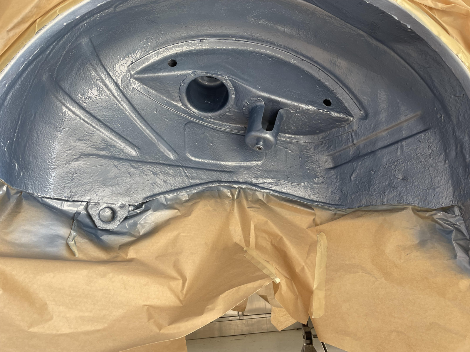

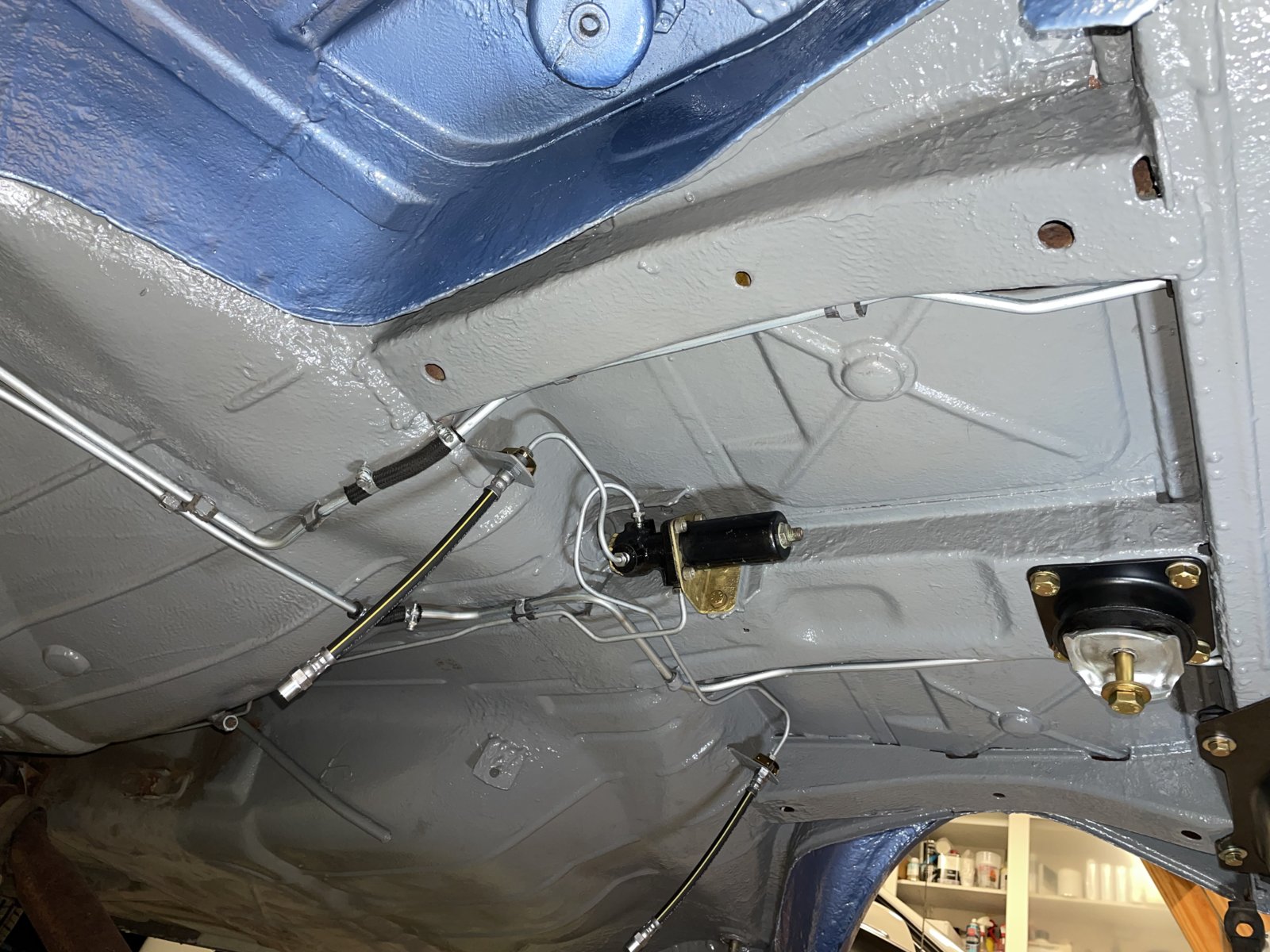

Finally, we put down some color.
Right side of the trunk was completed when the fuel tank was out in December. Now the left side is done. (this is the original trunk floor BTW)
Wheelwells have one coat of base Fjord blue and two coats of clear coat.
Undercarriage is now ready with both new fuel and brake lines install. Ready for the subframe to go back in with the differential.

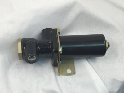

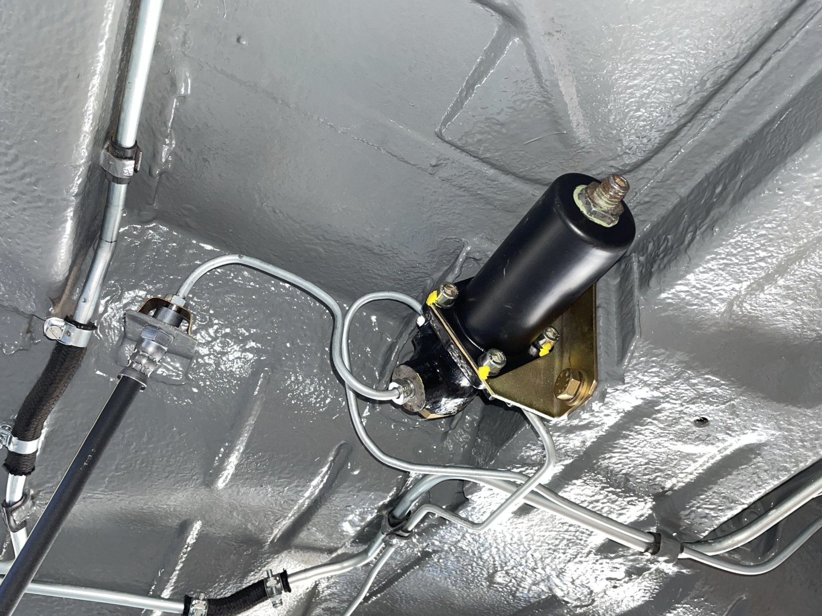

I have been waiting for the rear brake valve rebuild kit to arrive from the UK. It just landed and the rebuild process went very smoothly. Rebuilding is identical to a master cylinder + having to fixture the assembly under spring pressure to re install the four bolts. His instructions are very clear. The kit is complete. Highly recommended.
I am getting ready to reinstall the complete rear suspension now that this valve is done and installed with the new hard brake and fuel lines.

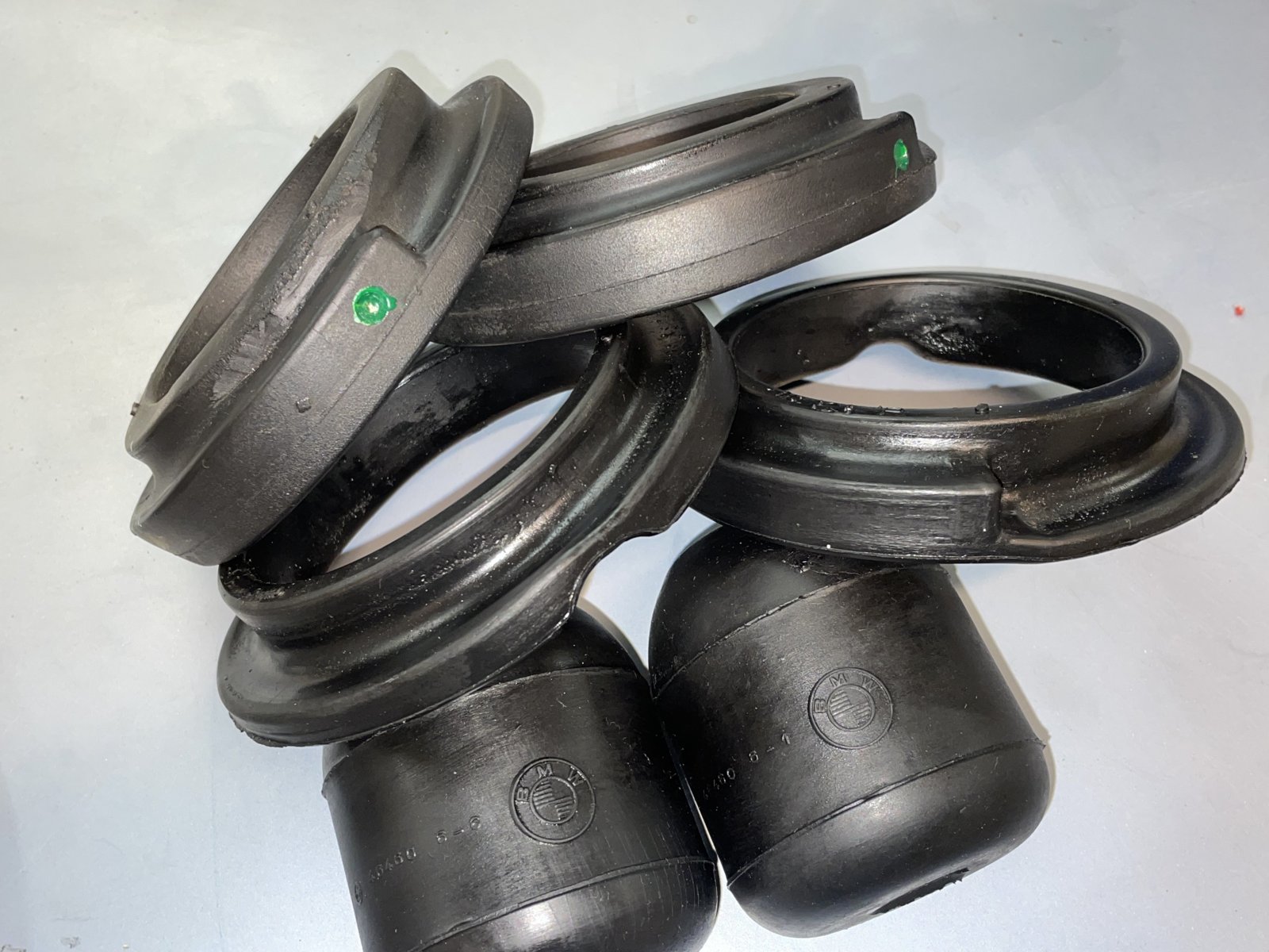

Lastly, it is just amazing 48 years after manufacture just how supple the original rubber parts are on this Coupe.

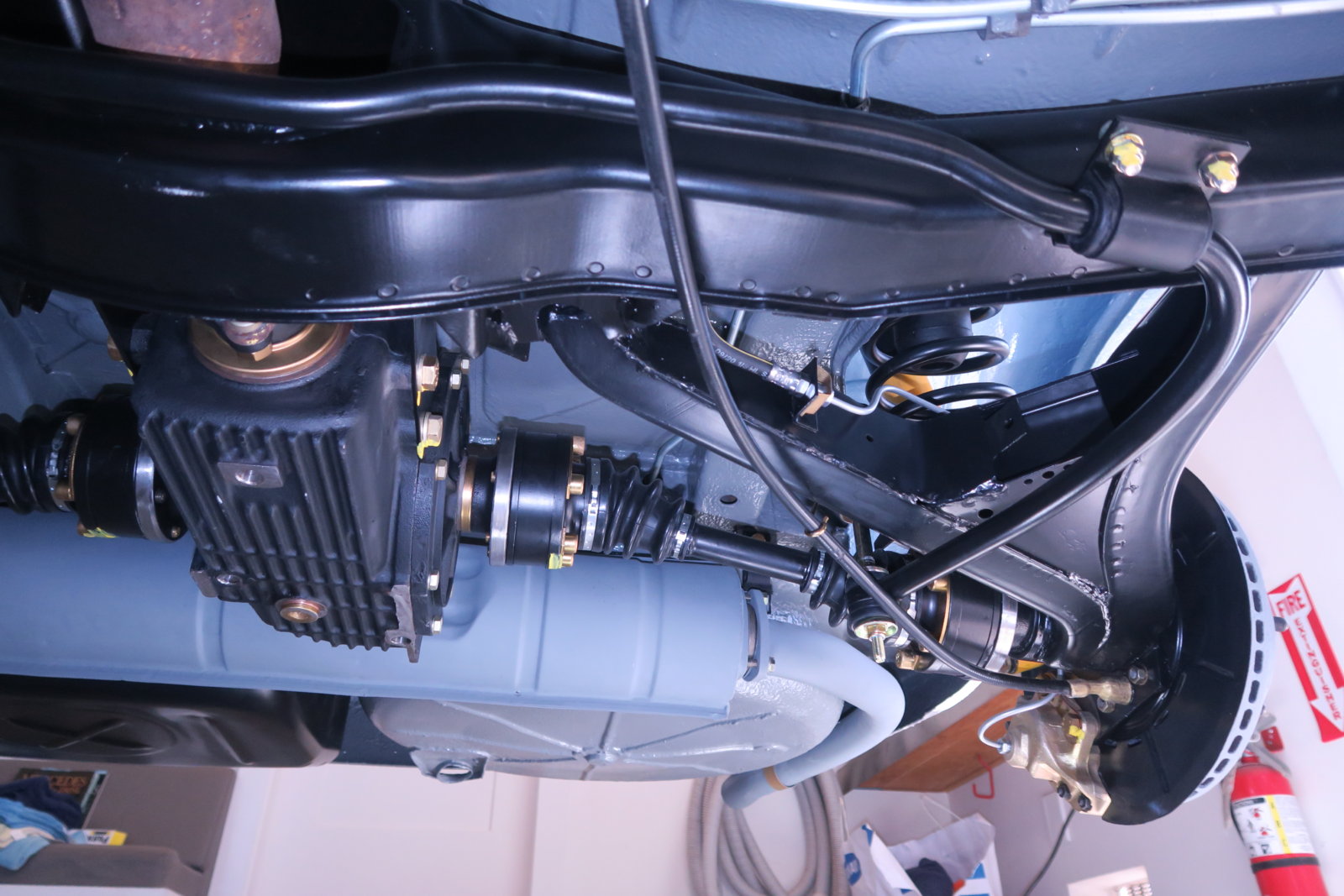

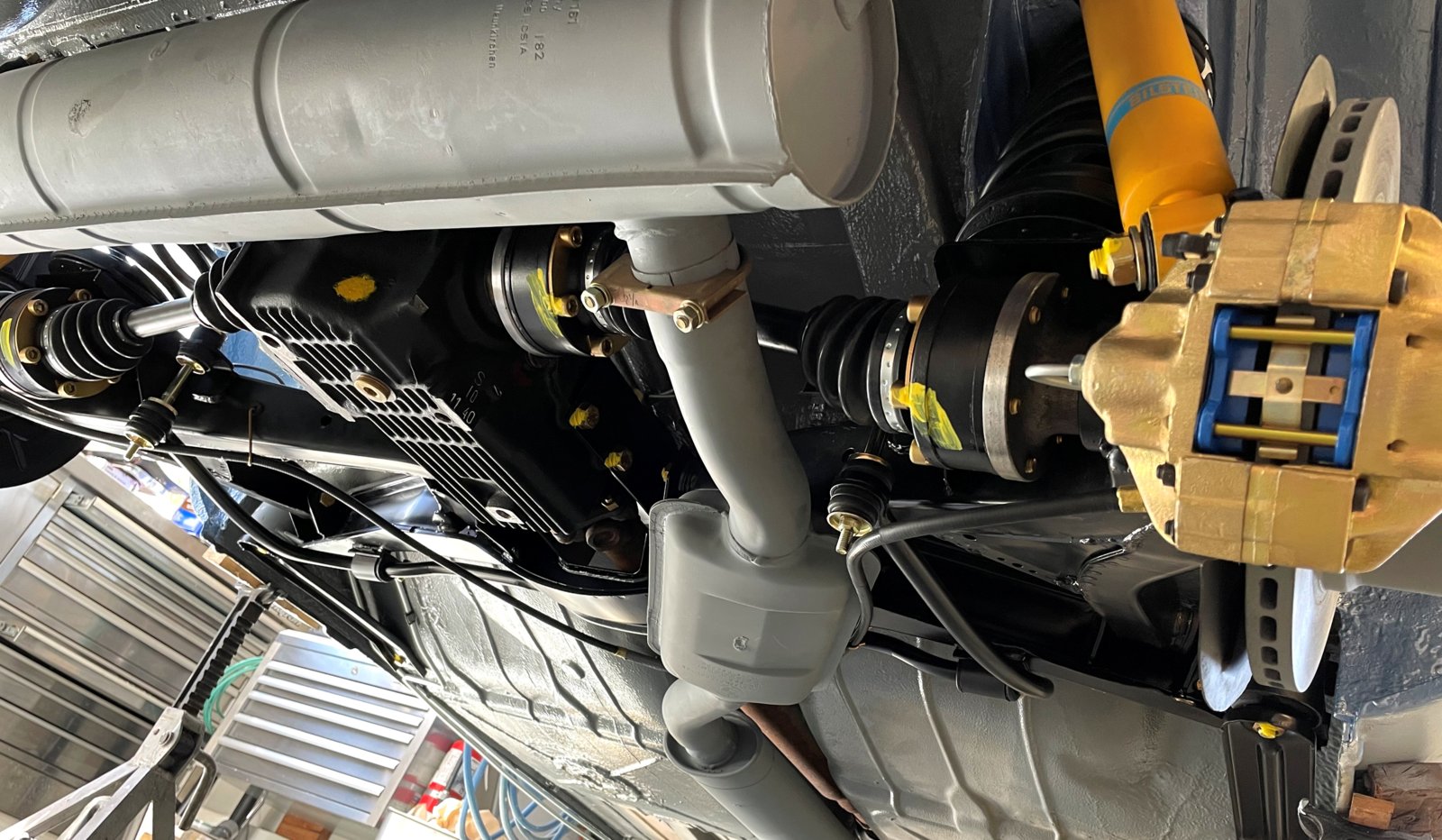

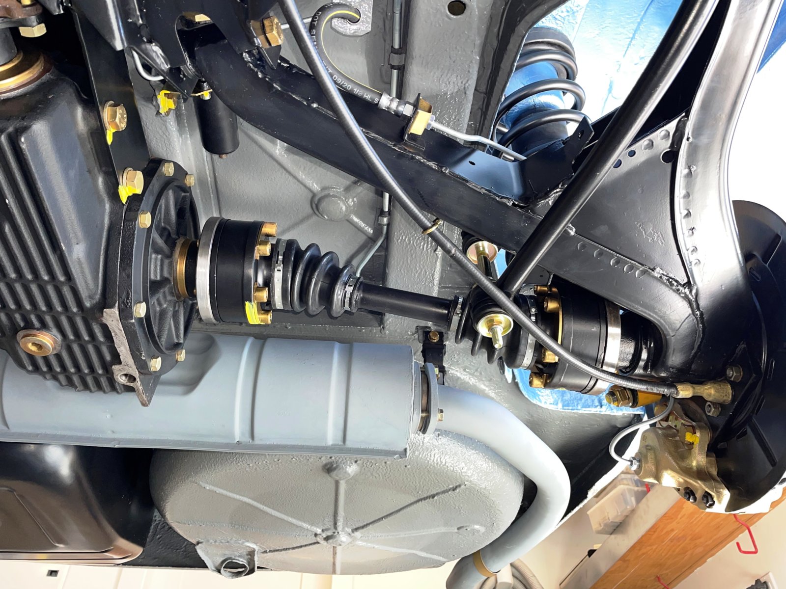

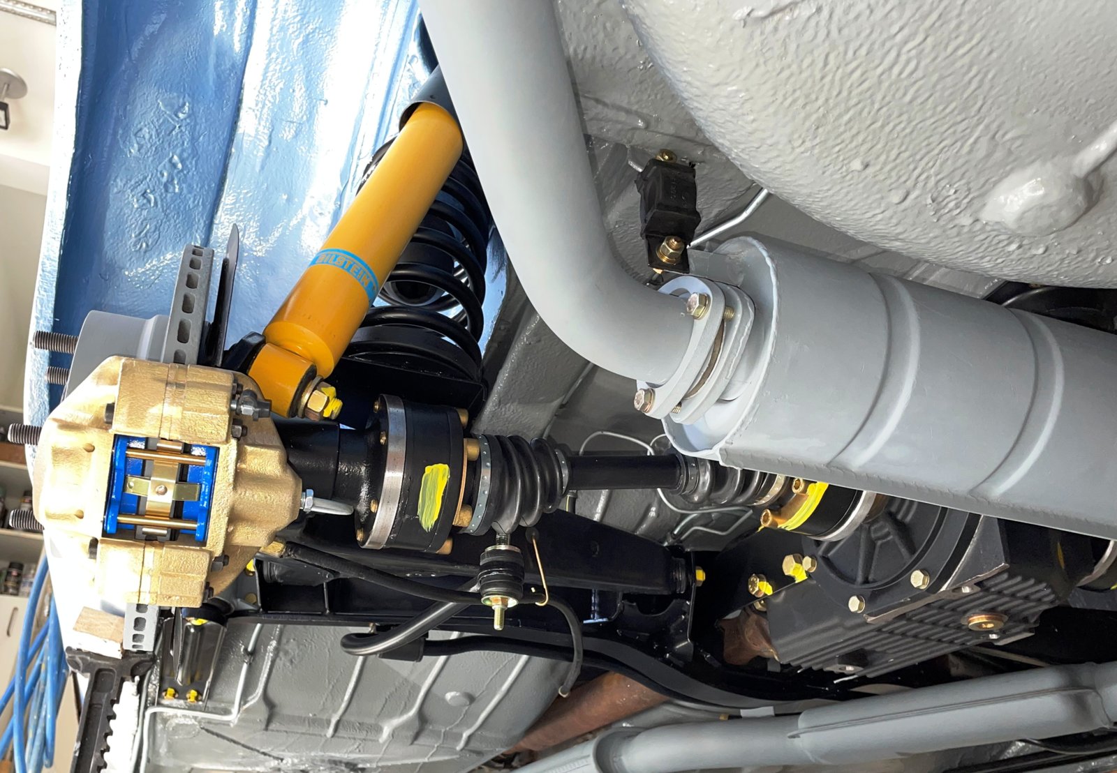

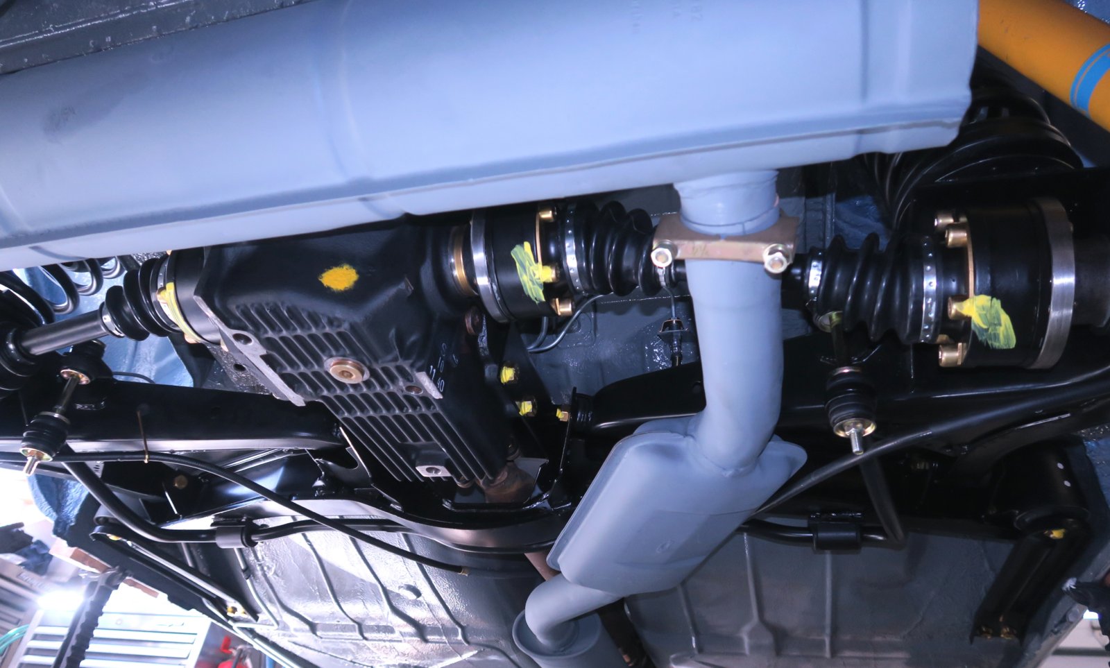

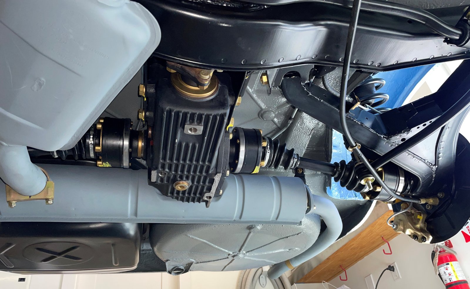

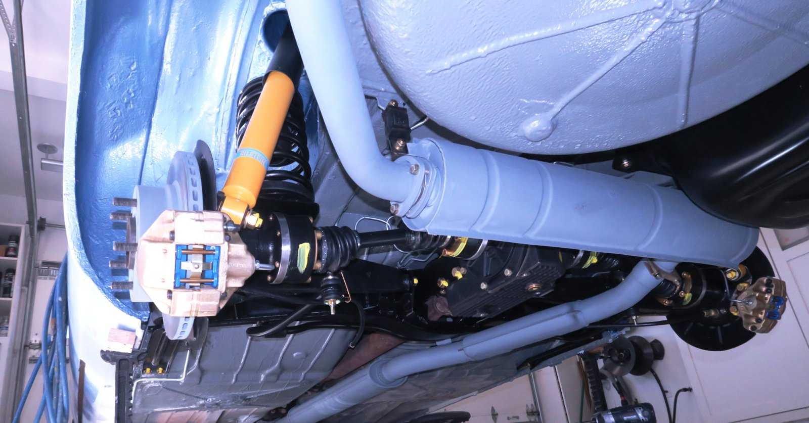

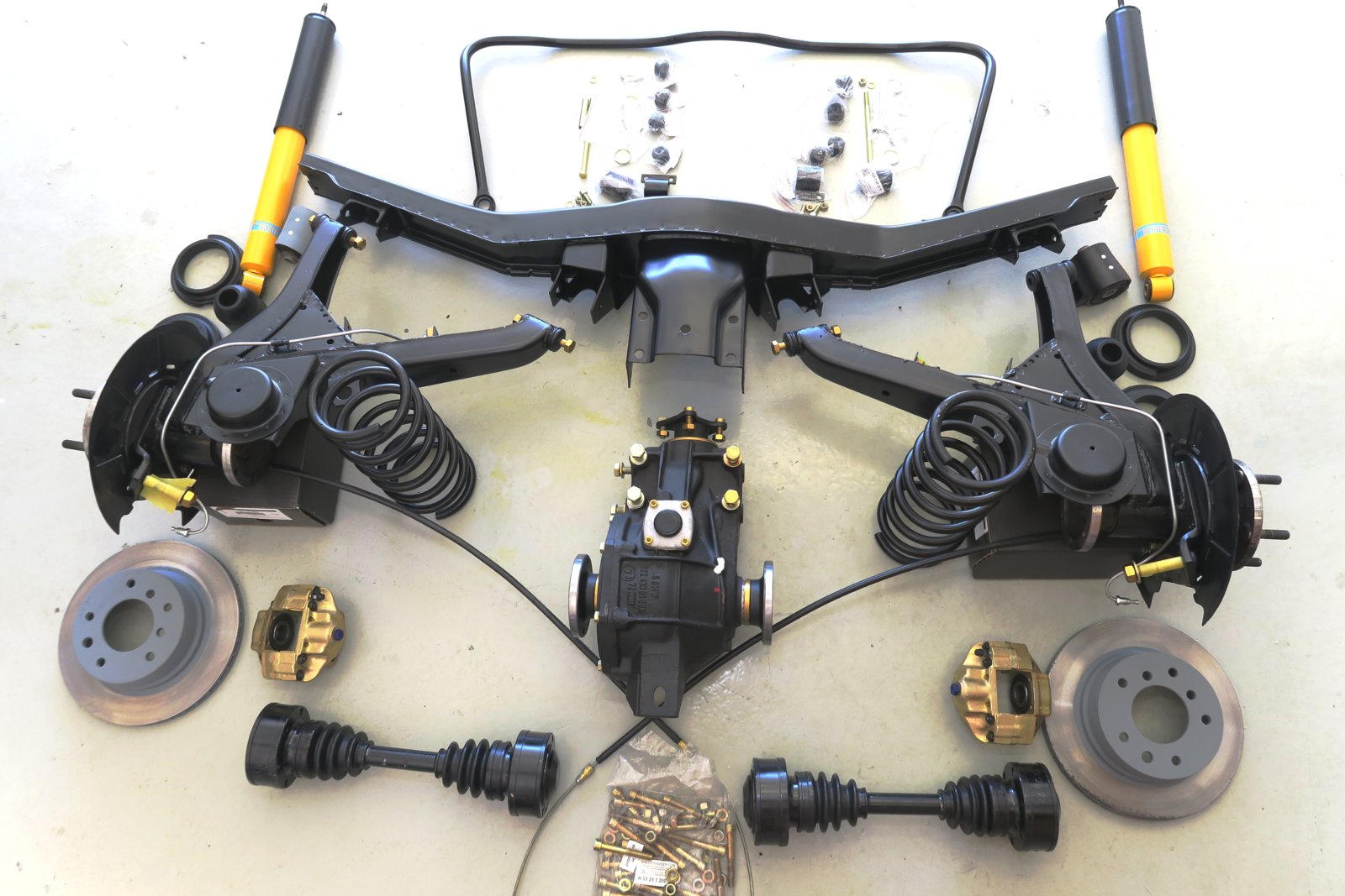

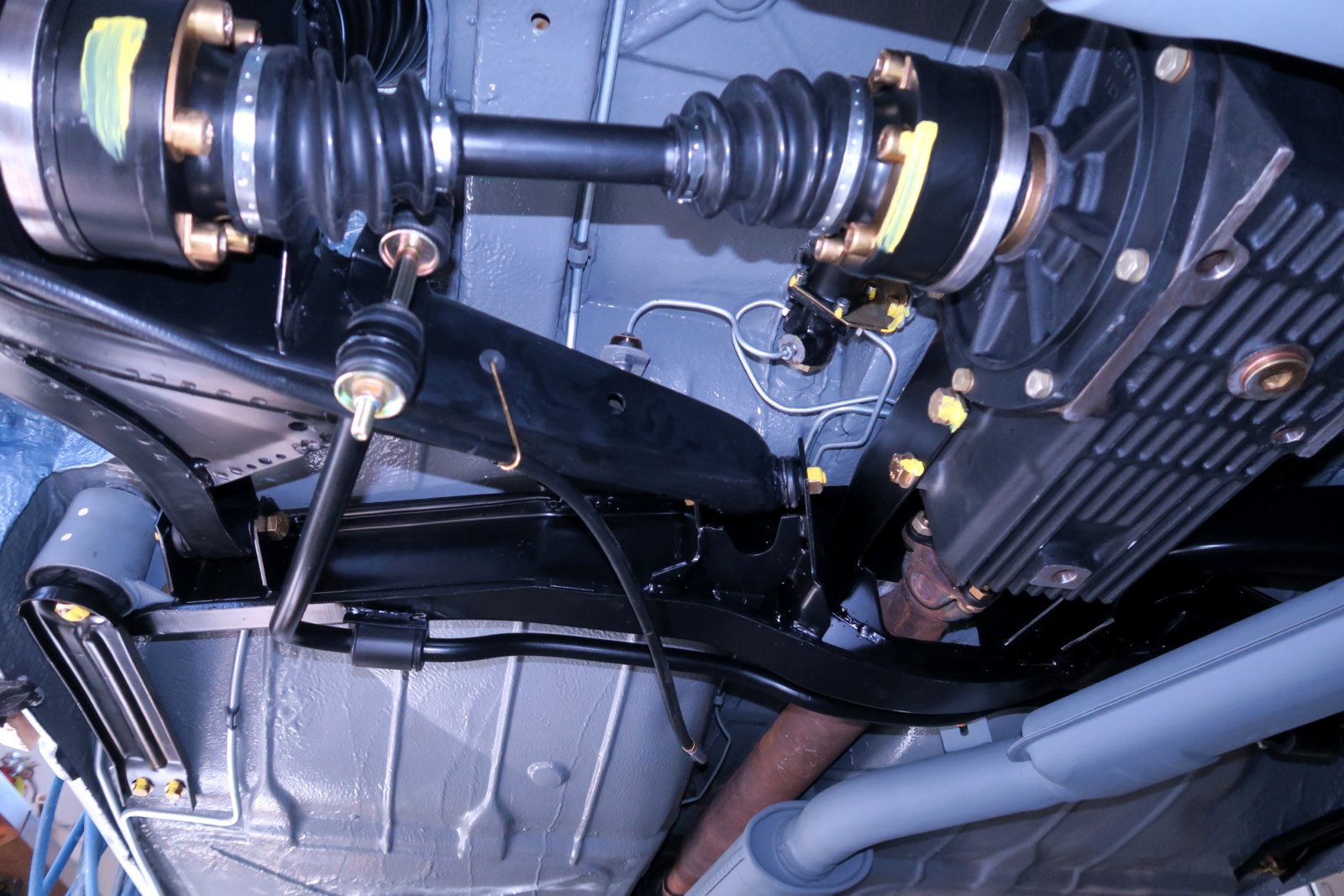

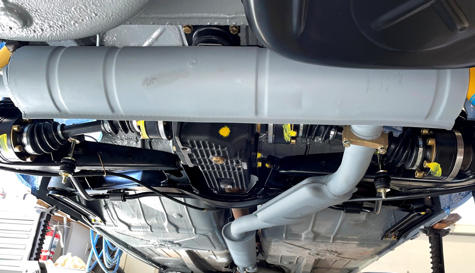

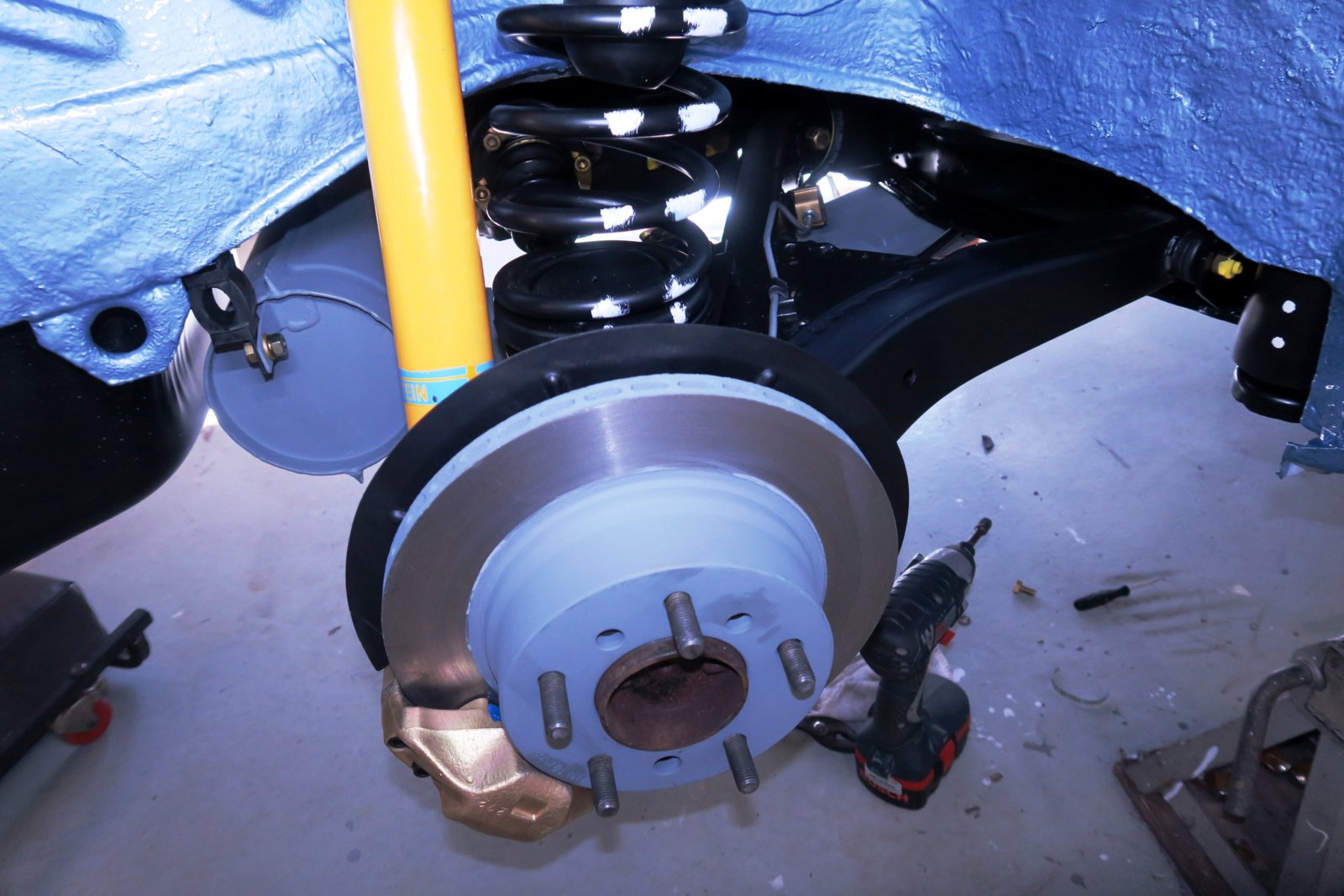

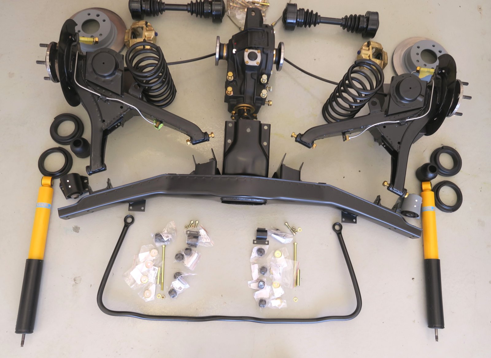

Ready for installation. I decided to remove the auxiliary oil canister off the differential as it was not originally fitted in 1974. Still missing some small hardware items, but the big pieces can go back in tonight.
