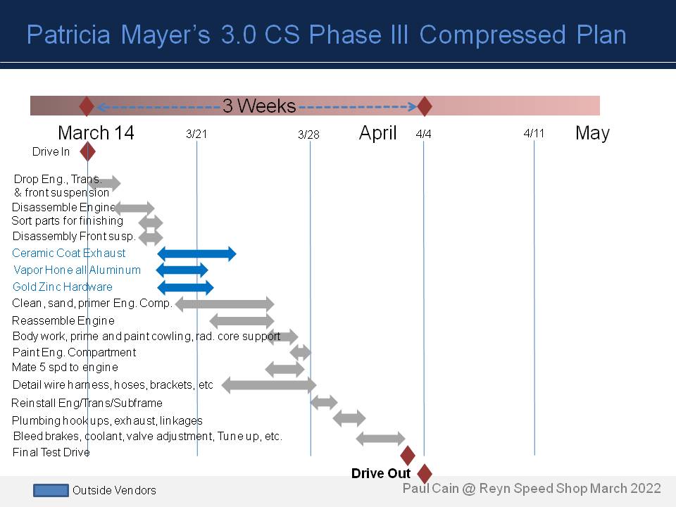

Monday begins Day 1 of Phase III. And Phase III is a game -to maintain a very high standard of workmanship, encompass a very large scope of work and to seriously compress all of it into three weeks with a hard deadline of April 4th. Watch this space.
See attached schedule.

Why April 4th?
Short Answer:
It was a combination of two things:
1-having all the parts and sub-assemblies done and 'on the shelf'
2-availability of a professional workspace
Long(er) Answer:

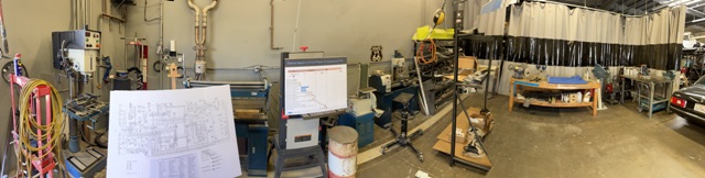

I am extremely fortunate to have Rey Rivera as a friend and an intensely focused Vintage BMW collaborator. For those of you who have not seen his 'shop' Shop is a massive understatement. Go to:
For the next three weeks I am renting this corner at Reyn's Speed Shop. There is no better space to do the work we are about to undertake, than this corner of Reyn's facility. All the mechanical work on the hoist, then roll it back 15 ft and we have an instant 'spray booth'. Then roll it back for assembly. Sounds easy, huh? ;)
I am exceedingly fortunate that I can do my own work here and then pull in Reyn resources to help with key areas to keep the timing on schedule. This shop is exceedingly powerful in ways the images can't convey. Its the knowledge base and resources that are a phone call or a heckle away. We know we going to run into issues and roadblocks, and it's this 'game' in this problem solving that is so gratifying. It's Rey's openness and sharing, and my desire to up our mutual game on workmanship and sharing whatever we learn.

Monday is 1 of 21. Three weeks ends on April 4th.

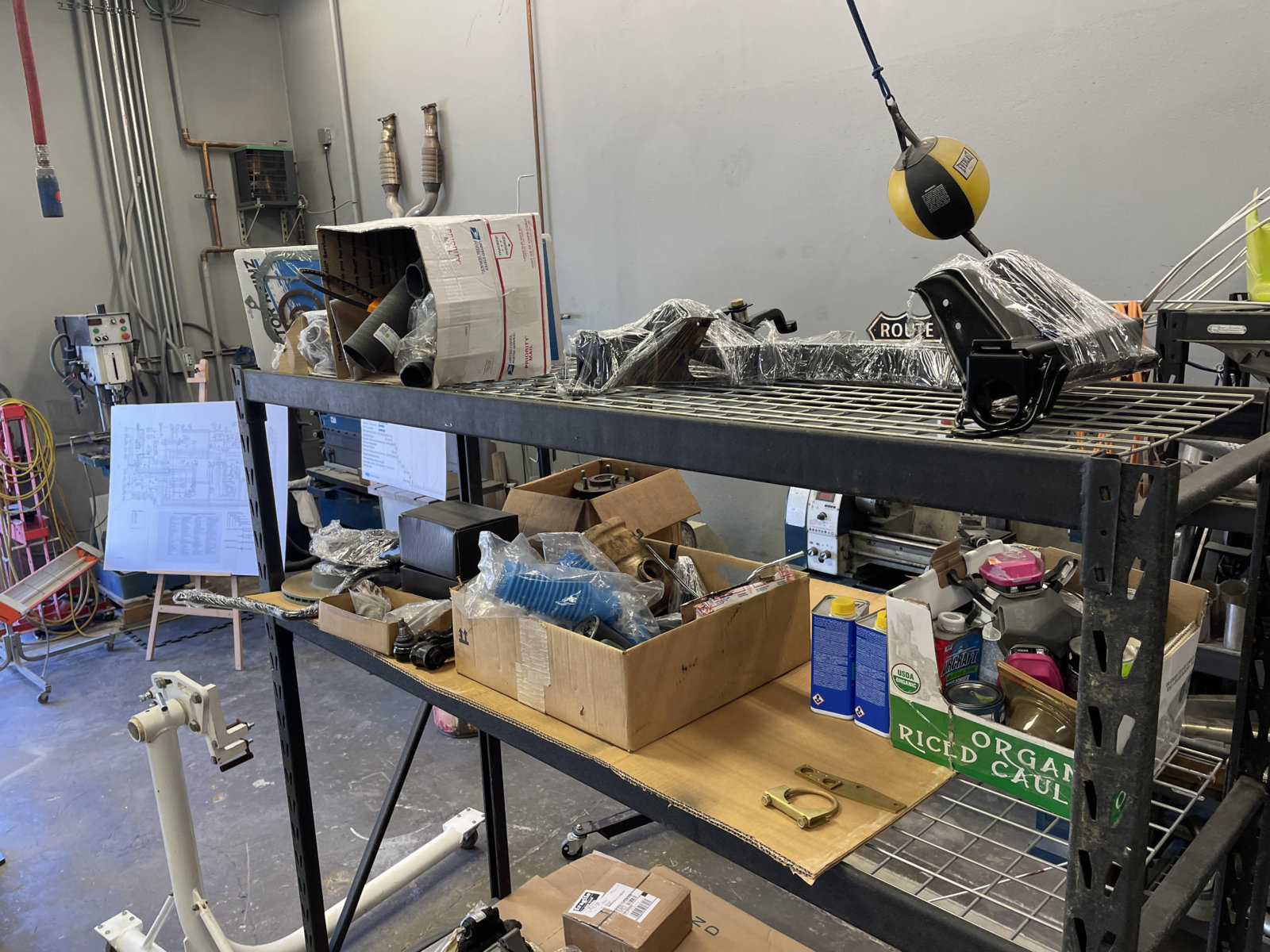

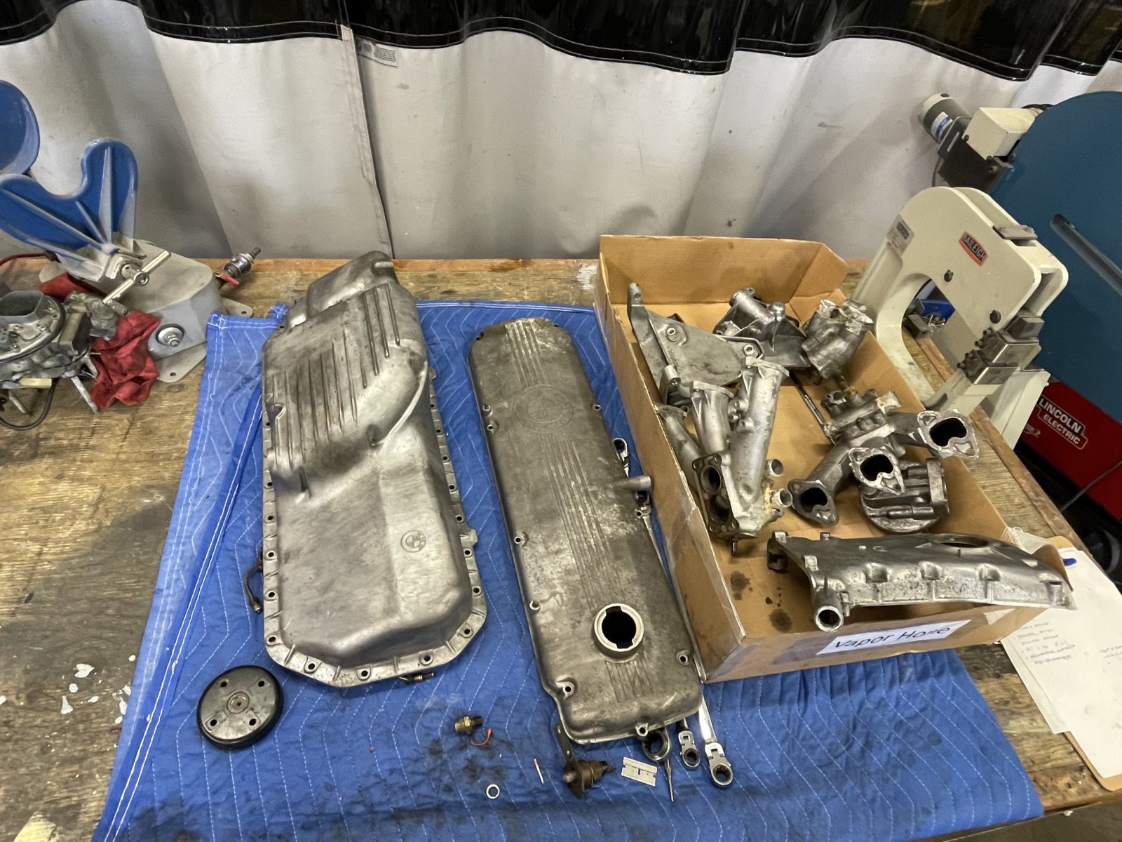

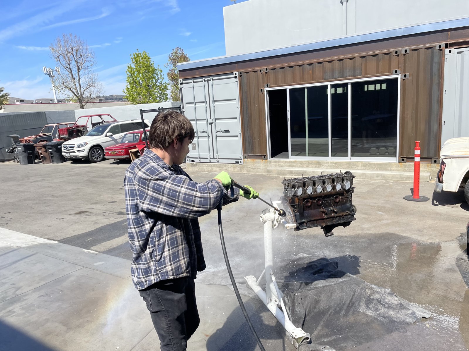

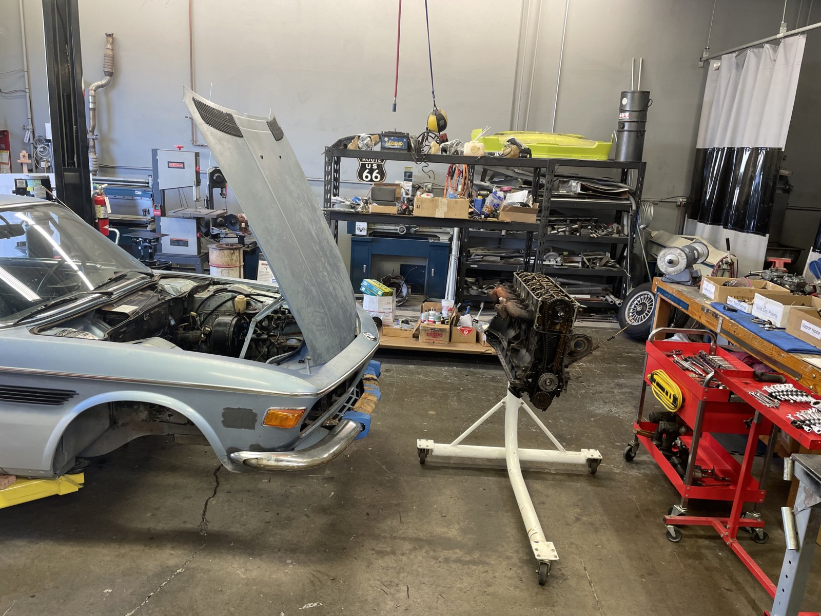

Day one was very productive.
Started at 7:30 am

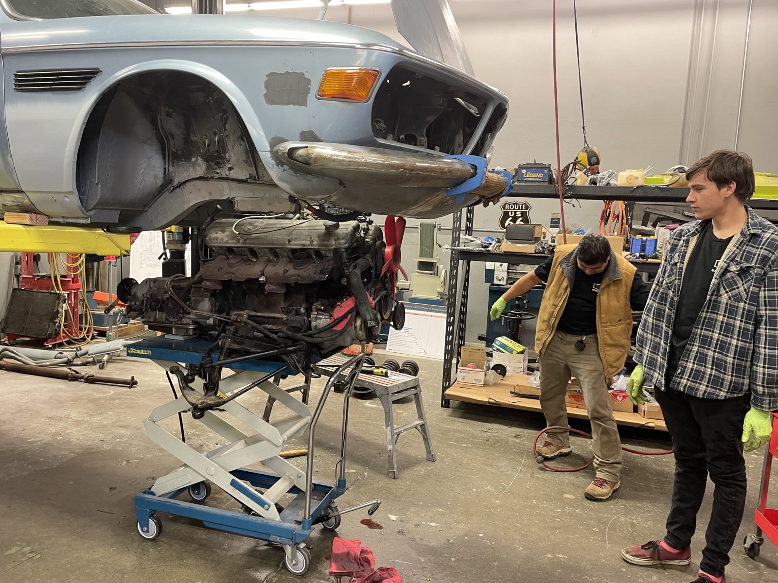

Image one: -the motor and auto trans dropped at ~10:30am

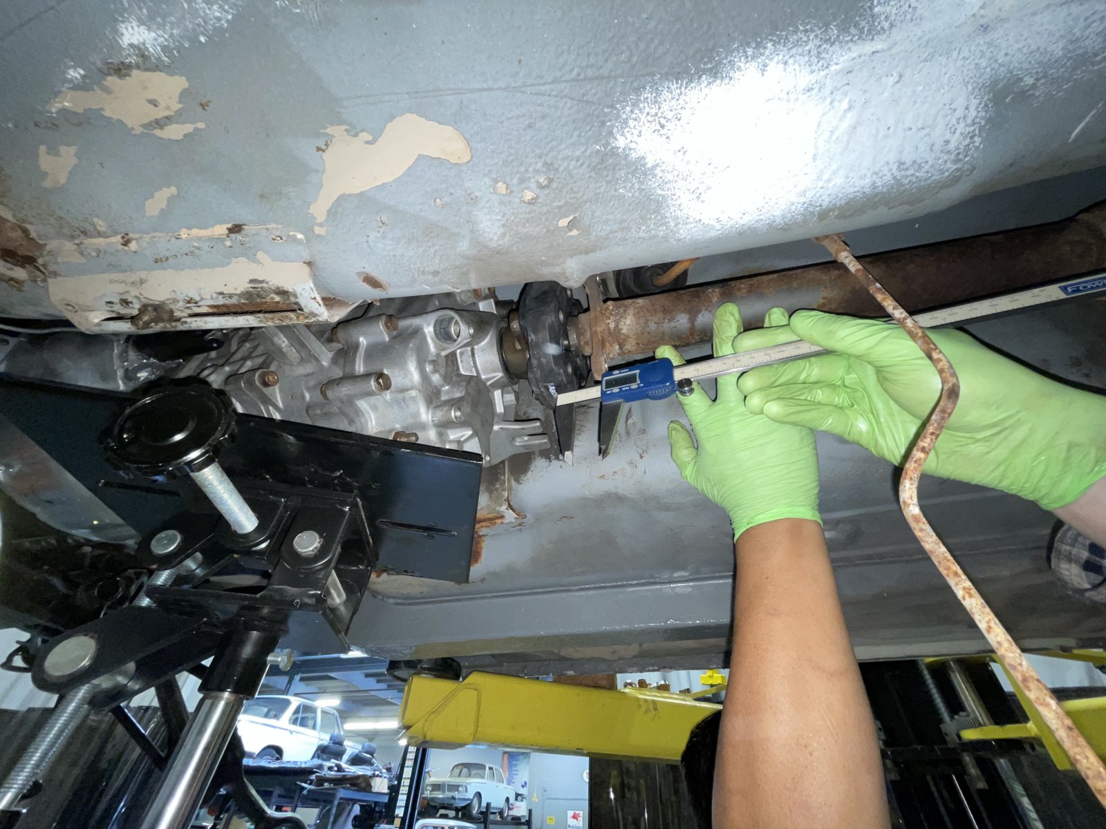

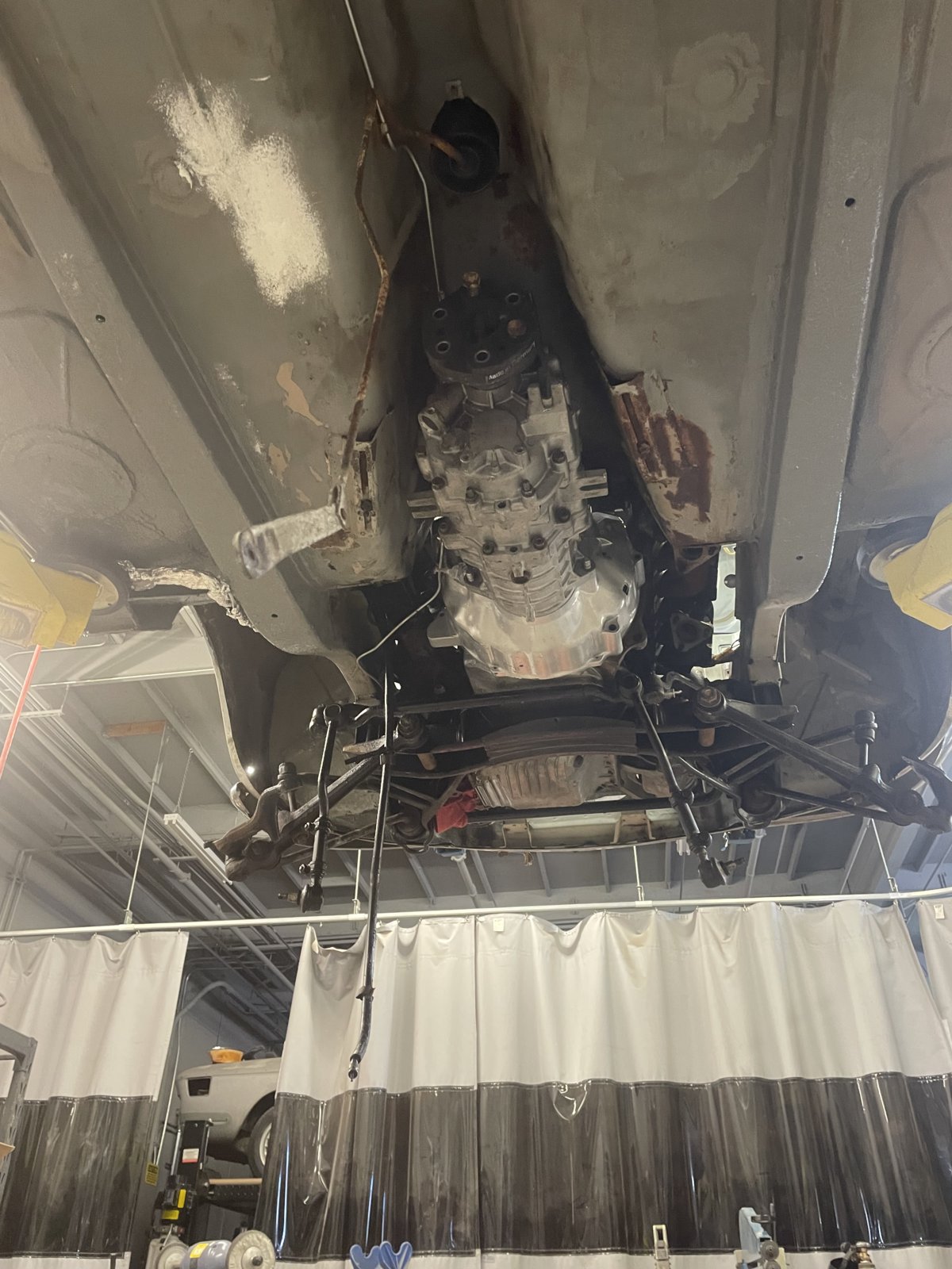

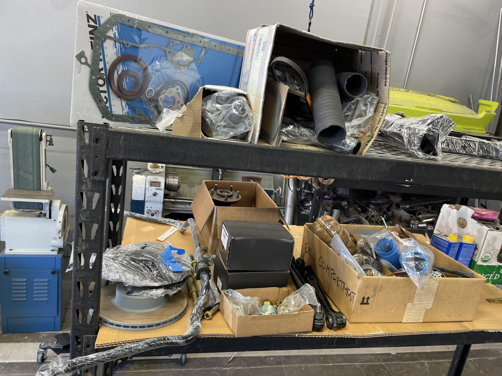

Image two, slowed us down. We did a quick re-installation, this time with the Getrag 265 attached to the engine (see image 6). This was to finalize what the new guibo depth was, holding up the original (auto drive shaft). This got us the exact dimension we needed for the lengthening this driveshaft - an item that is the longest leadtime for this project. It goes out in the morning for lengthening and a full rebuild and balancing.

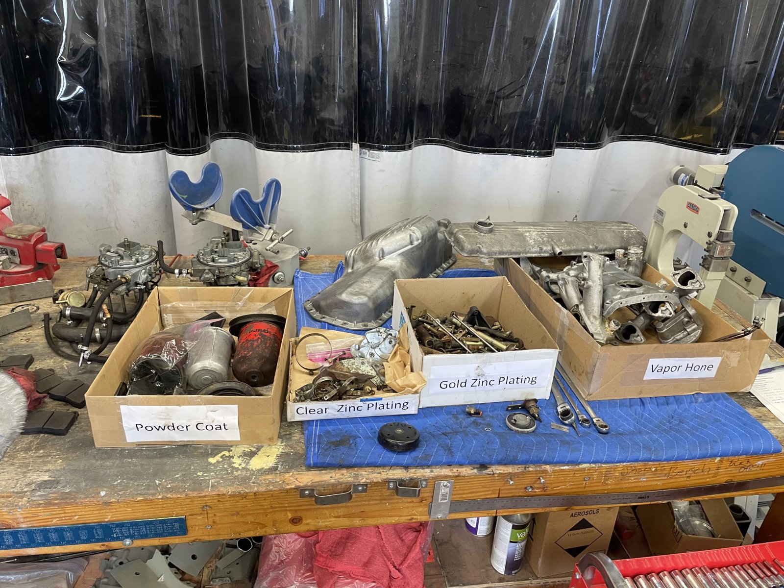

Image three was the really big surprise for day one. All the ancillary motor items were cleaned, sorted and boxed. All three boxed batches go out to different suppliers in the morning. This was really the big win of the day.

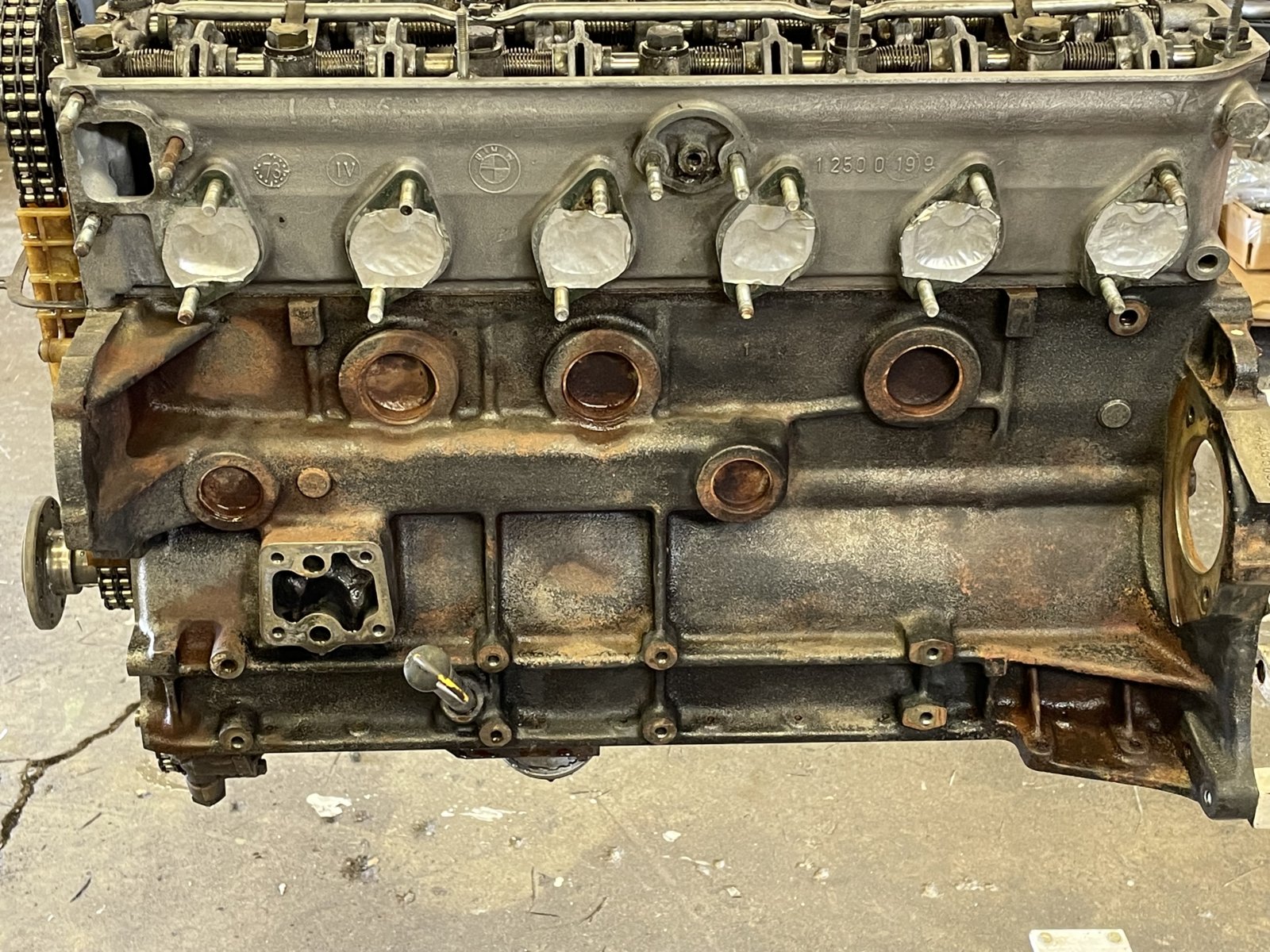

Image 5 was taken at 6pm tonight with the motor fully stripped down, tools away and ready for cleaning.
It all went smoothly. We had three really reluctant bolts but PB Blaster and some very focused heat, they all came out with no issues.
All in all, immensely gratifying.

Impressive--Primavera P6 or Microsoft Project??? You'd make a good construction scheduler. ;)
Deliberately avoided MS Project from prior career flashbacks. This was just for play in MS Powerpoint.

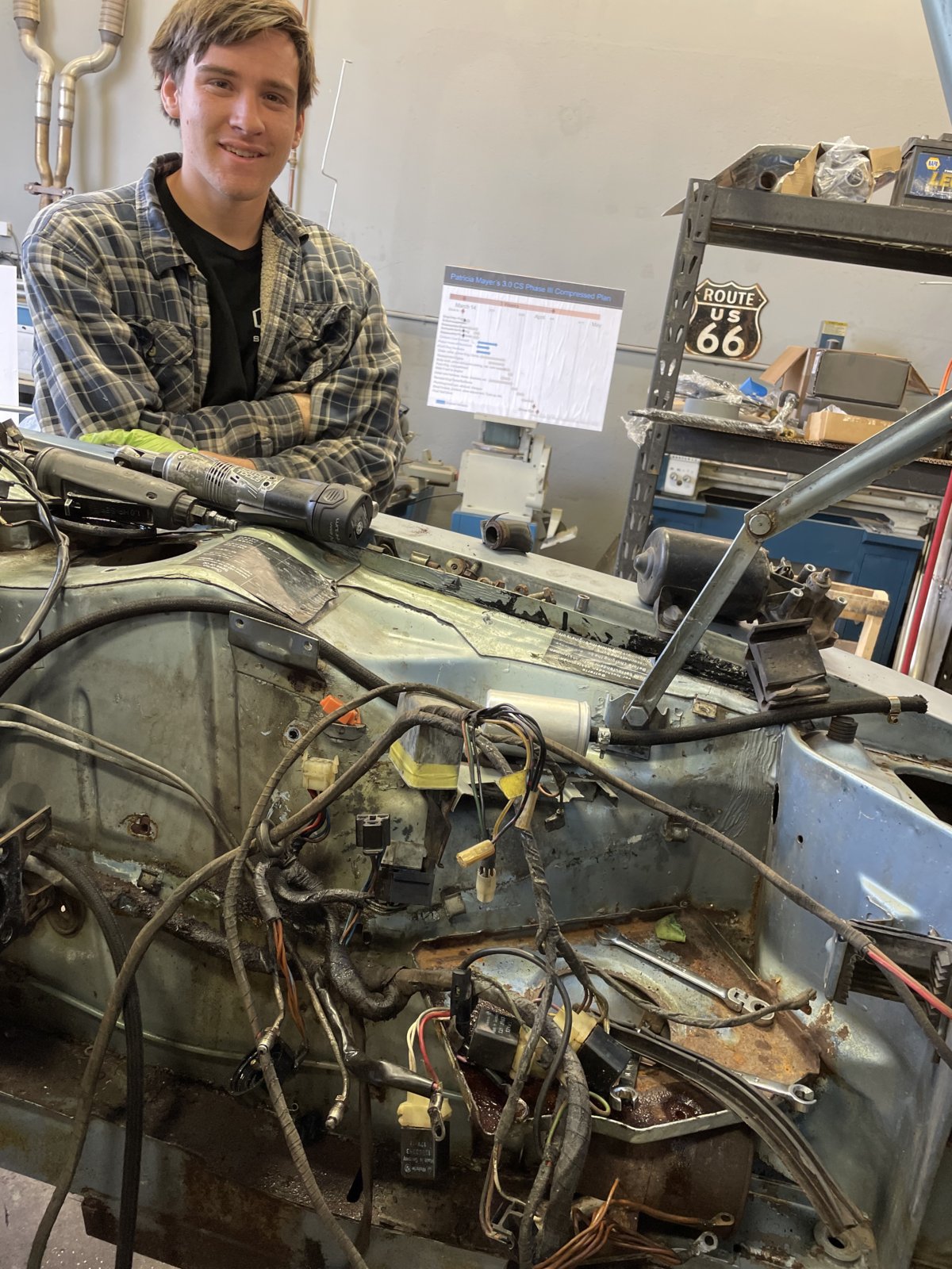

Another productive day. Introducting Dawson Graf -one of the mechanics at Reyn Speed shop. A pleasure to work with and he has a total 'can do' attitude. He's been absolutely key in making all this progress.
